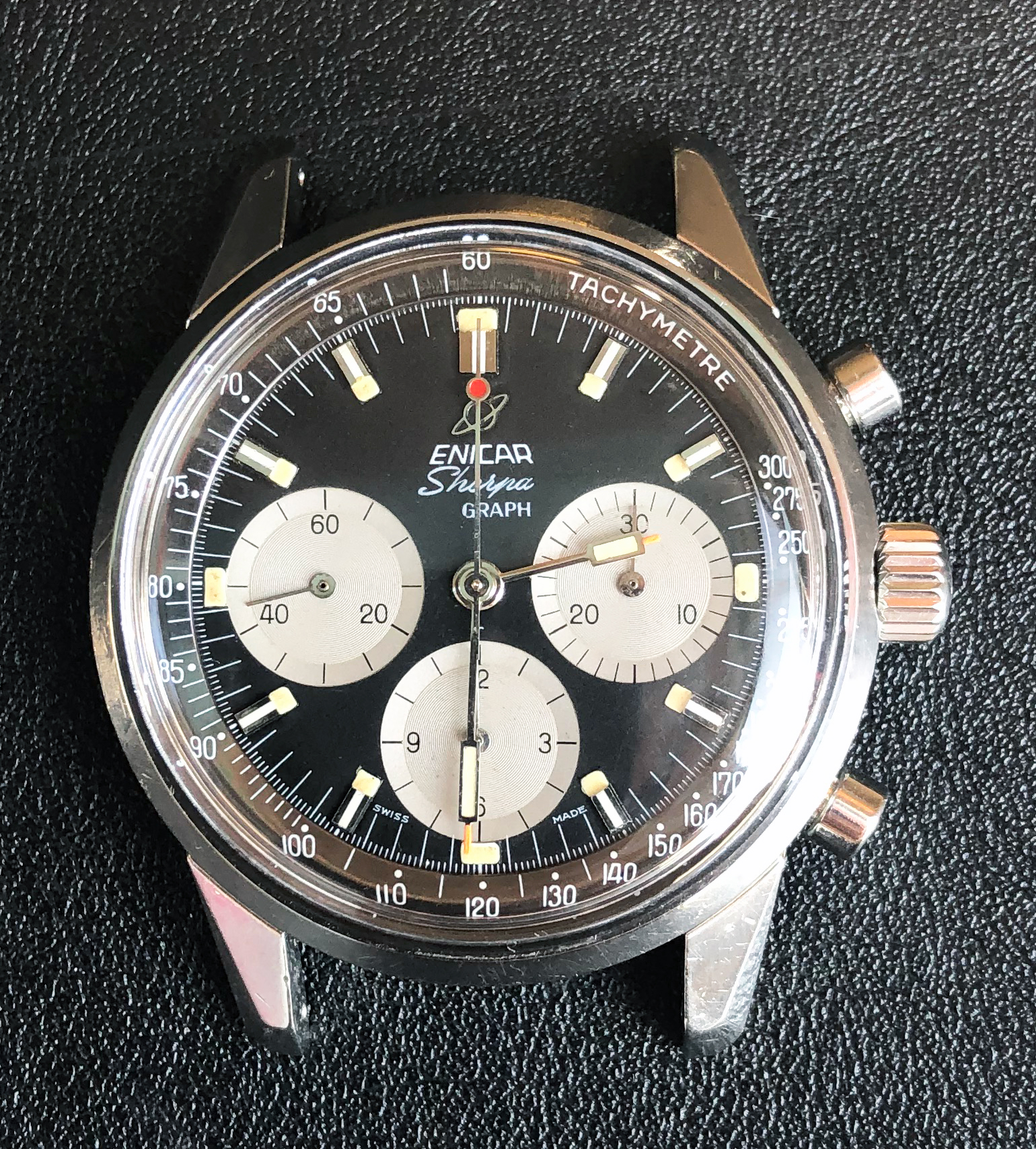

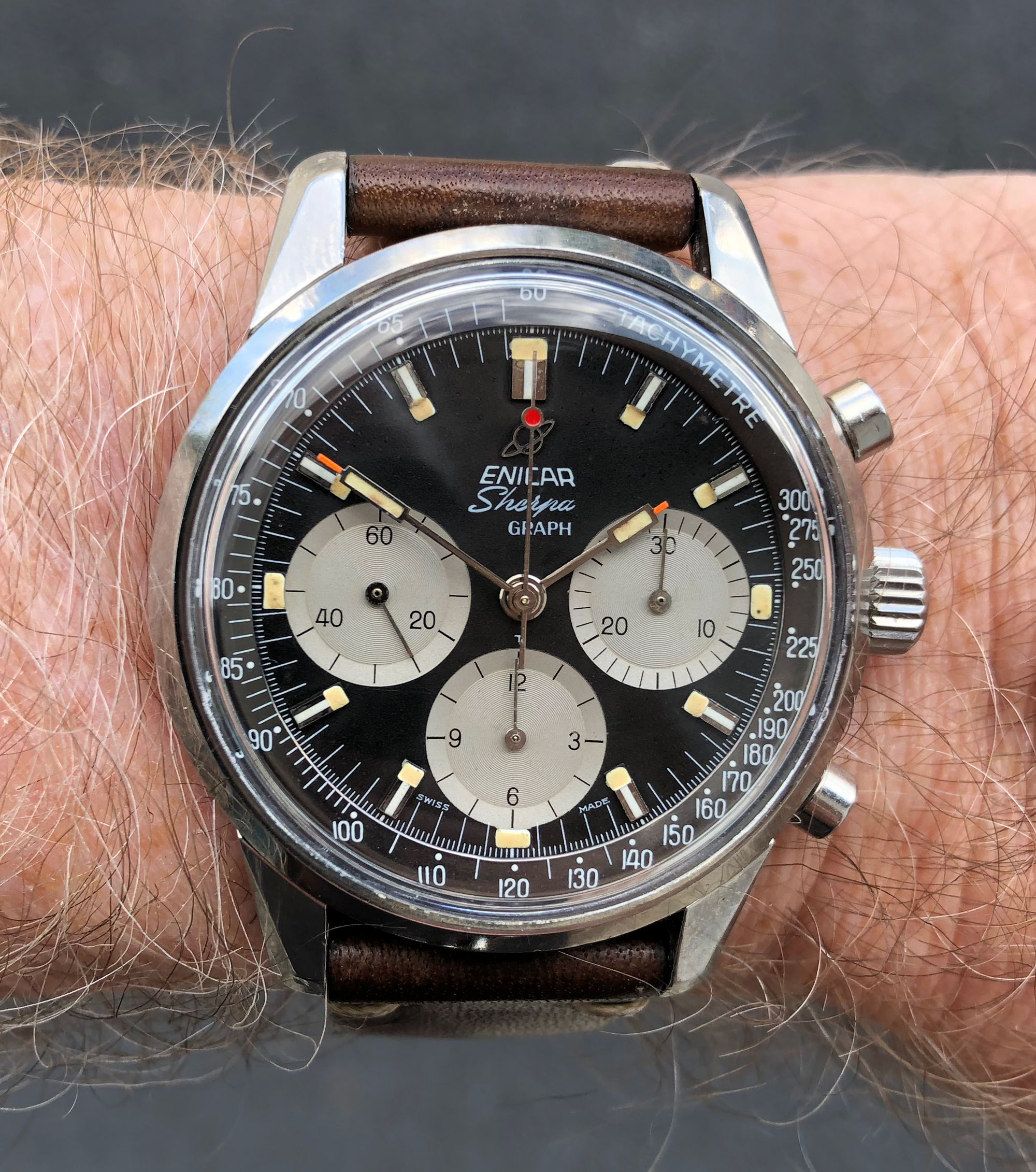

In September on a similar day and with the AC up especially high in the home that was still being worked on by contractors, I was wearing my Enicar Sherpa graph MK III that had just been serviced and had its rusty painted over central hands replaced with NOS hands that were pristine.
The watch fogged up badly, only this time as I dried it out, a very small bit of rust from one of the steel paddle hands very slightly discolored the lume.
Before:
Immediately after:
Just one single exposure . . . and never again if I can help it.
