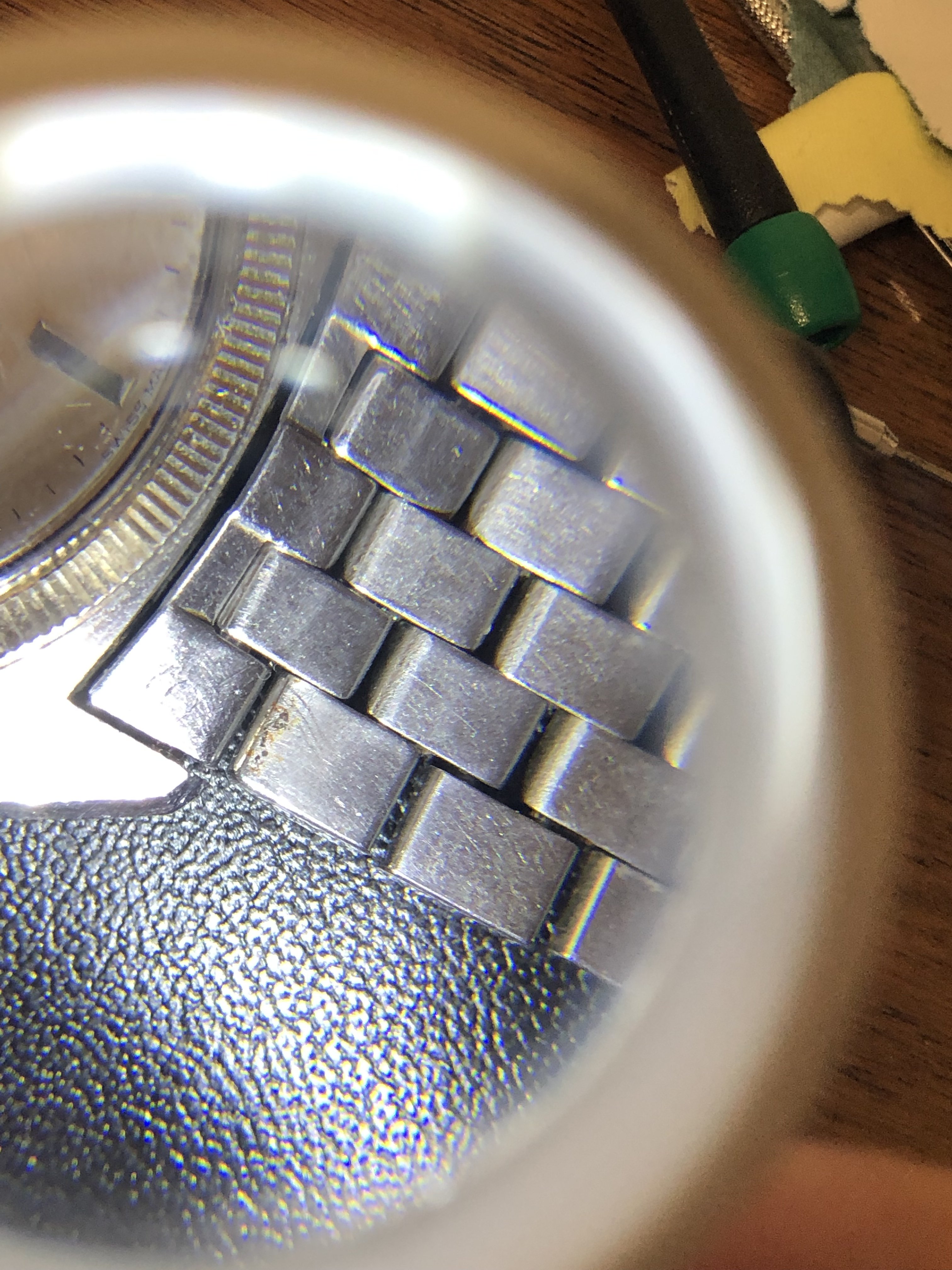

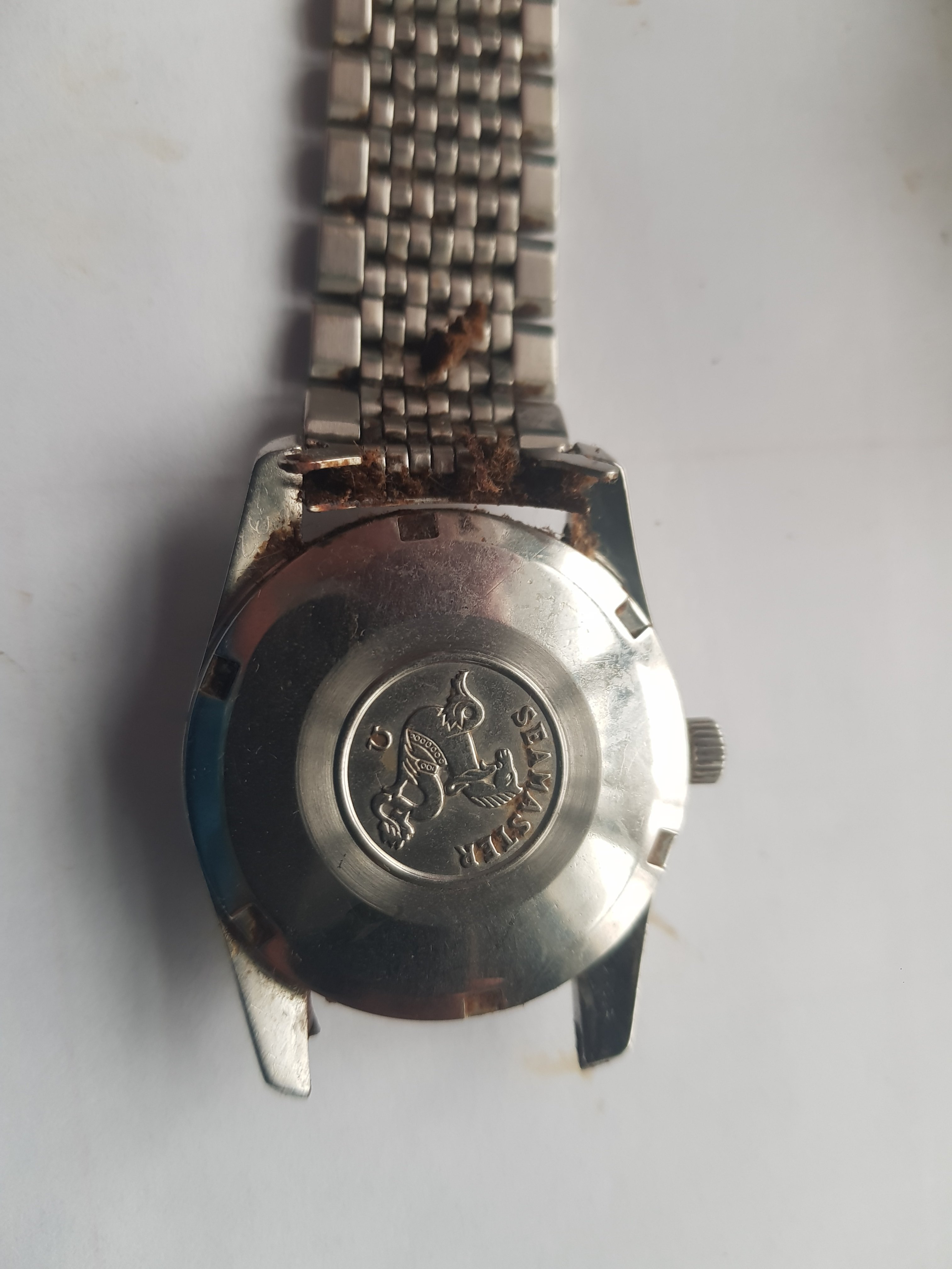

I wonder what can be done about rare corrosion spots
Once I left a bracelet soaked in WD40 for a while, shaked it from time to time, it cleaned the bracelet well too but I don't recall it doing anything extra
What do these spots look like?
2,681
3,161

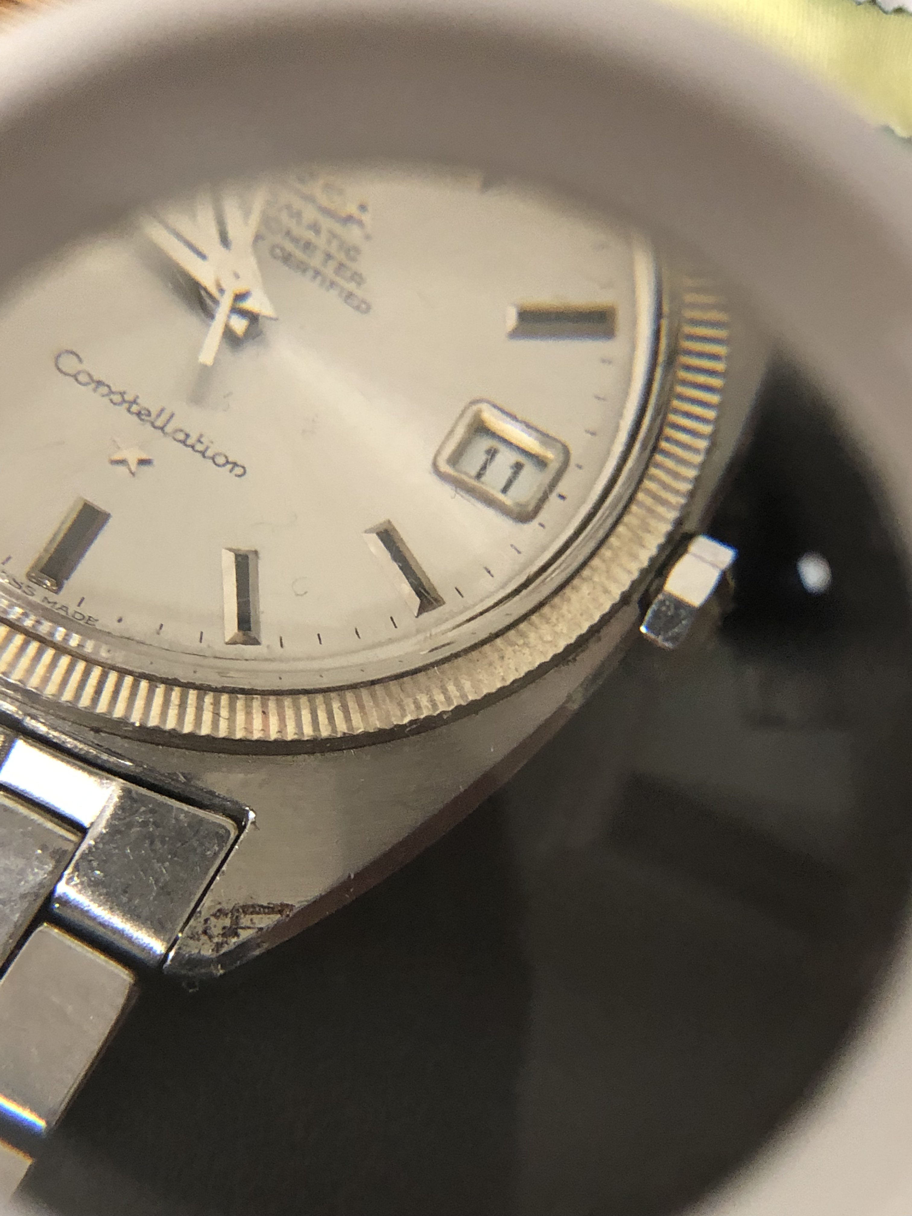

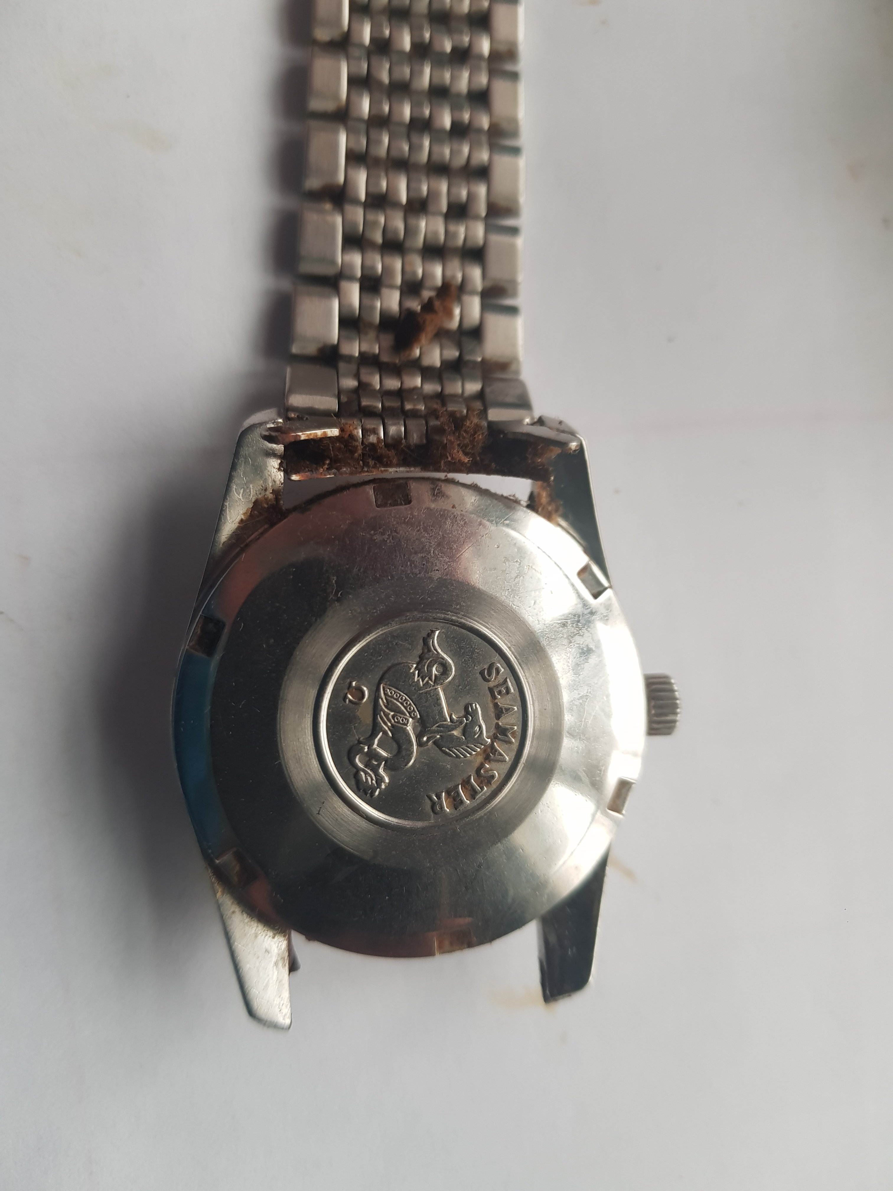

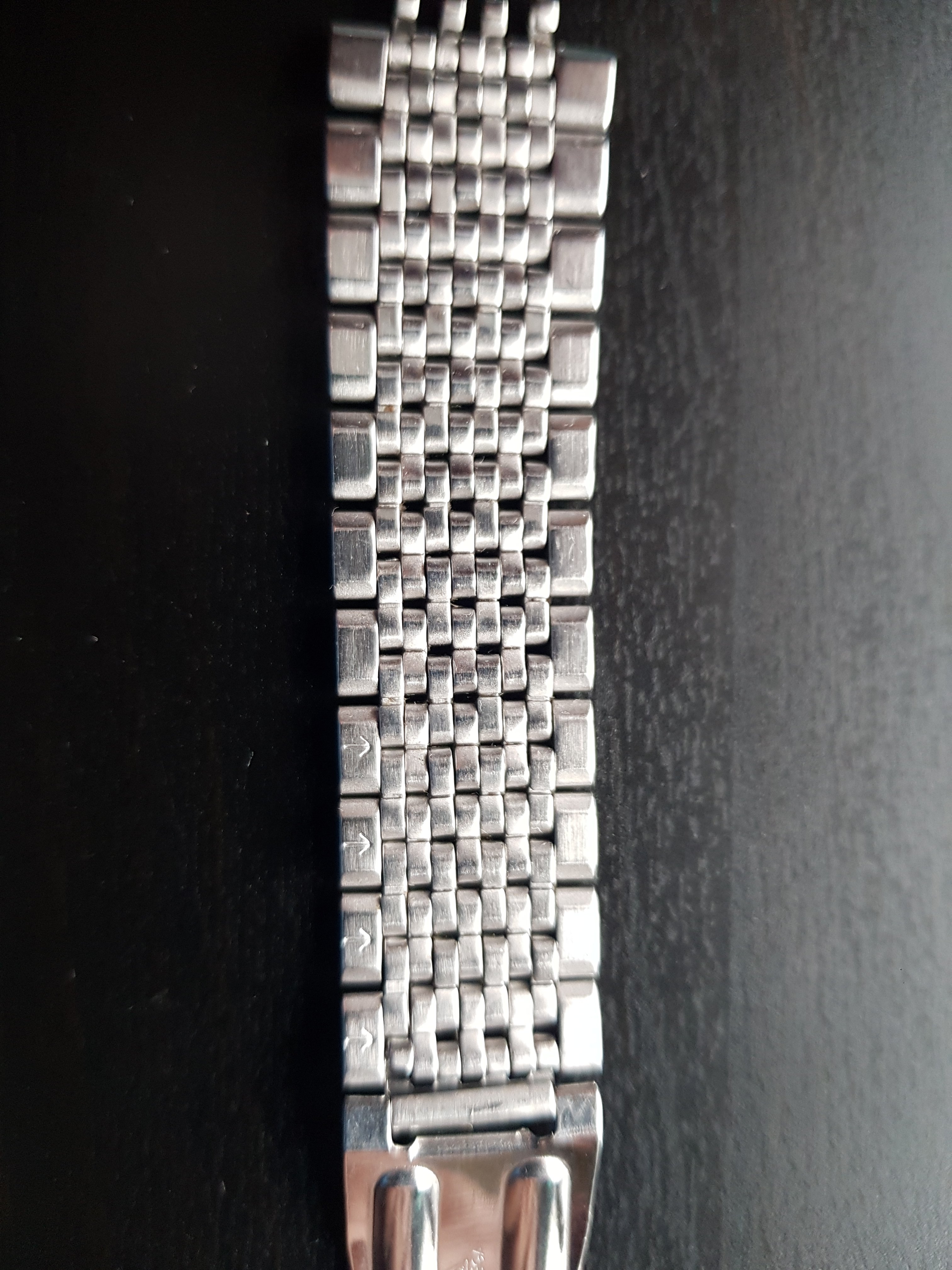

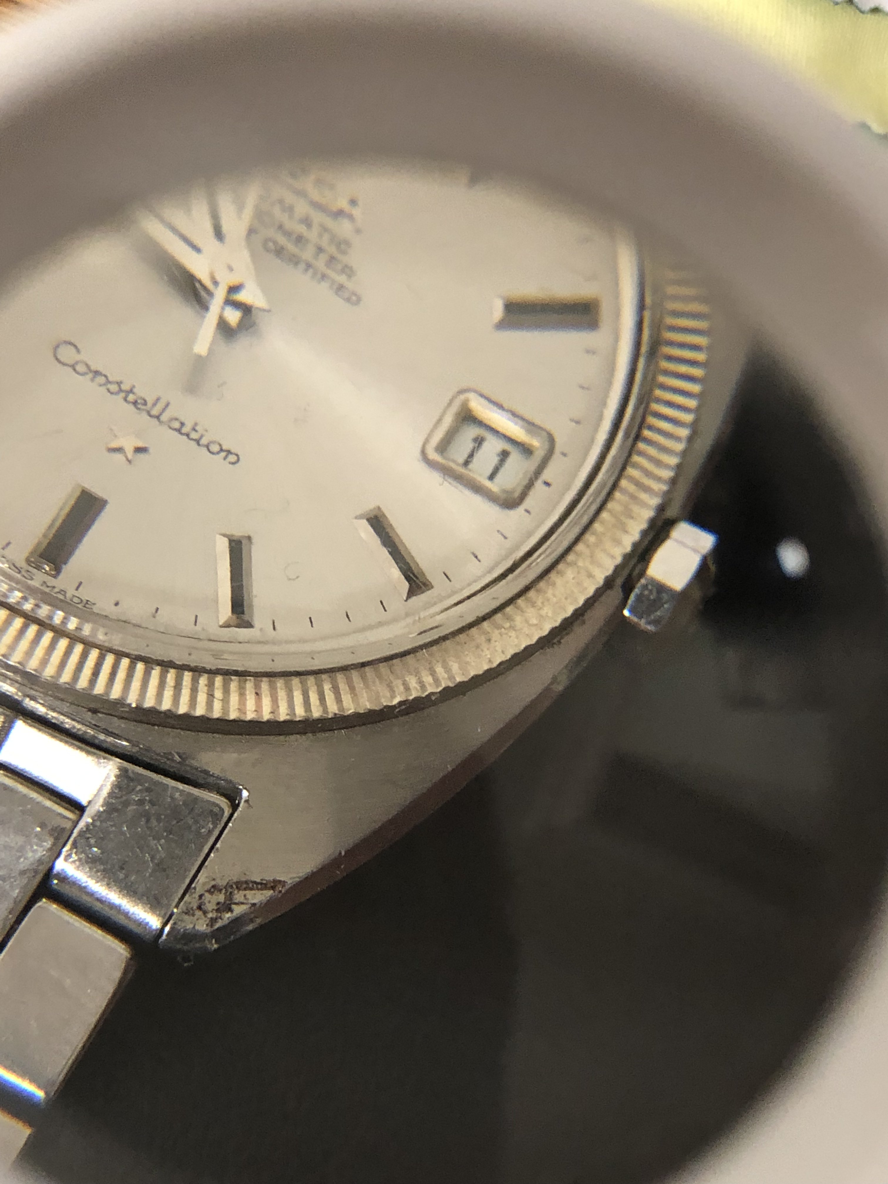

Found one on a bracelet, and as a more extreme example have this on a case :/ It’d look better if it was possible to get rid of the rust coloring on the case
Don’t know how the case got damaged, but the bracelet damage is because that part was inside the clasp and likely held humidity
There's not much you can do with the pitting at home. If you can find some evapo-rust that may help get rid of the brown colour.
Thanks, there's some Wurth / Winkel sprays here for sale - I might also check the watch repair industry in Turkey and see what their solution is, there's usually a solution, so far I've tried to ignore it and keep it original, but if it's possible to fill it and restore the original brushing, might be worth a try
My small advice for rust, it's best to first approach it with fingernails, the surface rust isn't that hard to remove and once the surface rust is removed, usually there's little to none penetrated rust underneath - fingernails also don't seem to mess with the brushing patterns

Sometimes it can be that stainless steel show some chemical reaction to acid so that some salts flock out - sorry for this unprecise description I`m no chemist 😉
Sometimes you can solve this just with a few drops vinegar.
Otherwise I use this white cleaning stone you maybe know it was initially invented by BASF.
