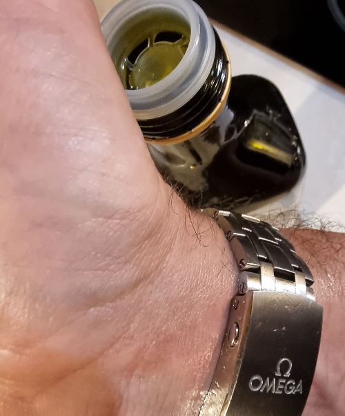

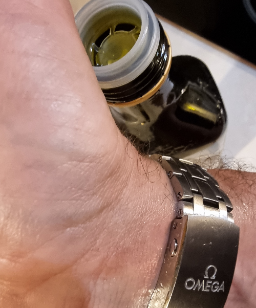

This happened to me as well with a new watch - I could not get it off my wrist !
I poured some olive oil into the clasp hoping to free it. In the end I put a screwdriver into the clasp and prized it open.
I took a few pictures expecting there to be some kind of argument about it. Took the watch into the Dealership in my lunch hour and they replaced the whole bracelet there and then. He said it was known issue and had a few in stock - I showed him the warranty and purchase receipt - all fixed, Happy days.
