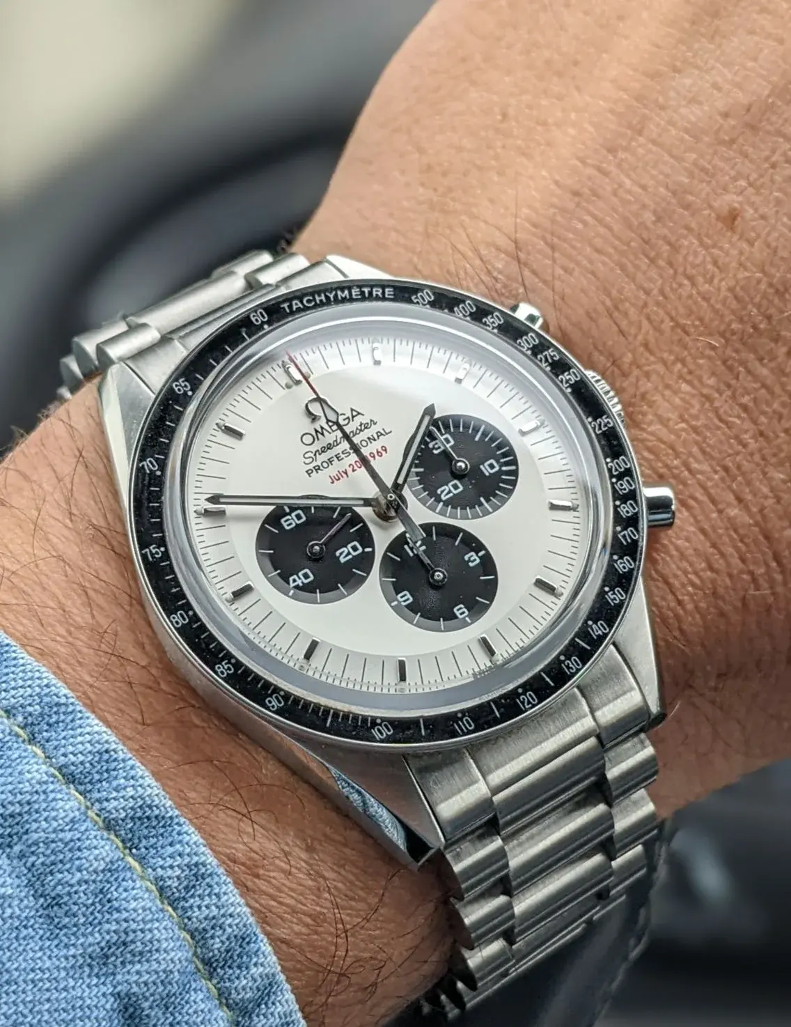

Hi all,
I have obtained a Speedmaster Trilogy 60th bracelet and well aware that this isn't compatible with the CK2998 in its current form. Does anyone know of any end links that will sit perfectly with the case and bracelet? I've heard STZ00804 is perfect but would like some advice before proceeding.
Thanks in advance.

I was under the impression you need the 1.5 curved spring bars to make this one fit to the CK2998.

Gotta go aftermarket with Forstner or Uncle Seiko endlinks

Yes, I think shares case with the previous FOIS. Uncle has more options with this particular model.

Any reason why you went with the trilogy bracelet instead of the flat link from the 321 ed white? trilogy bracelet is pretty chunky.

I use the 1450 and 1479. I also brushed the front of the lugs.

Do the end links on the ed white bracelet fit the CK2998? How much does Omega charge for that bracelet?
