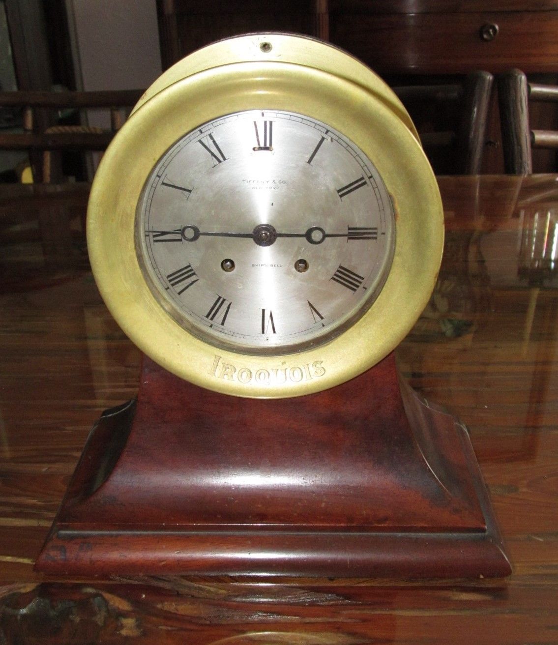

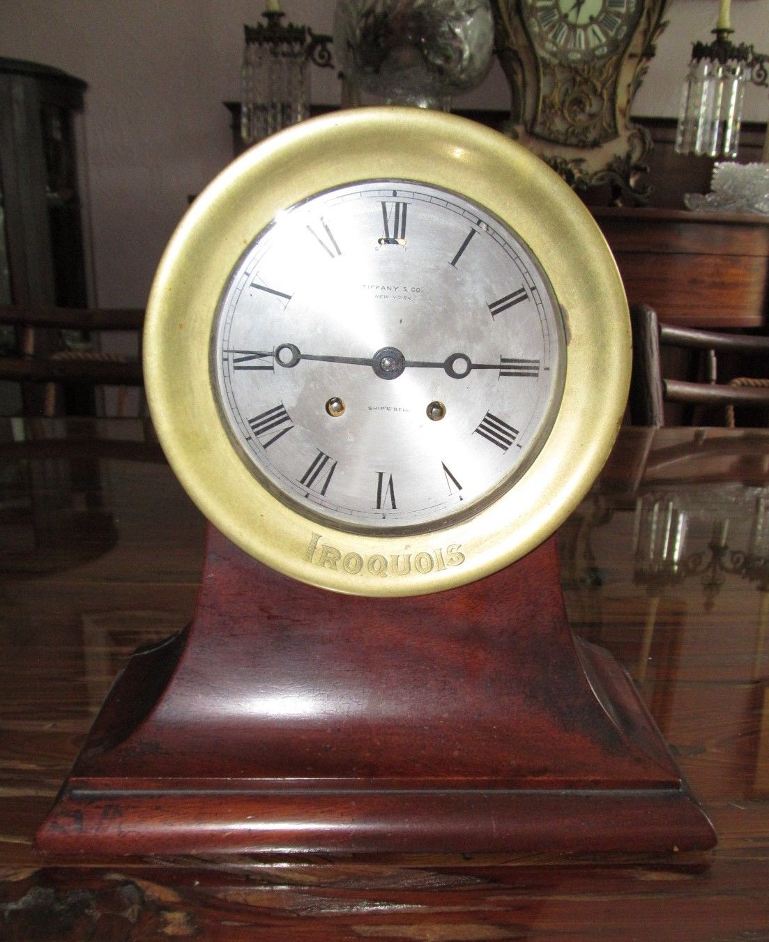

    I recently got this one off of Ebait ....
    sellers dis

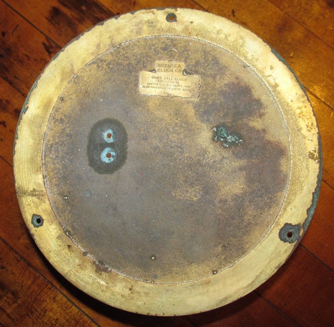

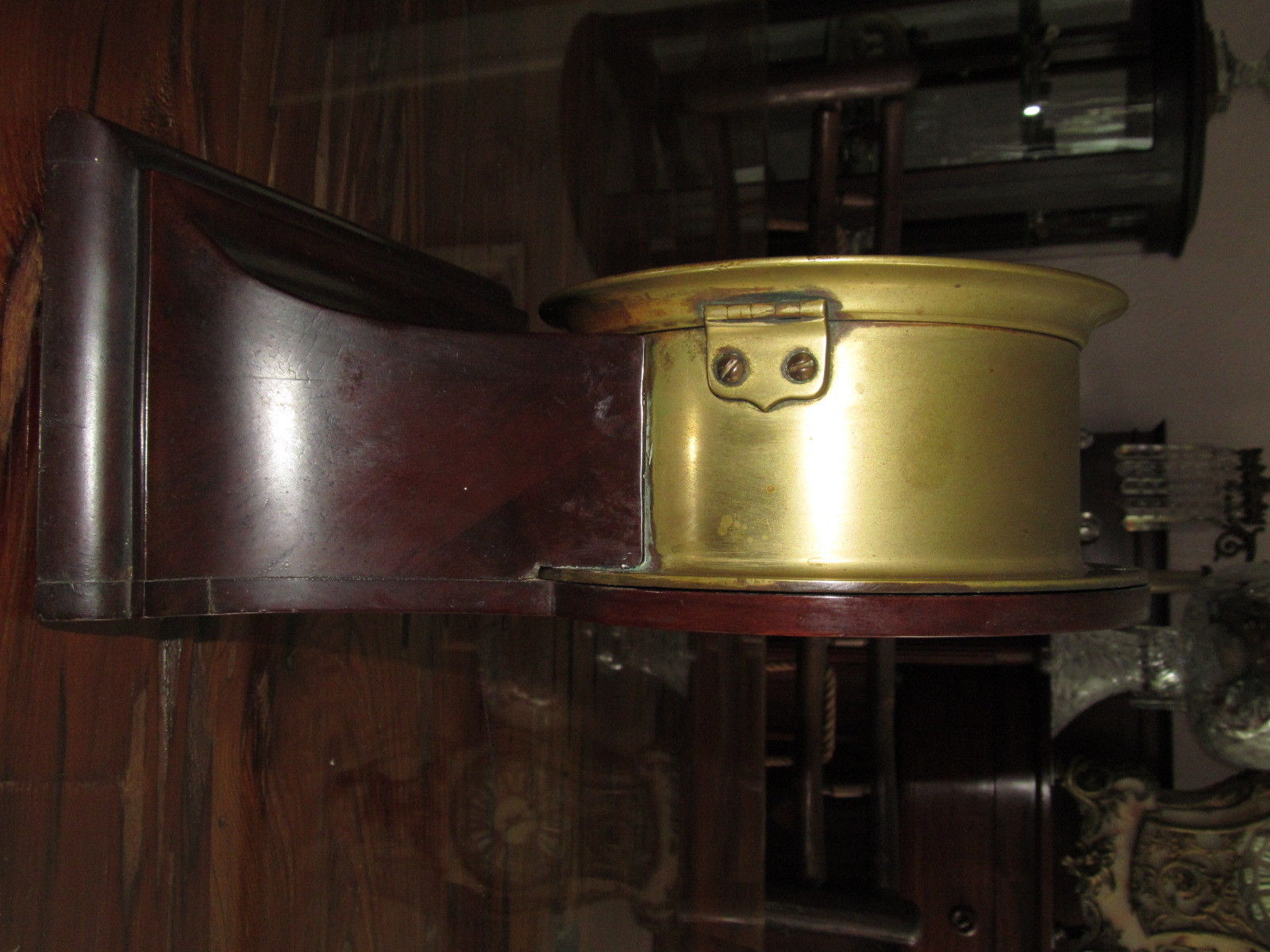

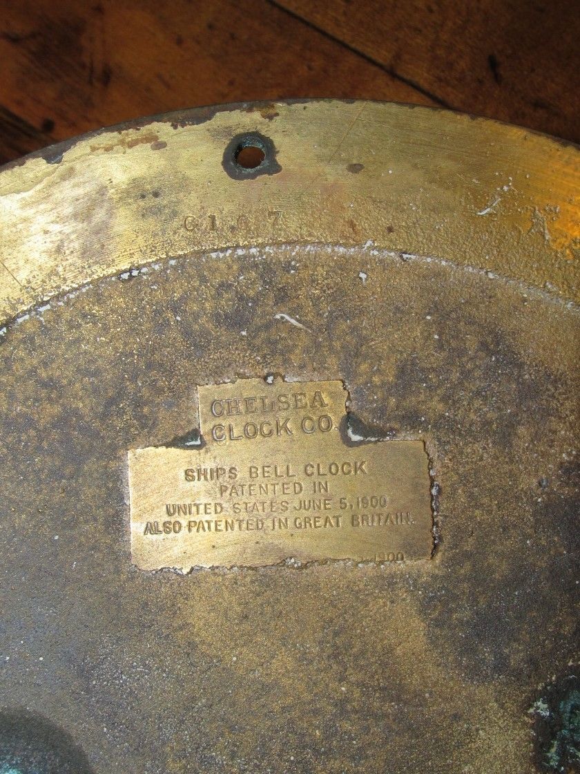

    Here comes for your consideration at auction a brass ship's clock that is the epitome of ship clock collecting! This is an early Chelsea Ship Clock with a Tiffany & Co. clock face. The makers mark on the movement and rear of case indicate the serial number is 6167. Dating this clock to 1900 for its production date. It measures 7 1/4" in diameter with a 3 1/4" depth. It has been on a custom Mahogany stand since being removed from its vessel. The stand measures 10 3/4" wide by 11" high and 5 1/2" deep.

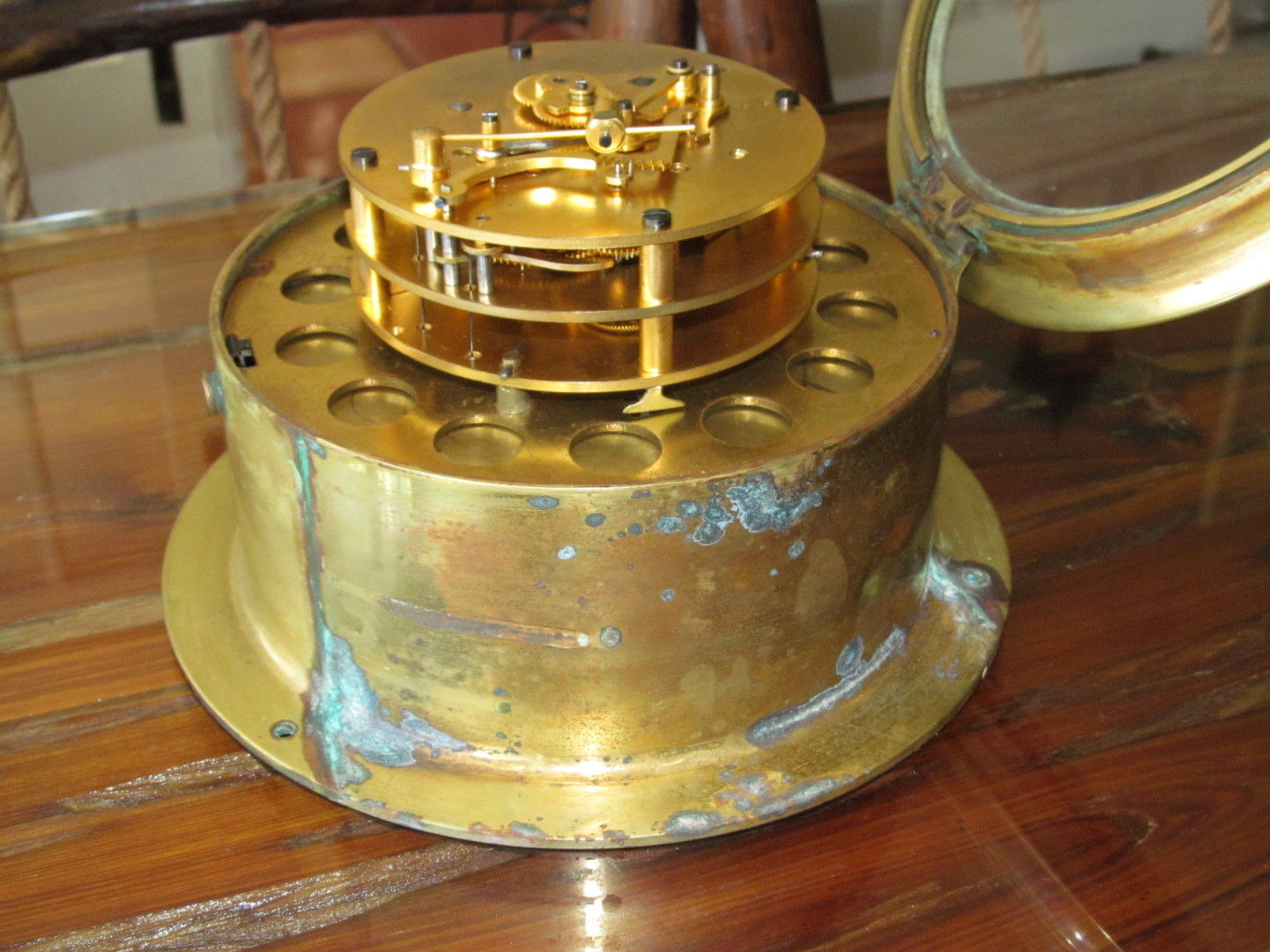

    The clock is running on and off and the ship's bells are operational, but it needs a good cleaning. It has been sitting for 50 years.

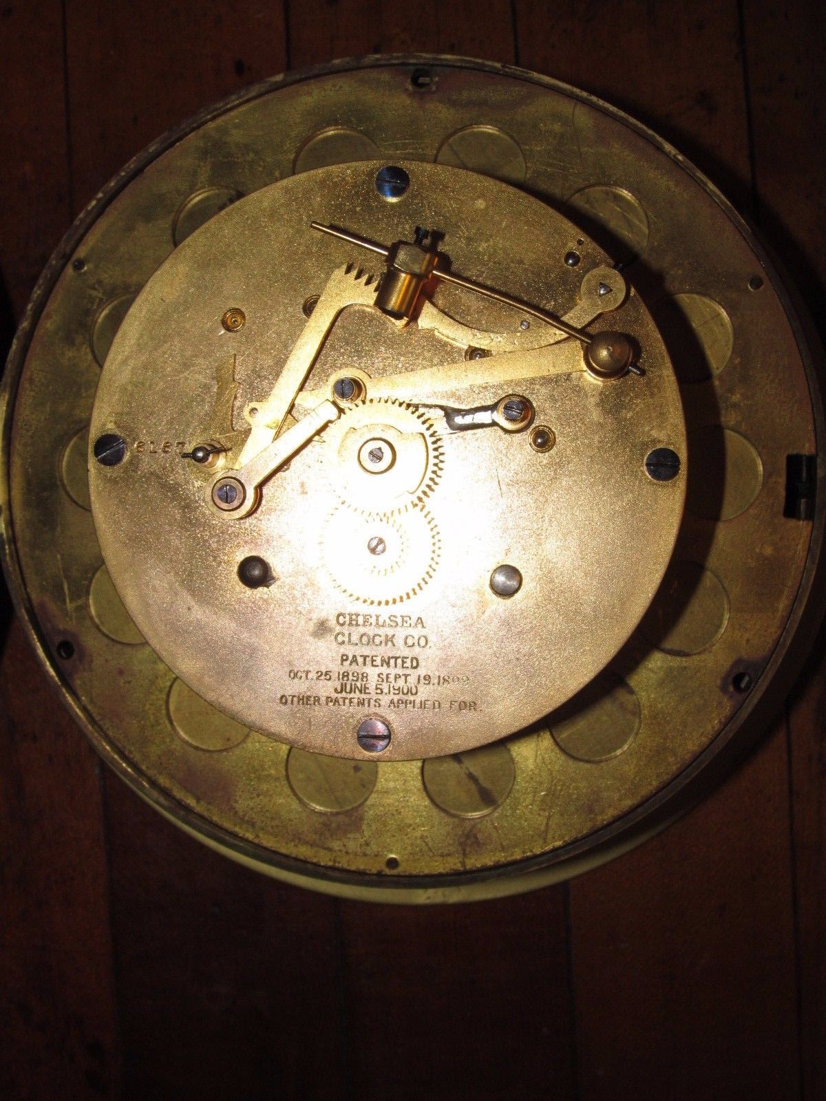

    Ok so I got the clock about 5 days later...

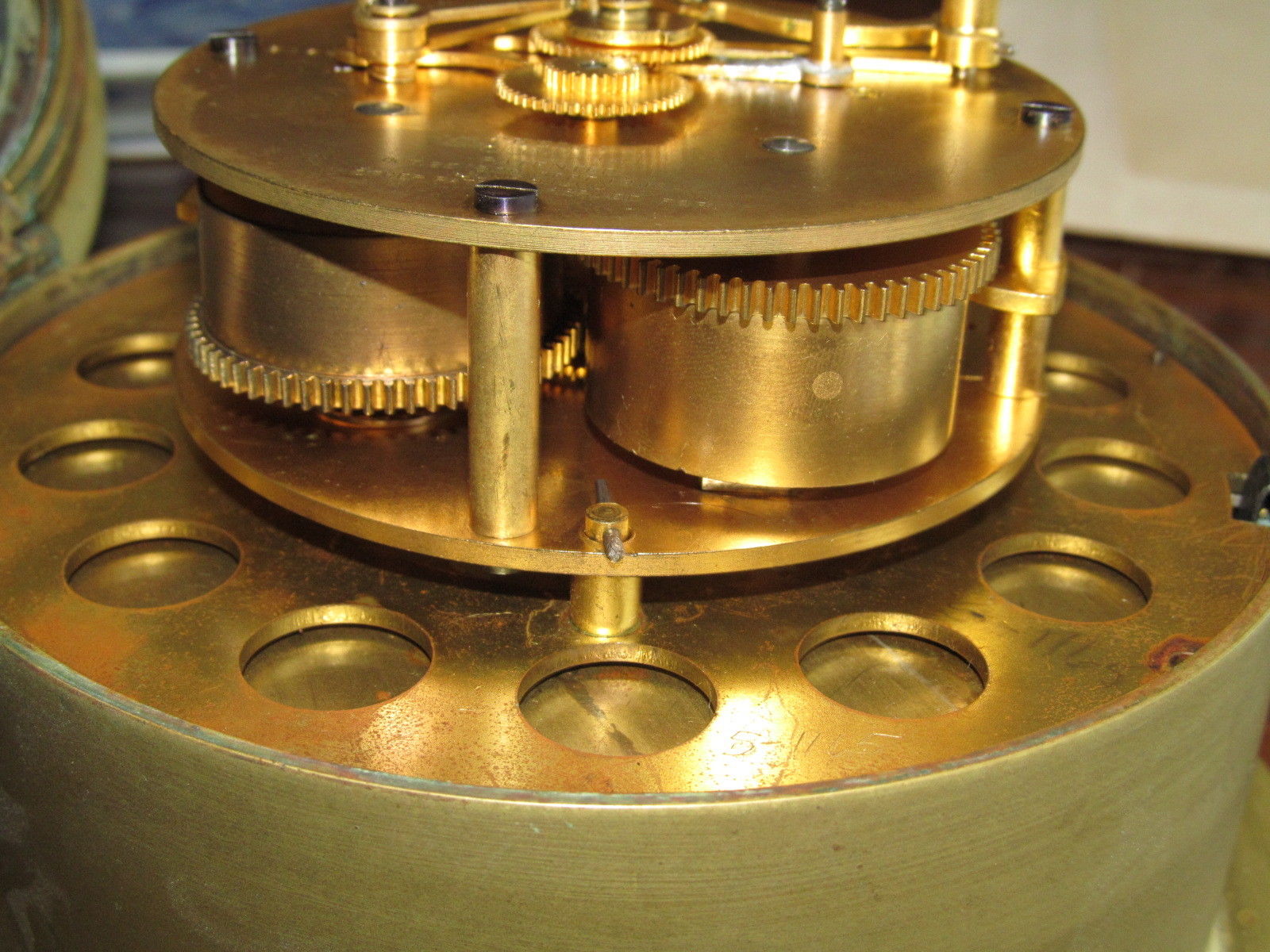

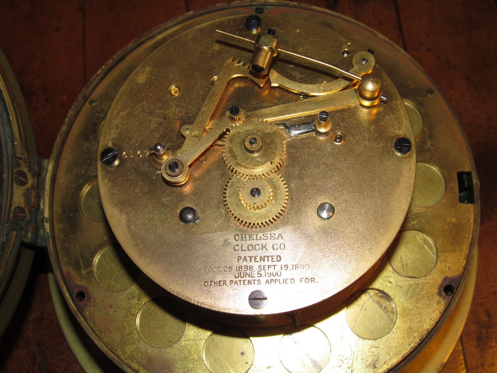

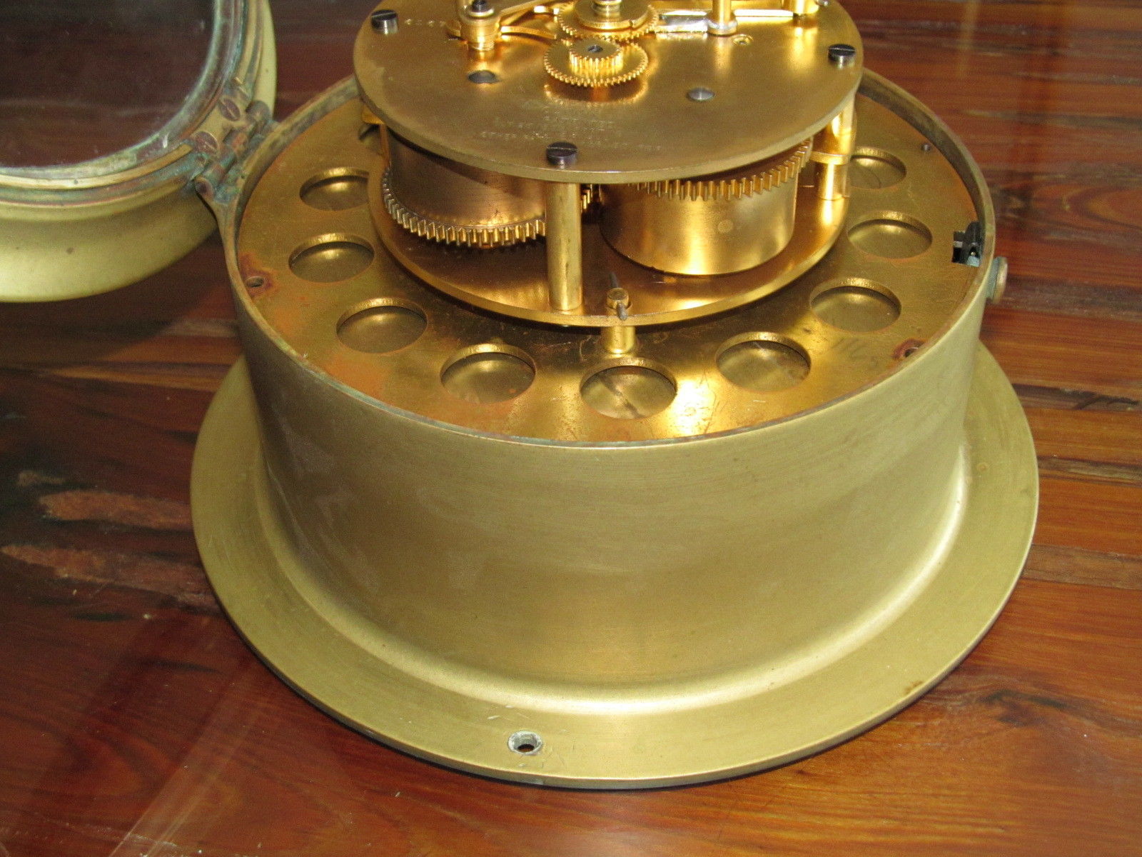

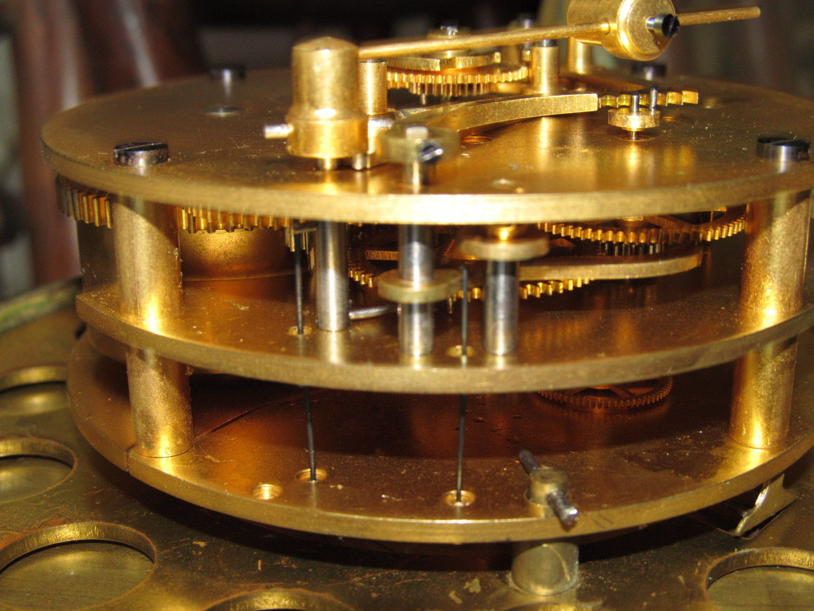

    Out of the box the strike was not working correctly, totally missing the gong ( coiled spring mounted in the back of the brass case.. I was able to adjust the hammer and that took care of that.
    I then noticed a silver solder repair to the lift spring ( that hold the hammer from striking even number on the bottom of the hour ) . It seems to work correctly so I am not going to muck with that.

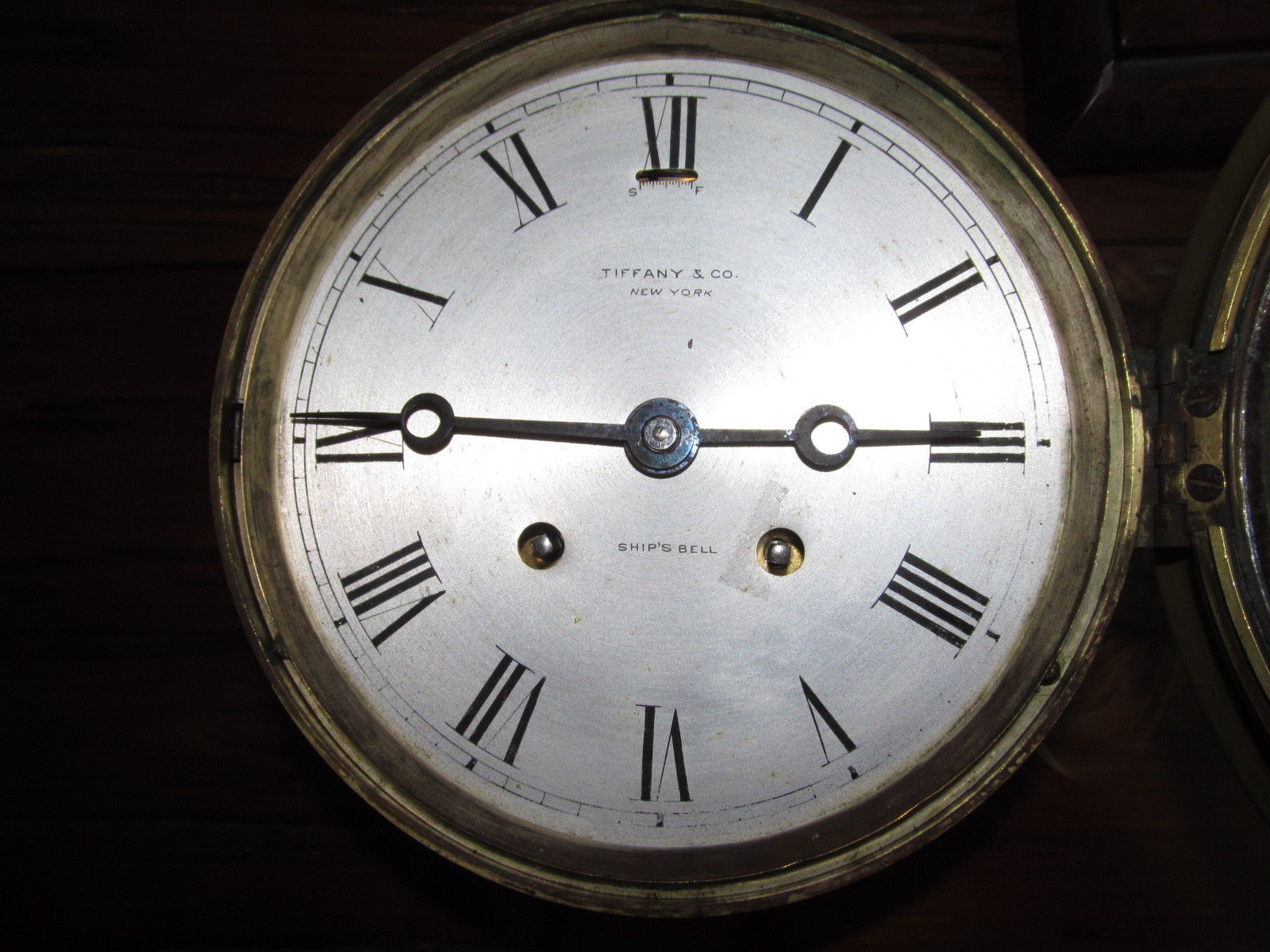

    Nest I put the clock back in its case... Noticed the hands were out of sync with the strike... The hour hand is friction fit so you can nudge it to the correct hour.... but the min hand is "keyed" to the pinion so luckly it was off by 180 degrees... a quick flip of the hand and we are in business...
    I wound it up and off she ran and its been over a week now and still going strong ...
    What I really like about this clock ... how great is a he-man clock with a girly name on the dial !!
    Secondly the serial number places it sales to Tiffany & Co NY to Oct 30 1902 ! Thanks to Eric at Chelsea !!
