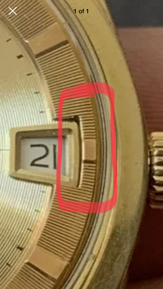

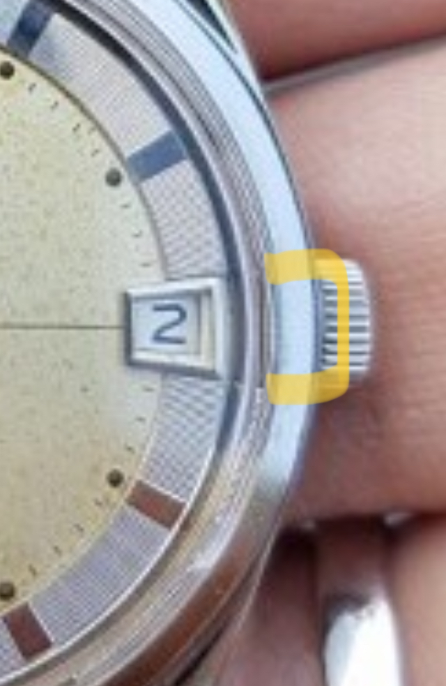

You can see some watch with a chapter ring completely cut for date window, thus looking like a “C”. Is it a franken with non date polerouter? or is it still legit ones?

I think the early Polerouter Date models had rings that had complete cut-outs for the date window (your second image above).
I think later Polerouter Date models had rings with partial cut-outs (your first image above).
Polerouters (no date models) should not have any cut-out.
Apologies if I've misunderstood your question.
409
1,074
The 204503 and 204504 (besides the (-2BD) had a non-joined marker ring, like in your second photo.
This is because they used a 215-1 movement, where the date ring was further out from the centre of the movement.
When UG changed to the new 215-2, the date ring moved inwards a few mm, and the marker rings could be joined at the edge (like in your first photo). This type of marker ring continued through into the 218-2 and 69/1-69 powered movements.
