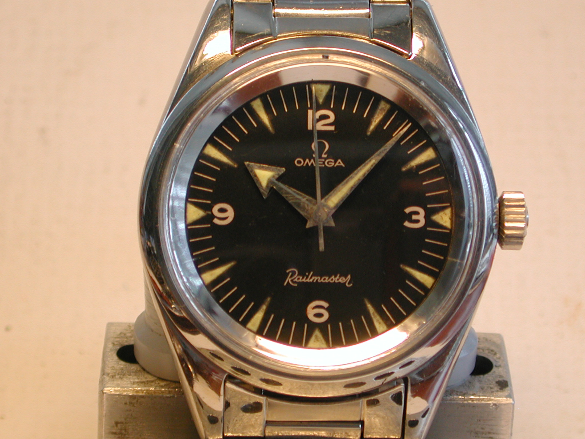

    I have finally purchased an original crystal with the large white retension ring for my Railmaster 2914 which will finally make the face of this beautiful watch look as it should. Only I am not exactly sure if the exchange is done as with a Speedmaster where I already executed it several times.
    My question: Do I need to remove the outside retension ring (silver bezel) or does it remain in place during the process? Or do I simply press out the old crystal and this bezel will come off by itself?

    the ring stays in place when pressed in. simply pop off the old crystal with your thump and press the new one in. some lubrication of the edges will assist..... show the finished work, pls. kind regards. achim

    Finish. Once again thank you achim for the adivse :thumbsup:
    [​IMG]
