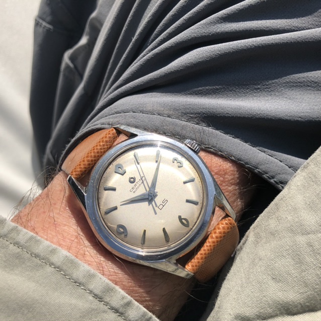

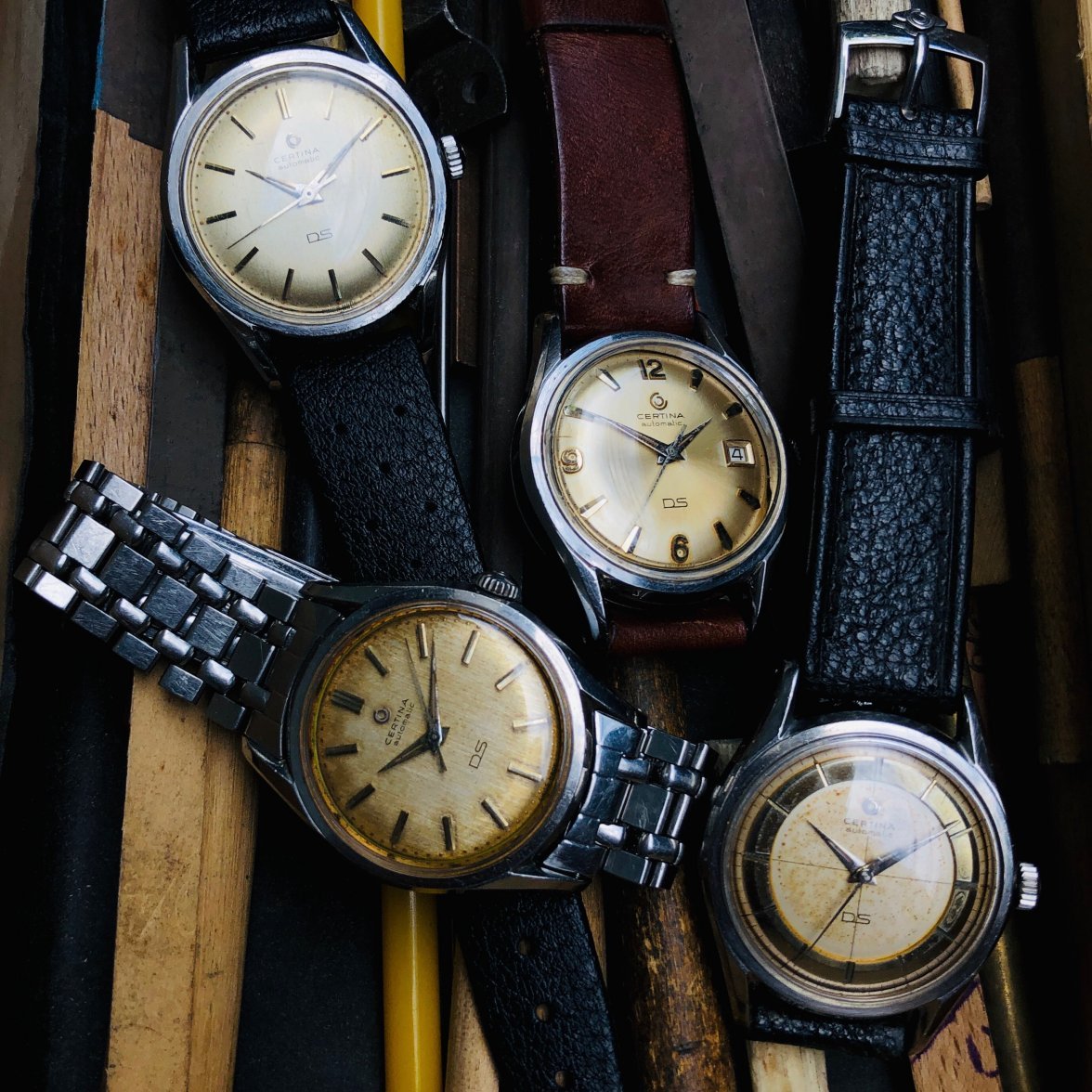

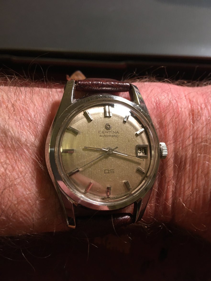

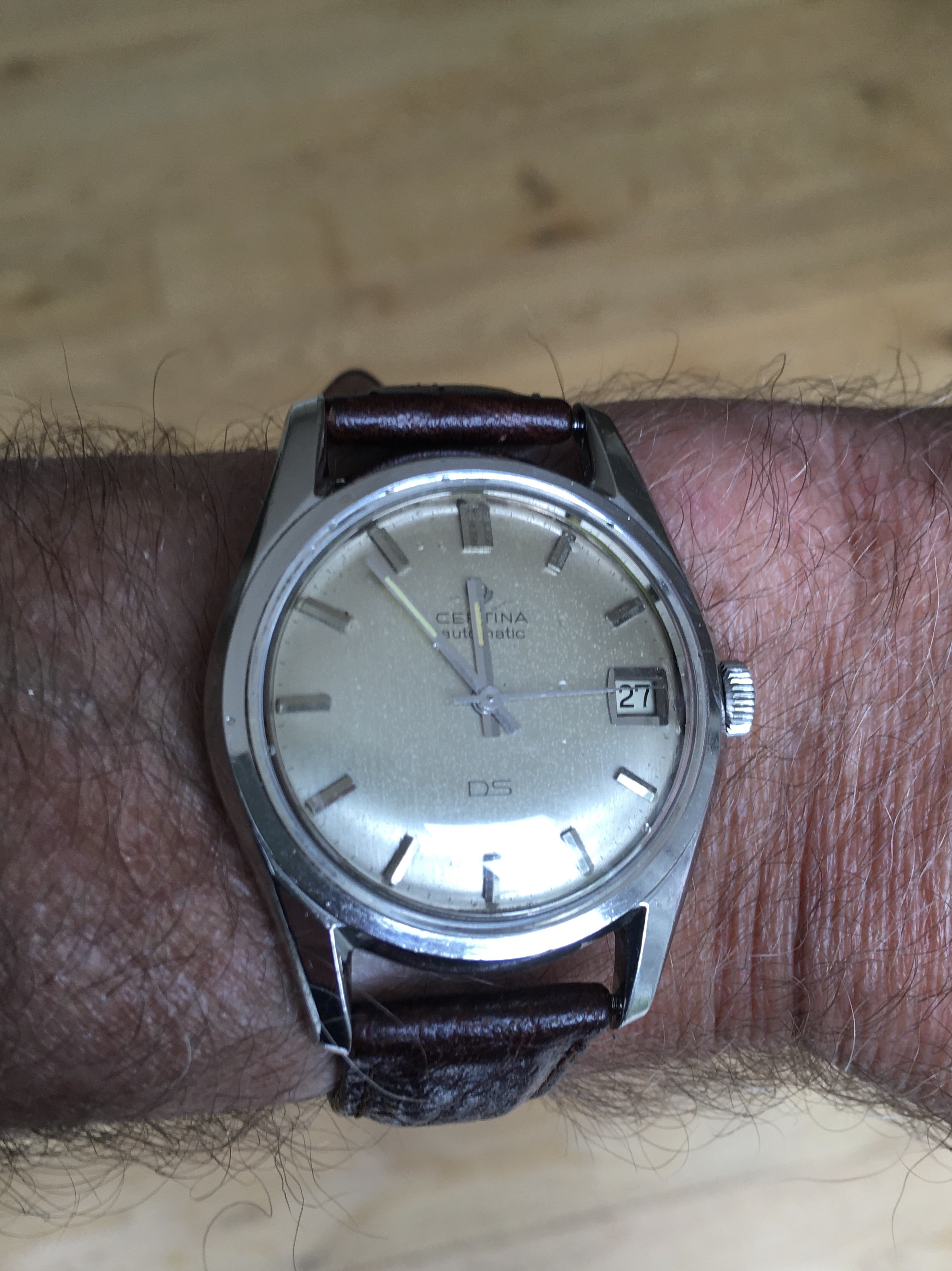

I’m intrigued by the different types of Certina DS hands and wonder if someone can clarify.
These two recent posts of 60s watches all show very attractive dauphine hands.

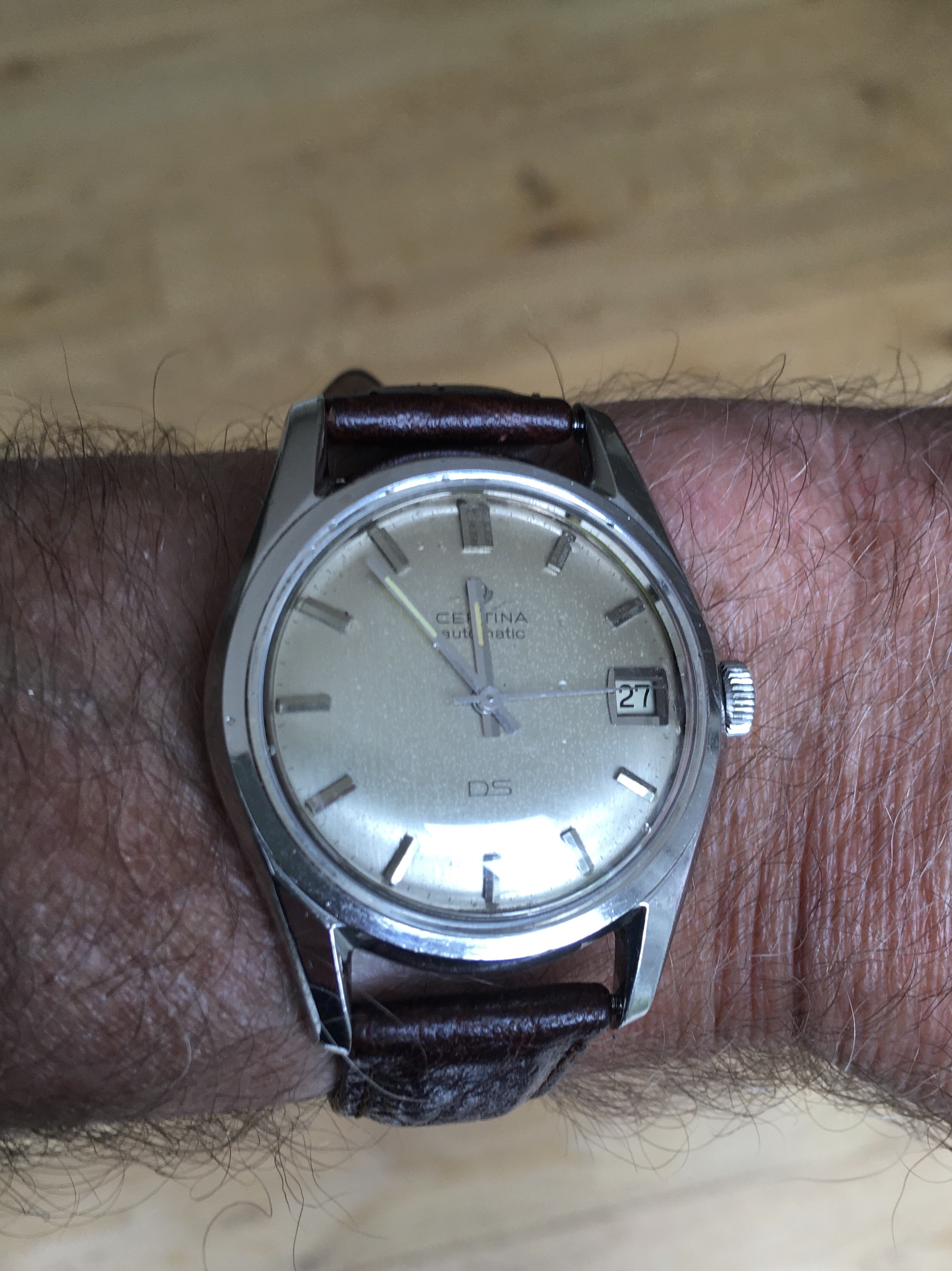

My mid 60s turtle backed automatic has stick hands. I am assured by both the OF member (based in Italy) who sold it to me, and by my watch repairer that all the features are original (although I have swapped my hour and minute hands for nicer originals taken from a spare parts watch in Poland).
I look out for these watches and browse various sites including Chrono 24, which has a good selection, all of which are sold by European sellers; French, German, Dutch, Italian, Polish etc., and all of which (currently) seem to have stick hands.
So, two queries, if anyone is able to assist. Did Certina change the types of hand on the DS and, if so, when? And second, if the hands weren’t changed, were thewatches designed to be sold in different markets, for example dauphine inScandinavia and stick hands in Central Europe?
Thanks in advance,
Robert

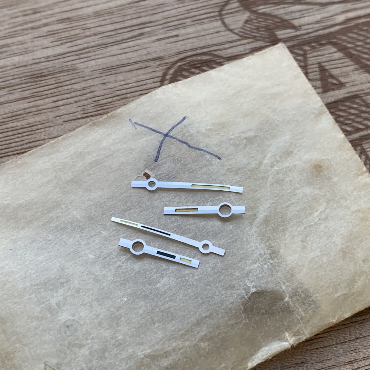

Stick hands were used, but the ones you show are not correct. They were (i.e. should be) wider. Examples:
ds1-9-jpg.697429
There were relatively narrow hands used on some variants:
I do not believe that the hands were connected to the various markets.

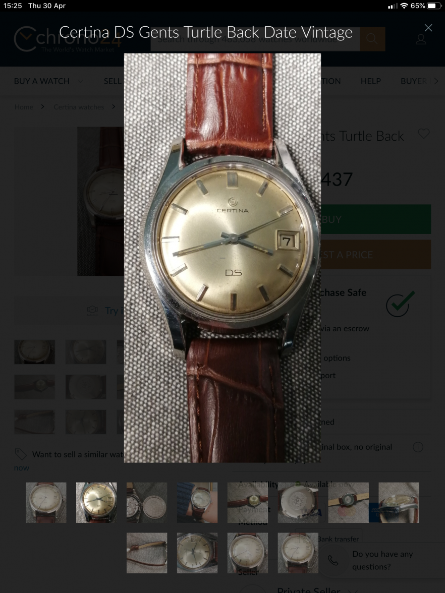

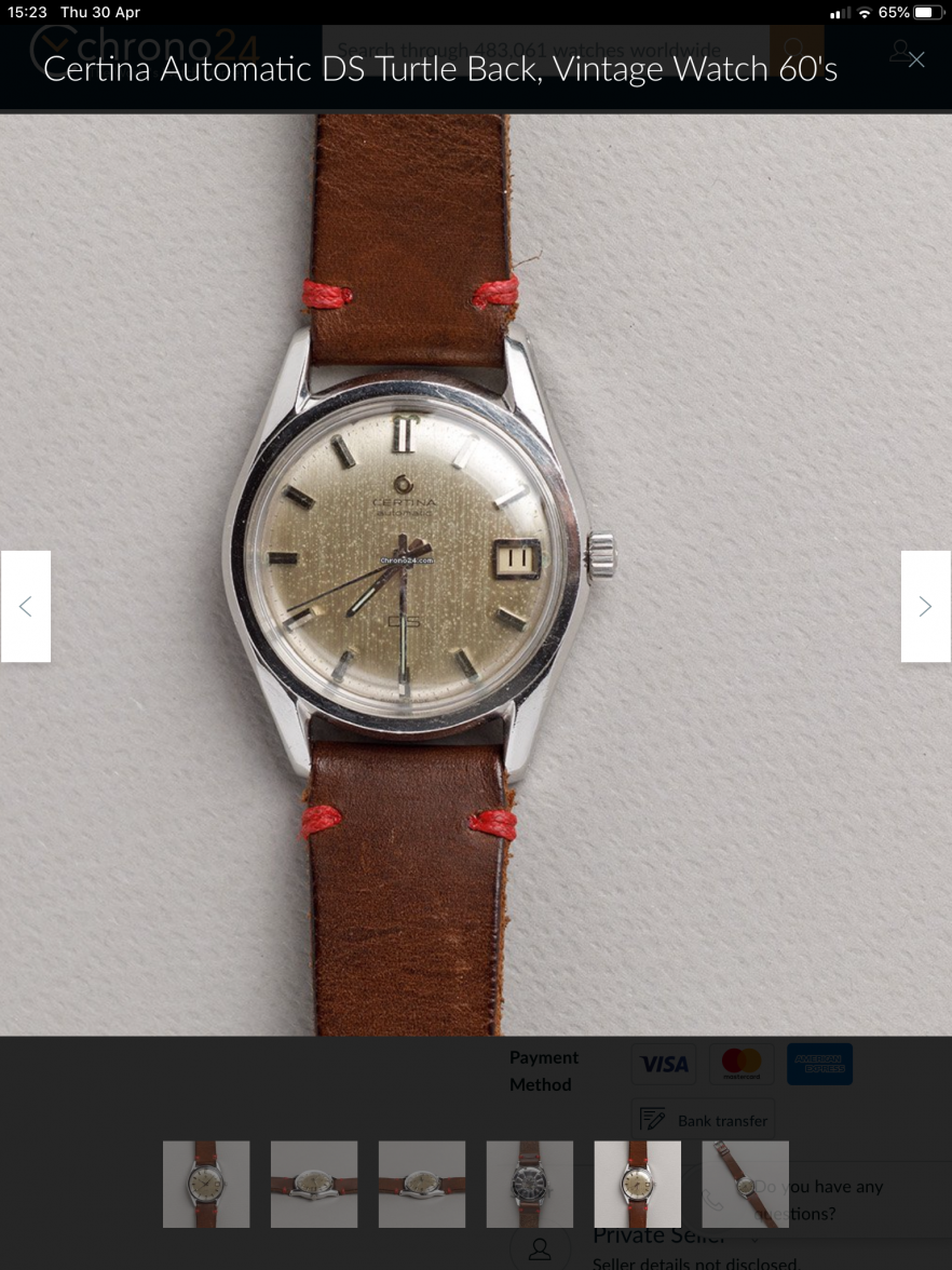

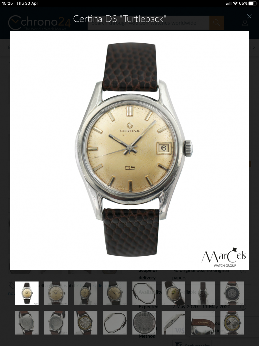

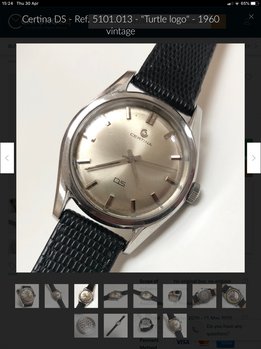

I thought it might clarify my interest if I posted 4 of the five watches currently offered on the website I mentioned and to which I referred, in general terms, above

As a rule of thumb, dauphine hands were used mostly on early models while stick hands were used on the later ones. Sword hands are uncommon and found (I believe) only on a few dial variations.
The stick hands should - in my very humble opinion - only be of the sold type, ie. without the band that runs through yours. Certina used the same movement family across the board on a series of very similarly sized watches, so swapped ones are very common to see. It would appear that the minute hand is a tad short as it should reach almost to the edge of the minutes track.
I would say that your stick hands are from a later reference, perhaps a Certina Club?
Yes, there were more narrow hands used on some models, but yours are not correct. The hour hand is clearly too short, etc.

Thanks for all the above. I’ll have to think about looking for a set of hands.
9,588
27,706
If you don't find any, let me know. I probably have a pair lying around.

Hi
I back up the statements made. if you browse through the catalogues on vintagecertinas.ch you will see that the change from dauphine hands to these we talke about happened between 1964 and 1965.
in the 1965 Certina DS catalog (also on vintagecertinas.ch) you can find a picture of some of the used hands.
(screenshot from vintagecertinas.ch)
I found out that the hands which are on the watch with dial A (above) was often used as a replacement hand.
Probably back in the days some watch owners wanted more modern hands and many Dauphine hands were changed to these by watchmakers (Imho)....

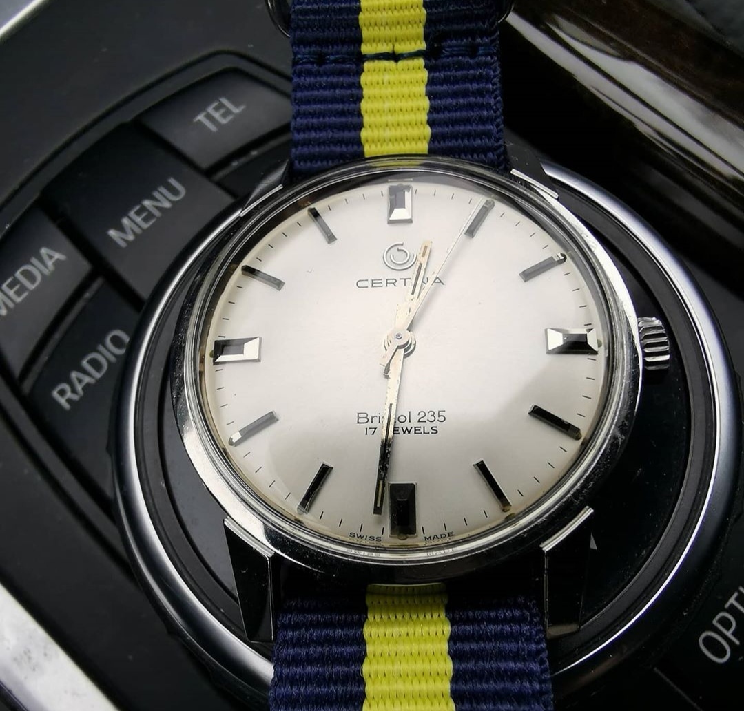

Here's my original vintage mechanical certina from the early 1970s...notice the hands. Not sure if that helps with your inquiry, but good luck.
8,257
29,173
Thanks, but the thread is focussed on the DS model line. Yours is a Bristol.

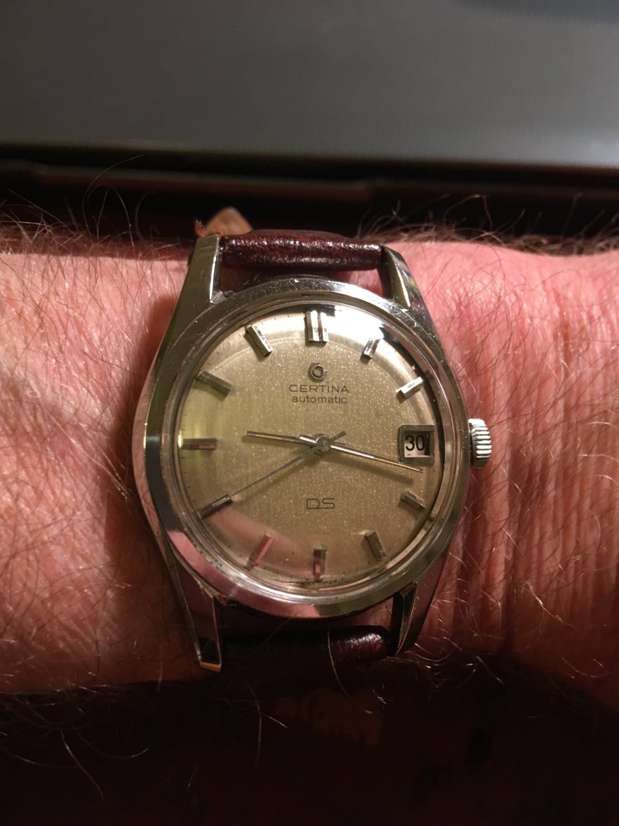

Now with correct-aged hands, and with thanks to the OF members who helped me source them.
