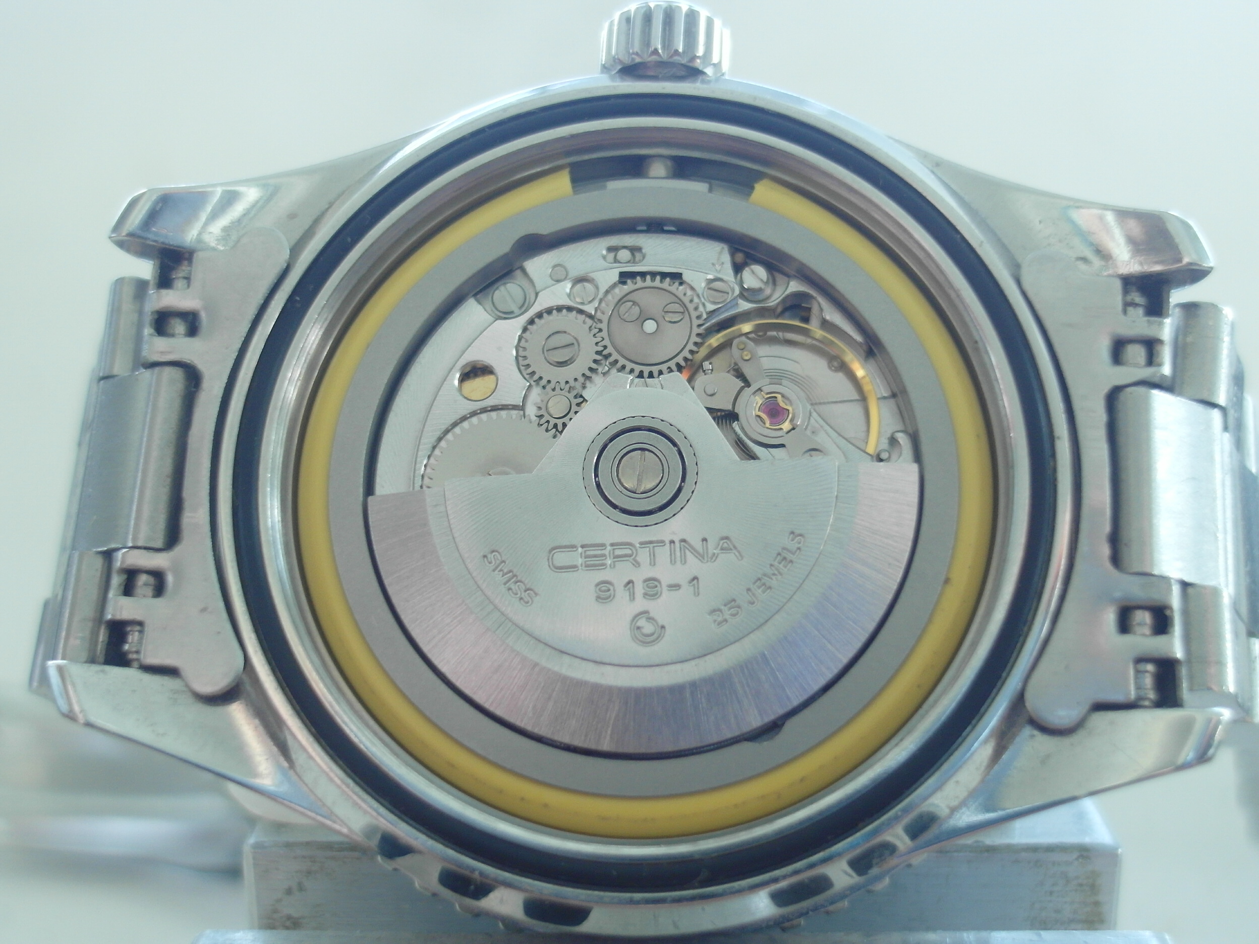

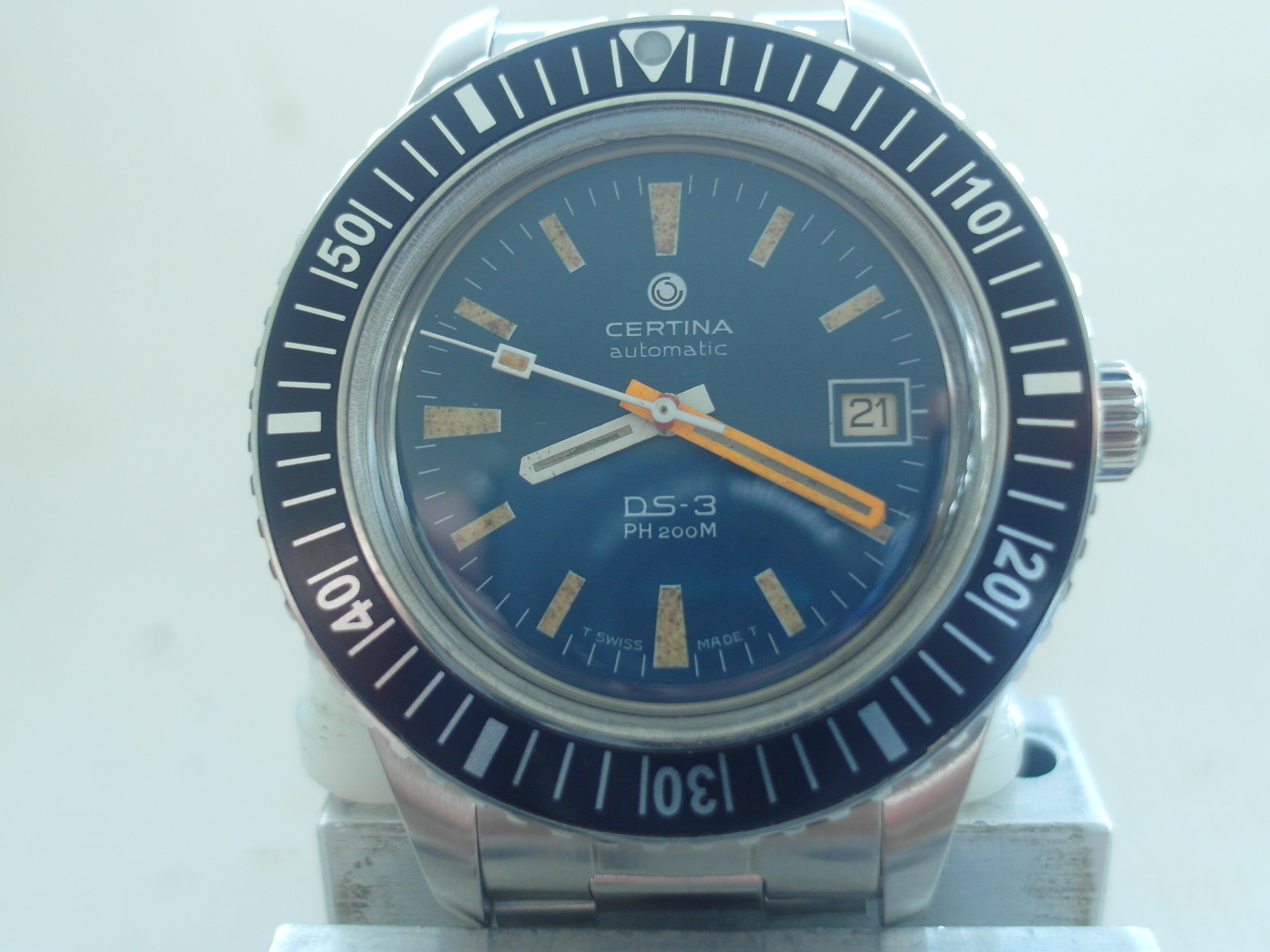

Always wanted to use the old blue 200 m Certina DS 3 Tritium dials and hands and Original 919 hack movement in an bigger case with turning bezel and water resistant for everyday wear..... So: bought a slightly used new Certina 200 m ..... And believe it or not: even the inner movement holder of the new model ( ETA mvmt .) takes the old certina hack movement 919 and the blue DS 3 dial. had a few spares left from previous services and the original yellow rubber ring is mounted as well. slightly thinner diameter . does the job and nothing rattles, when this setup is fixed with the new turtle case back. amazing. 2 pictures added. kind regards. Achim
and an old Certina steel band added as well.....

Nice outcome 馃憤.
The only thing I'm not keen on is the orange hand. Both white, or both orange and I'd be happy.

Divers in the 70's had only the minute hand painted Orange for better visibility under water. Together with the turning Bezel it reminded you , when your Oxygen was used 35% . The hour hand is uninteresting when diving.

..................The hour hand is uninteresting when diving.
