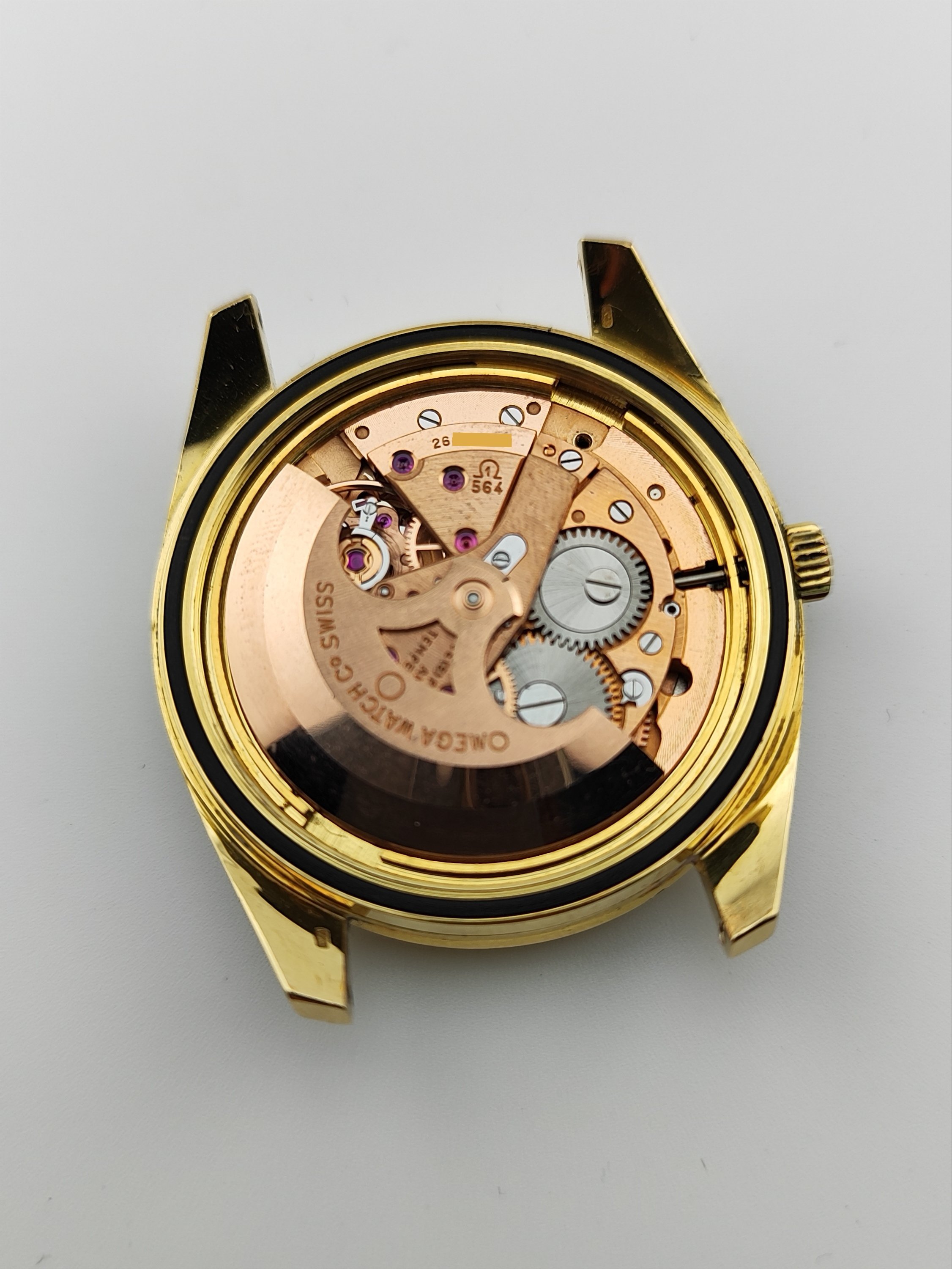

Hi all. I need a pair of case clamps and screws for an Omega Seamaster 168.022 (-67 if that makes a difference) with a cal 564. Have seen a few variations for that caliber and not really sure what's the right one. Would greatly appreciate some help.

If you email a parts supplier and clamps not discontinued. Just mention the reference number on the inside case back and caliber
Jules borel, Otto Frei. Canada - W H Perrin and UK - Cousins

East Europe. Jules Borel and Cousins don't have any clamps for the reference. Otto Frei I know ships internationally, but that site is too hard to navigate.

Try Perrins. I helped a German member on another forum years ago and they shipped to him
however. If those two didn’t have. Parts could discontinued. Find one and get them made

Clamp is 72205501974
Case screw is 1072255
You are a legend. Thanks a lot. I had the suspicion it was clamp 1974, but no clue what the screw may be.

mikeswatchparts had both the clamp and screw Archer pointed out. Saved the seller; thanks for the suggestion.
