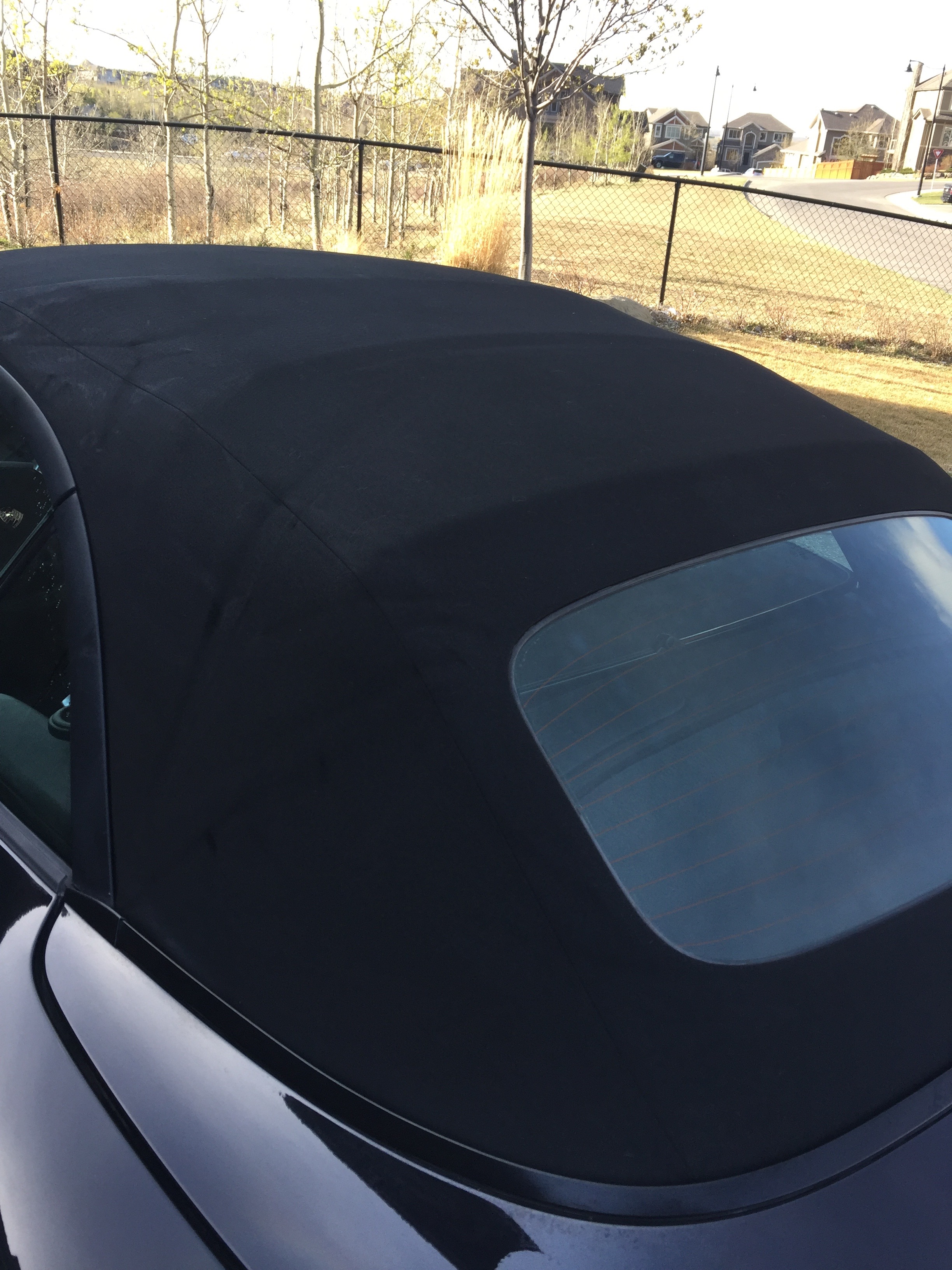

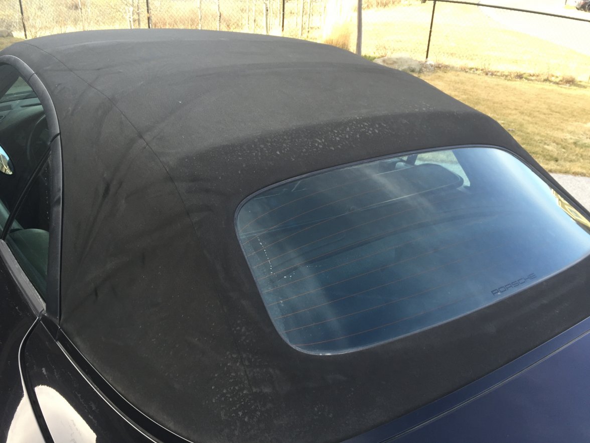

  13. Paedipod Apr 16, 2016
    2,069
    15,742
    a little grubby
    et voilà
    Matt-C likes this.
