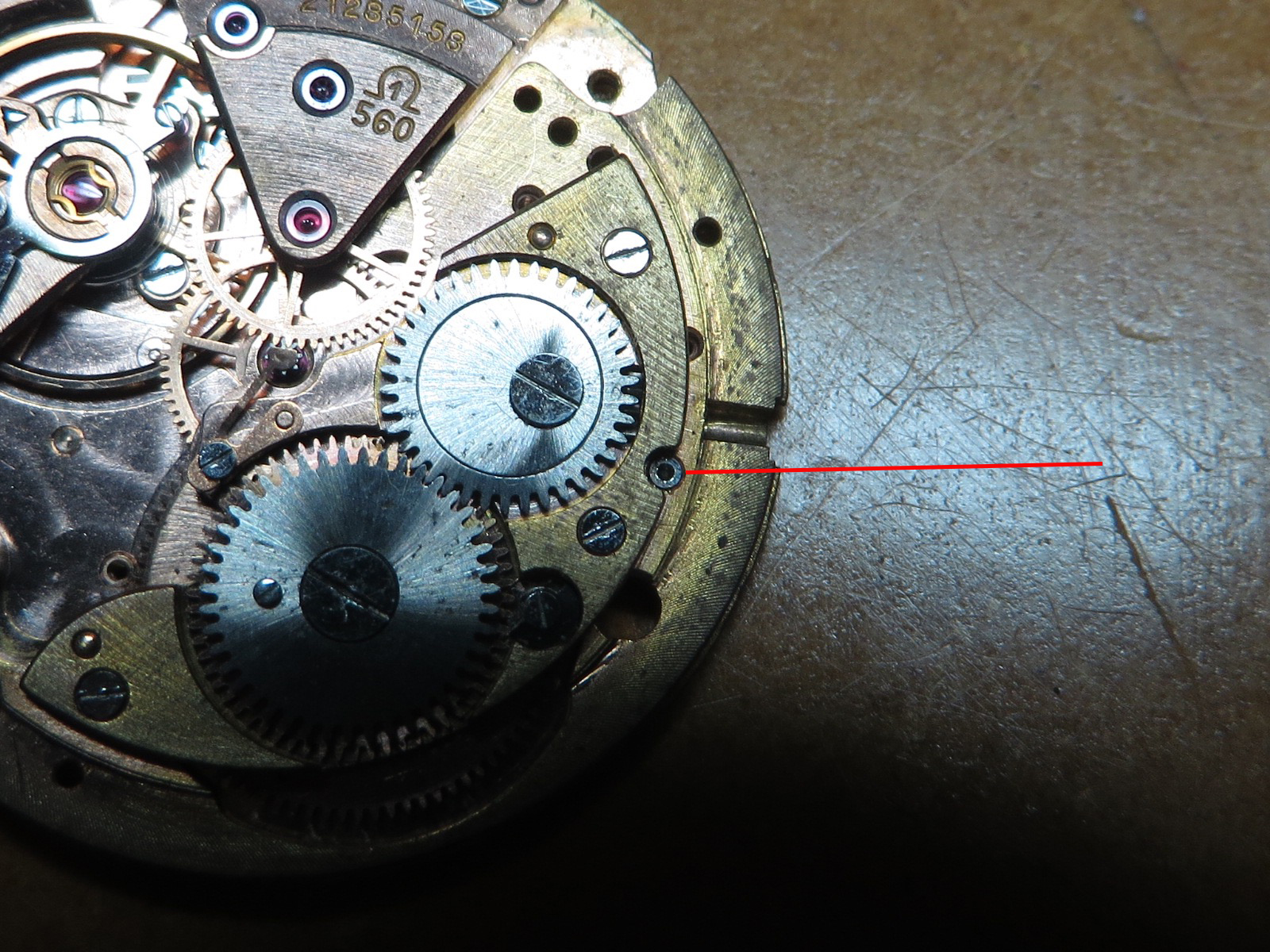

Are you pressing the set lever while inserting the stem?

Nope! That was the trick. Crown and stem are now installed!
However, I’m still not sure it’s quite right. Its a bigger crown than was on it initially, but it’s still difficult to wind and set time. I’m wondering if the crown stem is just a hair too short.
