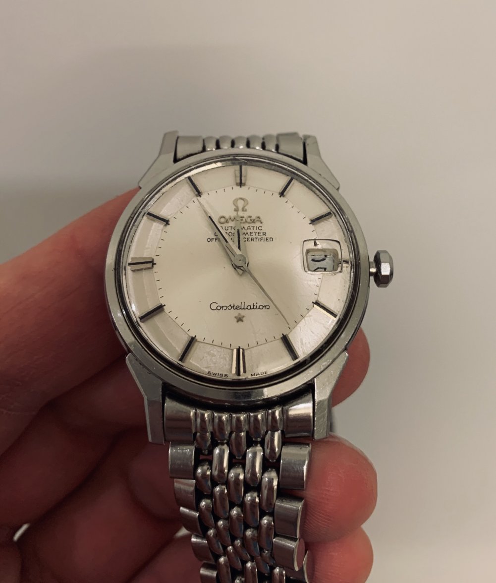

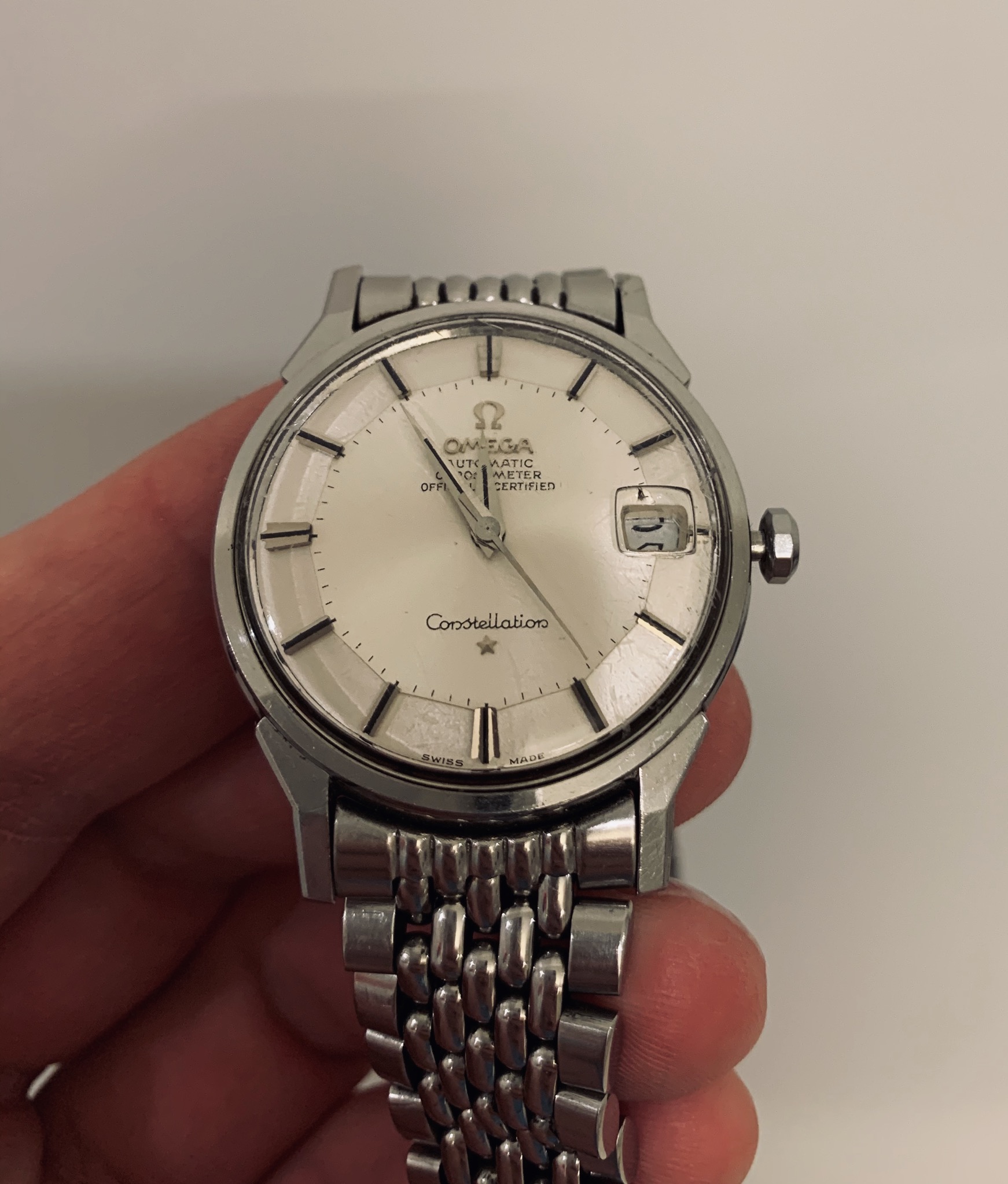

Hello,
I recently wanted to adjust the date in my 168.005, but when I wanted to push the crown back into the case to normal position, I couldn’t. Somehow it got stuck.
Is there an easy fix for this? Or do I have to bring it to a watchmaker?

Definitely watchmaker. At a guess one of the springs in the keyless works is broken.
Tom

Pictures of the crown and the tube and the position how it stuck?

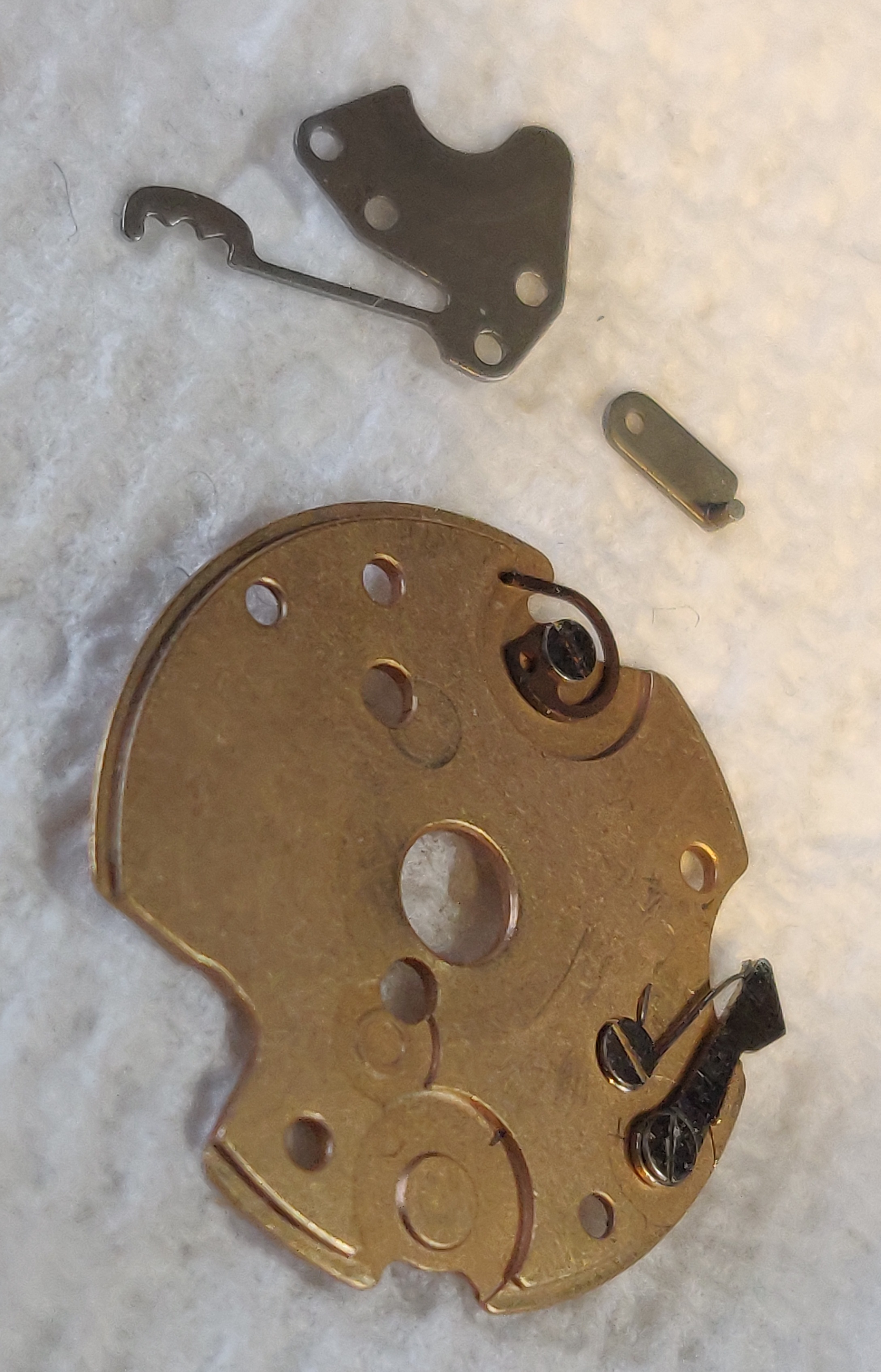

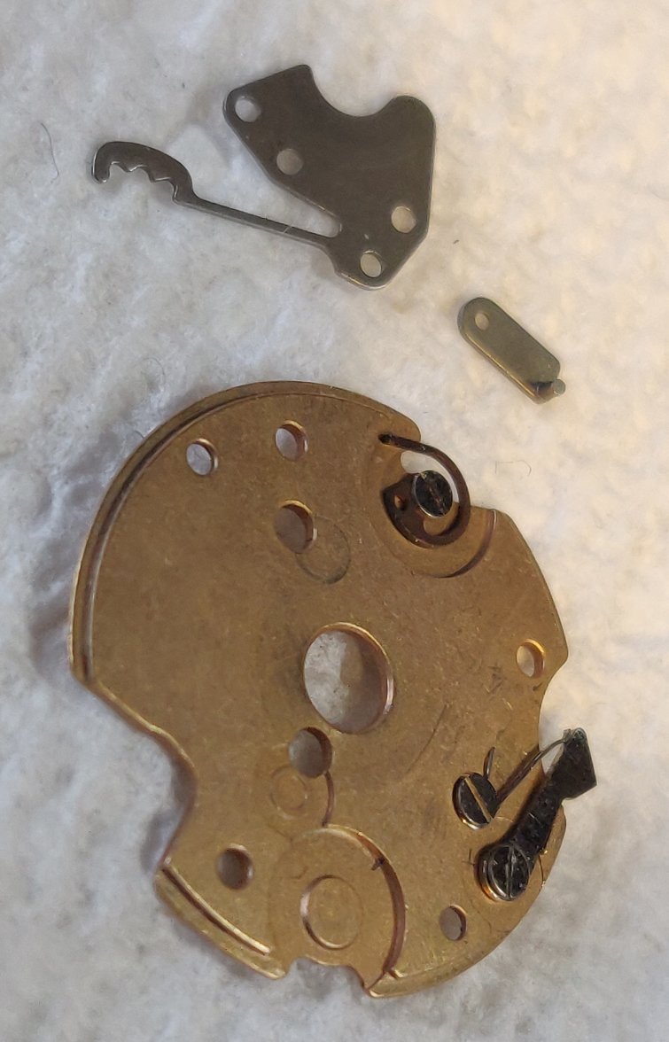

If it's a cal 564 the quick-set may have jammed.
2,326
1,887
I think you're right. Setting the watch during date change on some watches can be dangerous indeed.

It was not wound up and after it jammed the second hand moved about half a minute and then stopped.

For future, I only ever quickset mine with the hour hand between 3 and 9 o’clock (on the 6 side) as I experienced a similar issue a few years ago.

Sure you can do it yourself, first remove the hands, dial and then check to see which one was broken
Then you have to find the replacement part.
If you are lucky, the broken part is removed and it ticks again, if not you have to take everything apart and give it a clean some oil etc...
Hopefully, when you put them back together, it will run like before, if not ...👎...
