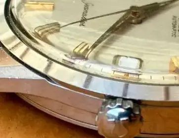

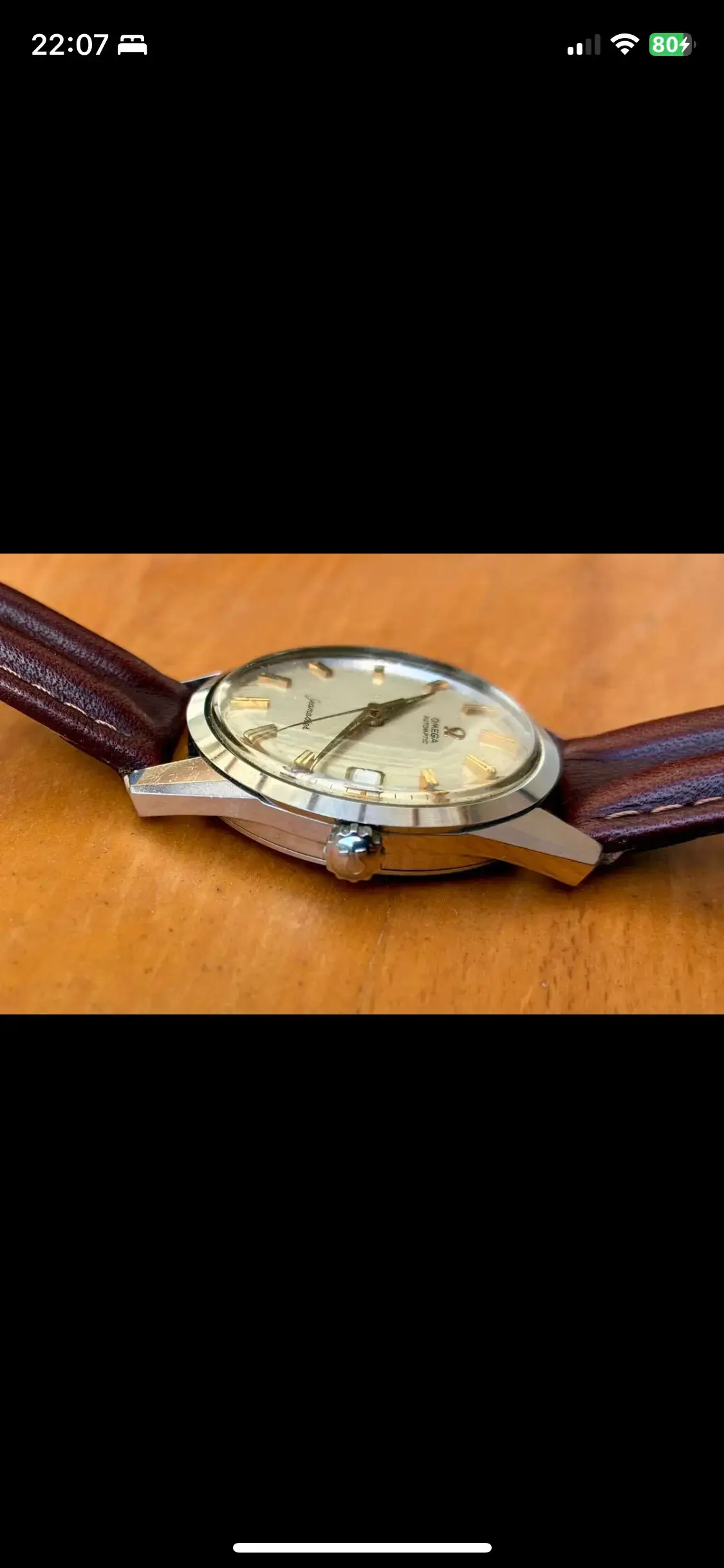

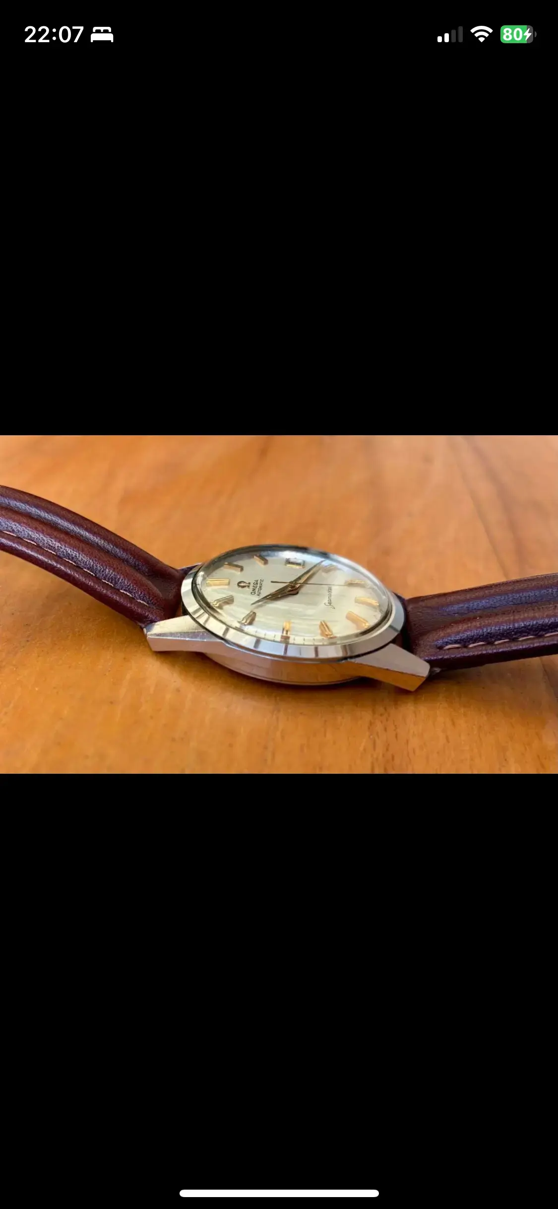

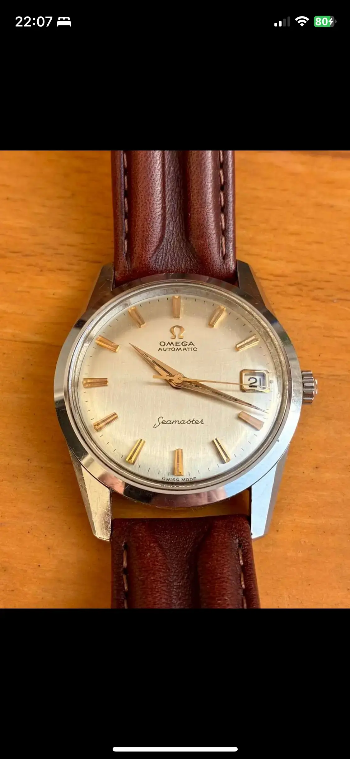

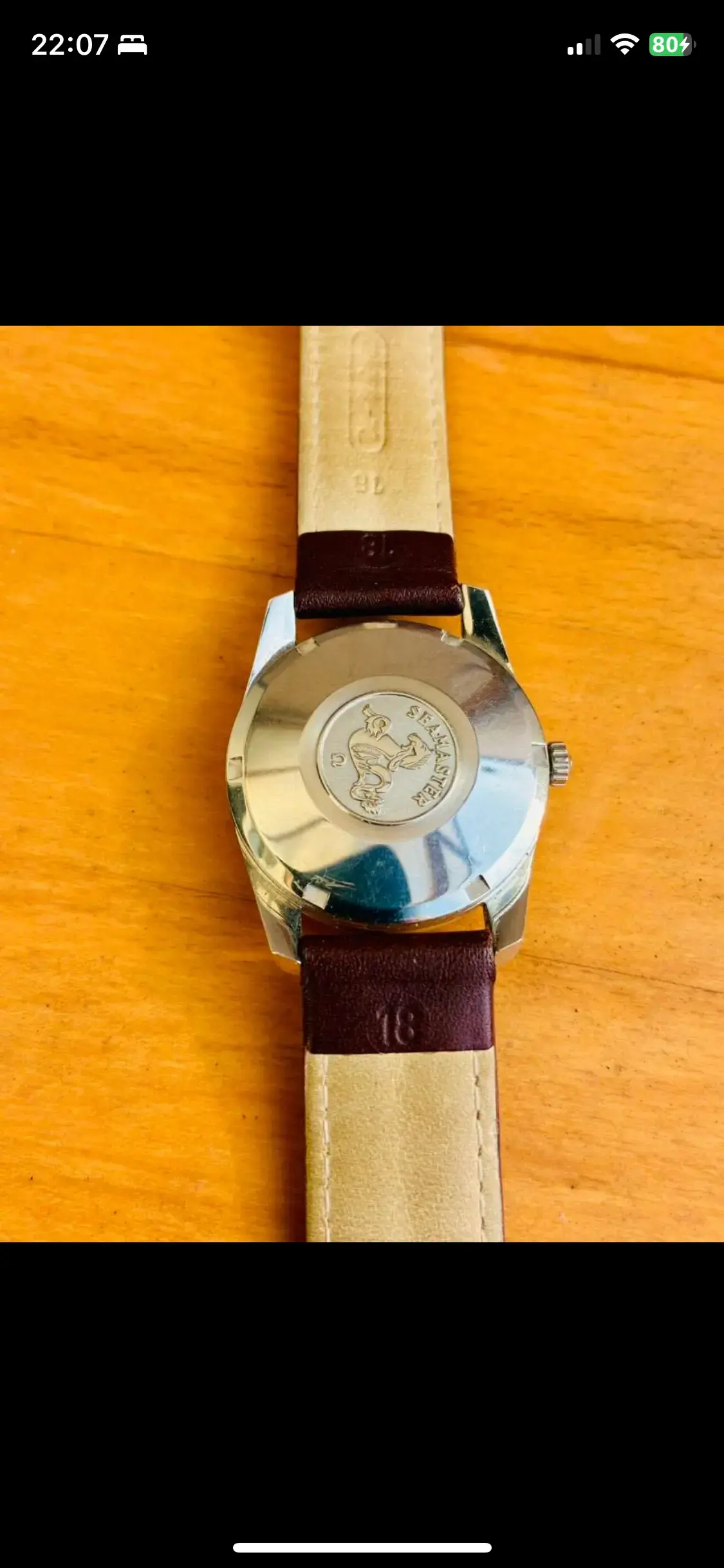

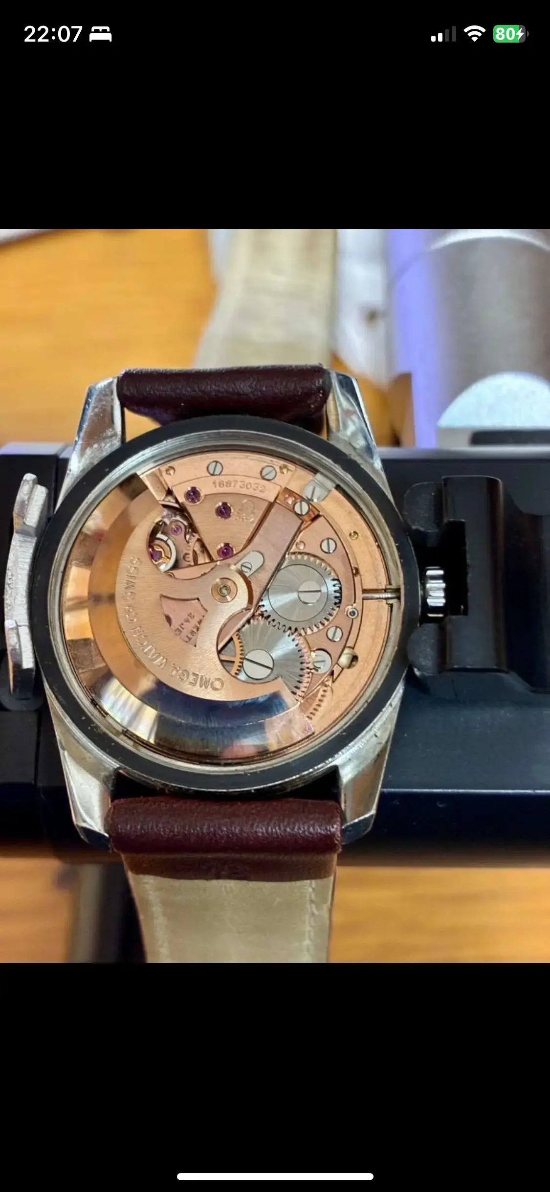

Posts 128 Likes 187 Jan Dietrich ·Tues. 3:09pm Hey guys I just found this seamaster and it seems way to cheap for me. Can you Spot any mistake? Its listed with 800€
Posts 3,027 Likes 6,448 SOG53 ·Tues. 3:15pm Looks like 14701 with those long straight lugs And a good one - I don’t see any issues. Crown even looks original.
Posts 24,263 Likes 54,033 Dan S ·Tues. 3:21pm Looks ok and the price is about right. $925 USD is certainly not cheap for this watch, but it's not crazy given the nice condition.
Posts 2,144 Likes 2,942 Passover ·Tues. 4:06pm Excellent looking case, I like the gold furniture. Plexi is Omega-signed, given the case condition it could be still the original one
Posts 17,945 Likes 37,524 JimInOz ·Tues. 5:15pm·Melbourne Australia Gold dial furniture isn't my favourite choice, but for this example I'd make an exception and grab it.
Posts 576 Likes 1,808 hant26 ·Tues. 9:24pm nothing wrong. Just the standard of living. 800euro is not cheap to most of us 😜
Posts 200 Likes 76 artisgil ·Tues. 9:37pm Looks good may be the lighting but is the 4 marker original ? Looks different. Nice watch. Price is a bit high. Edited: Wed. 4:45am
Posts 2,144 Likes 2,942 Passover ·Wed. 2:29am artisgil may be the lighting but is the 4 marker original ? Looks different. Lighting IMO
Posts 128 Likes 187 Jan Dietrich ·Wed. 7:01am Thank you for all the infos. I notice that my feeling with spotting a good watch gets better. Especialy when you guys verify it
