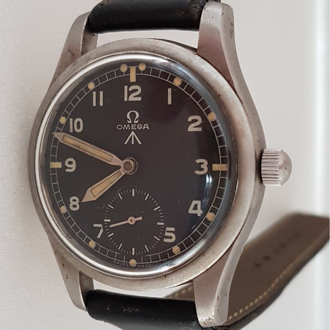

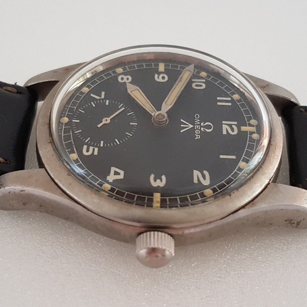

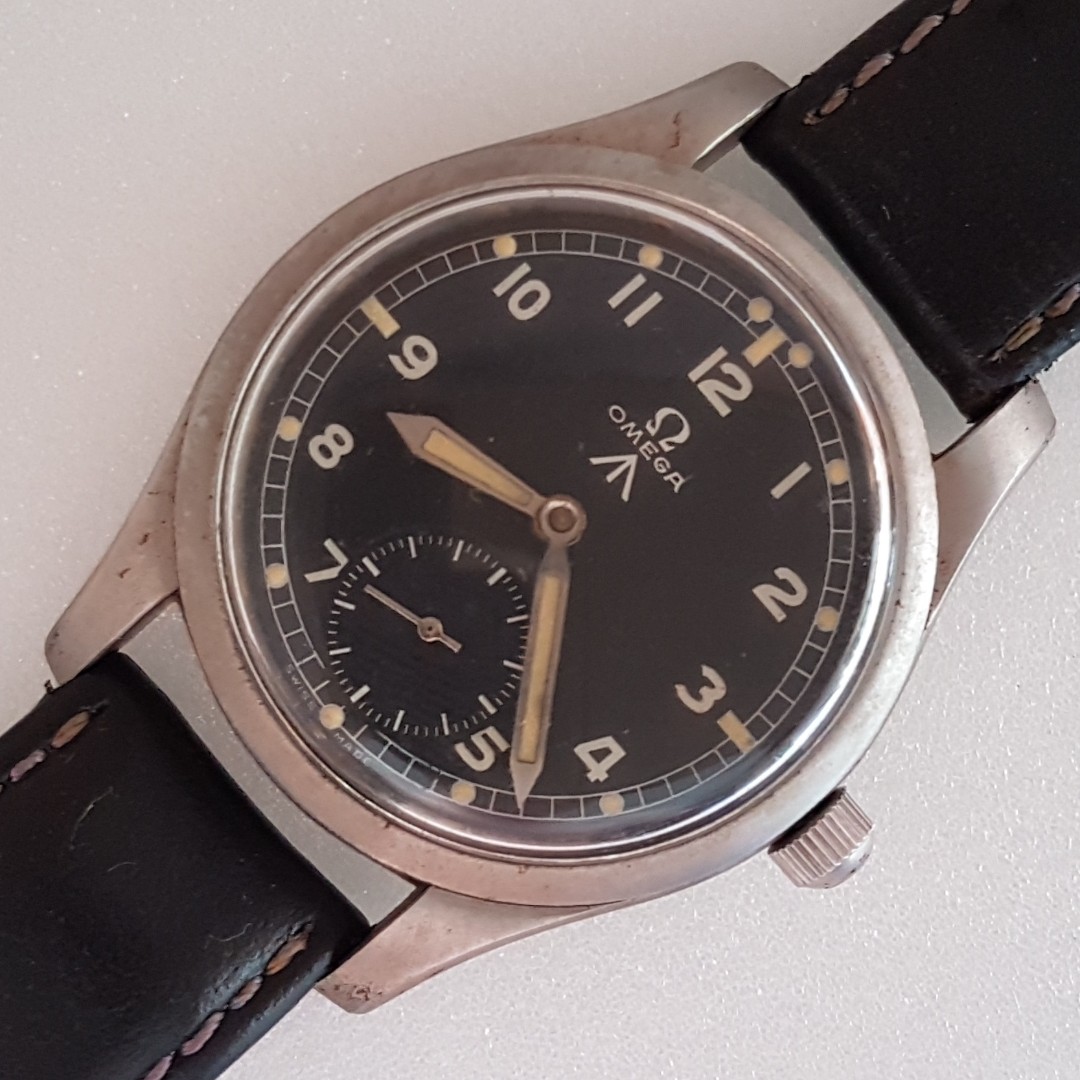

Can you please give me your opinion on this omega WWW?
258
230
These are the only pics I have of it. I am an admitted watch ignoramous, but upon comparing it to the omega WWW on hodinkee, I’ve noticed:
The way the subseconds cuts into the 5 and 7 is different and the numbers look slightly different. Does this mean this is a redial?
The second hand is clearly shorter.
The crown is different.
The bezel also looks to be different but I can’t say for sure. Could be the pics?
The broad arrow looks thinner.
The lugs look thicker.
I’m not sure what the inside is supposed to look like
Let’s say my above comments are all accurate, what value would you give to this watch?

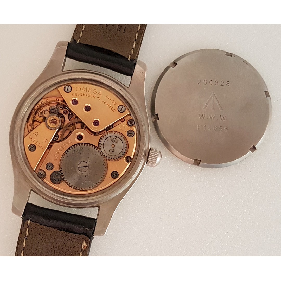

Definite franken. Movement is non-rhodium plated, whereas military issue were.

.....the movement is rhodium plated................
Rhodium is silvery, has your screen crapped itself E?
Ah whoops.
Reverse that then, it's non rhodium plated...

Fake/frankened watch, sorry. Apart from the obviously wrong seconds hand, it looks to me like the other hands are slightly off in their proportions.
Is that a 19 mil serial number..? 🤦

So what’s this strange Franken worth to you all?

Never buy it, if those frankenwatch seller don’t find any customer, hopefully they run out of business

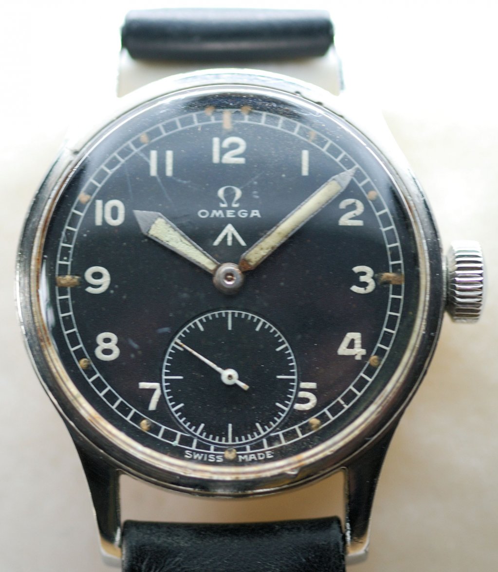

Though some might describe this as 'distressed,' this is what an unmessed-with one should look like:
