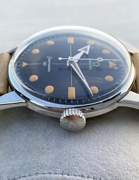

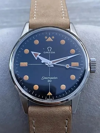

Newcomer on this forum and in the amazing world of watch enthusiasts, I came across those two Omegas, which I fell in love with.
Having not much knowledge about them, I was wondering if you can enlighten me, I don't even know if they're genuine or not!

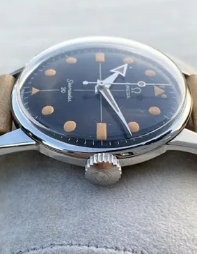

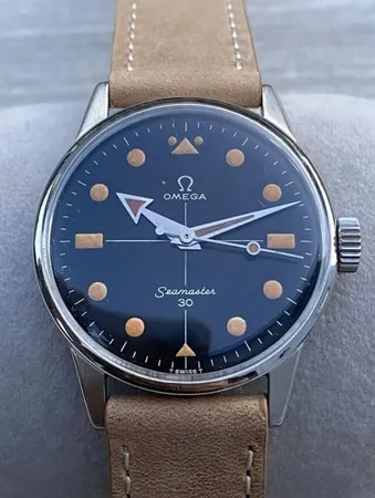

The first one, with a magnificent black dial and a gorgeous patina on the lume:
I've never seen a Seamaster with this aviation like dial and those spearhead hands.

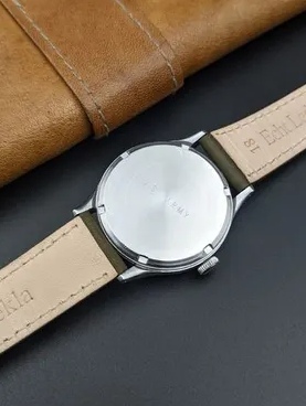

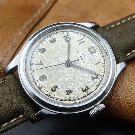

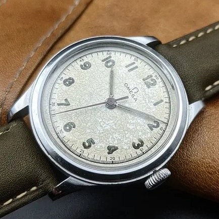

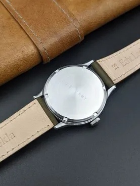

The second one is more often seen, but the almost mint condition and the US ARMY markings are suspicious... It seems to have been sold in 2021 by Exclusive Vintage Watches shop.

The first is a complete fantasy redial. Omega didn’t make such a dial

First one looks like a common fake dial. I can barely see the case-back engraving on the second.

And hands.

The black dial seemed a bit odd, and the combination of the Seamaster 300 like hands with it made me suspicious.

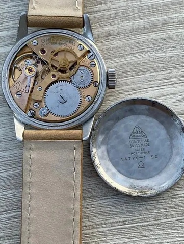

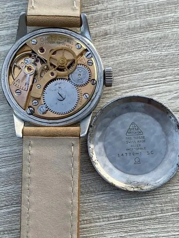

Here's a picture of the movement of the black dial one:
The second one may be a civilian version with "US ARMY" added?

If you had a "mint" condition one to compare it to you wouldn't find this one nearly so. The US ARMY markings on these were a bit random, often uneven, sometimes light, sometimes a bit heavier and keep in mind they are close to 80 years old. The only way to know if one is a true army issue is to get an extract from Omega.
If you Google the pictured caseback reference 14772-1 you will see what this watch should look like! Definitely franken...

The second one appears to be a redial as well. That "Omega" rendition looks uneven.

Just study the dial, and I think you will decide not to waste more time on it.

The second watch doesn’t look correct at all. It is possible the case is a Ref. 2179, but the engraving looks to be too large and deep to be real. Better pictures are needed for sure.
See this thread: https://omegaforums.net/threads/a-new-one-in-my-collection-ck-2179-us-army.50009/
Note that only the dial with radial numerals style was used on the US Army issued watches. Other dials were used on the Ref. 2179 sold in the civilian market.
