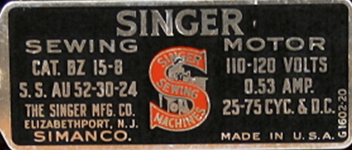

    Unfortunately this model will definitely not work in Australia without an expensive step-down transformer.
    Know anyone with a spare 240->120 transformer kicking around? :)

    The issue is not the voltage, if it says 200-240V then you are good to go. It is the frequency/Hertz that will be the problem
    A TRANSFORMER will not correct frequency issues. That being said if it is rated for 220V the in almost all cases it is good for 50HZ. Ask the seller about the frequency. If the machine is from most places other than the US it will work on 50HZ. A transformer corrects voltage not frequency. A motor is what will be affected by frequency.

    I did some research on sewing machine motors, and it appears that one can use a step down transformer to allow a US 120V 60HZ machine to operate at 220V/50HZ. Just be sure that the amperage of the transformer is more than what the sewing machine will require. The cord plug end would most likely need to be changed, but many transformer have the correct sockets for US then a cord to the country of need. Looks you could get a US machine and have it running in AUS. My wife has an Elna, and loves it.
  17. alam Sep 19, 2012
    8,094
    18,678
    Note that the transformer output will be 110V @ 50HZ - the last time I tried this with a dehumidifier designed for use in the US (60HZ), it killed the motor after a few weeks of usage. Of course the humidifier was running for longer periods; perhaps the motor on the Singer machine may tolerate a slower speed and survive...
