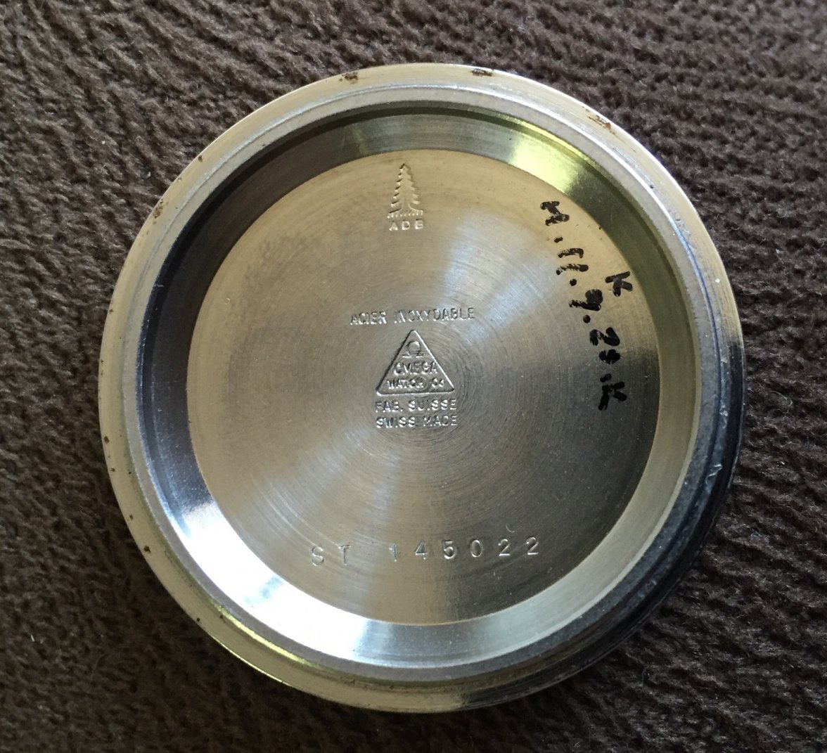

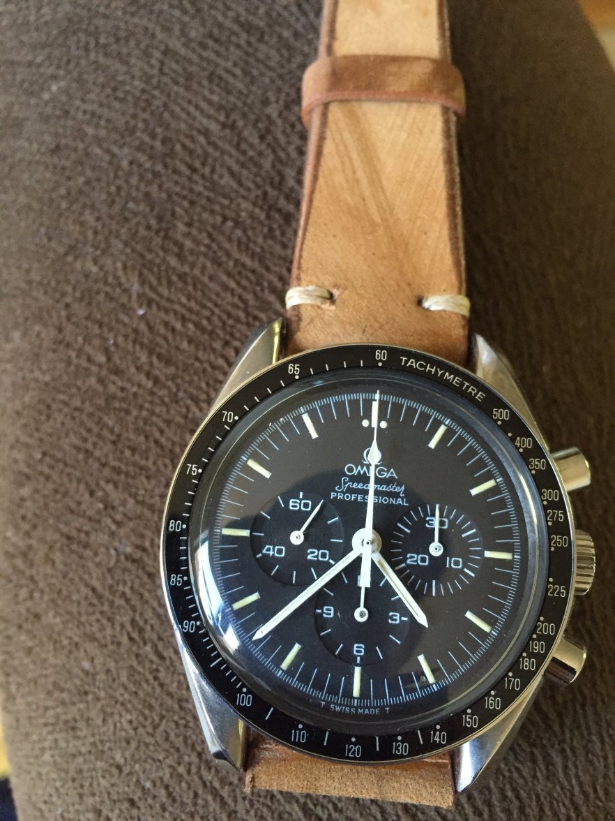

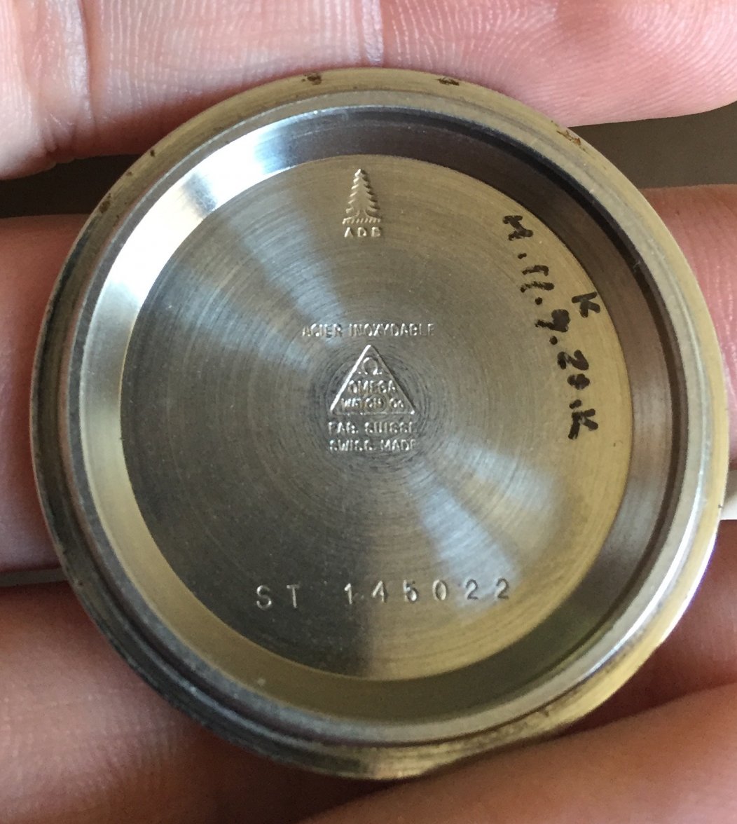

    Hello,
    Curious to hear from the experts.
    I saw a 482xxxx serial speedmaster with a the long S and R - not sure what to make of this back case though?
    What year of production would this be from and it correct for the serial?
    According to the dating years I found online this should be about 1991 production?
    Have a couple of pictures.
    Would appreciate any help I can get on this. Thank you for your time.

    Pre 98... but before the modern bezel...
    Speedmaster101 is not going to help as it's post 145.022-78
    I'm sure someone that has a copy of the MWO book can give you a better date range.
    This era is hard to nail down and serial numbers have a few years range as they are not sequential.

  5. DLT222 Double D @ ΩF Staff Member Mar 17, 2017
    5,175
    4,555
    Main reference 3590.50
    Its the only one to have the fir tree logo.

  7. efauser I ♥ karma!!! Mar 17, 2017
    8,658
    14,232
    I have a 3590.50, serial 4825XXXX with an extract from May 31, 1990. Before anyone says anything, yes, they're service hands. Haven't had a chance to put the originals back on.
