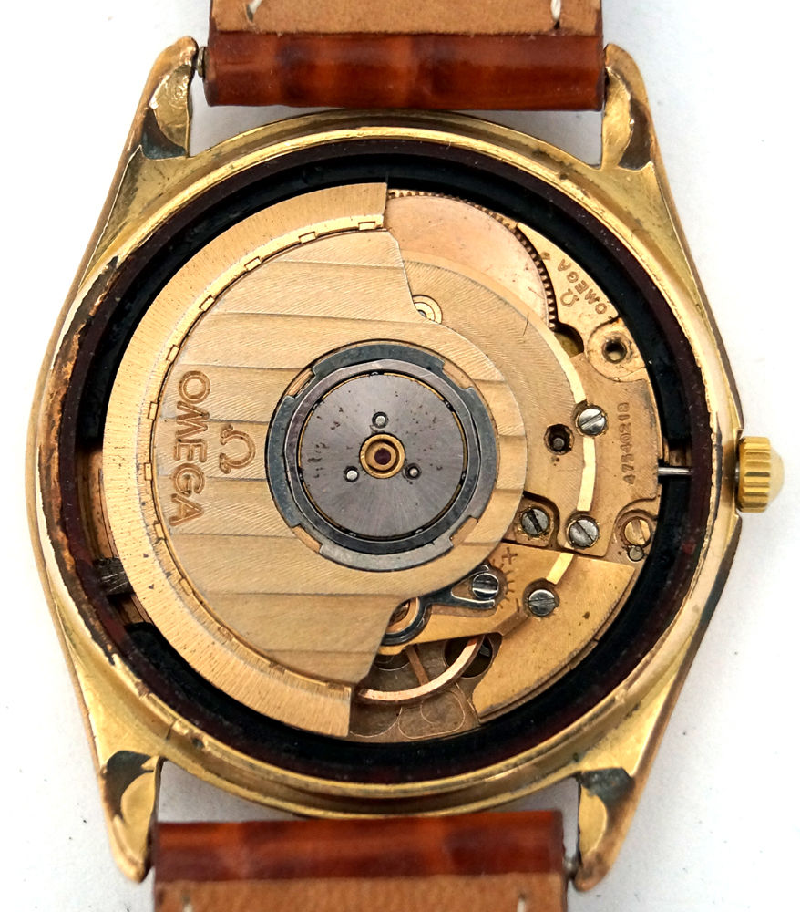

    Hi, I've lurking for a while and you guys/girls have been a huge resource to me. I saw a vintage omega while looking for a dress watch and quick google search brought me here and I've been soaking in everything you guys say for months. So I usually do a ebay search every few days and 'watch' the watches I'm interested. I am on a budget of $300 for this so any bids that go over that I unwatch and move on. Most watches in this price range are obvious fakes, or frankens so the sticky with all the fakes is a great tool. I have come across this one watch that looks great, fits all the qualifications listed on omega's database, except the serial number is throwing me off. It's listed as 475XXXXX. Googleing the serial number charts hasn't helped because some have 47000000 listed as 84 85, and some don't include 47000000 at all, they go for 46 one year and 48 the next. The charts that skip 47, almost always note that they skip 52 in the mid-90s, but no mention to the skipped 47. I hope this makes sense. Ill include the ebay post below.
    So is this watch legit? If not, can someone explain why? It looks and is priced too good to be true and the serial number is troubling me. http://www.ebay.com/itm/252568281639Purchases made through these links may earn this site a commission from the eBay Partner Network

    The issue is the condition of the dial, case, hands, movement, etc.
    Sure, $300 for an Omega sounds good, but even for $1, this one has way too many issues to deal with.

    Its in really, really bad shape. Be patient and wait for a decent watch.

    Can you explain what is wrong with it just based off the photos? I guess I've been so obsessed with spotting fakes, that I haven't really learned about quality.

  8. Taddyangle Convicted Invicta Wearer Oct 14, 2016
    4,817
    31,395
    Hands are flaking
    Movement is filthy
    Dial has spotting
    Case has been damaged by bracelet at lugs and over polished. Also corrosion.

    This was very helpful, I knew I would have to get the watch serviced but I didn't much thought past that. I like the Orient's and hear them recommended alot. I guess I could start looking at higher priced Omegas on ebay and continue to try to issue spot.

    After you pointed out the corrosion it became obvious. I am going to have to look at more movements, I was mostly looking if it had right copper color to check if it was fake. Thanks!
