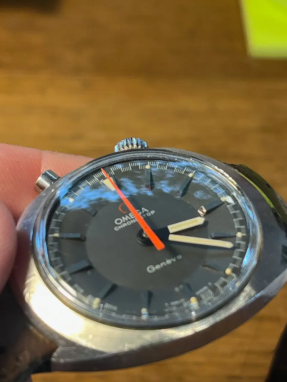

Here鈥檚 a pic - scratches actually look more dramatic here than in real life.
Polywatch arrived yesterday so will give it a go.
Thanks for posting a Before pic.. please can we see an 'after' shot too. As I want to give polywatch a go (also on a Chronostop;-)

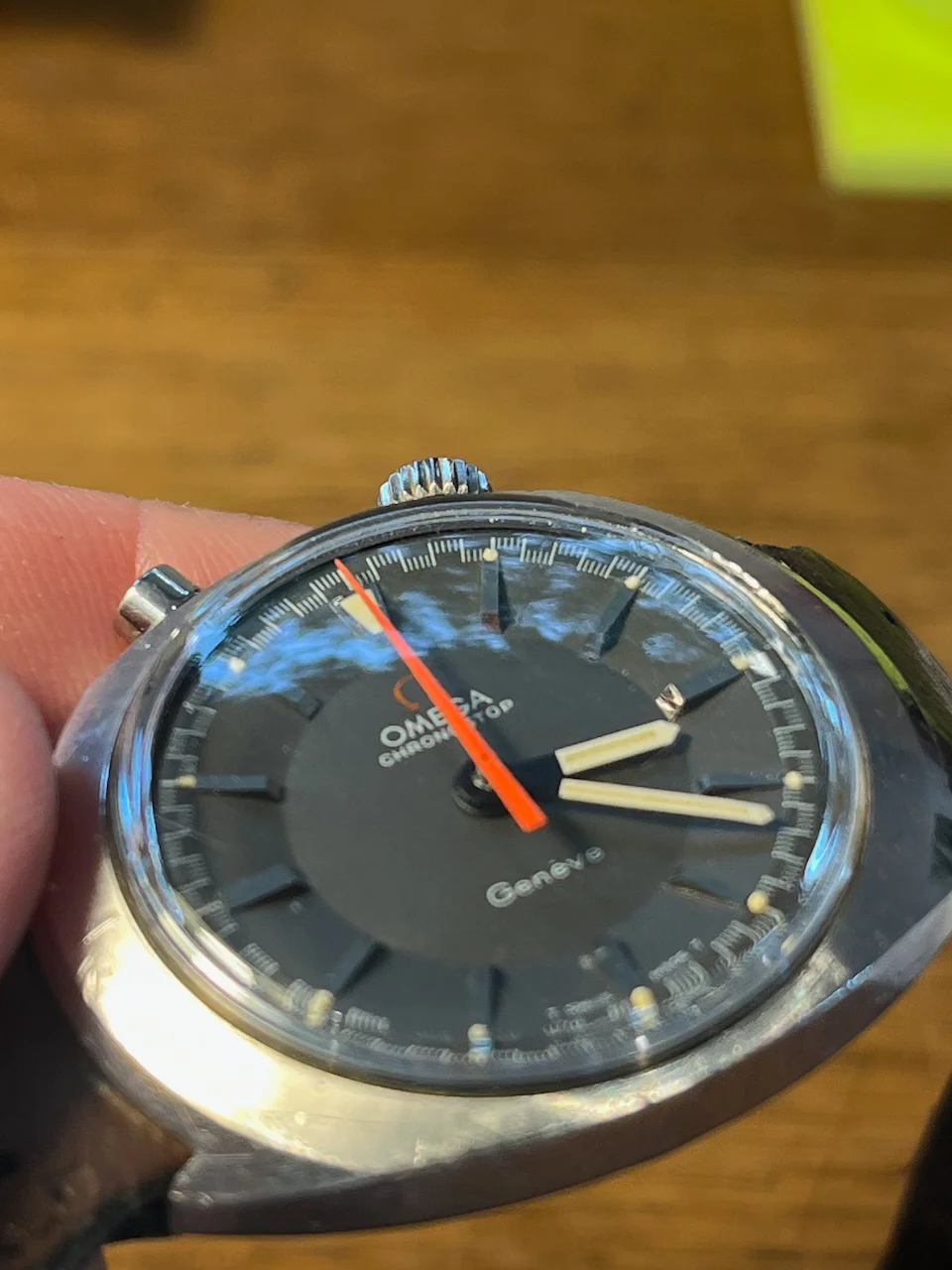

Surre - tricky to get a good angle but hopefully you're able to see how the dial has polished up with Polywatch. Almost no visible scratches at all now. This was after 2 applications.
Just tried the Polywatch and am thrilled with the results. Thanks for all the advice, folks.
