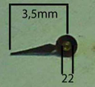

I've found some blued steel hands that I wish I have found in 'normal' steel color 馃榾
They could fit my Valjoux 23 (with a little help as the hole should be 0.23mm apparently and not 0.22).
Never been able to spot the 'normal' steel one unfortunately so here is my question :
Is there a way to 'unblue' blued steel hands ?
I've read that to blue steel you've got to heat it at 300掳c and then some oxydation happens and gives this color to the steel. I guess I will be corrected with my over simplification of what I understood.
But I've seen no sign of a reverse process: does it exist ?
Thanks for the scientific minds around for enlightening me 馃榾
Here is the picture of the blued hands : sorry don't have better ones but the seller is clear : blued !

The oxidation layer should be thin, so polishing might be an option. Not sure if you want to go this route.

Blued hands are mild steel, "normal" steel would be stainless or else eventually go rusty. Apparently vinegar can be used to remove the blue layer, that's what the firearm websites say. But you may wind up with unusable hands and nothing to show for your money and effort.

Polishing is the way to remove the oxide layer...

Polishing will easily remove it. Vinegar will as well, you just don't want to leave them in vinegar for long. I'd recommend clear nail polish or another type of clear coat to protect the white steel from rust once you've removed the blue.
