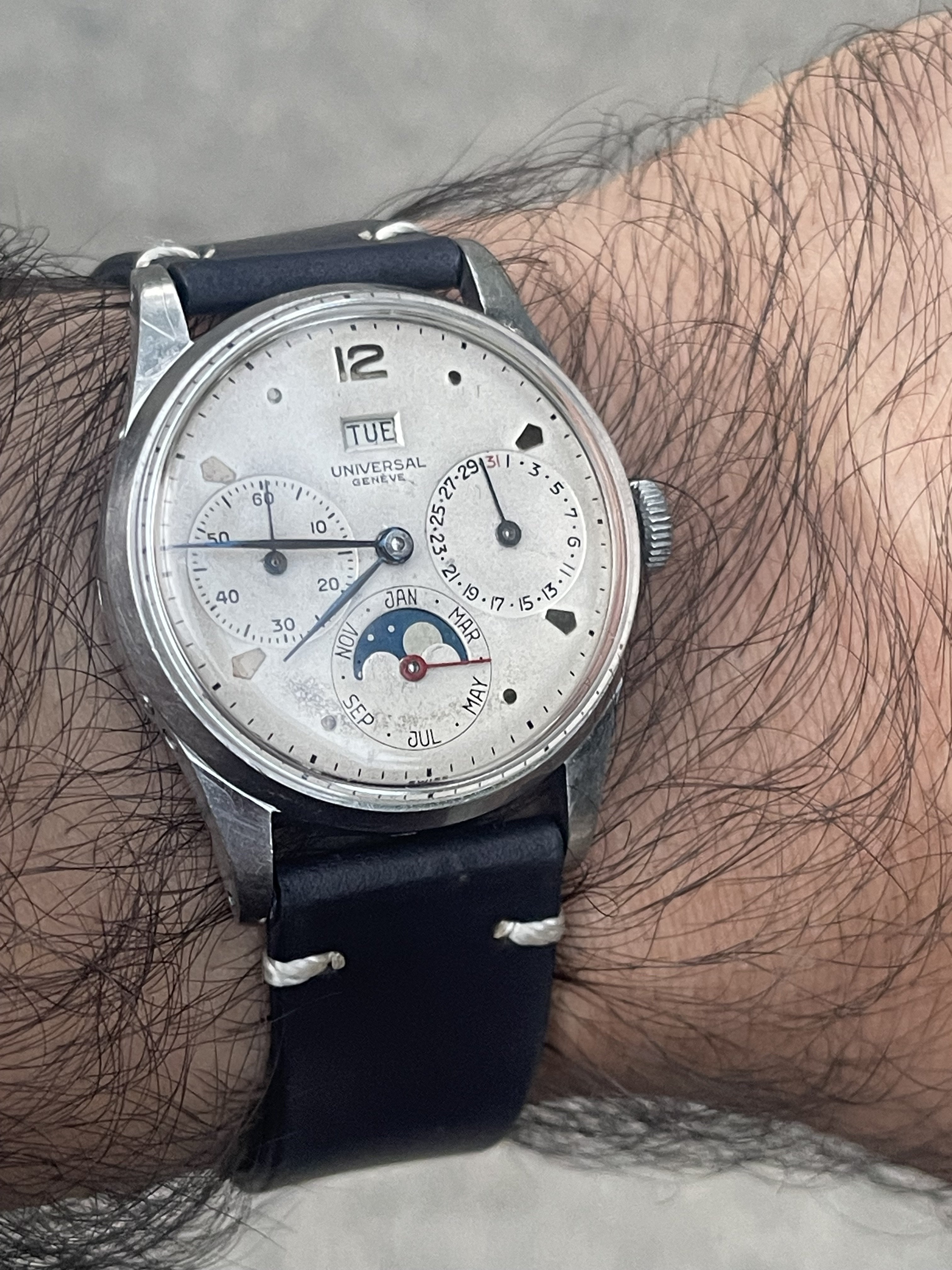

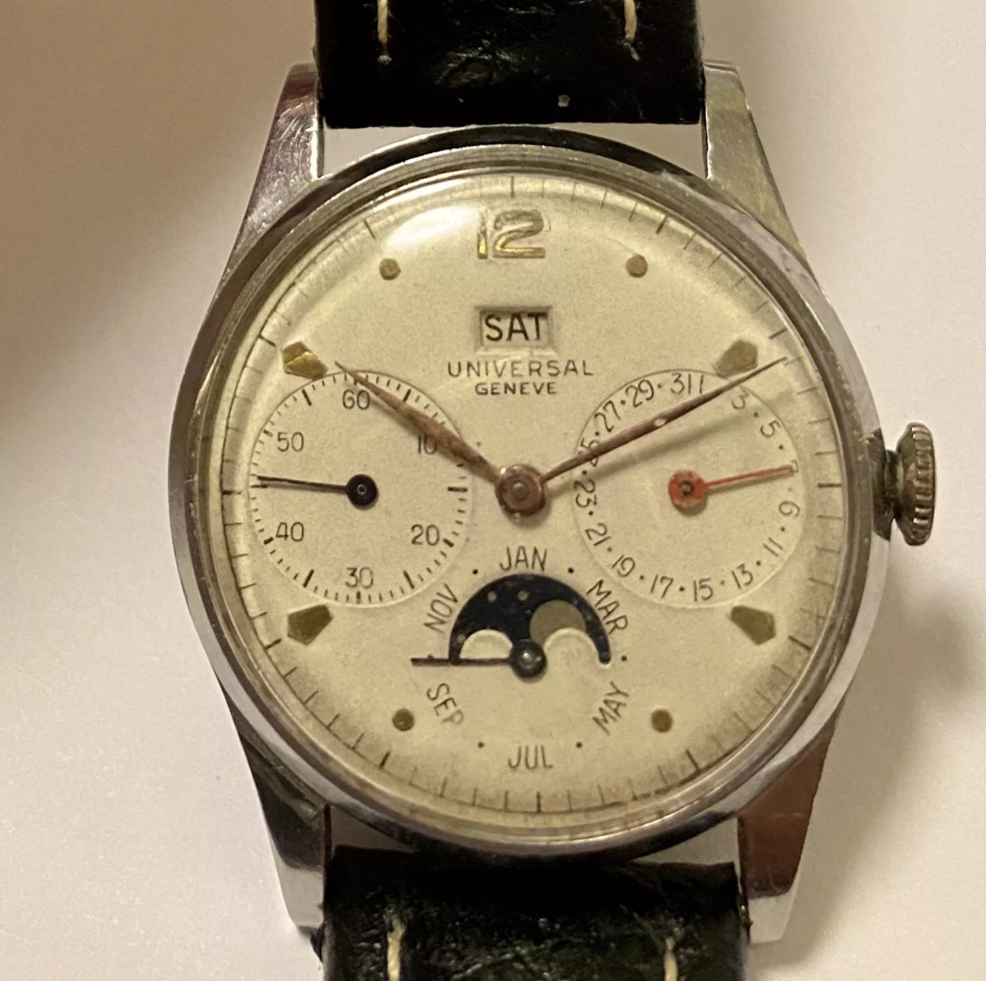

Can never tell with these triple date dials
32
81

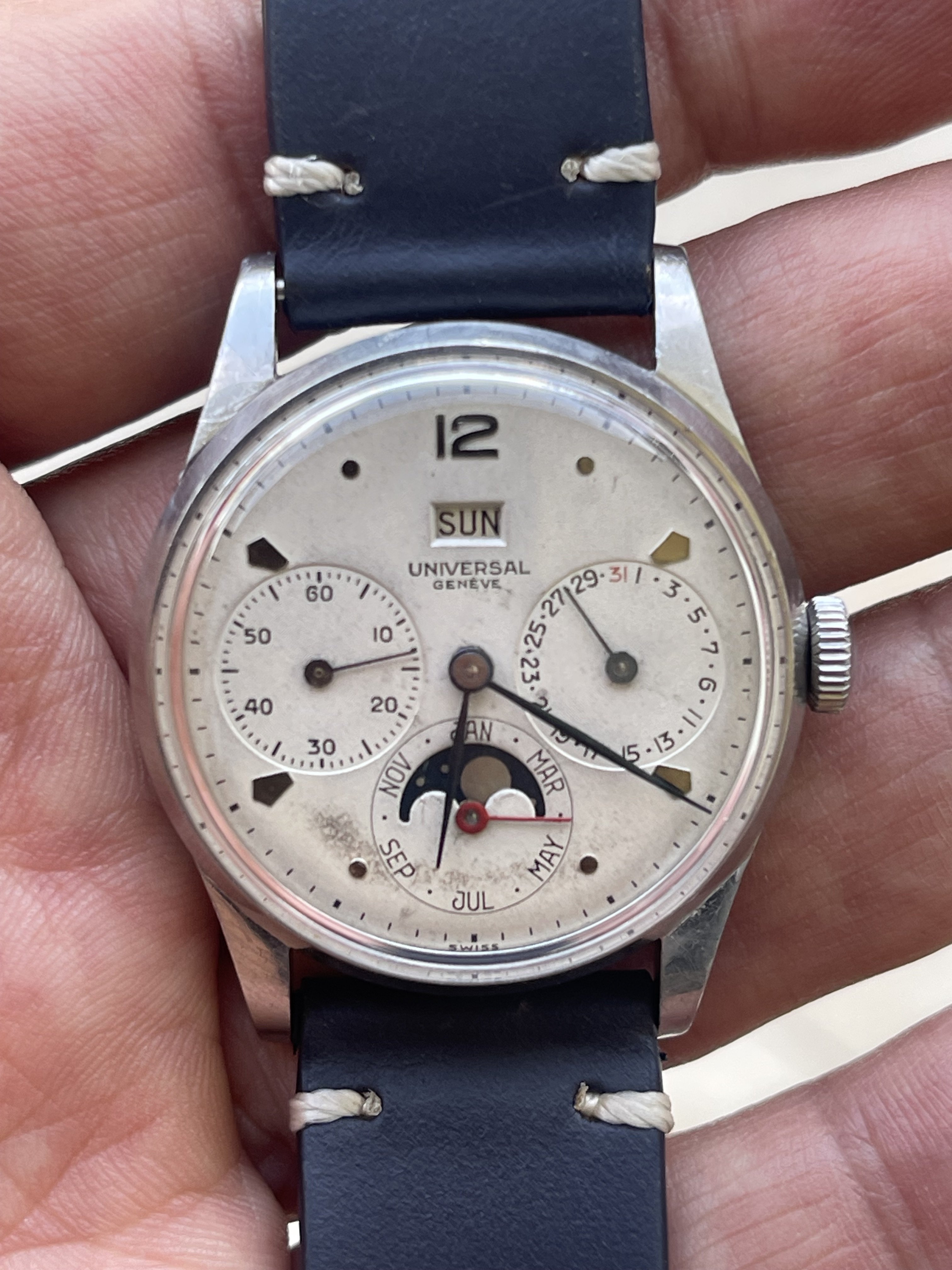

Looks pretty good to me but the font is so close to the logo; markers are misaligned but not enough for me to not be hopeful.
343
3,345
The dial has been re-done in my opinion. But I could be wrong..

I think so too.
8,811
62,402
I see no elegance nor beauty even if it has an original dial.
Maybe it’s the lighting and camera

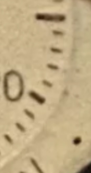

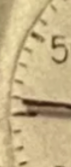

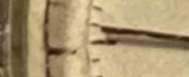

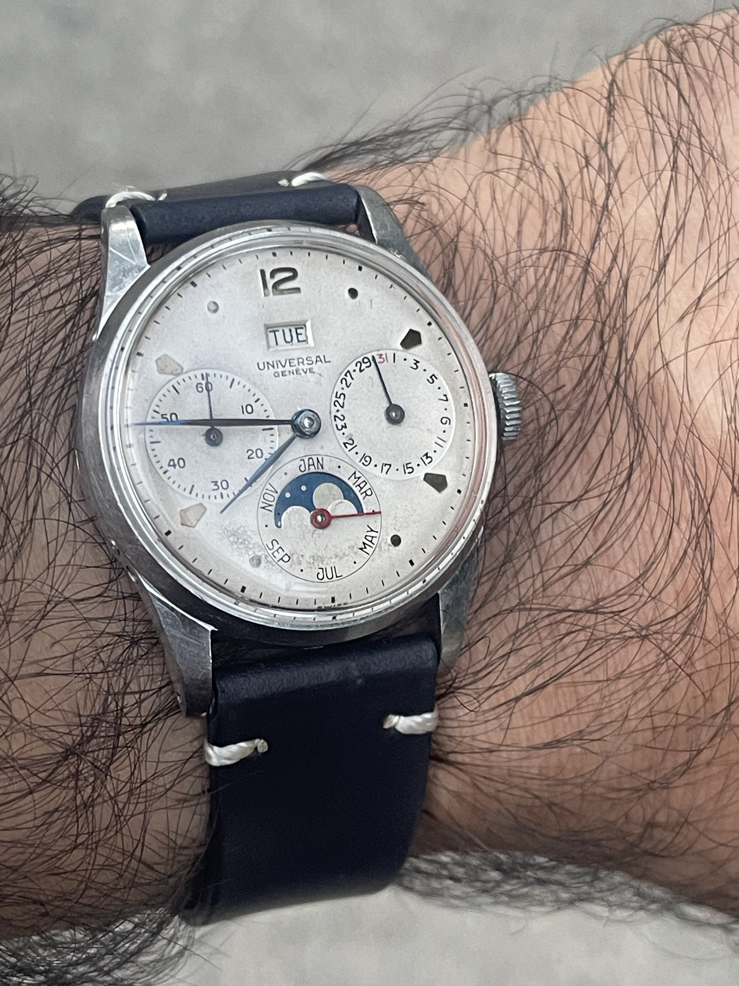

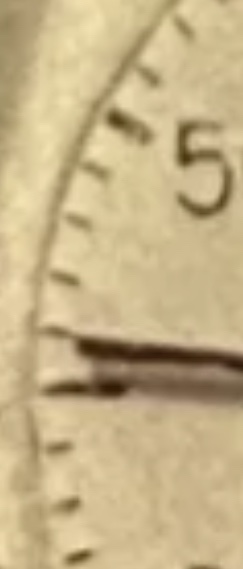

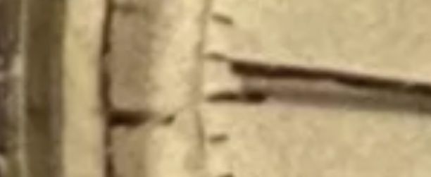

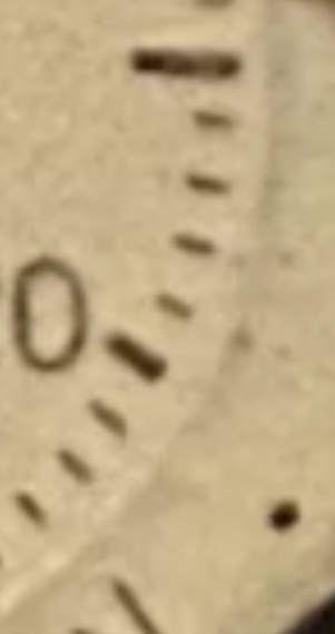

Repainted, otherwise they did a patchy work! Apart from the unappealing general aesthetics, when you see stuff like below, it’s usually refinished.
Horizontal markers not at the same level
Sub dial markers are very splotchy and not a the same distance from the slight recess. Note that gap in the first picture, while almost none in the second.

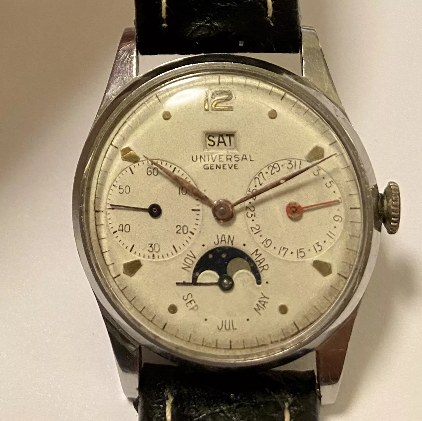

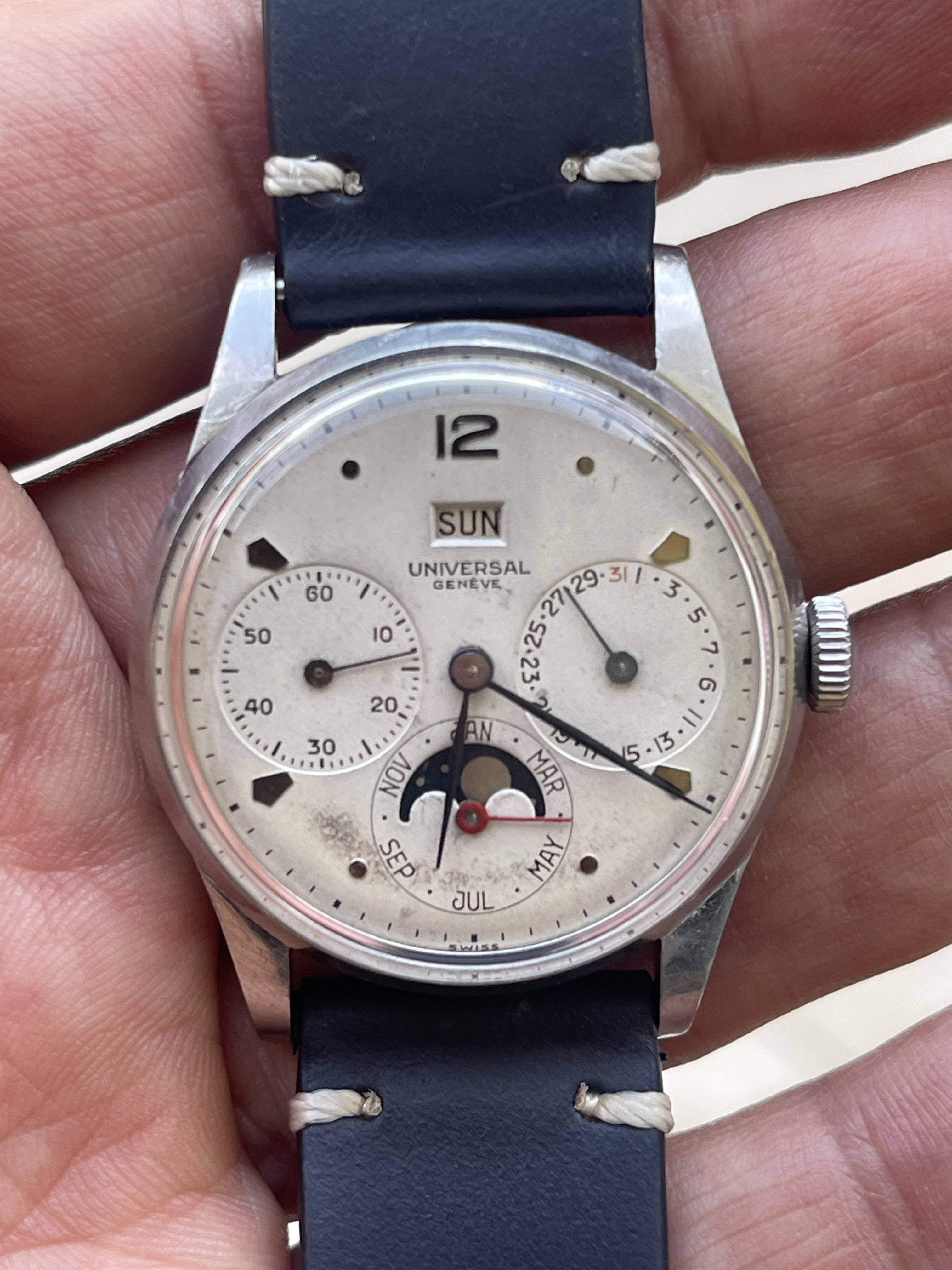

I think they reversed the red month hand and the date hand as well
