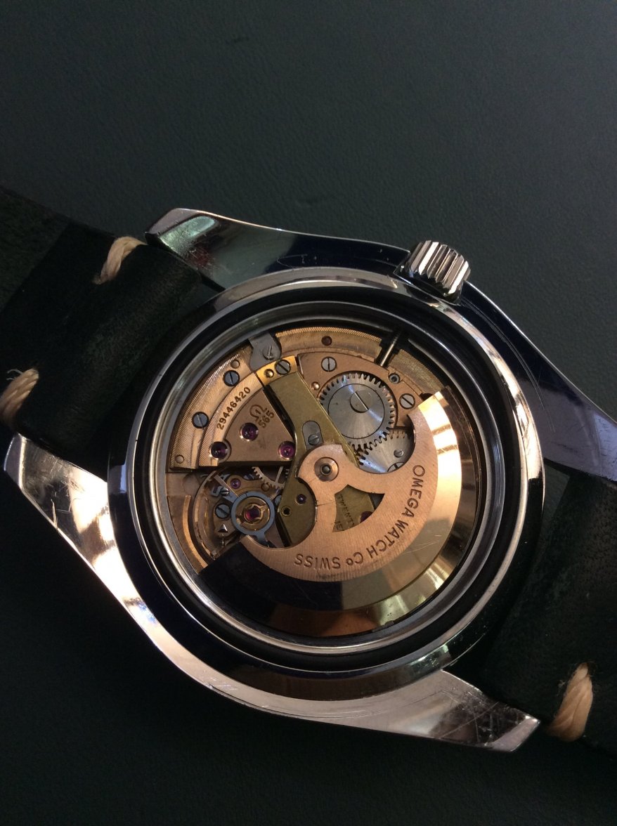

  12. 76duece Nov 28, 2017
    27
    The owner sent these photos of the movement and case back today. What do you guys think?
    Larry
  13. craftandtailored Nov 28, 2017
    31
    17
    Its a WatchCo SM300.. his asking price is right on target for what it is but the Dial, Hands, Case Back, Crown are all service replacements. movement by my research serial on teh main plate dates it to 1971
