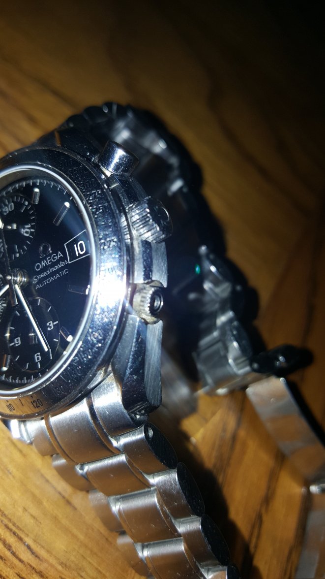

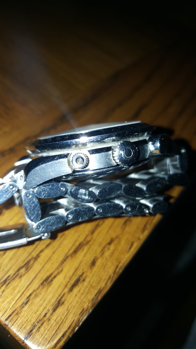

    My Speedmaster pusher button came off.Has anyone any idea of the part number as its £600 to get done by Omega.Was serviced 3 years ago so dont really want to pay that at moment if I have an alternative.Thank you.Its my first time on forum . 20190510_204123.jpg 20190510_202938.jpg 20190510_202851.jpg 20190510_202833.jpg

    Think you have to buy the whole pusher, maybe a watchmaker with a parts account might just fix it.
    But not many will do it as a small job as the movement has to come out.

  4. Chewbakkka May 23, 2019
    71
    62
    you have your case reference? Then you know already which pusher you need
  5. Dan S May 23, 2019
    18,812
    43,263
    Maybe the cap just got loose and unscrewed from the pusher rod (or whatever it's called). Are you sure you need a new part?
  6. Archer Omega Qualified Watchmaker May 23, 2019
    26,463
    65,604
    Correct - the whole pusher is needed - part number is 086ST0079 assuming that this is a 35135000...
  7. wsfarrell May 23, 2019
    2,441
    4,133
    Easy fix for a watchmaker and the part is availablePurchases made through these links may earn this site a commission from the eBay Partner Network on eBay.
