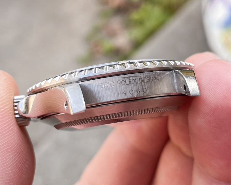

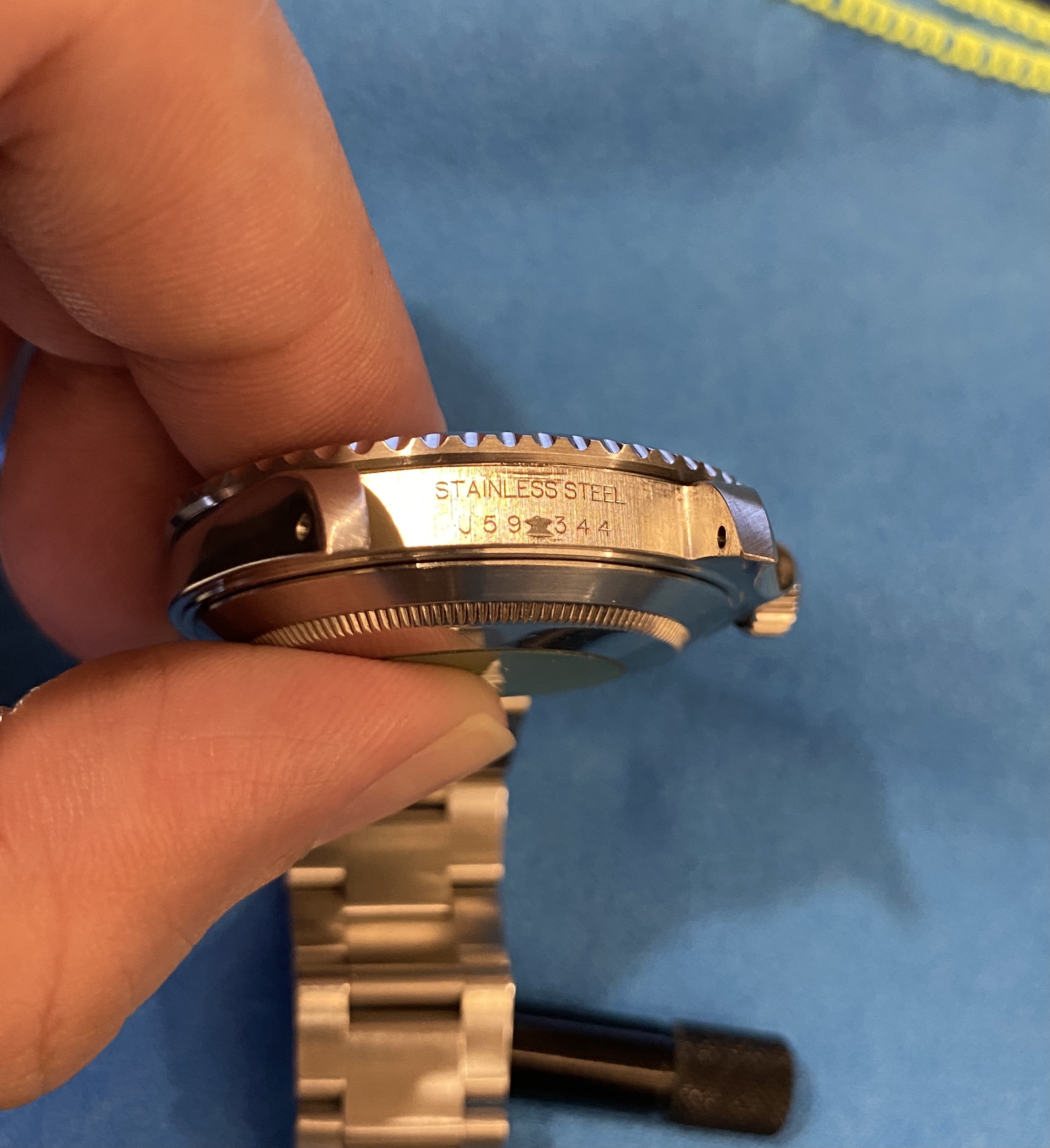

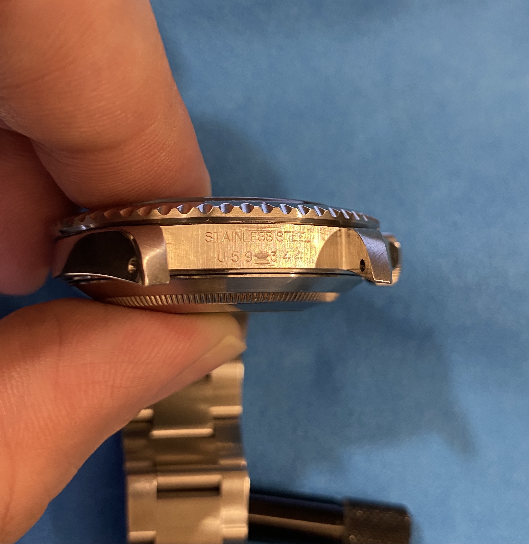

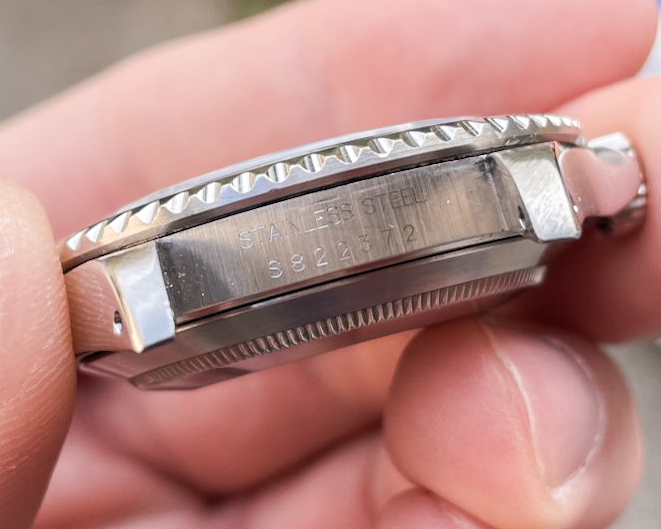

Hi guys ! I bought a 14060 full set but when I removed the bracelet to check the serial number , to my horror I saw this !
Is it possible that the bracelet did this ?
Many thanks in advance !

Intruiging. Why only at that very spot?

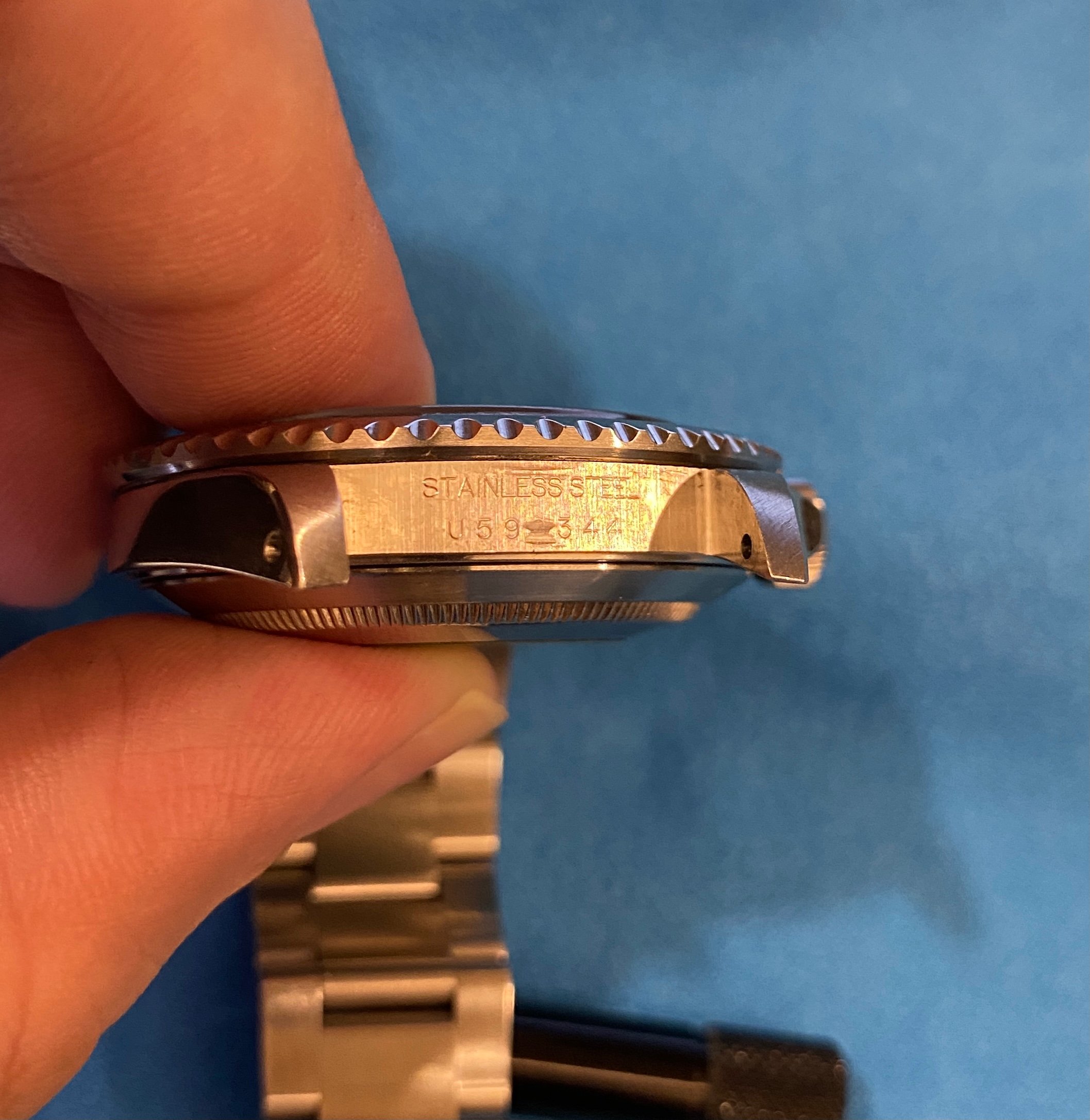

The same happened on my U serial 14060.
41
75
It's the central part of the links that holds the spring bar that caused the wear , imho

I owned an S serial 14060 and it never had any wear like this. Just the typical wear from the top of the end link.
140
168
That is quite common on Subs and could be even worse with years. Nothing to worry about.

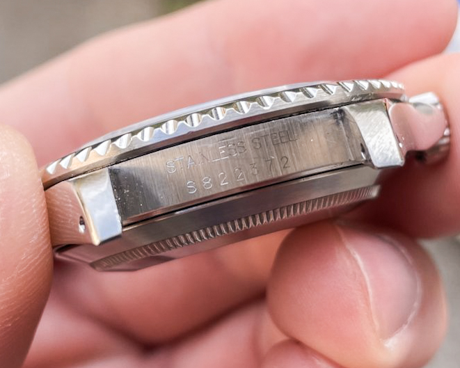

Yes, it's quite common, especially with hollow end links. The only downside is not knowing what the true serial is; typically when an RSC discovers this, they engrave the serial onto the case back before (a part of it) is completely rubbed away.

Pretty common to see such wear marks on those 14060. I have seen the wear marks in the same location on either the 6 or the 12 side off the case. But I have also seen plenty with very few marks. Either they changed the end link design in a certain year or in 2012 when it became the 14060M the case became no holes, so perhaps that changed the amount of wear marks?

I agree that this common in my experience with many Rolex cases, even more modern models like yours.

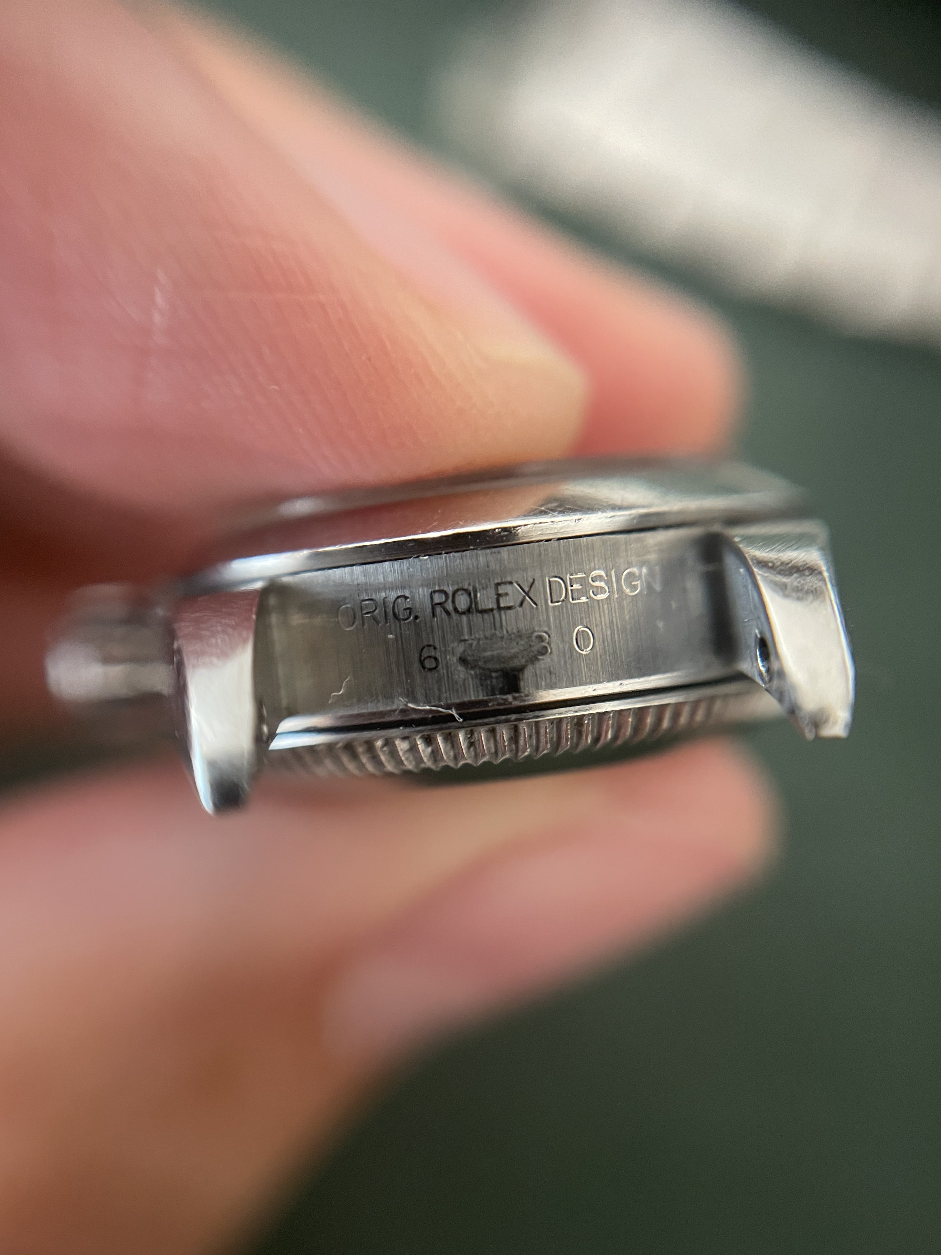

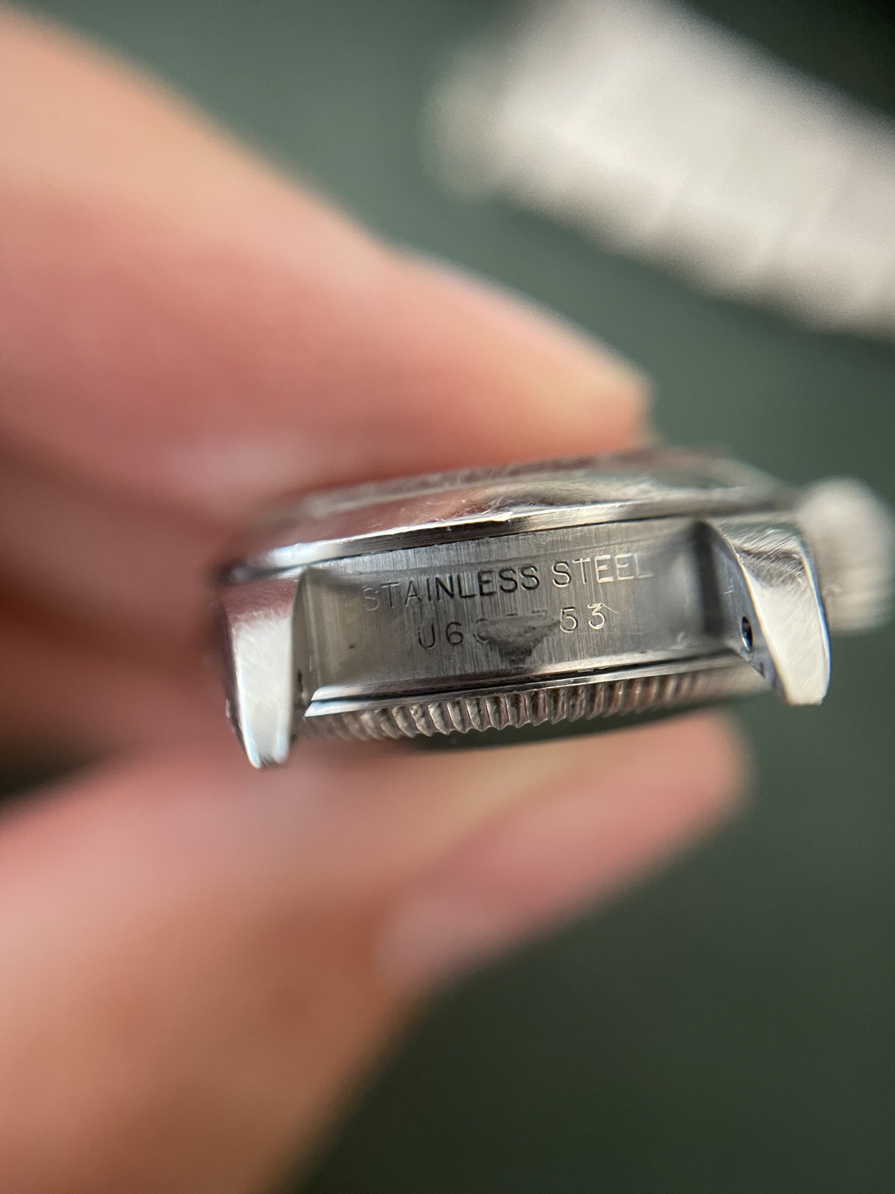

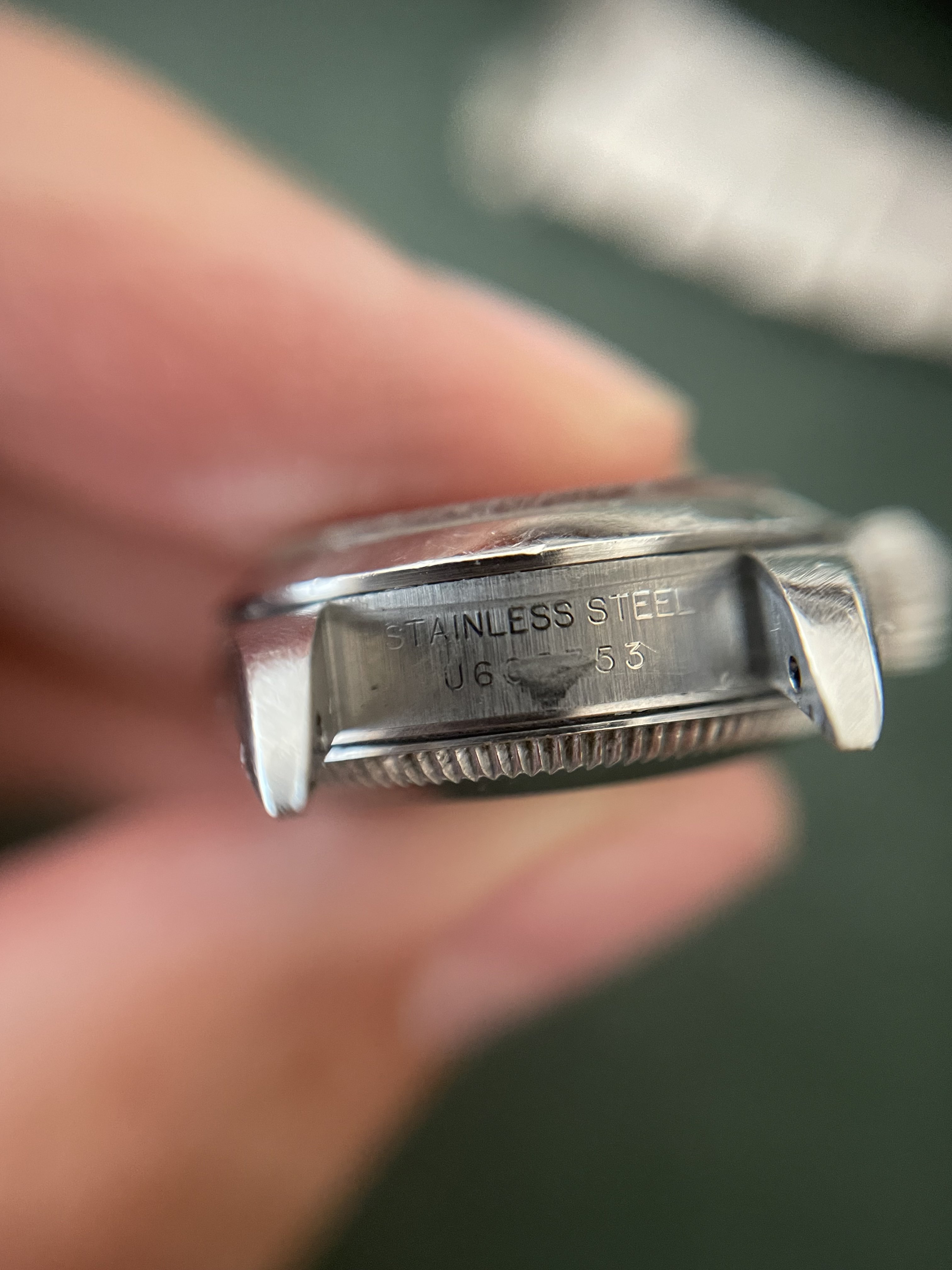

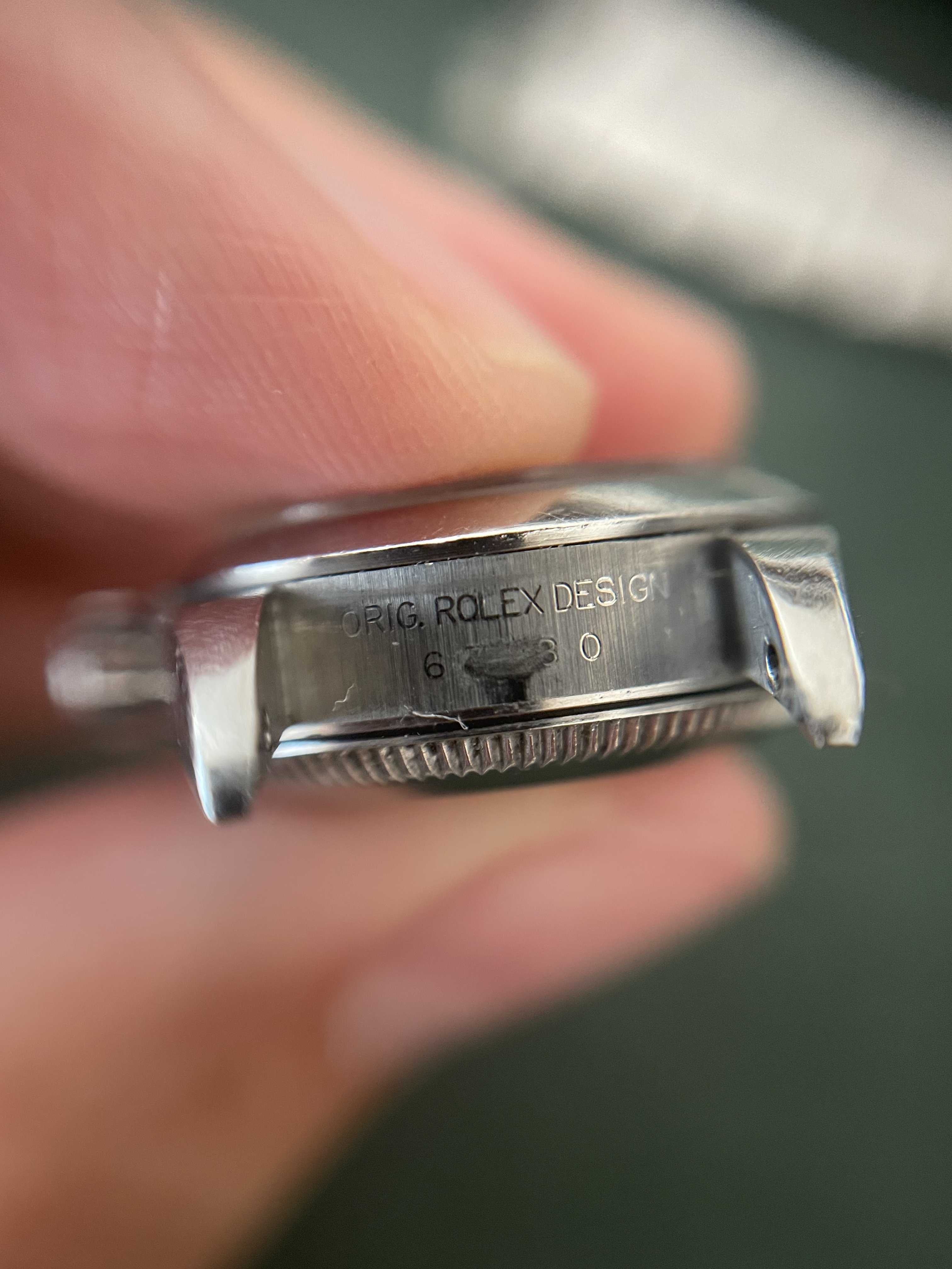

Here is a ladies watch that I had purchased from the original owner, luckily came with papers so I know the full serial.

Frequent occurrence for braceleted vintage pieces
Seems like its a U-serial kind of thing huh? So weird!

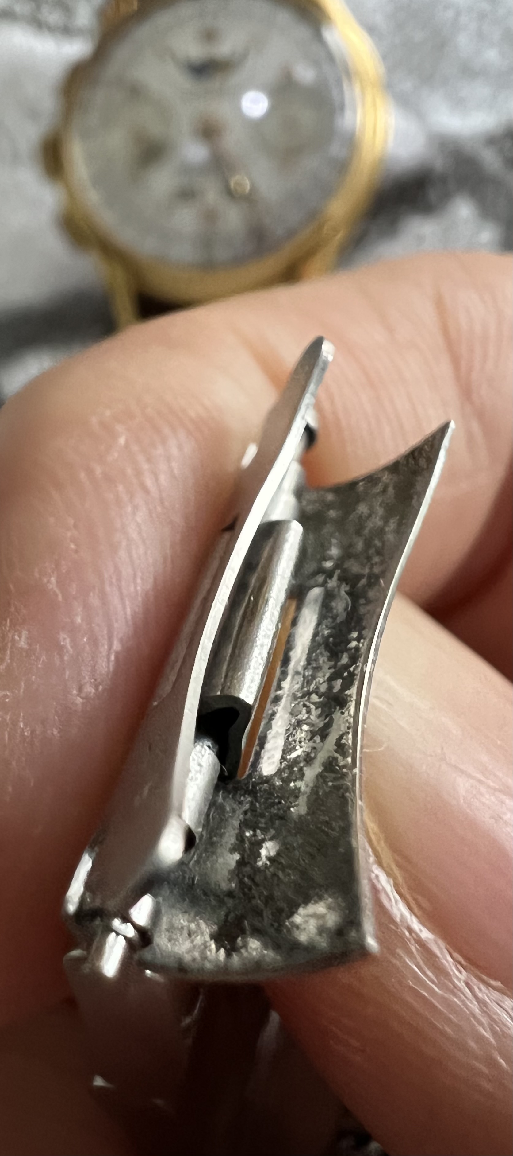

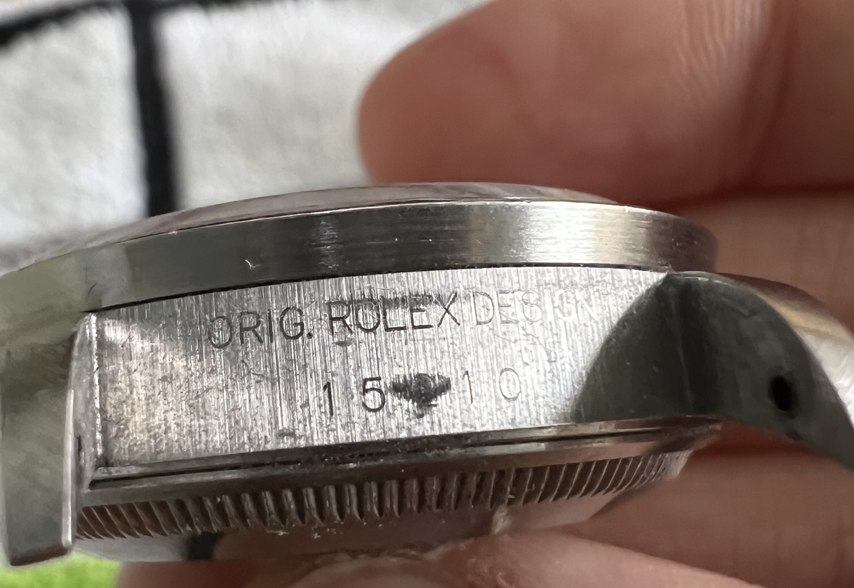

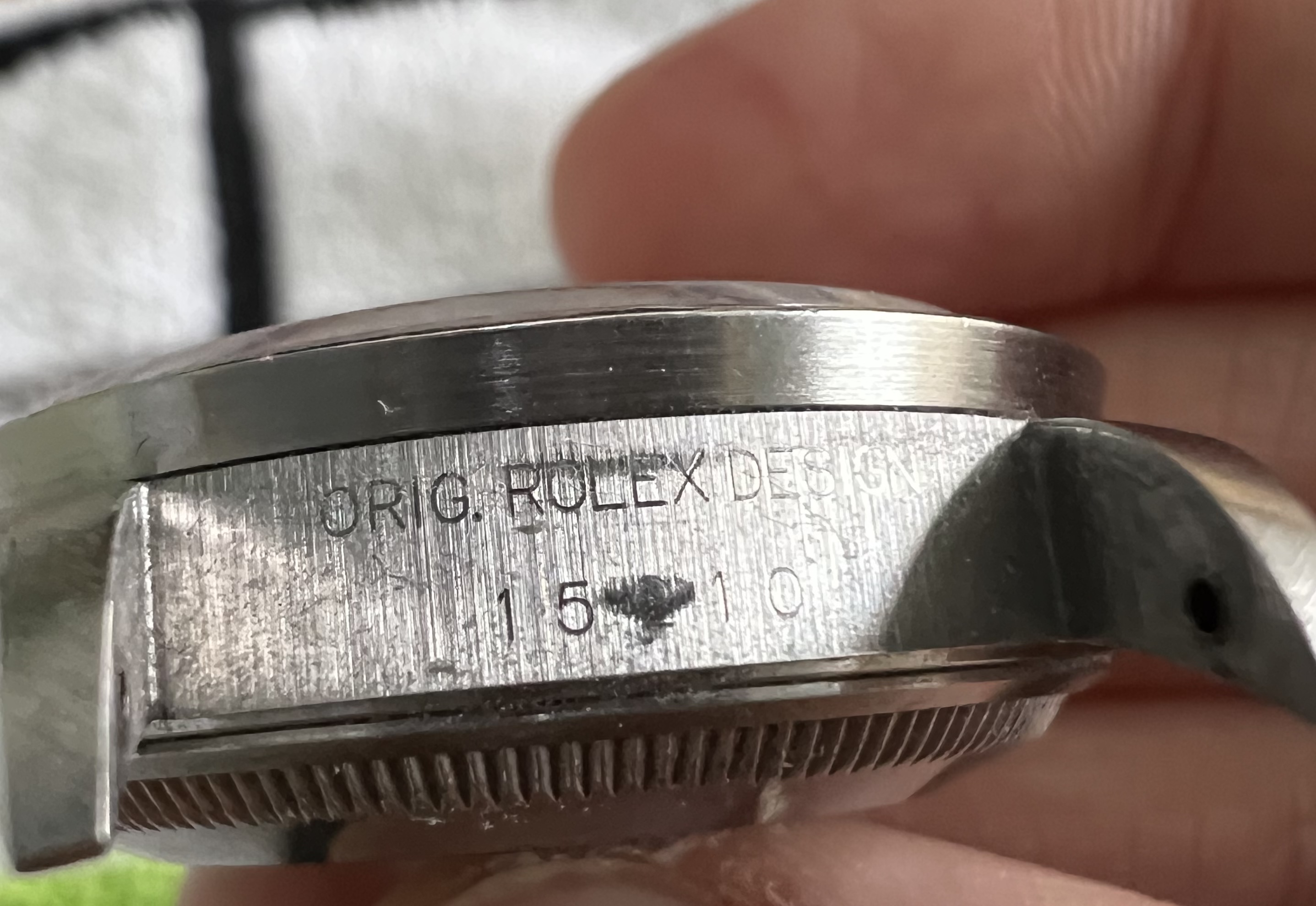

Reviving an old thread I just came across. I thought I would also make my contribution for watch enthusiasts researching this topic in the future.
My 15210 showing the same signs. you can just about make out the ‘2’ in 15210. As for the serial number, I can’t figure out what the mysterious number could be.

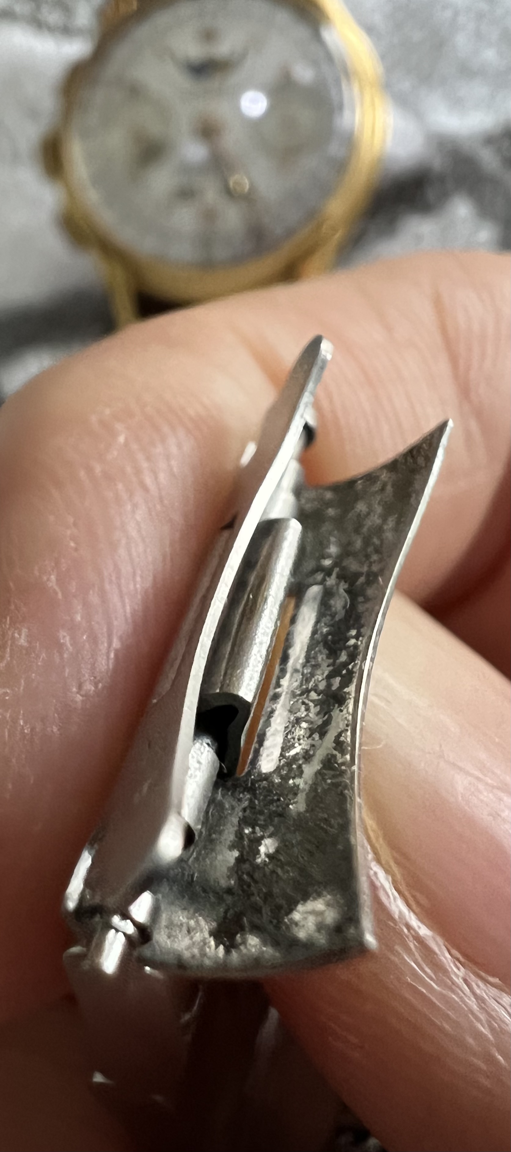

Hollow link 78350 bracelet, endlinks 557 B. The crimped link at the end is what causes this, as photographed.

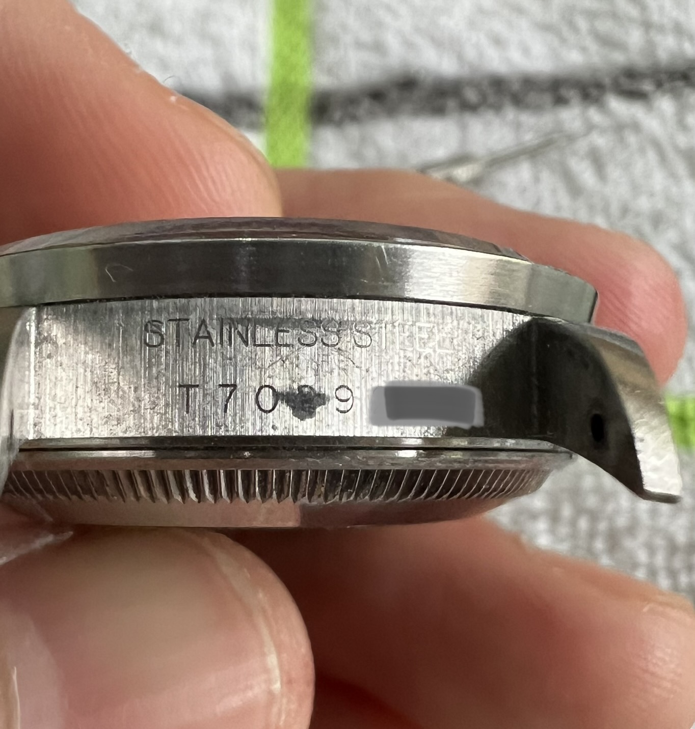

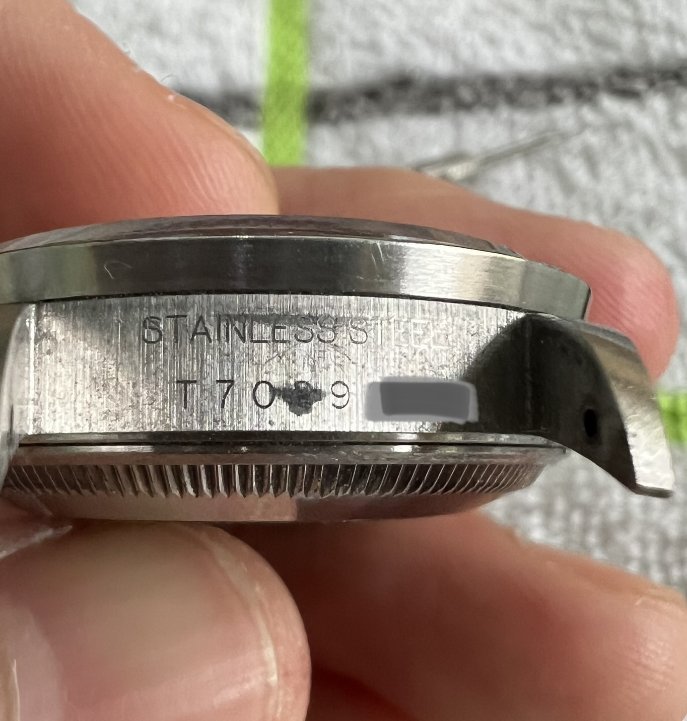

Minor compared to quite a few pieces I've come across...

True, but unfortunate that one of the digits is completely illegible.
