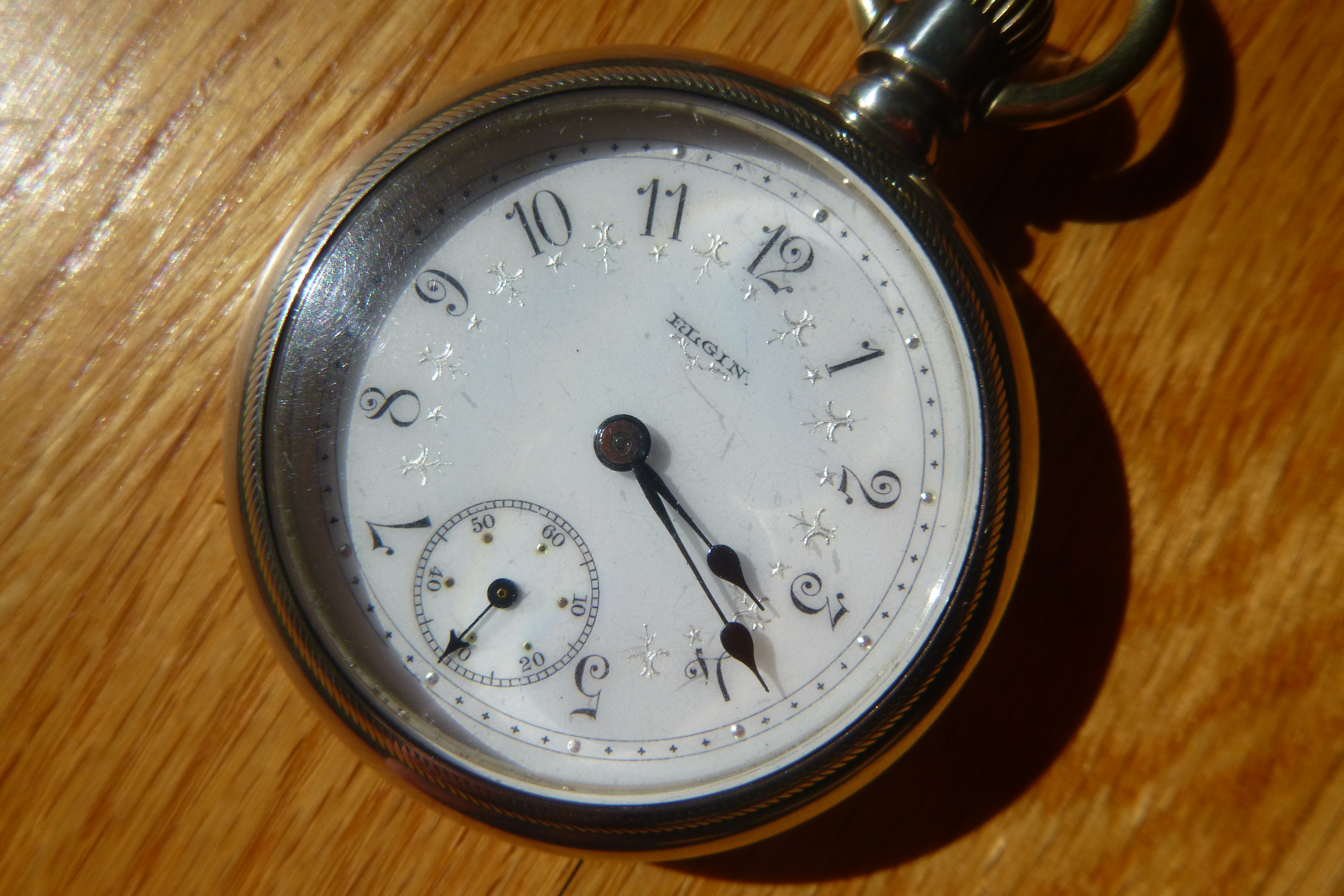

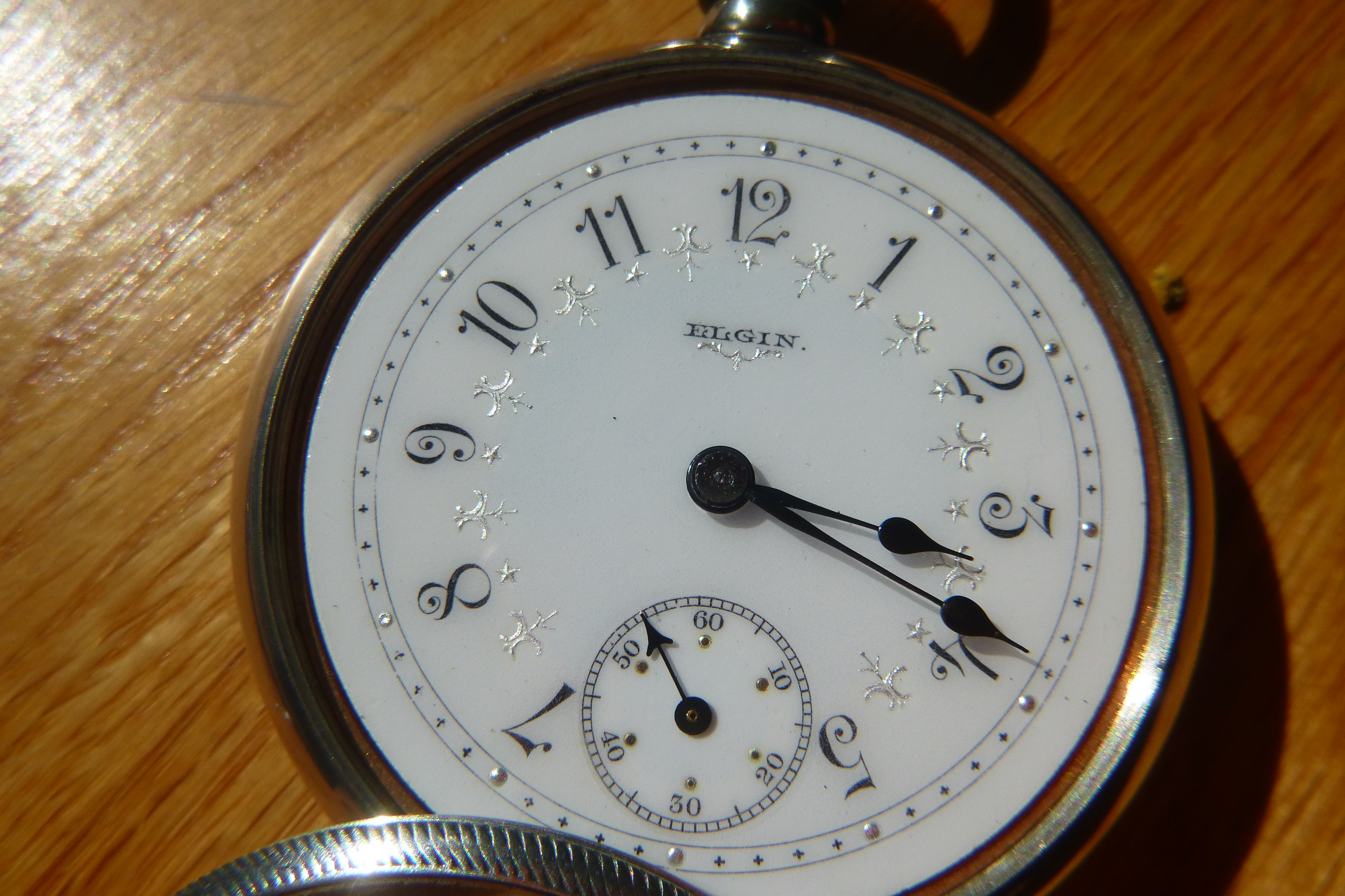

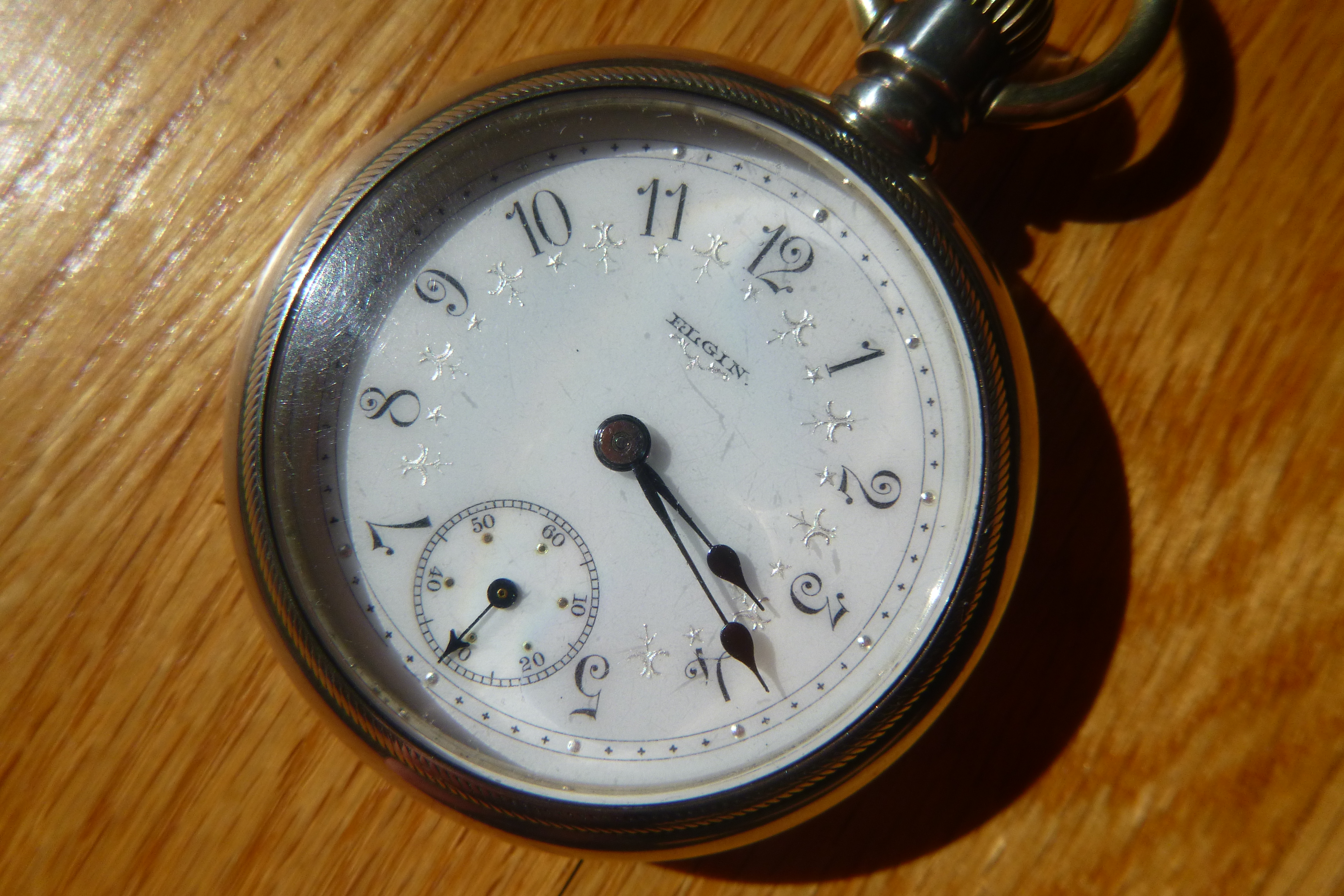

Elgin 15j, 18s, coin silver case, 1917
the dial is pretty much mint, not looking like it had ever been fit to a movement when I bought it and stuffed it onto this old lump, the scratches are all on the crystal.

Thanks @Canuck , this one is a type III, with the less common white gold-filled case
Yours has the preferred optional dial. Nice. Your case almost looks like green gold in the picture. Thanks for completing the picture.

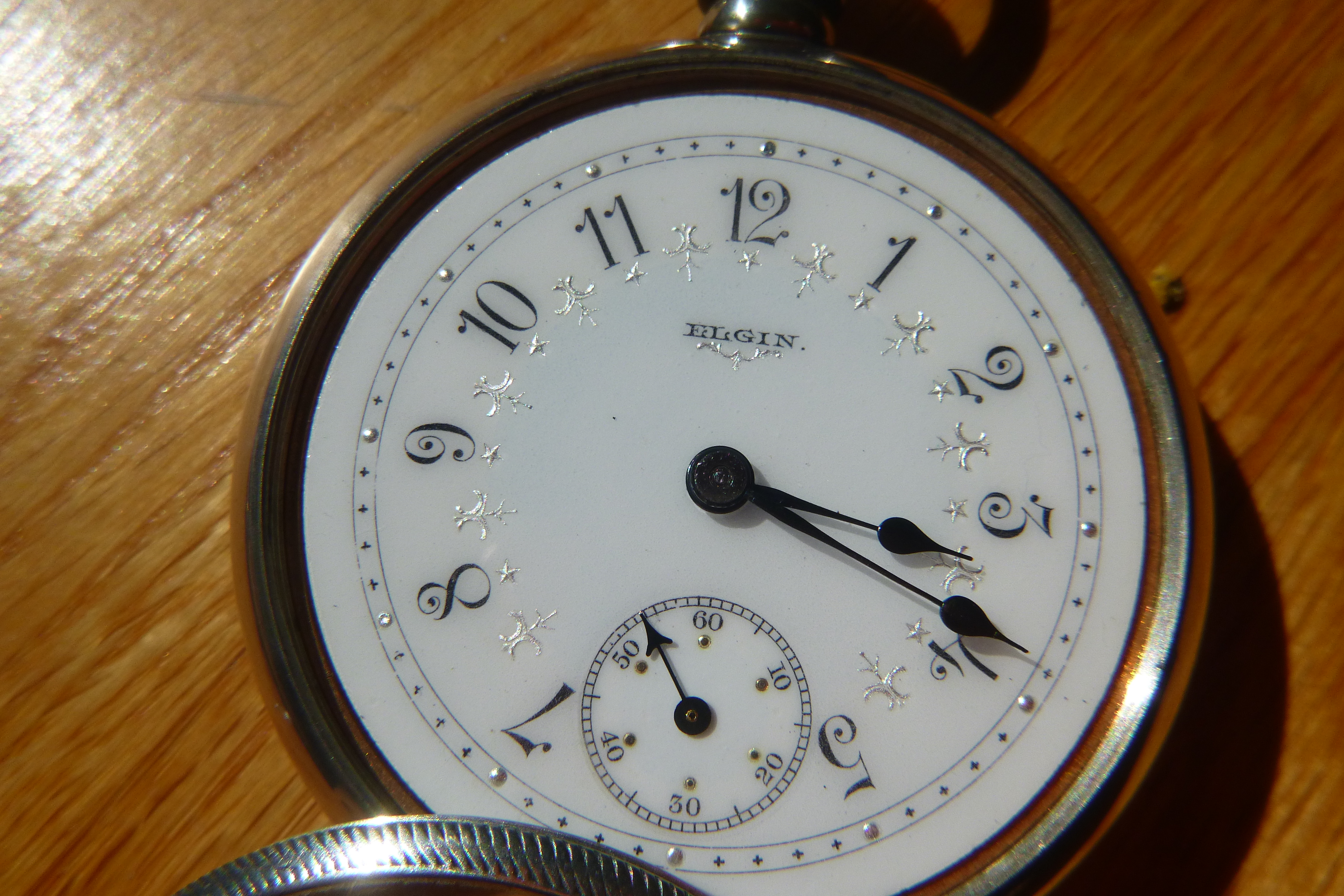

pretty!
I really like that dial. Congrats on this
15,997
48,115
The decor on those dials was difficult and expensive to do. And there was lot of spoilage. After the dial had been enamelled, the foil was added, then the dial coated with a clear flux to immerse the foil, then the dial was fired again to melt and fuse the flux. If the dial is viewed from the edge with the light glancing off the surface, you’ll see the foil is covered by the flux. This is called “underglaze”. Then the dial was printed, and fired again. This resulted in an overly thick enamel surface which was prone to crazing. It was little wonder that, by about the late 1940s, most U S A watchmakers discontinued use of vitreous enamel dials.

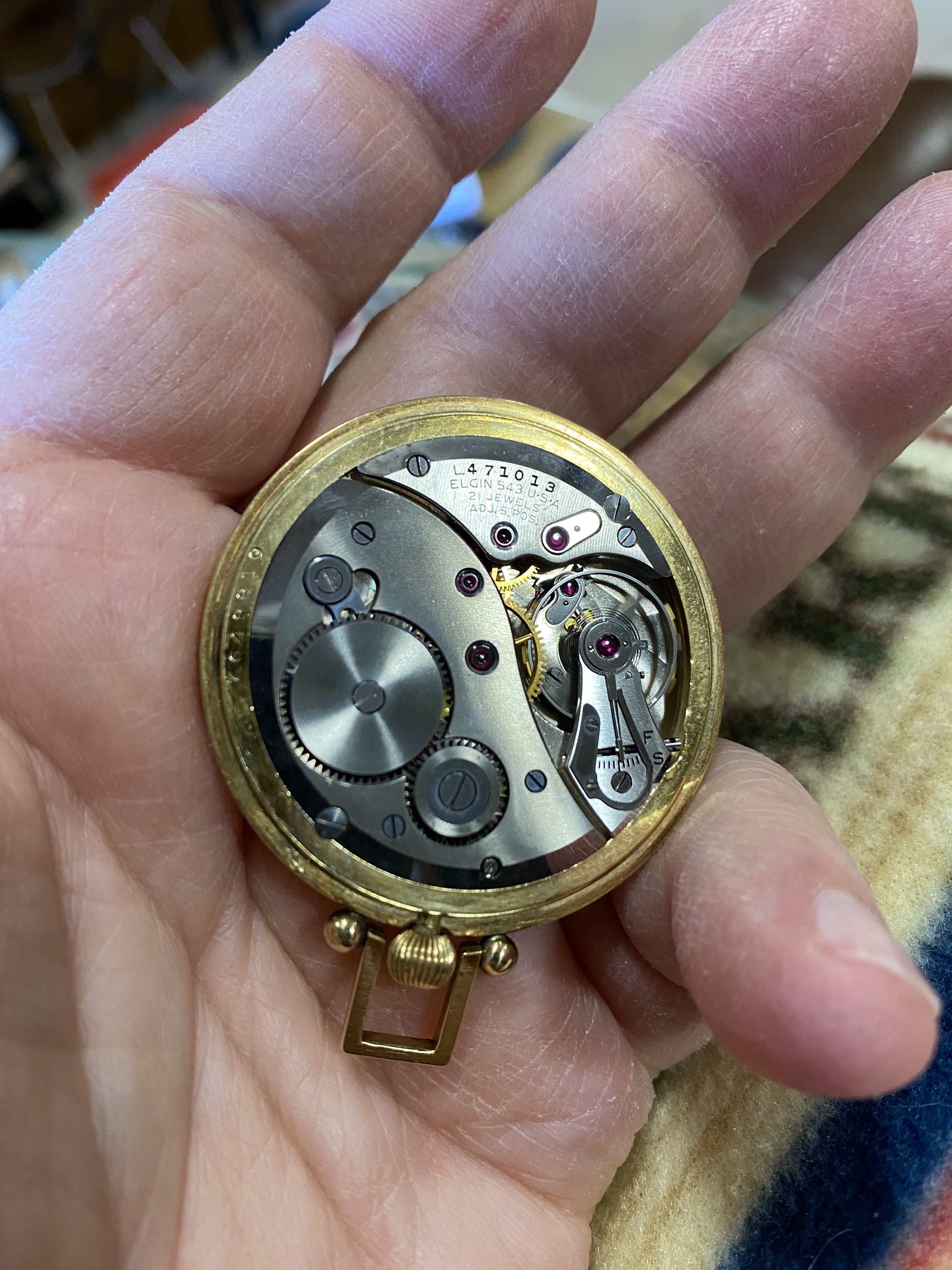

Neato!

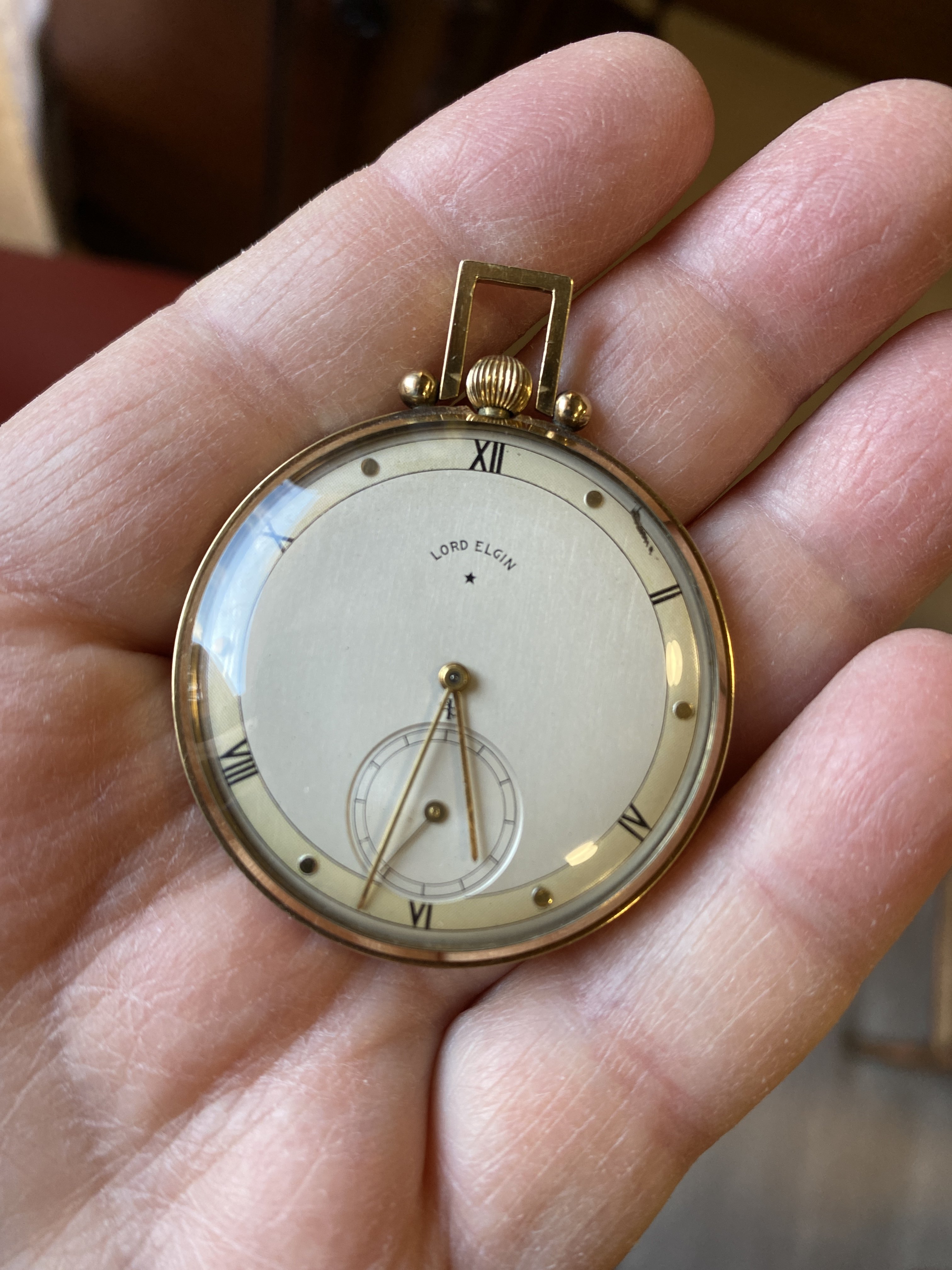

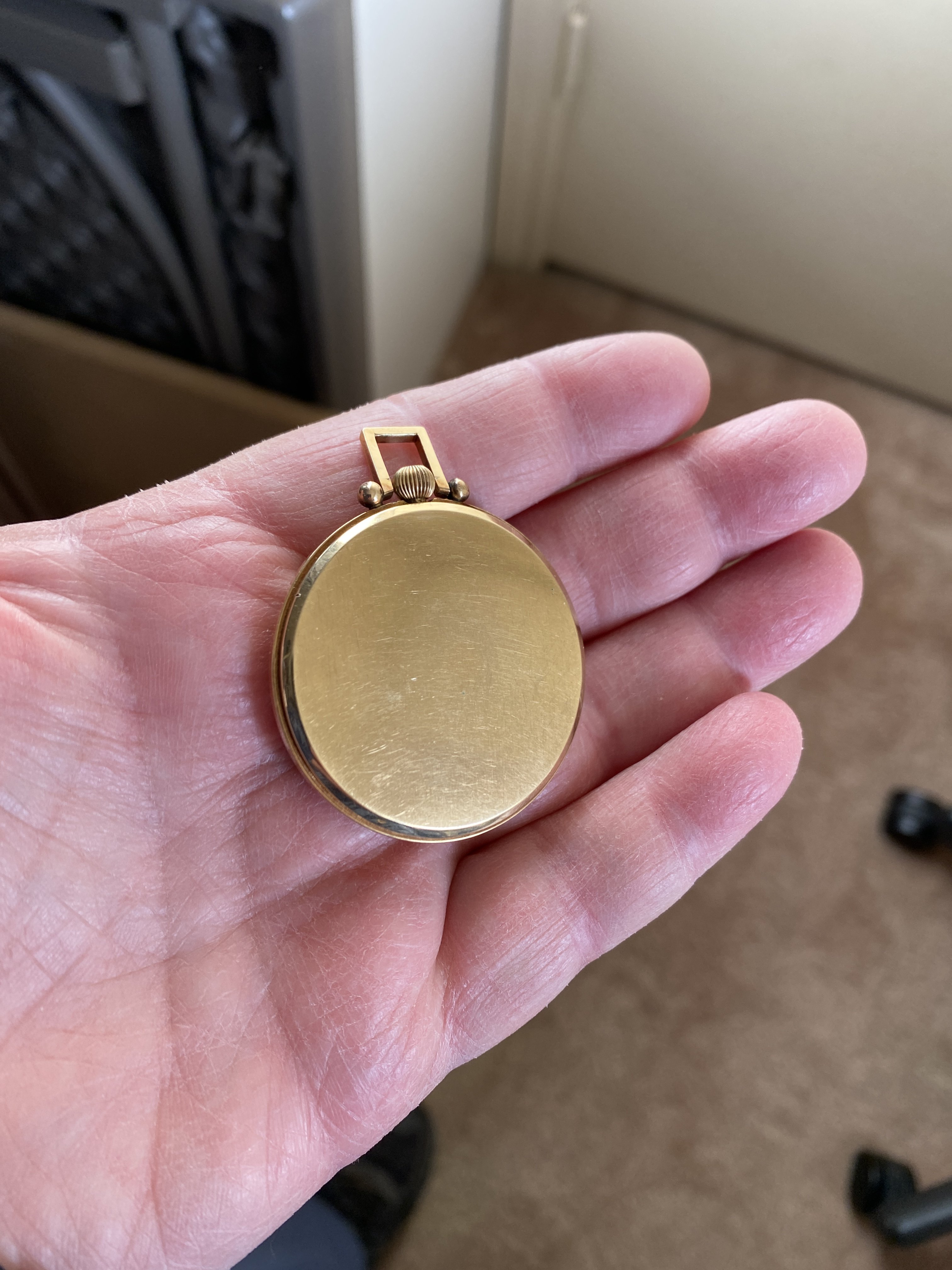

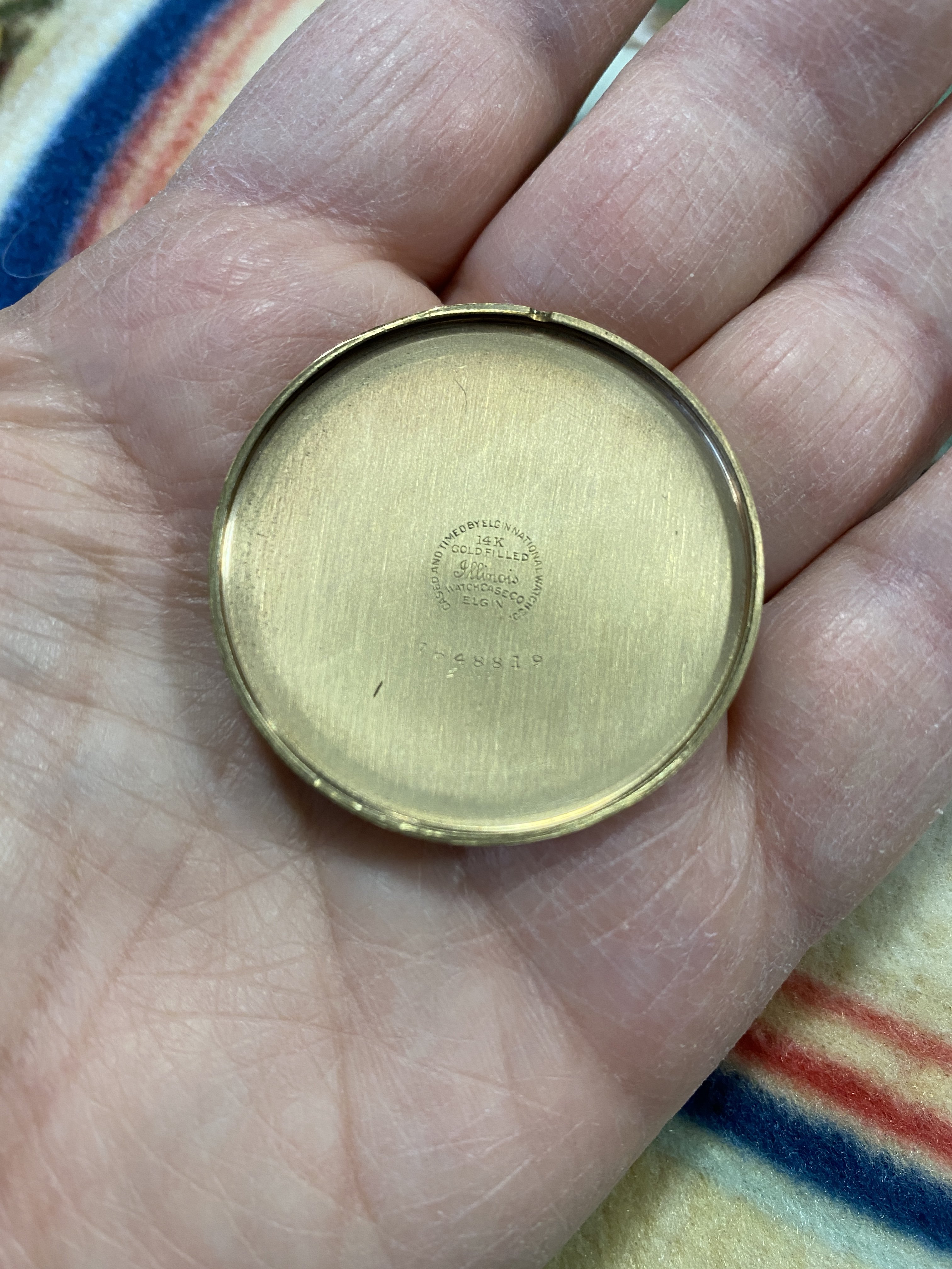

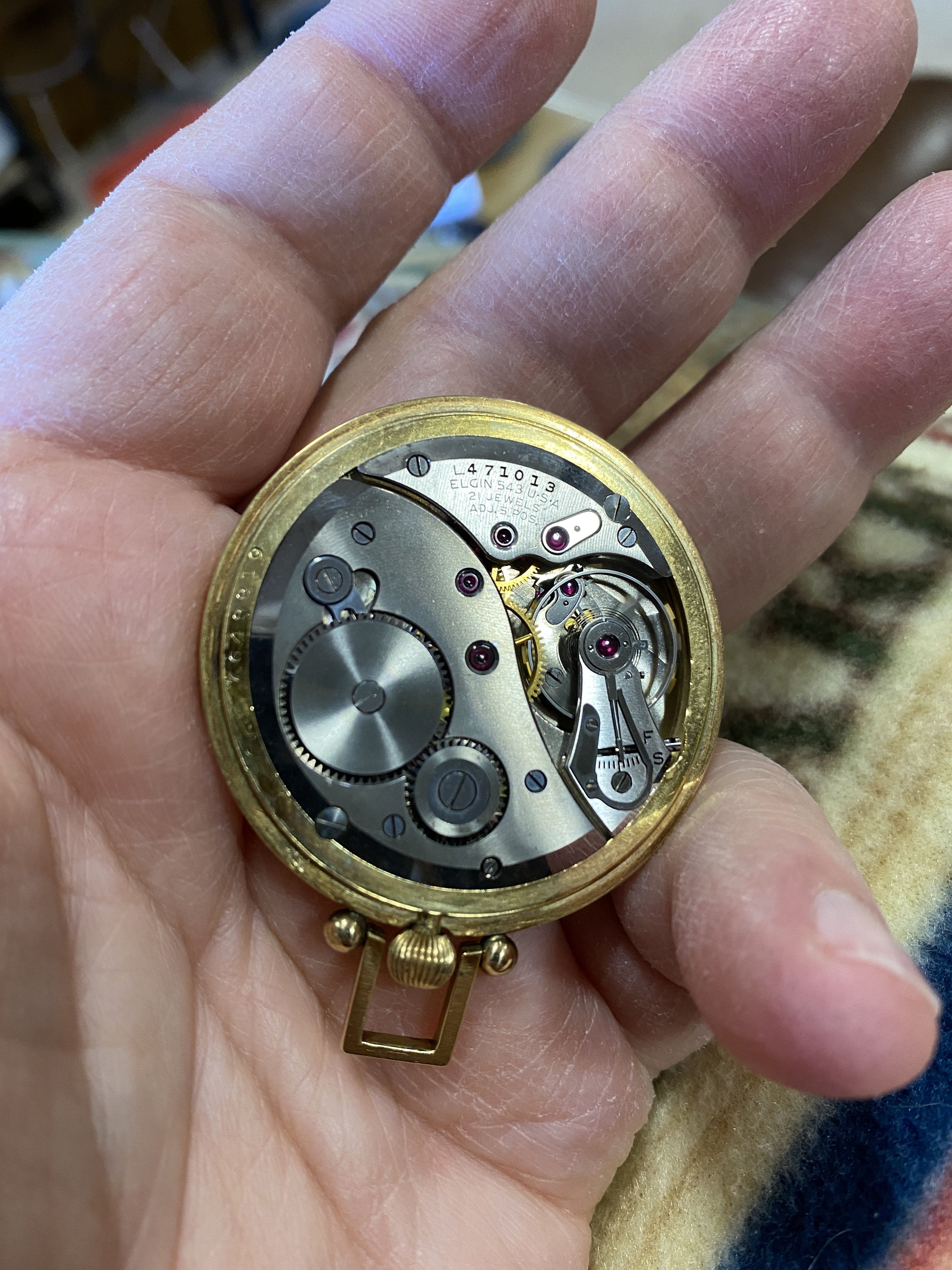

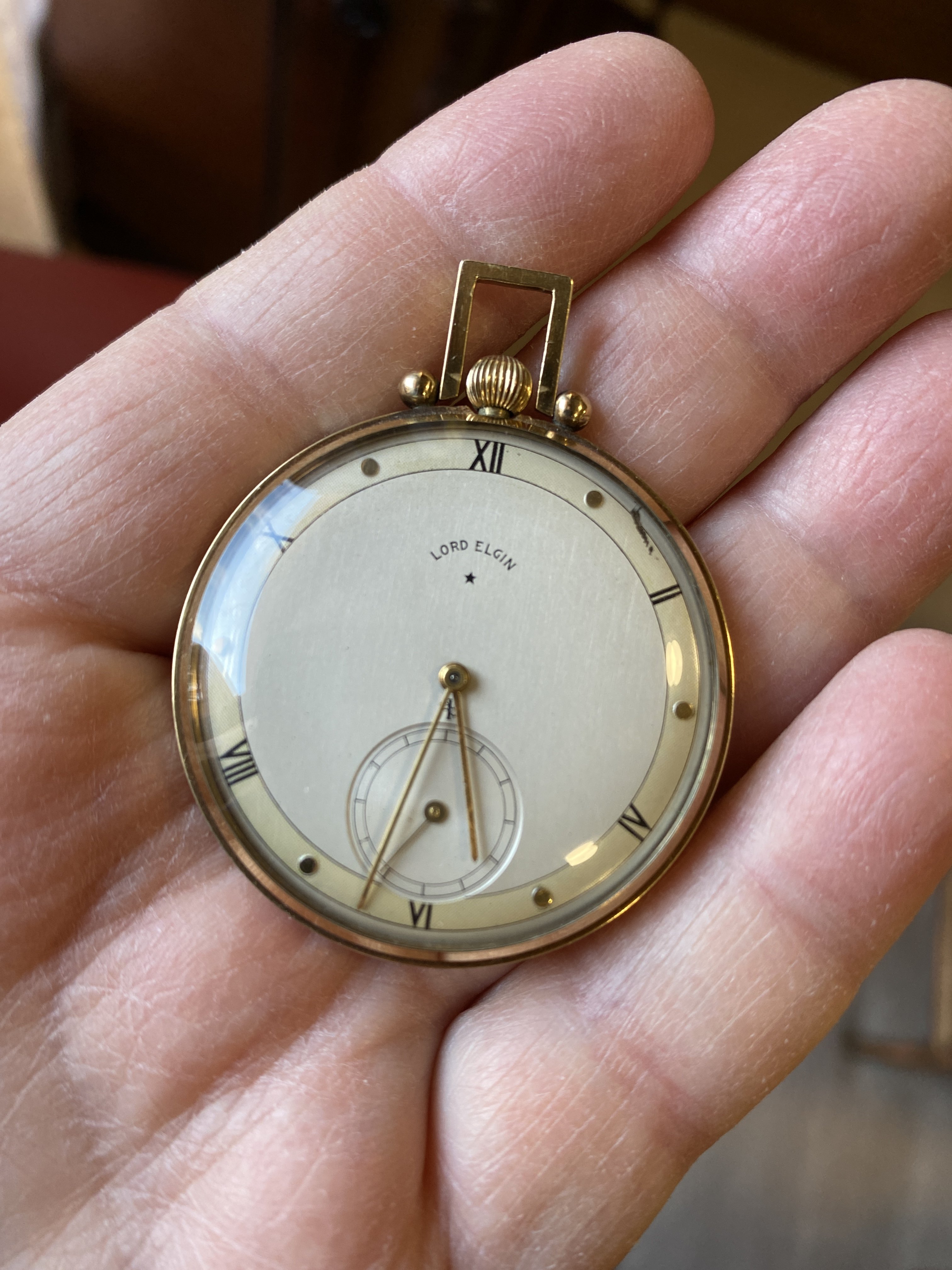

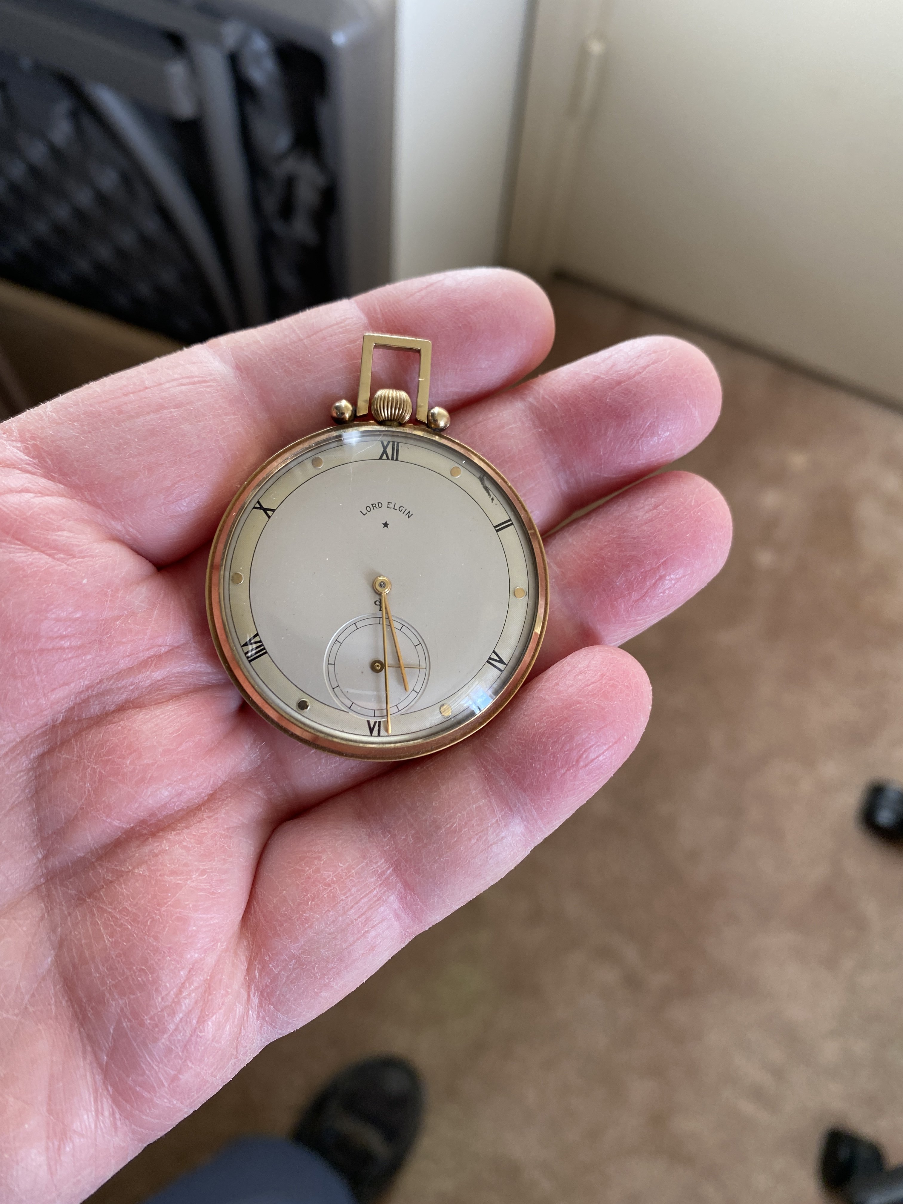

https://pocketwatchdatabase.com/search/result/elgin/L471013
When Elgin serial numbers reached approximately 38,xxx.xxx, they dropped the year prefix, and replaced the two digits with a letter. X replaced 38 in 1938 (and 1939). Each year, the letter prefix changed. The L prefix on @TexOmega ’s sharp little Elgin represents 1940, and the numerals represent the year. The pocket watch was slowly going the way of the dodo bird when this one was made, but the railroad approved pocket watch still had a strong demand.

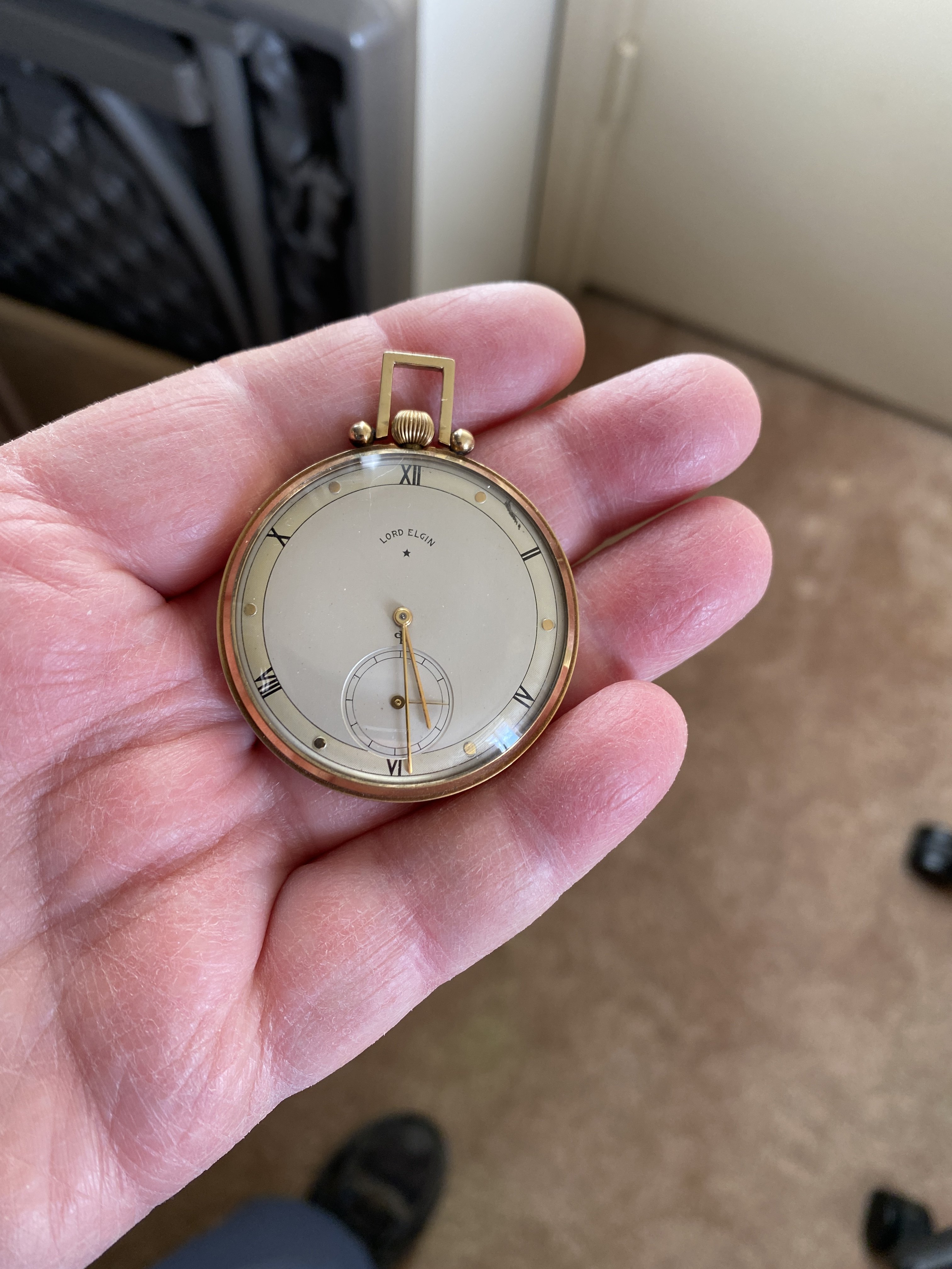

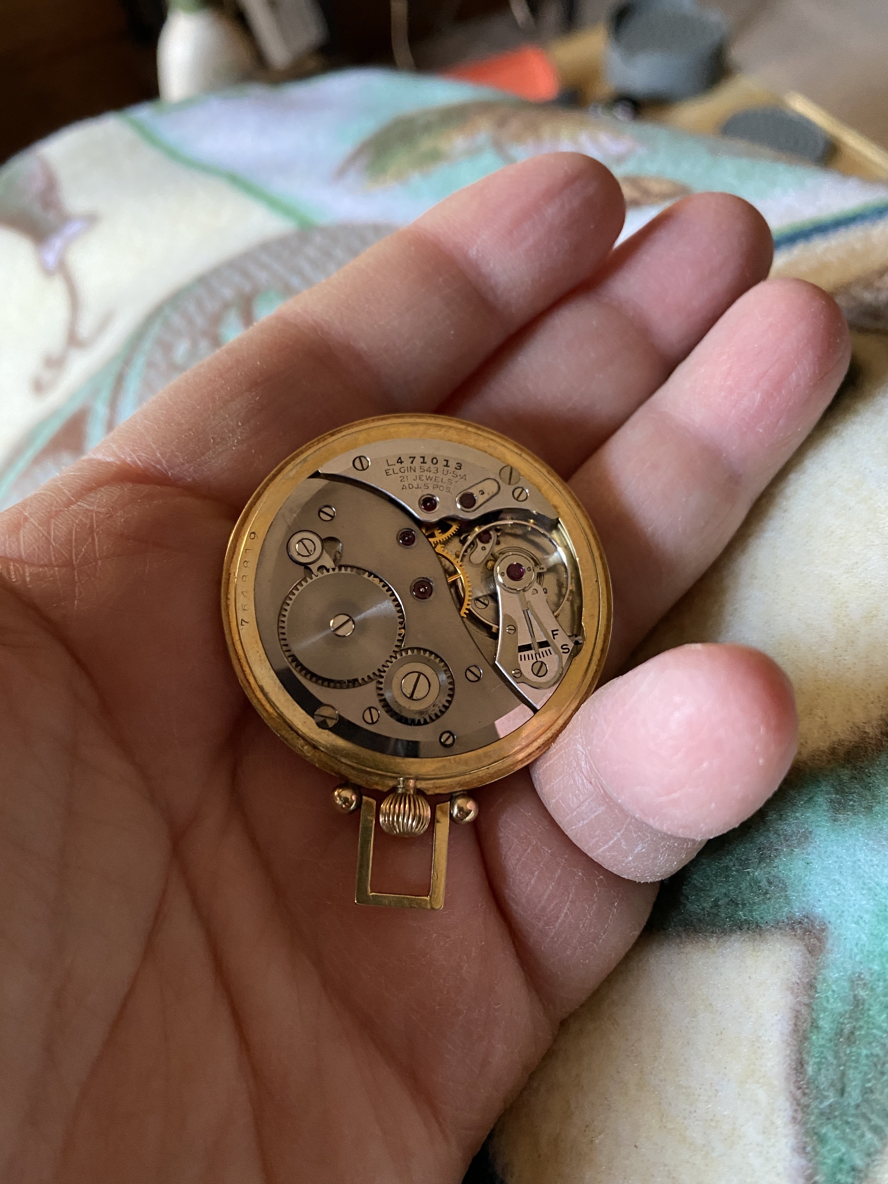

8,881
62,889

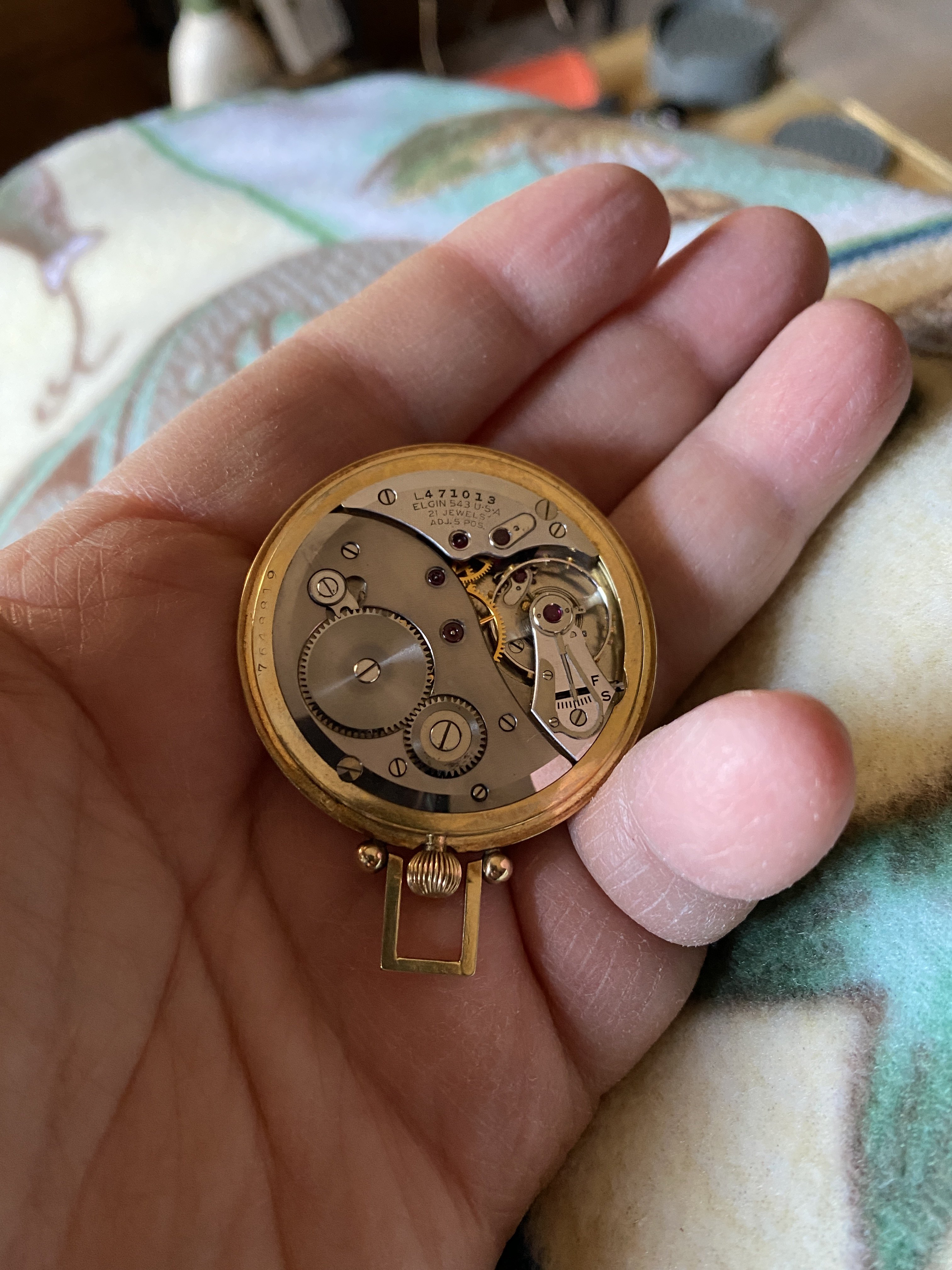

My notes from back when I bought it, state this was Elgin’s 1st size 10 with the Ball regulator and therefore able to be adjusted to 5 positions.
I’m sure mostly a marketing angle, not much demand then nor now for a Small, highly accurate pocket watch that a size 12 wouldn’t cover.
but nice esthetics in and out.

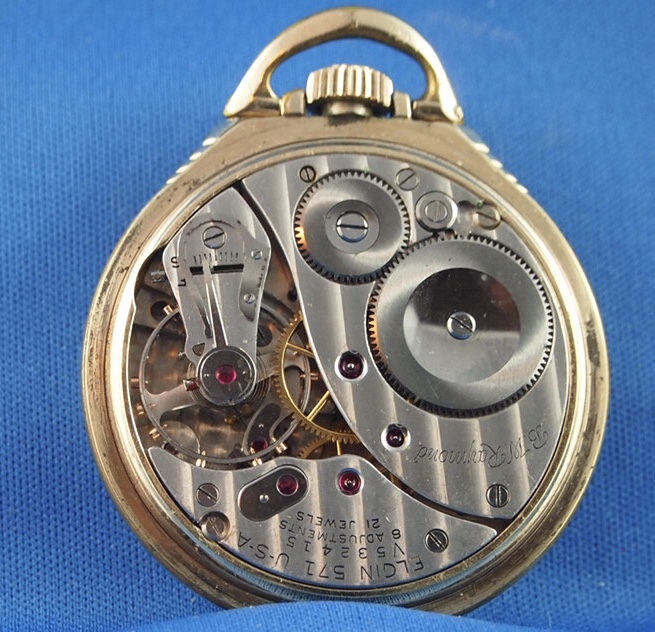

In U S sizes, an “O”size was 1 5/30ths of an inch. So a 10-size would be 1 15/30ths of an inch, 1 1/2” in diameter.

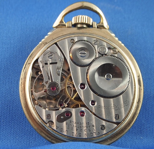

I have long felt that earlier U S made watches were dolled up because they were often sold without cases. The first view a new buyer might have of the watch he ended up with, was the “undressed” movement. It was easier for the retailer to sell the “eye candy” than it was to sell esoteric features such as positional error, temperature compensation, and isochronism. Obviously, such features added to the price of the watch. So the “eye candy” seemed (in the customer’s view), to justify the extra costs of the features he didn’t understand. Then, late in the 1920s or early 1930s, the U S makers started to sell their watches cased. No longer the need for showmanship!

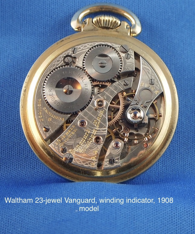

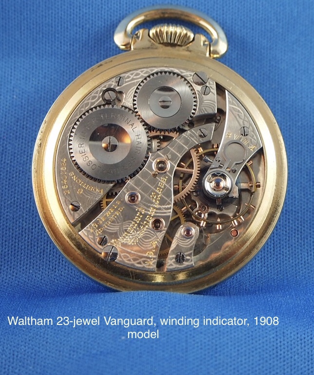

The “dressing down” appears to have begun perhaps in the late 1920s when one of the first adornments to disappear was the screws holding the plate jewels in, such as this Waltham 1908 Vanguard, circa late 1920s. Still
pretty, though! From there, feature after feature was dropped until the 1960s as characterized by the Elgin Grade 571 B W Raymond. To Hell with pretence!
Waltham.
Elgin.
