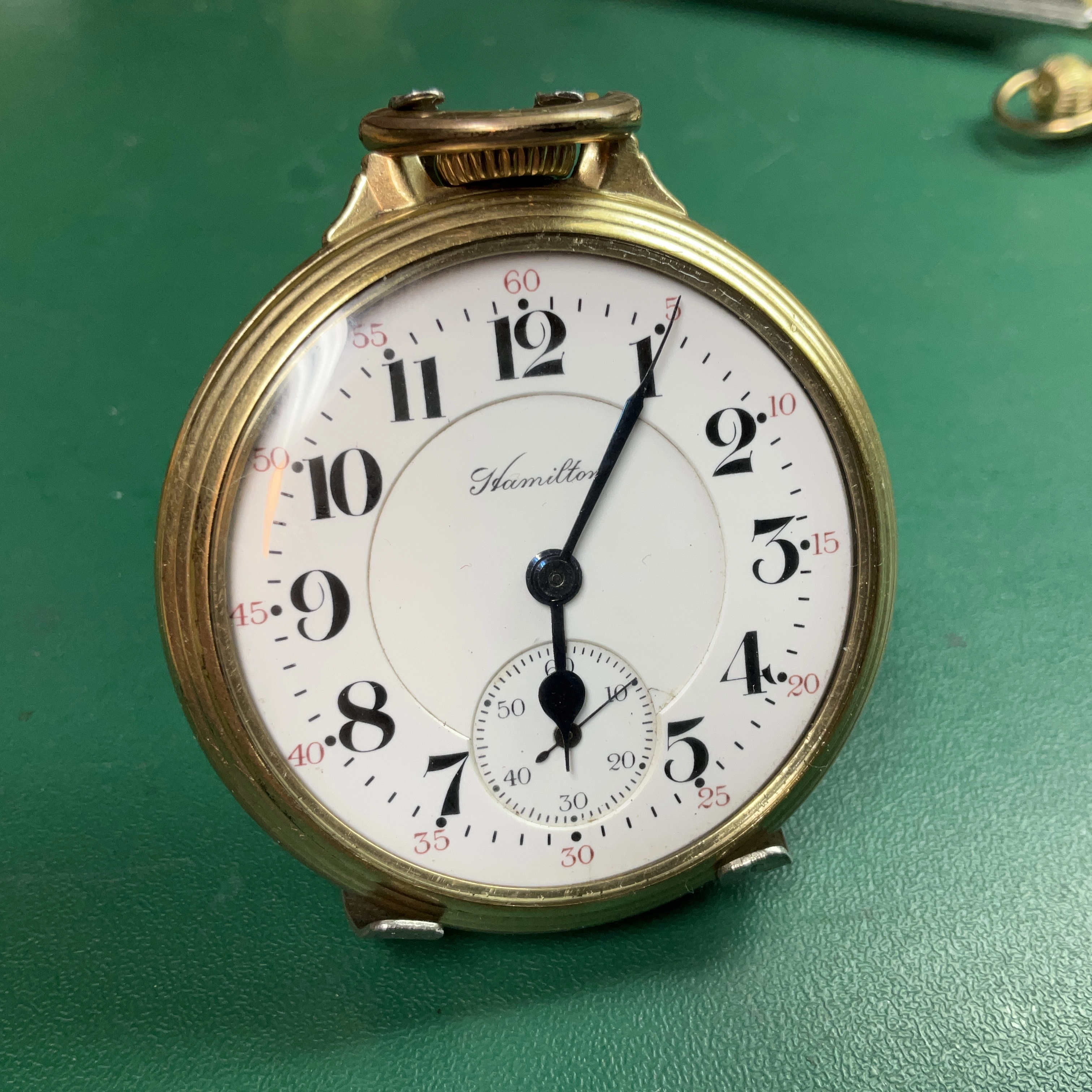

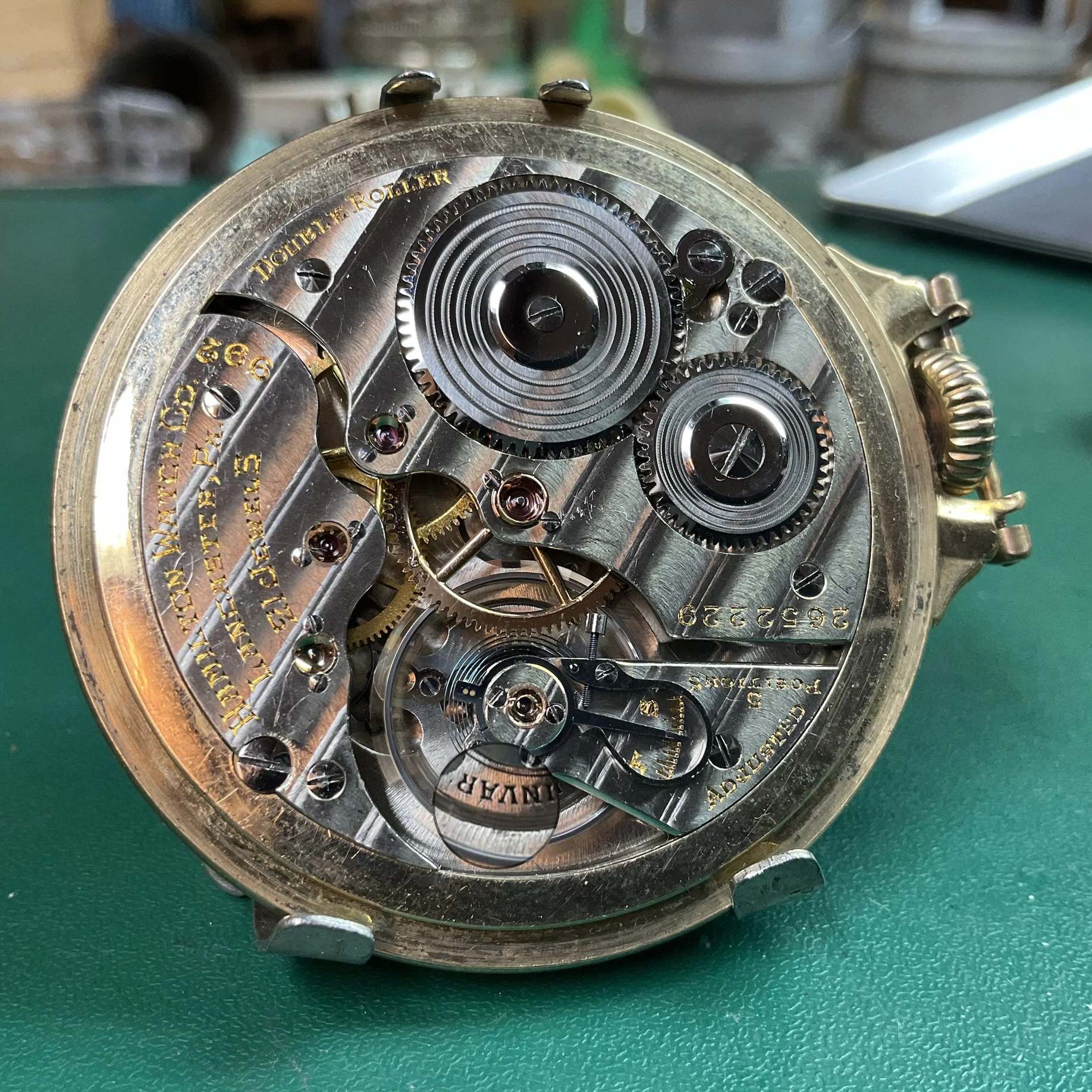

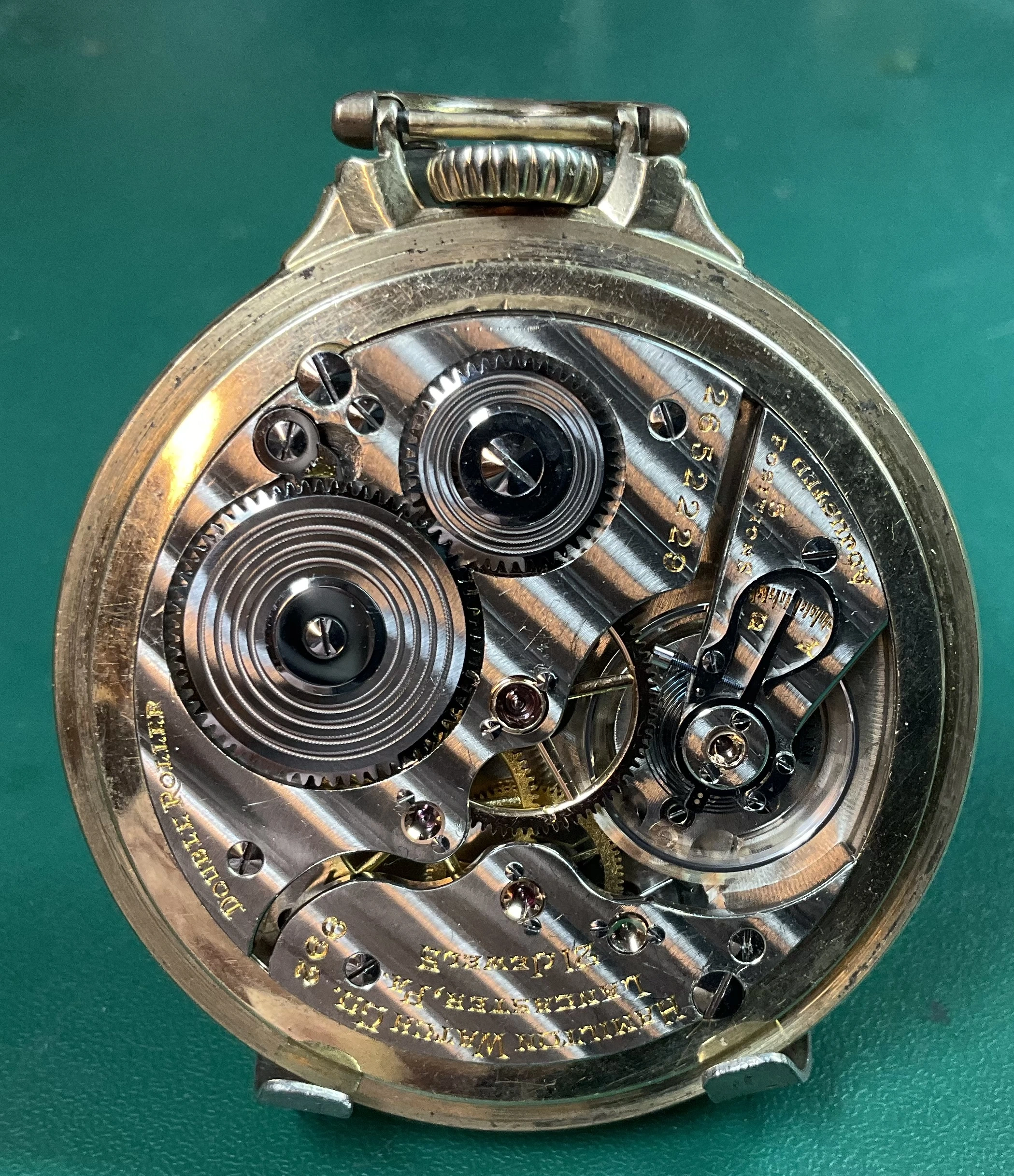

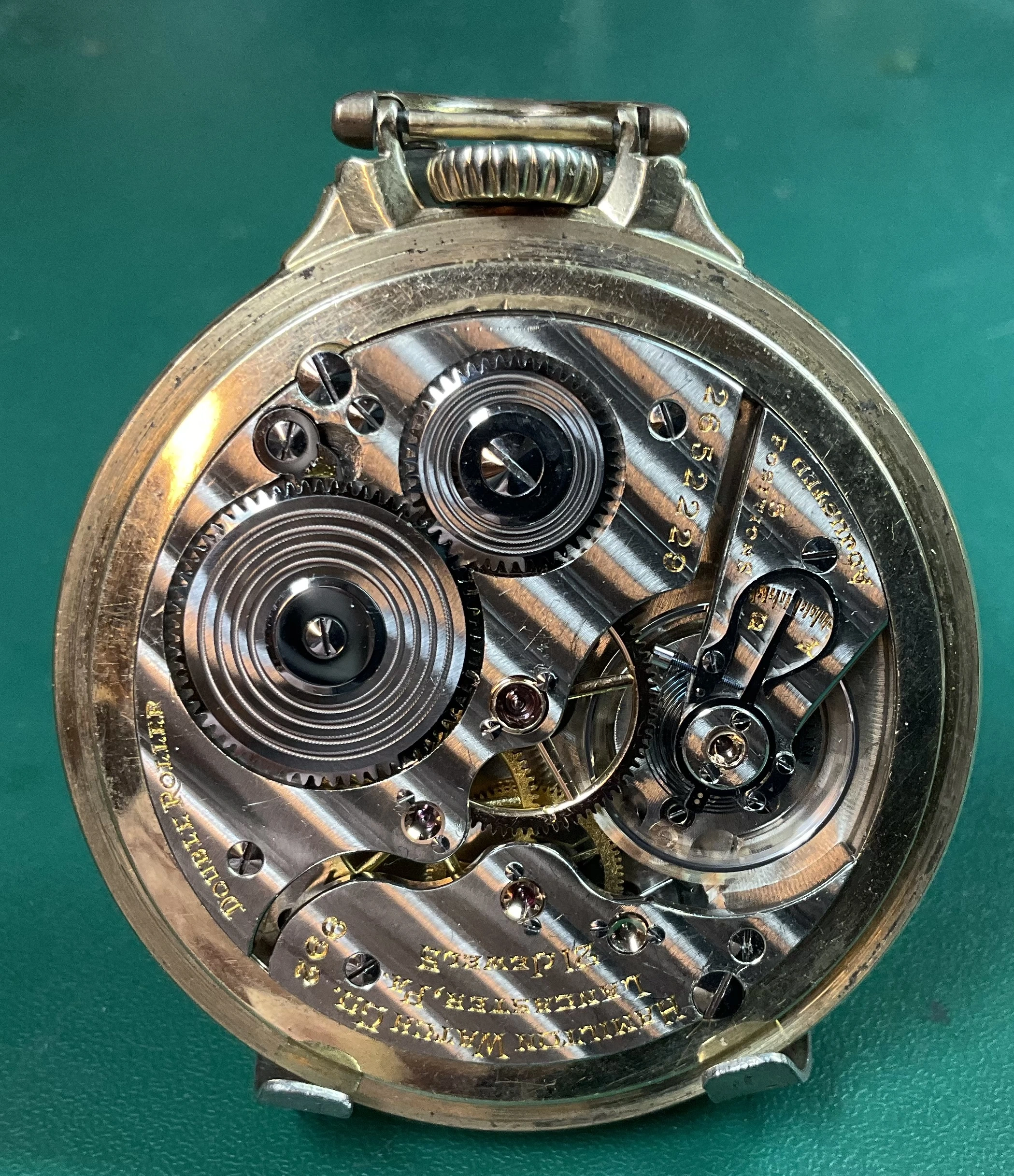

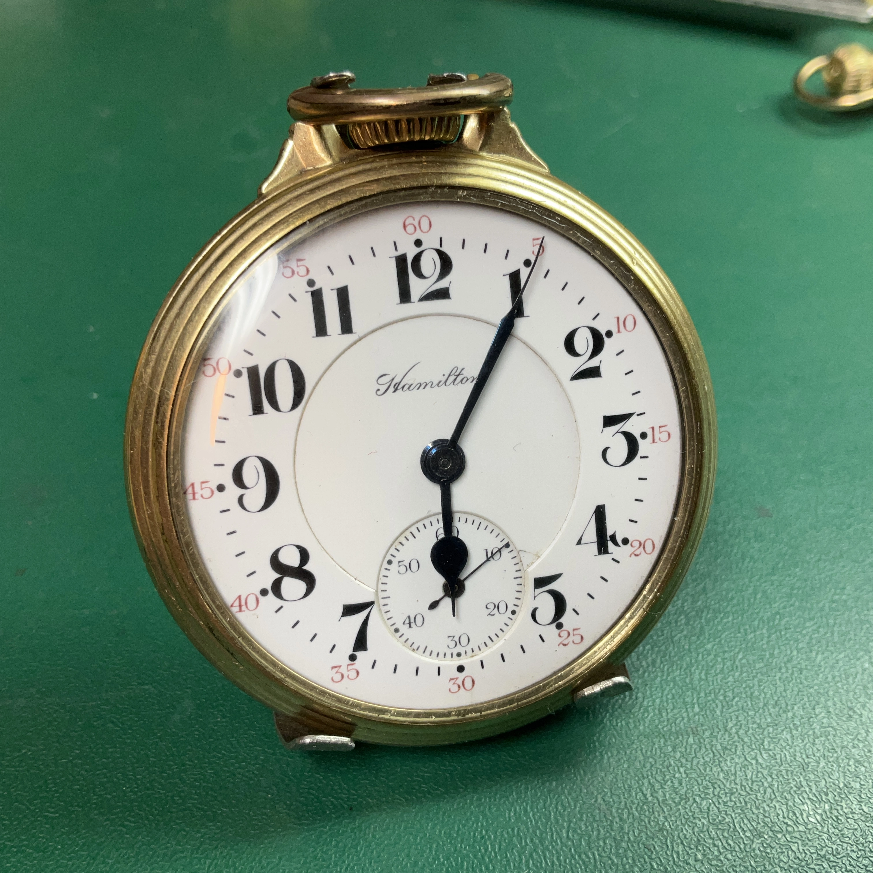

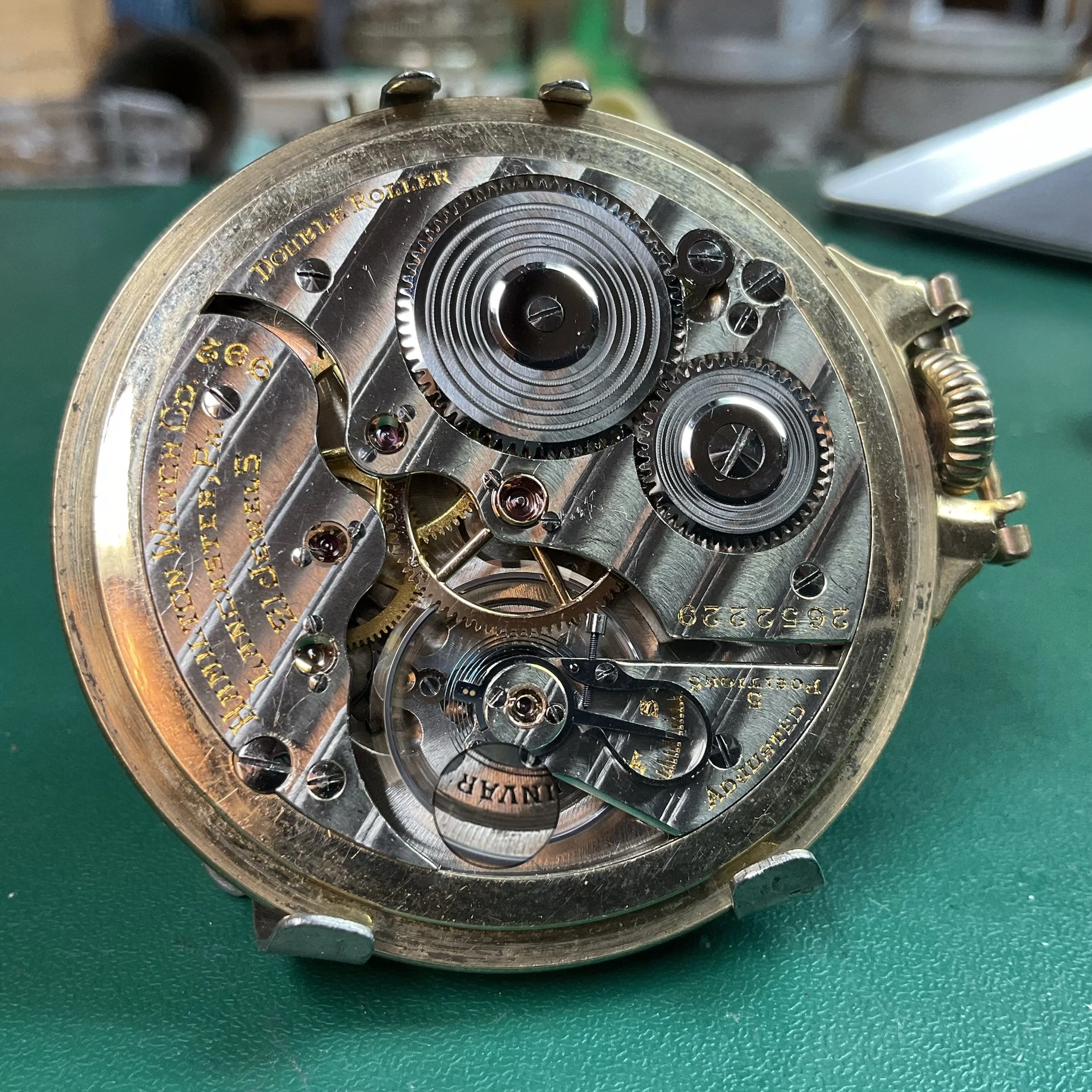

I serviced this Hamilton grade 992E (Elinvar) for a friend, today. It was his late grandfather’s railroad watch. After his grandfather retired, the watch was shelved. The present owner’s father (as a boy) was fascinated by the watch, and played with it. Result? He dropped it, and all three dial feet broke off, the dial shifted, and the long pivot of the fourth wheel (carries the seconds hand) snapped off! Well, too late, but the watch was put away securely. It sat until the present owner’s father passed away, and the watch came to the present owner (the grandson). He has worked for CPR for 22 years, and is involved in the CPR Empress class steam locomotive # 2816 program. Try to find a fourth wheel for one of these! I check with numerous watch material suppliers, and no joy! The fourth wheels are made of unobtainium! I lucked out, and found a donor watch locally. Intact fourth wheel, and a very good double sunk vitreous enamel dial. Today, I stripped it, cleaned it, fitted the new fourth wheel and dial, replaced the seconds hand, fitted a new glass watch crystal, and here it is.
The Hamilton grade 992 was a very popular 16-size railroad watch, but it was not anti-magnetic. This in an era when diesel electric locomotives were replacing steam. Circa 1931, Hamilton upgraded the 992 by replacing the bi-metallic, temperature compensating
balance wheel and blued steel hairspring with non-ferrous parts (Elinvar), resulting in the watch becoming unaffected by magnetism. The 992 became the 992E. There was a fringe benefit as well. By adding Elinvar, the watch ended up not affected by temperature change.
There are a number of ways to identify a 992E. Check for the monometallic balance wheel. Or, in the third picture, you’ll see the “loupe” focussing on the pallet cock which is engraved ELINVAR.
In 1941, Hamilton brought out the grade 992B which was a total departure at that time, and nothing is interchangeable with the 992 or 992E.

Wow, nothing interchangeable, I had always assumed that it was just an upgrade by gradual progression.
Did the latest iteration the 992b posses all the Elinvar componentry?

It is possible there would be some components, like screws for example, that would match. But nothing else is interchangeable between the 992B and the 992 and 992E. The 992B and 992E both have the mono metallic balance wheel and hairspring which renders them both immune to magnetism, and temperature variations. The 992 has the bi-metallic, (steel and brass) balance wheel and blued steel hairspring. The 992 IS affected by temperature variation and magnetism.
Early Hamilton 992Es (like the subject watch) had an earlier Elinvar alloy hairspring which had problems. The alloy was soft and easily distorted. Elinvar alloy is white in colour. Later alloys were more successful. Hamilton had a lot of backlash from watchmakers and dealers about the colourless Elinvar hairsprings. Hairsprings in Hamiltons (steel ones), had always been BLUE. The result is that Hamilton DYED the Elinvar hairsprings BLUE! Notice the hairspring in the subject watch. It is BLUE! Yet it is an Elinvar (or Elinvar Extra) hairspring that has been dyed blue! When the later 992B was introduced, Hamilton built them with the white Elinvar Extra (white alloy) hairsprings in their natural white colour.

The 992 and 992E are both Model 2s, the 992B is a Model 5.
Model 2
Model 5
I stole the pictures from the PWDB.

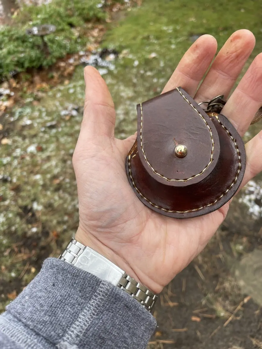

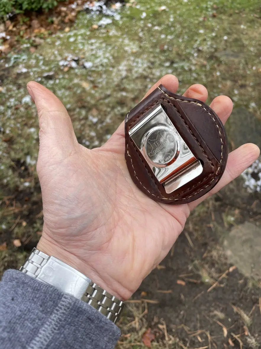

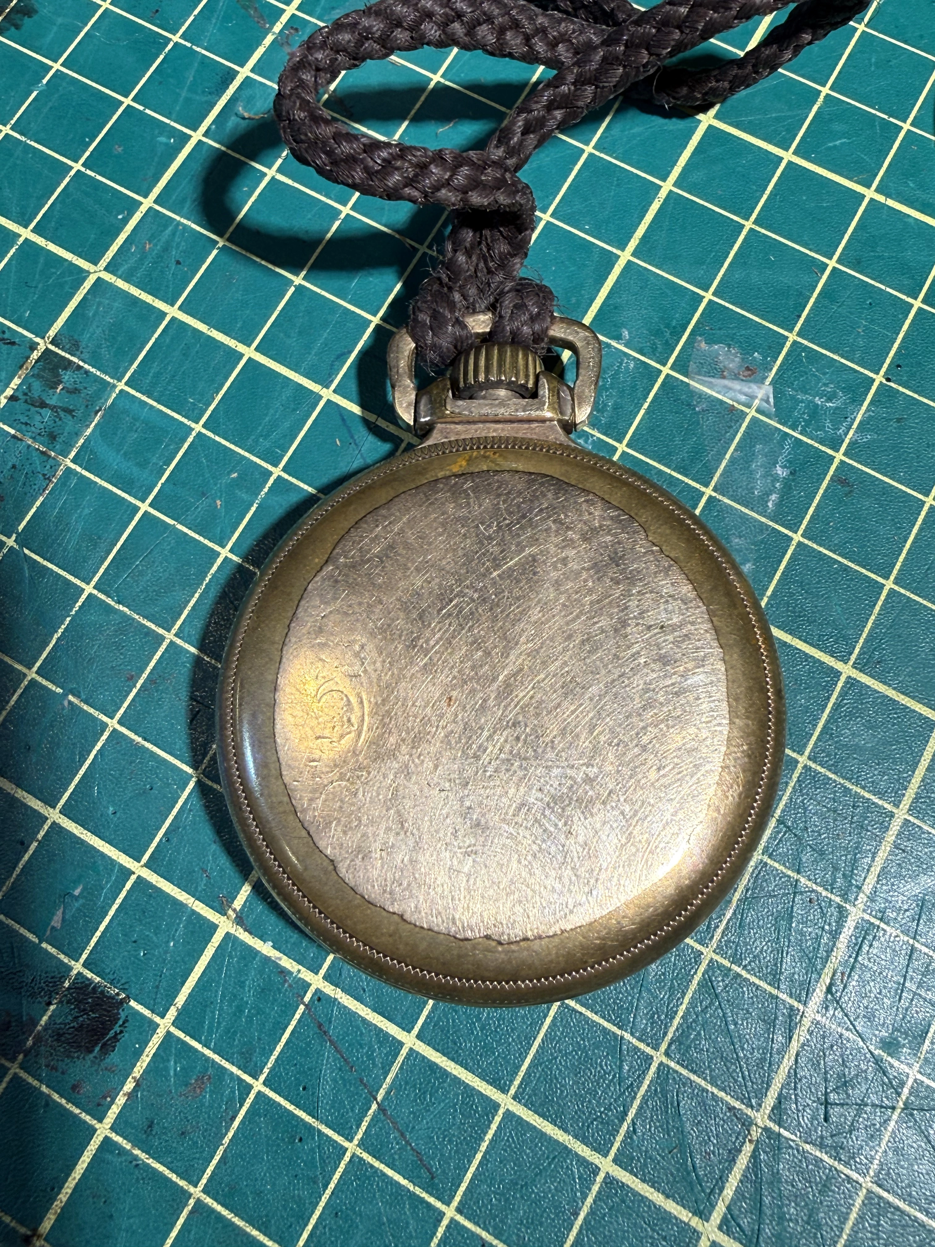

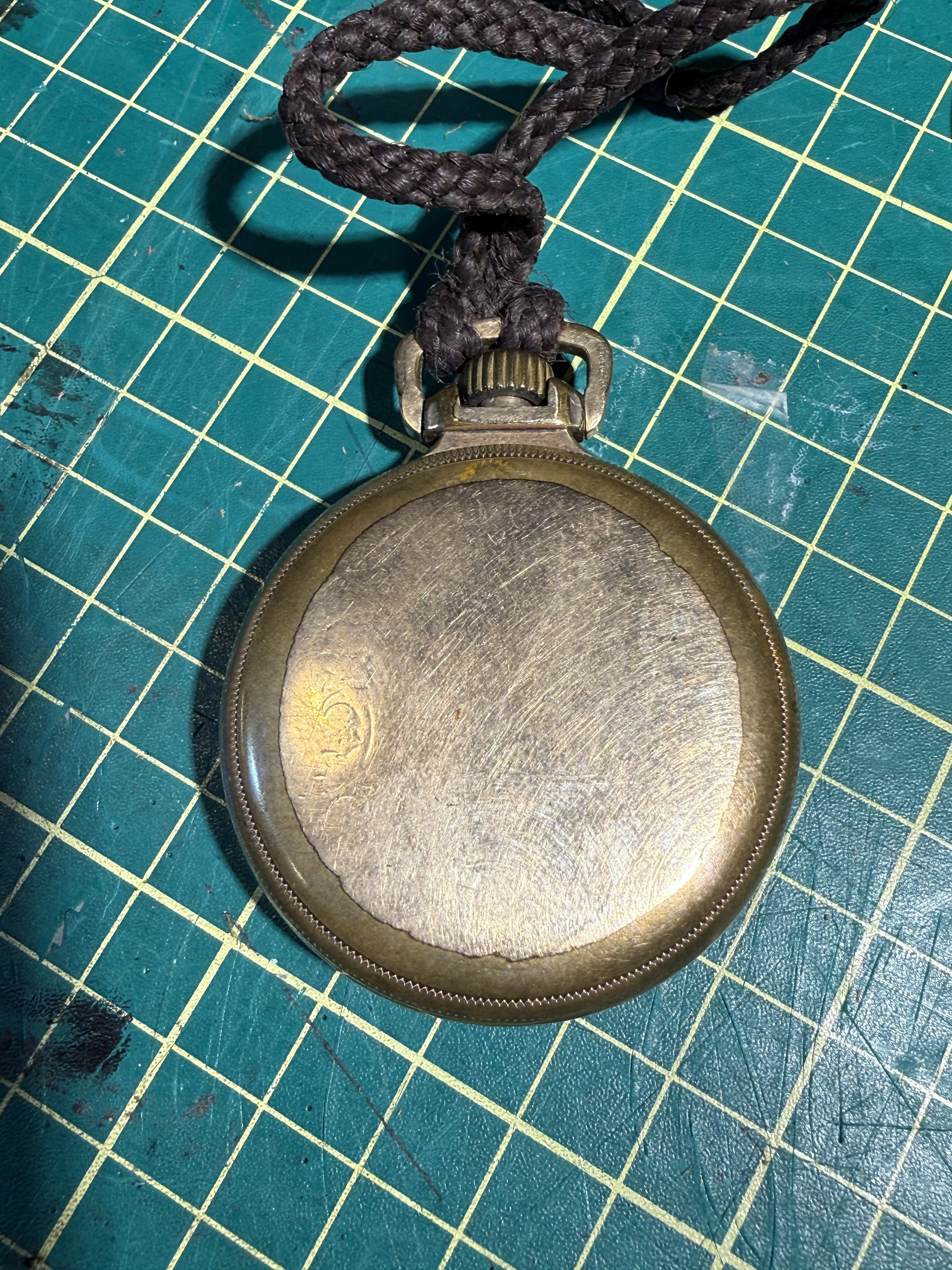

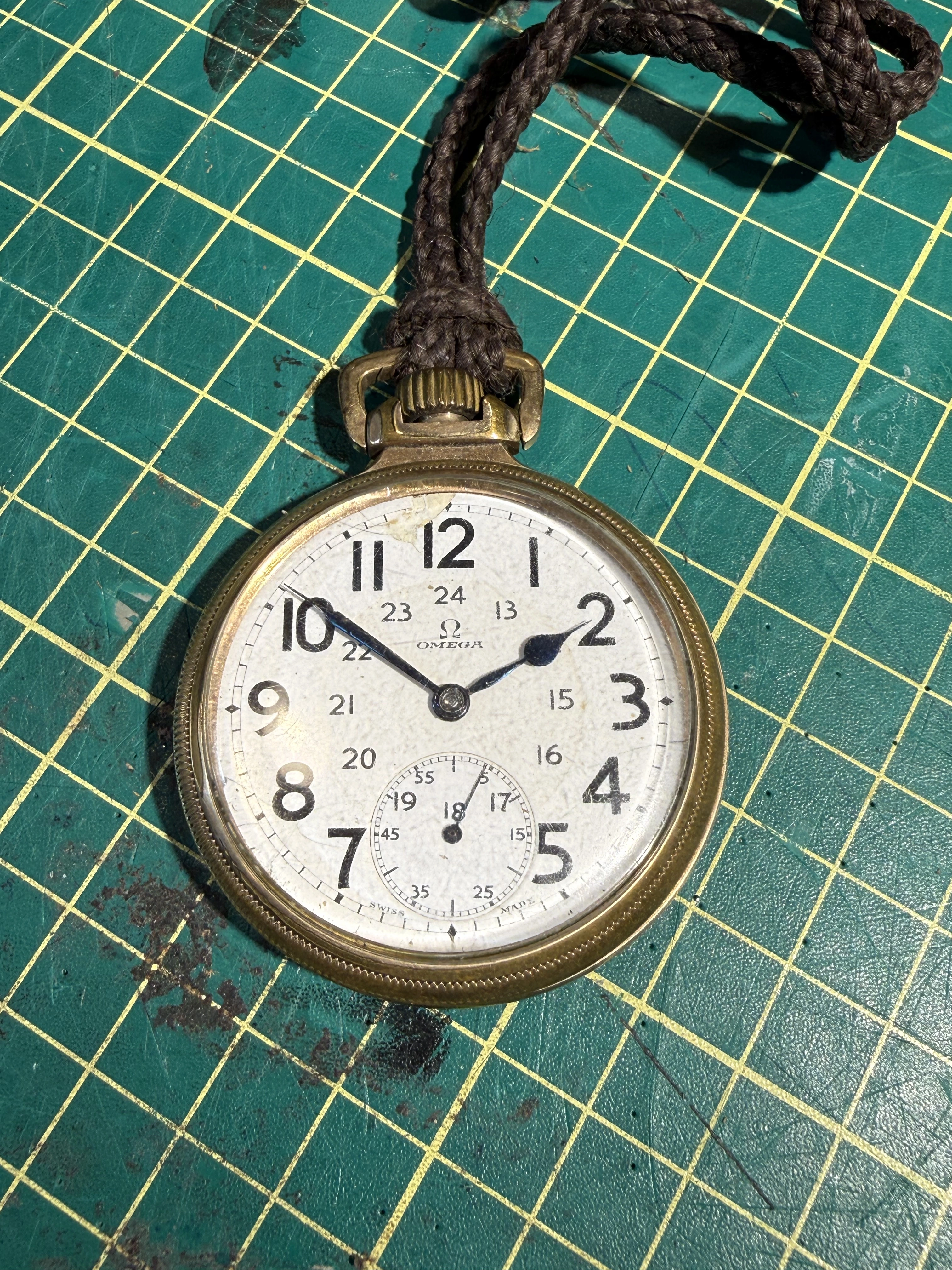

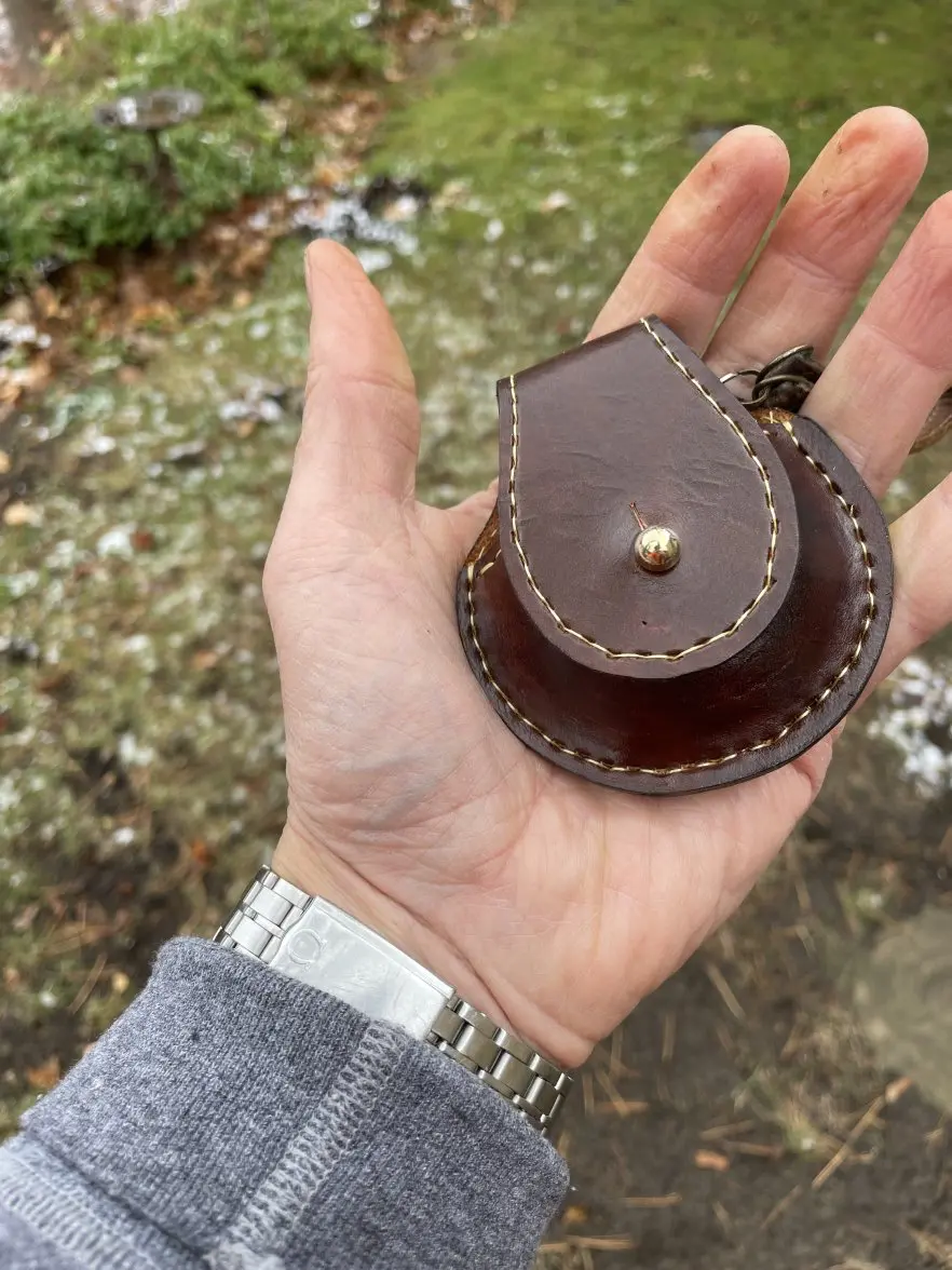

A guy came to the shop yesterday with his grandfather’s watch.
I felt comfortable asking to take a couple photos, but did not open it up.
He left with a belt pouch.
By the amount of brass showing, this had been a well loved watch. How hard did you try to sell him a leather lanyard?
3,485
35,539

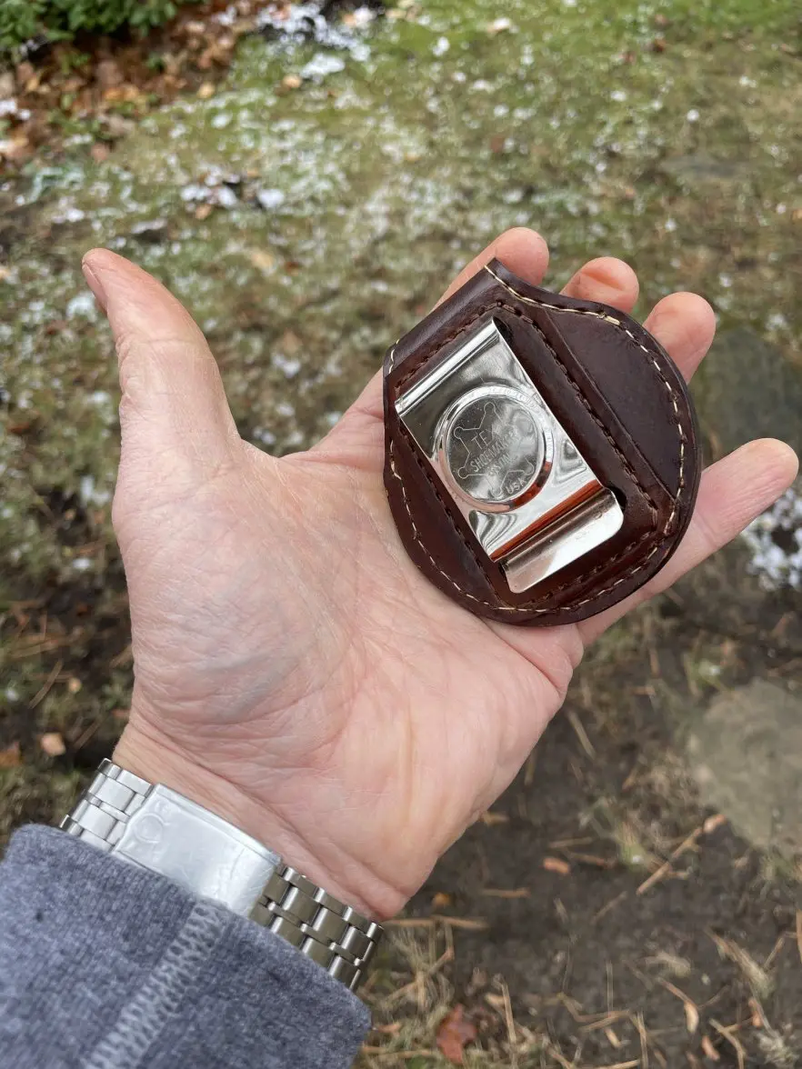

He was not interested in a chain or lanyard but when he saw my belt pouch he clipped it on and never took it off.
serial on subject 992E is from 1940, making it very late....992B were being promoted
Hi Steve is the pouch you sold to him leather that attaches to a belt or a pouch worn in the pocket attached to the belt with a lanyard? This Omega is either 16 size or 18 size are your pouches a relatively standard size accommodating either of these watch sizes?

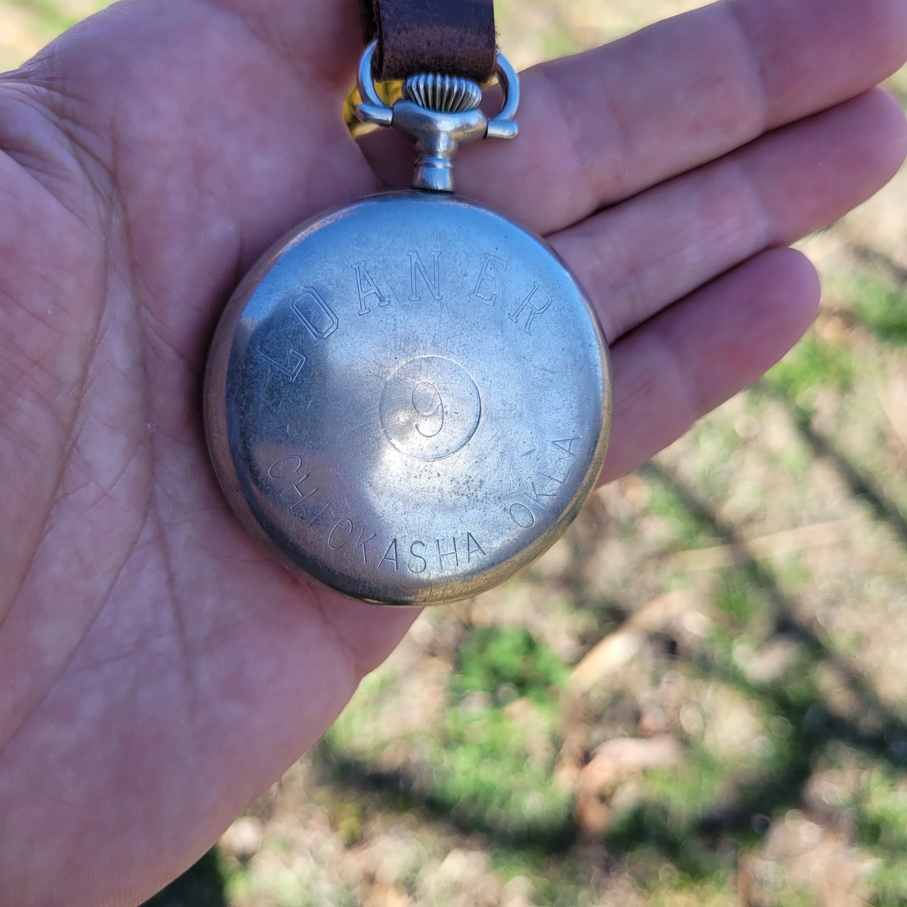

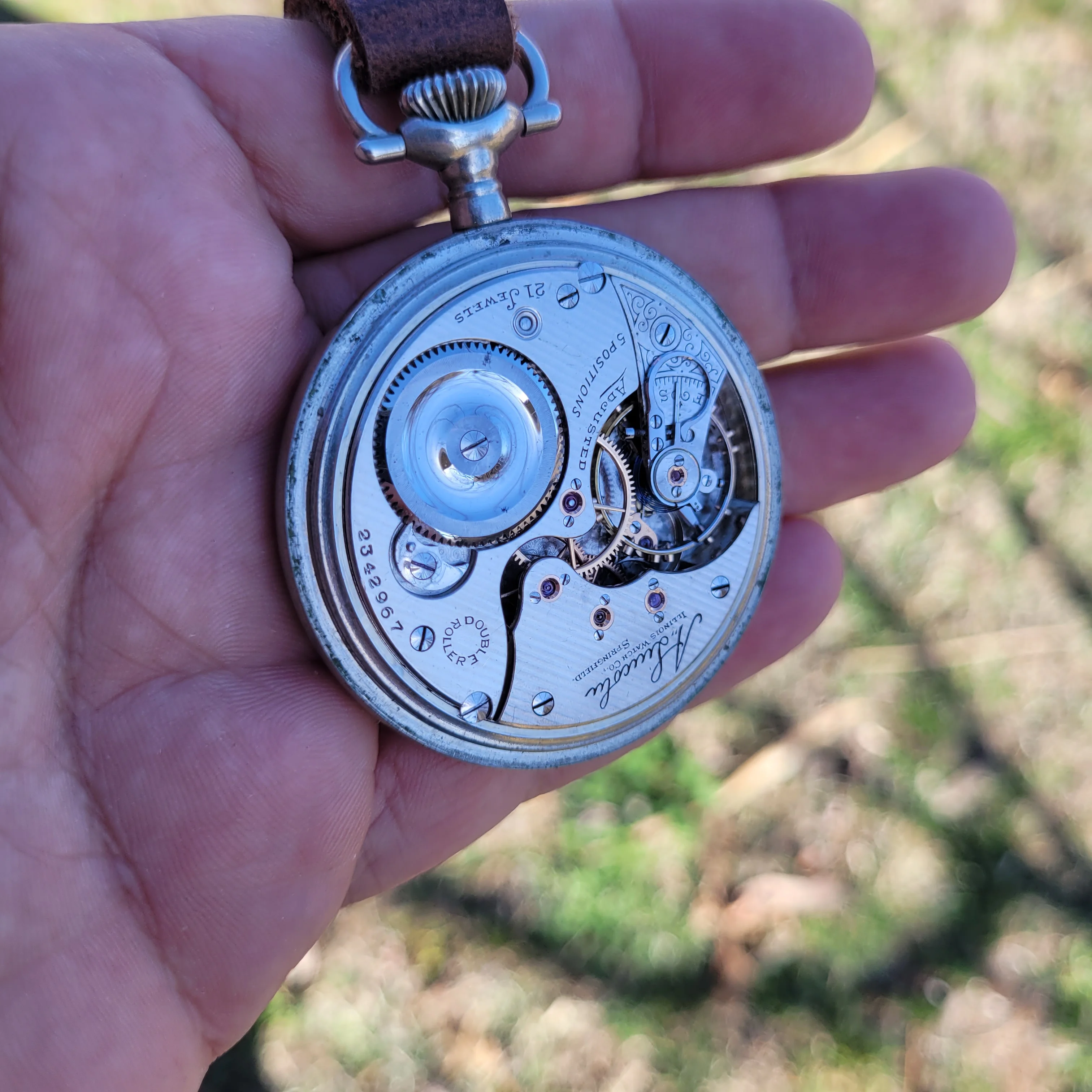

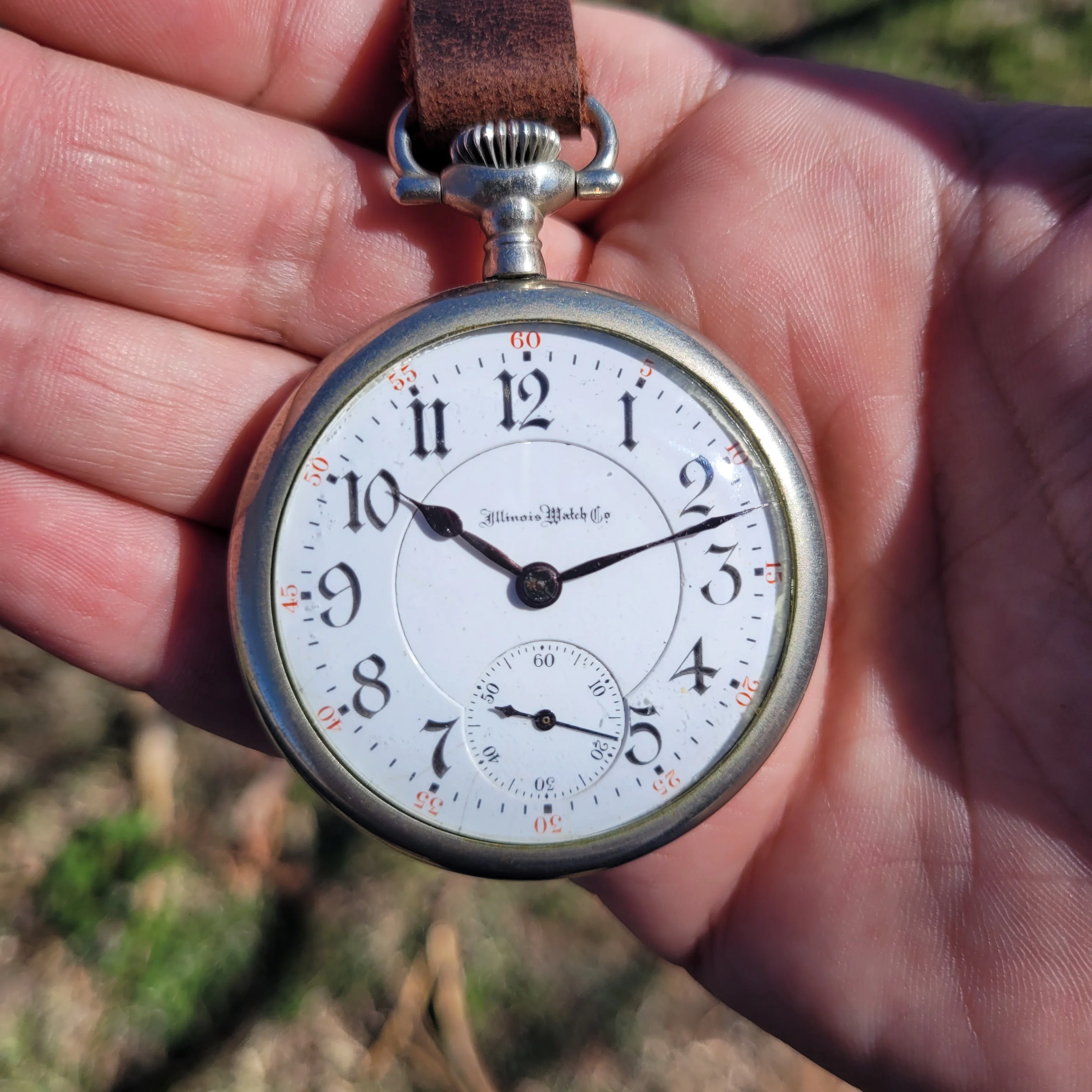

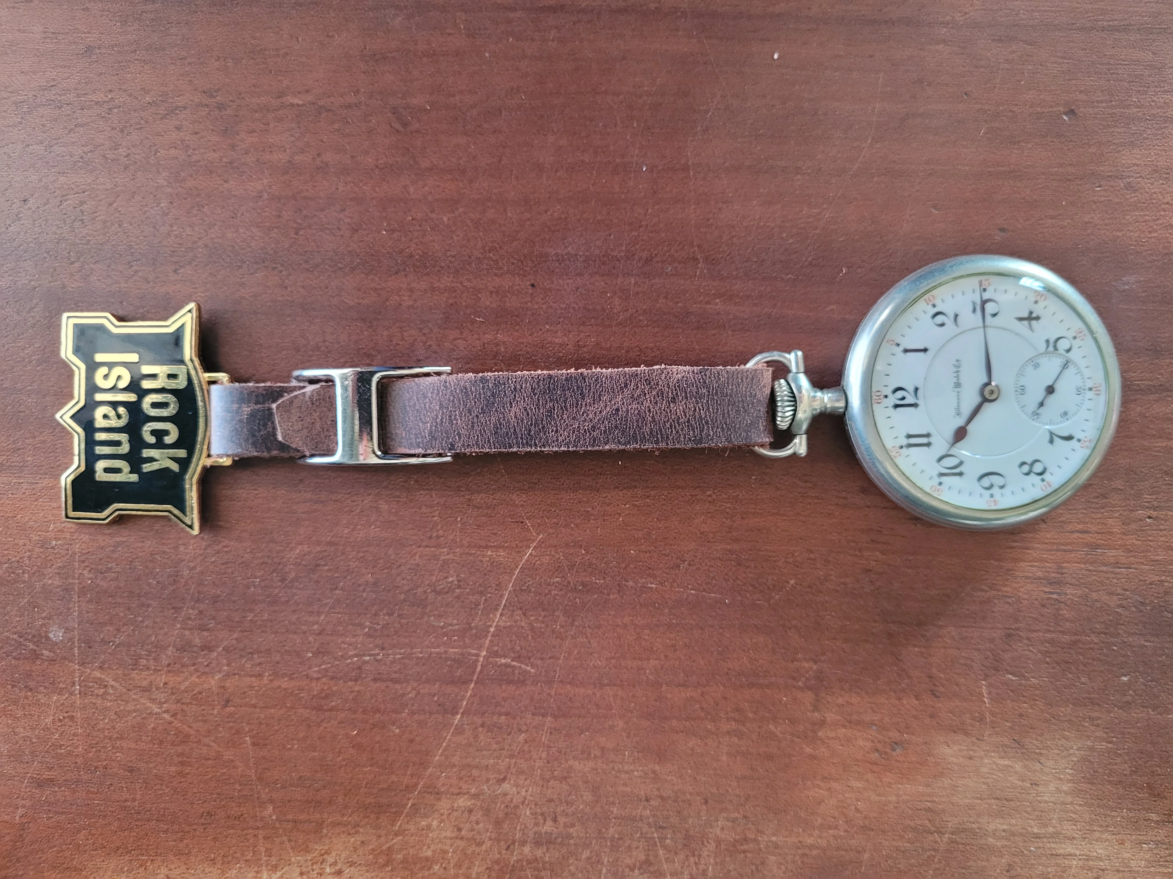

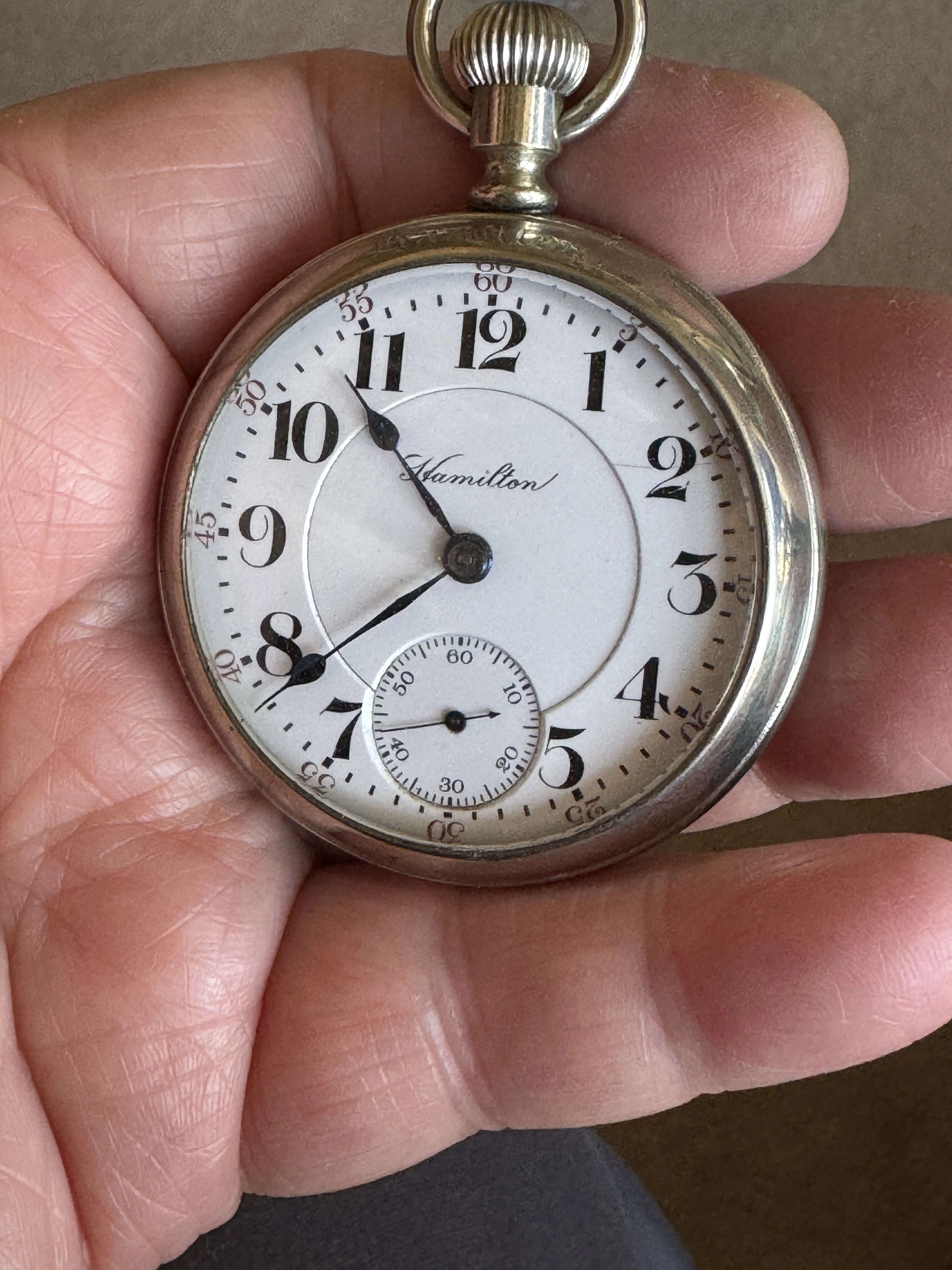

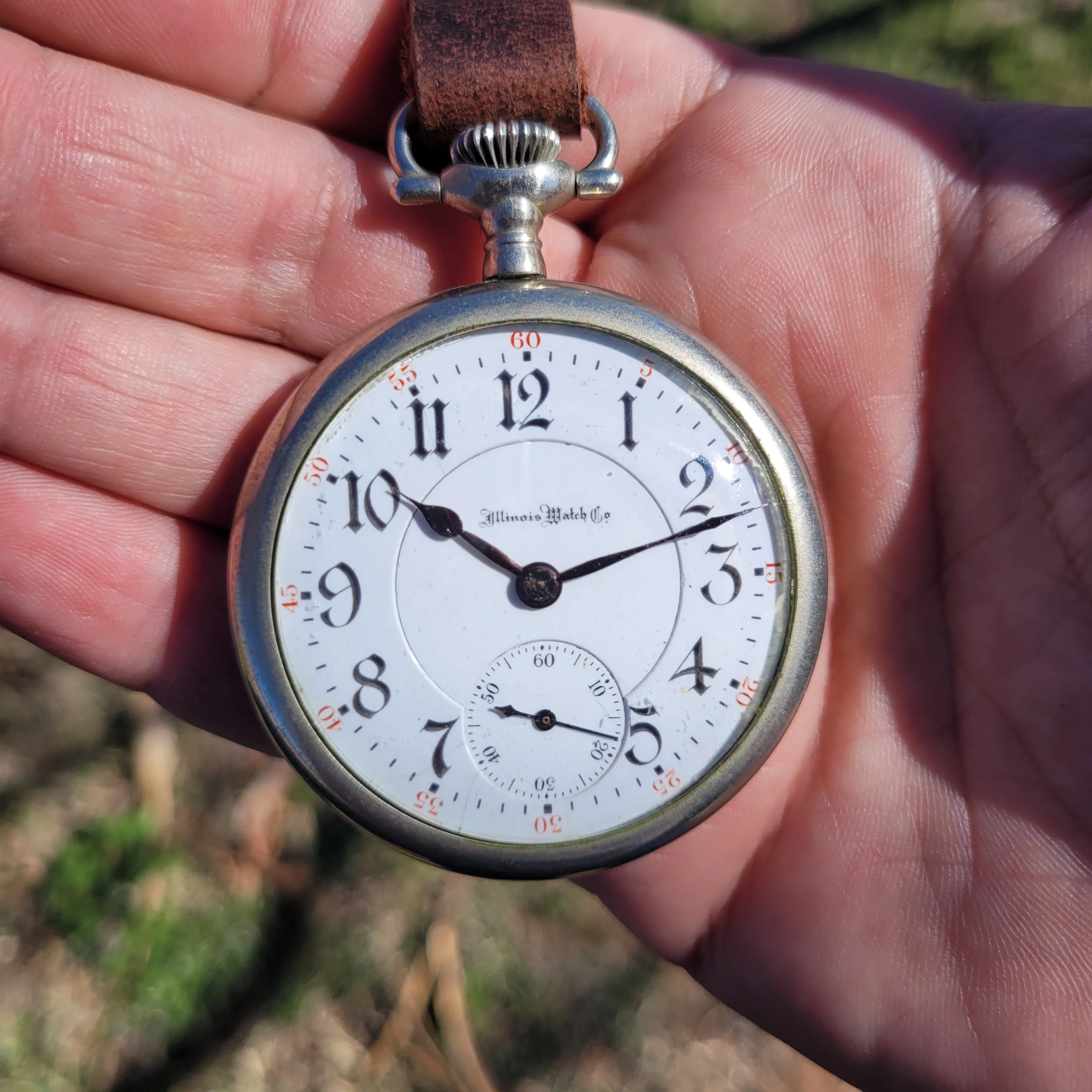

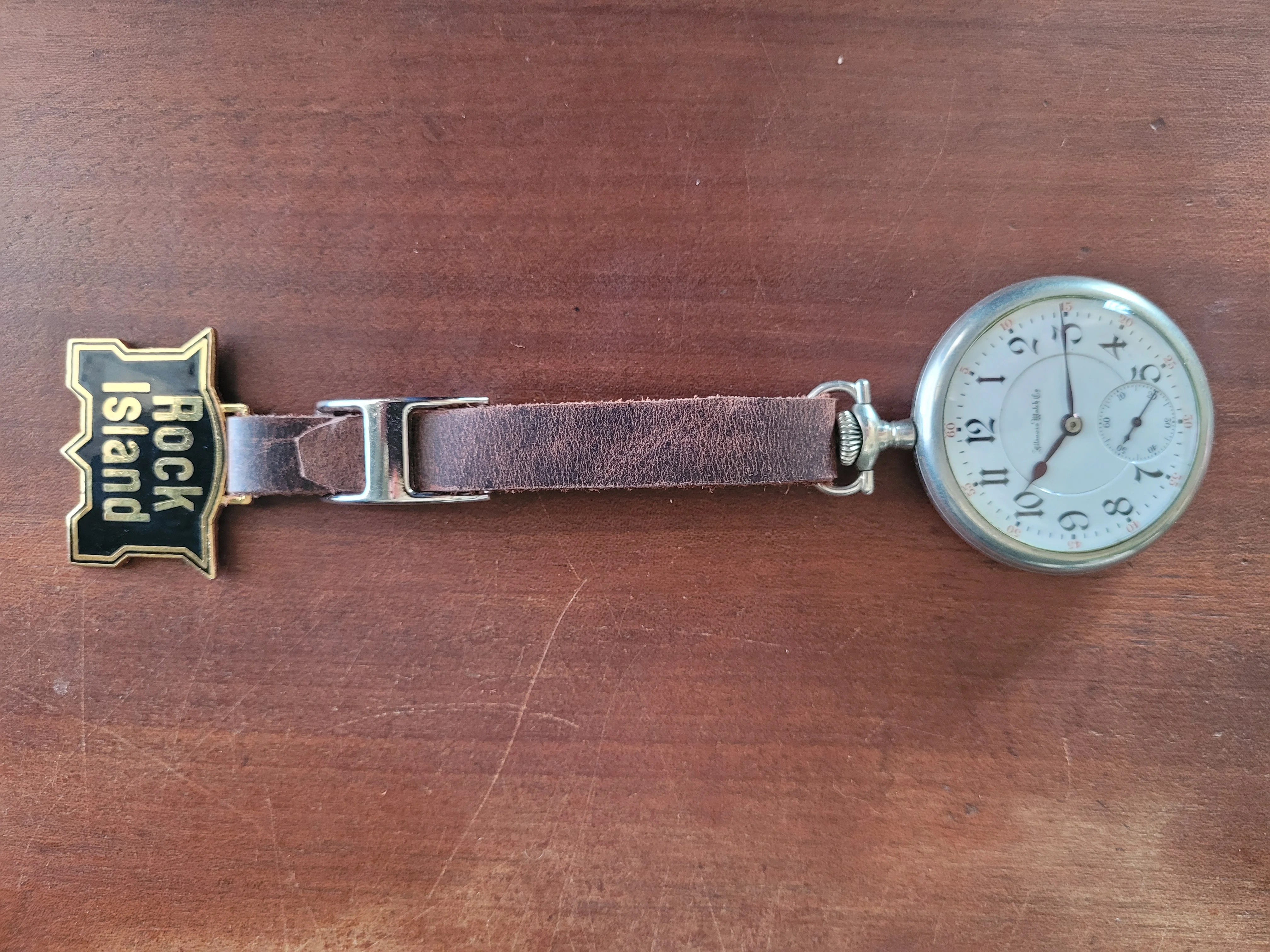

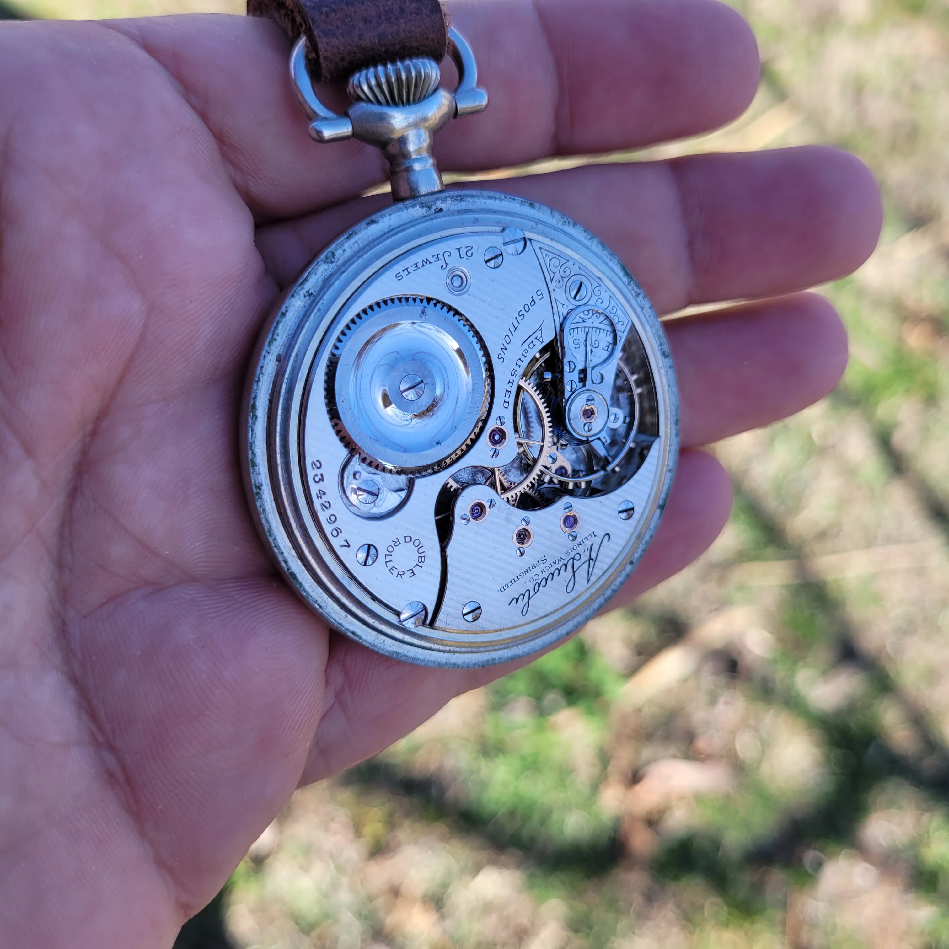

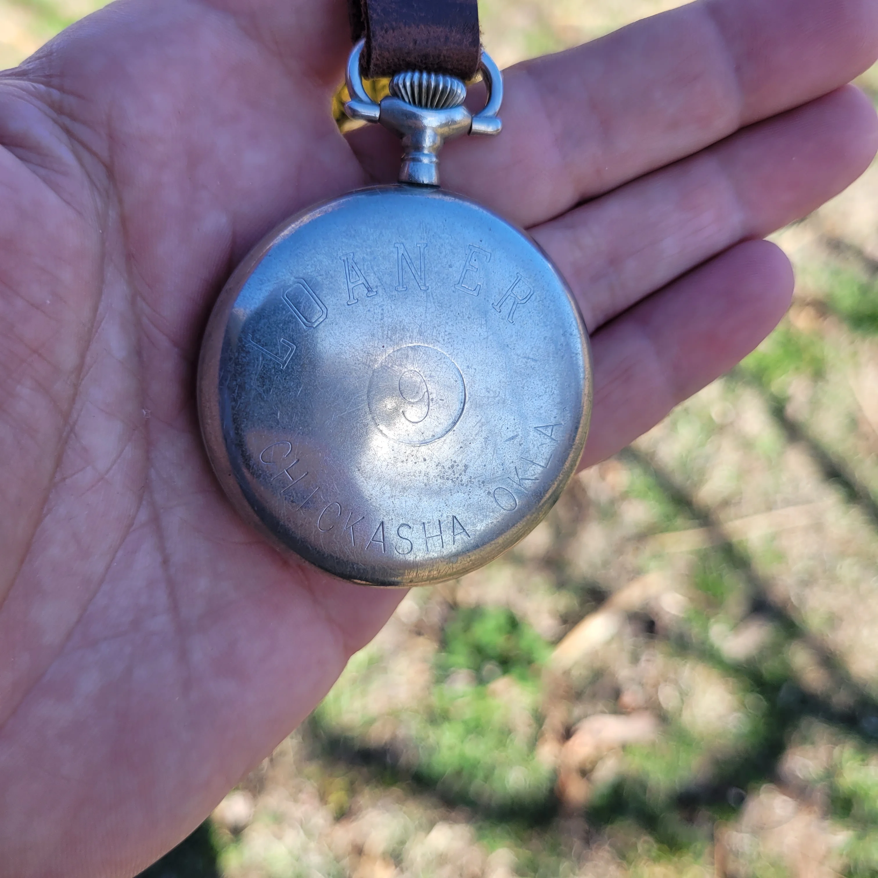

I am wearing my A. Lincoln grade Illinois, which was a loaner watch at the Chickasha Rock Island depot, not far from where I live. While perusing Ebay the other day I found this Rock Island fob, looks like it was made in the 70s or 80s, and I picked it up fairly cheap. It didn't have a strap, so I made a strap and utilized a Conway buckle to secure it to itself.
I re-read my post. My wording was awkward. I didn’t check the production date of the subject watch. I stated, “early 992Es (like this one, had (etc. etc.)”. Sort of sounded like I was calling the subject watch, “early”. The earliest 992Es had softer Elinvar hairsprings. The subject watch (from circa 1940) might have had the later Elinvar Extra, improved hairspring.
Nice example whatever the production date.
The top-notch for the grade 992 after a 40 year run, Very successful!

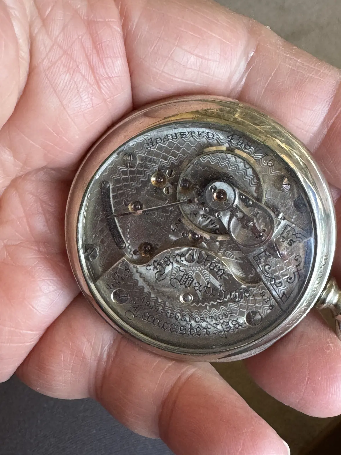

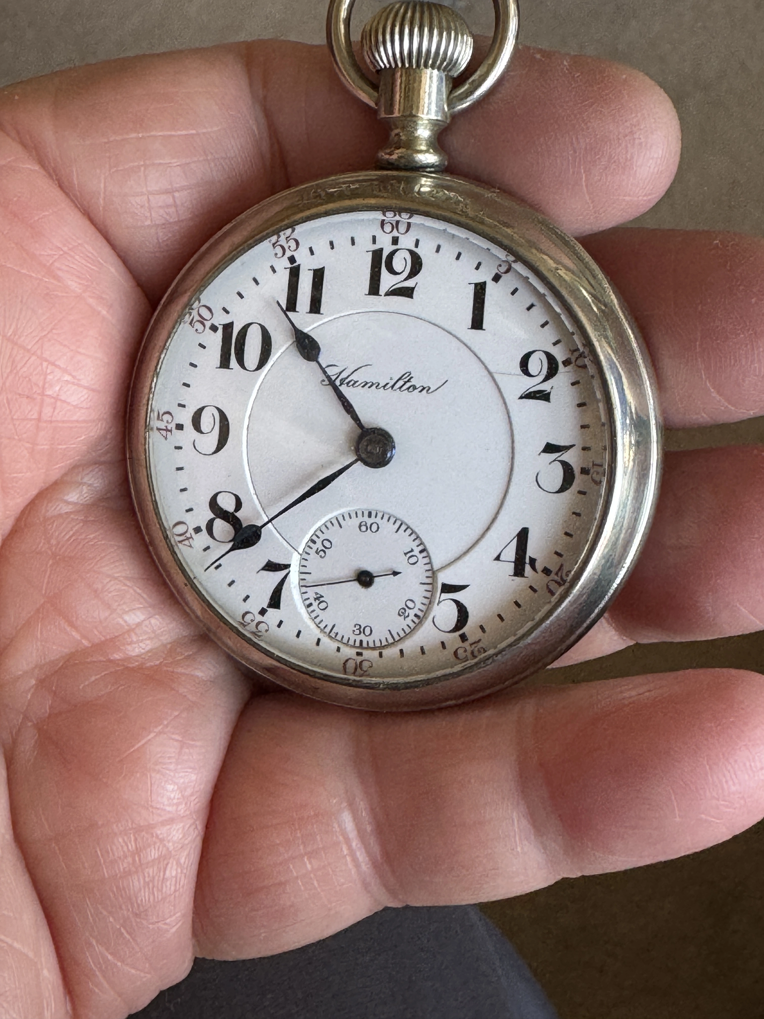

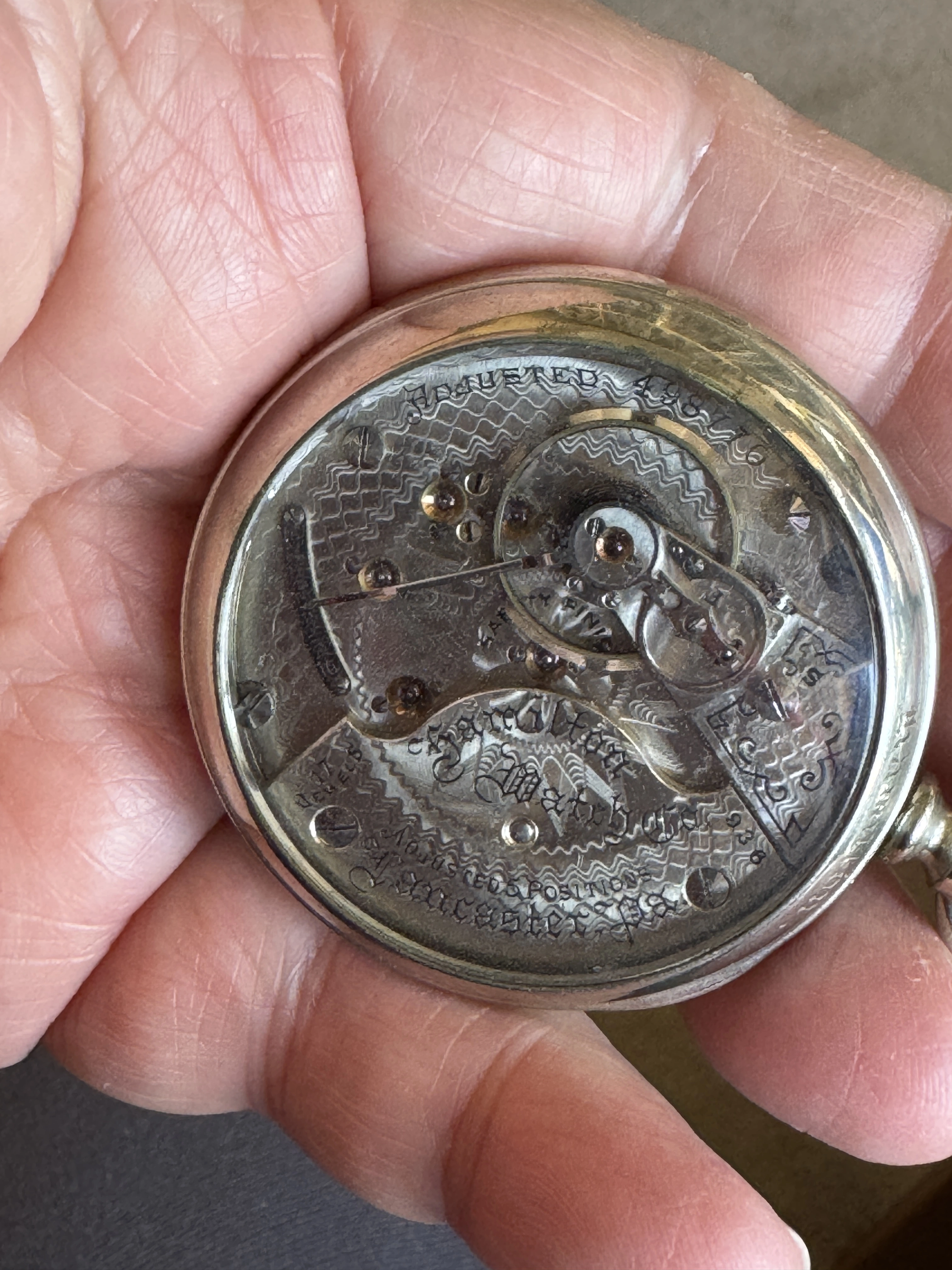

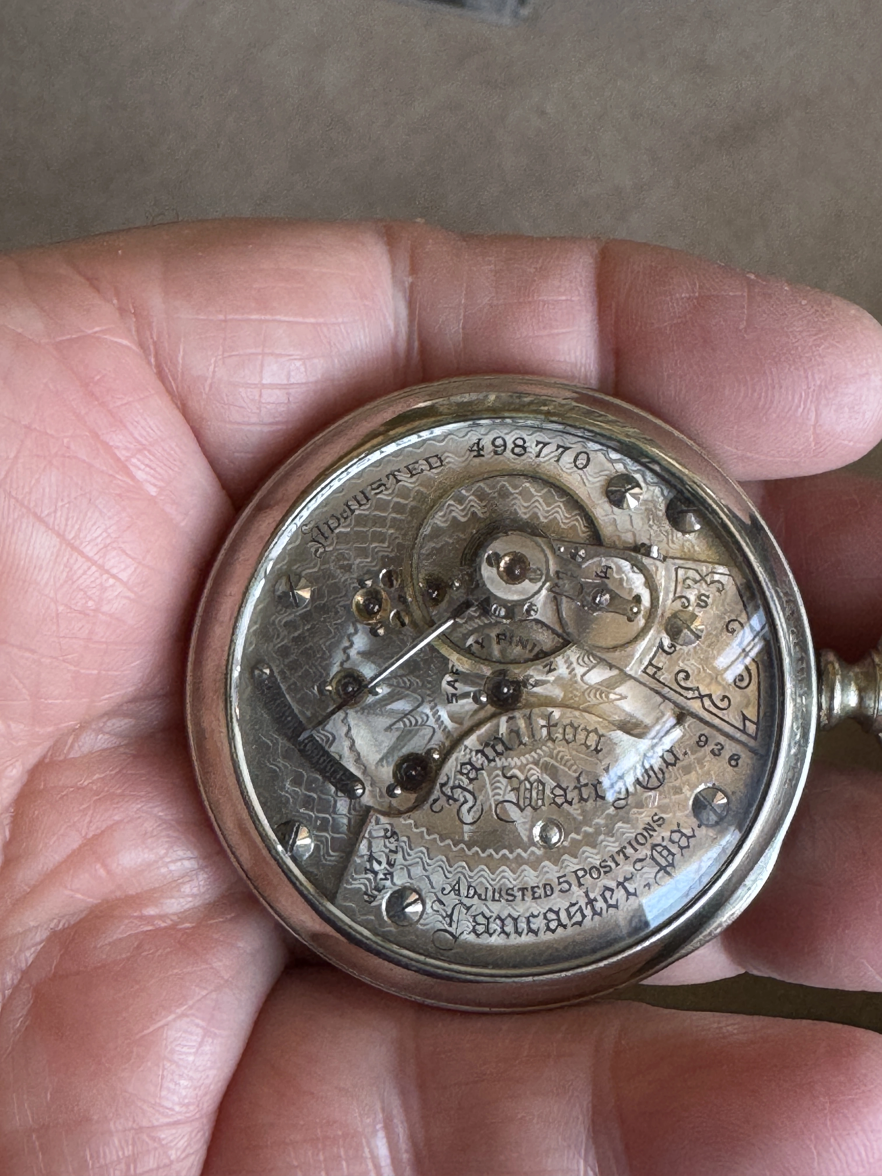

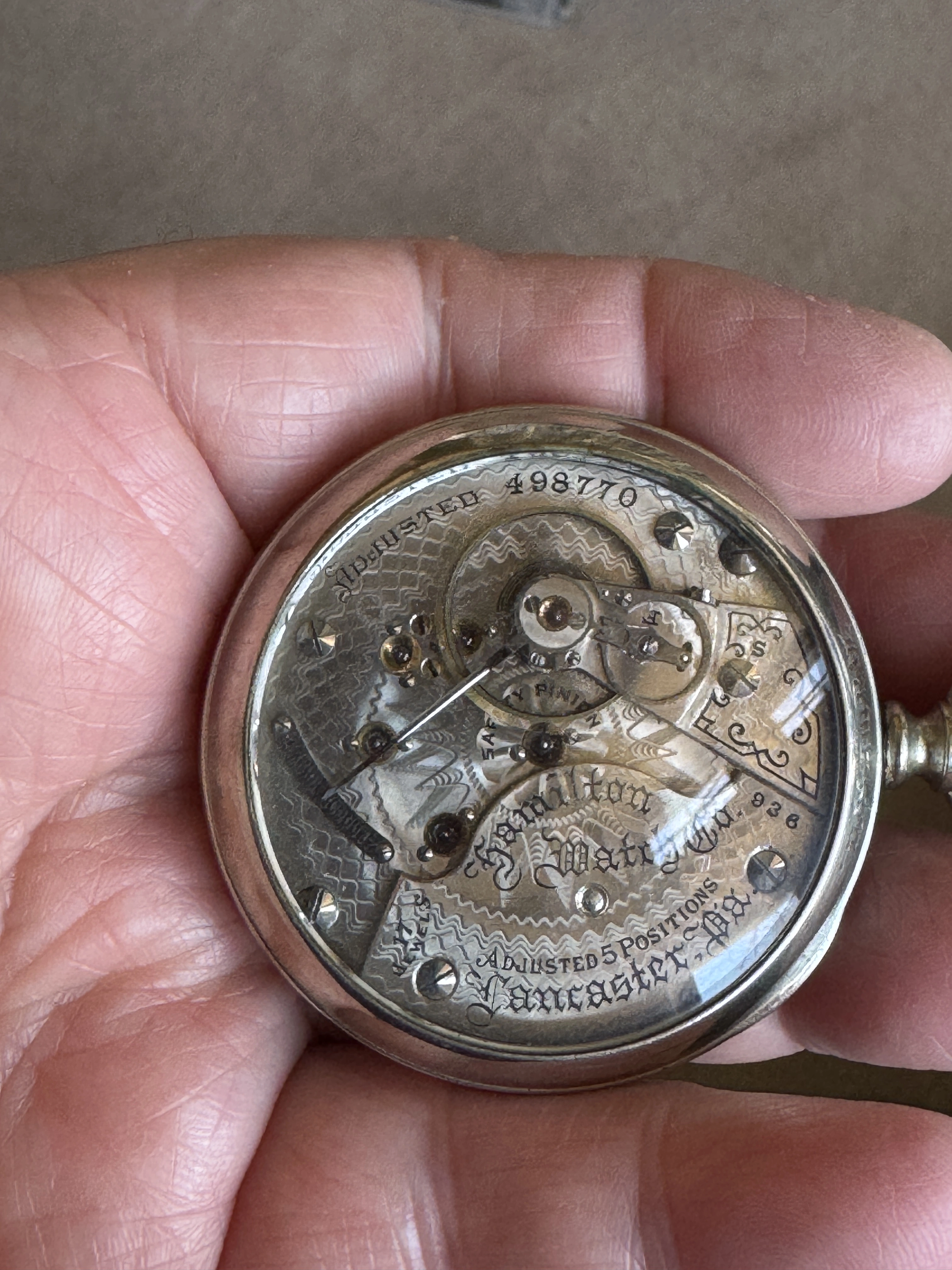

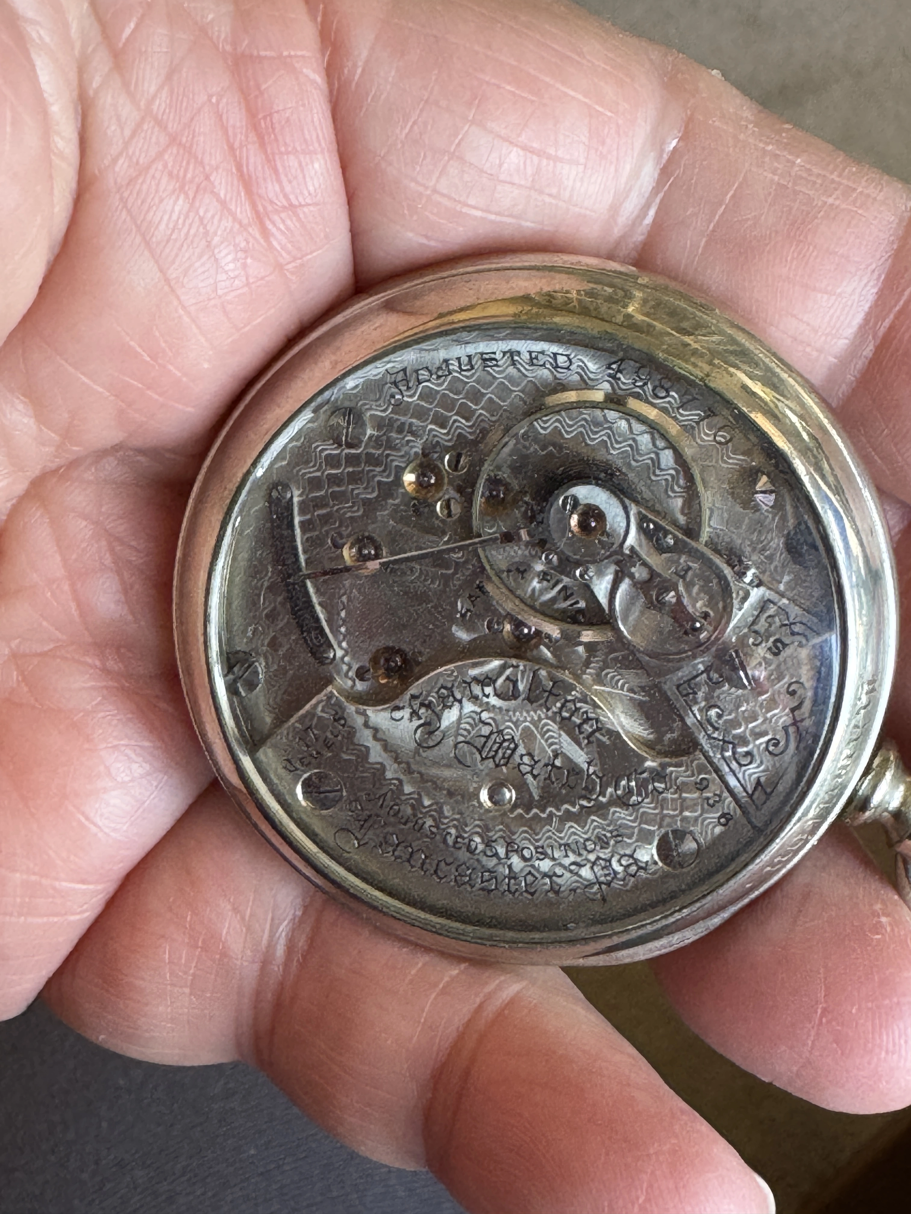

Another beautiful damaskeening on a 18s RR grade Hamilton watch.
Early (1906-7) example grade 936 with grade and “Adjusted 5 Positions” markings.
I’ve also read these marked bridges were offered as an exchange if certain lines did not grandfather them into the new requirements.

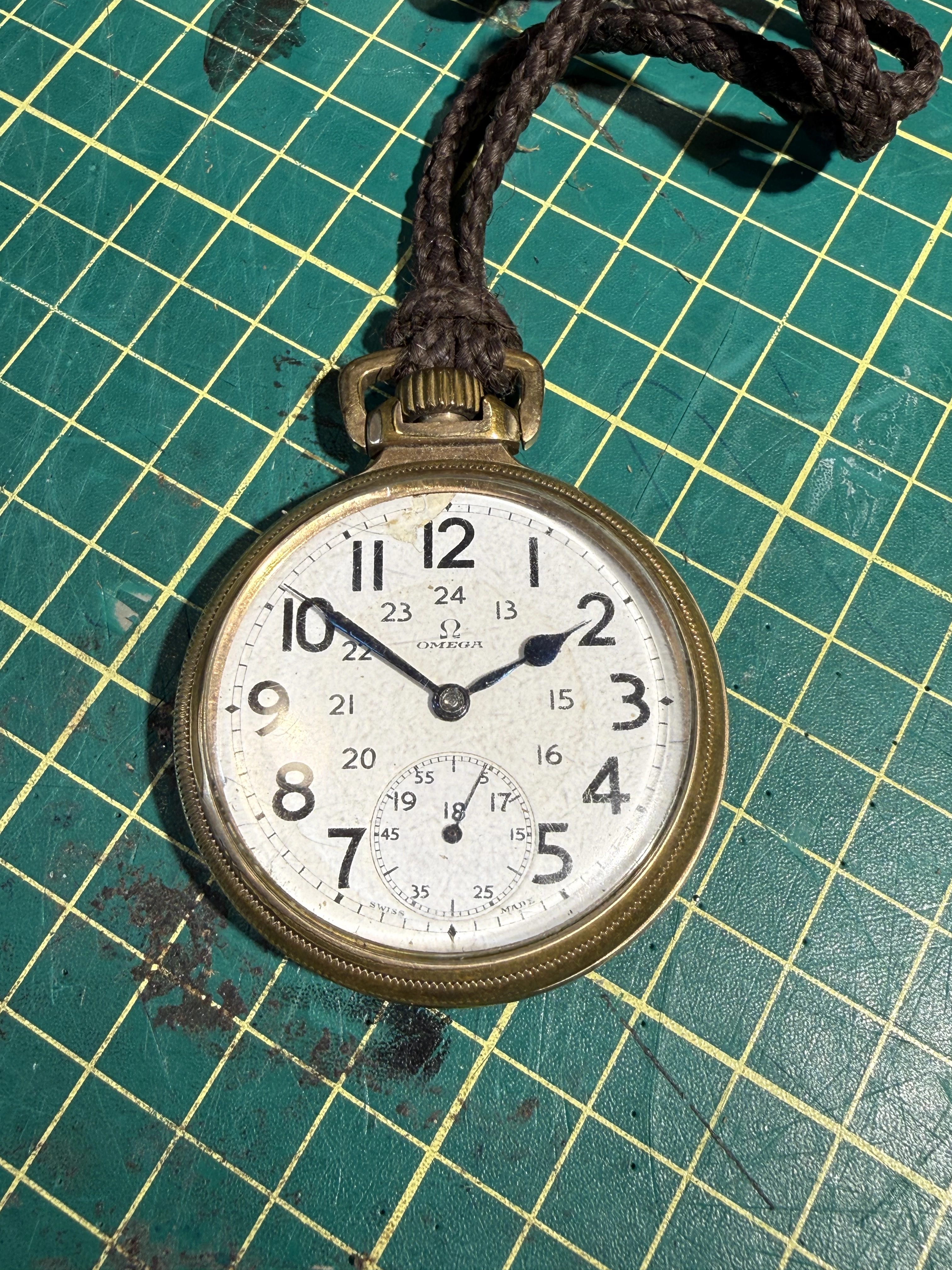

24 Hour Canadian dial markings, chances are it was a high grade intended for RR use PW. Shame you could get the inside goodness captured in a photo, so I guess we will never know lol.

Hi Steve I just saw your picture of the Tex Shoemaker watch pouch. Very nice. I will have to try and find one as not happy with what Im finding on Amazon.ca, Walmart etc around here..
