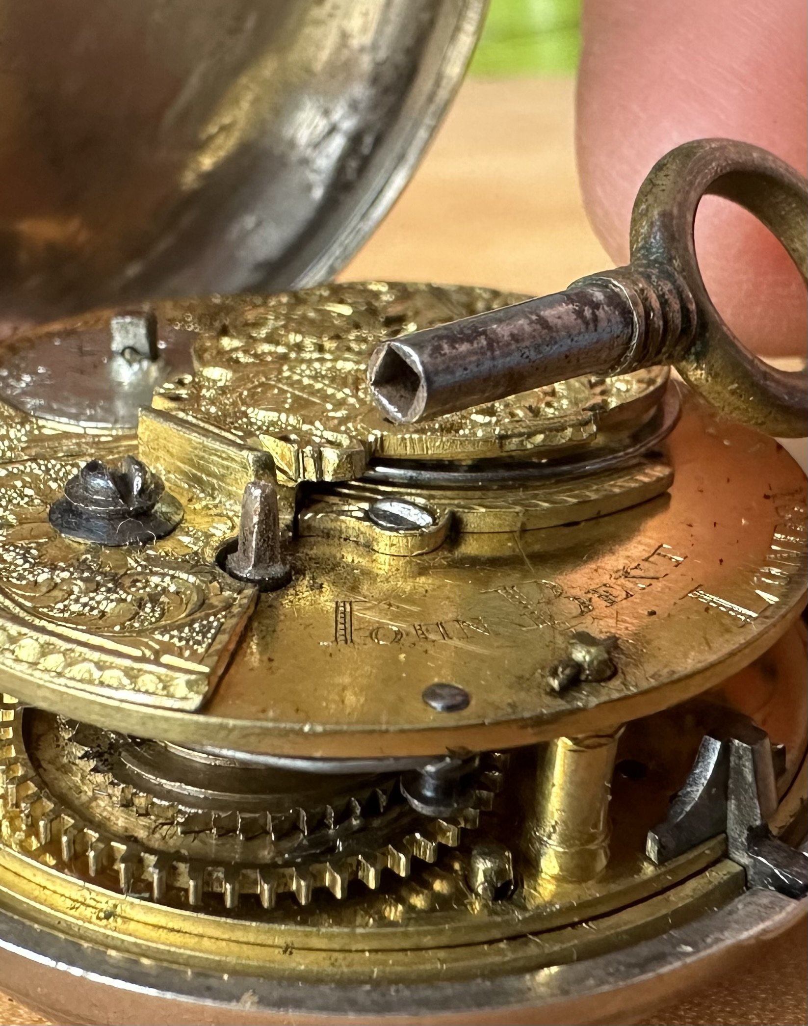

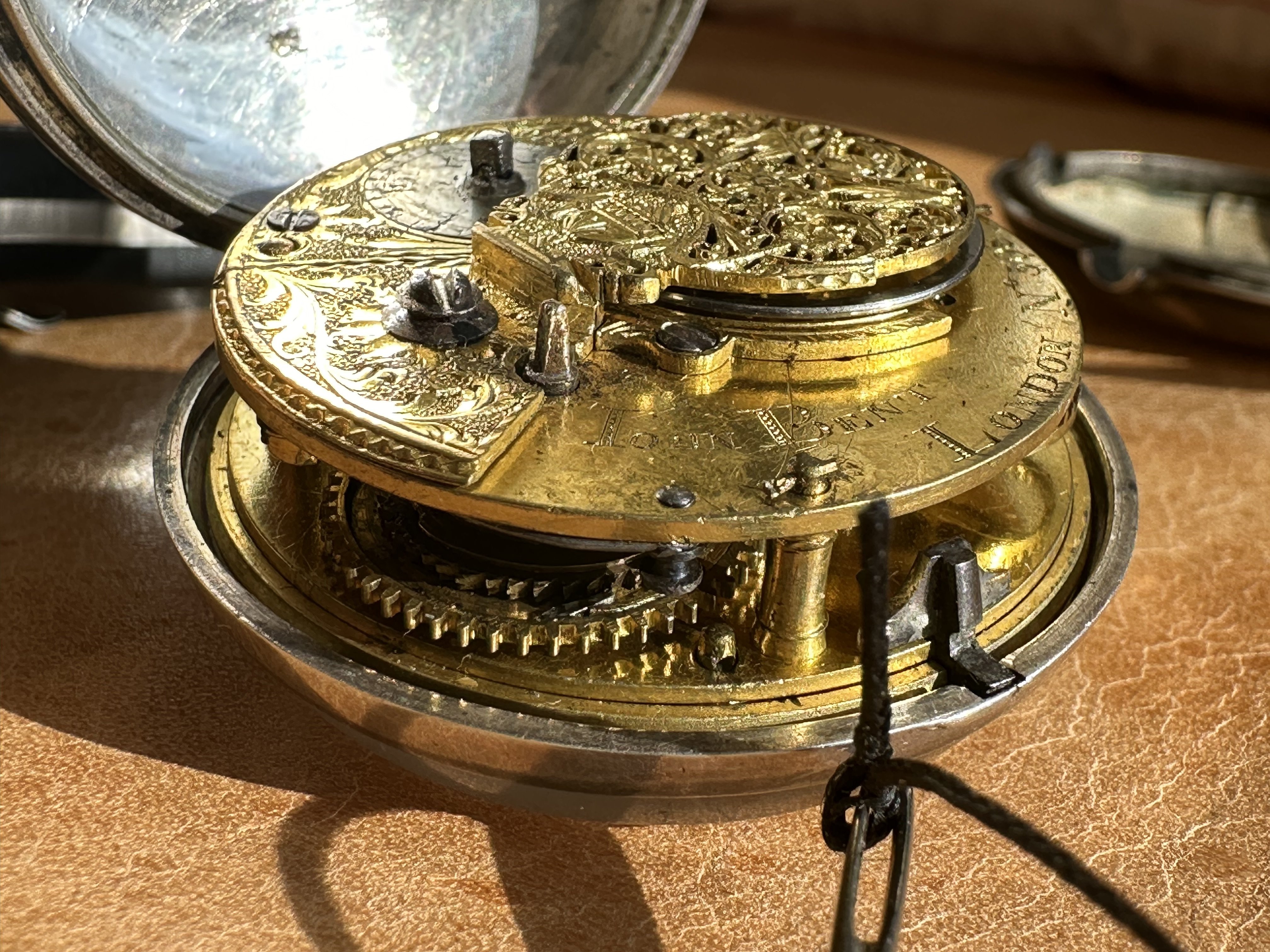

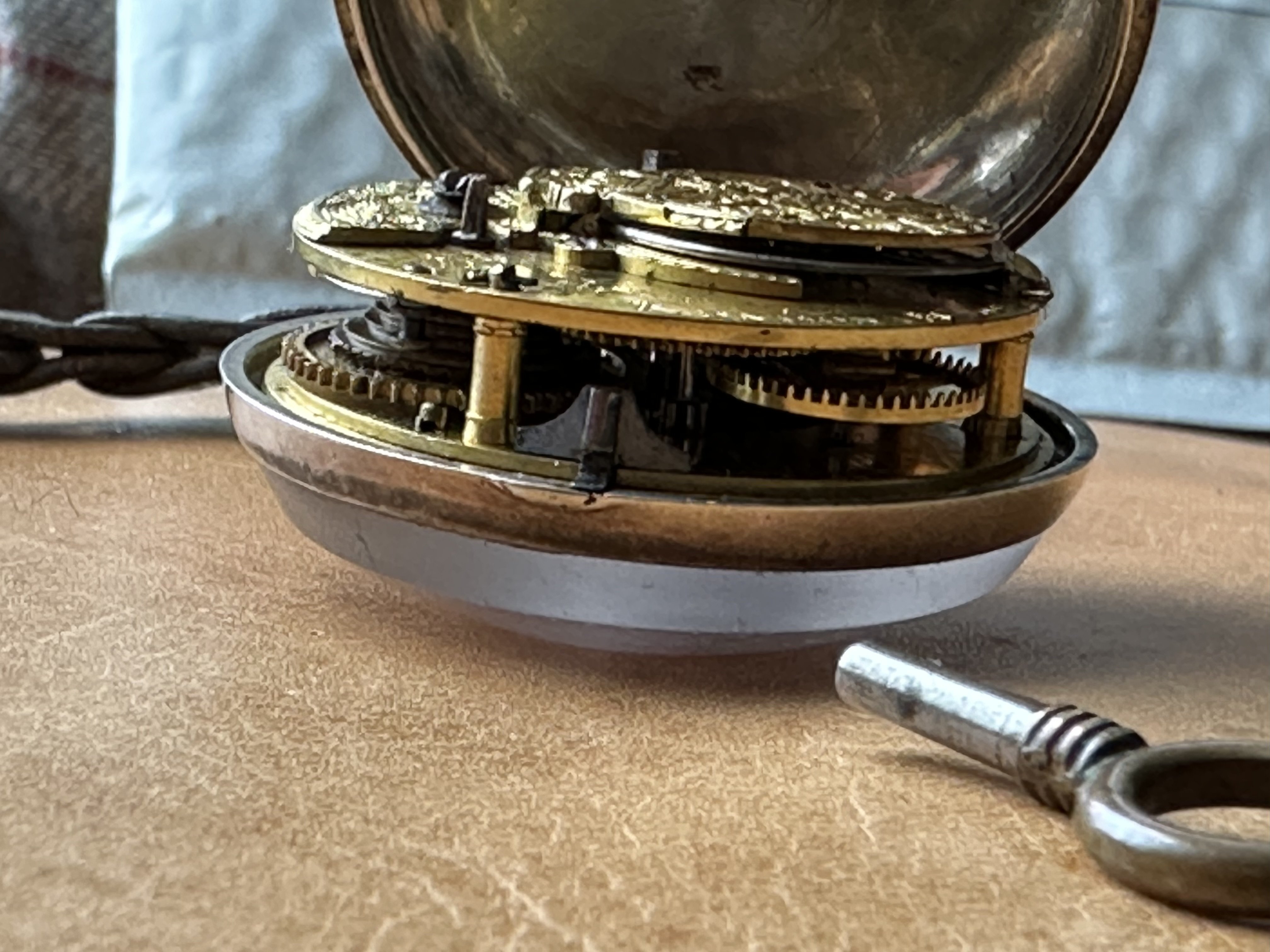

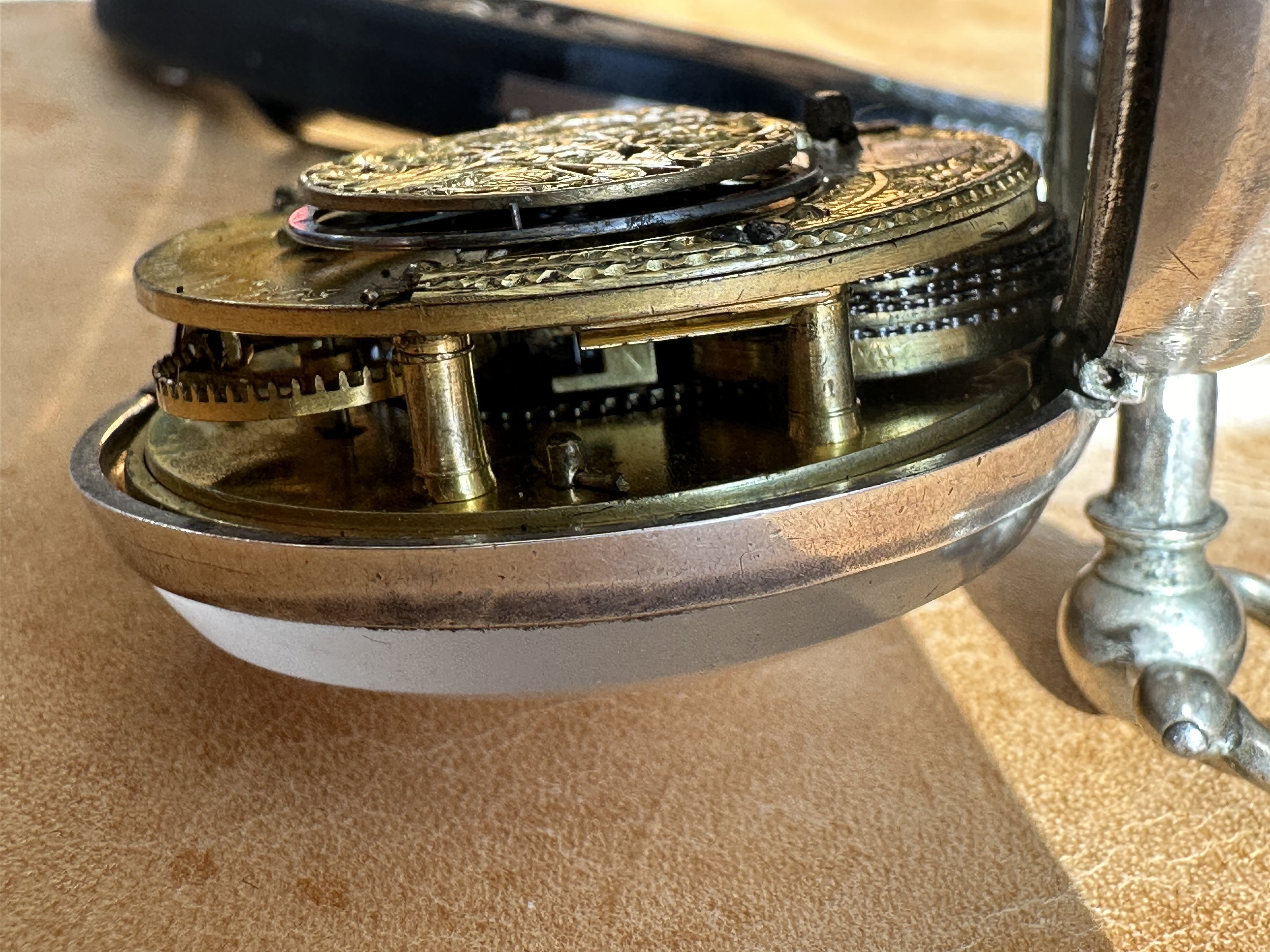

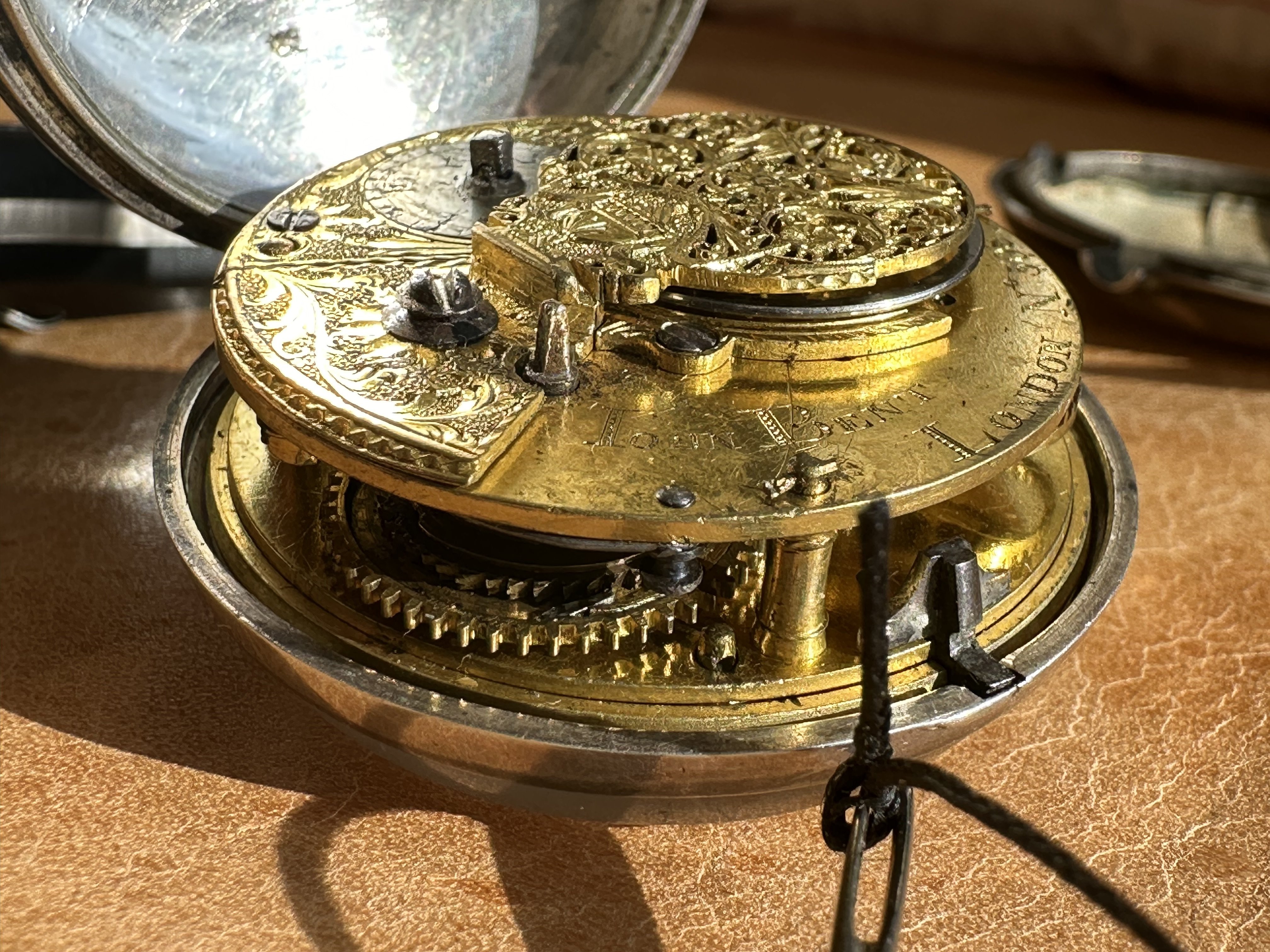

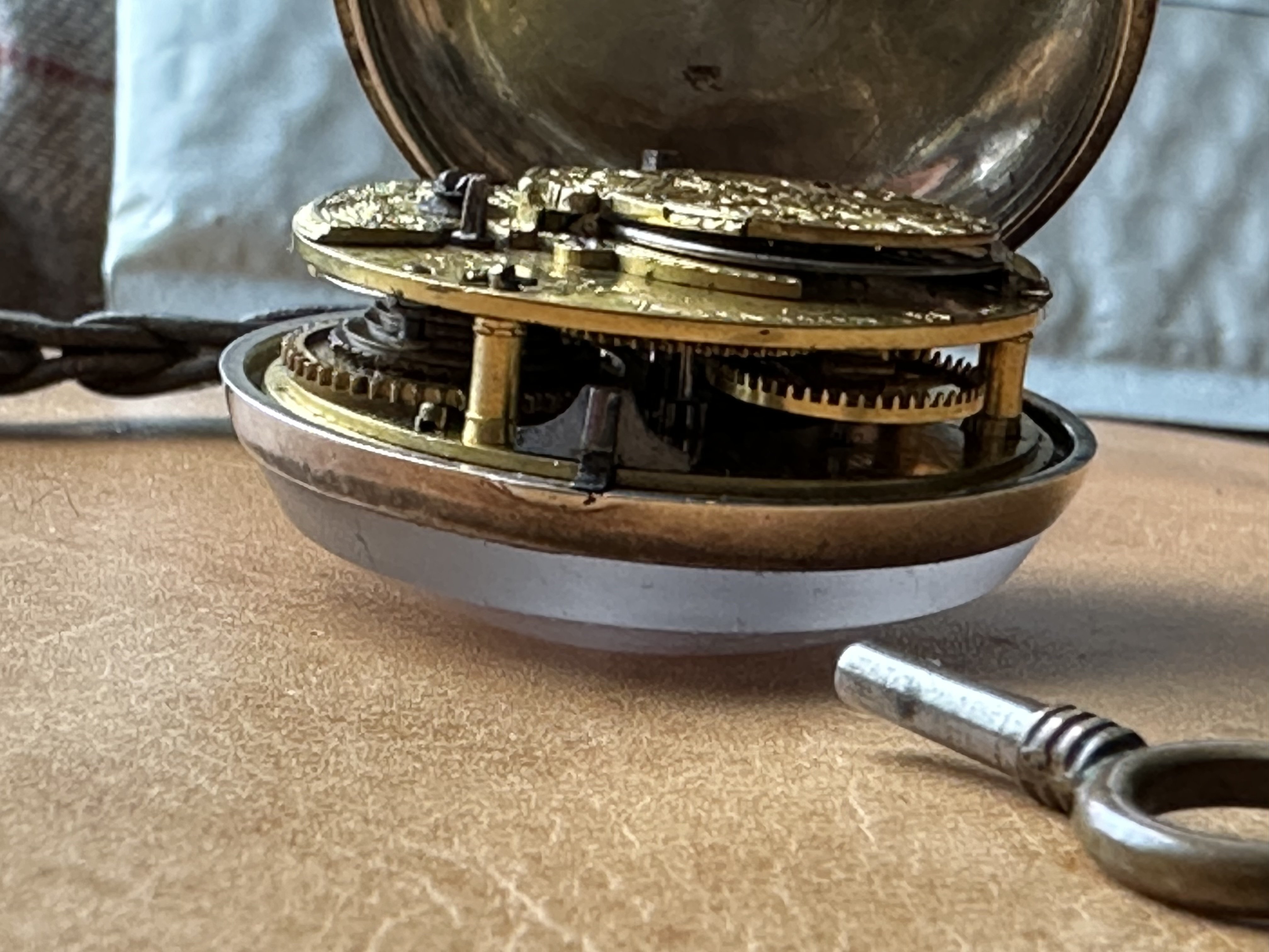

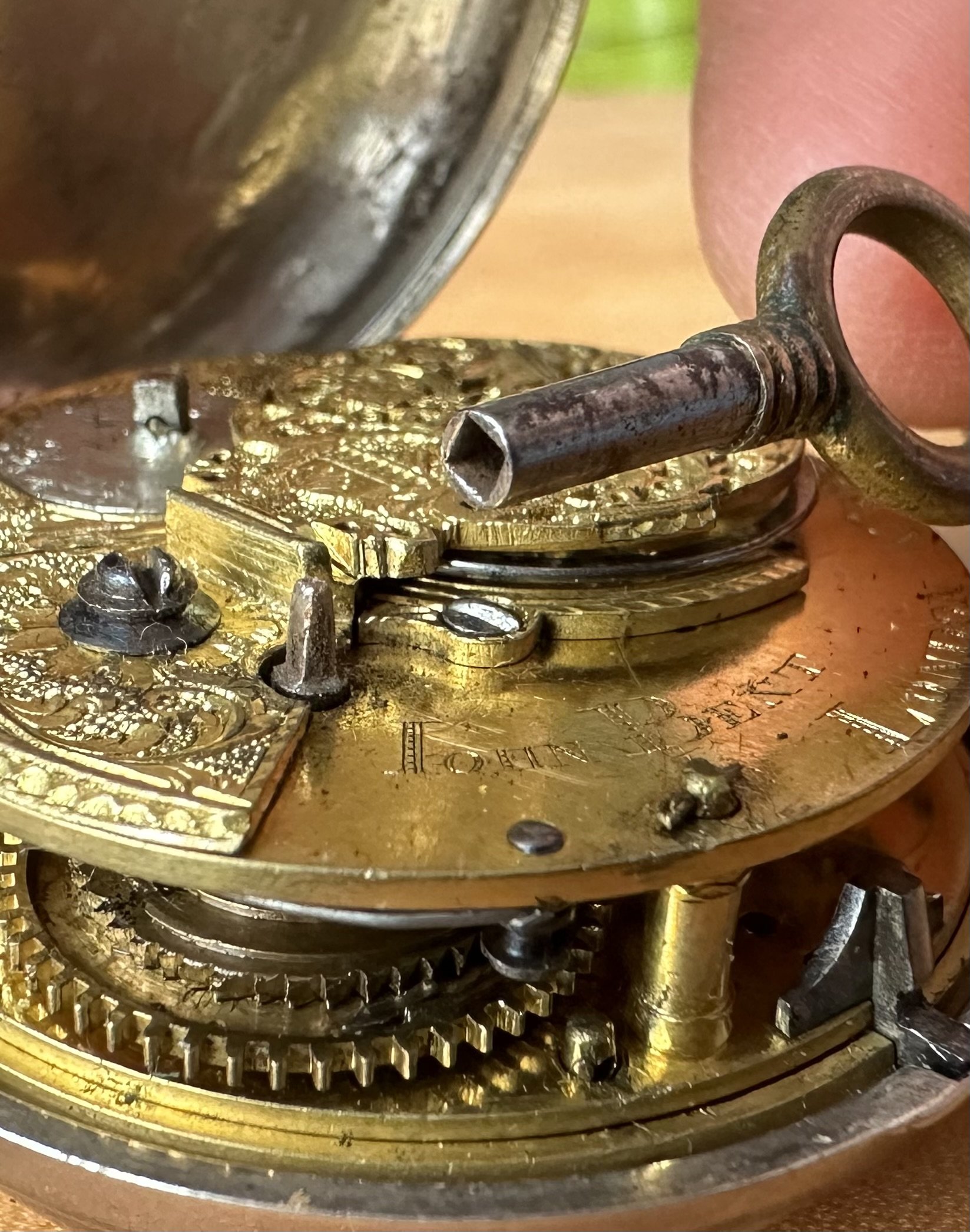

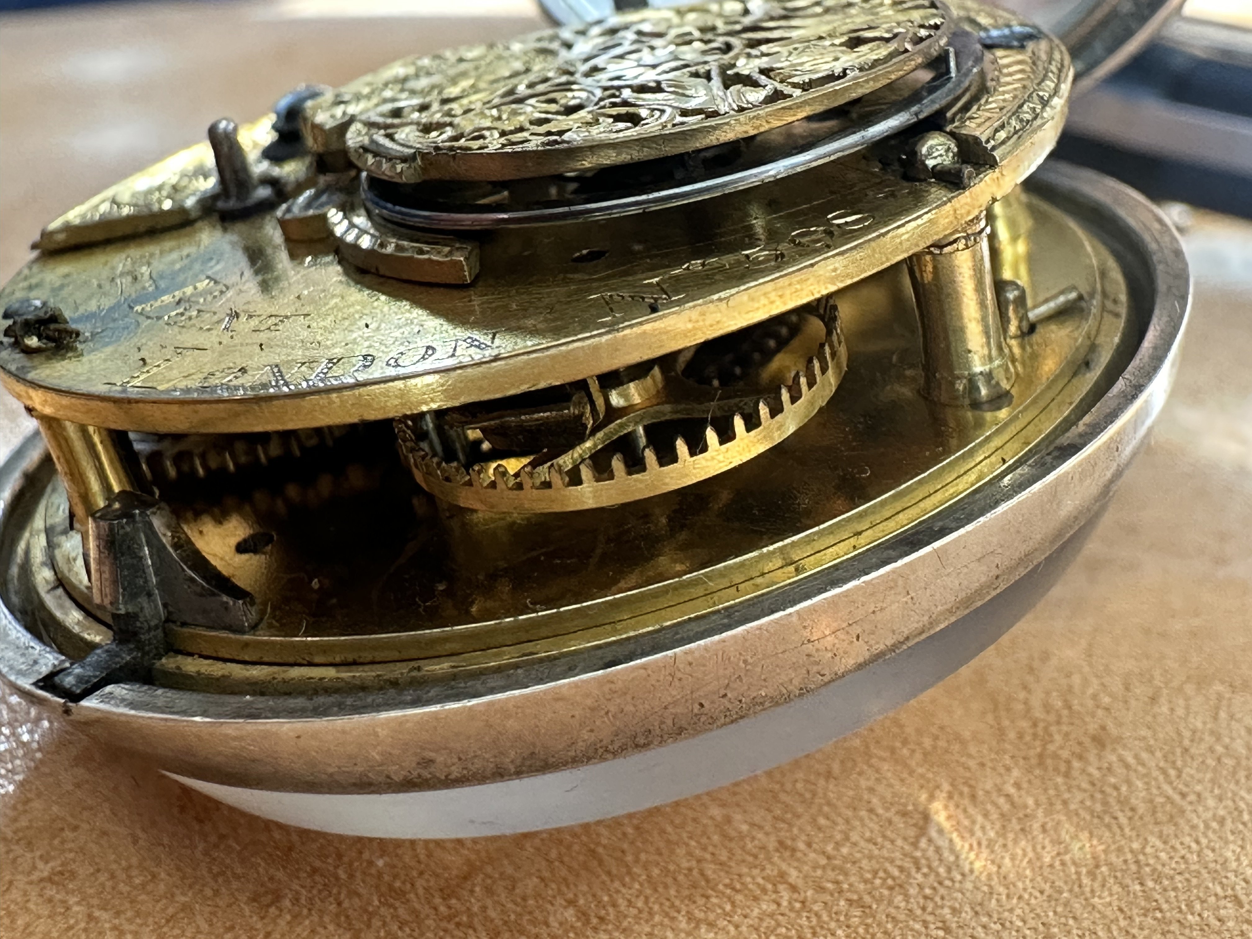

On the topic of posts, being as you are dealing with an antique English pocket watch, I thought it might be of merit to discuss the pillars or posts between the plates on early an English watches. A lot can be told about the origin and the vintage of these English pocket watches by looking at the pillars between the plates. I don’t have any reference material in front of me at the moment but I think that probably when I get out of the bathtub a little bit later, I’ll see what I can do about finding out some reference material that might be interesting to those who have an interest in antique pocket watches from England.

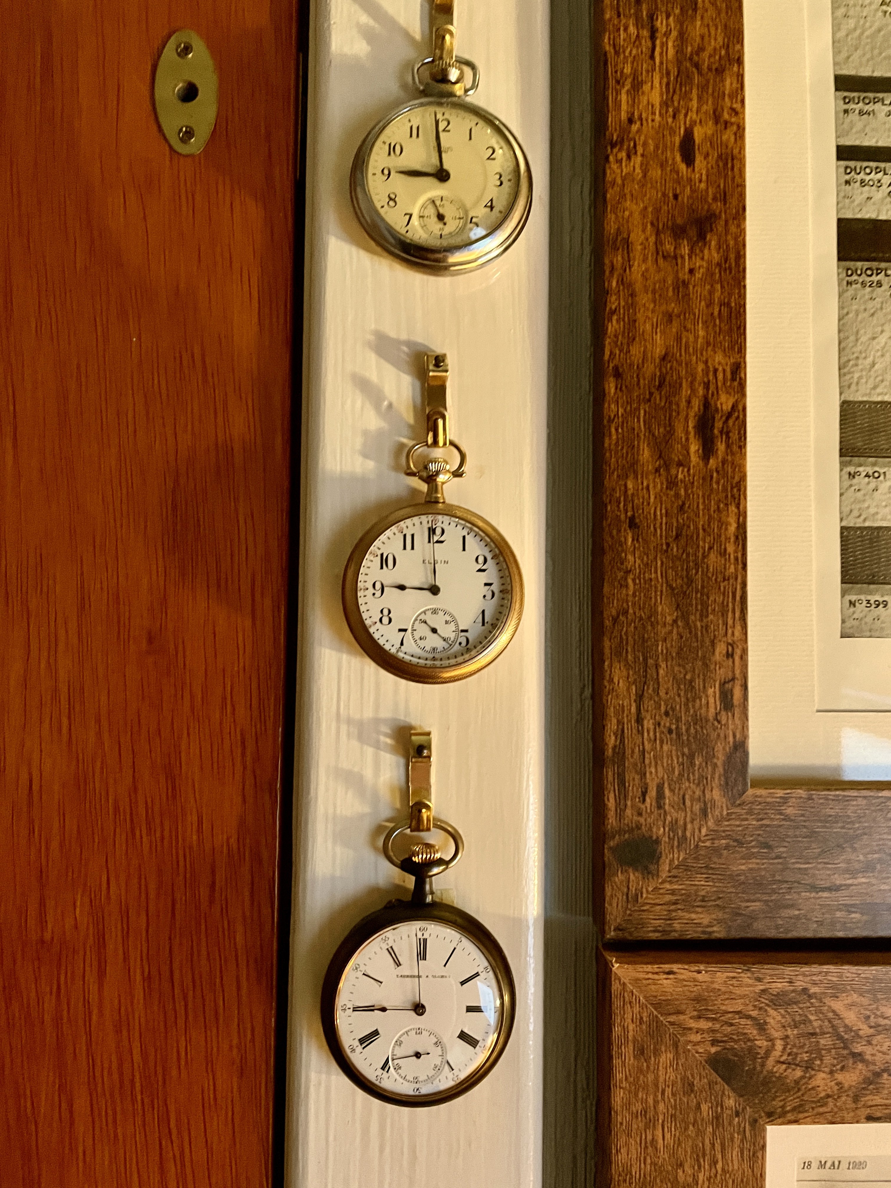

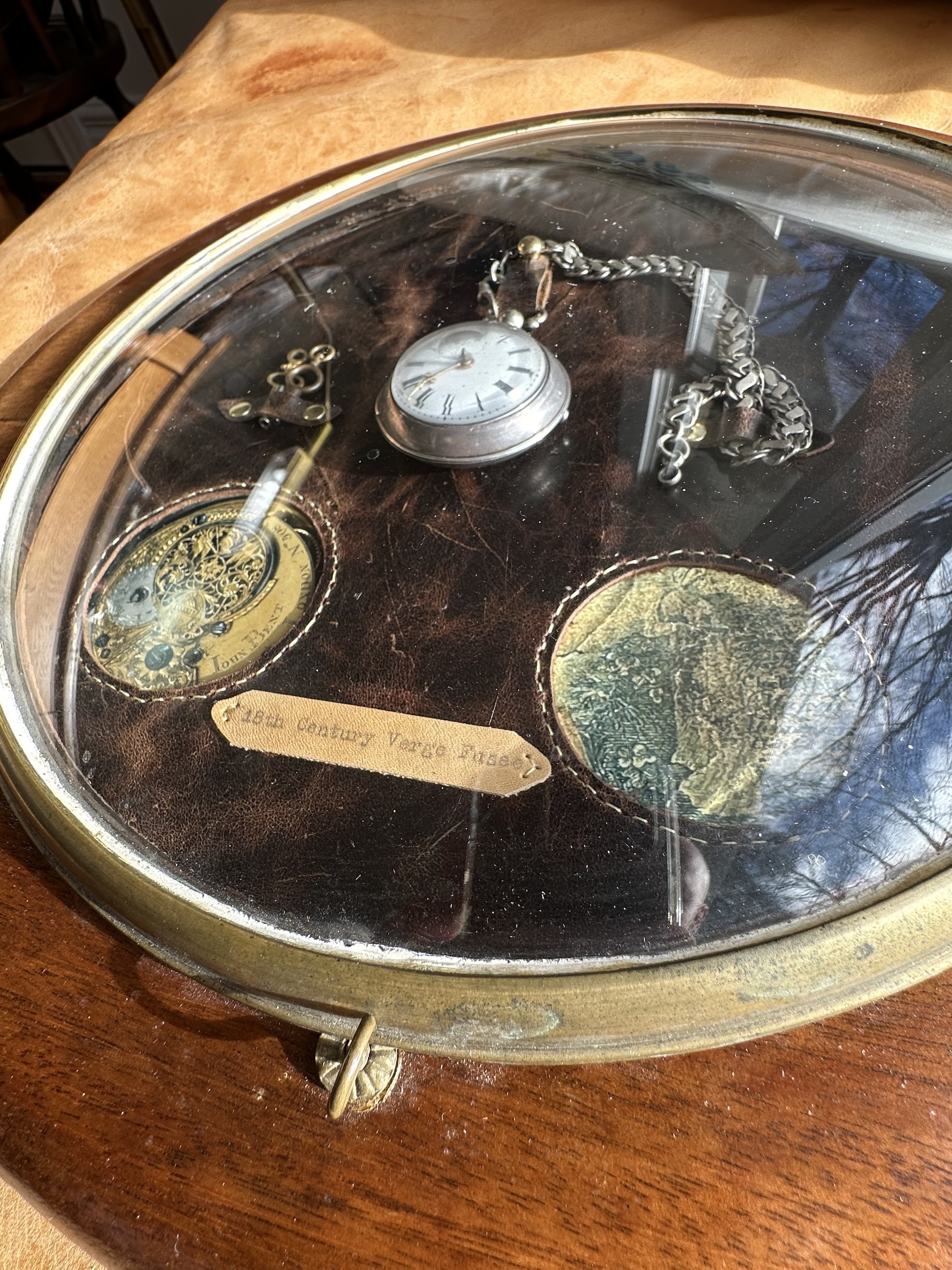

I like @Duracuir1 ‘s idea for displaying his pair cased pocket watch. I’m still wearing the Hamilton grade 952 pocket watch that I vowed I would be wearing when I see in 2024 (not in the bath tub, of course!) It is still on my @Duracuir1 leather lanyard. With 50 pocket watches, I couldn’t begin to find the space to display them in a similar fashion. I might do a photo collage of them, and paper a wall. But then I’d have to do the same with my wrist watches. I’d need a bigger house!

On the subject of “pillars” (as in posts), the style of pillars used on watches from the 16th to 19th centuries, followed trends set by significant watchmakers. Some conclusions may be drawn from the style of posts exhibited in watches from these eras. @Duracuir1 didn’t show many details pertaining to his English pair cased watch, but chances are the pillars on this late 18th century watch may bear some resemblance to a pillar shown in the attached. Credit to my Shugart, Engel, & Gilbert collector’s bible.

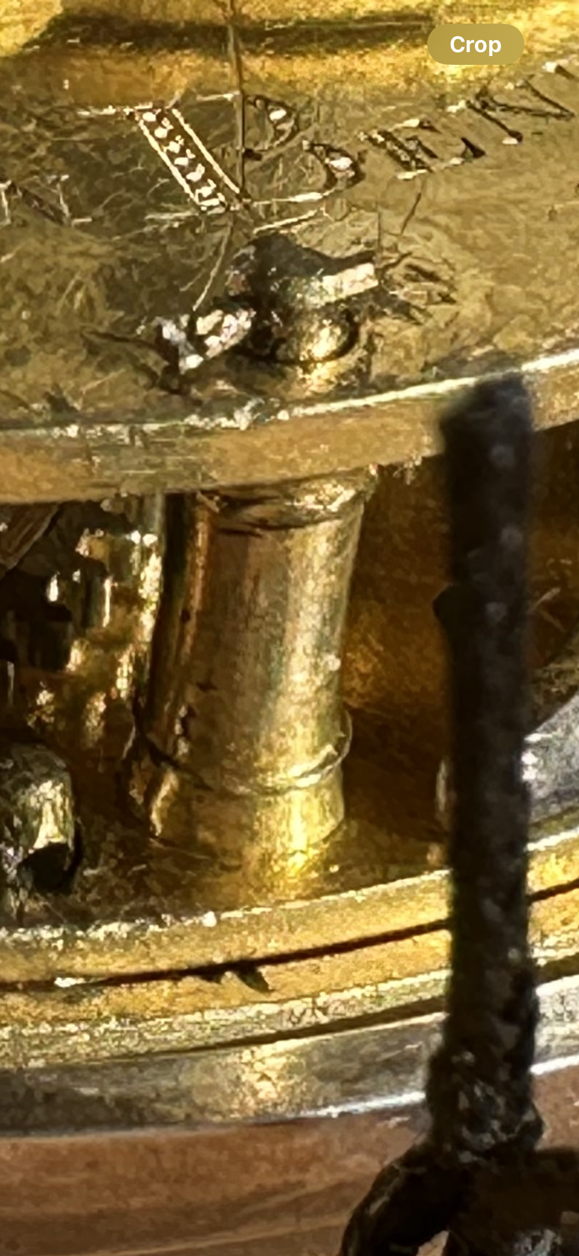

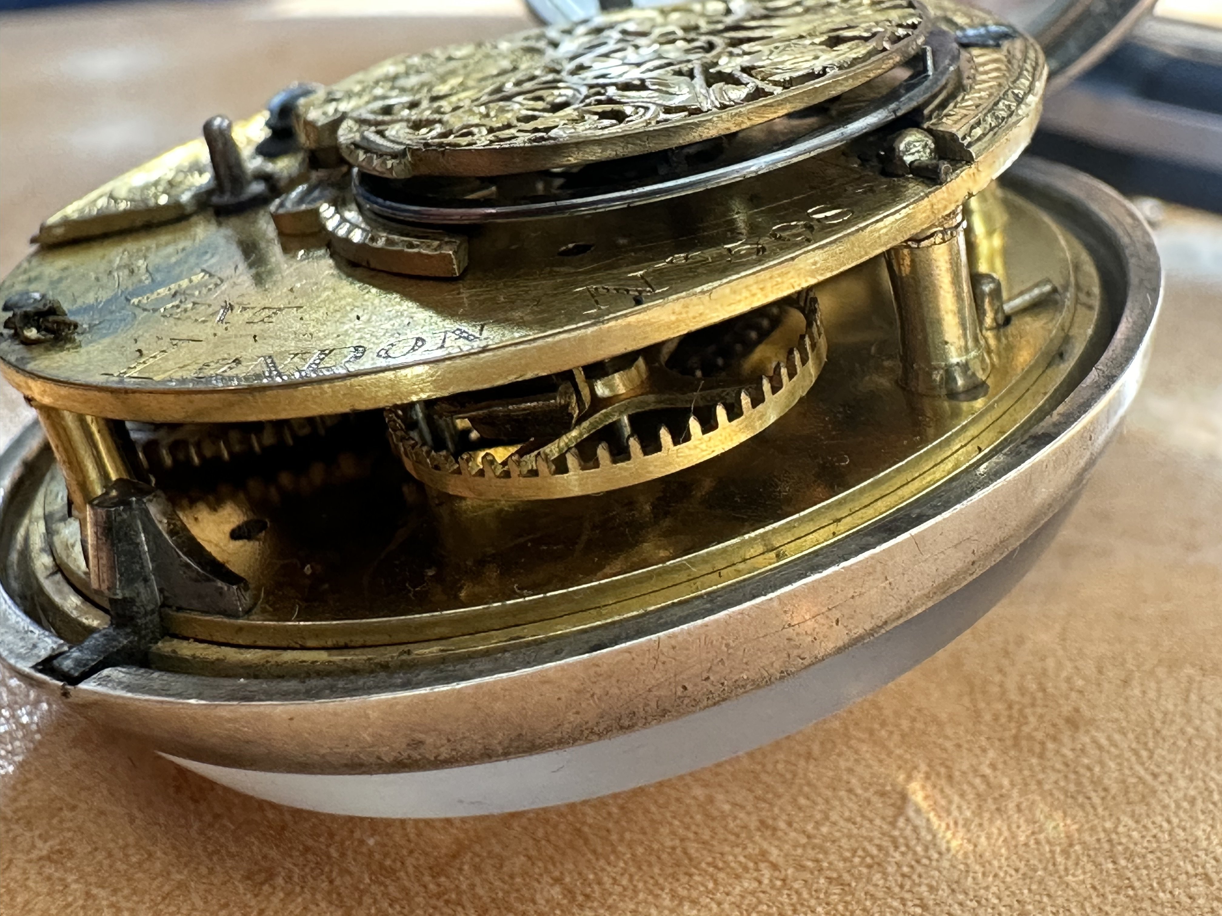

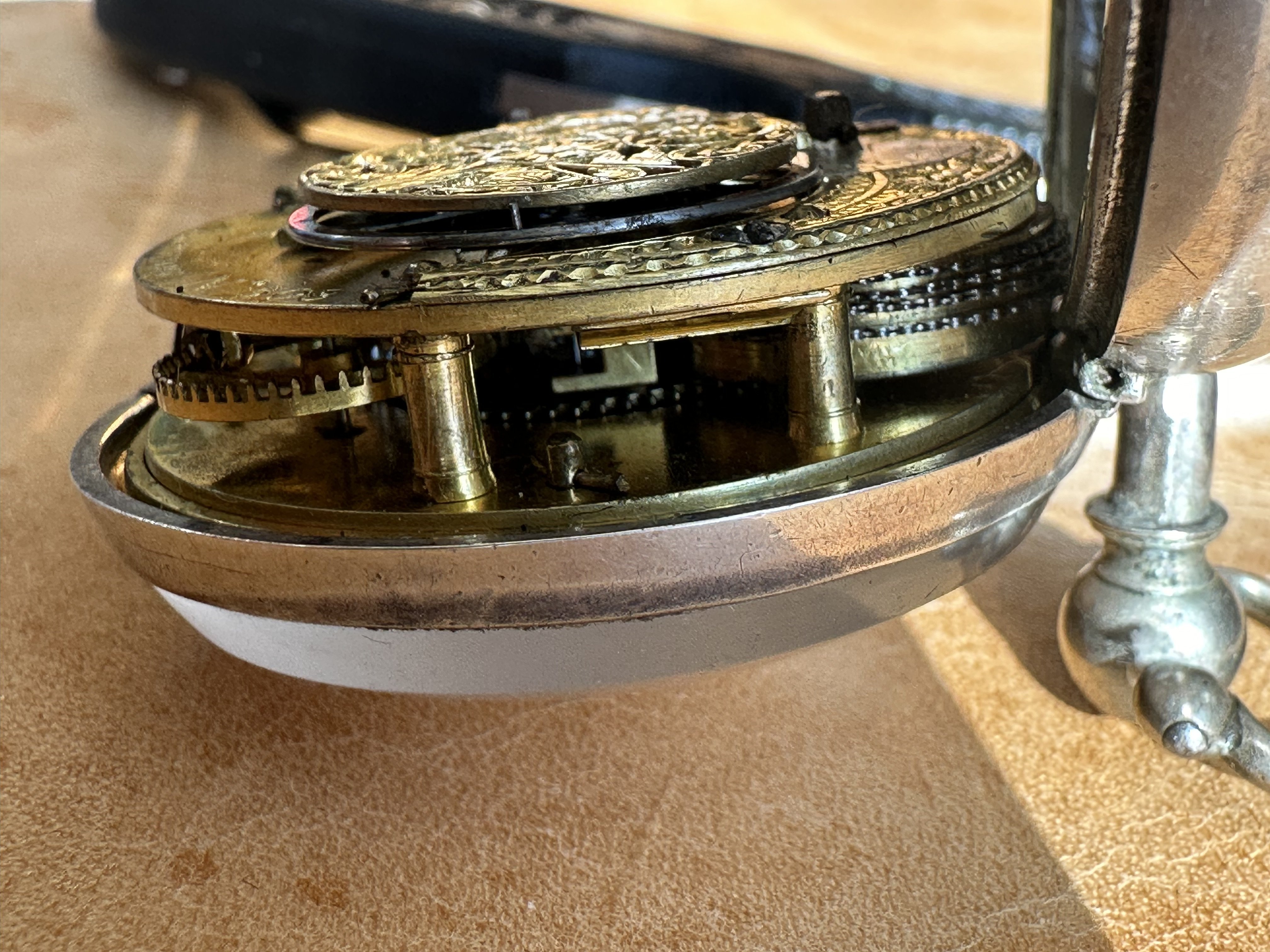

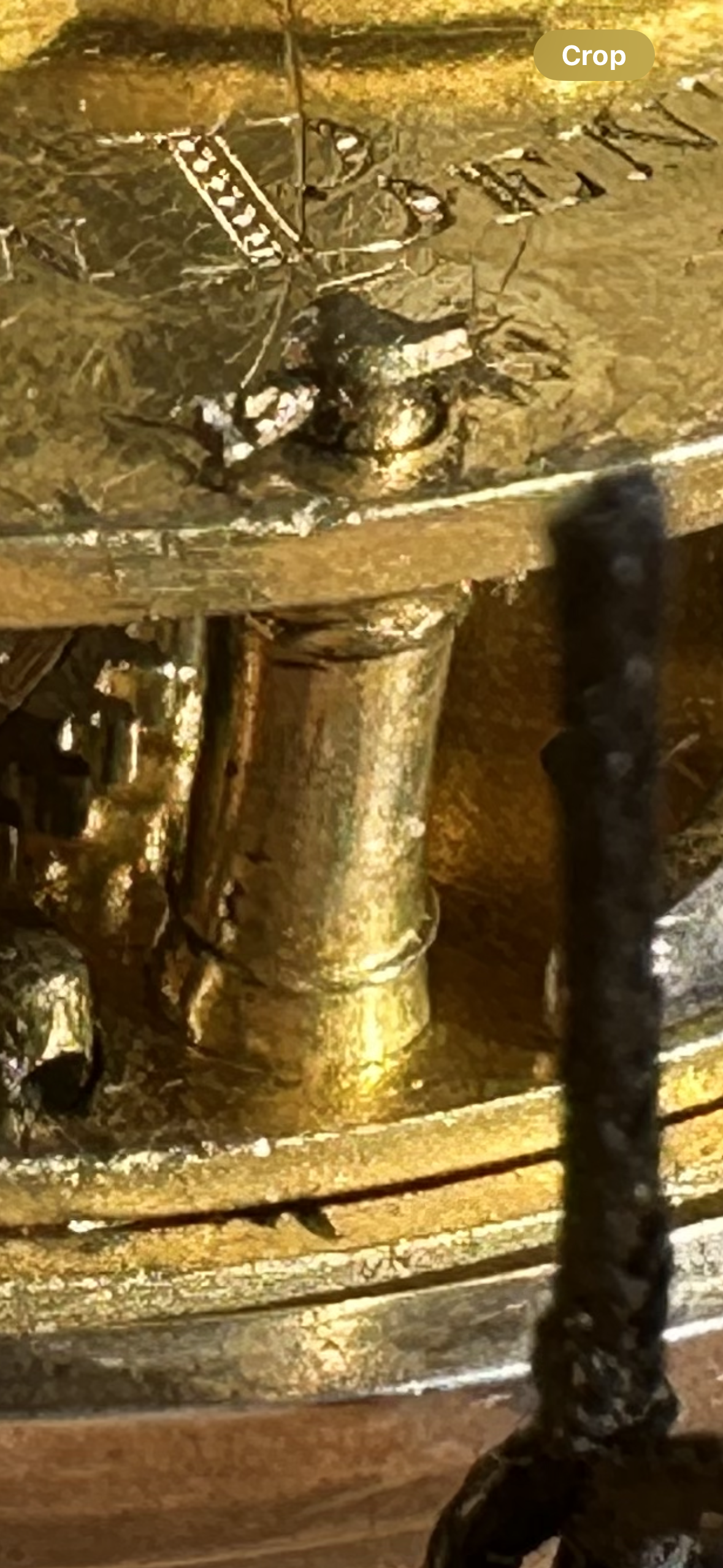

The pillars looks pretty plain. Like number 1 perhaps? Maybe 6? The cat also had a look.
You’ll notice the pillars are plain, but tapered. It occurs to me they more closely resemble #6 in the examples shown.

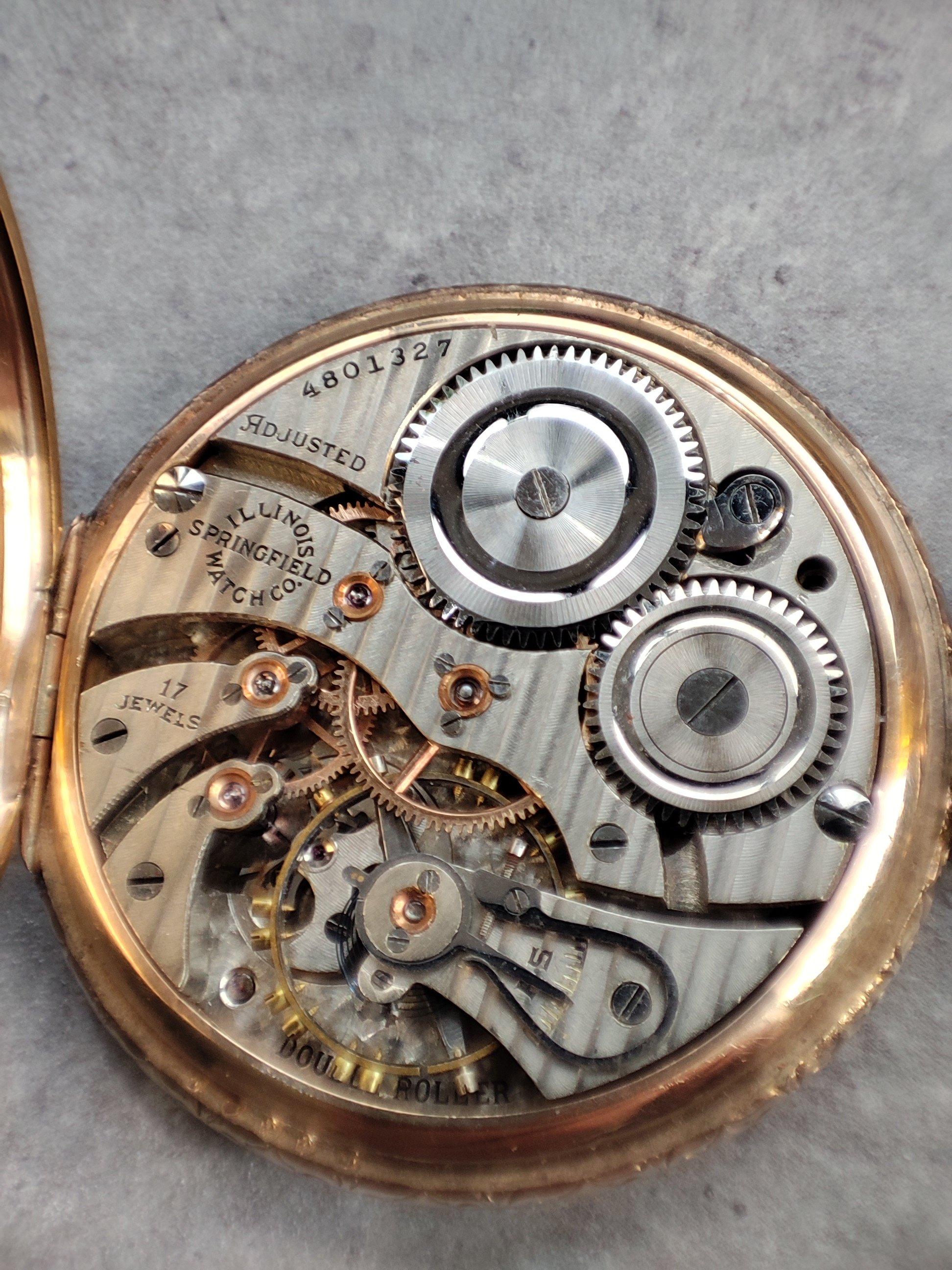

There are so many nice US PW brands out there.
You already have two fine brands you might want to look to extending brands.
One brand to me that I think encapsulates the quality craftsmanship and beauty of US PW's would be Illinois RR grade models more so than any other.

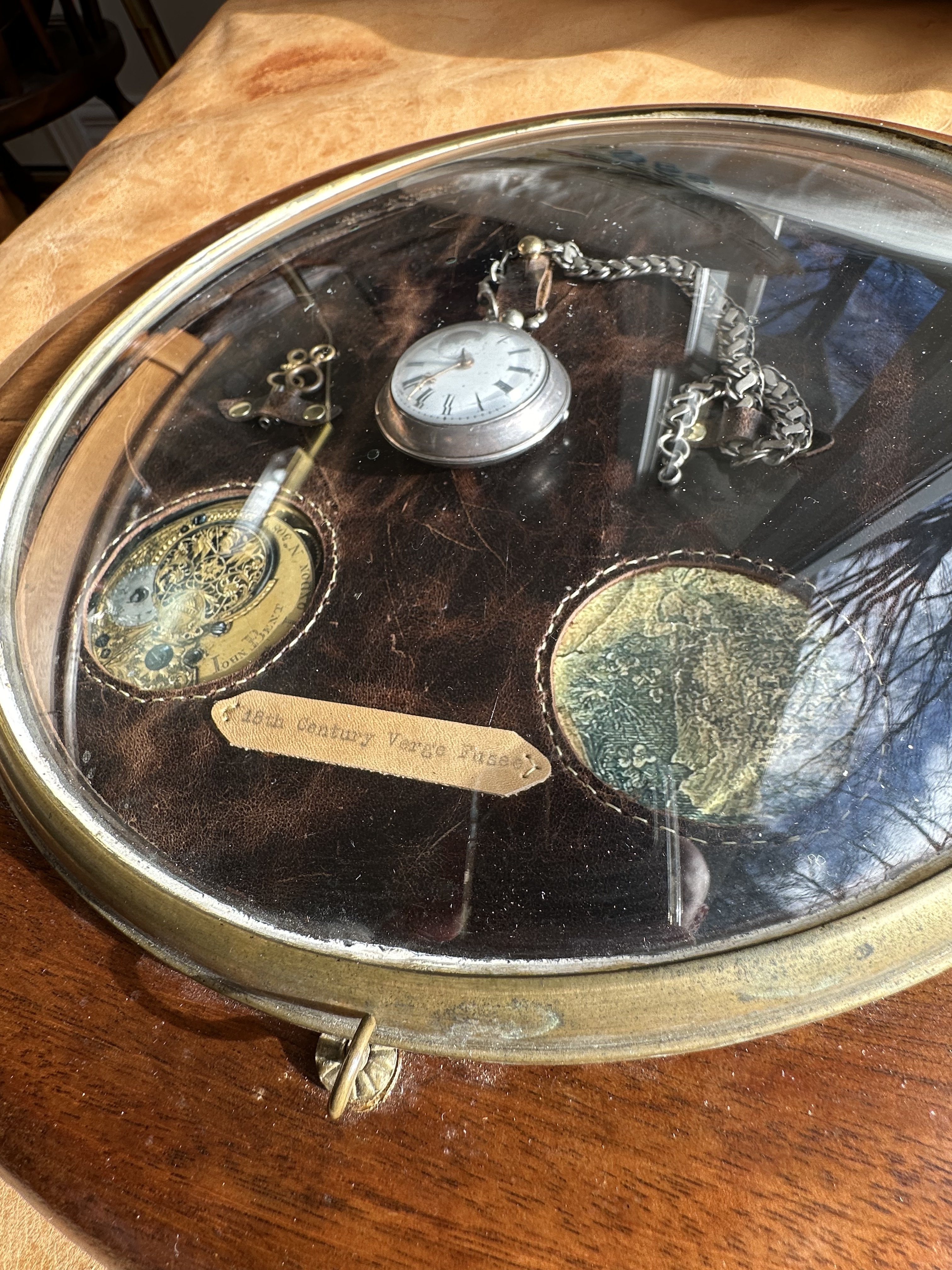

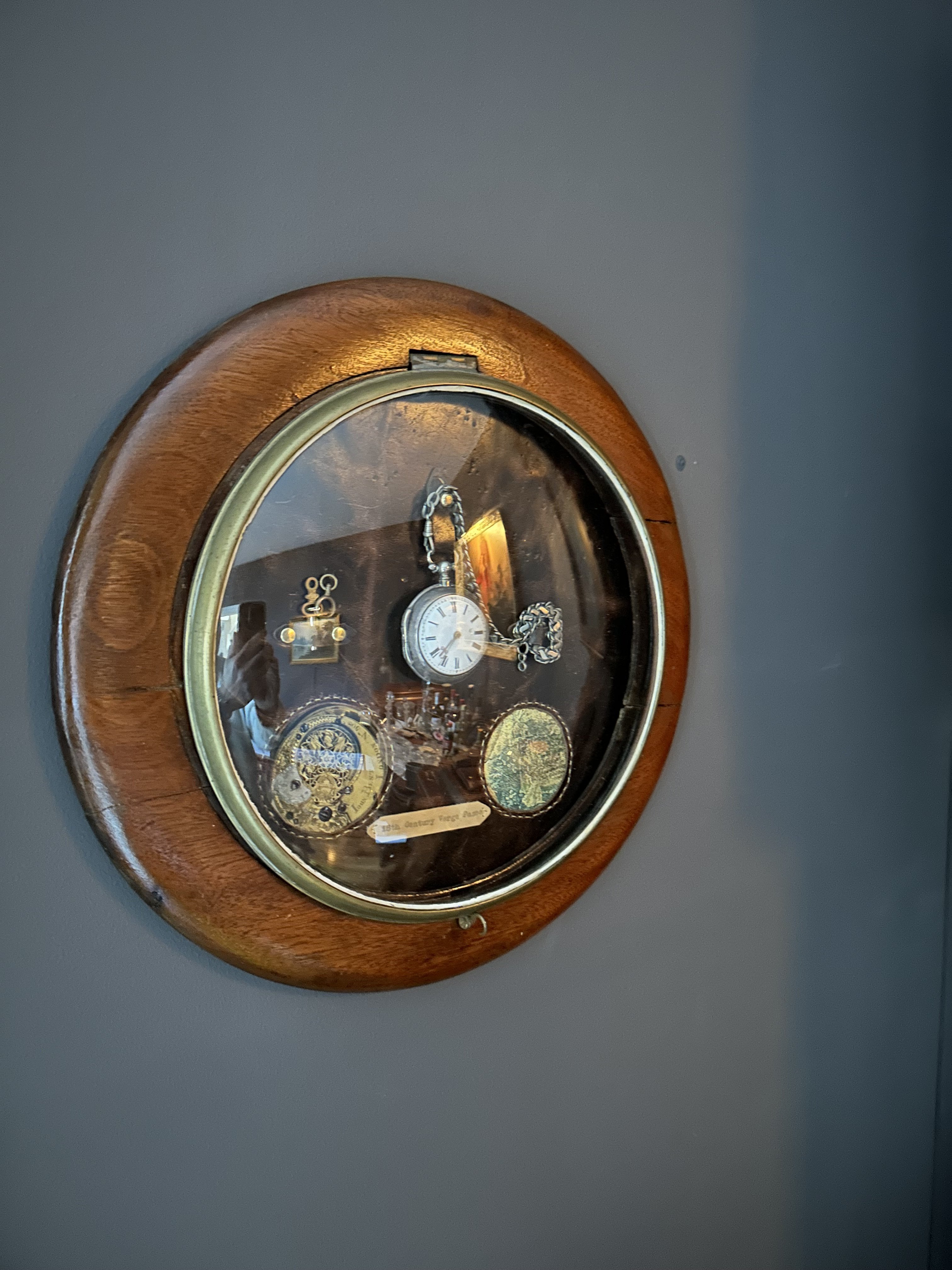

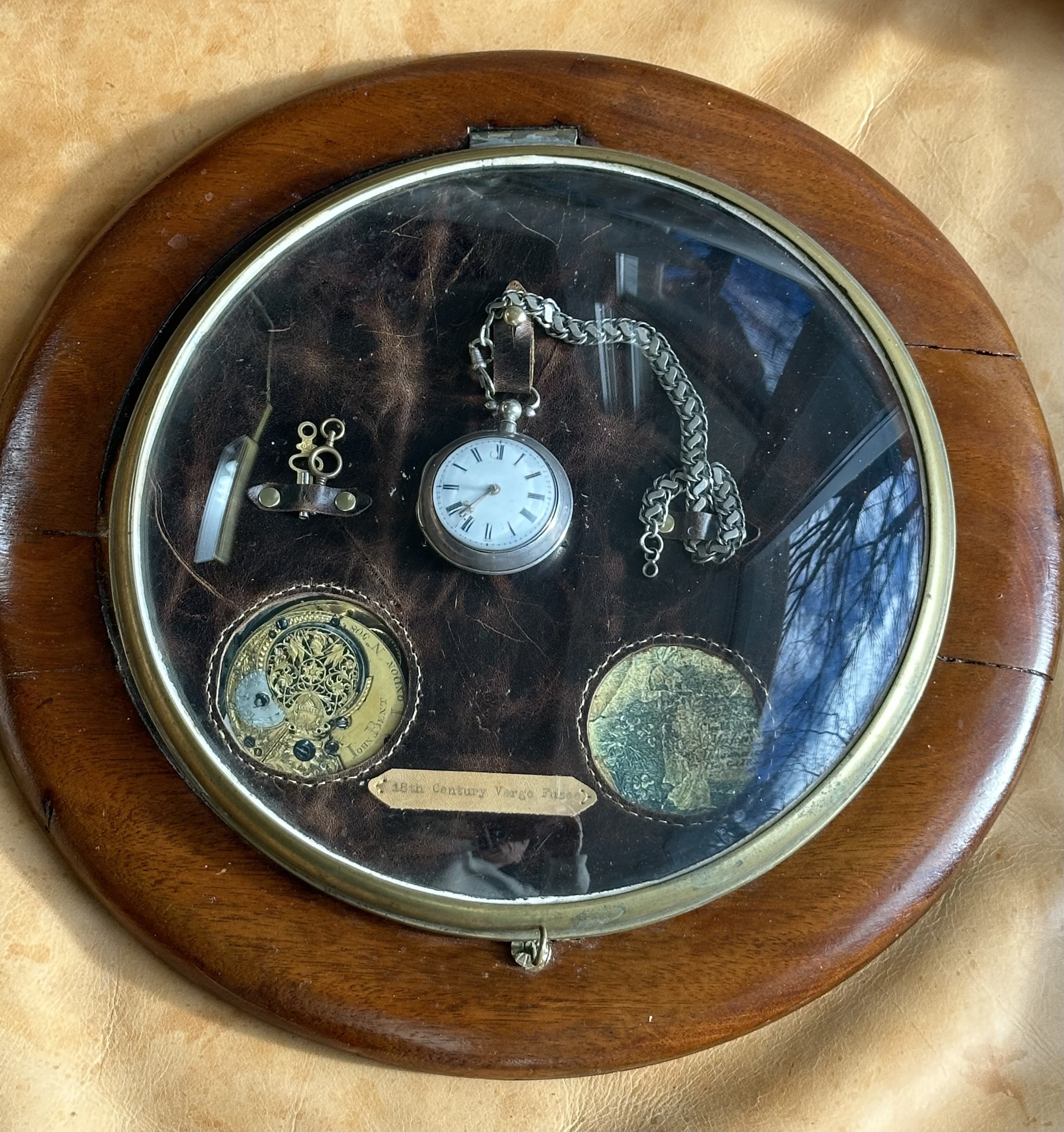

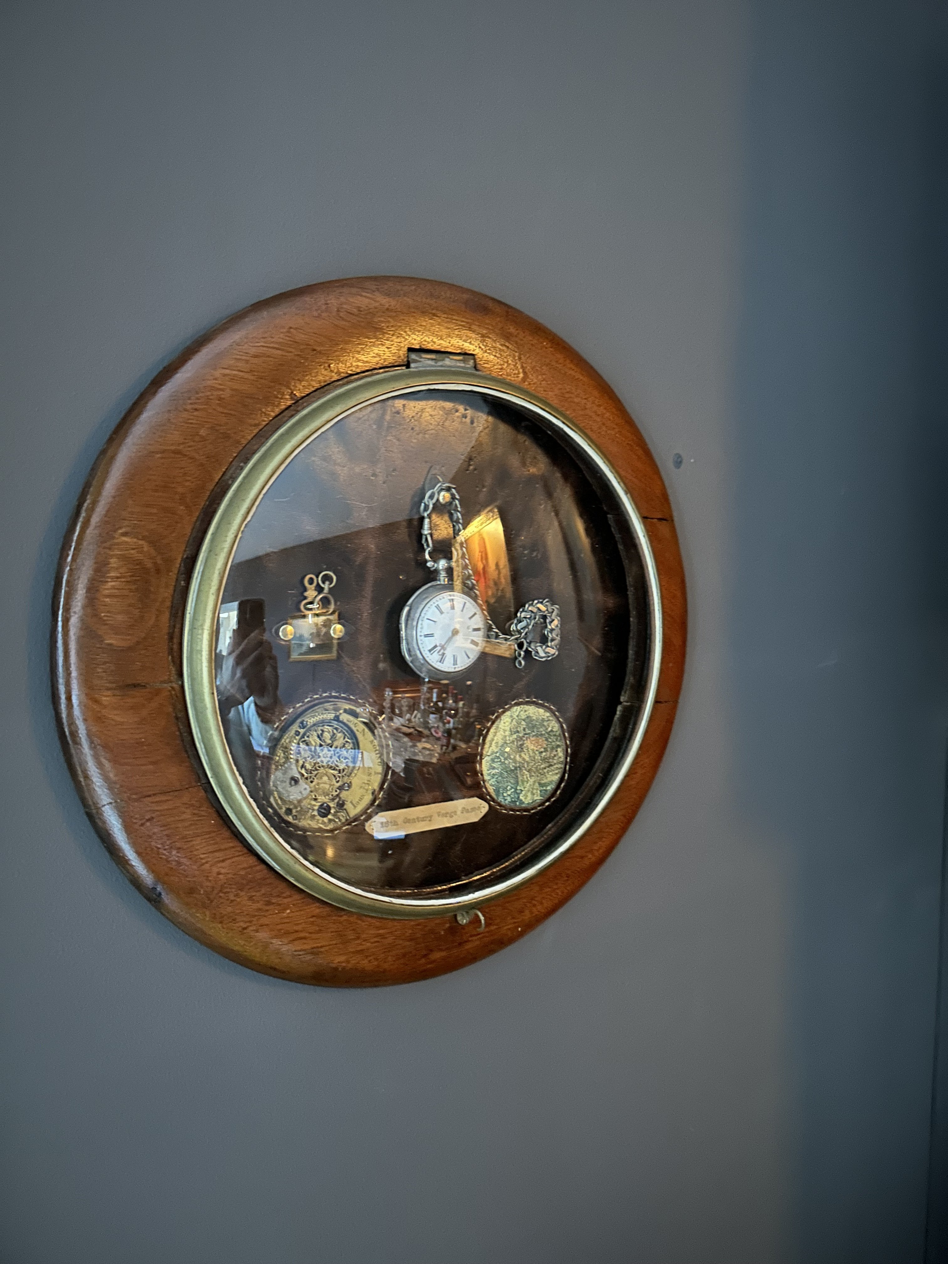

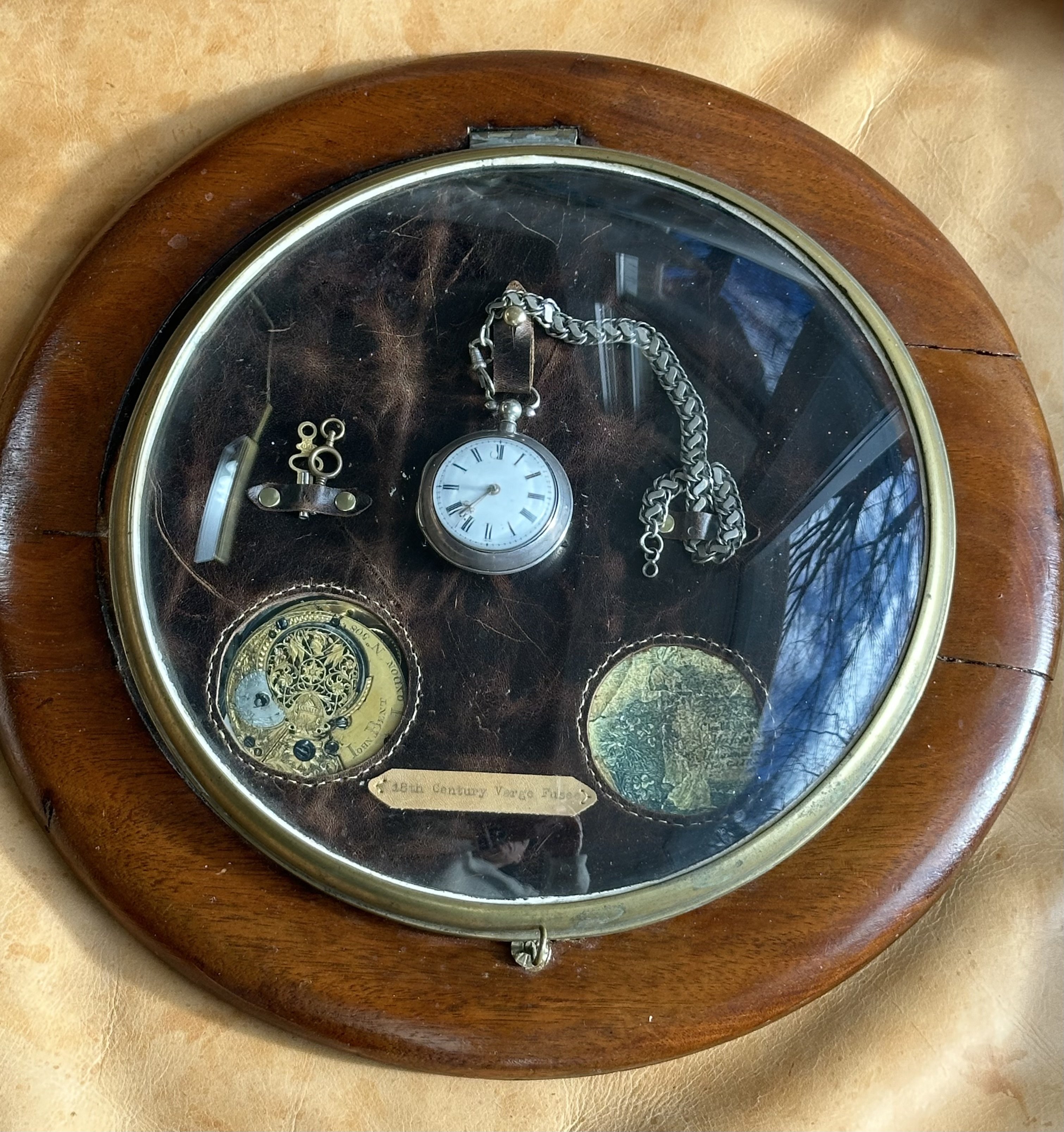

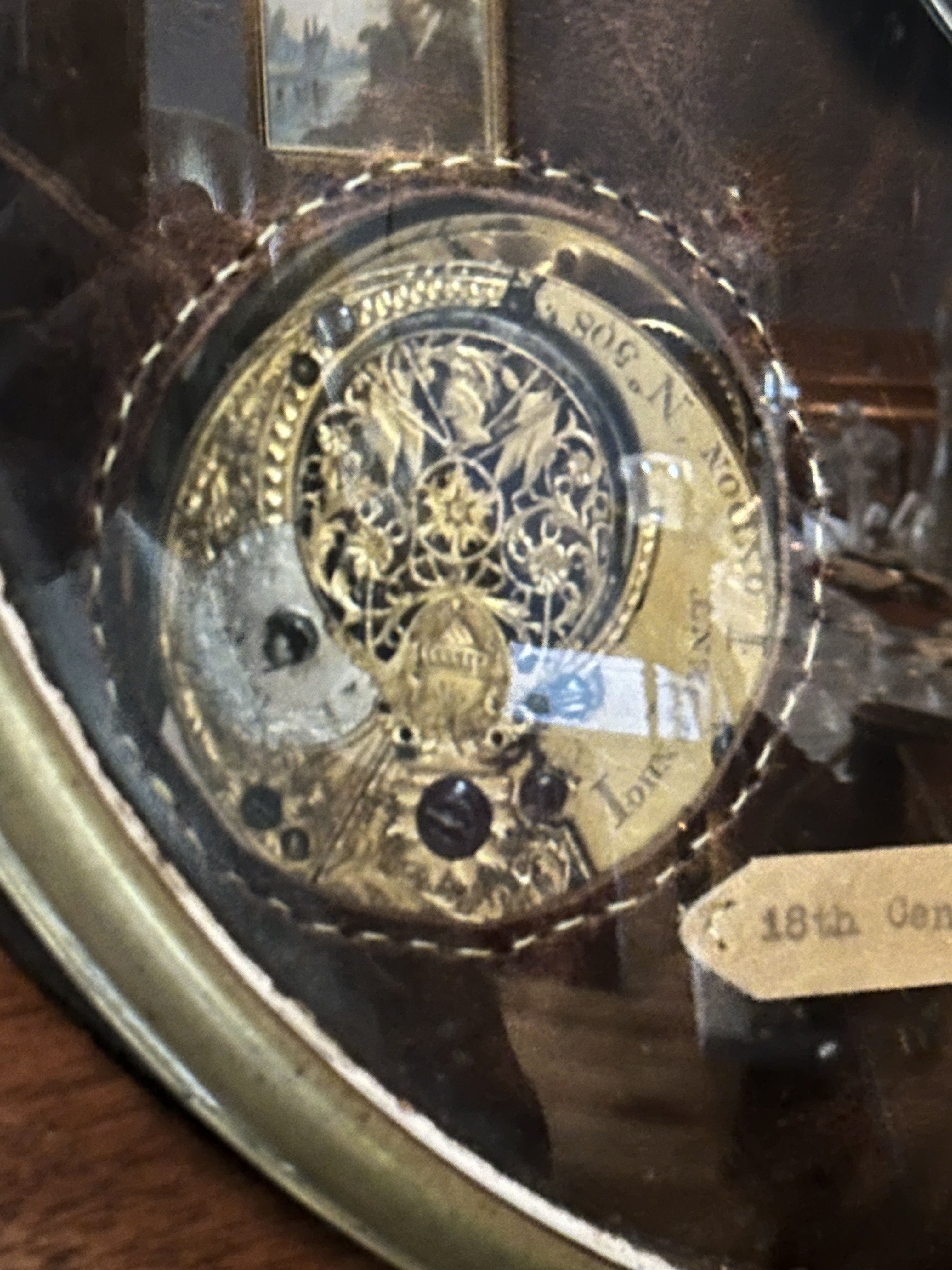

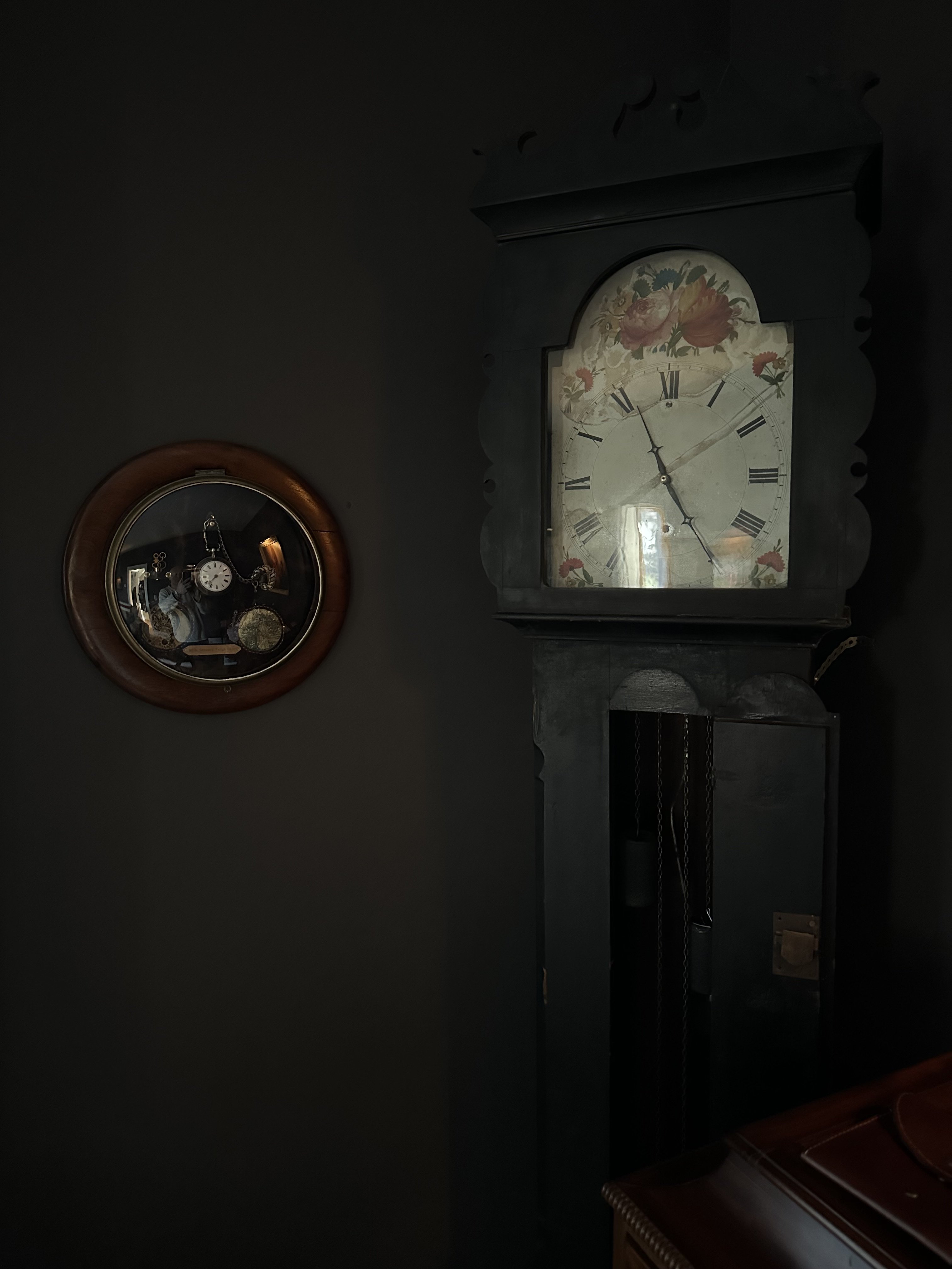

My display is completed. I used the old typewriter on a thin strip of leather to add a caption.
It’s hanging next to a clock that is a bit younger than the watch, but only by a few decades.

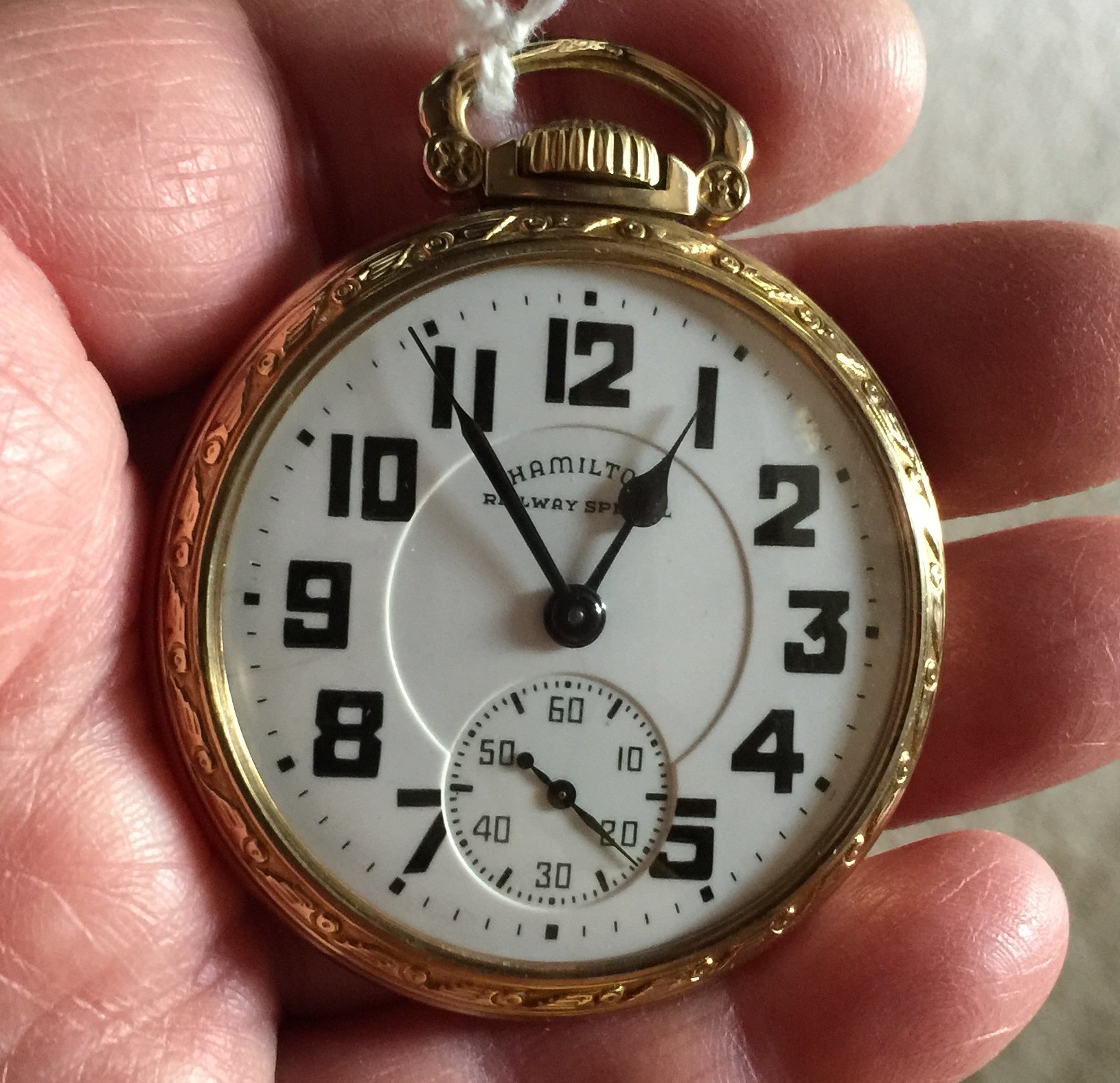

Many thanks! That’s two votes on the Illinois. I’ve been interested in the Hamilton 992b as well.
I’ve seen plenty of pocket watches that piqued my interest listed in this thread. Only problem is my understanding of value, worth, and cost. I’ve got some work to do to figure out the difference between your A, B, and C choices. ;-)

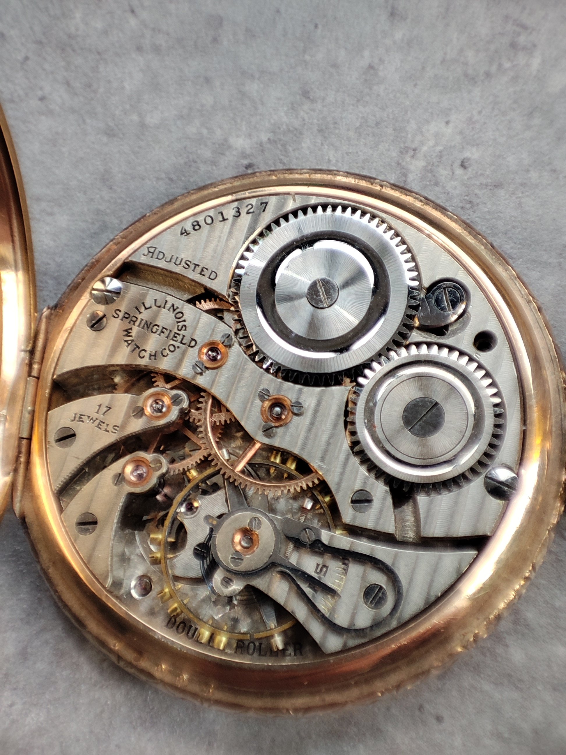

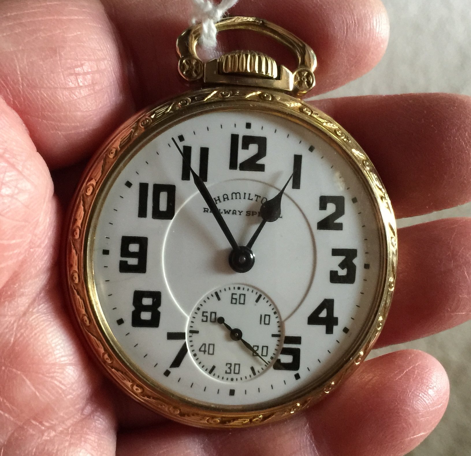

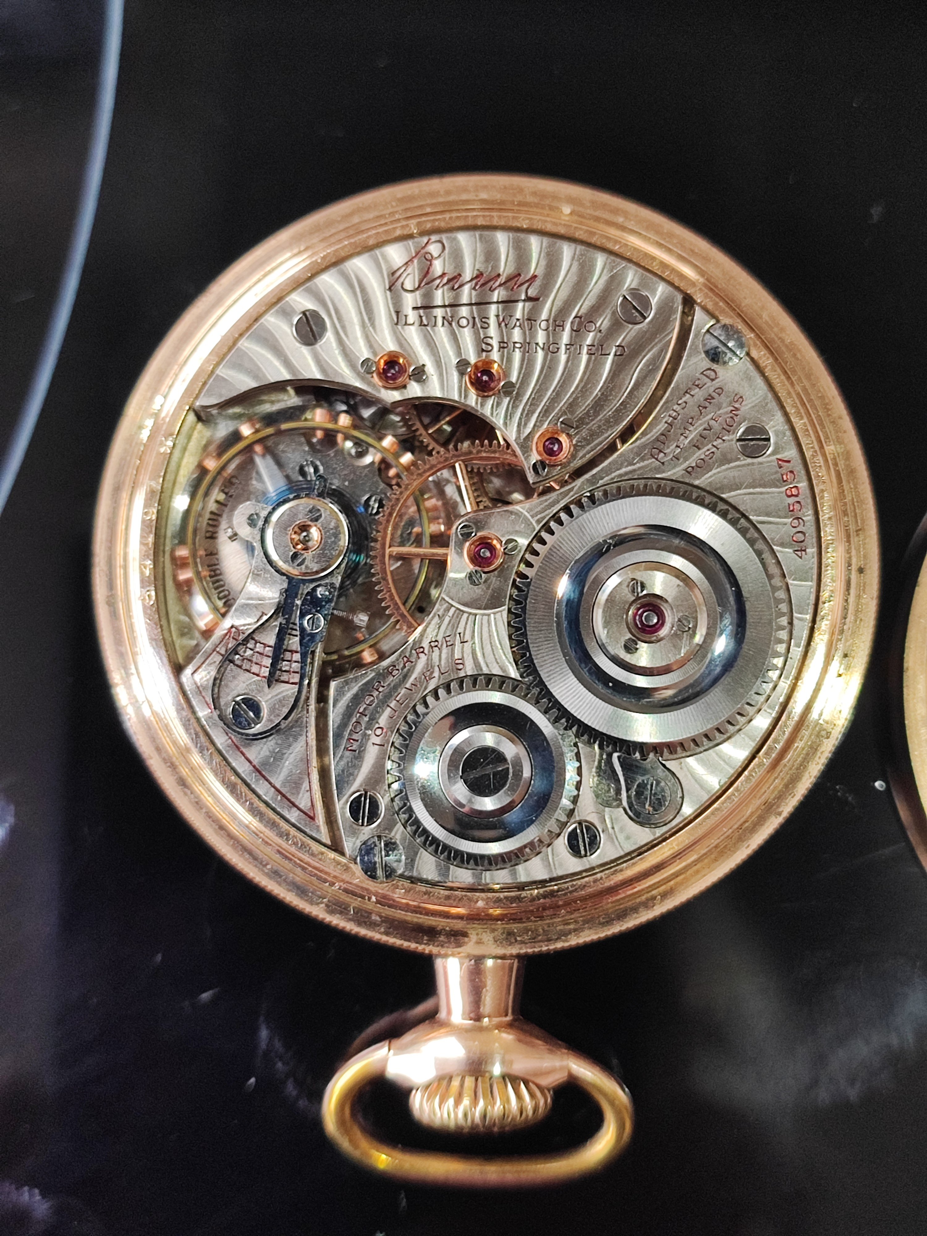

I would say a 992 or a 992B should be a cornerstone in a PW collection. Hamilton produced the 992 from roughly 1900 to 1940 and the 992B from 1940 to 1969 when they closed their doors.
Iconic, workingman's American RR grade watches and they sold as many as they could produce because they were designed well, durable, easily serviced by qualified WM and always at a modest, middle class price point.
Plentiful now, so finding one in your price range should be easy. $200-$300 should bring an extremely nice example with a double sunk porcelain dial with no damage, and an excellent movement. I always evaluate the screw heads in any pictures to see if a ham-fisted amateur with incorrect tools decided to play WM.
Case material(gold) will increase price accordingly.
If you must have a very nice GF Hamilton Case in the era of your movement(no evidence of being recased), expect to pay a bit more, maybe $50.
And...........if you can be happy with a double sunk porcelain dial with a minor hairline or two and a tired looking GF case, the price will drop to $100-150. and sometimes less.
Over the years, I have bought many because there are variations, etc but this is the PW that my dad's uncle had that I remember crawling up into his lap and watching him wind this cool, giant thing that ticked real loud...Dad eventually received it, then me. It will stay in the family. This watch started it all for me.

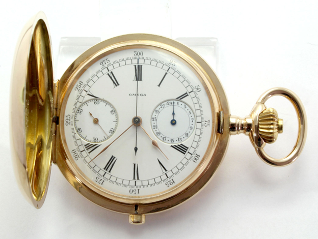

This is the gold OMEGA Chronograph Pocket Watch I own. Can anyone explain the outer rim numbering up to 300? Tia

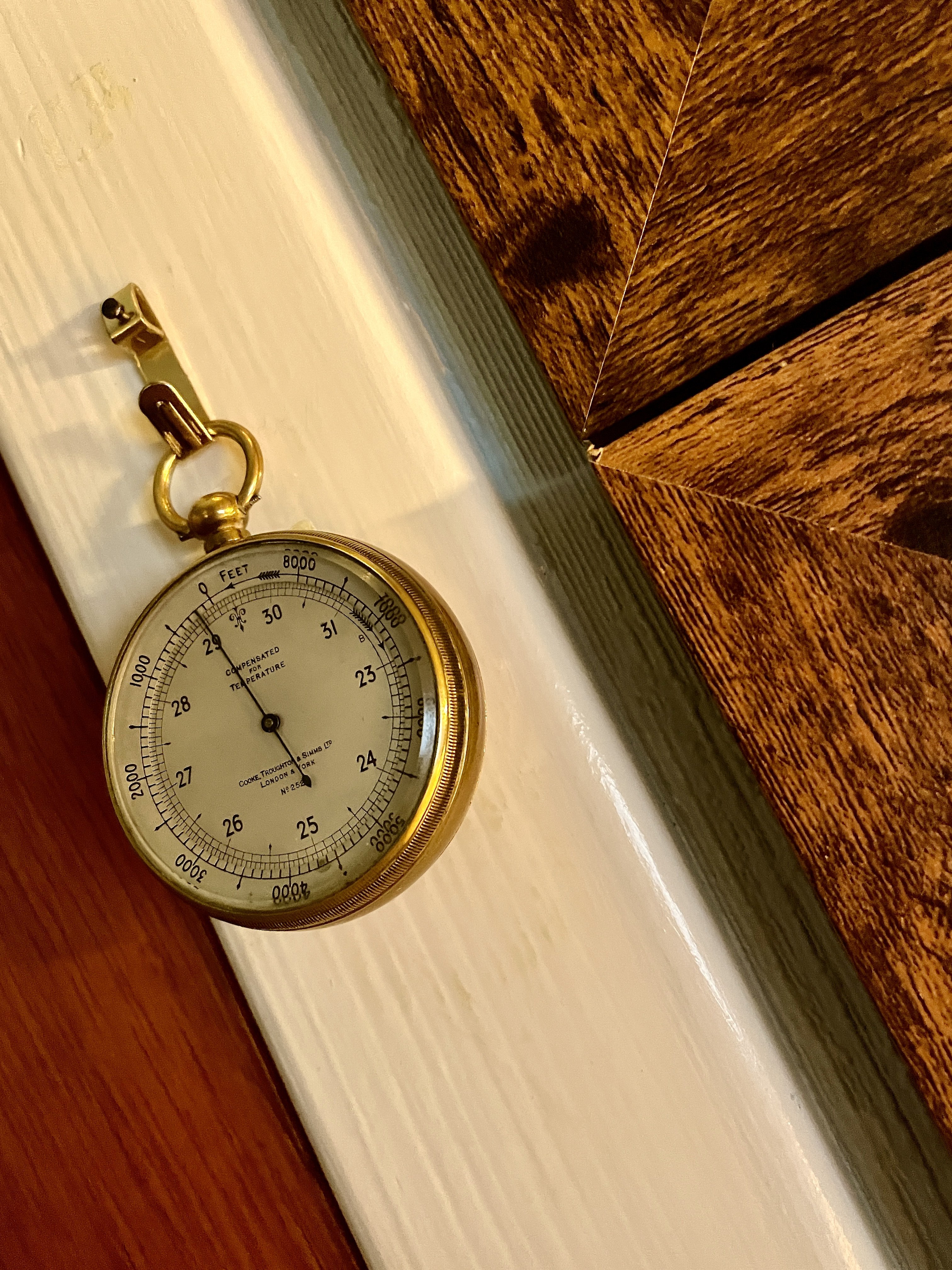

Not even remotely associated with the Pocket Watches this little one often hangs out with them, a birthday gift from the love of my life 🥰
