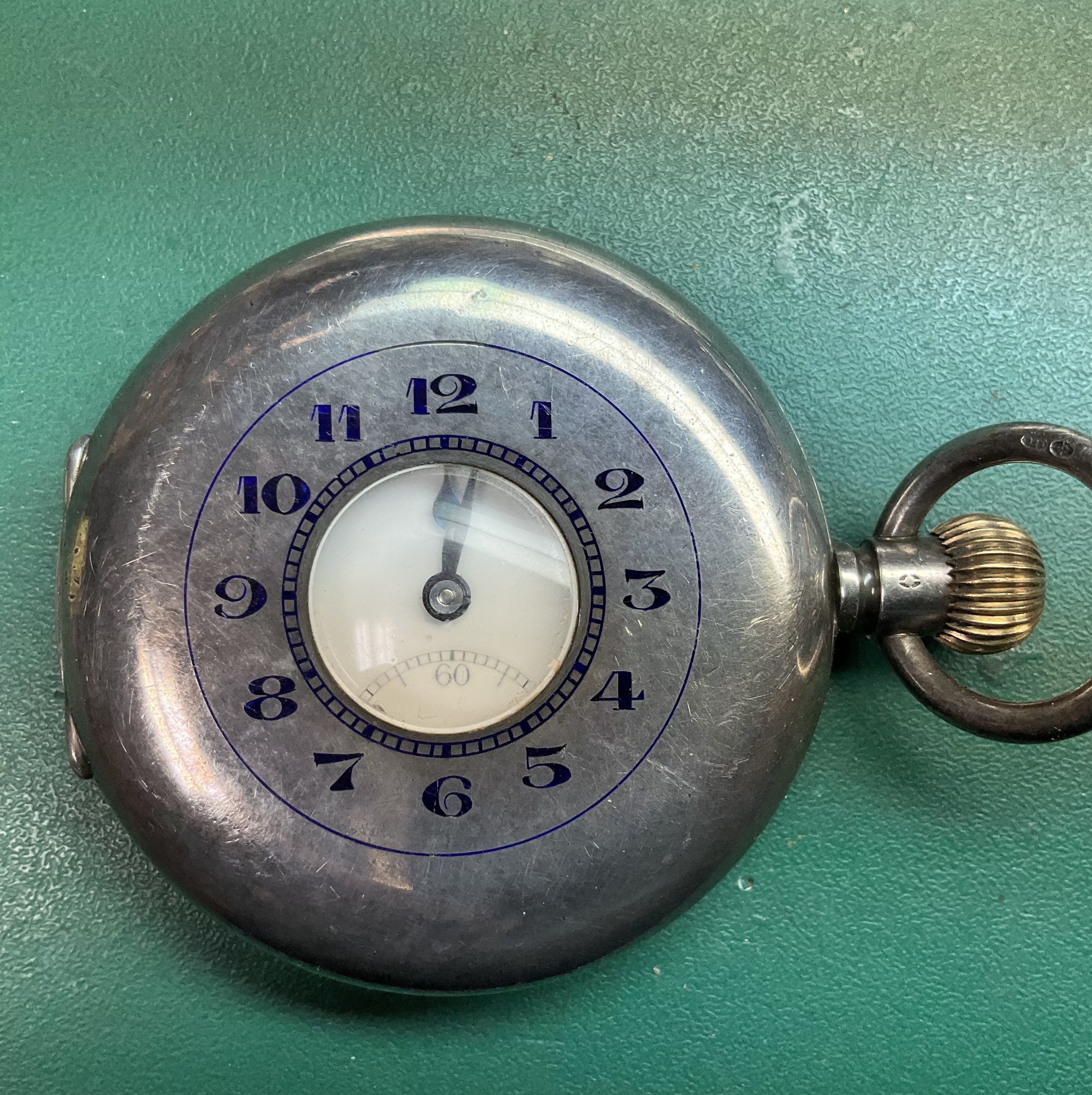

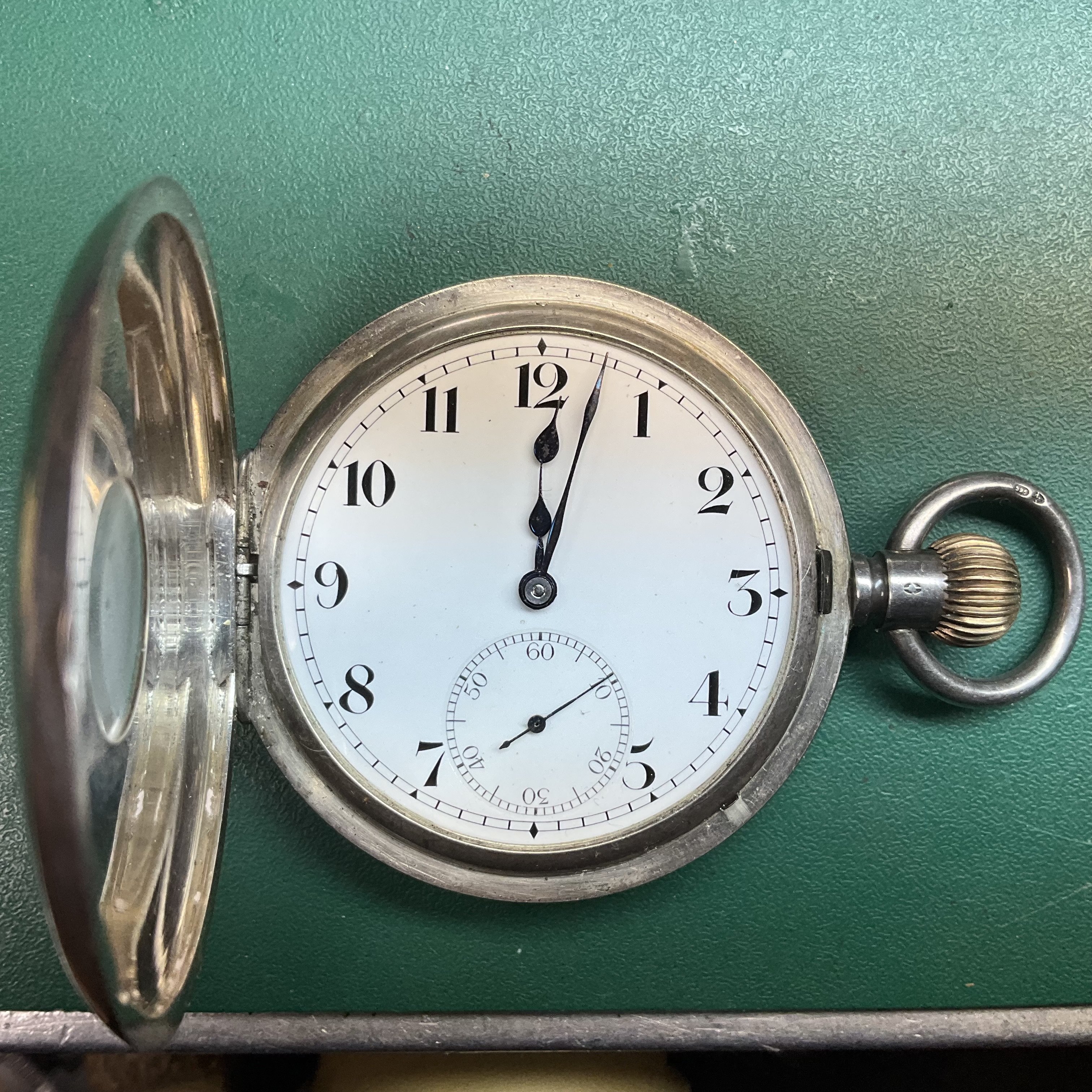

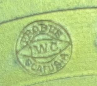

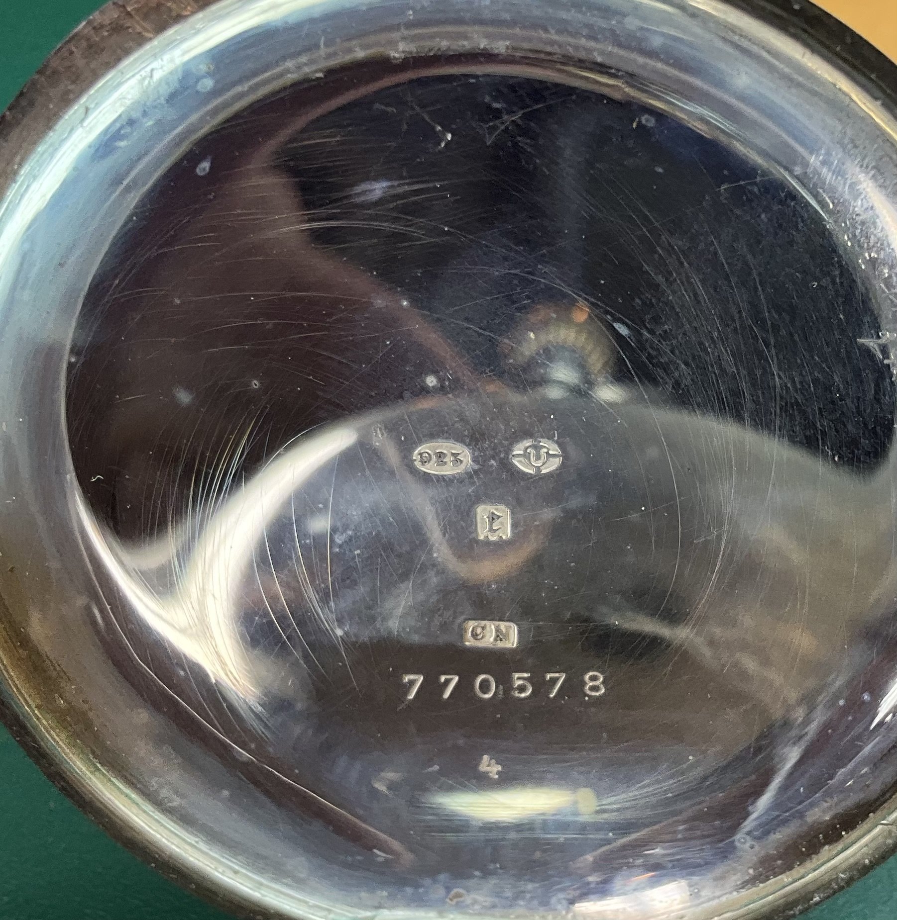

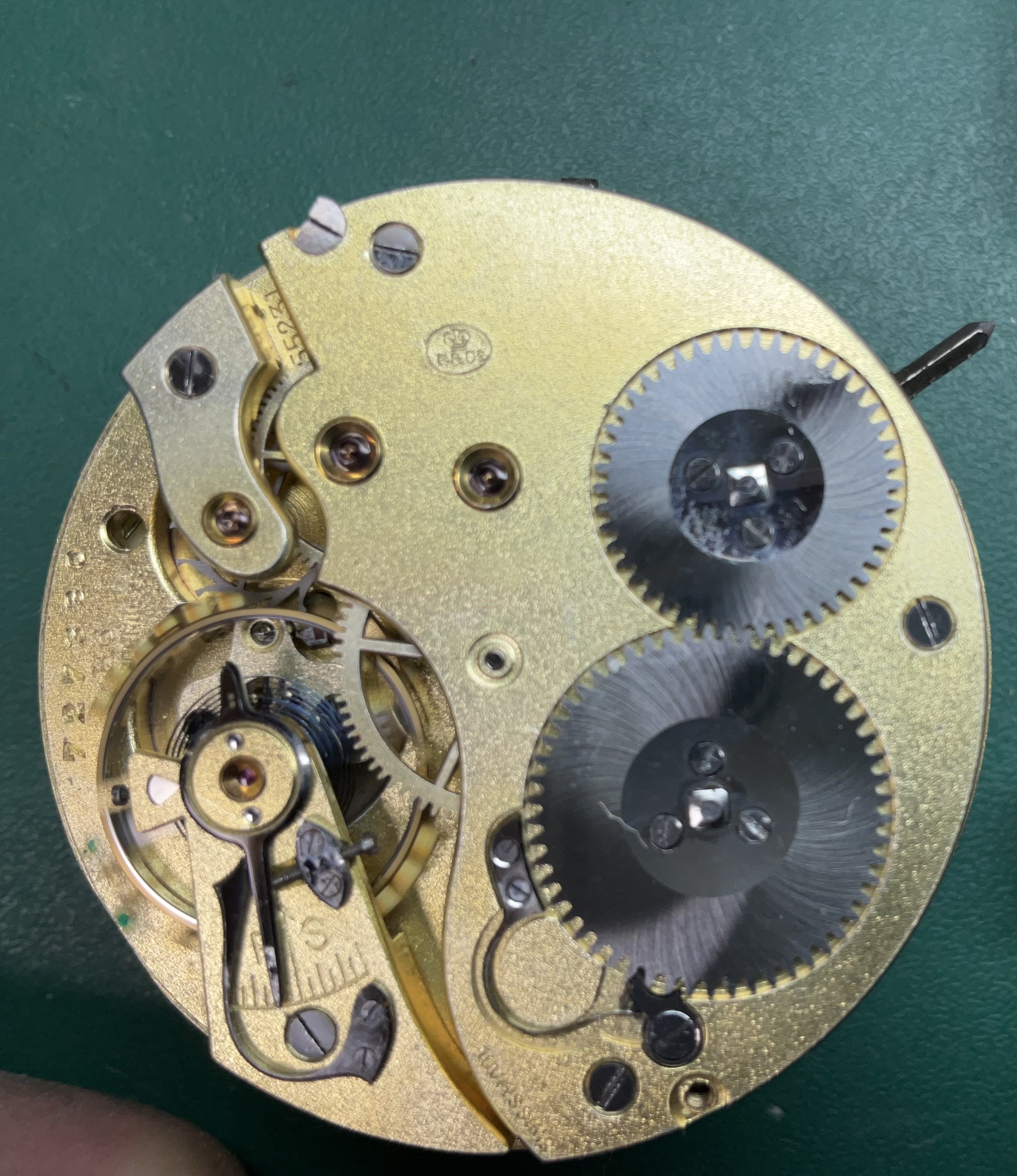

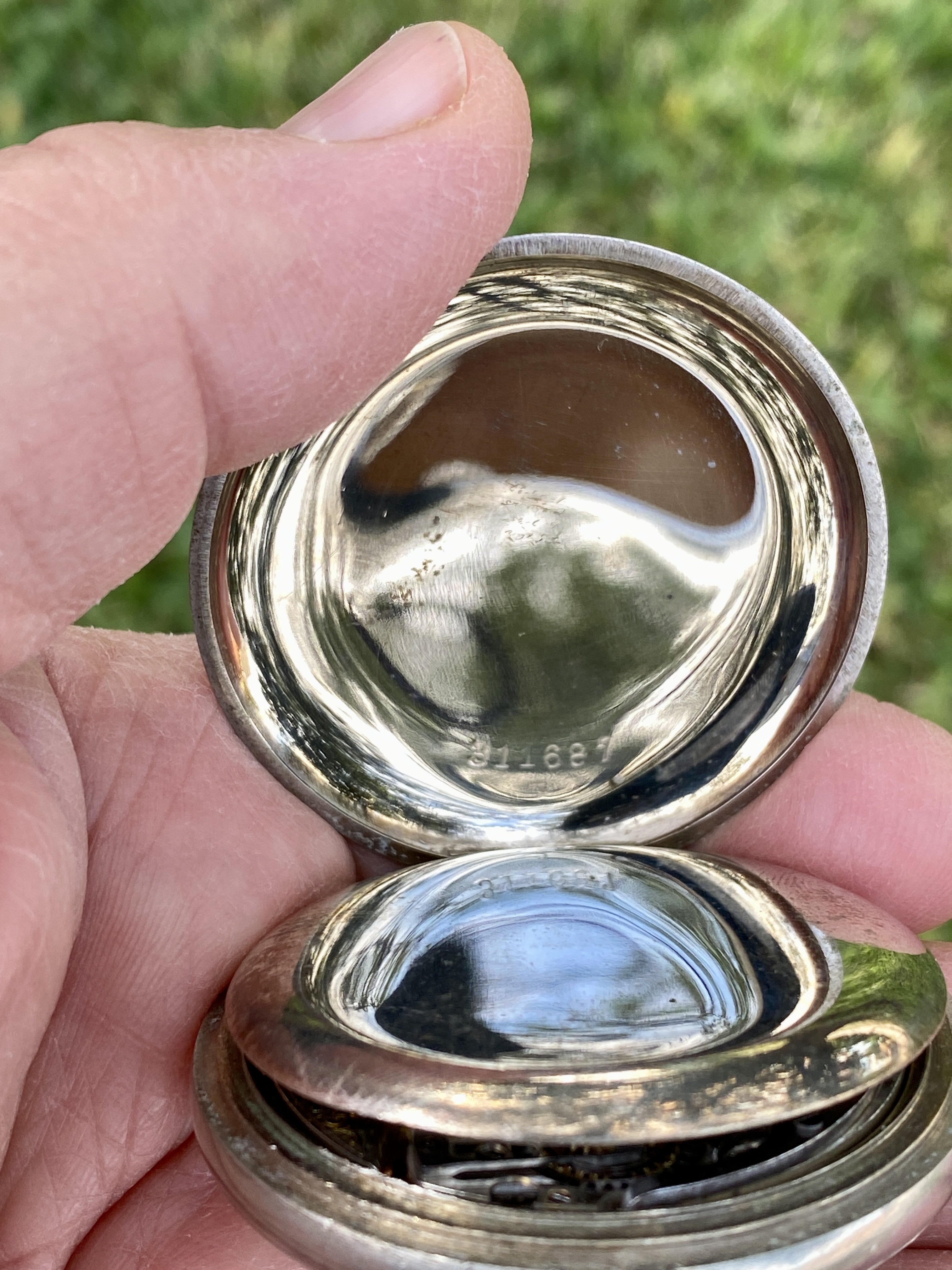

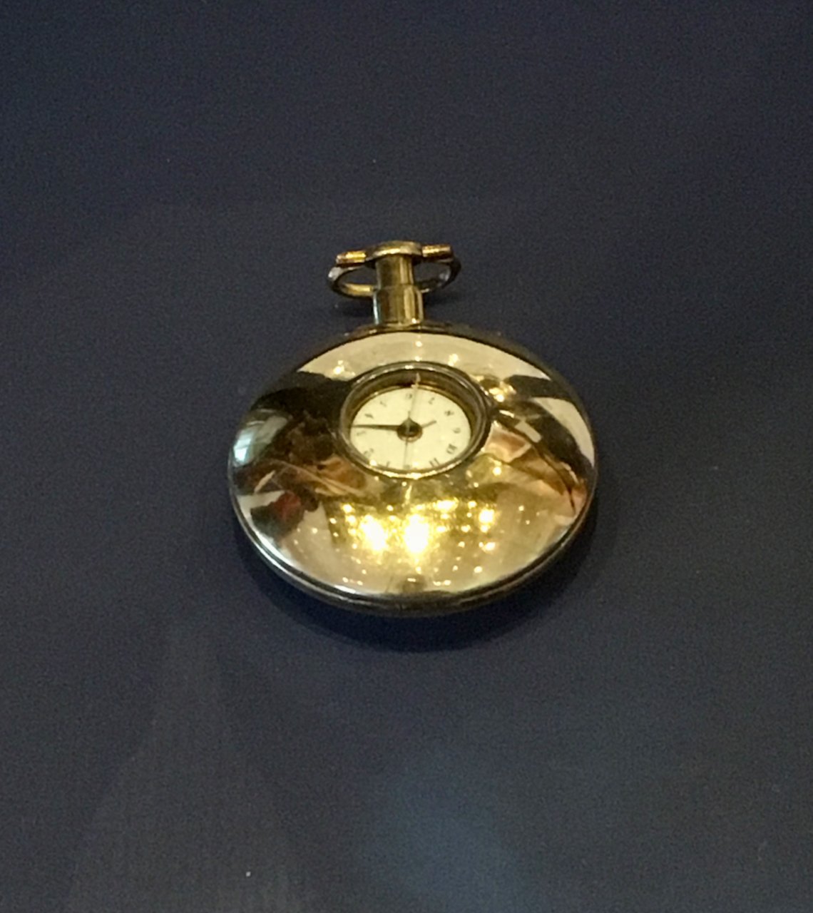

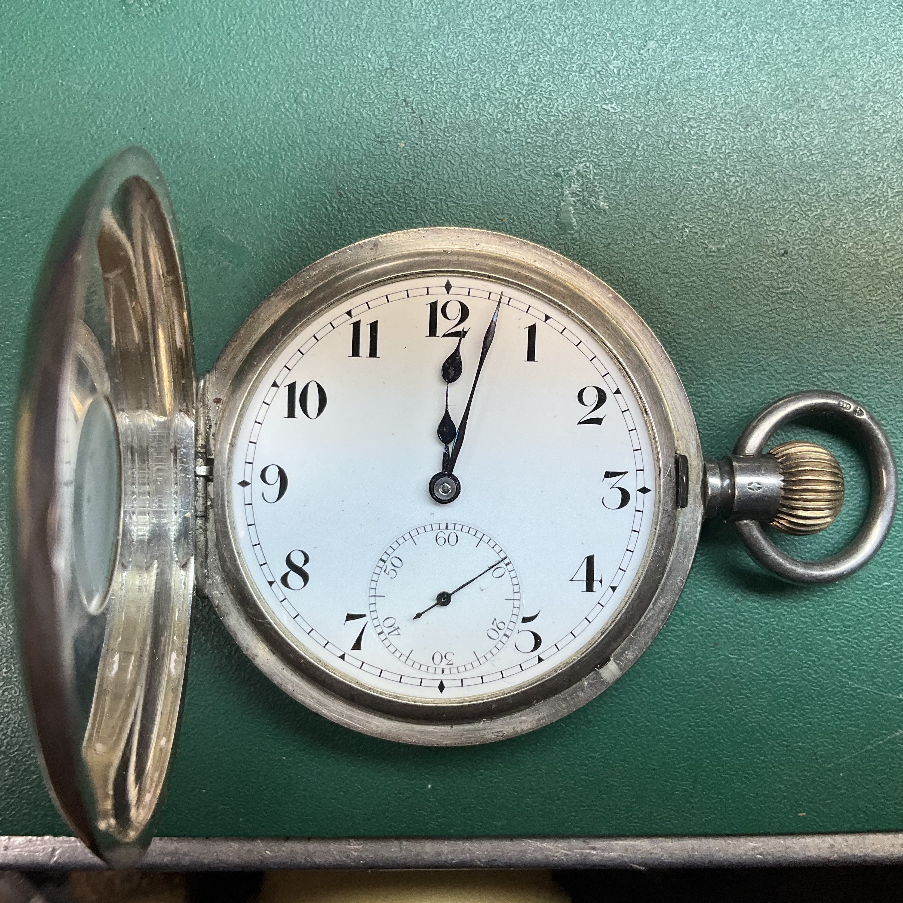

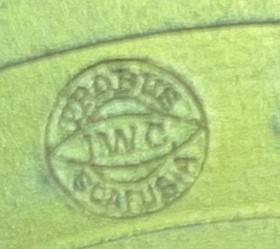

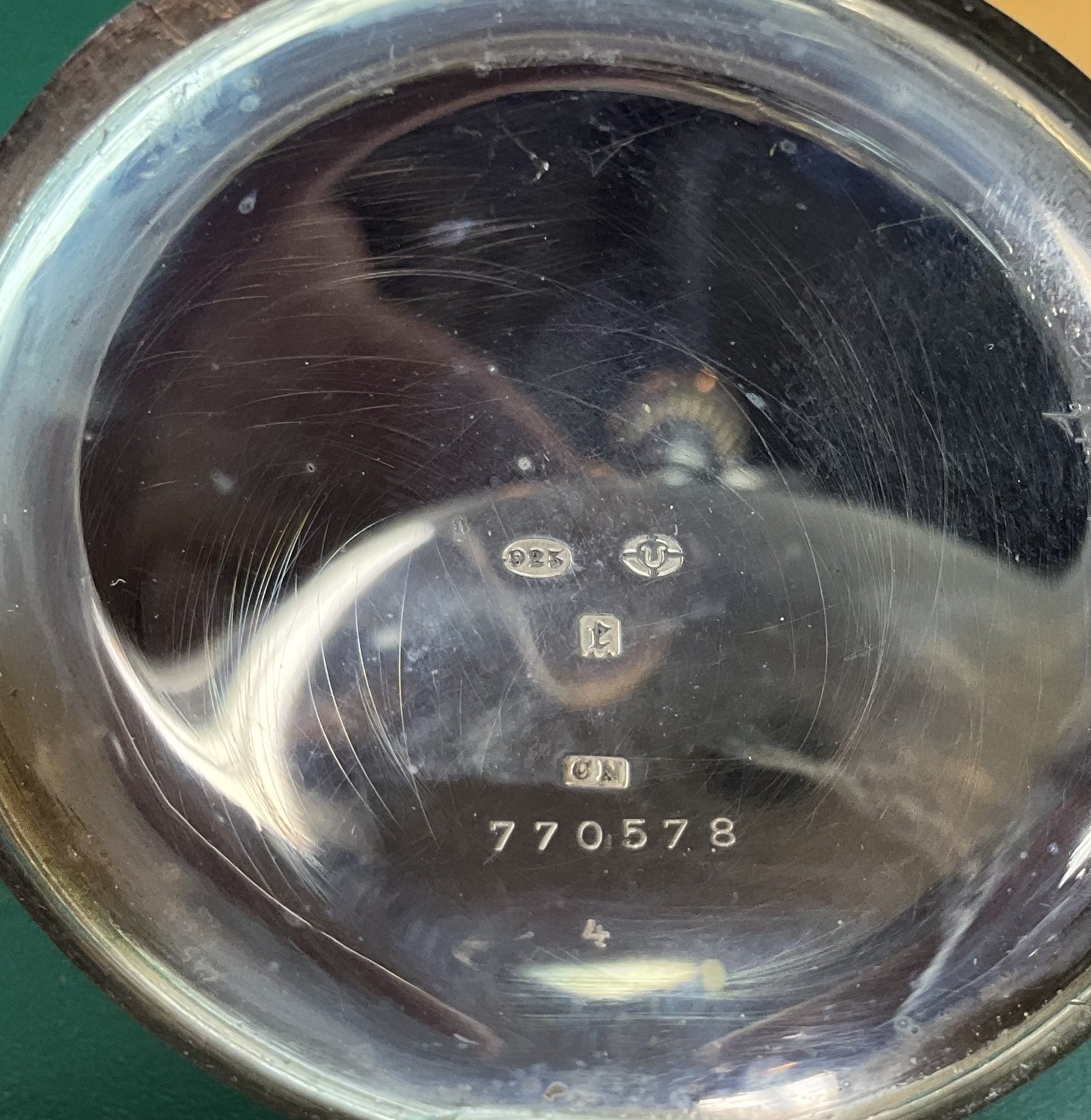

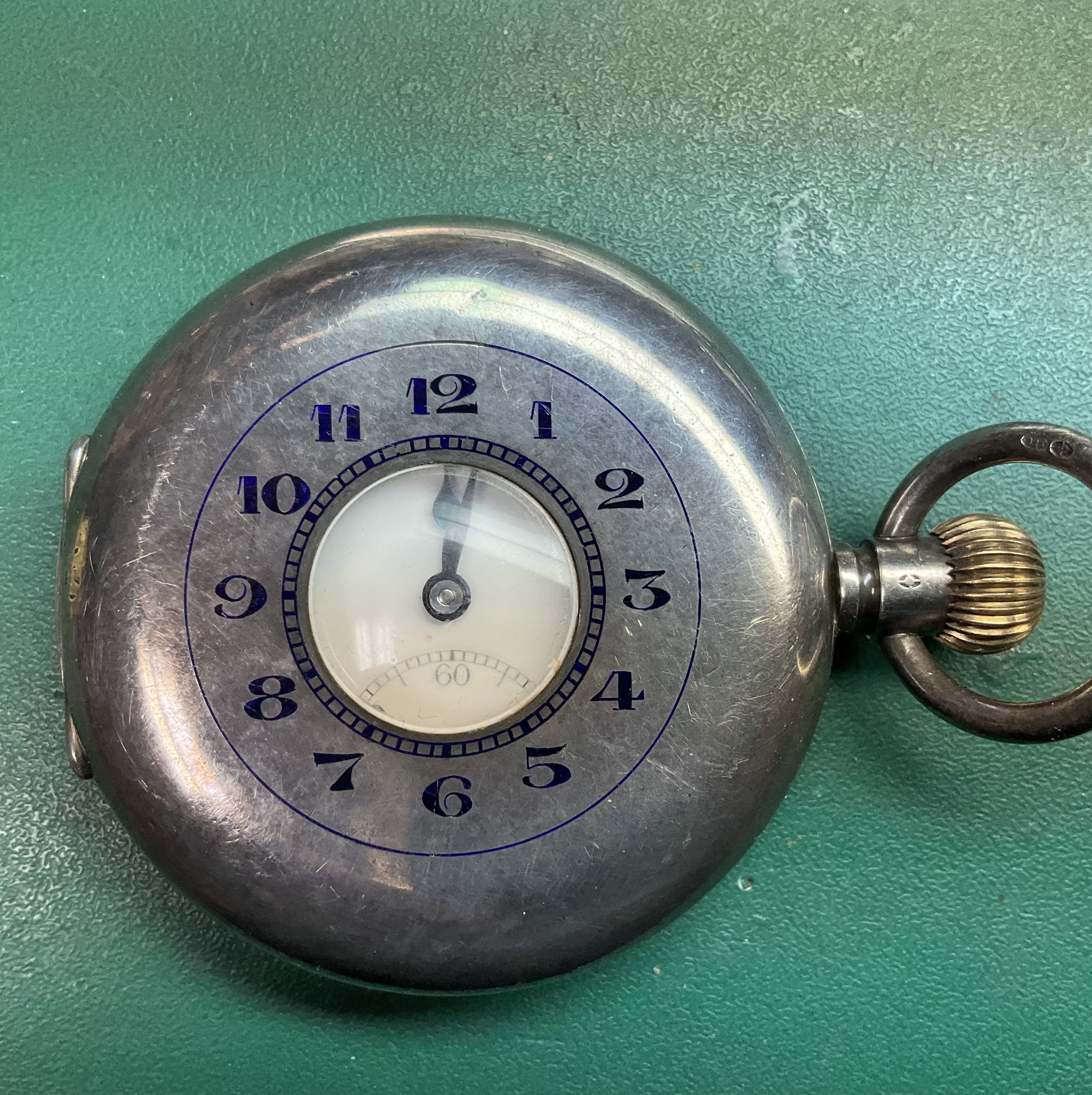

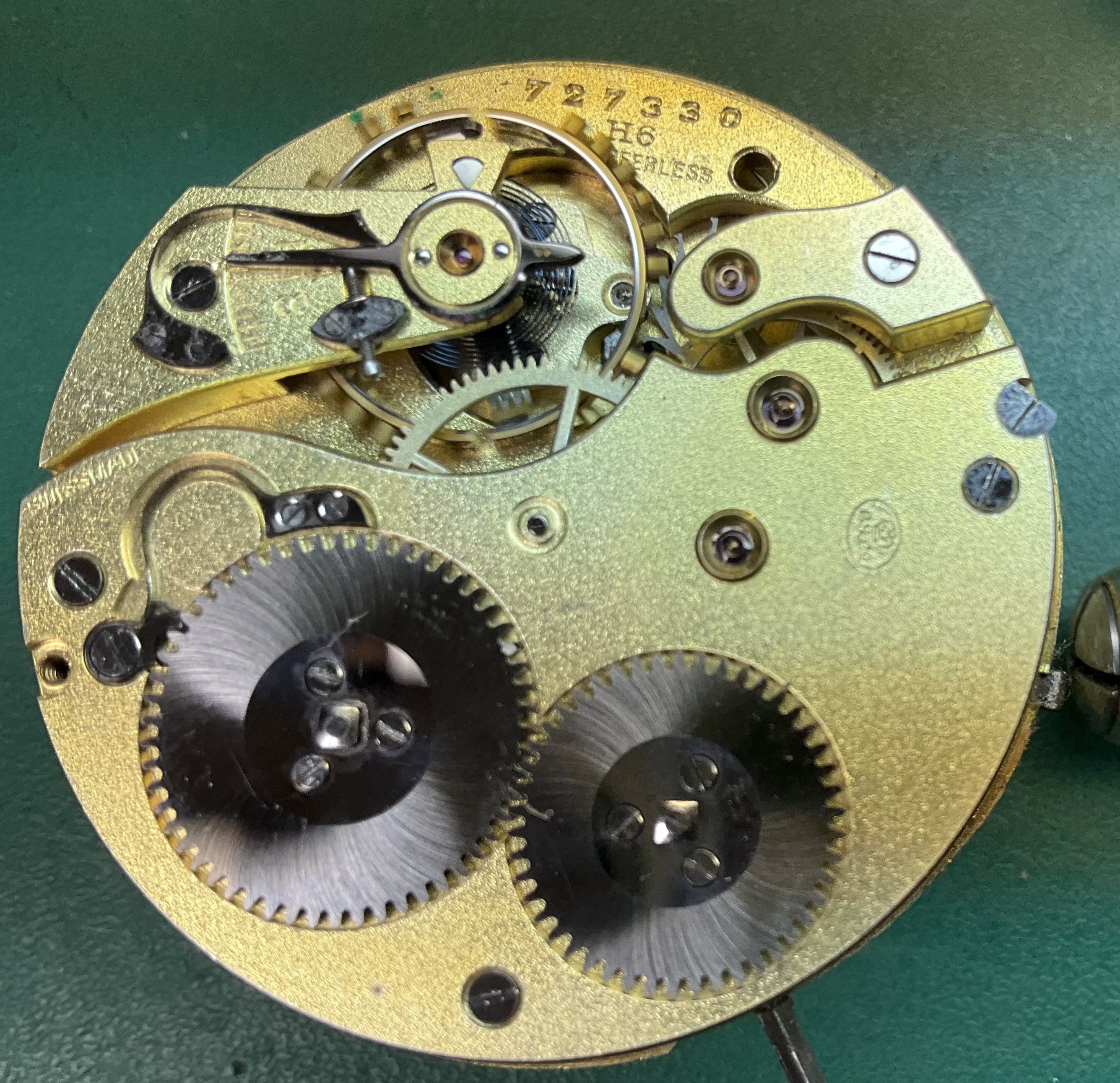

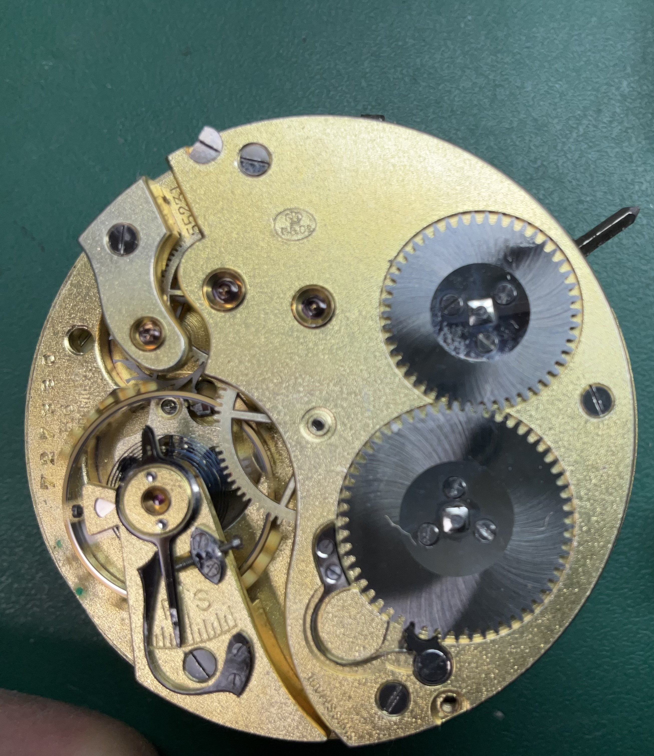

Here is a curious one! It came my way today for possible repair. It was stopped, and fully wound, It had two trade marks that I could see, on the movement. One on the pillar plate, and one on the train wheel bridge. I looked up both trade marks in Mikrolisk, and got a hit for each one. Well, sort of a hit. The Mikrolisk entry on these two trade marks were either not identical, or otherwise, vague! So I pulled the dial. Voila! A definite hit! The watch was made by the International Watch Co., Schaffhausen, Switzerland, I have shown numerous images of these trade marks, but the only one that is relevant is the IWC one. The IWC trade mark shows in Mikrolisk as PROBUS IWC SCAFUSIA which clearly shows in the one picture.
https://en.worldtempus.com/article/industry-news/business/iwc-probus-scafusia-14381.html

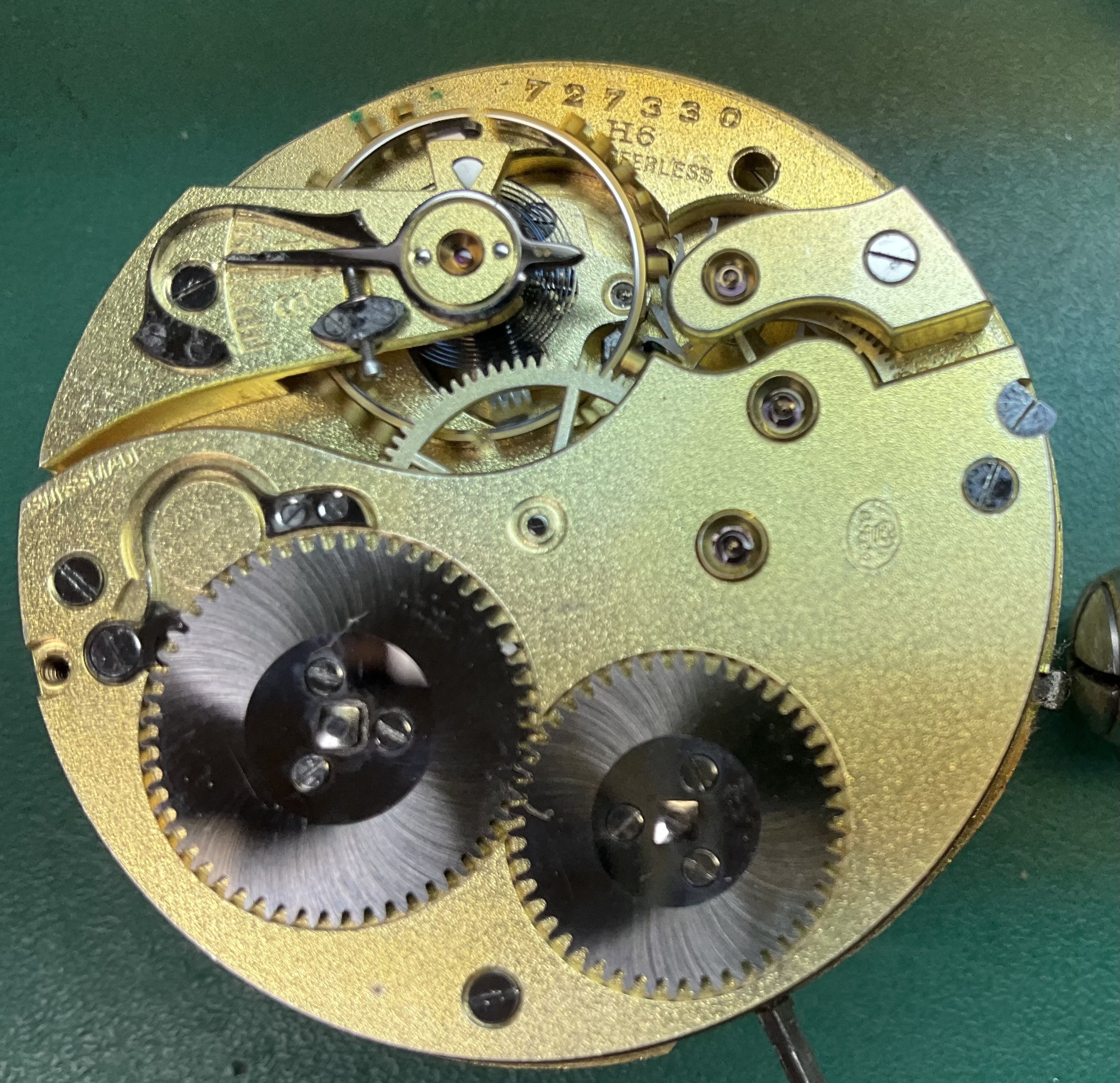

The movement is in excellent condition, and it shows many of the earmarks of other high quality Swiss watches. The one trade mark inside the case back indicates .925 (sterling), and one other trade mark indicates the case was imported into England from Switzerland. The hunter case is known as a Demi-hunter, of half hunter. Because of the window, you don’t need to open the case to read the time. Hence the curious hour hand.
The reason it quit is that one of the case screws had come out and was buried in the gear train. I coaxed it out, put the watch back together, and left it running. It should be cleaned but I’ll call the dude and see what his pain threshold is like!

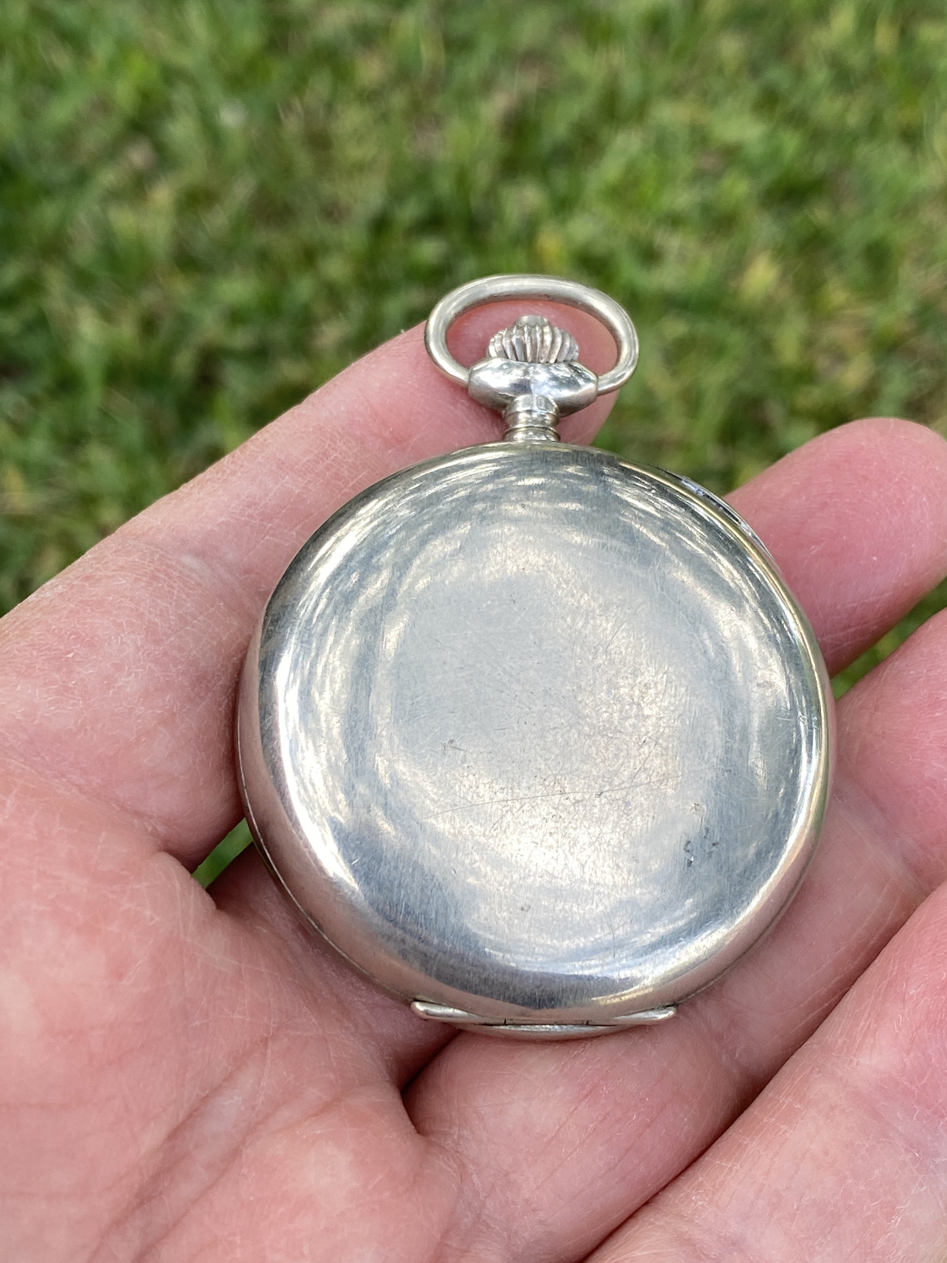

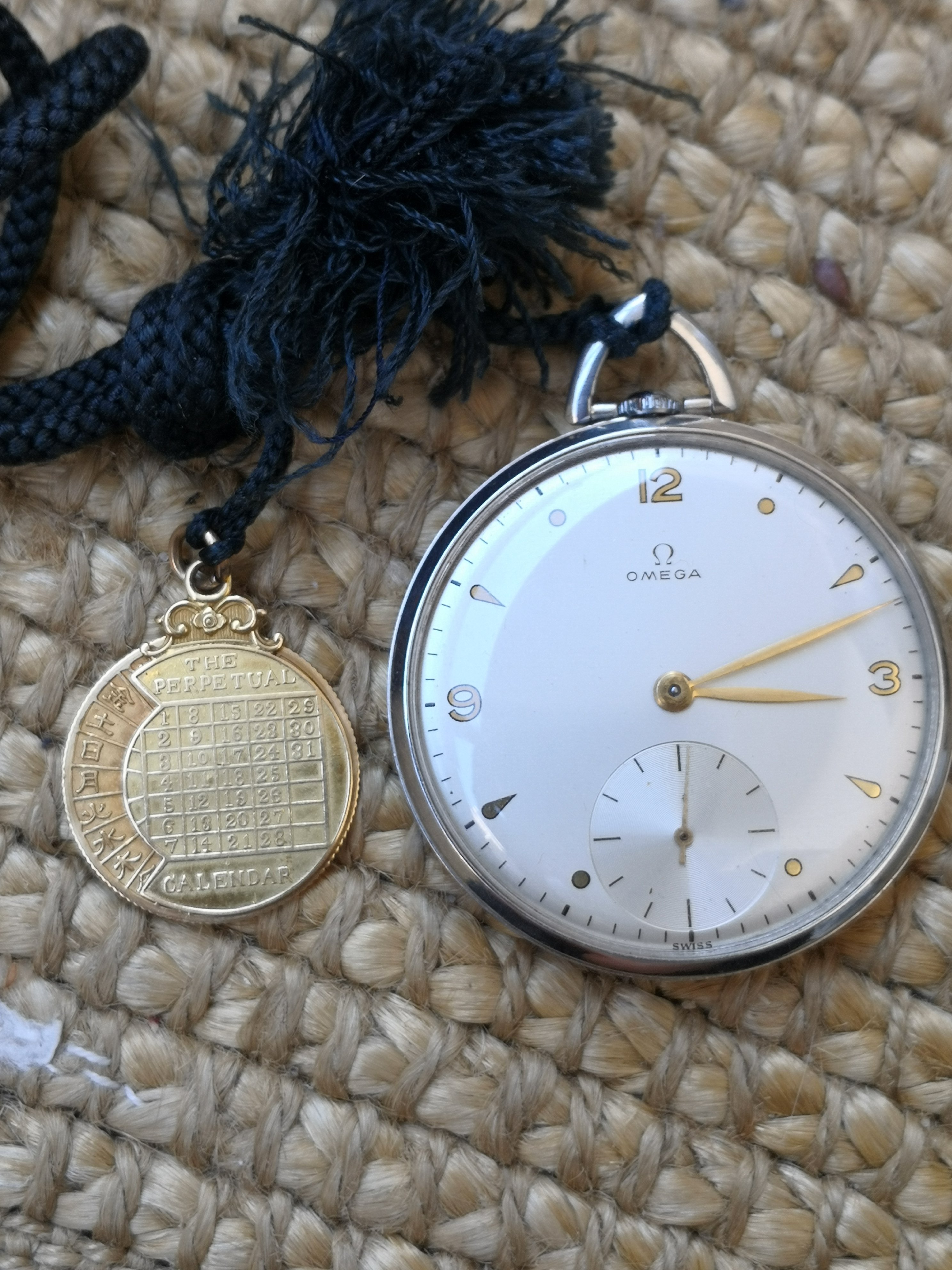

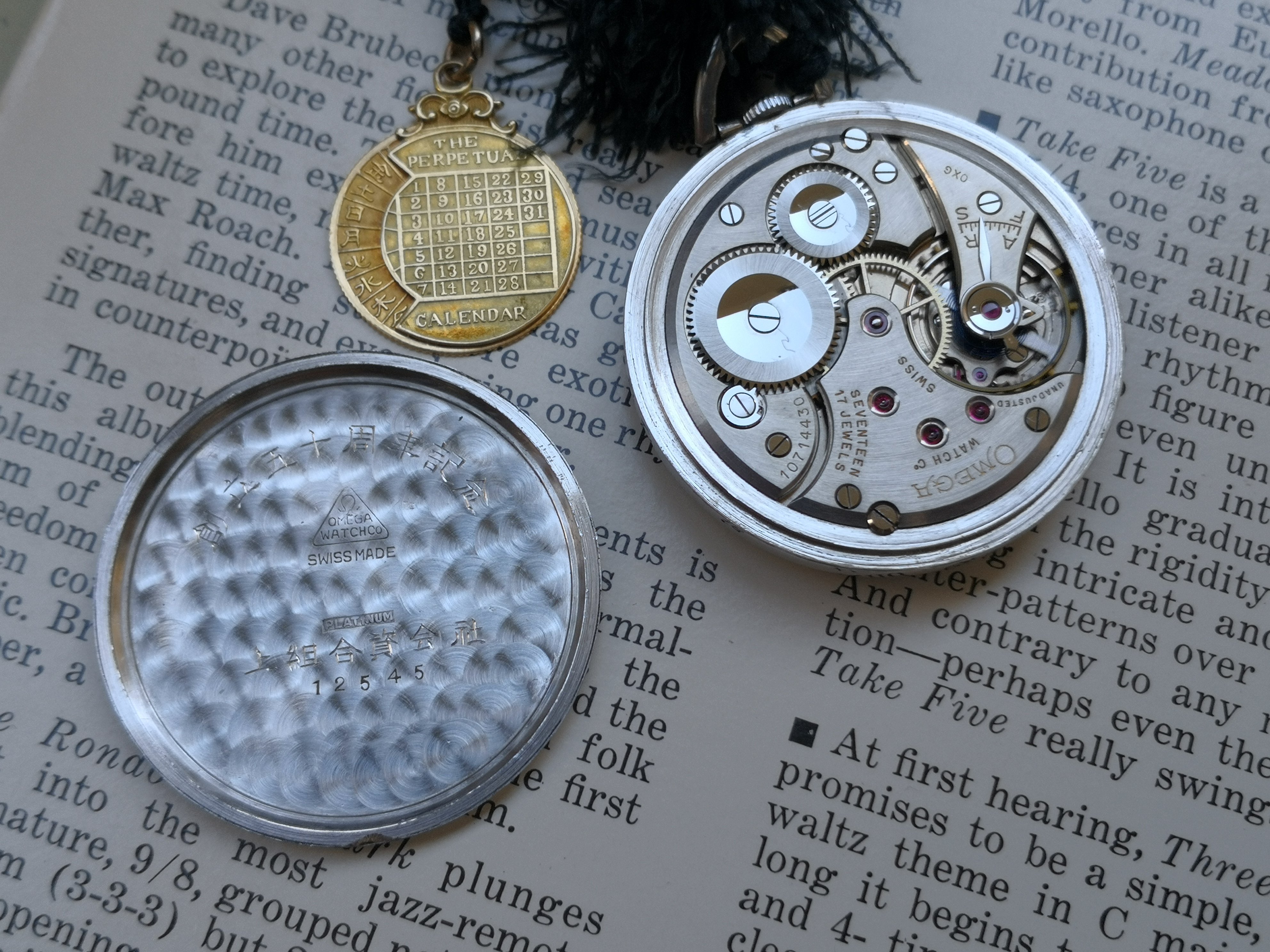

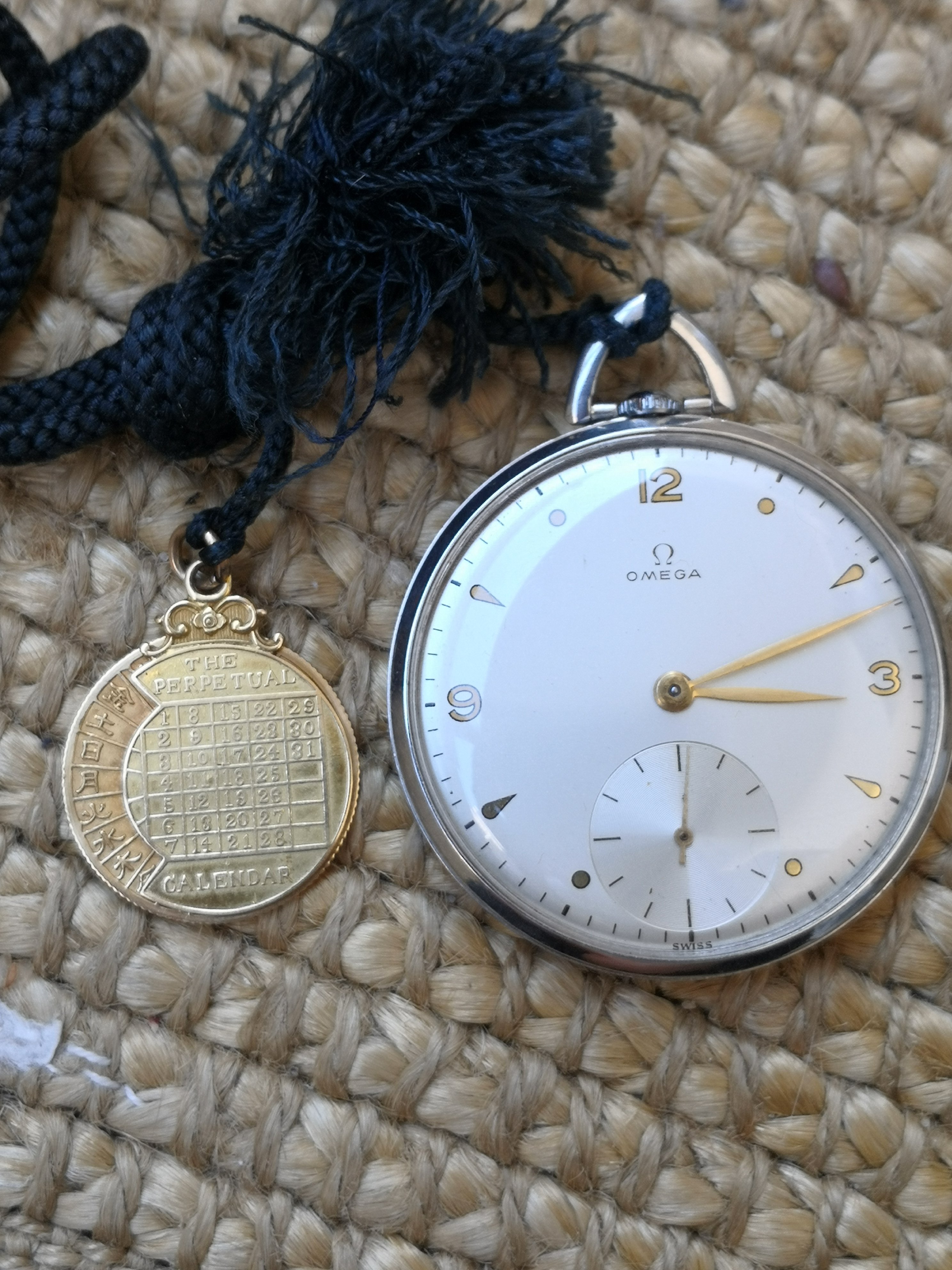

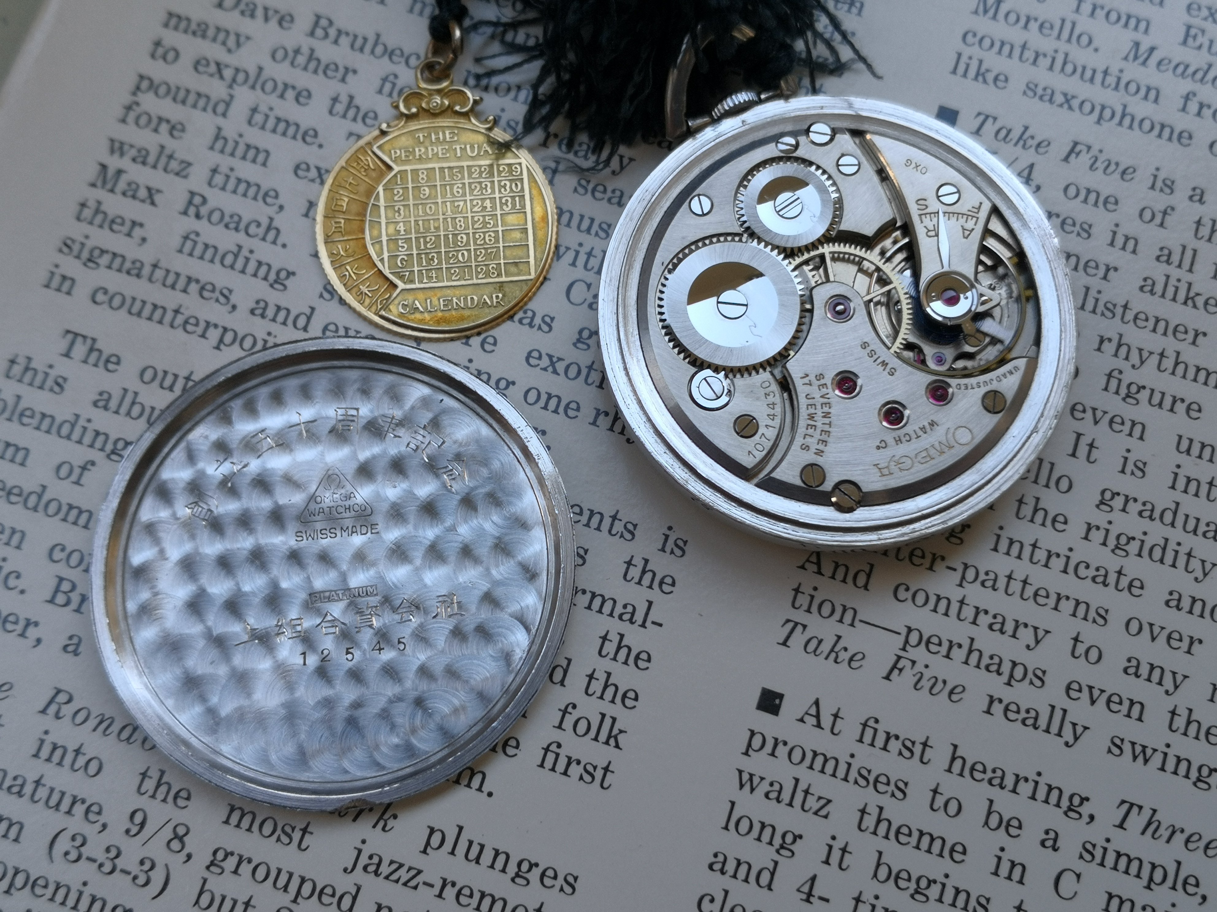

My first and so far only pocket watch, and a rare one i would guess... A 1945/46 Omega 37.5 T1 in Platinum, together with an japanese perpetual calendar in 18k Gold. A jubilee gift to an employee in Japan.
Does anyone here know more about how rare Omega pocketwatches in platinum really are?
Beautifully finished parts, especially the regulator and click spring.
My initial impression when I opened the case was that it was a quality watch. The finish on the winding wheels and the other steel parts seemed to indicate that it is a quality watch. But it wasn’t until I saw the IWC trade mark that I twigged.

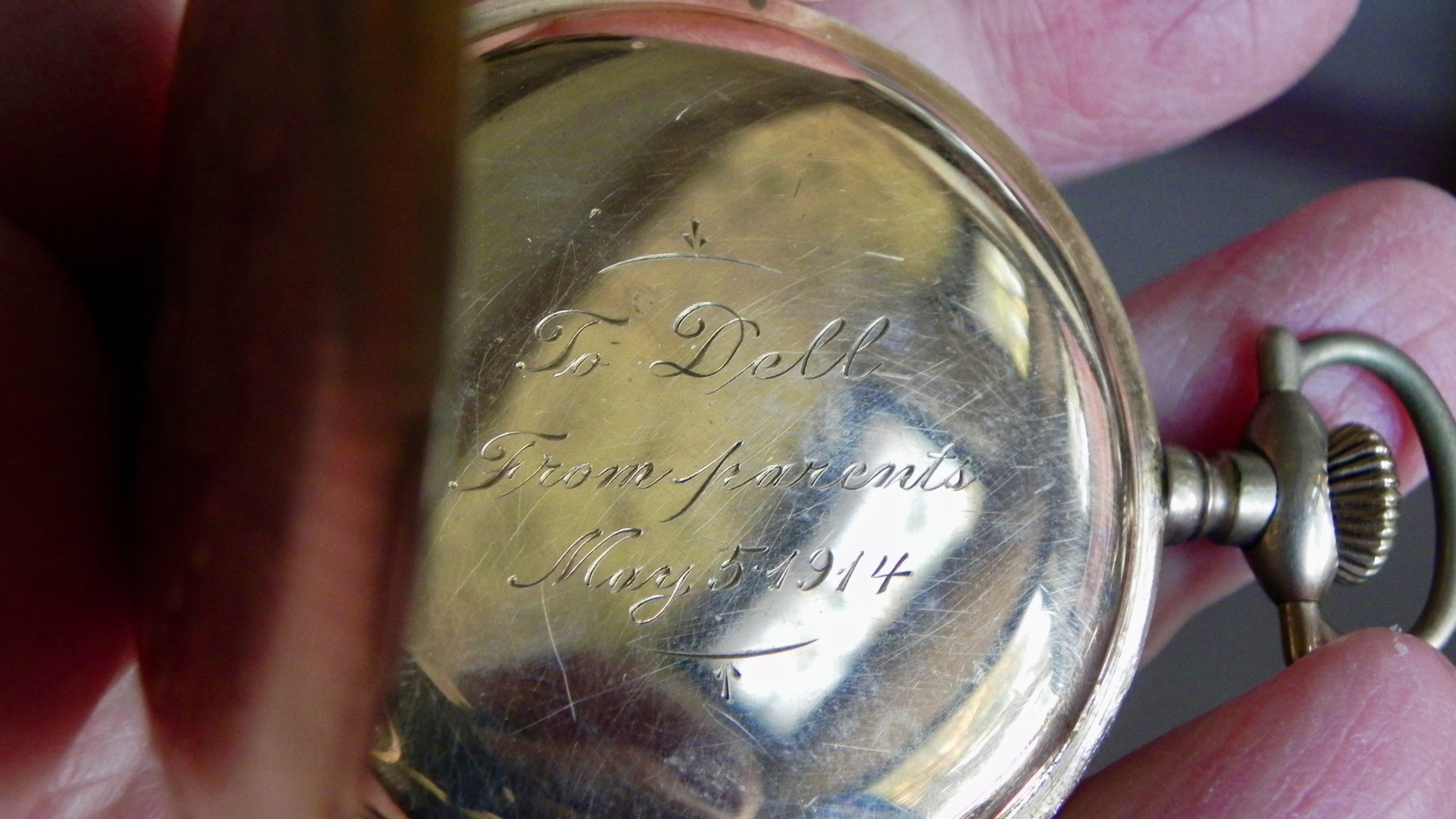

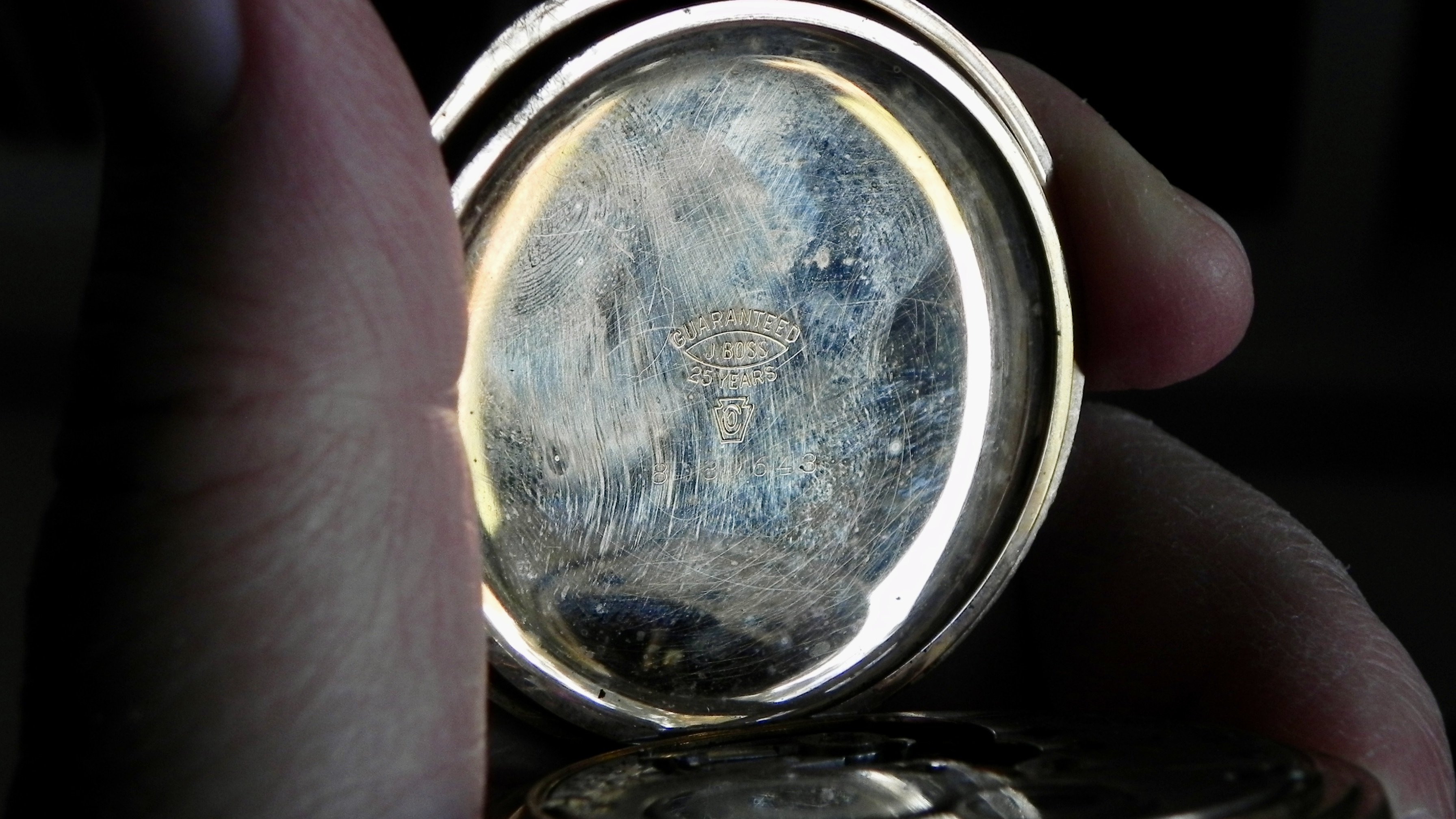

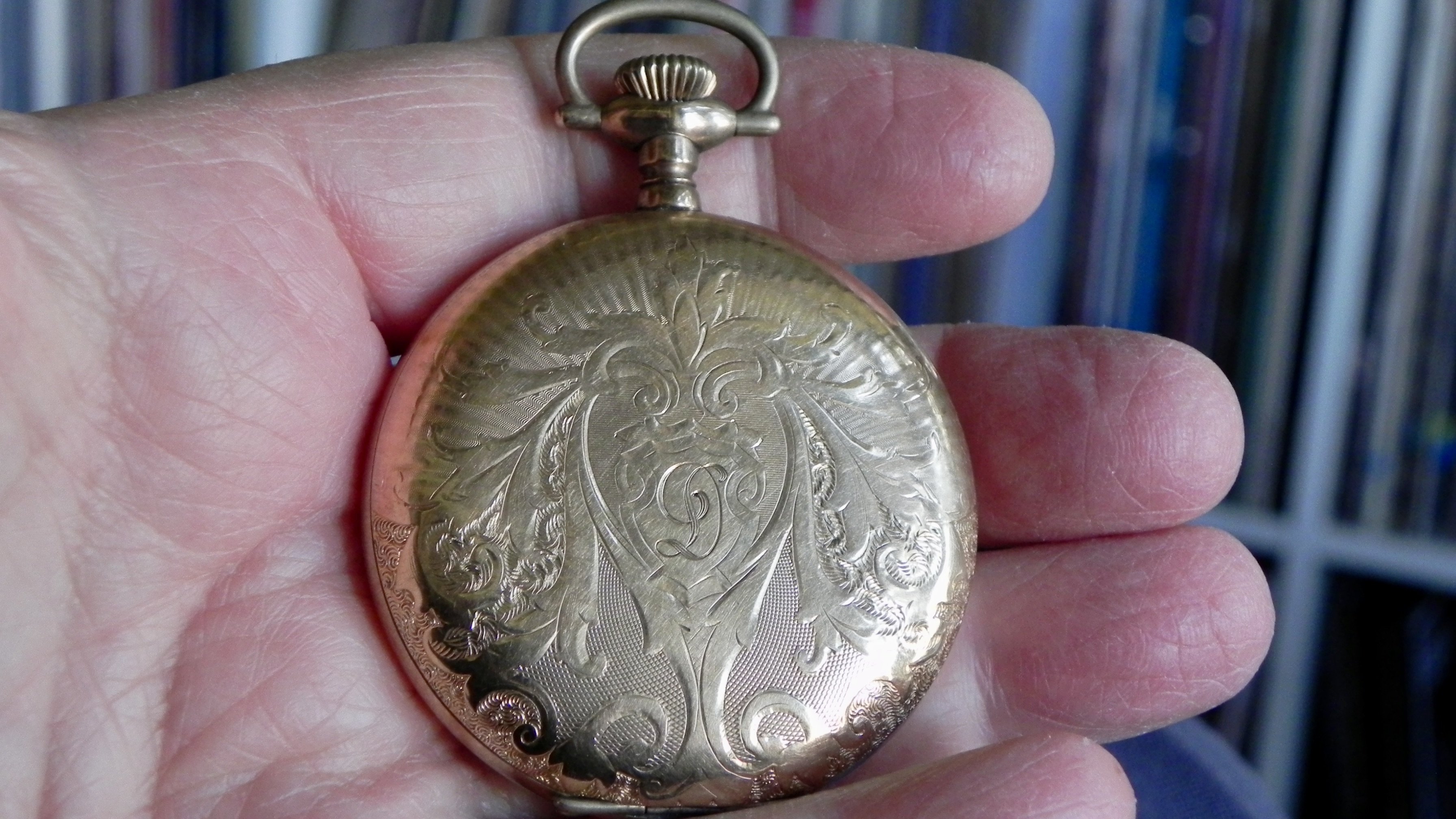

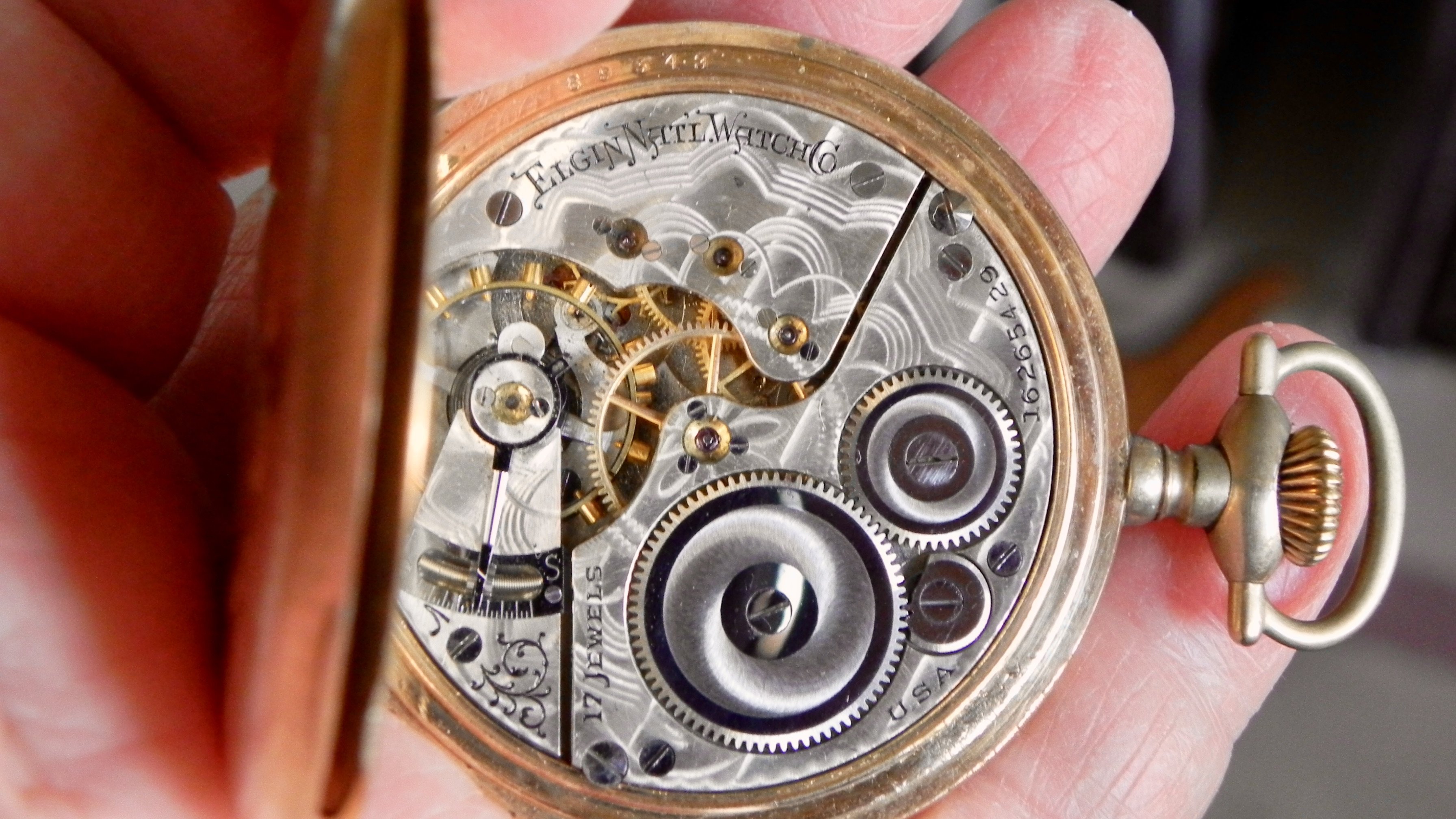

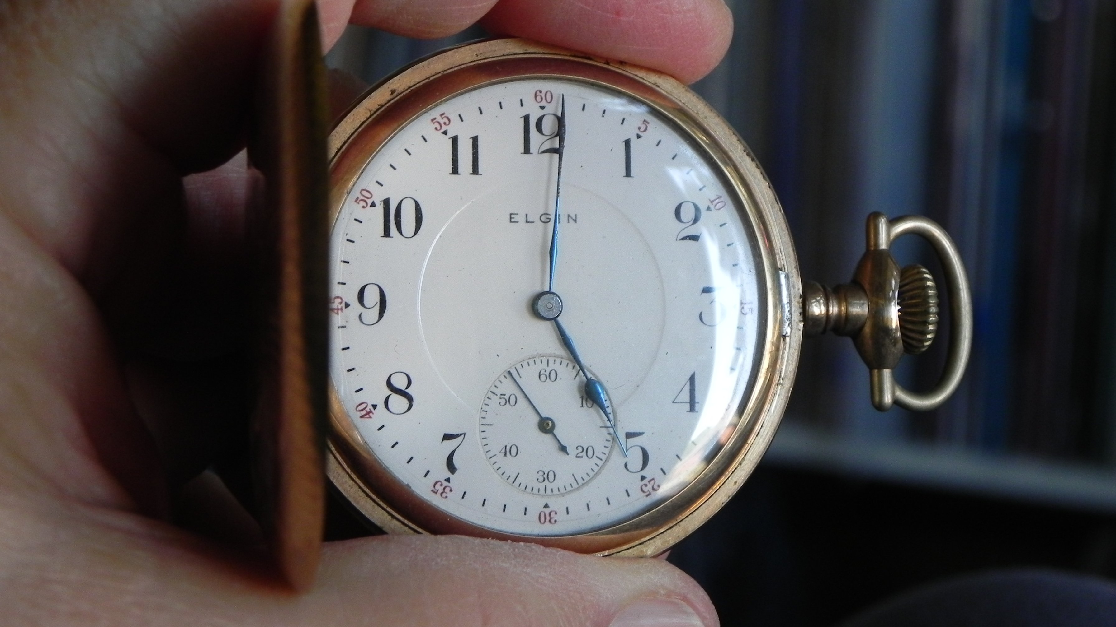

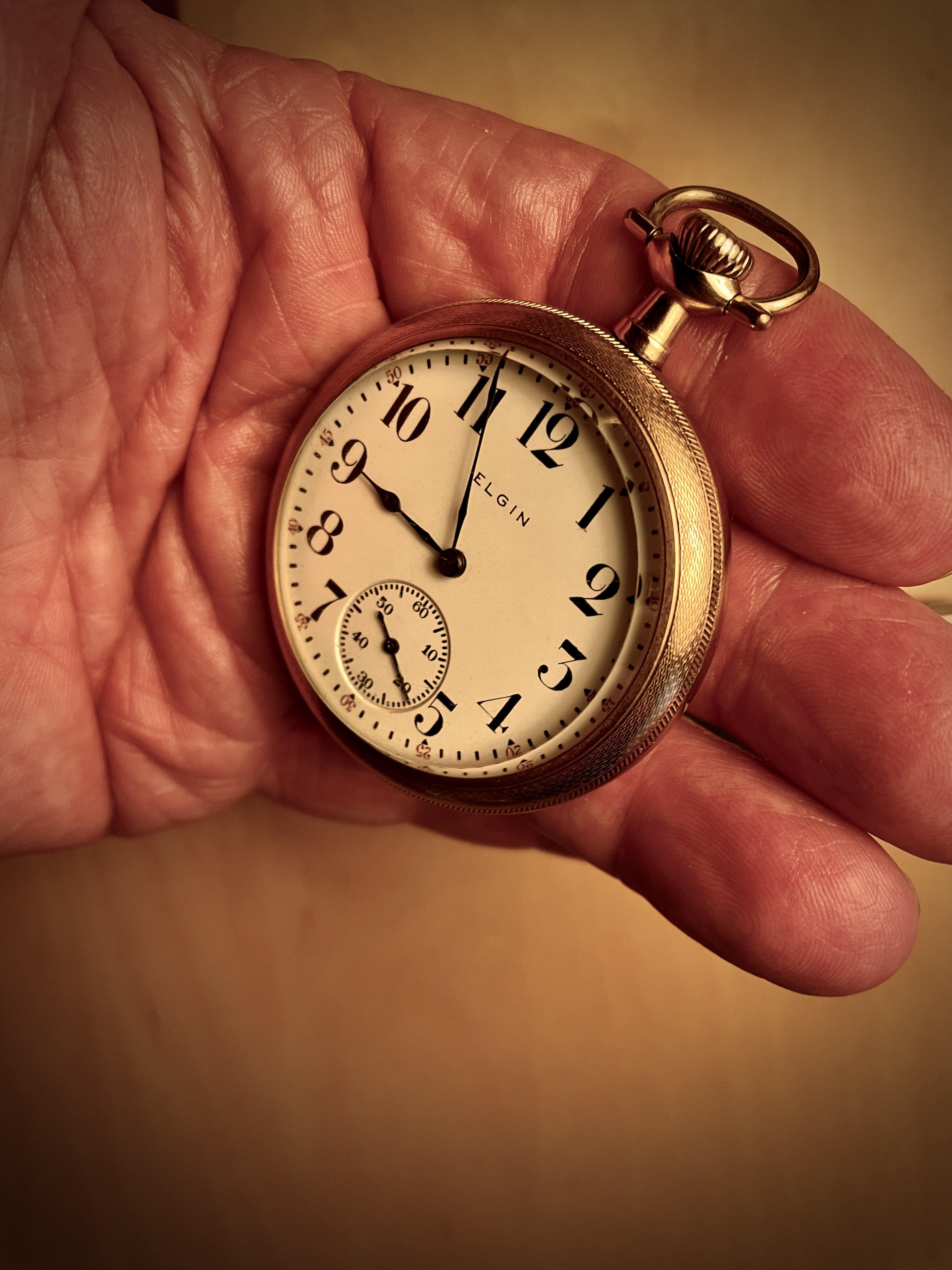

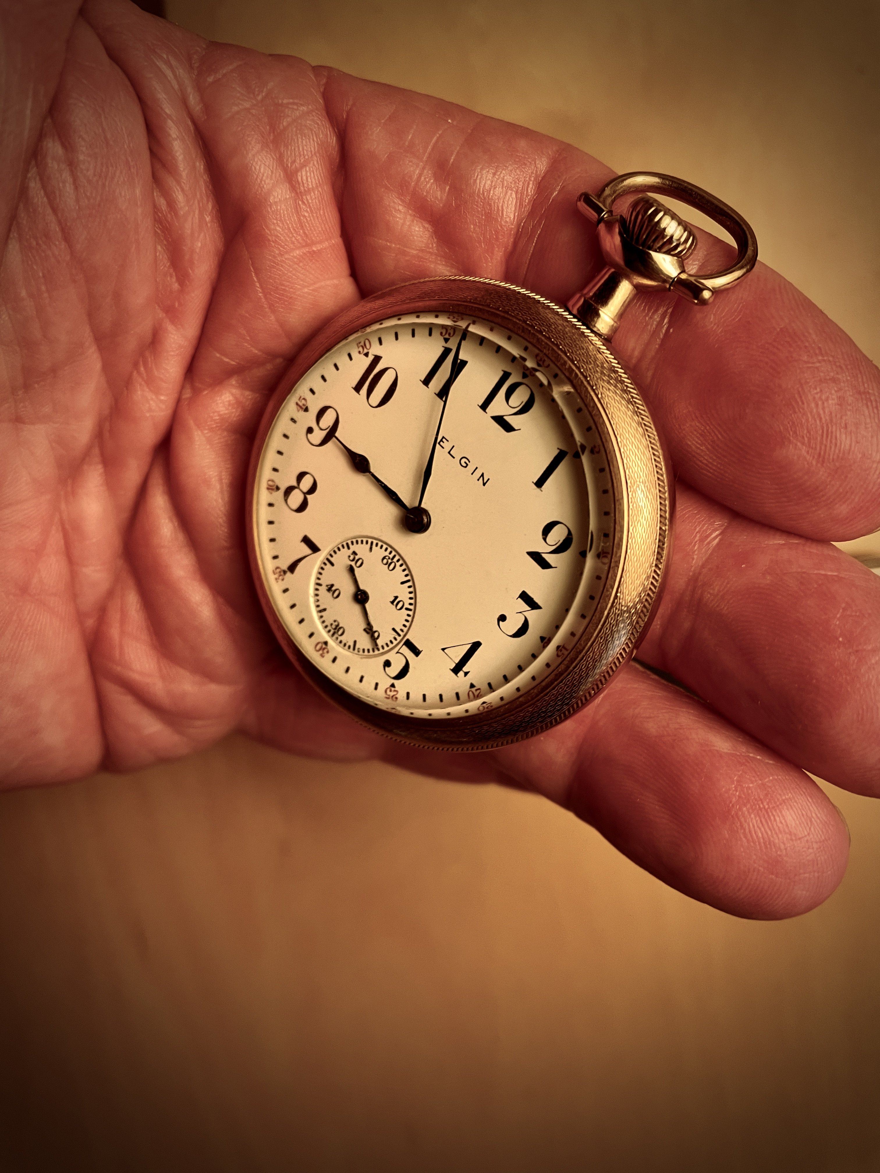

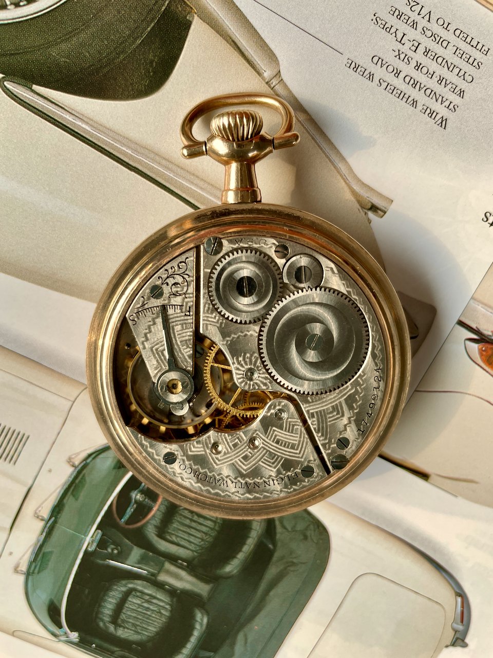

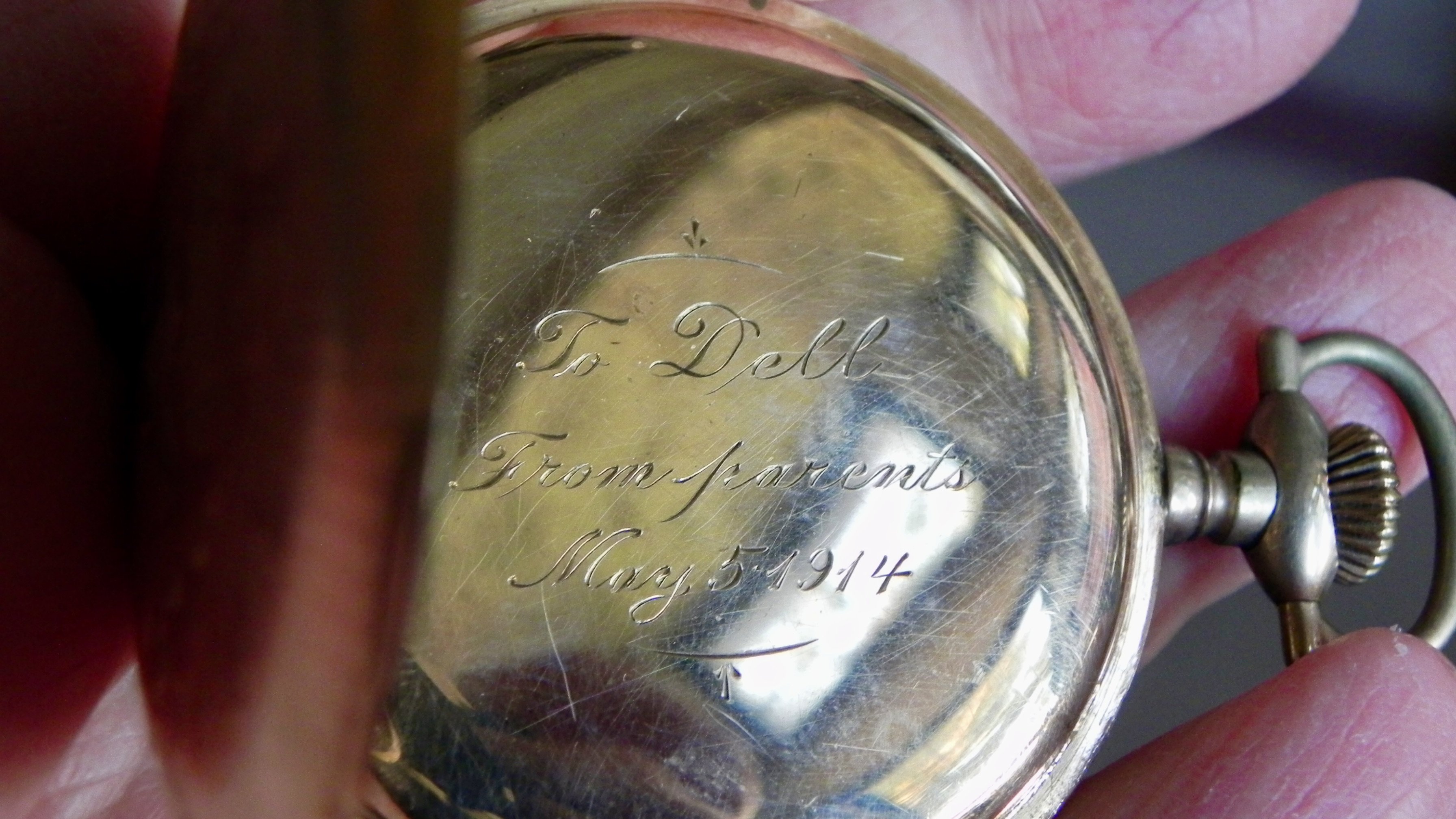

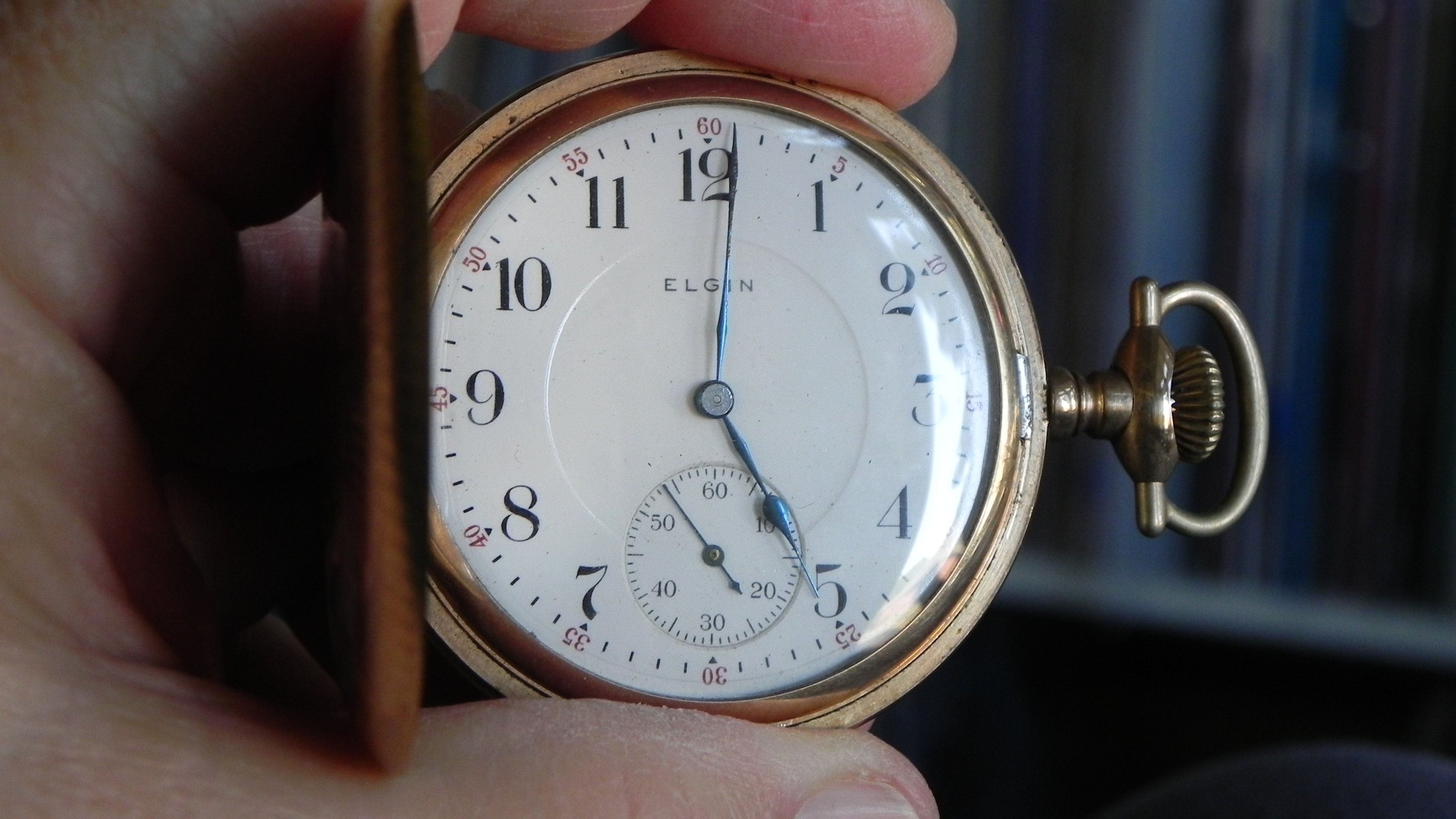

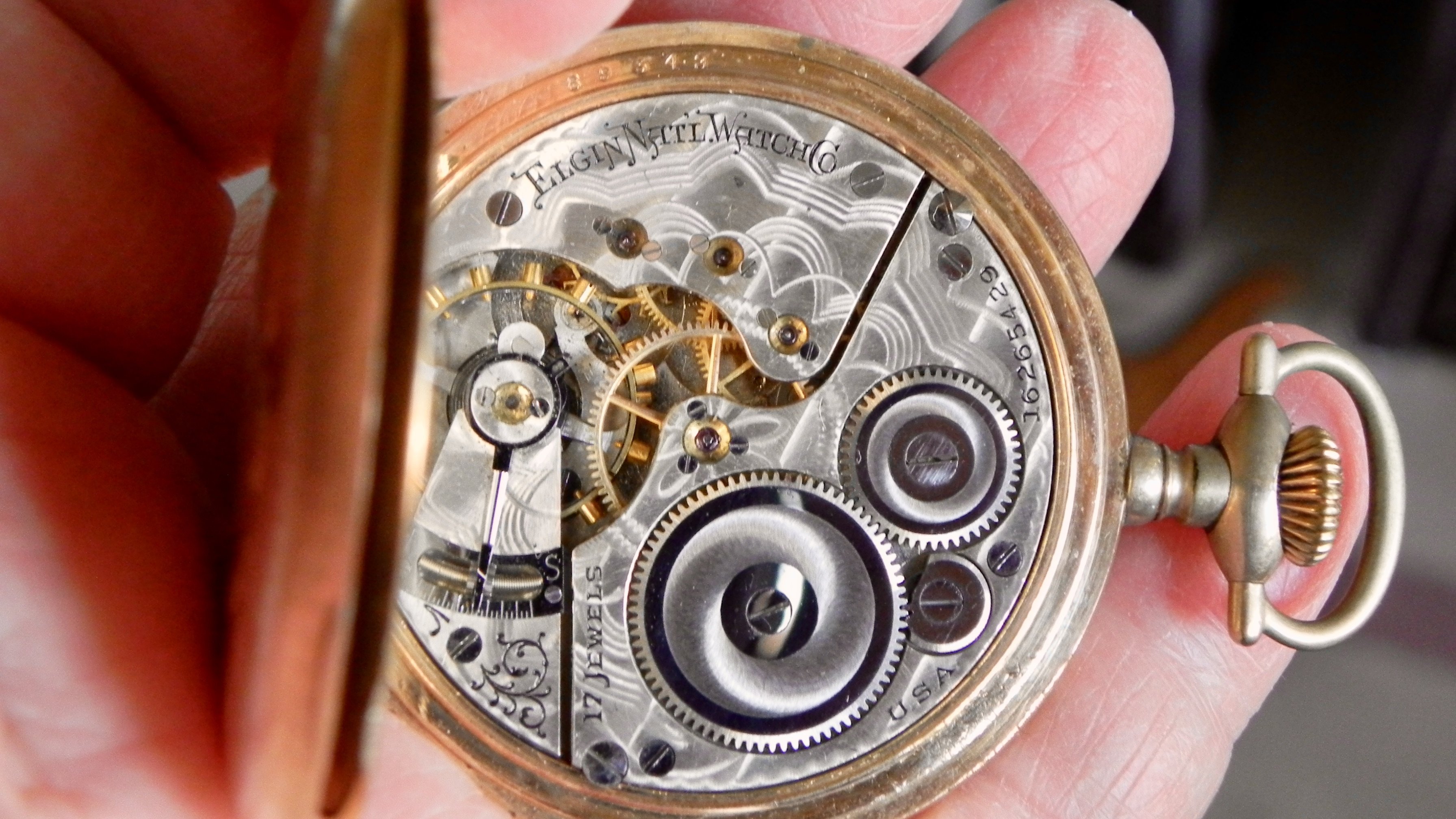

Elgin National Watch Co.

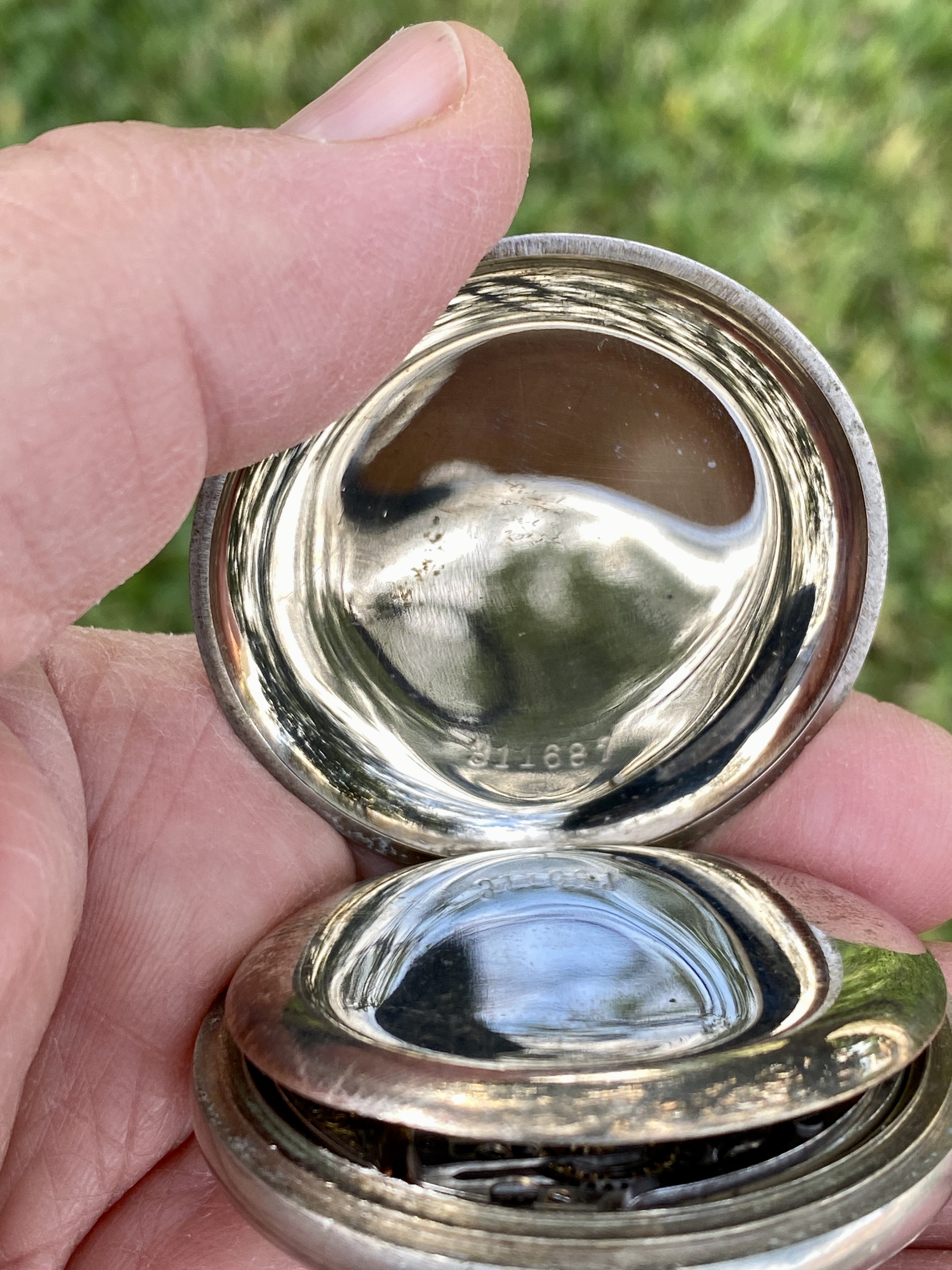

16s 17j grade 386 Year: 1912.......inscription: 1914
Solid workingman's/student watch

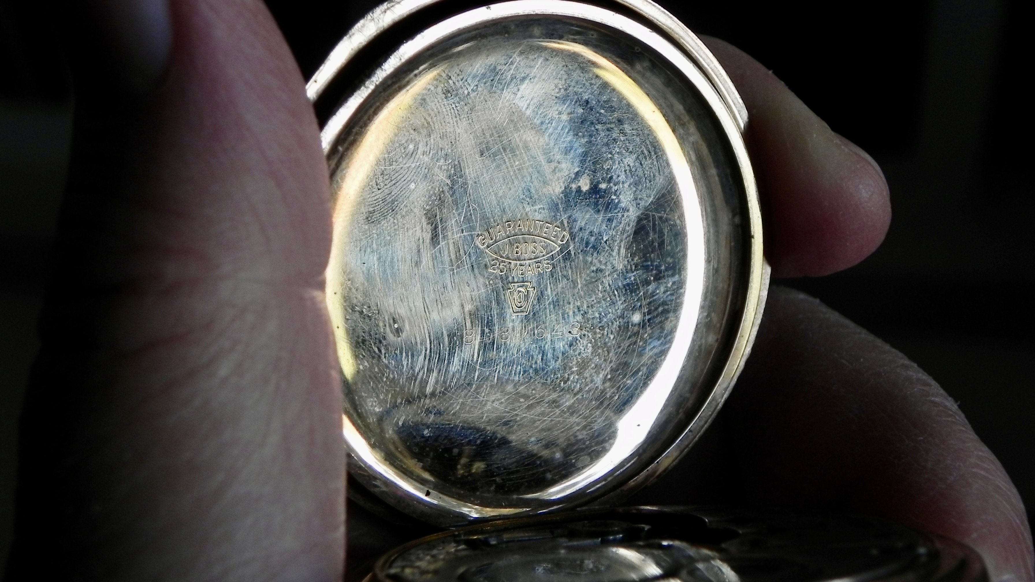

Elegant Keystone J. Boss GF hunter case

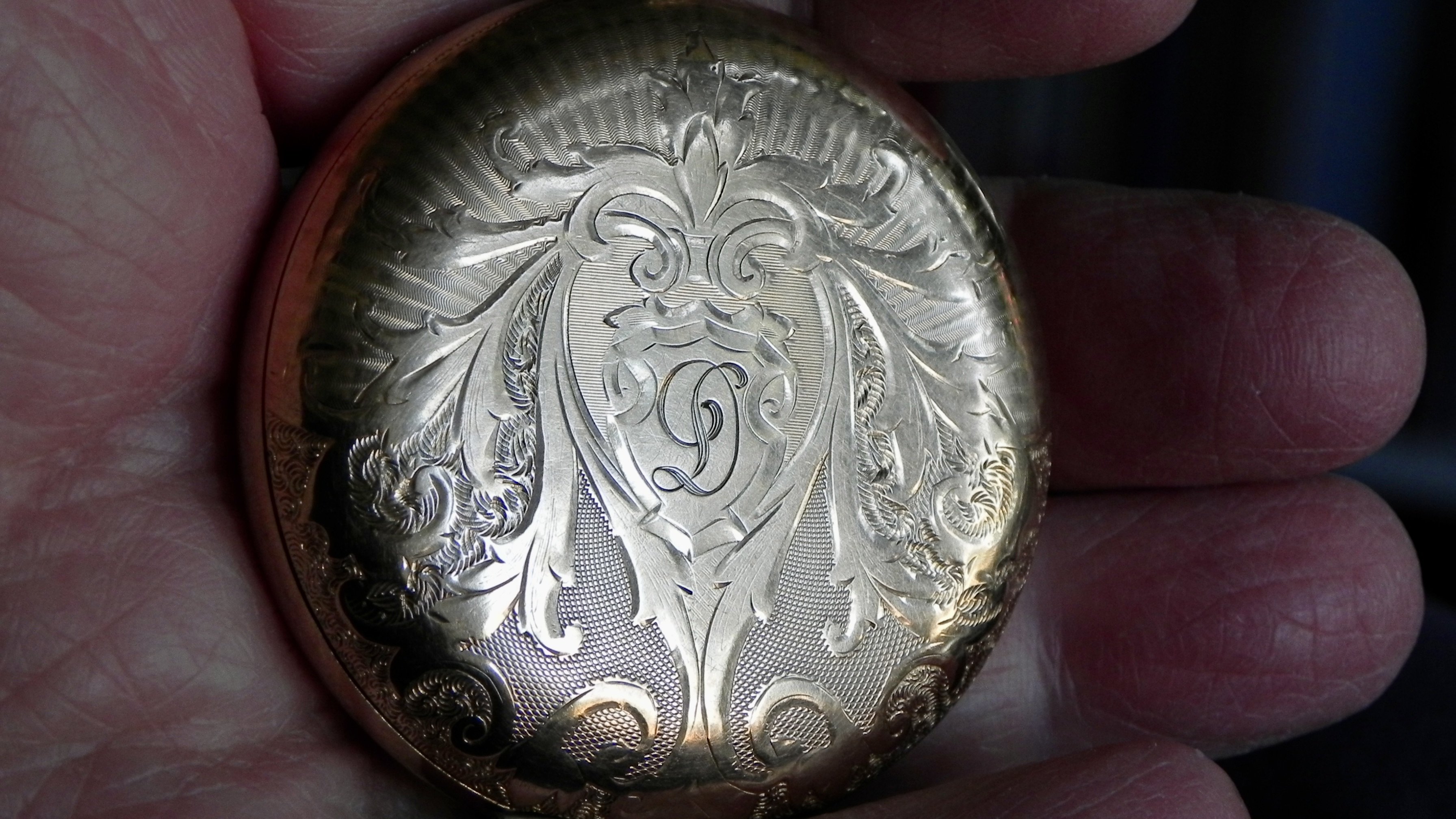

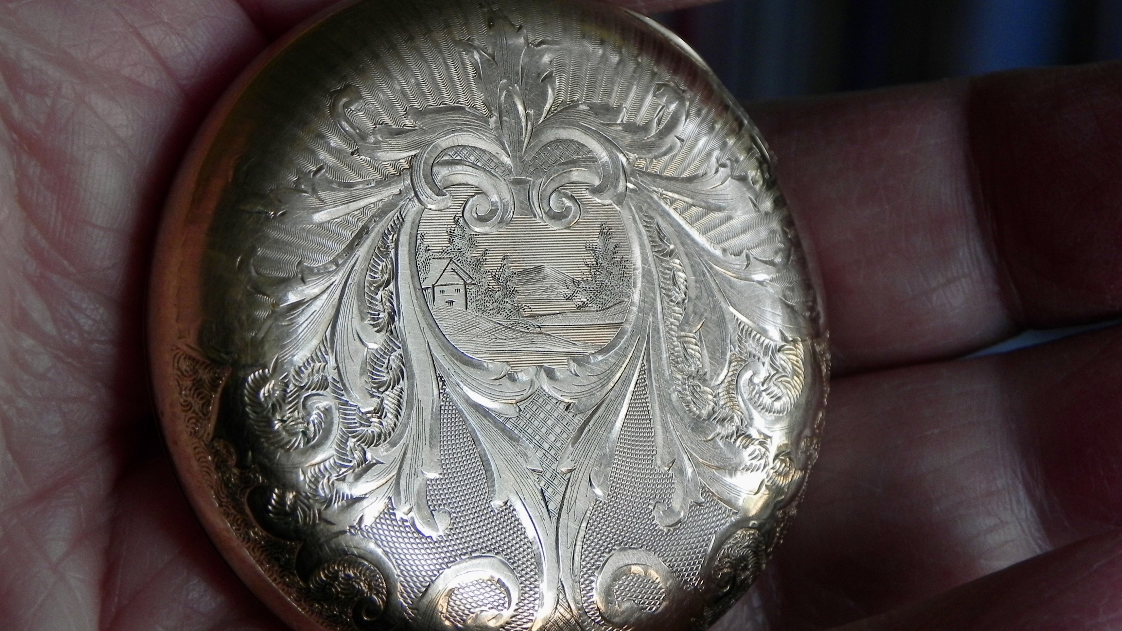

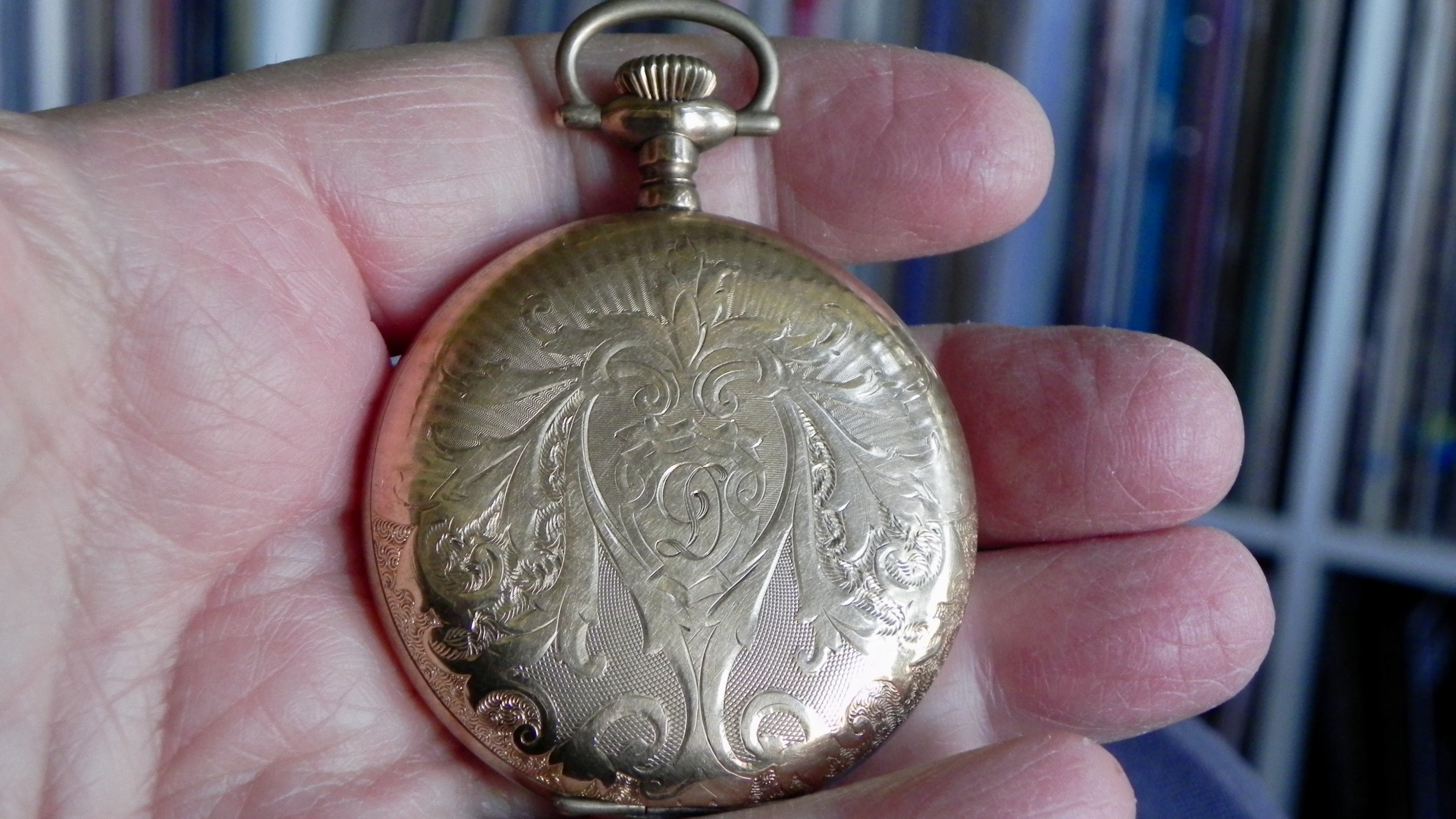

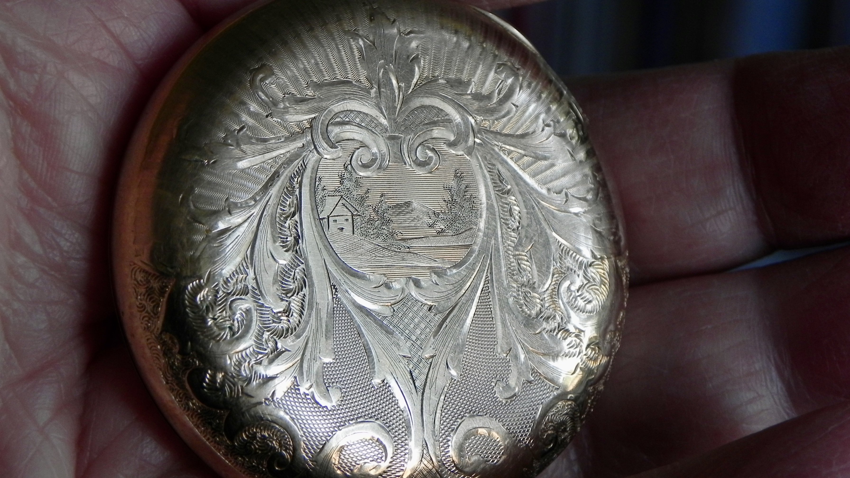

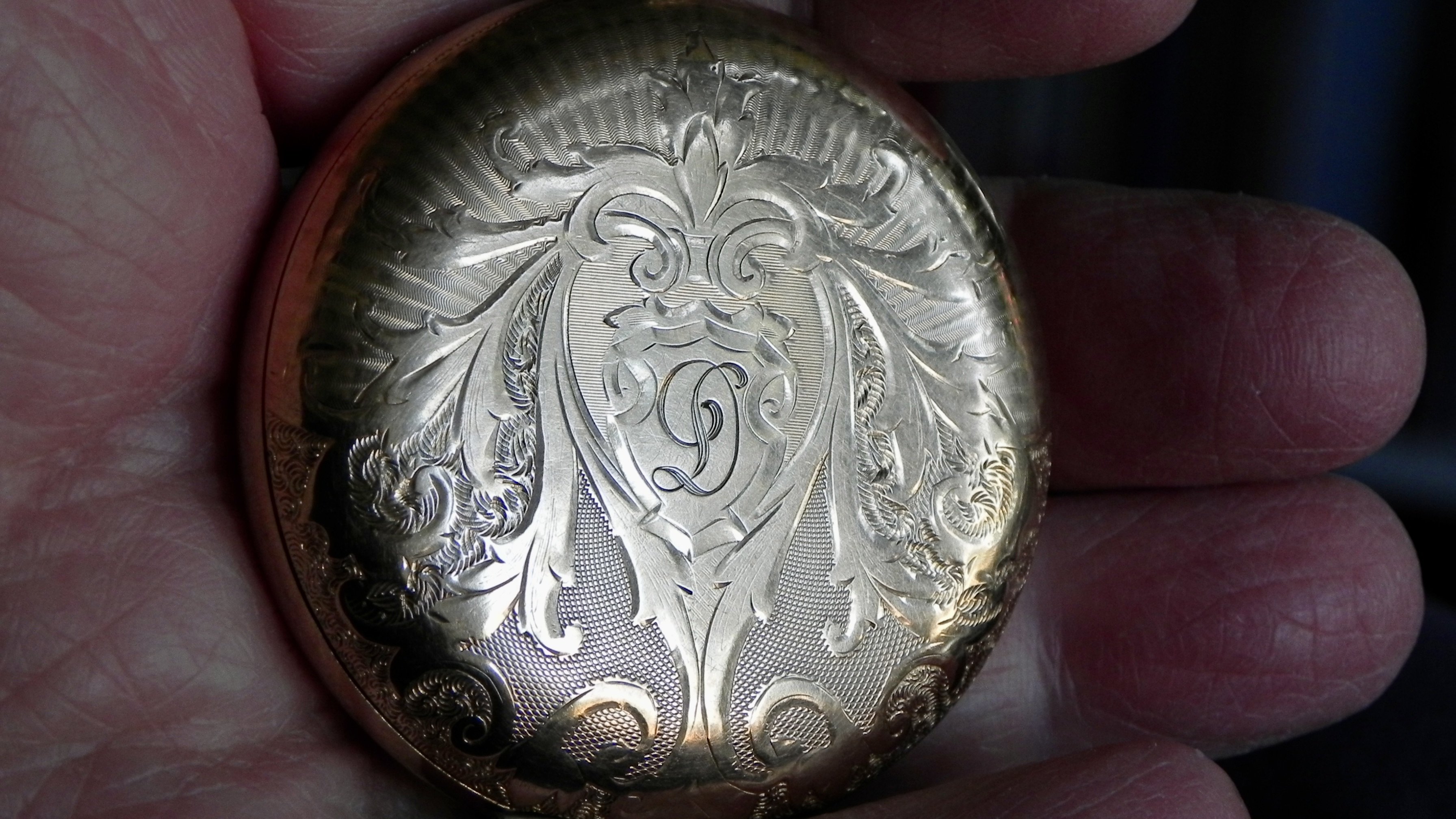

Stunning in every detail! A true tribute to the hand engraver’s art! The watch hardly shows any wear. Just short of 110 years old. A “working man’s watch”. Seems like it would be meant for a professional working man. Doctor, lawyer, accountant, that kind of work.
8,881
62,901
Catalog priced this at $17USD(movt and dial/hands) , add $5-10 for case and RR grade 992 probably was around $25-30.....so I kinda was thinking a solid workingman's watch, but certainly possible 'ol Dell was a professional.
Fun to speculate, anyway.
Thank you, Stunning indeed!
Why I bought it, pretty pedestrian movement and it also has a nice double sunk porcelain dial and blued hands.
Hard to resist that combo back in the day.

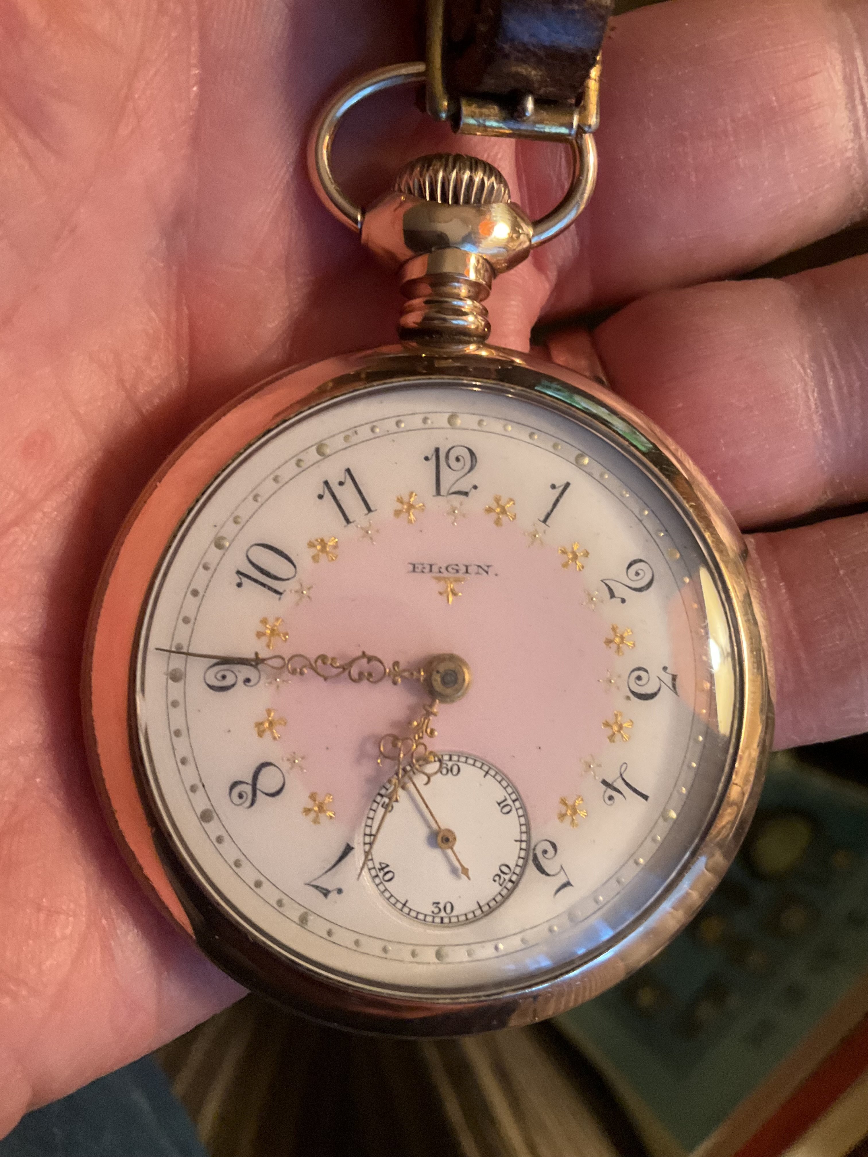

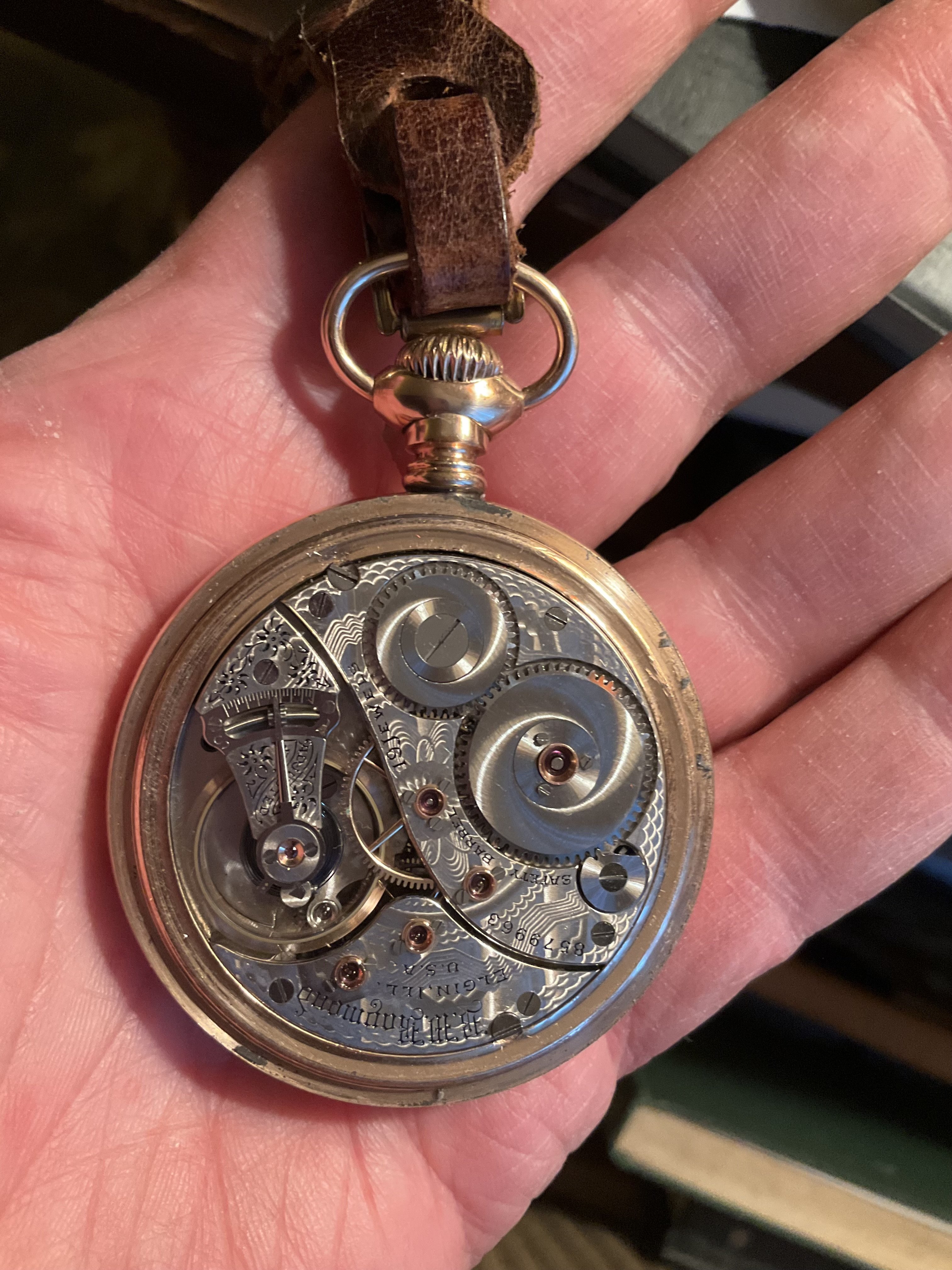

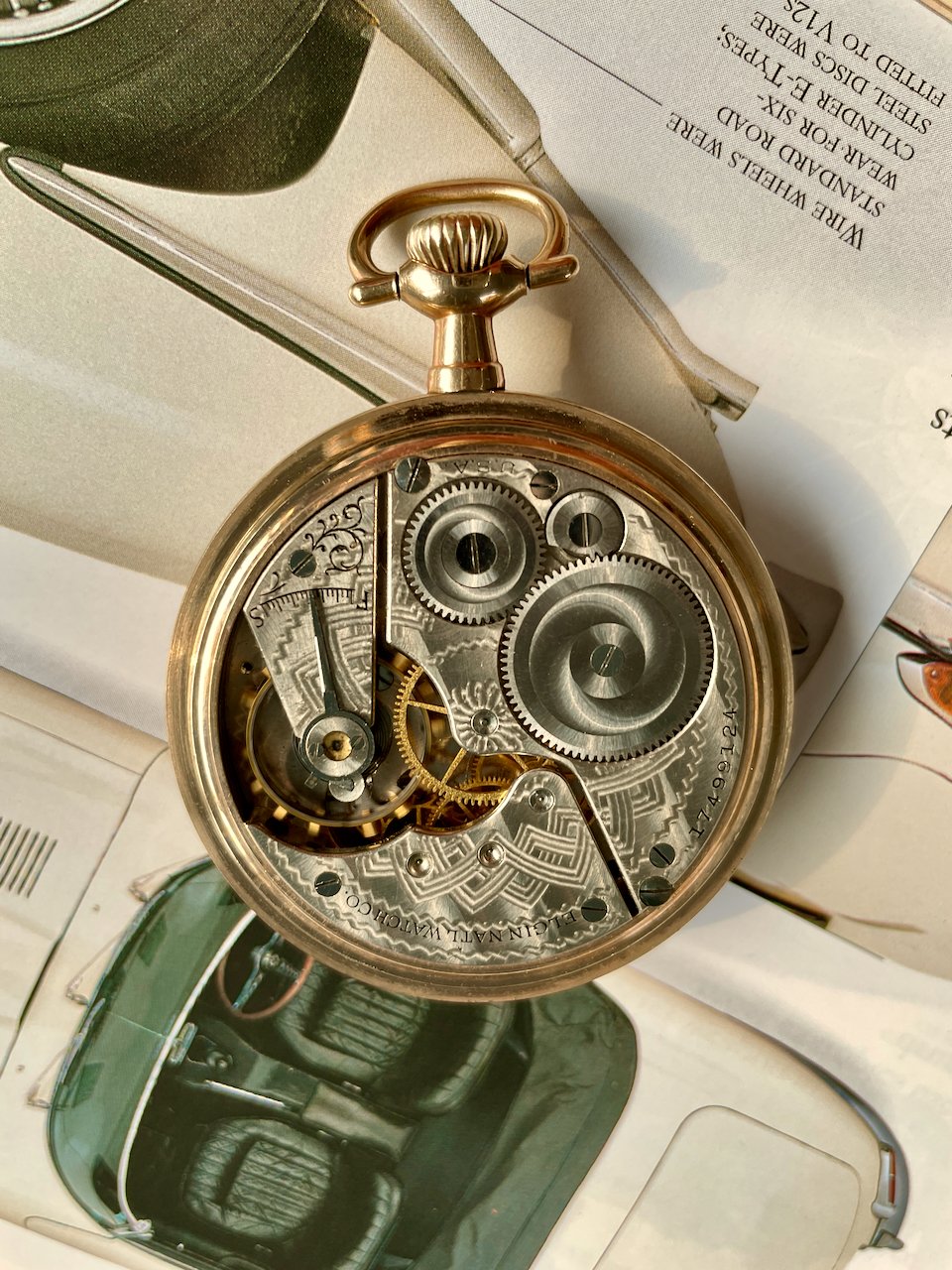

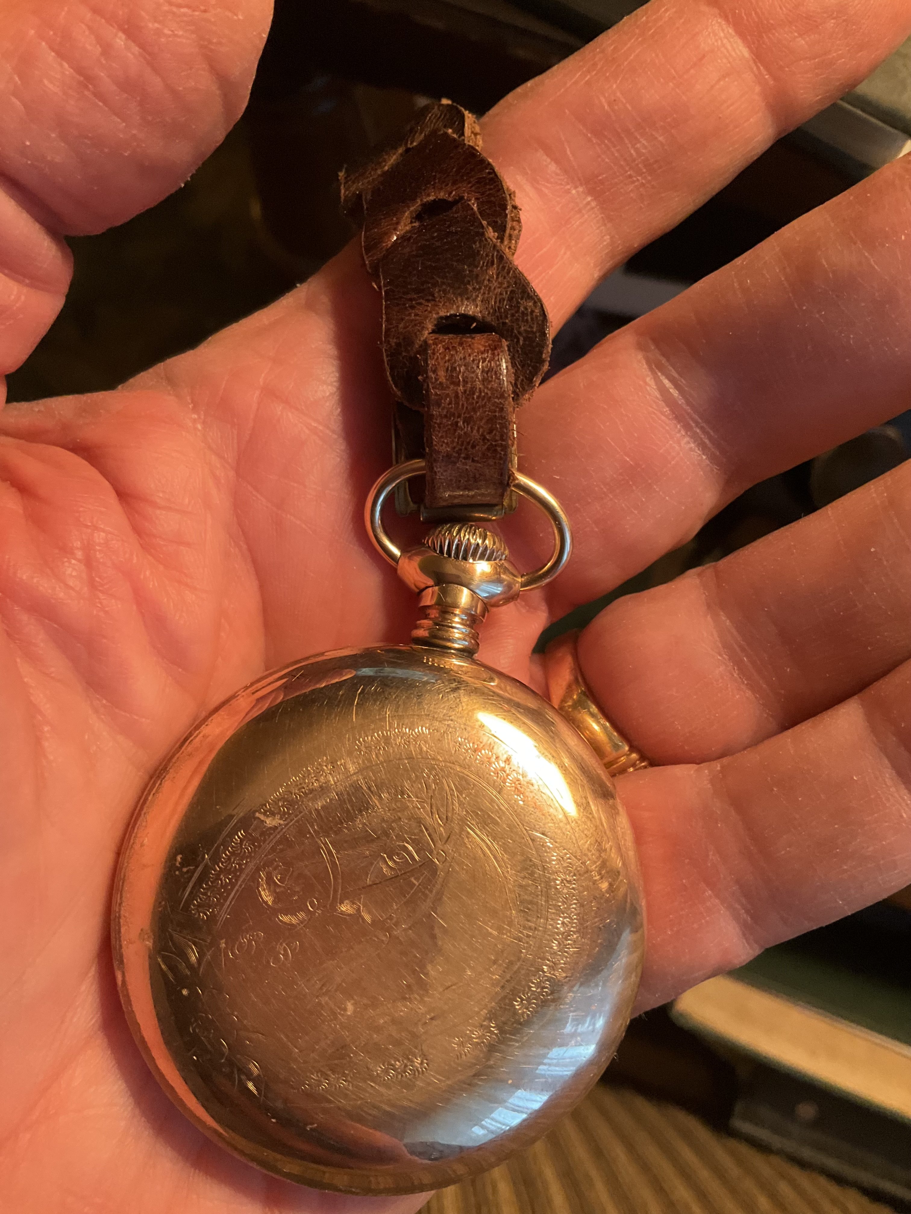

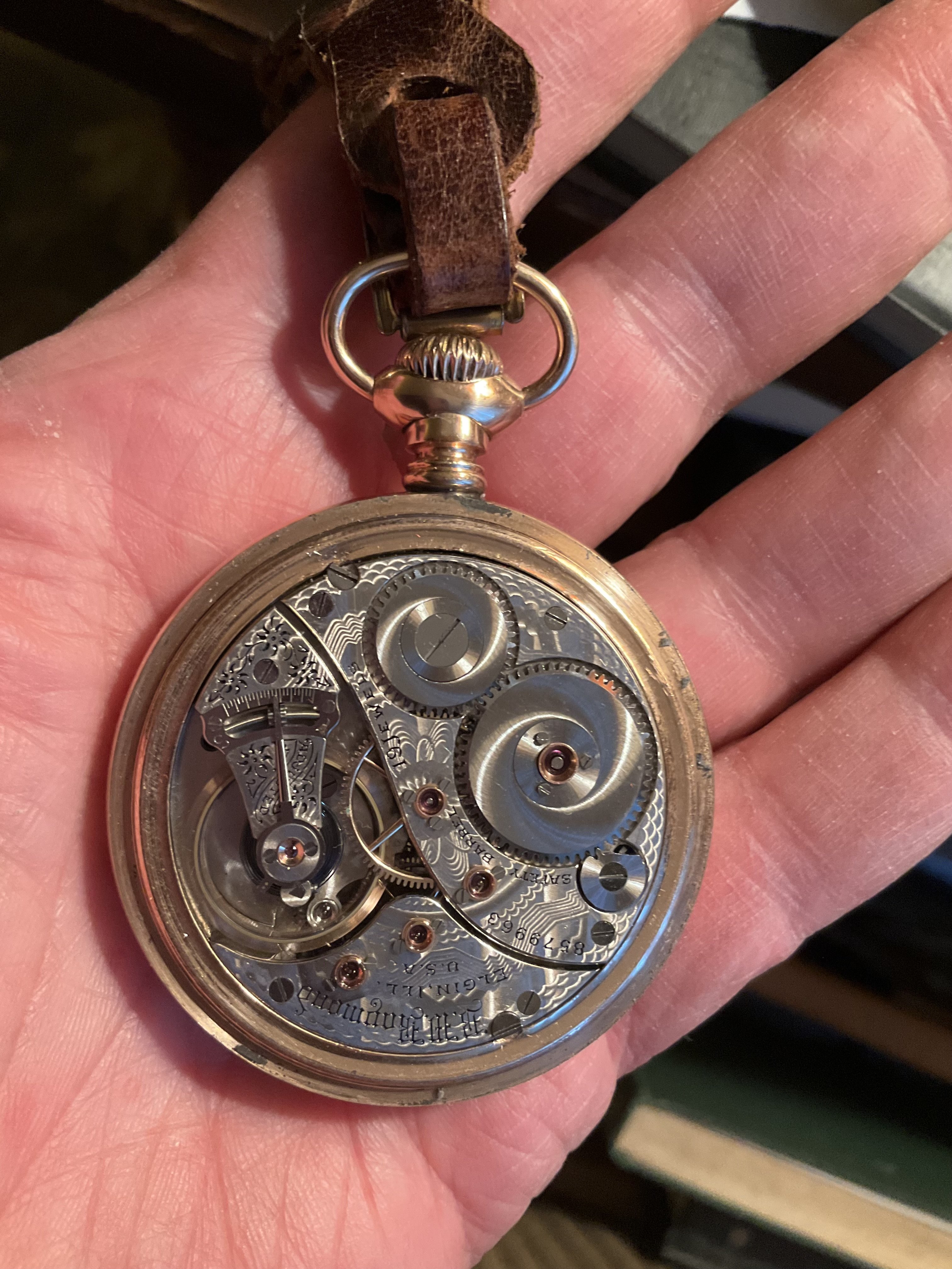

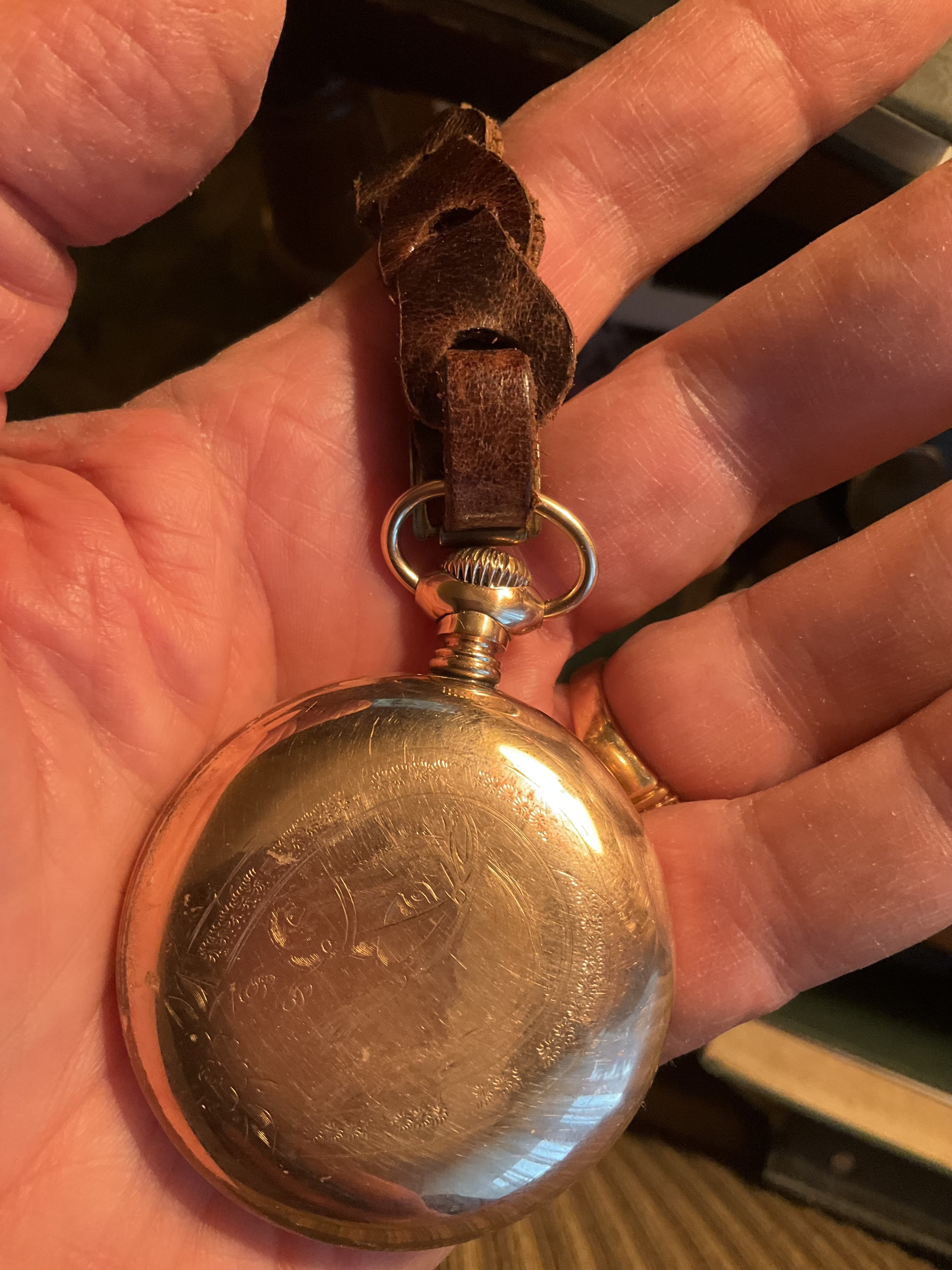

Owing to family schedules, Thanksgiving (Canadian) dinner happens for us on Tuesday. A special day requires a special pocket watch. This one is from my wife’s family. Her great grandfather on her mother’s side. He was a sergeant in the Union army in the U S civil war. He later became a sheriff in Paducah County, Kentucky. After marriage, he moved the family to a farm in Kansas. His wife worried about tornados, and the children. So they moved to Spangle, Washington which was a small town south of Spokane where they farmed once more. This was circa 1895. The farm must have prospered as he branched out and opened a hardware business in Spangle. He bought this watch circa 1903.
It is an 18-size, 3/4 plate, 19-jewel B W Raymond which would not have been railroad approved because of his choice of dial and hands. One of my prettiest 18-size pocket watch movements. It is on my @Duracuir1 leather lanyard.

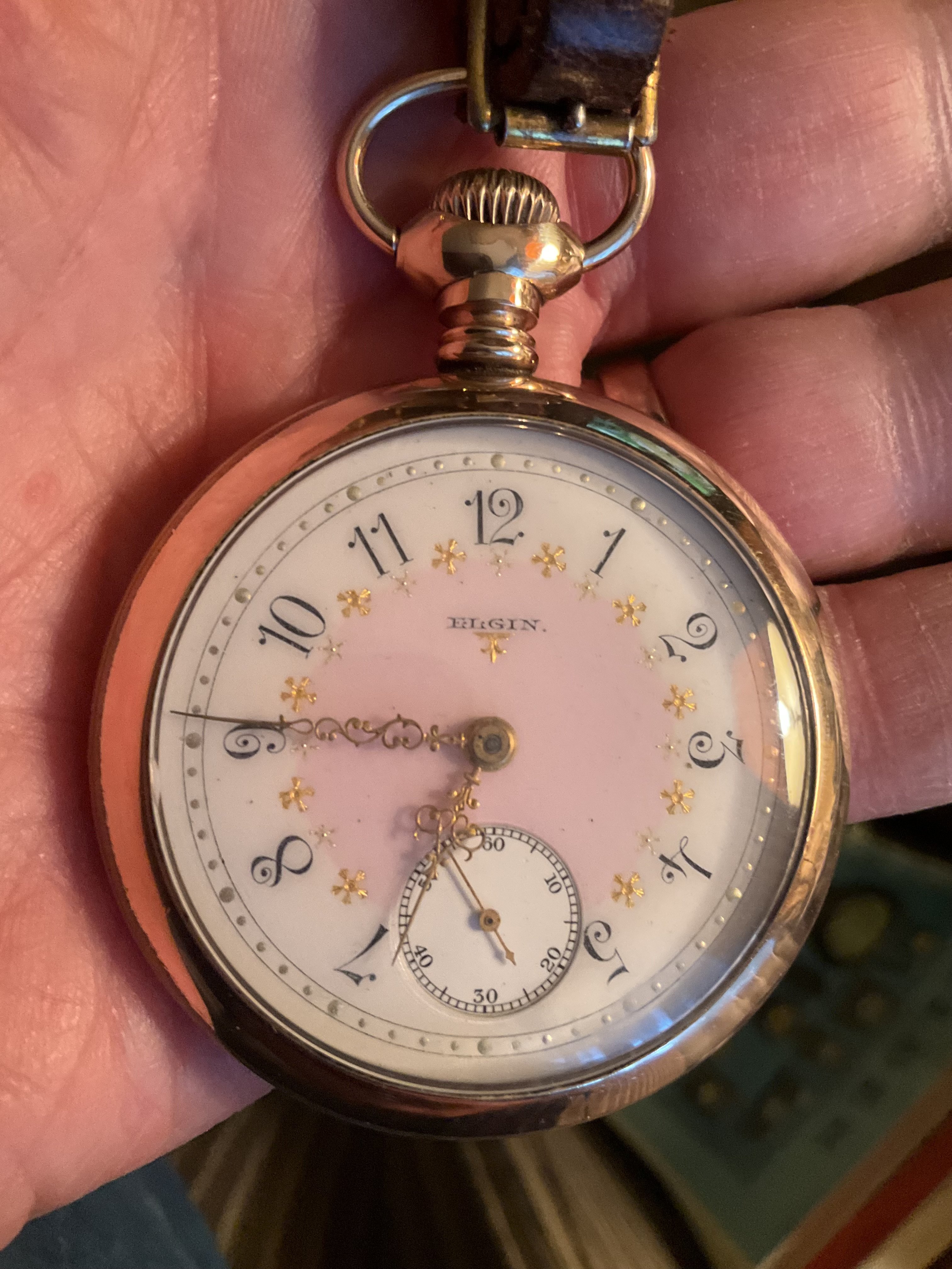

Reminds me of Moorhouse designed dials around that time. At least in his style.
Excellent👍
15,997
48,116
Excellent👍
Referring to?
8,881
62,901
The squiggly numerals......very radical, unVictorian Era adornment.

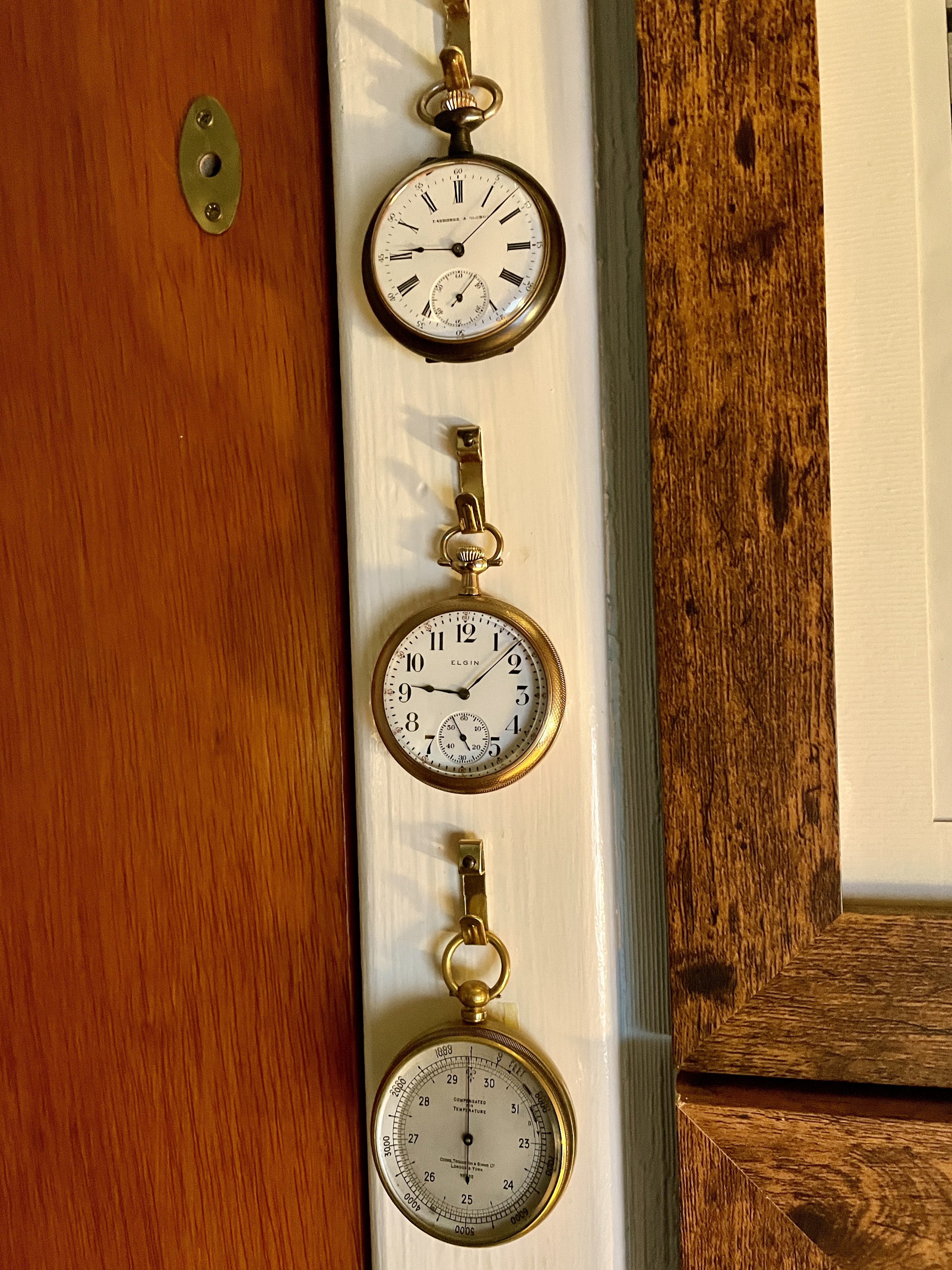

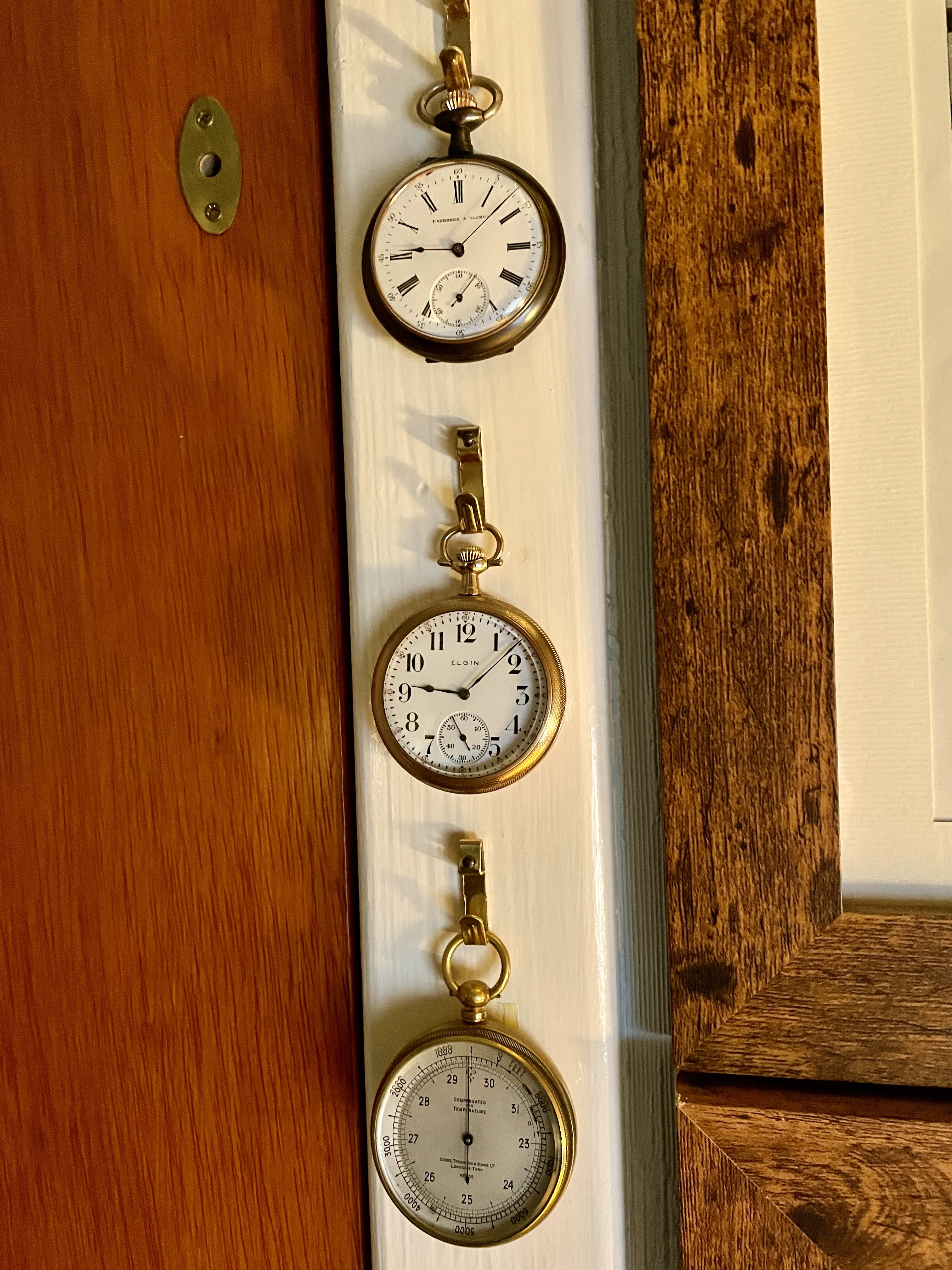

Running away nicely today, t.b.h. they now spend most of the time hanging here next to my desk 😀

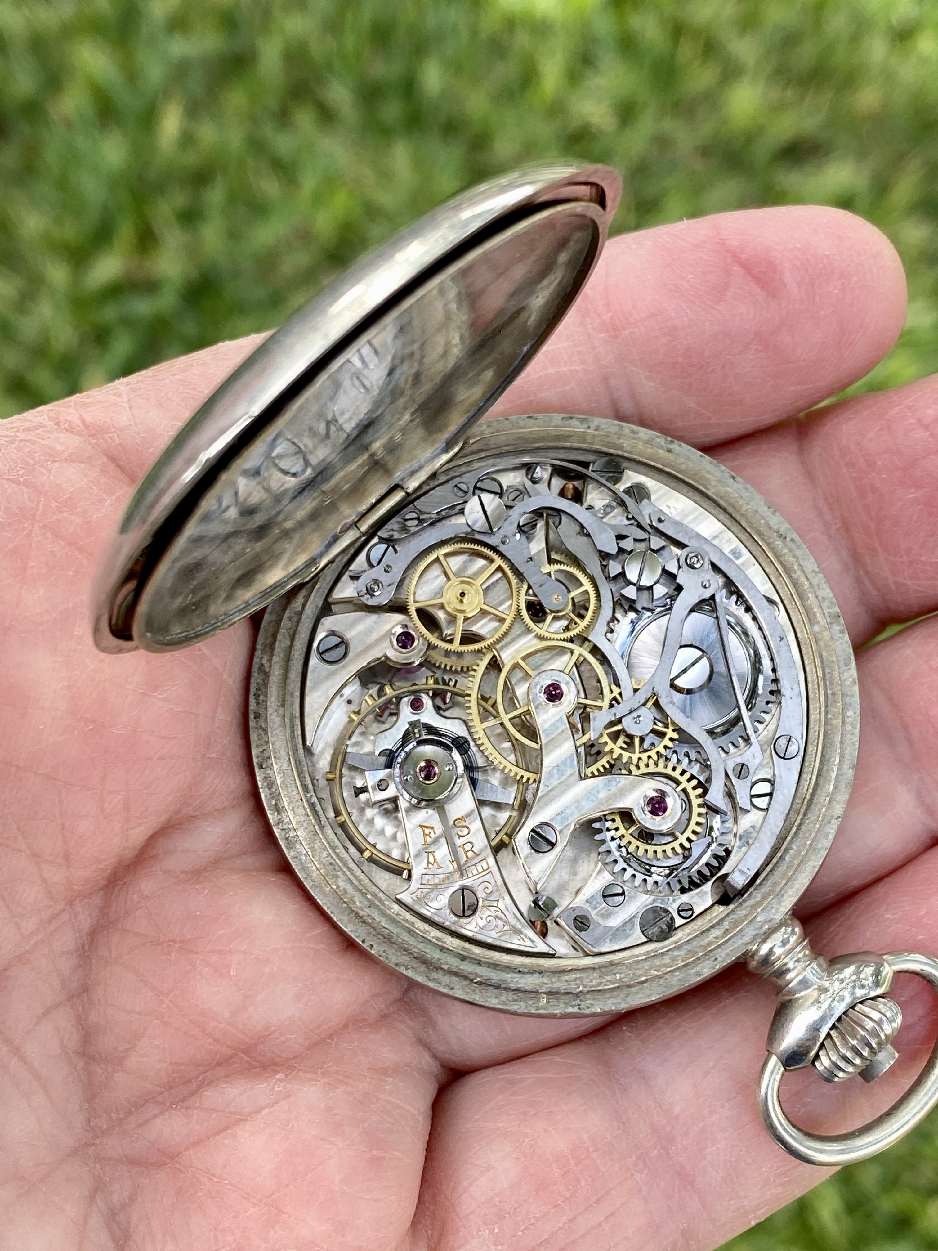

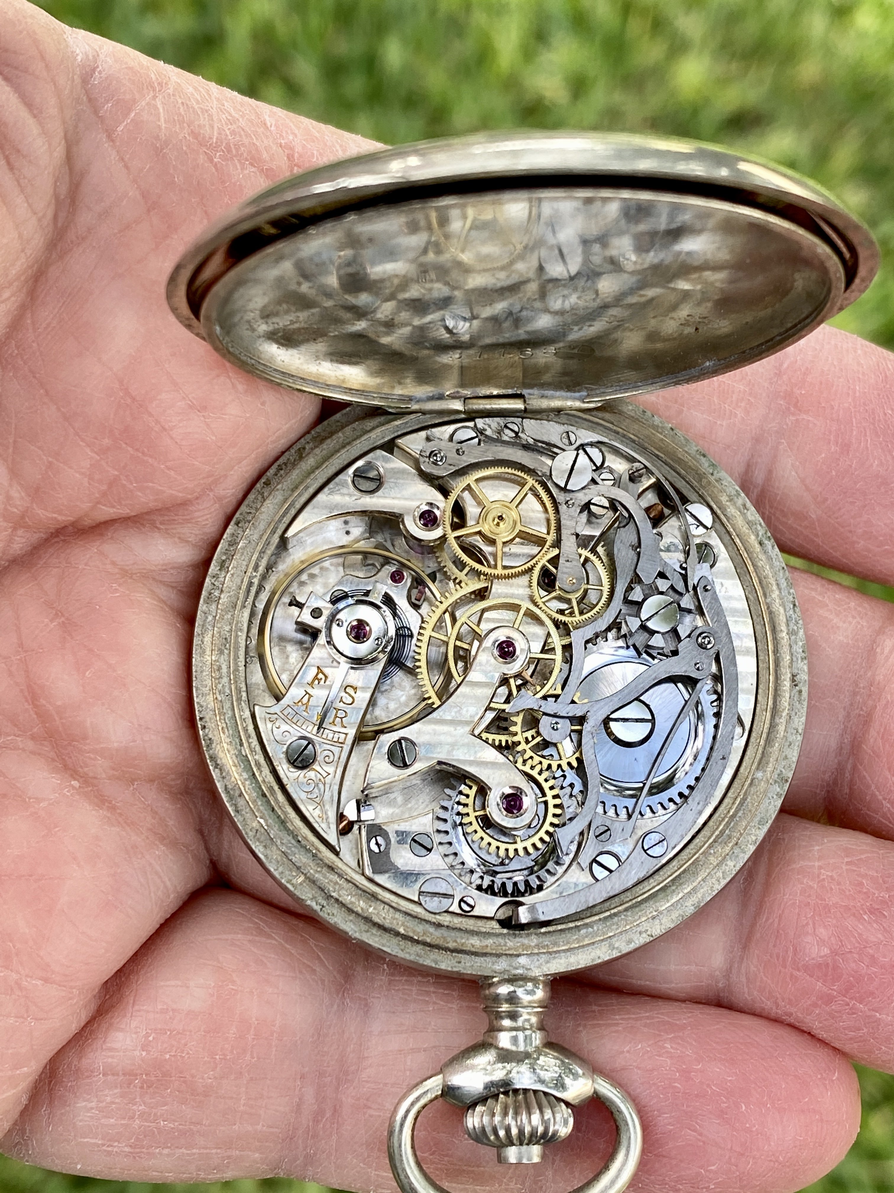

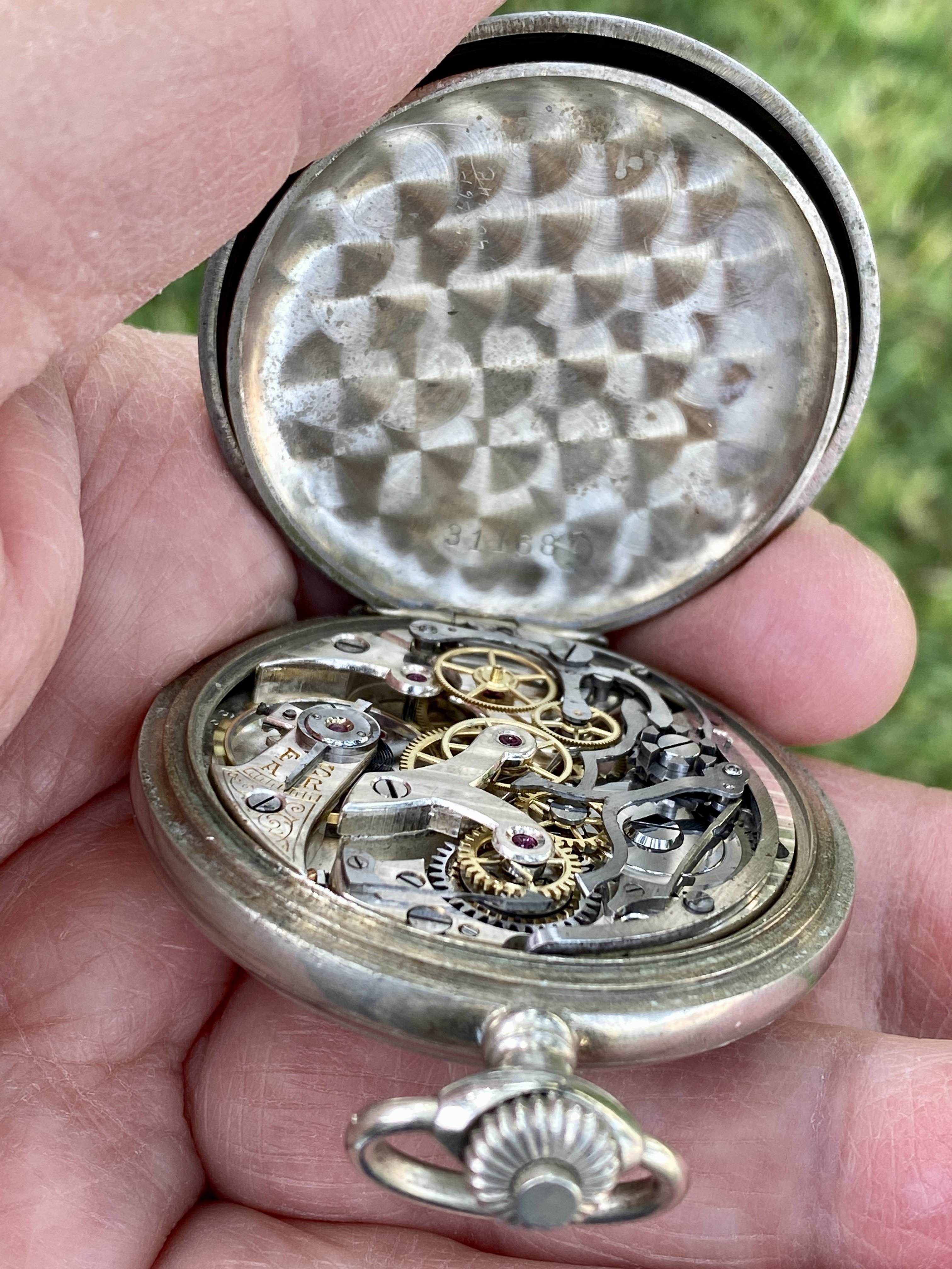

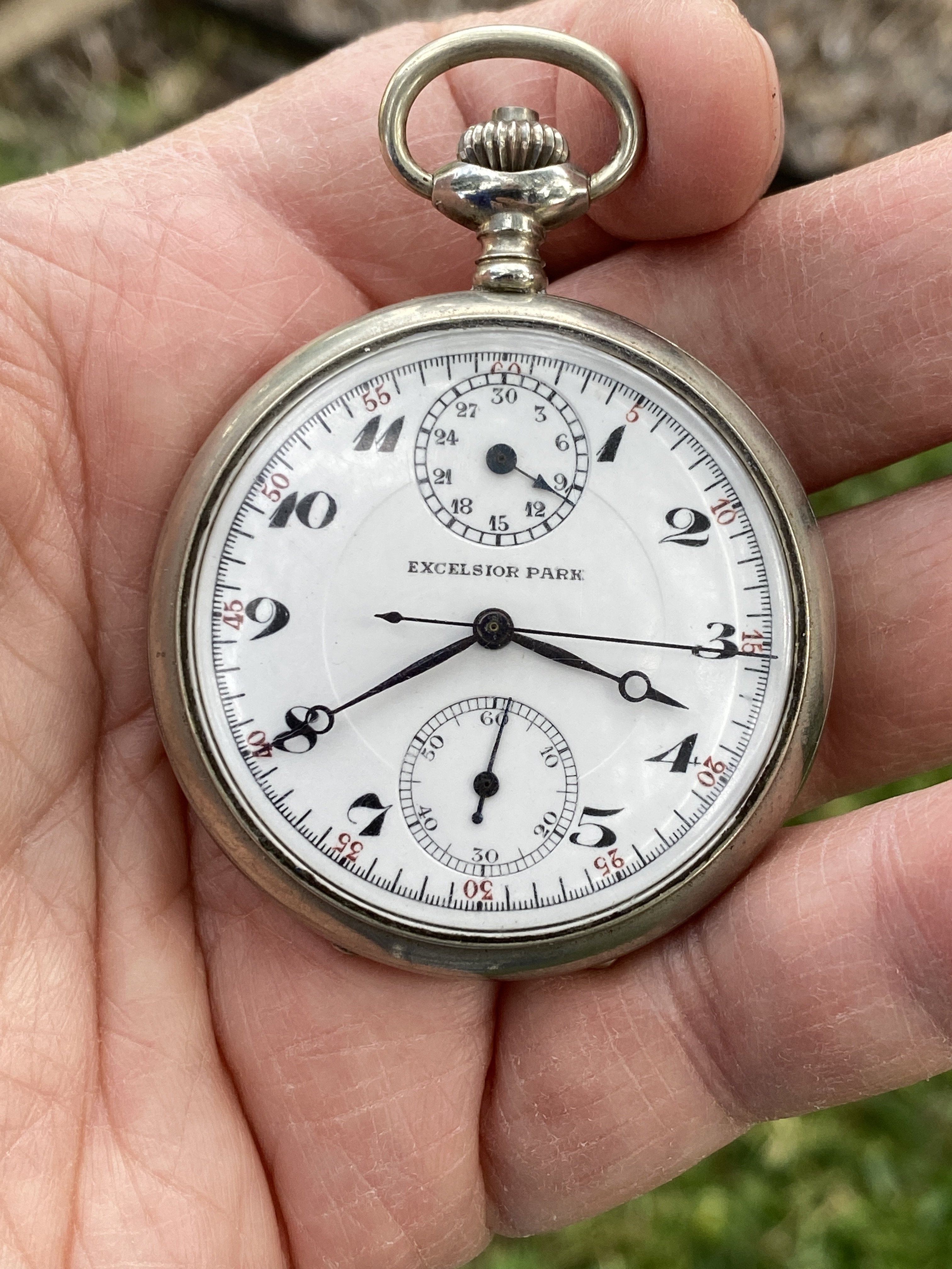

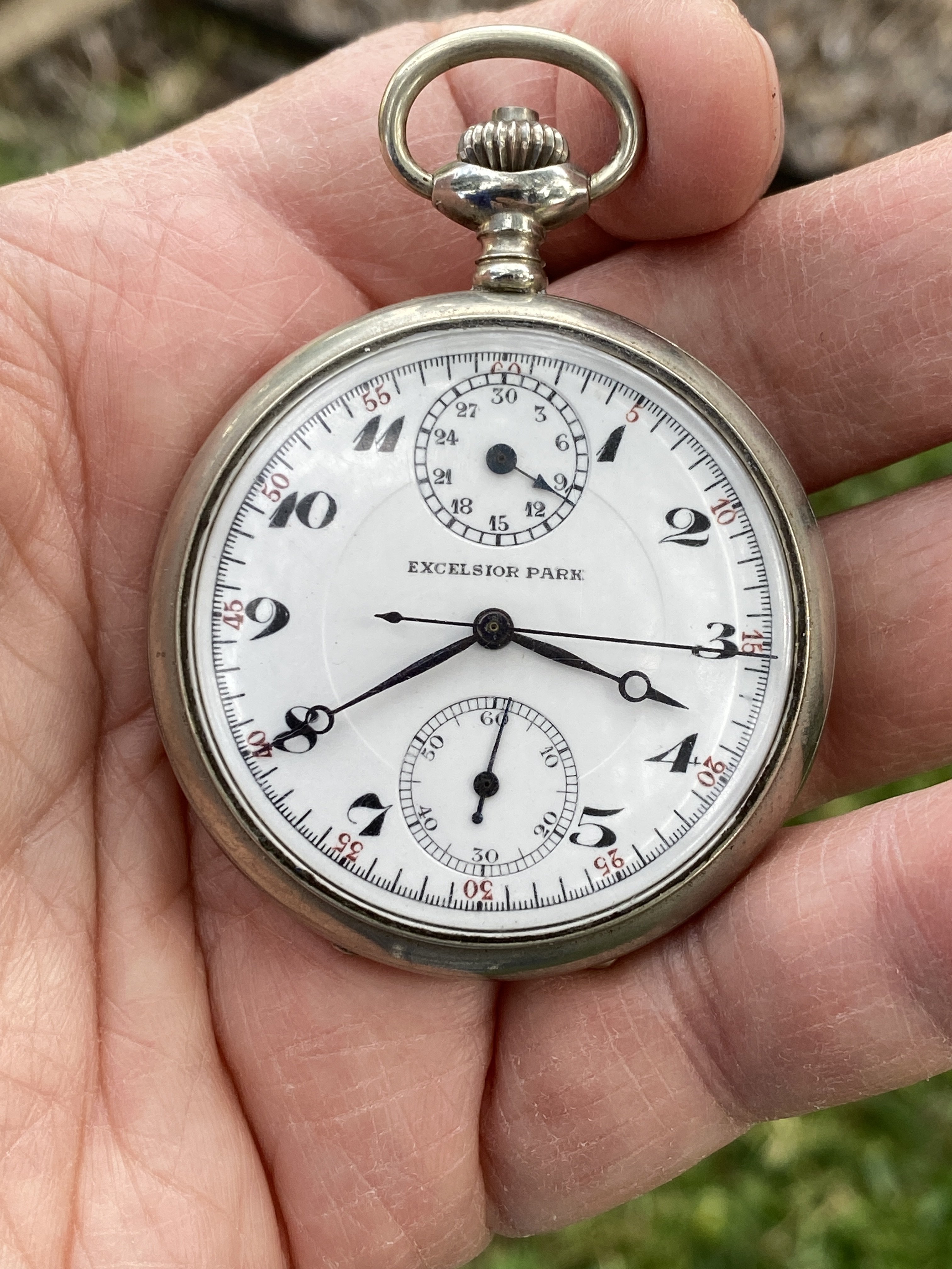

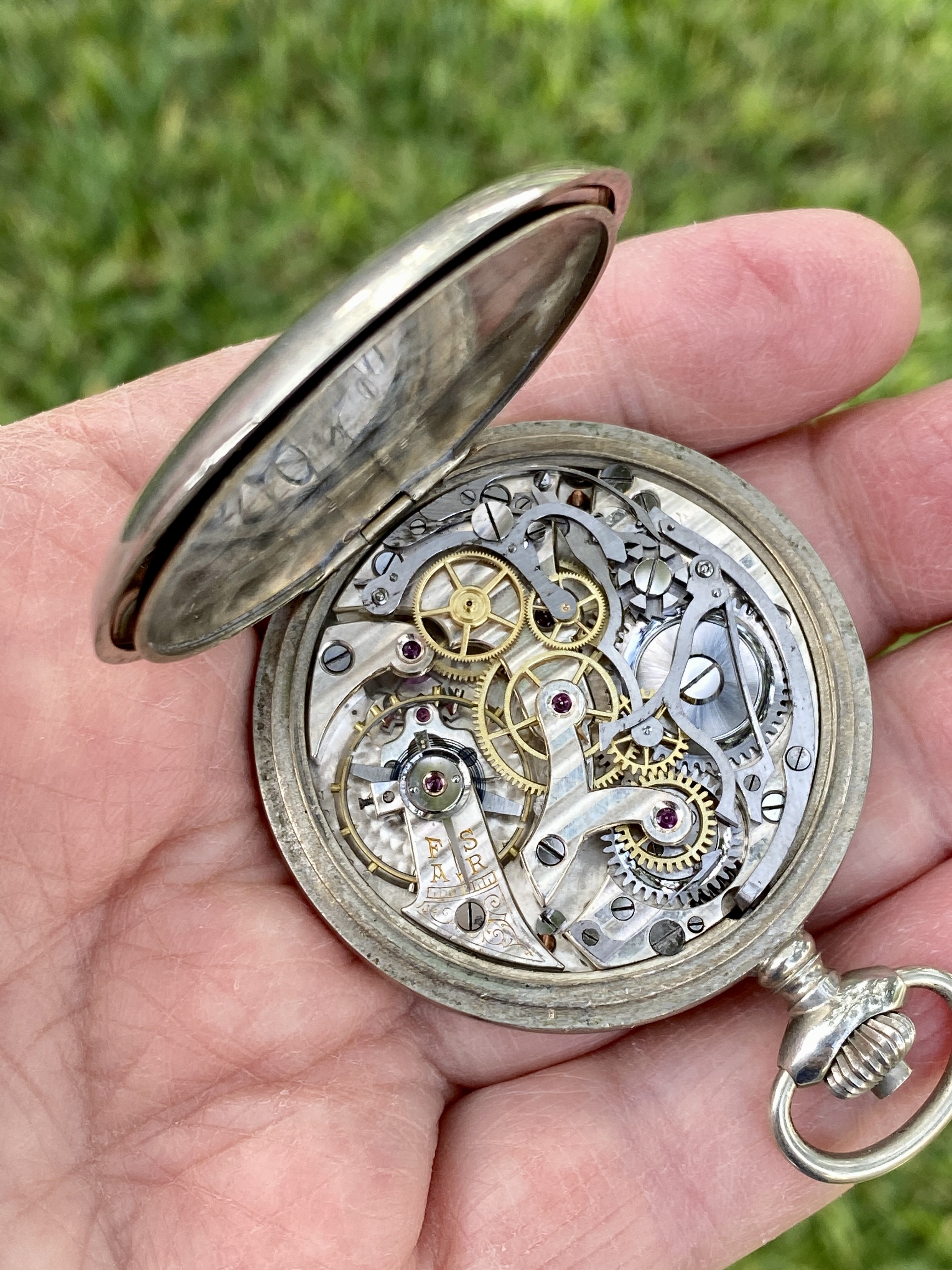

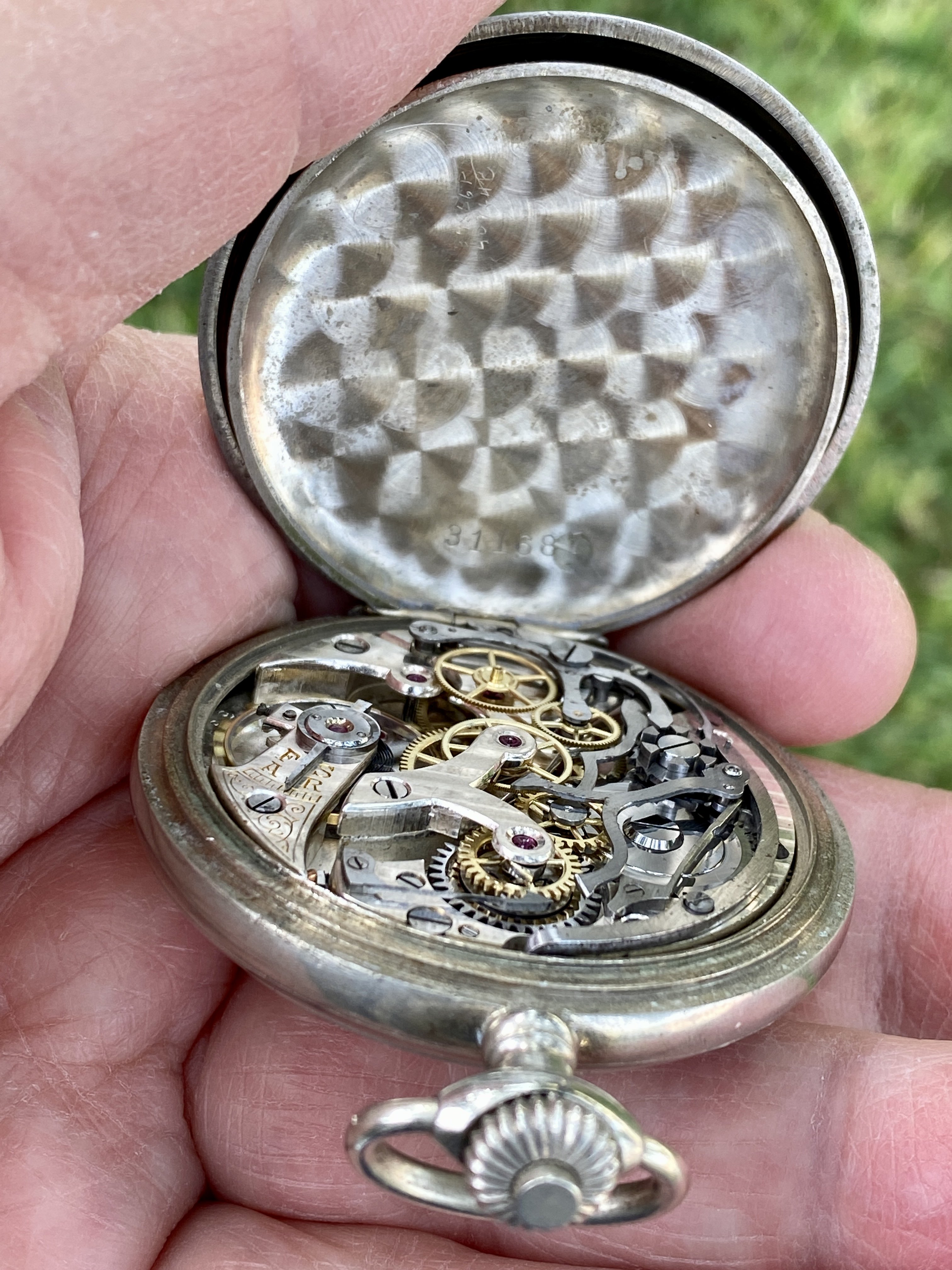

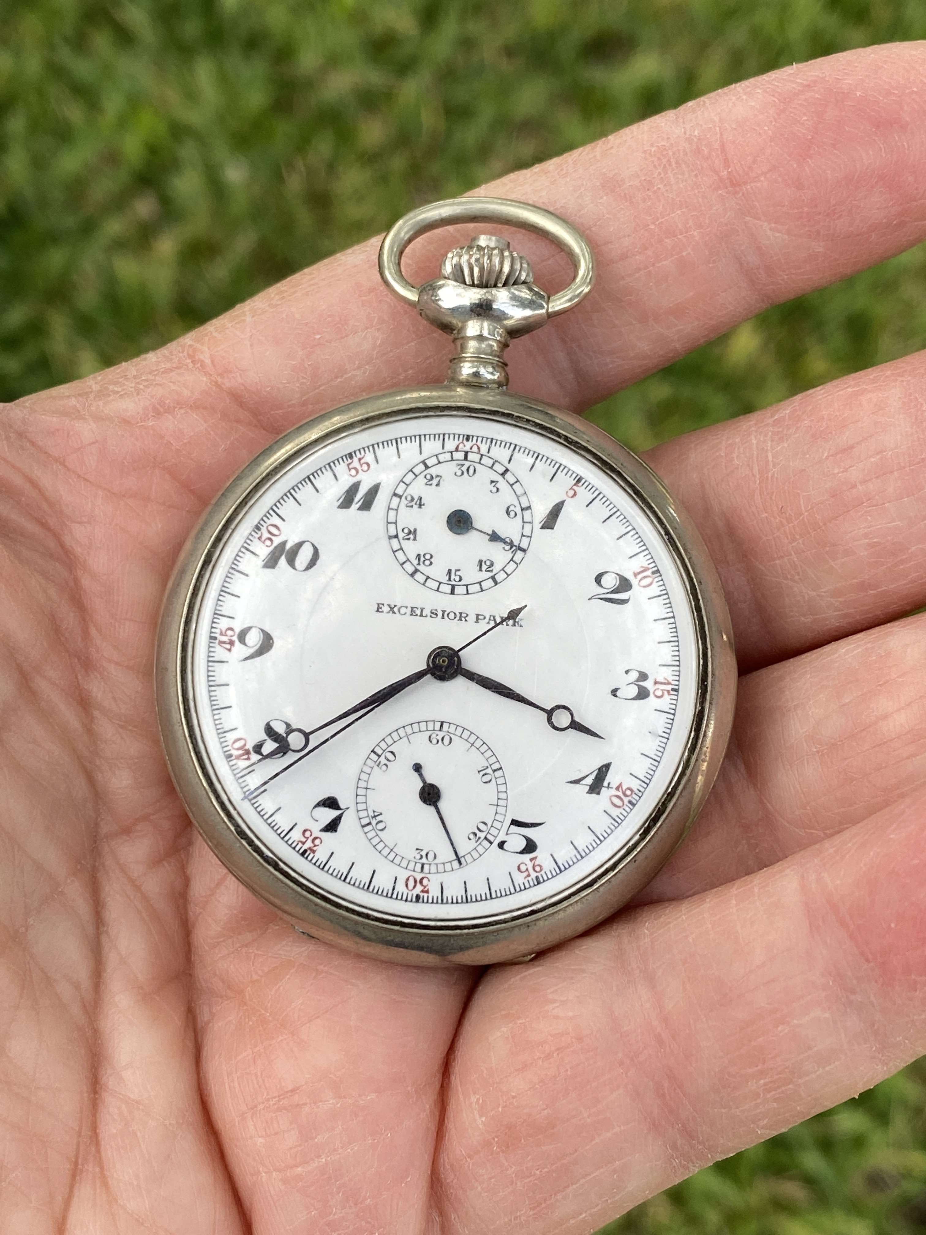

Excelsior Park Chronograph
Double sunk porcelain dial
Moon Hands
Pre Incabloc
Nickel-Silver case
Resets like Budda
Super-Accurate

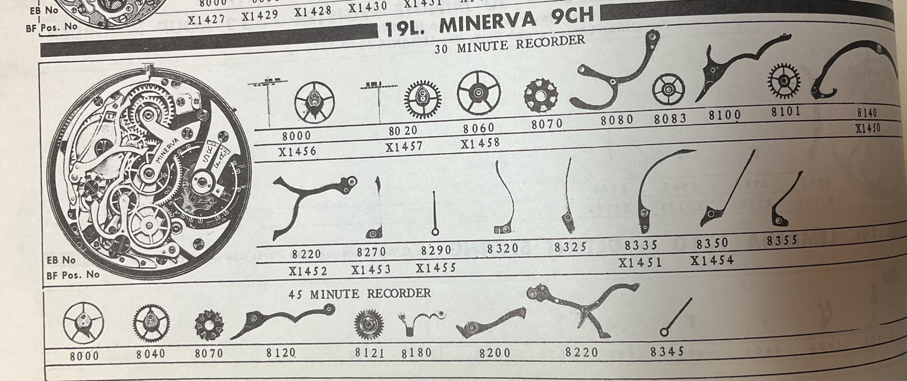

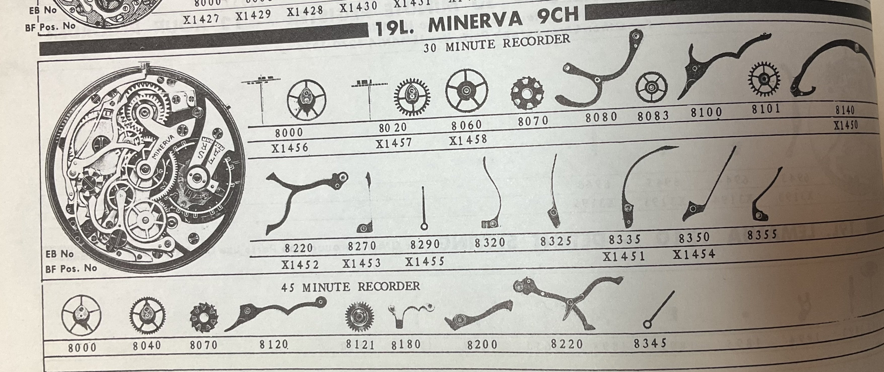

Anyone know the movement?
15,997
48,116

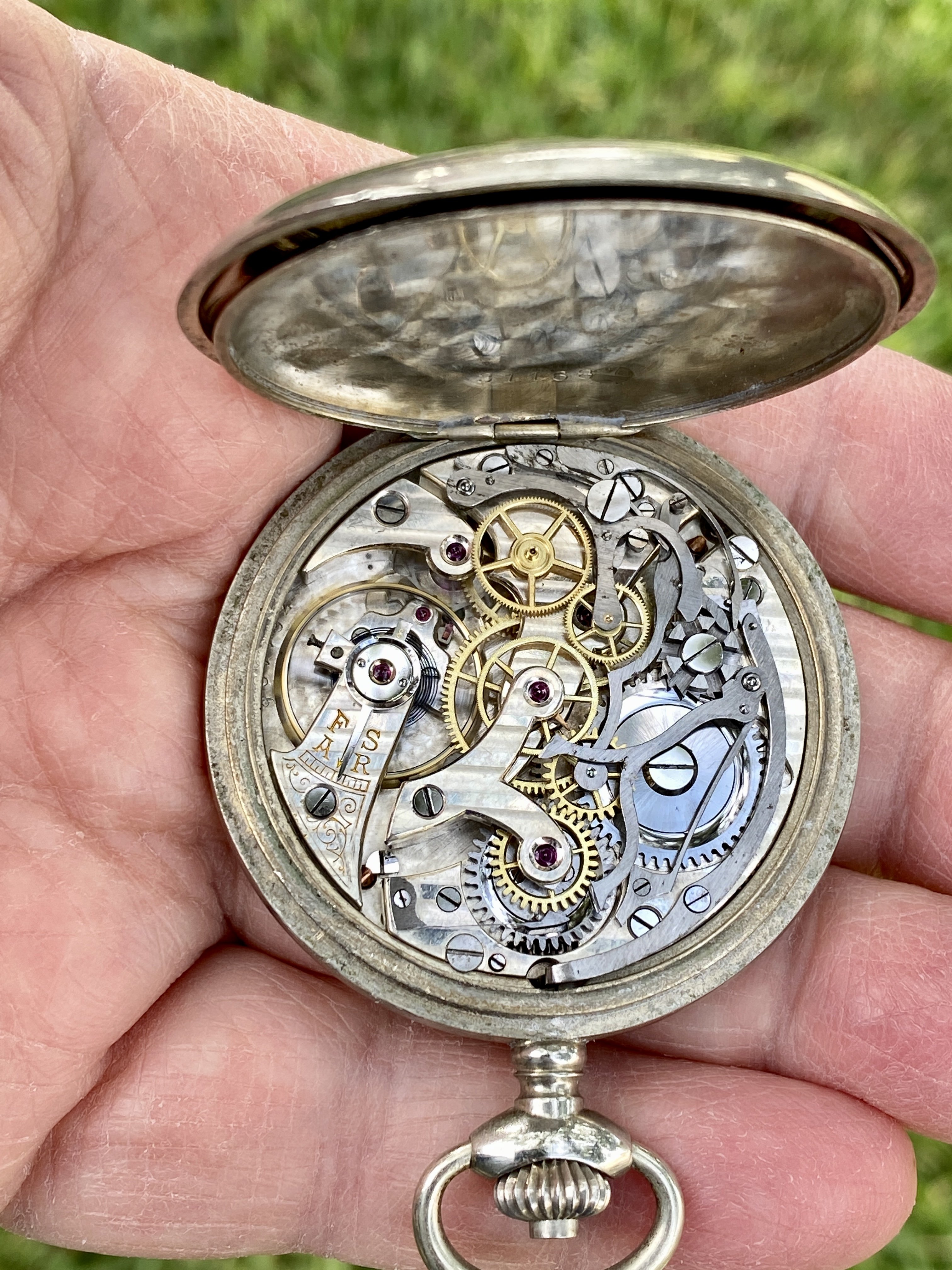

Moon Hands
Pre Incabloc
Nickel-Silver case
Resets like Budda
Super-Accurate
Certainly a change from the four jewel, pin lever, department store dross we run into. My Bestfit catalog calls the movement a19 ligne, Minerva 9CH. See image.
8,881
62,901
Thank you
Yes, indeed. Googling........Minerva made these movements for many companies 1910's-1940's.
