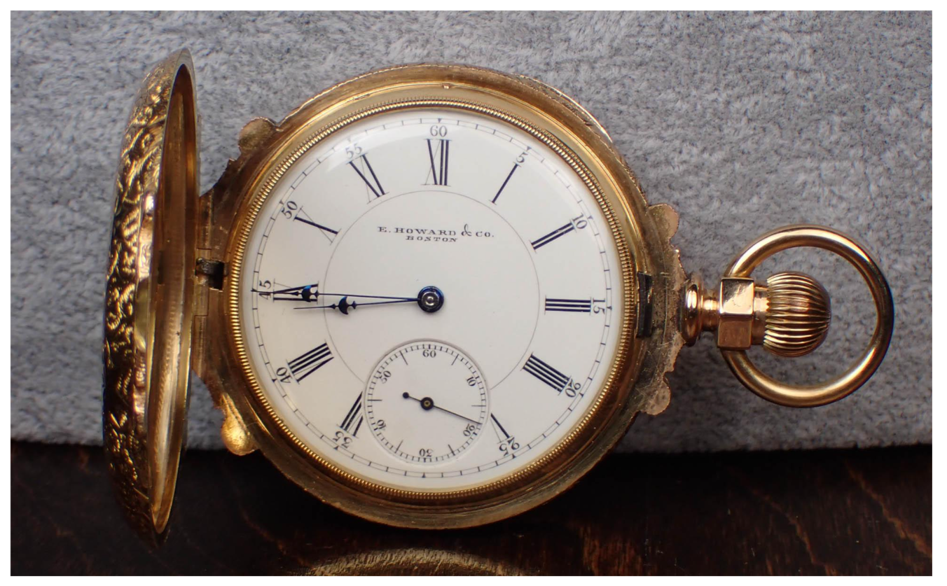

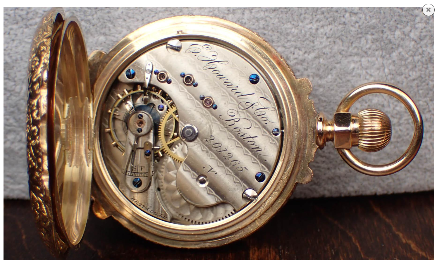

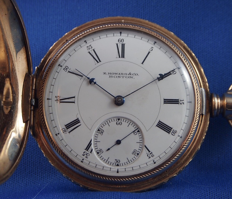

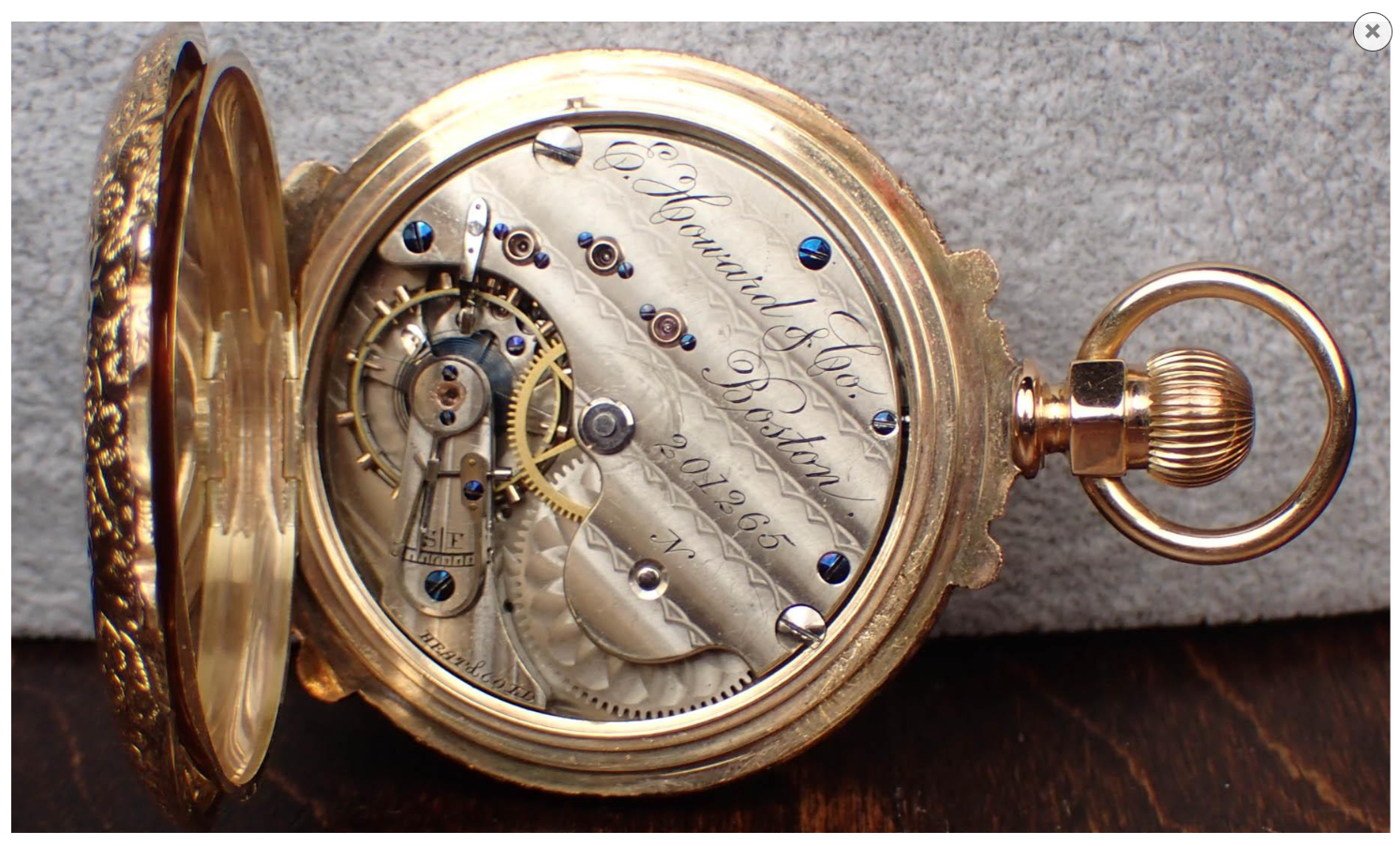

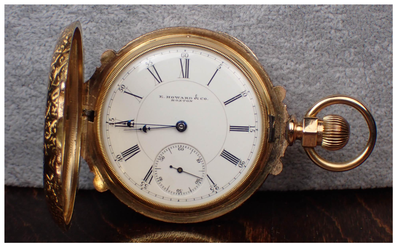

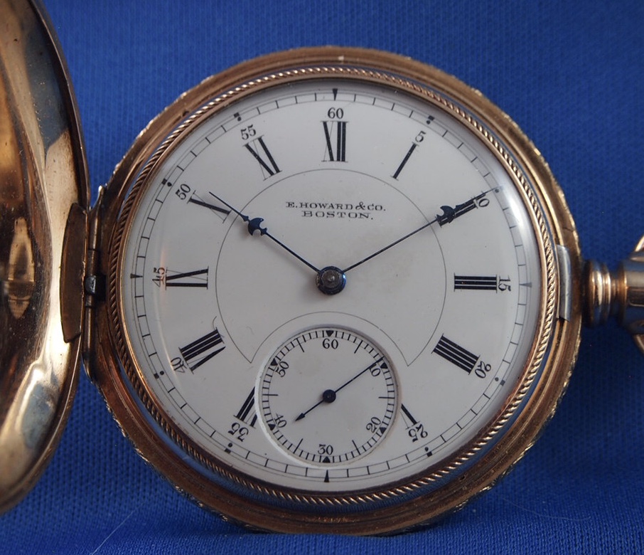

3/4 plate E Howard, Gr 4, c.1885. For sale at auction (not by me).
Interesting to see the regulator arm on the balance cock as normal, but then with the hairspring stud carrier fixed to the main plate.

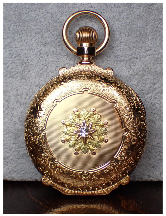

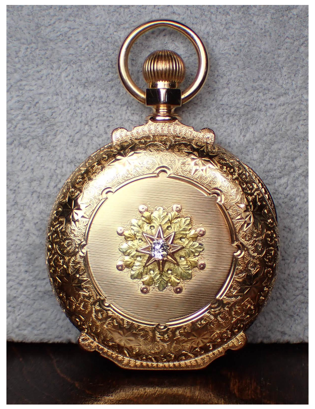

Exceedingly fancy diamond set case work

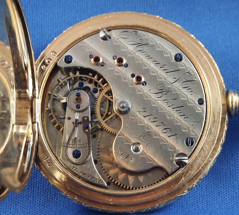

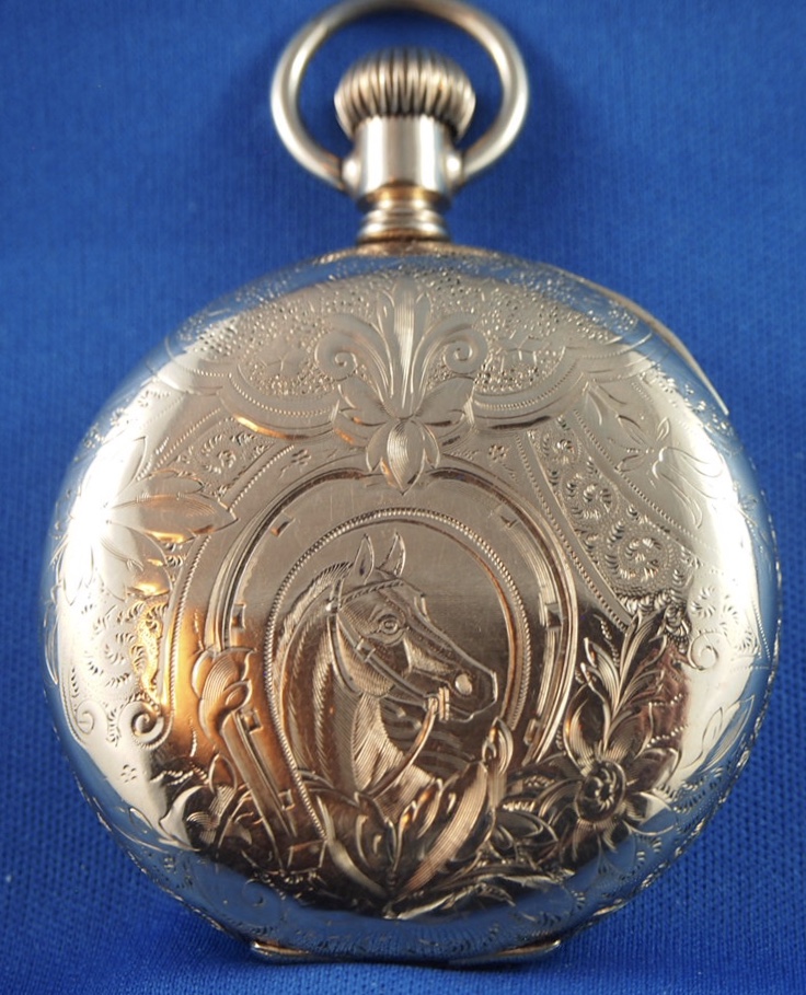

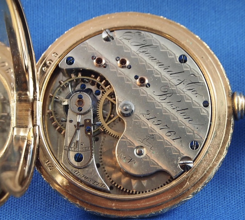

In his book on the E Howard & Co. watches, Colonel Townsend lists this “N” size Howard S# 201265 as being a VII th model. This was not a designation given by Edward Howard. E Howard watches were almost entirely individually produced by one workman. Howard made no secret of the fact that interchangeability of parts was not his priority. There are differences from model to model which are obviously different. I have shown a picture of my (only) E Howard watch (S# 219761) which is also an N size, VII th model. The pinning point for the hairspring stud is on the balance cock, not a separate “bib” attached to the bridge over the train wheels. Howard had a system of designating the grade of his movements. The “hound” grade had a hound engraved on the train bridge, and it was “unadjusted”. Next was the”horse” grade which was adjusted for heat and cold. Then there was the “stag” grade which was adjusted to heat, cold, and 6 positions. The hound, horse, or stag was usually engraved on the bridge over the train wheels. The watch posted by @WestCoastTime doesn’t have the grade designated on the movement. Notice on the image of my E Howard, the “stag” (denoting the highest grade) is engraved on the plates. Notice the subject watch doesn’t have the grade designation marked, but it is engraved Heat & Cold which indicates to me that it must be a “horse” (mid range) grade of movement. My “stag” grade example is marked adjusted. Interesting differences from watch to watch was common with E Howard watches. Beautiful four colour gold (likely karat gold) case!

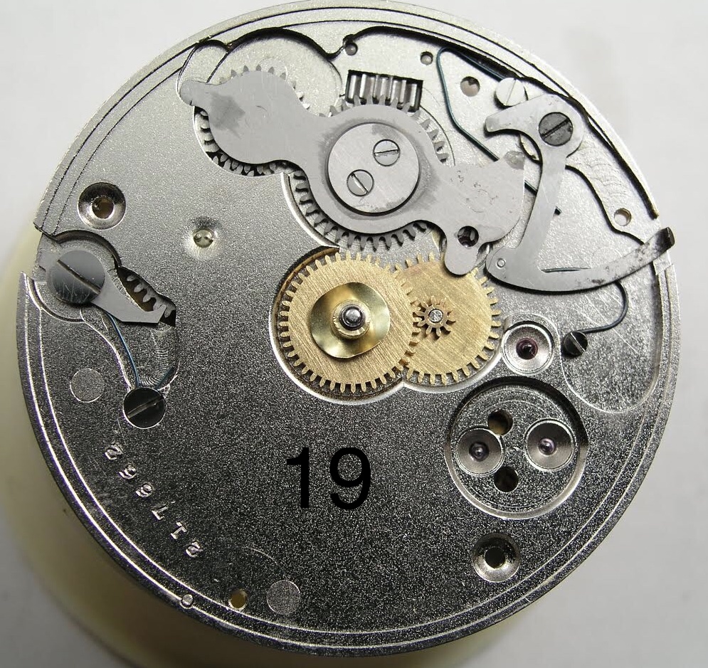

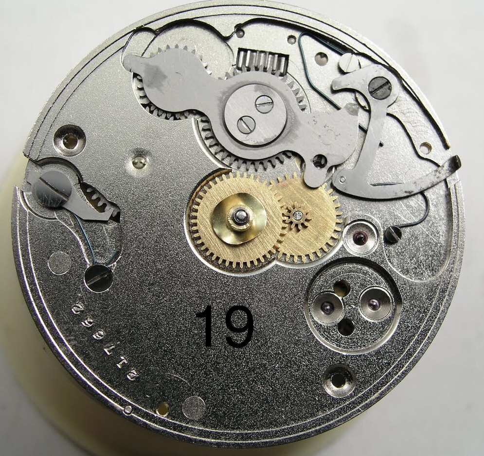

Do you know how one would let the power down on this type of movement? I'm assuming there is something like a conventional click under the main bridge, but not seeing any access to the click or to any kind of actuator.

The two Howards in this thread don’t show a crown wheel and ratchet wheel on the top plate. Thereby, they use a rocker-bar system behind the dial. The stop click and the ratchet wheel are also behind the dial. Many American watches that use this rocker-bar system have a radial hole drilled through the edge of the pillar plate. Letting the power down requires the movement to be out of the case. Use a bench key to back up the recoil click, then insert a pin into the radial hole to contact the tail of the click, then the bench key allows you to release the power. Not all Howards are like these two.
15,997
48,115
Further to your question @WestCoastTime , this image shows a typical rocker-bar winding and setting set up behind the dial of an 18-size Hamilton. The recoil click is located at about the 9:00 position. In the case of the movement shown, the tail of the recoil click can be seen through an access window in the edge of the pillar plate.

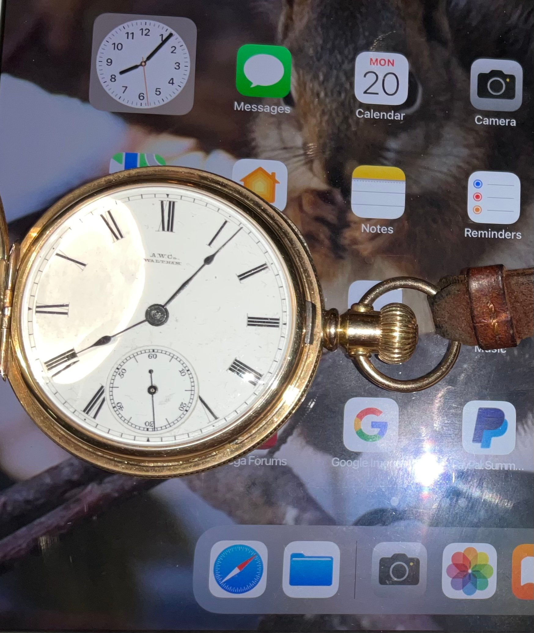

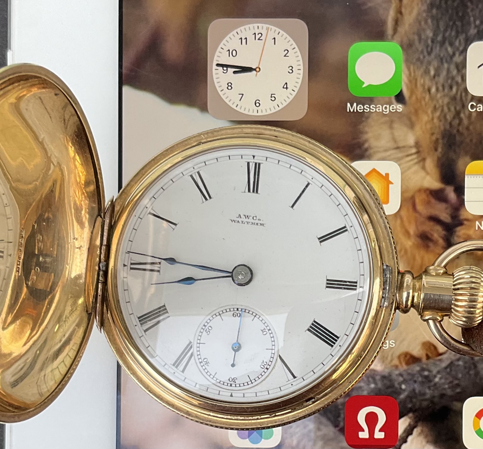

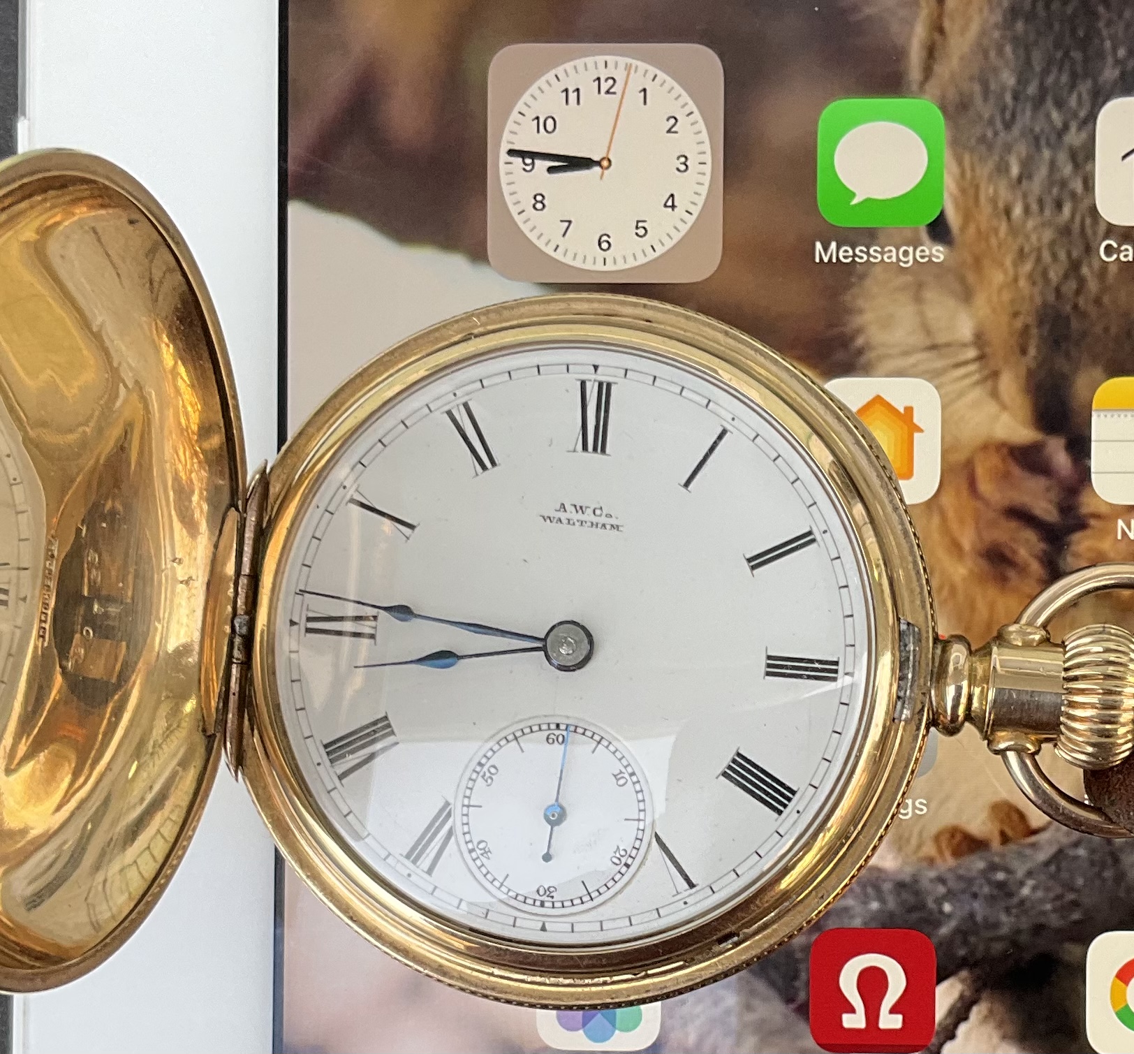

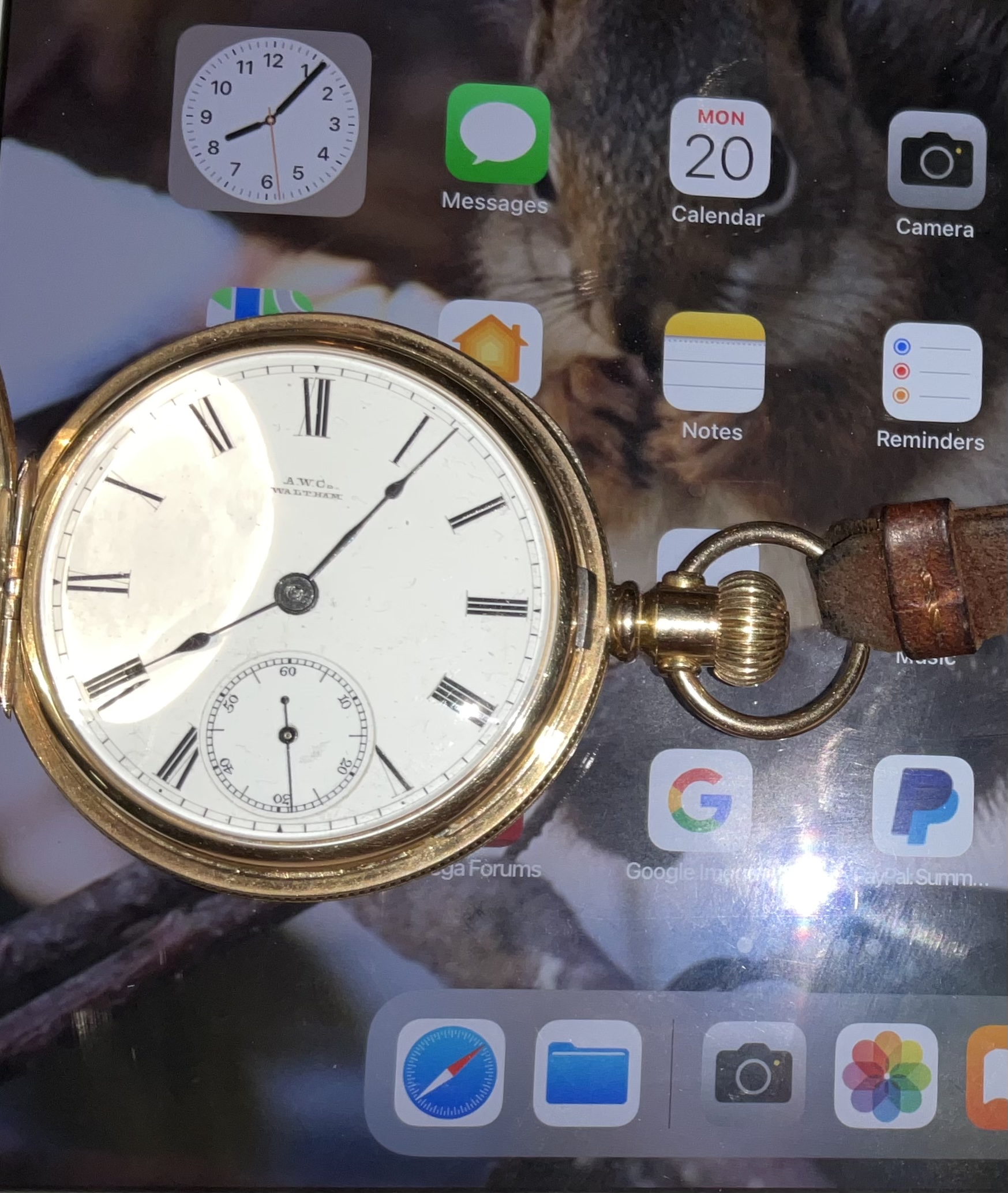

Last re-set and minor regulation of my 138 year old Waltham 1877 model hunter cased pocket watch was five days ago. As of Saturday morning, it is about 2 seconds slow! And it is not railroad grade, or railroad approved. Remarkable to my way of thinking!

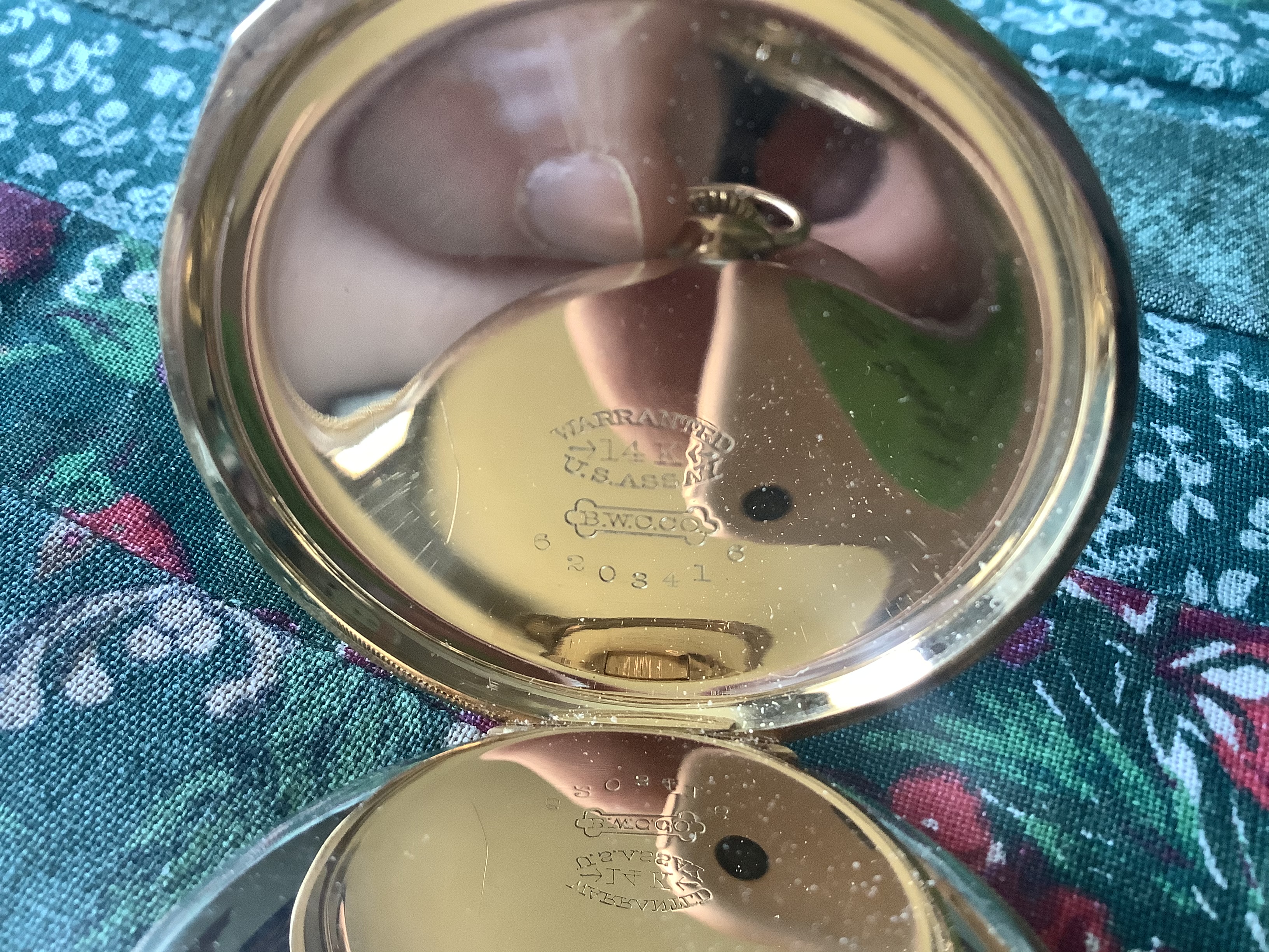

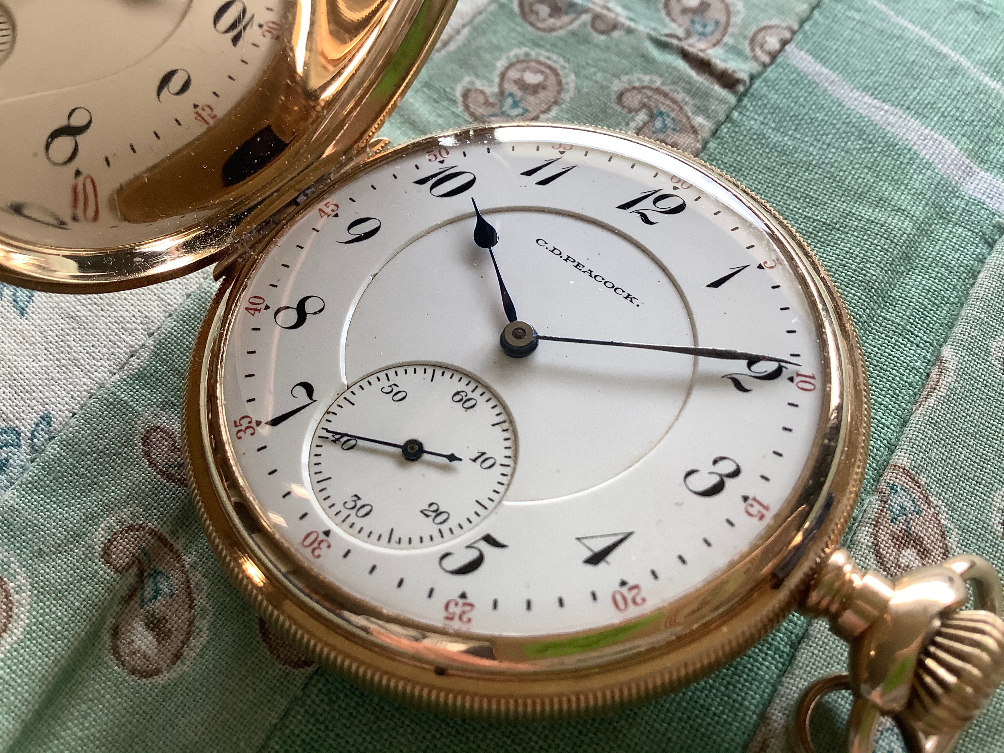

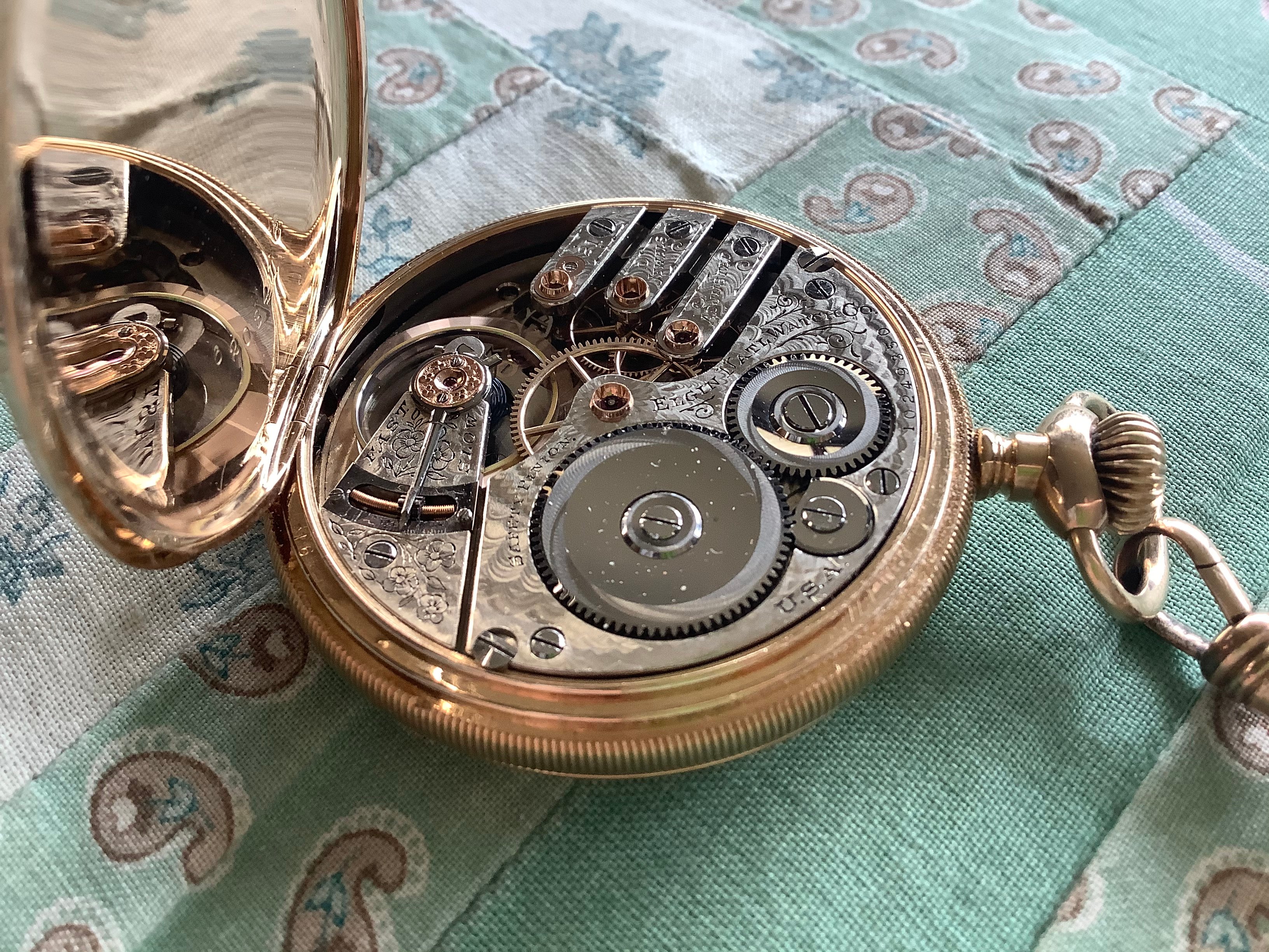

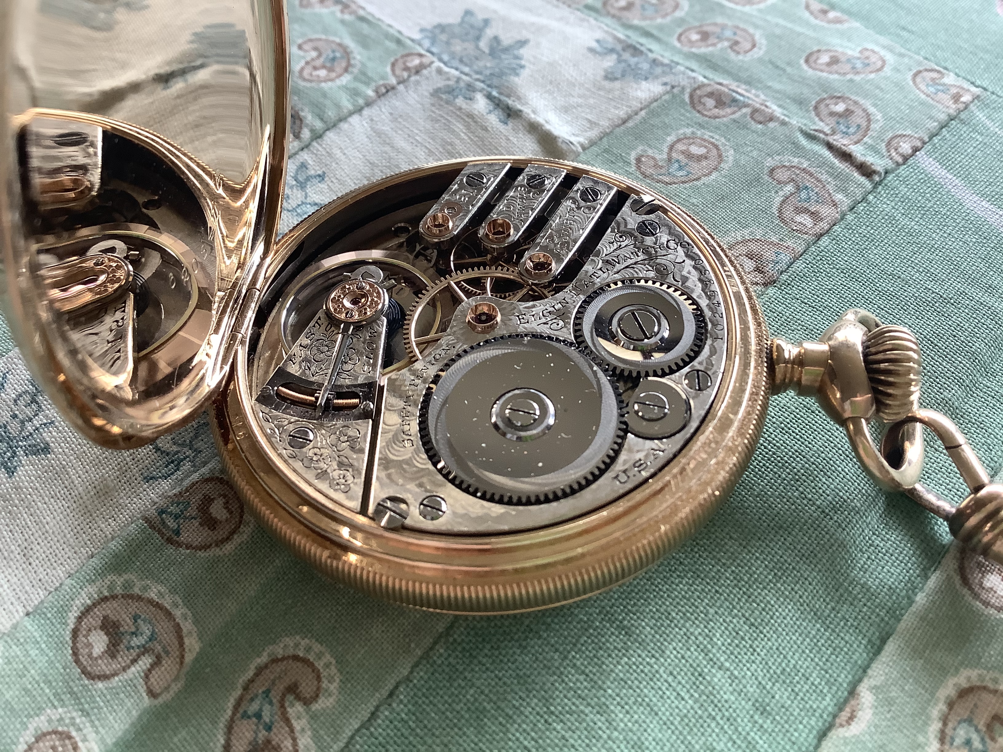

Elgin 156... this movement cost $100 wholesale in 1905, without a case. So top of the line then.
15,997
48,115
Ooooooh! Exquisite!

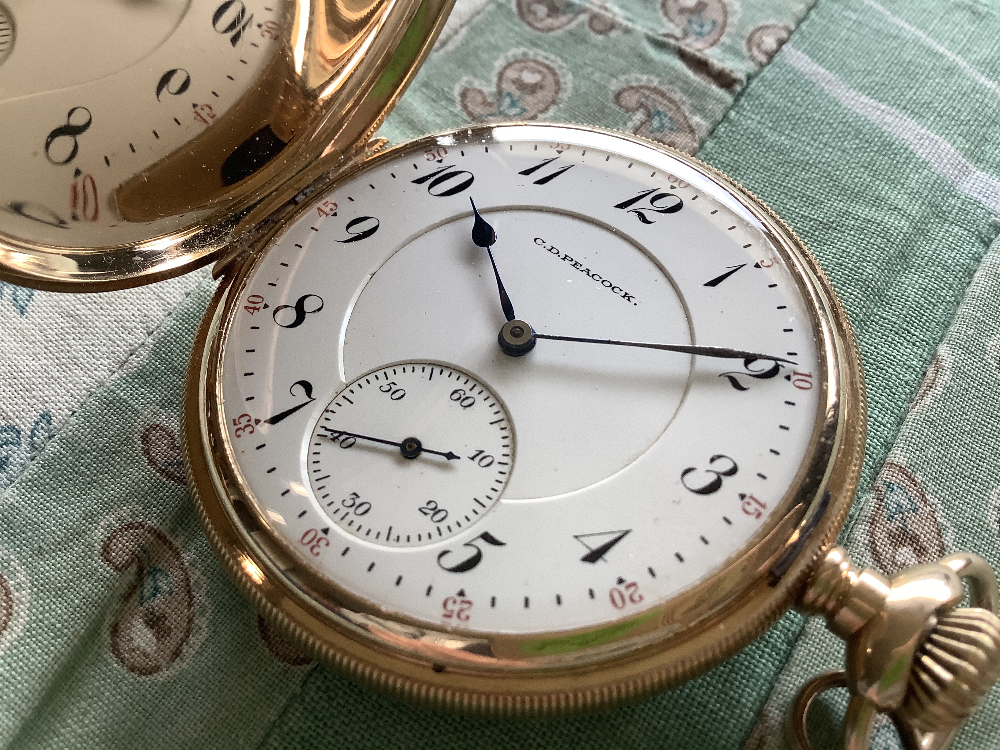

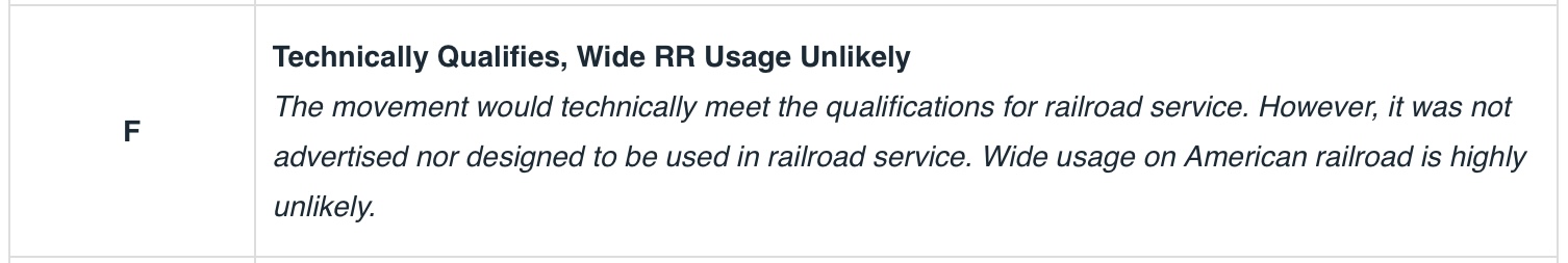

From the pocketwatchdatabase. With a production date circa 1904, the database listing shows this hunter cased movement to be railroad grade. Railroad grade, but railroad approved? Different railroads interpreted generally accepted time service rules as to what they permitted on their own railroads, so this one might have been railroad approved, somewhere. It has my approval! Please tell us more about the case.
https://pocketwatchdatabase.com/search/result/elgin/10249350
From Wikipedia.
https://en.m.wikipedia.org/wiki/C.D._Peacock

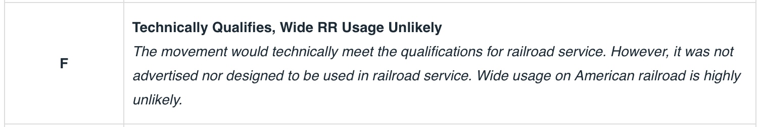

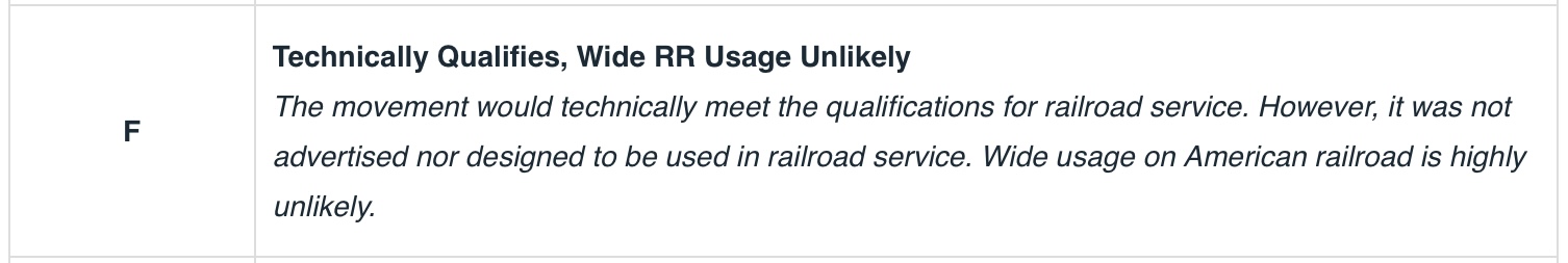

The data base classes this a “Class F”. The definition of class F.

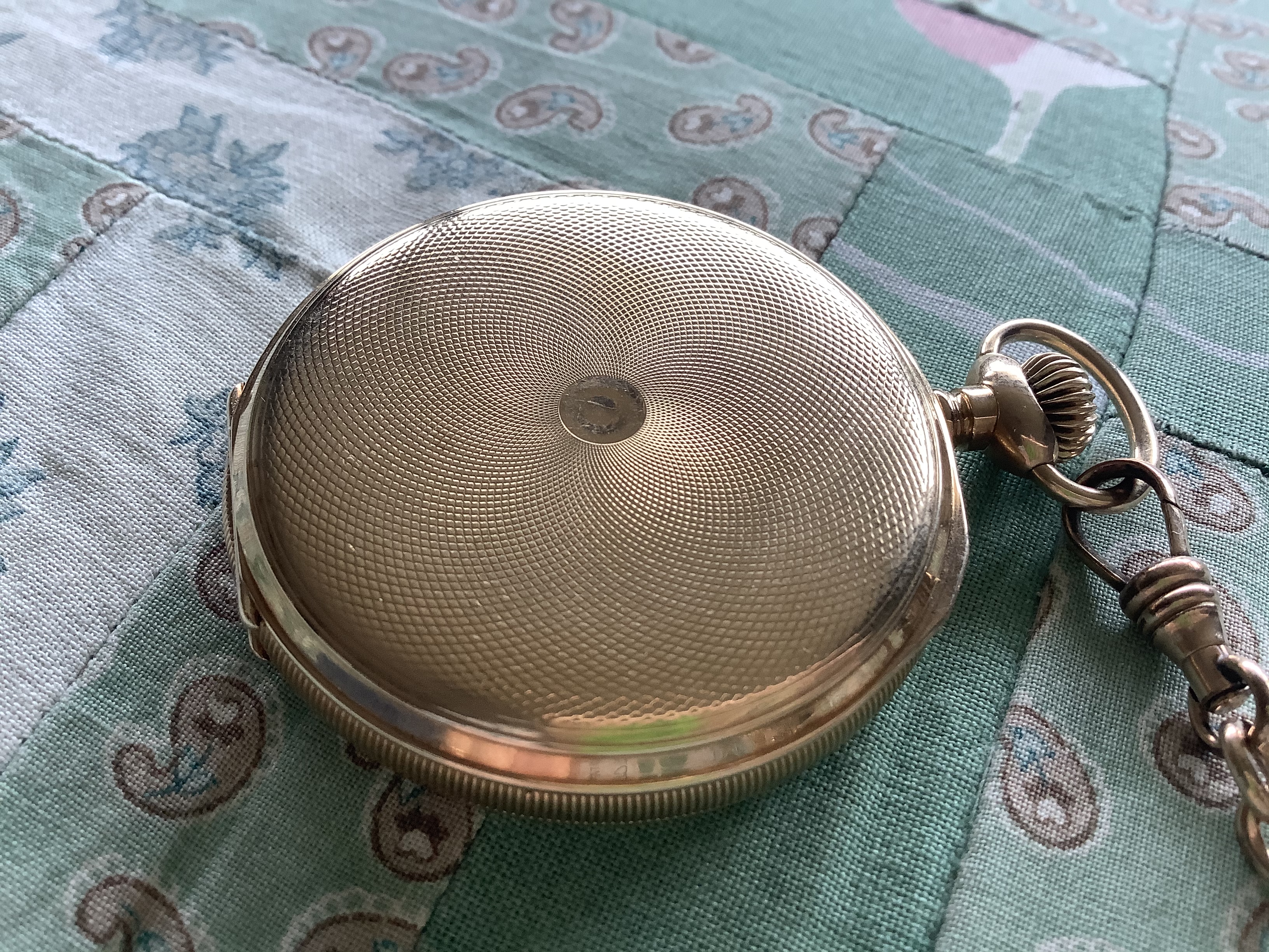

As C.D.Peacock styled themselves more as a high end jeweller I doubt this was sold to anybody who ever stepped on the deckplate of a steam engine. With a very expensive movement in a solid 14k huntercase, this was likely somebody’s dress watch and likely their pride and joy.
I’ll bet he drove a Packard.
I’m sure you are right. Classed as railroad grade F.
Definition:
If he paid that much for it in 1905 I feel quite sure he was chauffeured in a Packard! That sort of cash would likely buy a house,
Double sunk front, 3-finger inside and 14kt Hunter outer.......couldn't ask for more. 👍
I totally agree! A highlight piece, for sure. If. Was to stumble onto such a treasure, I think I would quit collecting. I wouldn’t be able to aim any higher.

Seventh day since last re-set. My 1877 model, 18-size Waltham, made circa 1885. Not railroad grade nor railroad approved, but dead on! Truth to tell, in seven days, it had been 2 seconds slow at one point, and 4 seconds fast at another. But this watch rivals the very best of my railroad approved models. (And the guy I bought it from wasn’t interested in paying for the repairs it needed! I am eternally grateful for people like him!)
This is the best piece I have. I always wanted a 3 fingered bridge Elgin as they are just such beautiful movements, but this thing just blew me away the first time I saw it. I had already called my pocket watch collection complete, but strangely was able to find room for this one.
Frau Fritz was mildly annoyed at the loss of our first born son until I offered to make his bedroom into a sewing room, that, and having to mow the lawn myself now have made this a relatively inexpensive purchase.
