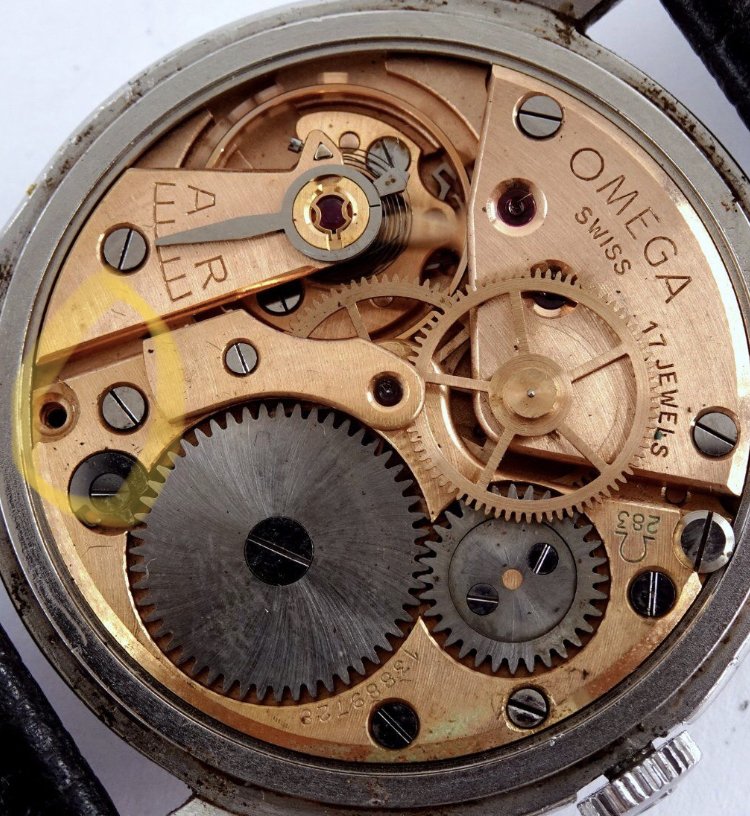

Z Posts 5 Likes 0 Zuirk ·Jul 22, 2024 anyone knows what is the role of this missing screw? the movement seems to work without it.
Posts 912 Likes 3,845 rendo ·Jul 22, 2024·faux legend It's a case screw, same as the one on the opposite side. That's how the movement is secured inside the case.
Z Posts 5 Likes 0 Zuirk ·Jul 22, 2024 rendo It's a case screw, same as the one on the opposite side. That's how the movement is secured inside the case. Great thanks!
Z Posts 5 Likes 0 Zuirk ·Jul 22, 2024 Archer Screw you need is Omega part 1072709. Thanks, btw is it normal that when i try to adjust the time and rotate the pointers anti clockwise the pointer of the seconds also rotates?
Posts 30,292 Likes 78,210 Archer ·Jul 22, 2024 Z Zuirk Thanks, btw is it normal that when i try to adjust the time and rotate the pointers anti clockwise the pointer of the seconds also rotates? Yes.
Z Posts 5 Likes 0 Zuirk ·Jul 23, 2024 Archer Screw you need is Omega part 1072709. Are you aware of any web store selling that? Thanks again
