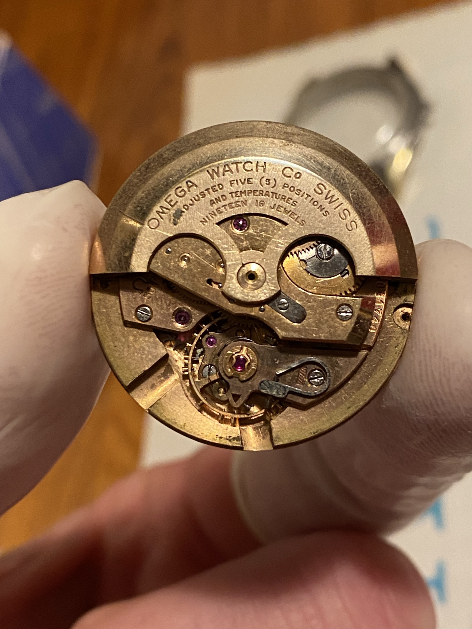

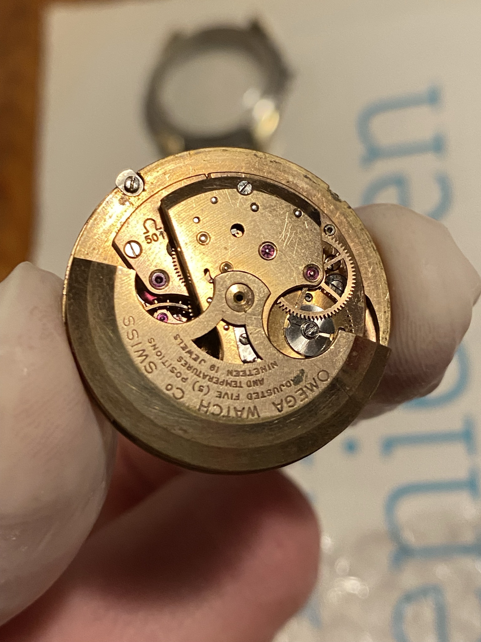

He folks,
I’ve got a 2852 that’s a bit of a project. It’s one of the earlier examples with a cal 501, not in running condition and with parts missing.
My assumption is that while the adjustment process was different, which was duly noted on the rotor, the other parts are interchangeable with “regular” cal 501s, is that correct? I’d then save the rotor and the serial as a bare minimum and would use a donor movement to complete it. Finding a donor 501 isn’t difficult - finding one that was chronometer certified much more so, hence the question.
Thanks a lot for the feedback!

The movements are technically identical, though obviously more time would have been spent adjusting the balance assembly on the chronometer version before it left the factory way back. Remember also that back then, these watches were poised by hand without the benefits of electronics and lasers. If you drop in any old 501 balance, it's unlikely the timekeeping potential from a regular "clean and lubricate" service will give chronometer results. A master watchmaker with an Omega parts account, however, can adjust any 501 to run well within COSC with basically no beat error given enough money, time and effort. Depends what you want to spend and what your expectations are, I think.

Cheers, I just had to know if they're technically identical, thank you! The act of bringing them together, the service and everything that's part of it I'll leave to my watchmaker and I'm not bothered about extracting the very last second out of it's precision. Yes, it was running within COSC specs 65 years ago, but I won't get cross with an old lady for being ever so slightly slower in that elevated age. 😉
