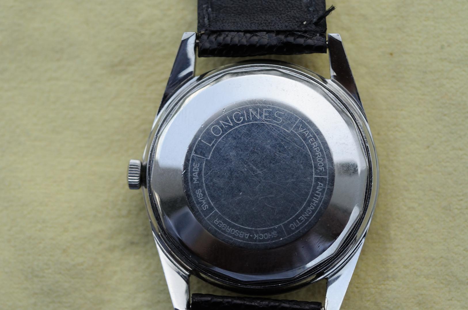

    Please school me briefly on Longines and medallions or the lack of. I just acquired a Conquest with a cal. 291 with a non-medallion caseback:
