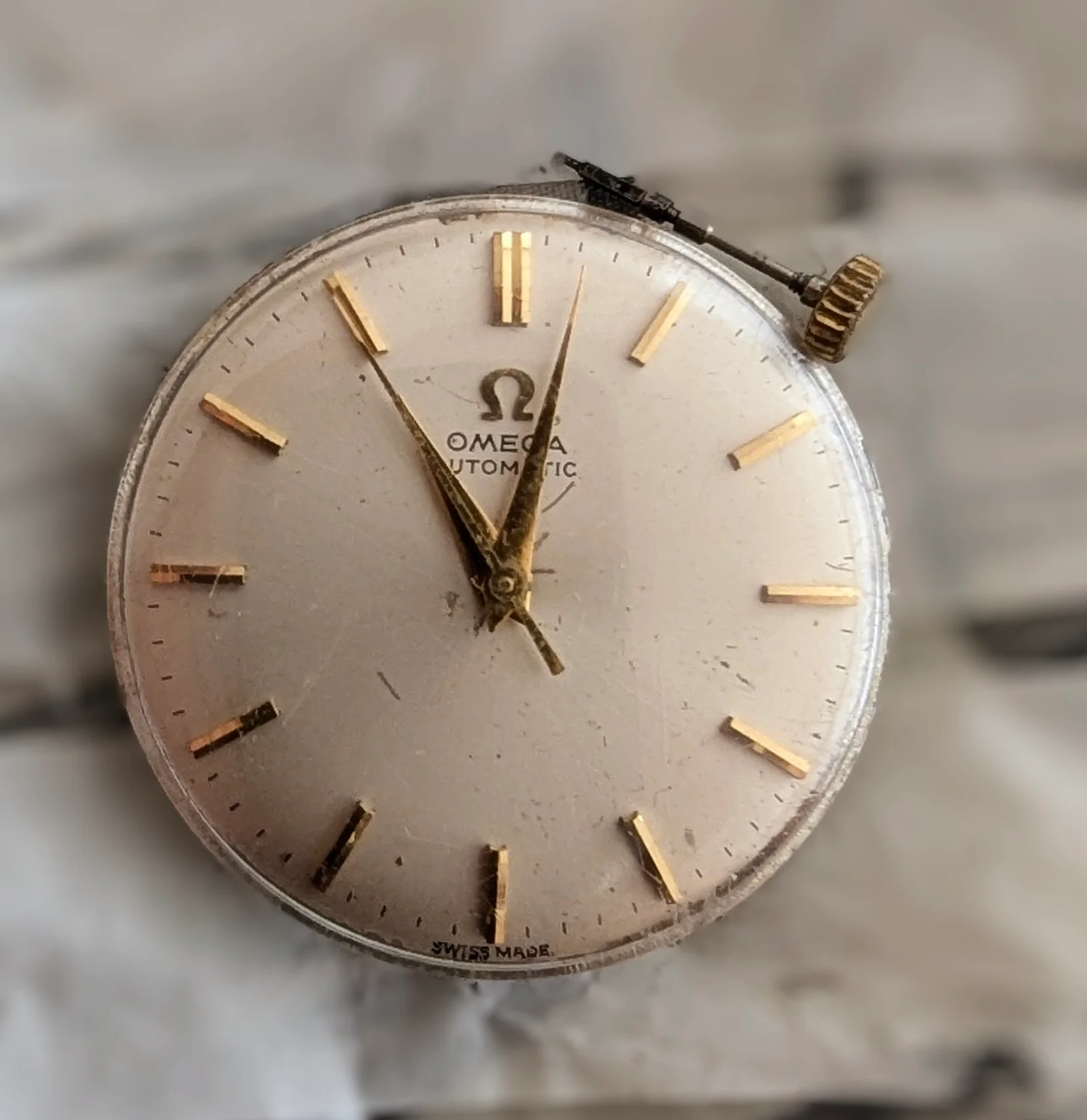

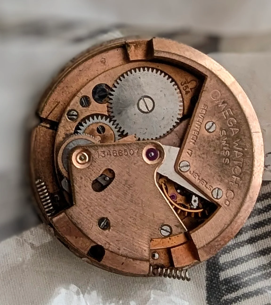

Hi Forum. Just trying to get your expert advice ! Found this in my Dad's drawer a few months ago. He is in his 90s now and I am lucky enough to have inherited his Speed master 2998 from 1960 in pretty good condition. That's another story! Is this a cal 354 movement from 1952 ? Not sure what model the watch face ? It seems to work fine as soon as you pick it up and I think it's been sitting in a little plastic bag for many years. No idea where the rest of the watch is !! Thanks

Your’s is a Seamaster.
Seamasters didn’t have ‘Seamaster’ on the dial until after 1954.

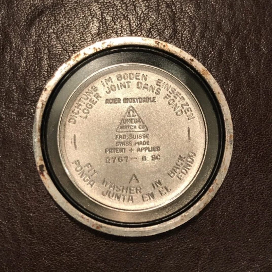

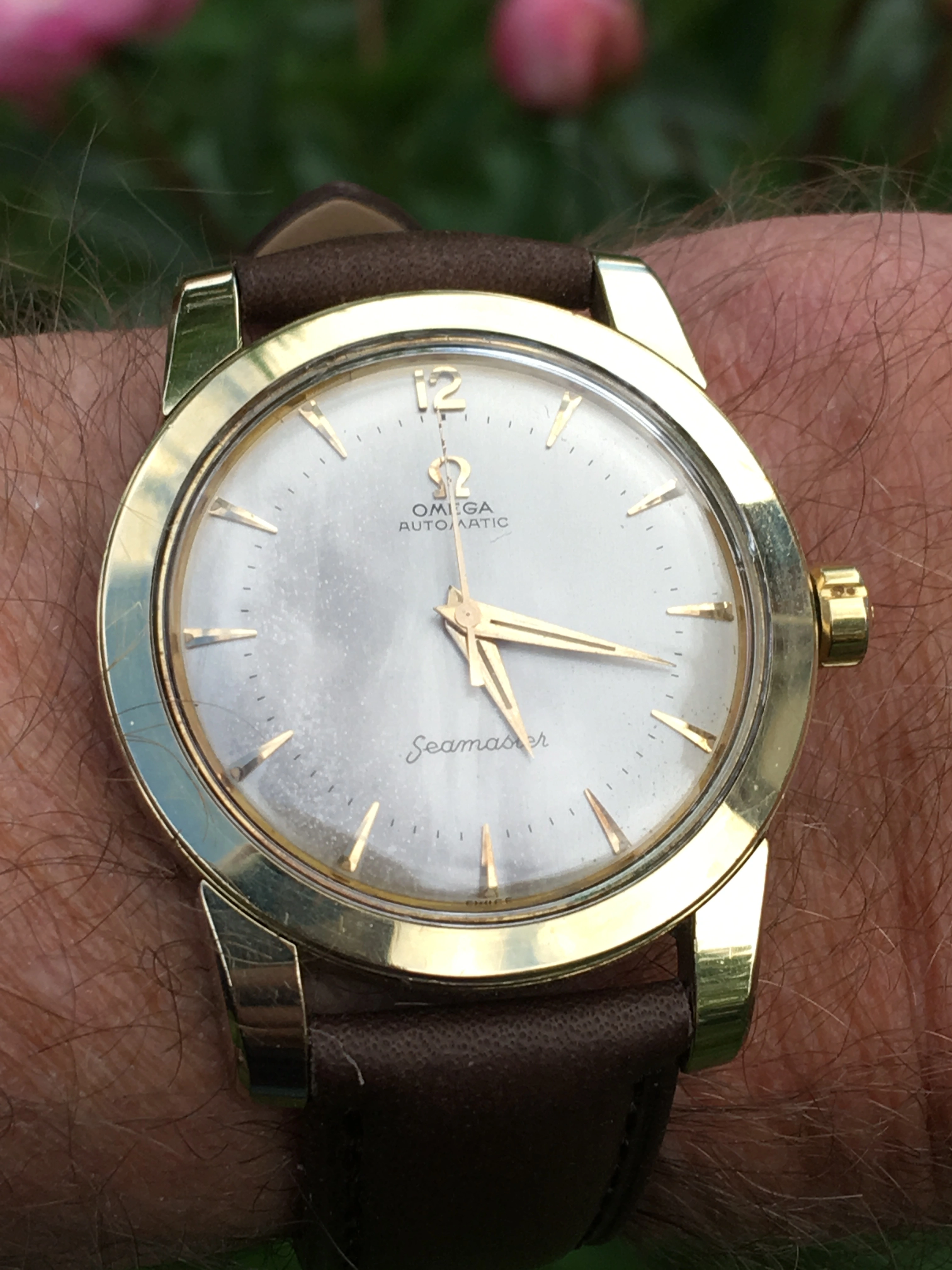

Mine, from 1954, has a 2767 case and you’ll have to start looking for a case or a watch with a good case but in poor condition.

Back in the bag and back in the drawer. Dial meh, movement condition poor. Springs out of position.
You don’t even know what case it was in. There are 2-3? Cases that could have come from.
Could email Omega with the serial number of the movement and they might be able to tell you, but if sold as a raw movement only. Ends there.

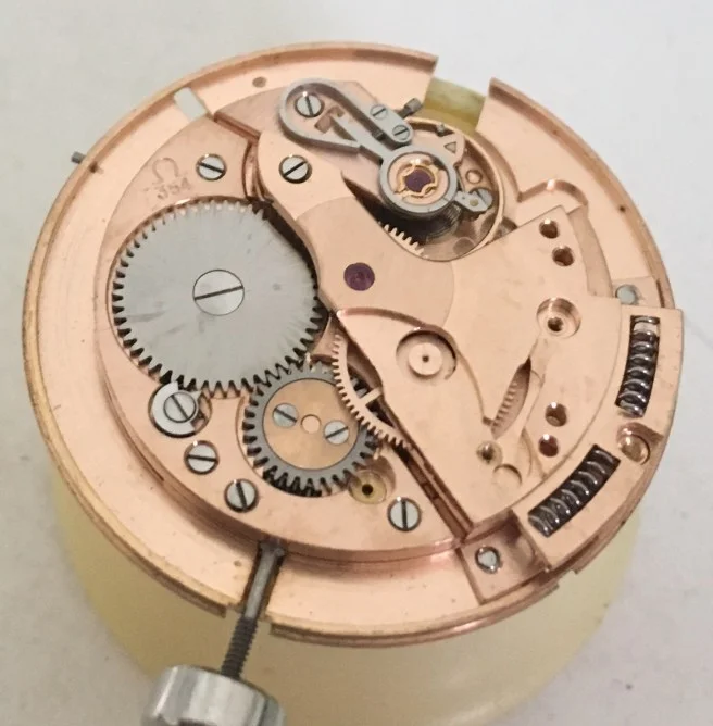

Unfortunately, I think you have a problem with the bumper springs. They should be entirely under the bridge. Like this:
The highest and best use for this movement is for parts that could save several other vintage watches.

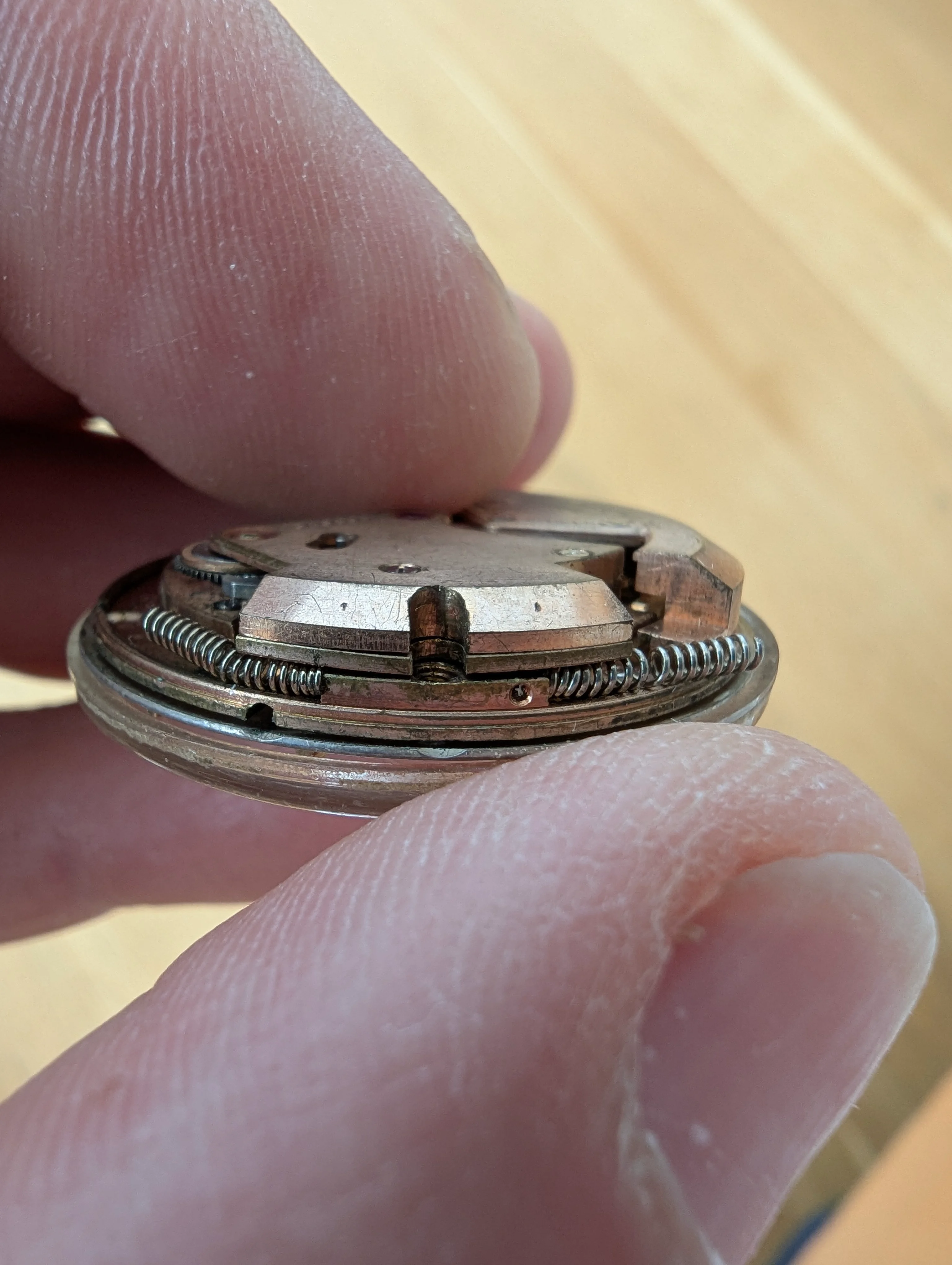

Just on the springs being the wrong way round..are they ? I am no expert and the springs don't look in best condition but to me they hit the part of the movement that moves with the seventeen jewels stamped on it..seey bad photo below!
Not sure I entirely agree. The 354 bumper movement was used in other lines apart from Seamaster. The SM text actually started to appear around 1950 and is seen on low 12m examples so this being 13.4m would most likely have SM on the dial if it were from a 2577, 2767 or similar. I'd suggest the lack of text suggests it is from another line altogether, or perhaps none ie one of the so called 'International Collection' watches. It has been persuasively suggested on MtV's excellent 2577 thread that no 354 movement Seamaster should have a sterile dial due to that movement only being introduced around 1952, with all SMs being so marked by that point.
Those are not the correct springs. Don’t even know what those are from, but not Omega and not even for a watch. Original are shown in gators image. Tucked under the rotor bridge.

Maybe but Gaytors mvt is a 354 like mine but mine does not seem to have the same space for the springs like they are different 354 versions ?

Maybe but Gators mvt is a 354 like mine but mine does not seem to have the same space for the springs like they are different 354 versions ?
I agree with @DON. The springs are supposed to be hidden underneath the bridge with just a small portion exposed. There were a few Omega bumper automatic movements with fully exposed springs, but these were not the cal. 354.
