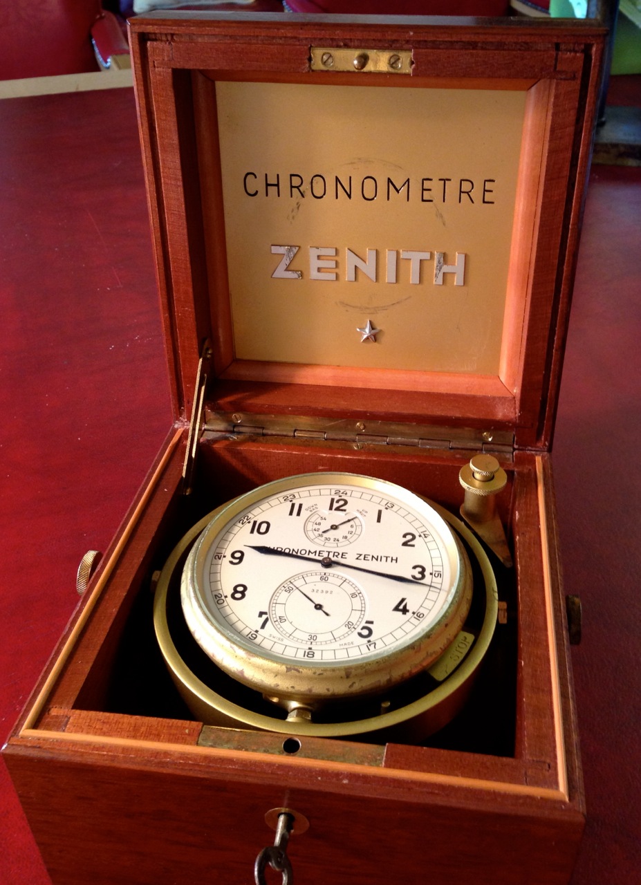

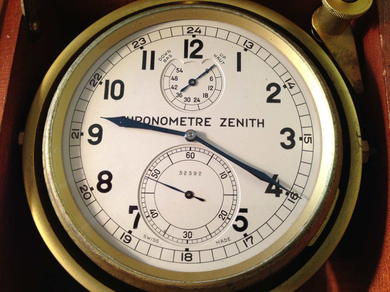

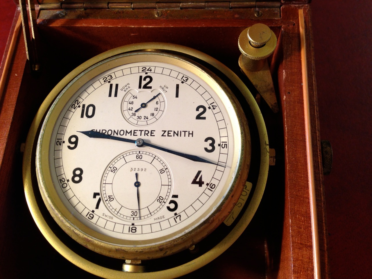

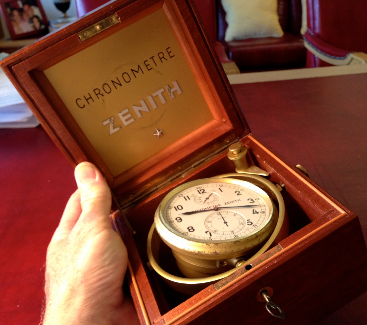

    Zenith's cal. 26x range was produced from 1920 to 1968 and was developed from an 8-day car clock with bezel winding and setting. This series was the mainstay of Zenith's reputation for observatory accuracy for 40 years.
    Illustrated is the cal. 260 version, sold as a marine chronometer, gimbal-mounted in a wooden box. Like its predecessor, it is wound and set via the bezel. The gimbals, of course, kept it horizontal whatever the ship might be doing. I have not photographed the movement (#32392), but will have it photographed when I have it serviced. Presently, it is keeping good time.
    Also illustrated is the timing certificate from 1964 and the original instructions in Spanish for the Zenith 'Cronometro Marino'. I found it in Madrid.
    Also produced were the cal. 261 (observatory version for competition - also gimbal-mounted in a wooden box) and cal. 262 (shop-window clock for watchmakers, wound and set from the back).
    IMG_0240.jpg IMG_0241.jpg IMG_0242.jpg IMG_0247.jpg IMG_0248.jpg IMG_0243.jpg IMG_0251.jpg

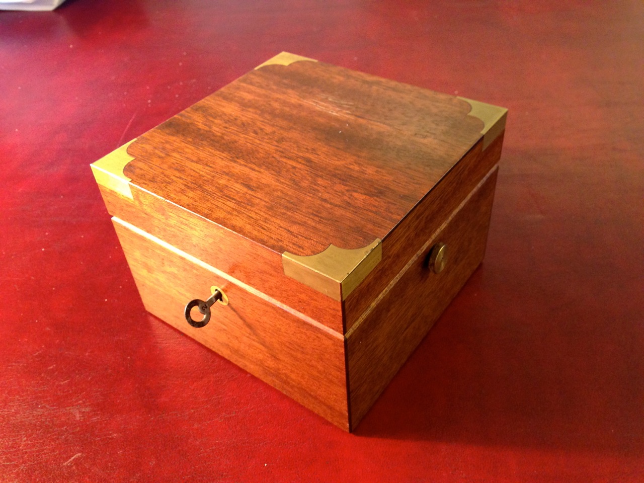

    Unlike many marine chronometers, it does not have a protective glass cover under the wooden lid, but however buyers may have used it, it was marketed as, in this case, un Cronometro Marino, doubtless in anticipation of a new Armada. (Nobody expects a Spanish invasion!).
    The use of the bezel for winding and setting (manipulacion y puesta en marcha) had led to inevitable wear-through of the gilt on the bezel, but it adds a lovely mechanical feel to the process.
