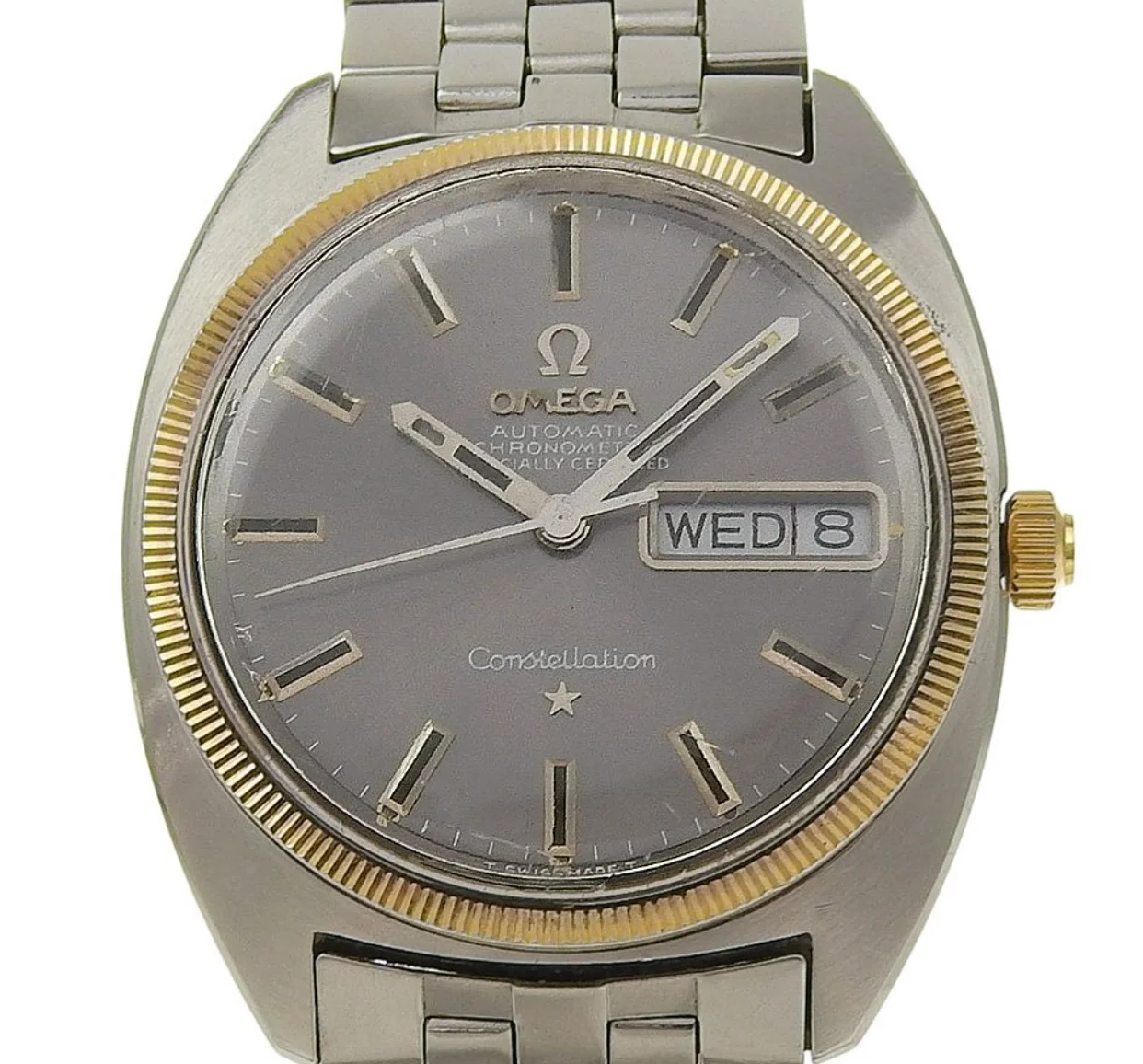

Hello,could someone tell me p[ease
was the C shape 168.027 stainless the only case with a solid gold bezel
Thanks
48
11
If thats the case can tell me which other models had a solid gold bezels
apart from all gold watches .Regards
6,790
10,446
All gold-capped Constellations had solid gold bezels.
But AFAIK, the C case you refer to is the only SS Constellation that had a (white) gold bezel.

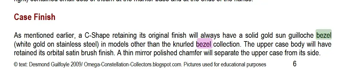

To revive this - has anyone seen this published in a period catalogue or de-mounted a bezel and found a hallmark or tested a bezel?
Like @calart, I'm curious about mine, have seen all the comments and read Desmond's treatises (excerpt below) but haven't seen an official/documented/tested source. .
https://omega-constellation-collect...12/constellation-c-shape-omegas-child-of.html

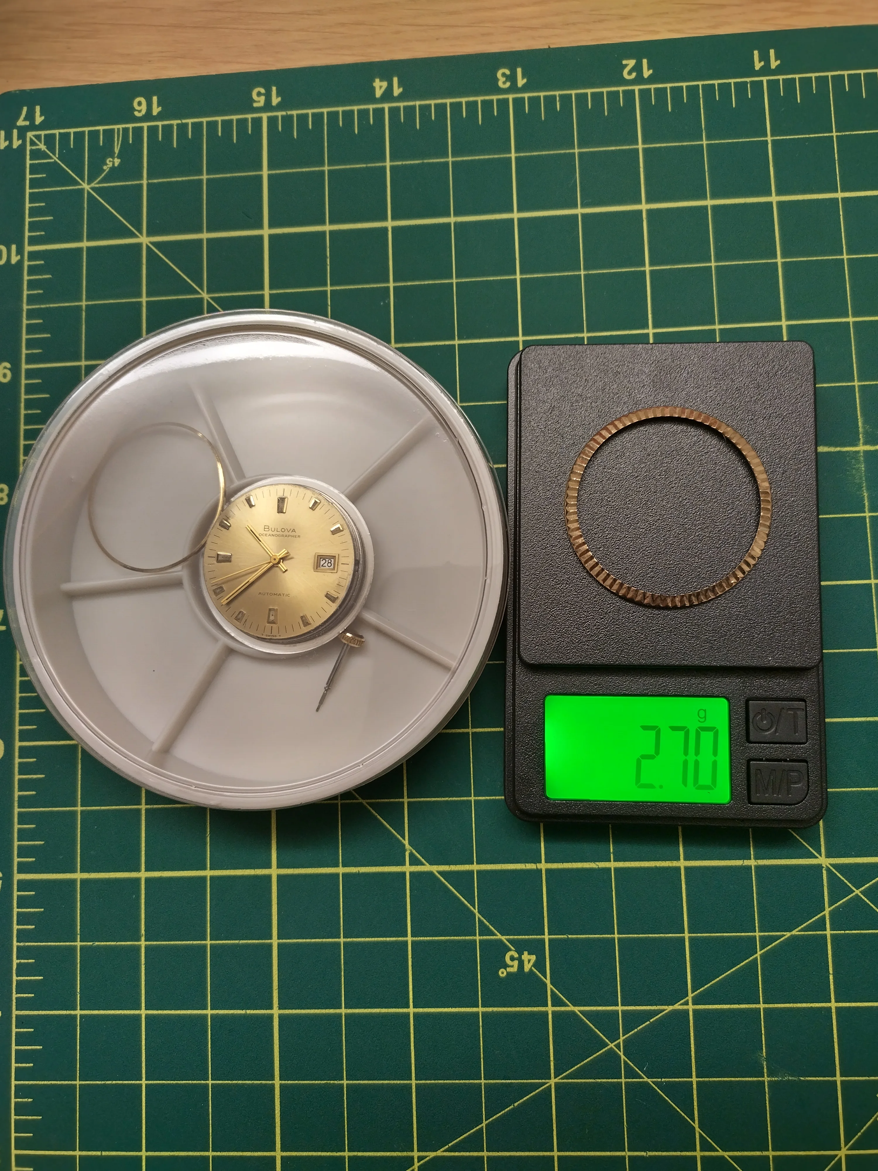

I weighed a 10k bezel from a Bulova when I had it apart for cleaning and it was 2.70g.
