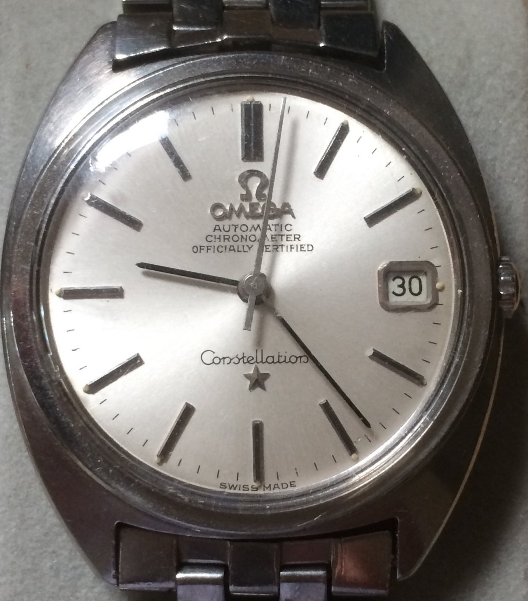

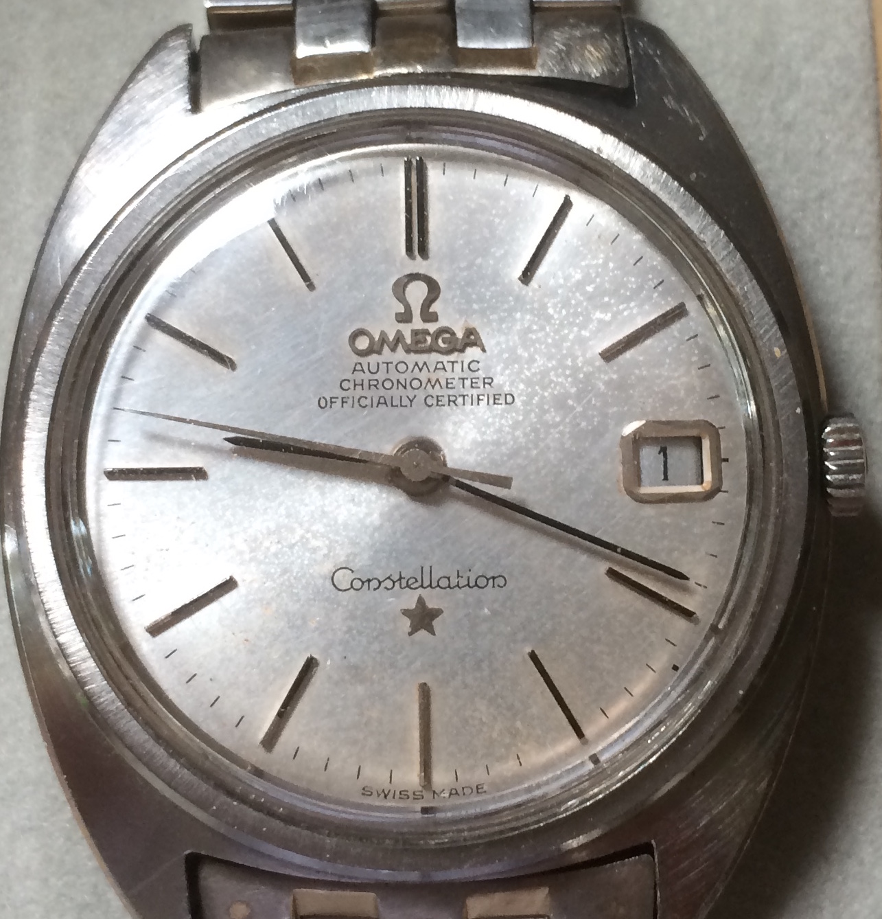

OK so I need to get a life - how could the star position on a C Case dial be so annoying?
Well, here's hoping some of you C case aficionados can help with this query. Apologies if this has been covered in previous threads - I did search, but to no avail...
Two examples of the same ref. 168.017 from my little hoard - but the star position under the Constellation script is noticeably different on each one.
The first (very worn) dial there is a clear gap between the star and the script above; on the second example (with a spotless dial) the gap is barely there at all.
Is this second example a worrying sign of redial tinkering? Hoping that C case experts may reassure me there are variances in the position of the star.
I have studied the scripts, MOY etc closely on both watches, and they seem kosher. But this star positioning is bugging me. The silver dial is immaculate - too good to be true? I've already spotted the crown is incorrect BTW. Any thoughts much appreciated.

Second one appears to have been refinished. Lume with plain stick hands...Second hand has been replaced as well.

Under closer scrutiny - I see the second hands appear different as you say (the short end of the second one is, er, shorter) Thats not something I would have noticed

But are there lume plots at both 4 and 5 o’clock on the first C case posted ? ( also with no lume hands)?

Re: the first pic -the black finish on some of the hour markers has worn away at the edge (especially the 9 o clock) so it looks like a lume plot. But no lume, unlike the second pic, which clearly has lume plots.
I seem to vaguely recall a discussion about lume plots on thin hands
