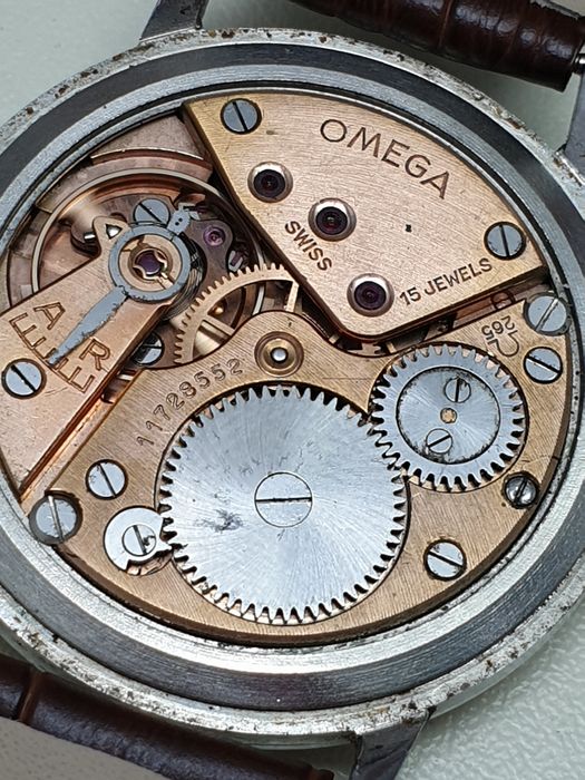

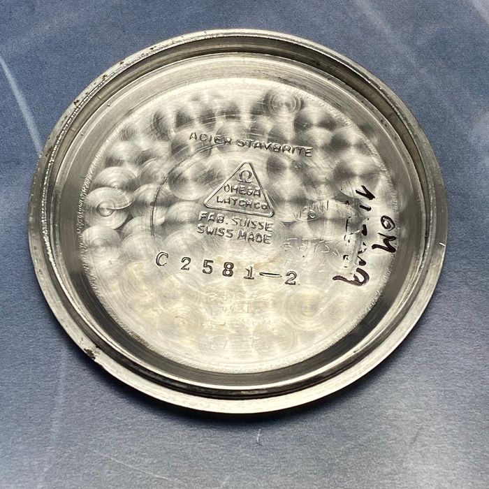

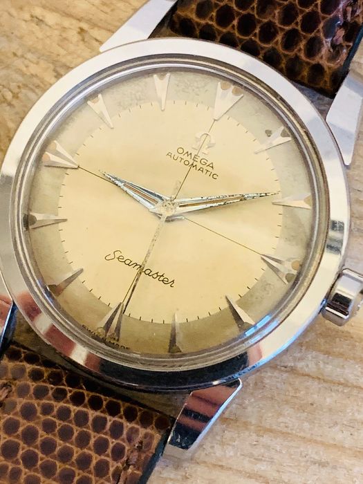

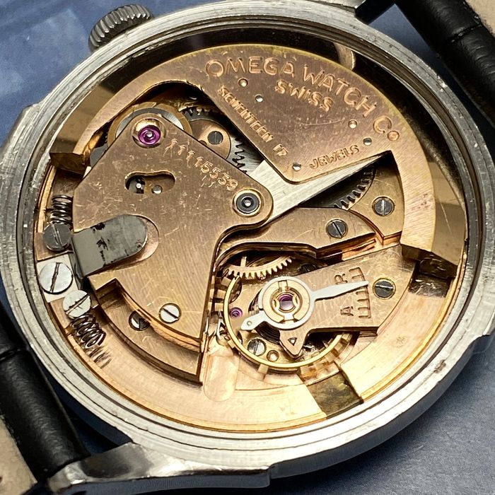

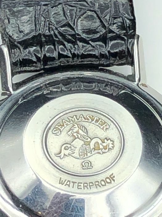

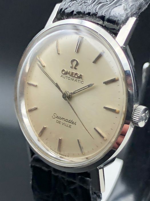

Hi guys and Happy New Year! I am a new member who is looking to buy a vintage Omega and I would highly appreciate your thoughts and feedback as I am very new in the omega world. I would be glad if you could tell me what do you think about the authenticity of the models as well as if there any "redial" in any of these models.

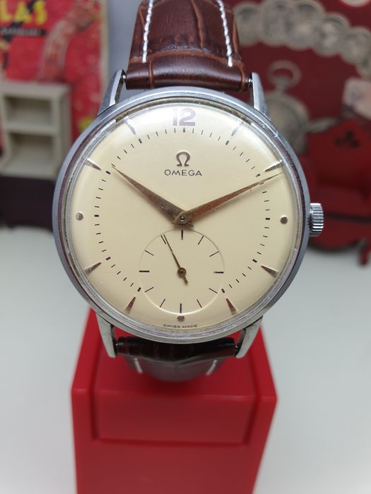

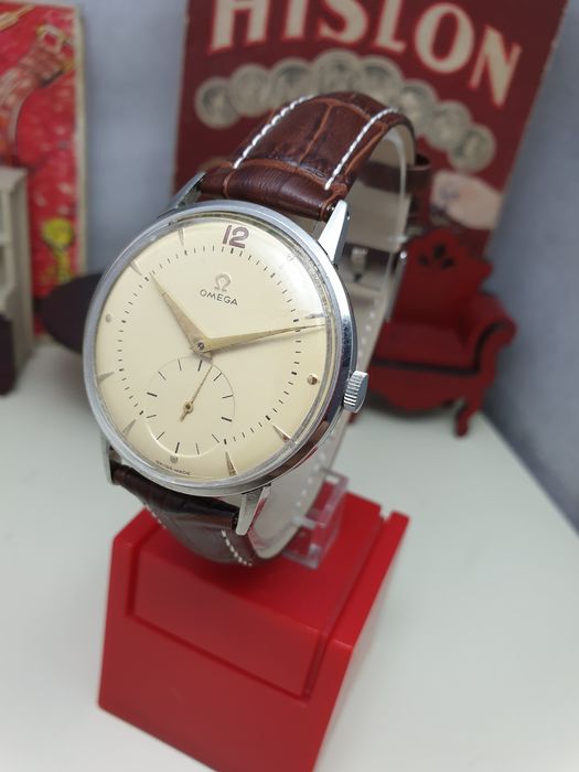

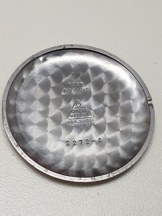

Option 1: Omega Jumbo 38 from 1947: Pictures 1-4

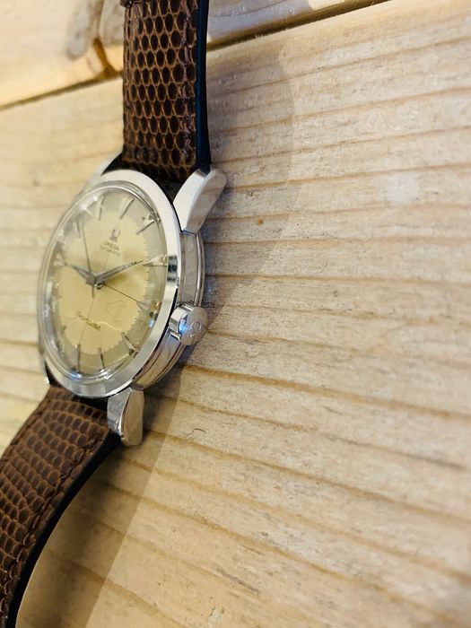

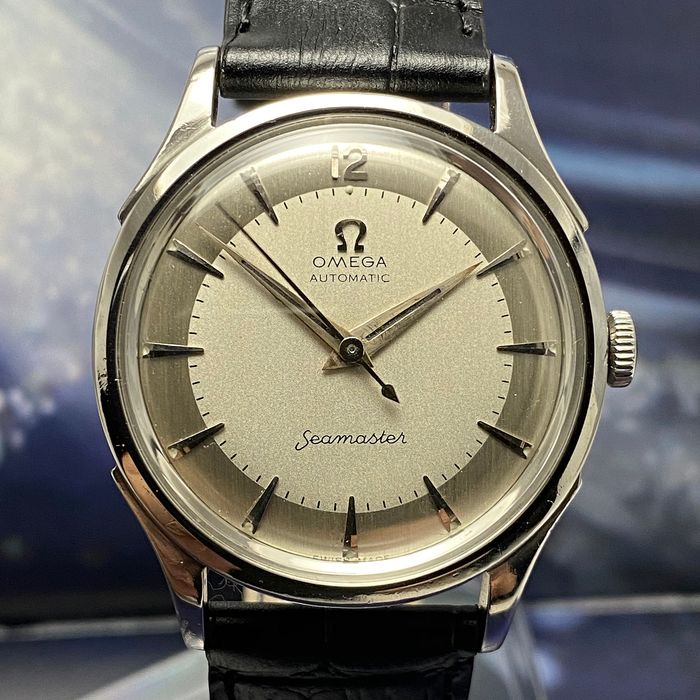

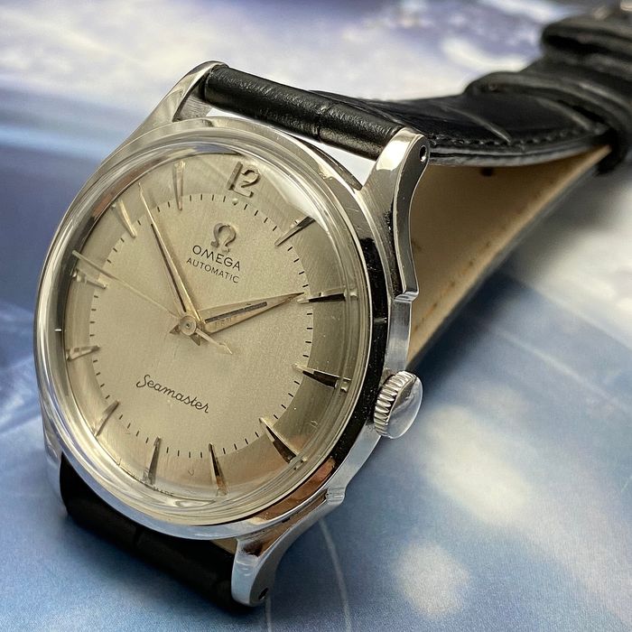

Option 2: Omega Seamaster two tone dial 1950s: Pictures 5-8

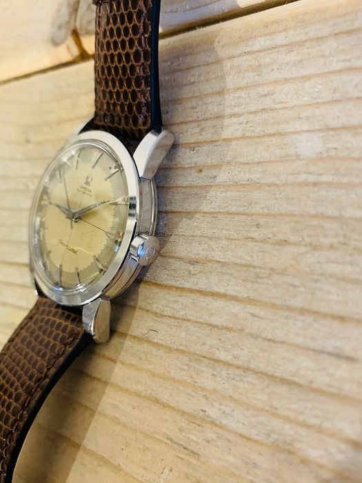

Option 3: Omega Seamaster two tone gray dial 1950s: Pictures 9-12

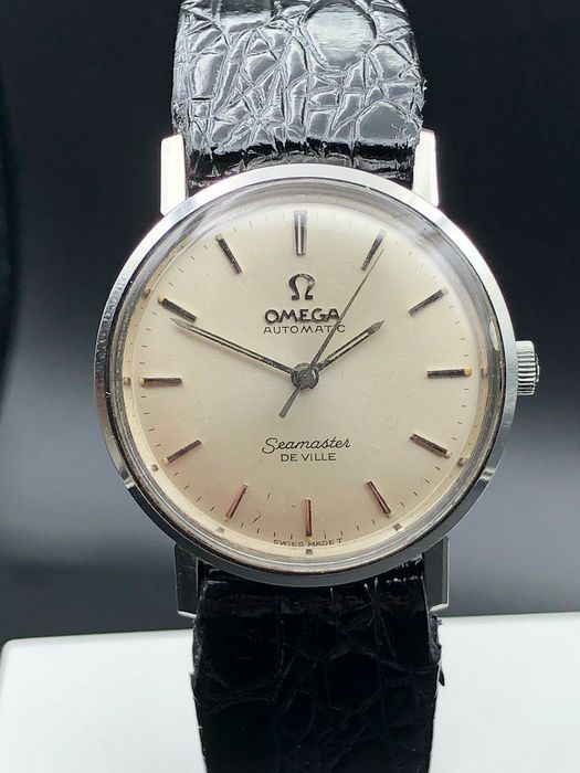

Option 4: Omega Seamaster Deville 1960s: Pictures 13-15 (no pics of the calib are provided in the ad)

My two cents:
Option 1: redial
Option 2: nice watch, all original AFAIK, quite attractive
Option 3: probably redial, wrong crown
Option 4: honest watch, original dial.

Option 1 I'm not too sure on the dial, something in the first photo with the letter of "Omega" that doesn't quite sit right with me, but I'm no expert I think some of the other more experienced members would be able to that dial is original.
Option 2 The dial definitely looks original to me, can't quite see from the photos but the case looks like it might have been polished due to the rounding of the lugs.
Option 3 Dial also looks original, agree with Bardamu on the crown it's not signed so will be a replacement with detracts from the value and desirability.
Option 4 Dial also looks original as well, can't see any issues with the case or crown either.

On option 2 I don't like the font of "Omega Automatic", but honestly "Seamaster" seems original to me.

Thanks a lot guys for your time and help! two more questions:
1) Should I be worried that in Option 4 there is no photo of the mechanism?
2) In general what price range do you think would be reasonable for the aforementioned watches based on your experiences?

1) likely front-loaded i.e. everything is assembled through the front of the watch, I would think the seller would need to completely disassemble the watch to get a picture of the movement.

Be aware that option four is only about 32mm, AKA mid-size, which is significantly smaller than the standard 34mm SDV.
Number one is a bad redial.

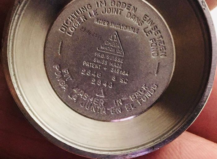

Number three is a complete franken, not a Seamaster and the movement should be a 28,10 RA, which is a sub-seconds movement.

Option 2 and 4 are honest and show their age in an appealing way.
1,625
6,077
Agree. I'd go for option 2.
