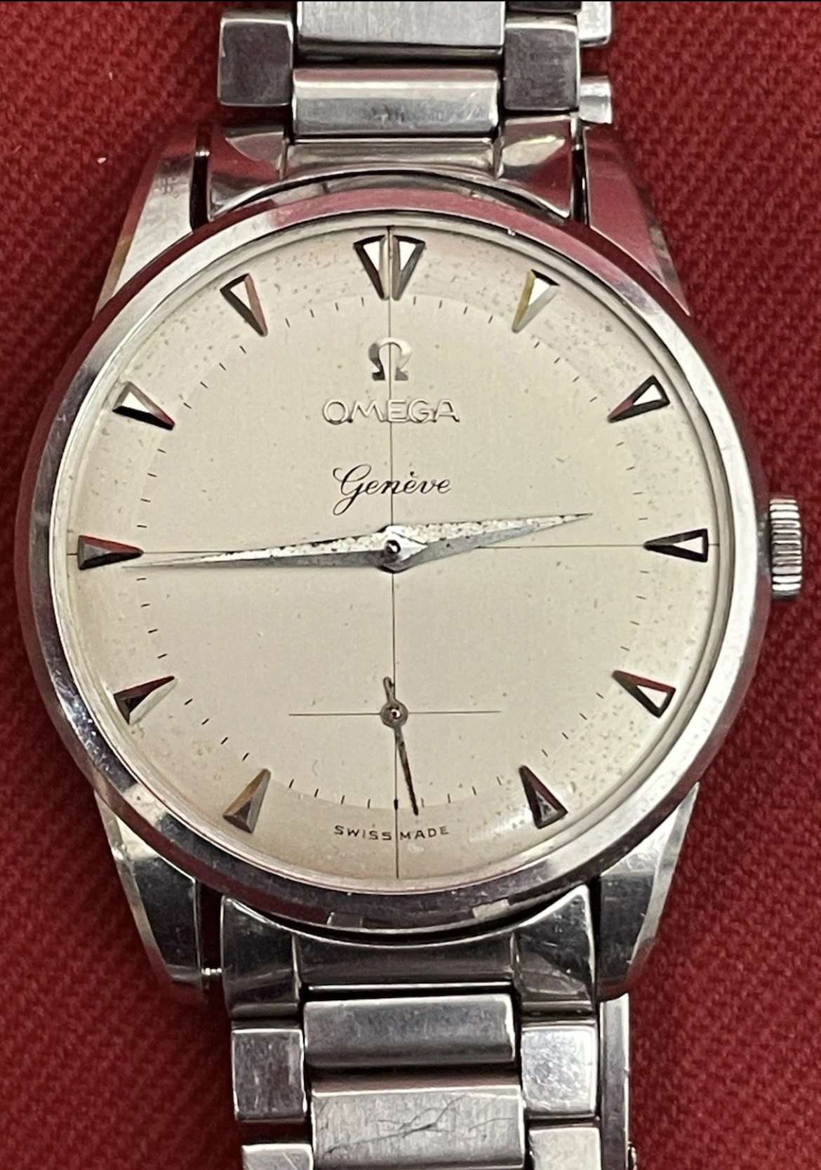

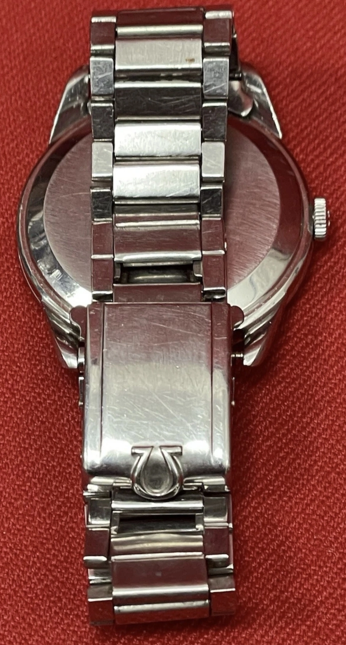

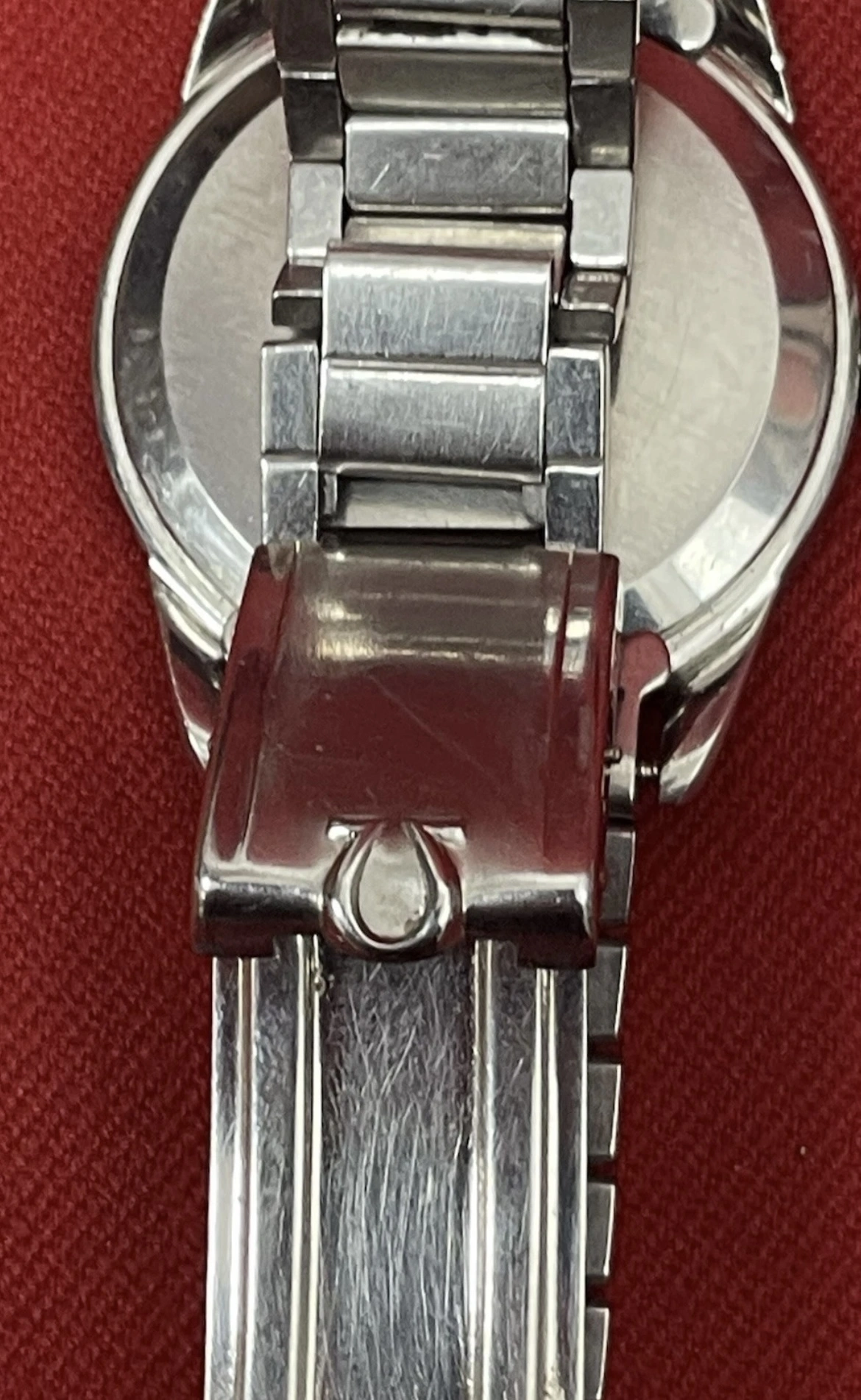

Hello OF,

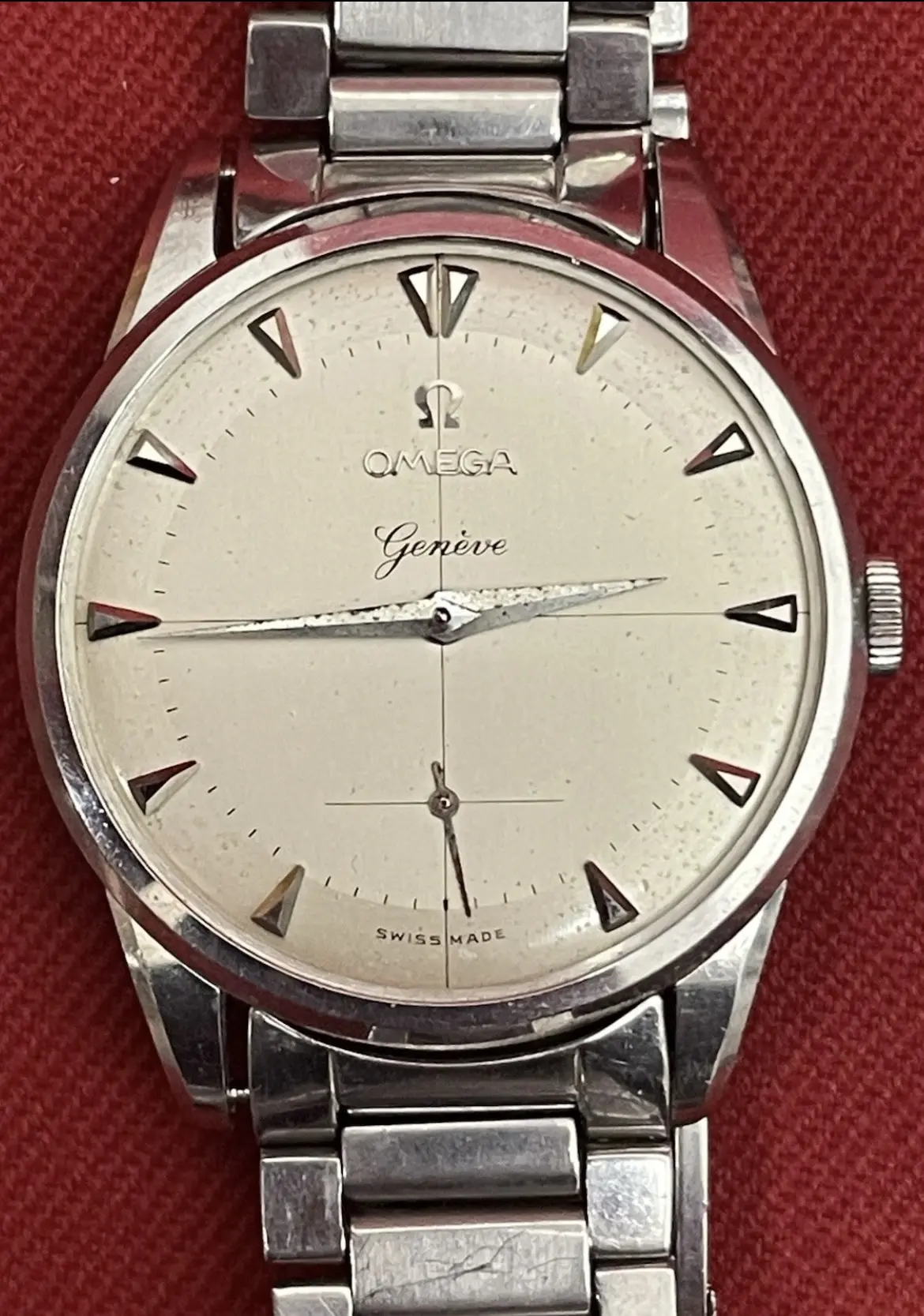

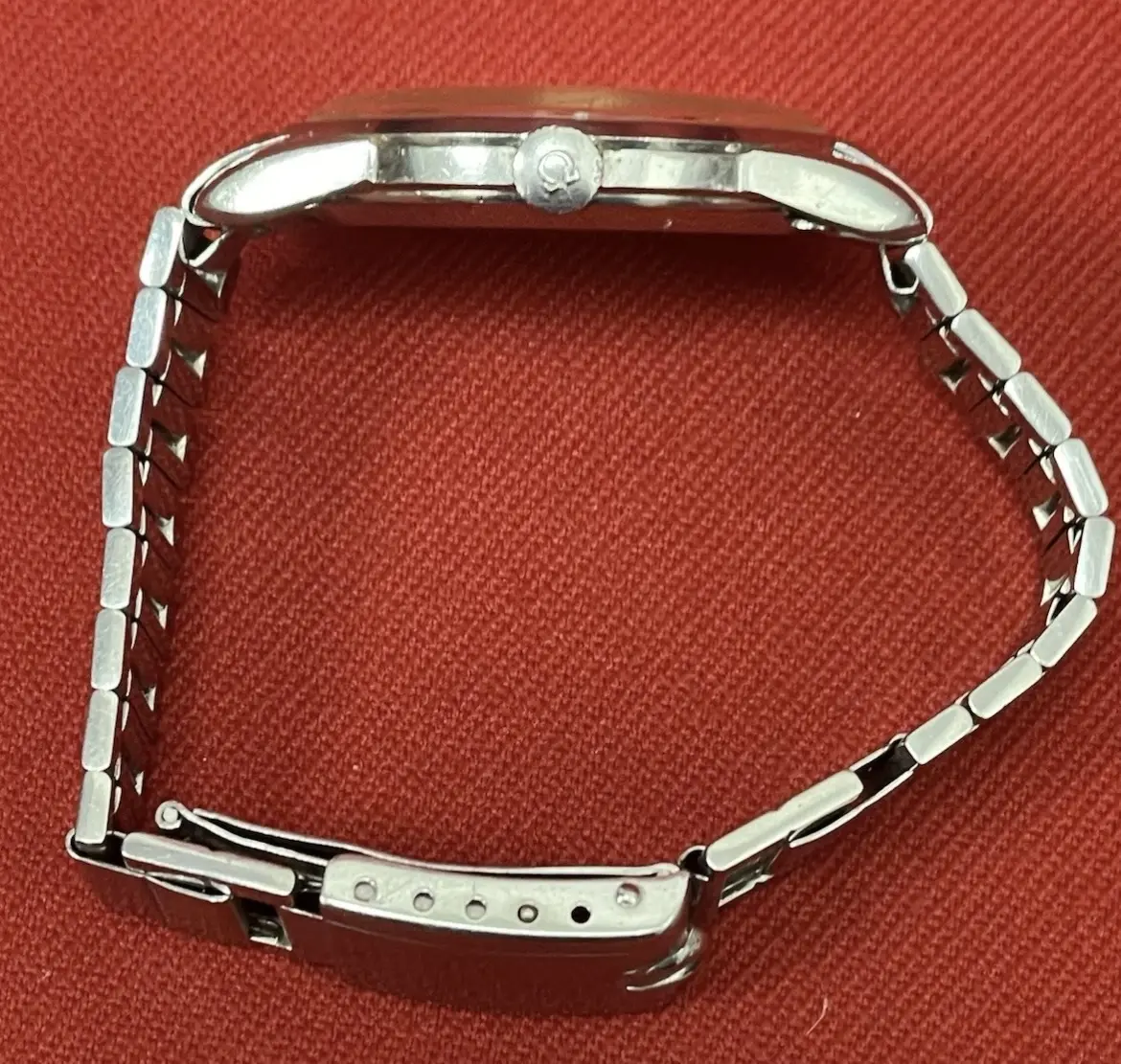

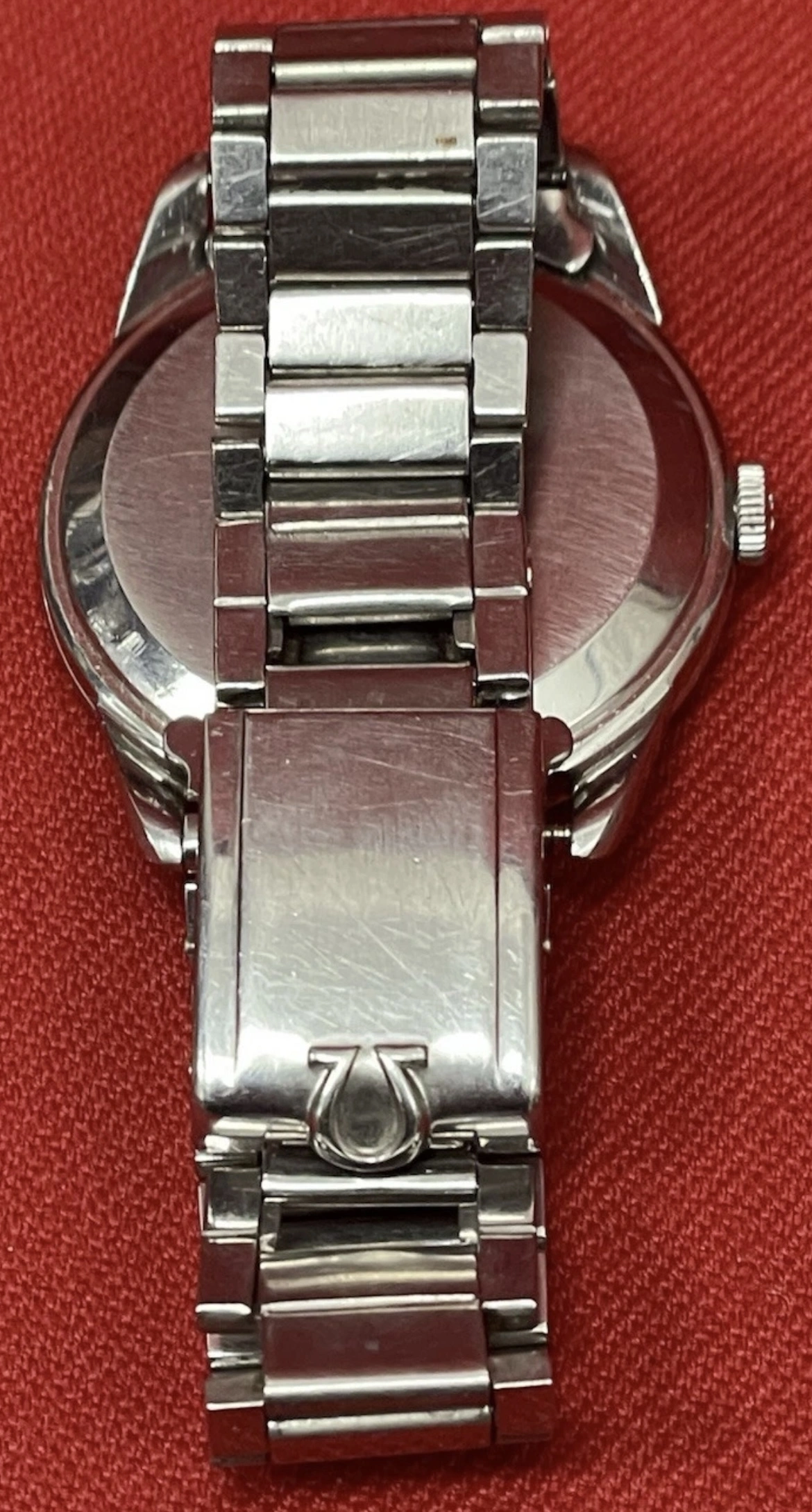

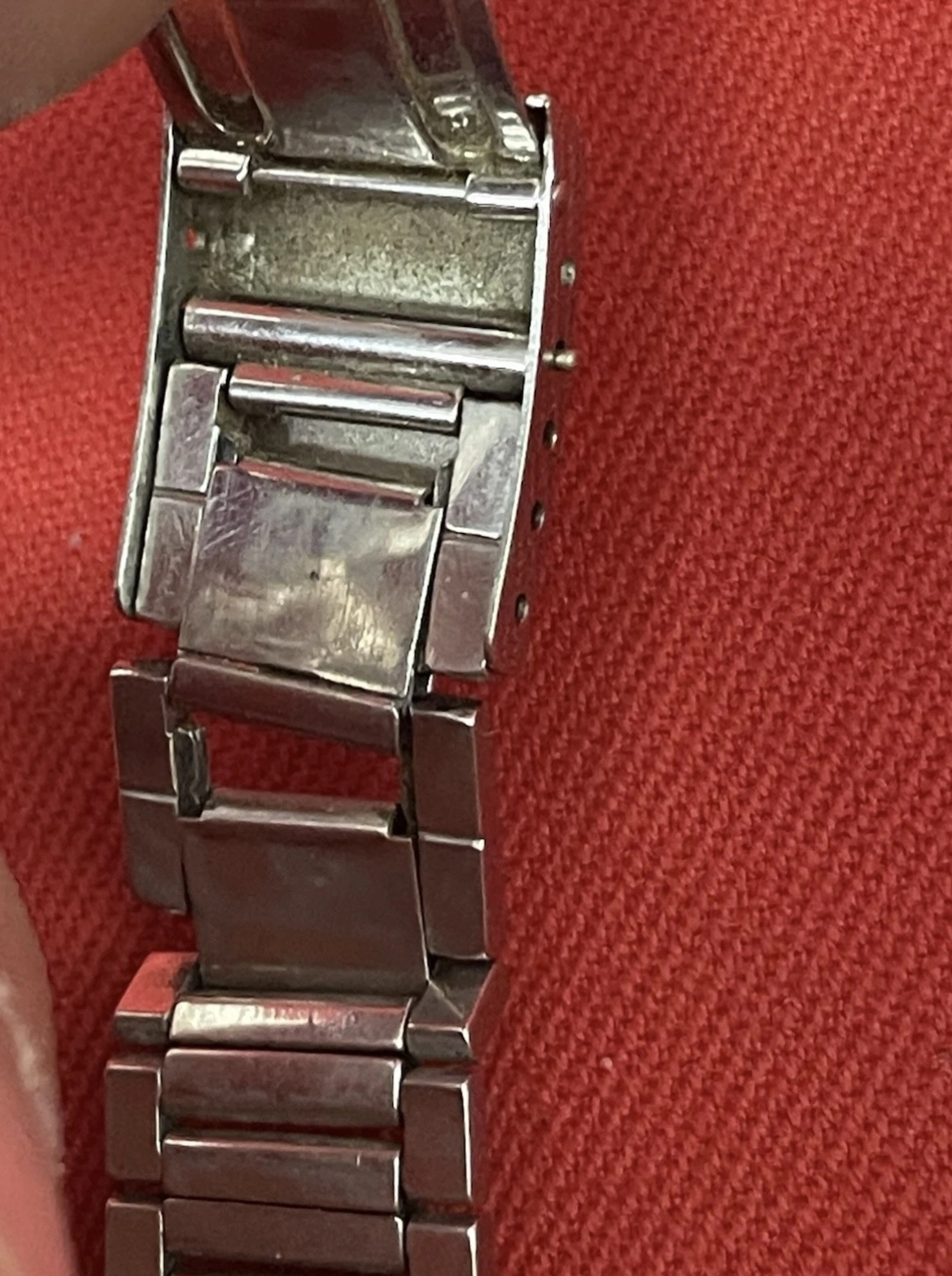

I am interested in an upcoming auction. However the watch, which is my primary interest, is fitted with a broken flat link bracelet.
I don’t have much experience with these, and struggle to understand:
1/ how hard it is to fix and
2/ what a fair value would be so to not miss out on the auction
See below some pictures of the bracelet.

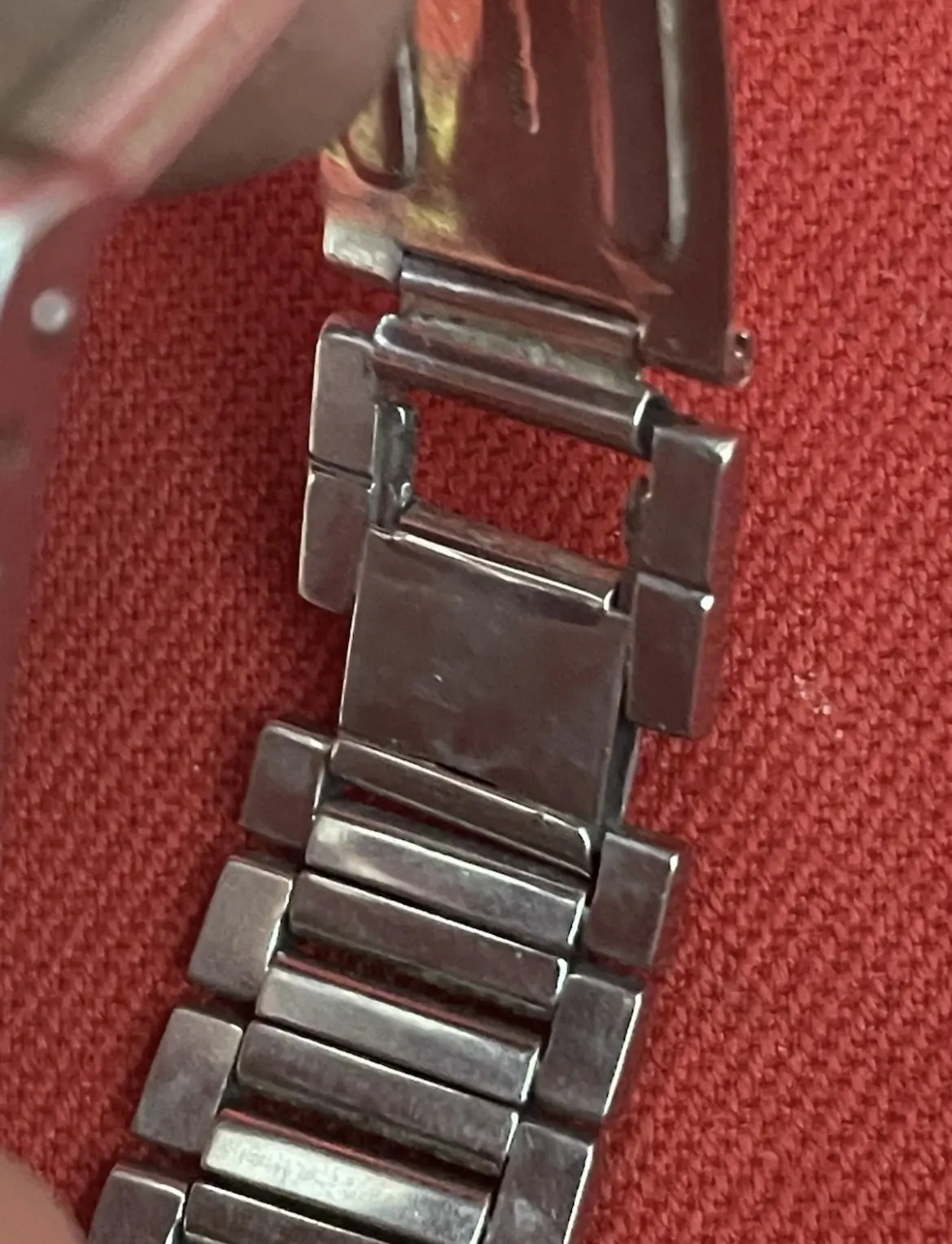

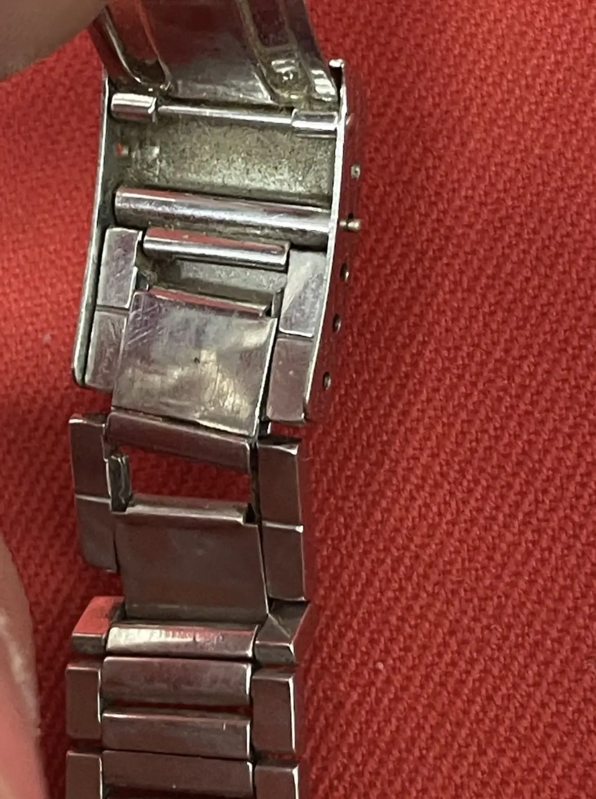

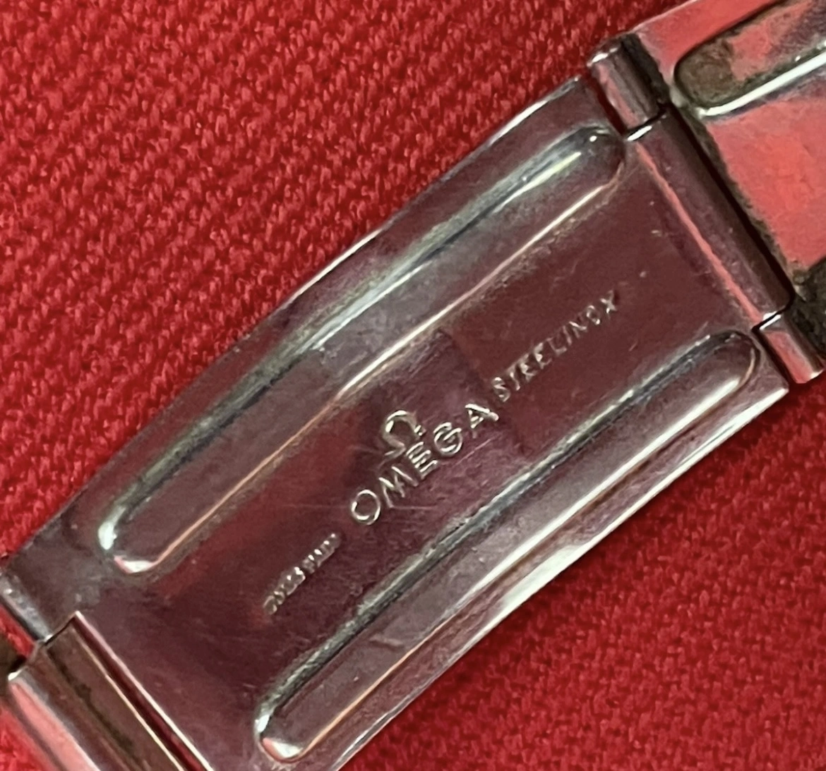

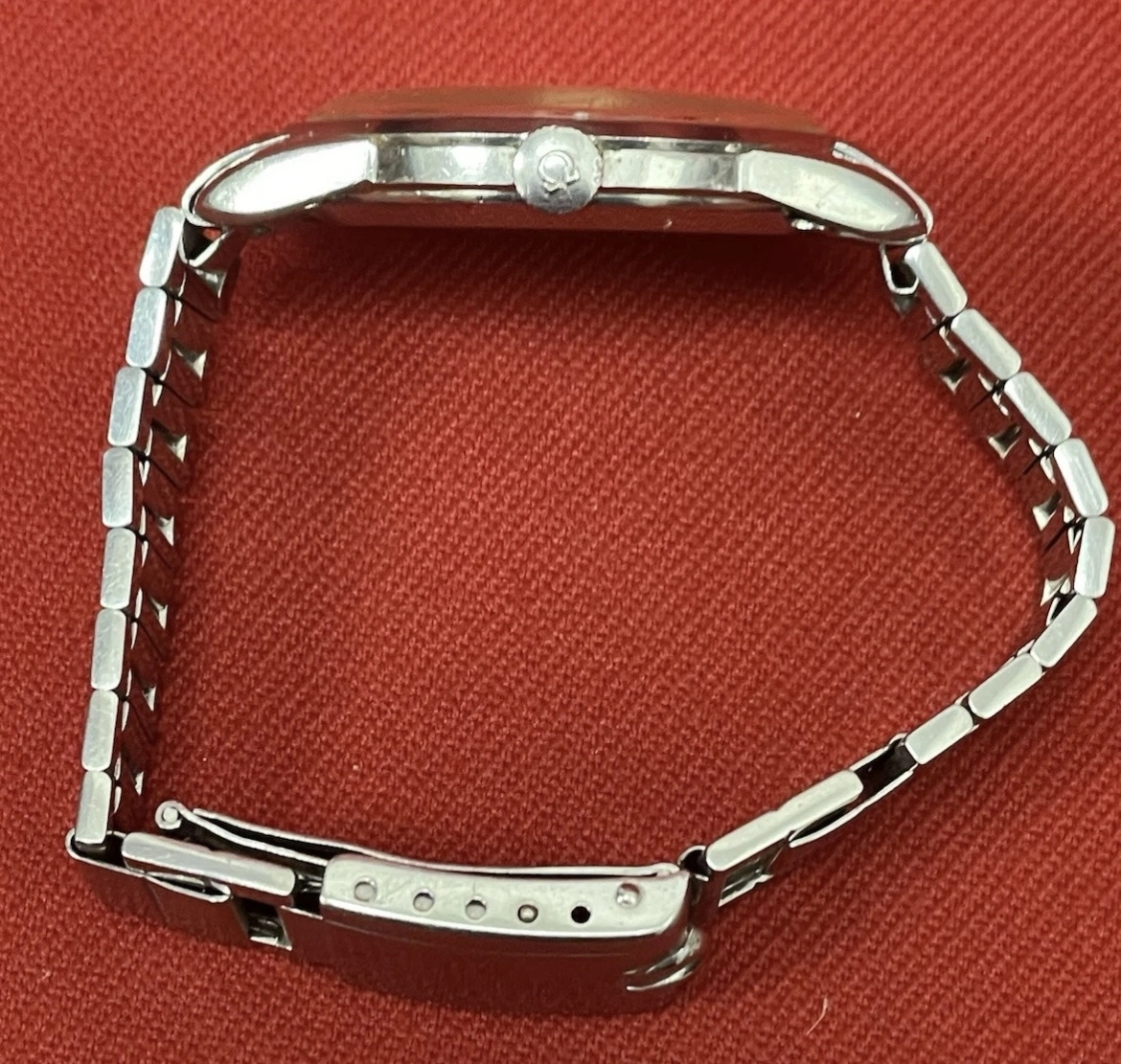

My research points to an early 7077 type A (short buckle double spring links, no date on the clasp). There are 8 solid links either side but only 3 spring links (damaged part) instead of 5.
So it’s incomplete in addition to being damaged. I found a couple of threads on repairing bracelets, but it seems extremely complicated.
What do you think?
Many thanks.

The links aren't too difficult to repair, springs are available. Finding extra links is more complicated but often not needed unless you have really large wrists. More important are the end links (not pictured) which are often worth more than the bracelet itself and can be harder to source.

Thanks. The back of the ends links are not visible on any picture unfortunately. I asked about it a few days ago but don’t have too much hope of getting an answer.

The bracelet is also short, a full length 7077 will have 5 double stretch links, 3 on one side, 2 the other. This one looks like it only has 3 in total.

Worth calling out it has 18mm endlinks, too narrow for the watch, but correct for Seamasters and Constellations of the era.

Yes, the bracelet wasn’t meant to be fitted to this watch (which has 19mm lugs)

Quick update on where this auction went, for posterity.
The watch was a Geneve 2748 (jumbo). Overall a nice “barn find”, with a very attractive case, the dial was good but with some spotting, so not pristine. Marked as non working, movement needs a service straight away, perhaps parts to be replaced. Crystal is broken. And of course the incomplete and to be repaired flat link.
My max bid was far too low to stand a chance. I am honestly surprised by the final result at… 1380€.
