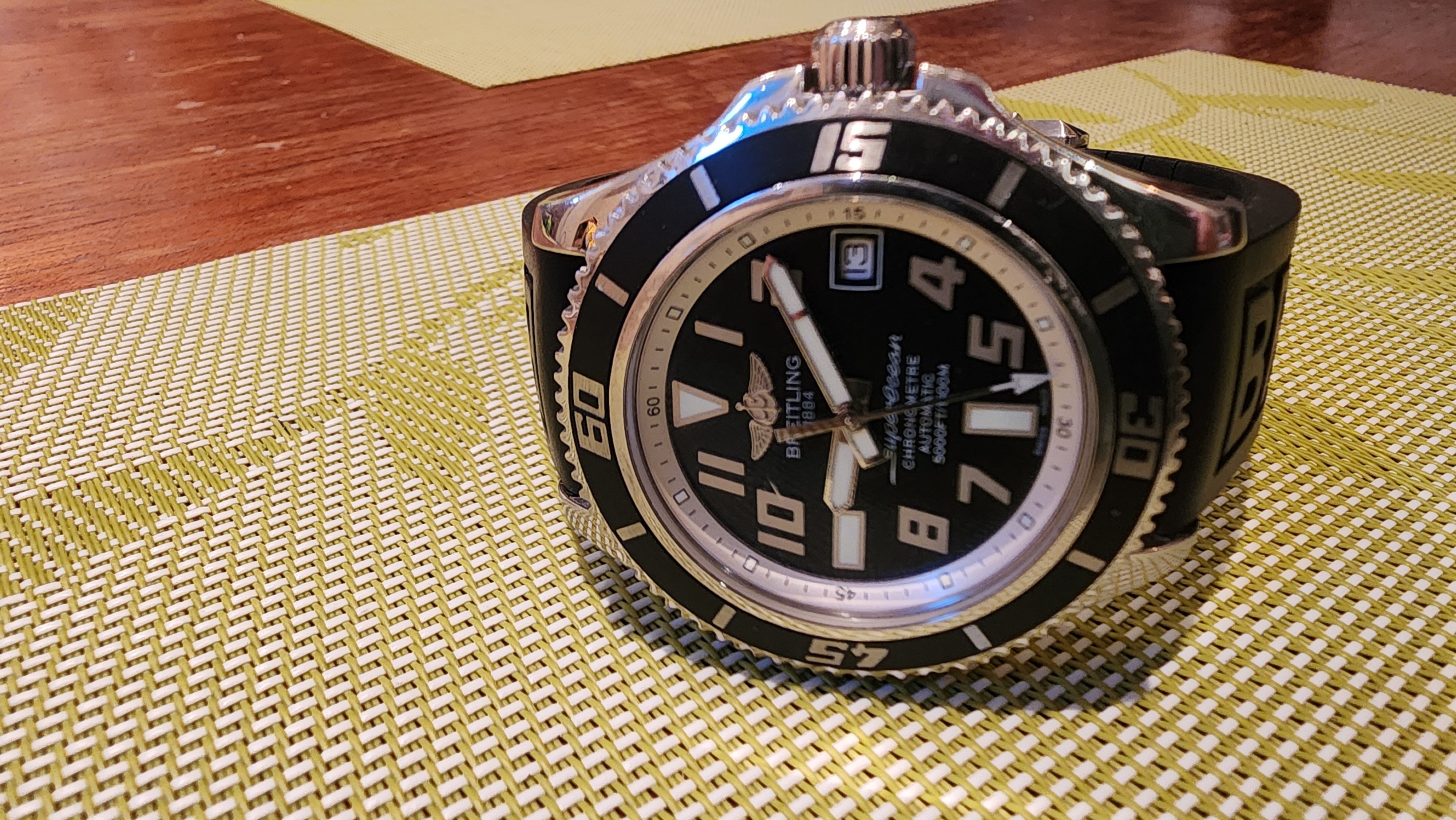

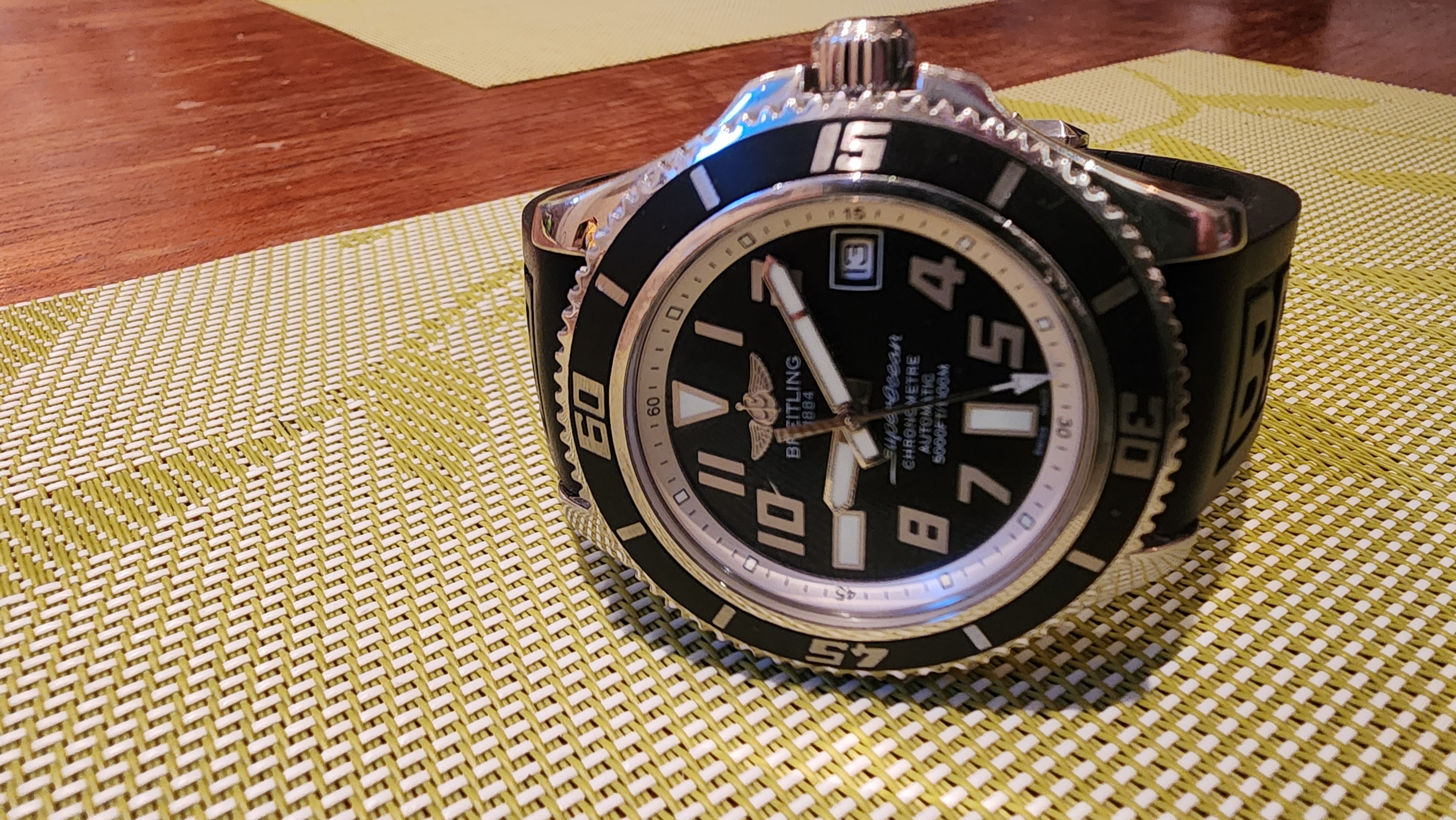

I have a Breitling SuperOcean 42 that I have had for a couple years, it came to me as serviced and has always ran well within specs.
I went to set it this morning and when winding it, the crown turned "differently" it felt kind of clunky, not smooth as usual.
I gave it a quick turns to wind it, set the time and proceeded to make my kids' lunches and prepare for the day... and I soon noticed that the hands never moved.
I thought that was odd so i took it off and wound it again, (still seemed "off") and shook it around in circled like i do to give a quick wind, and I saw the second hand runs backwards a few seconds!! Under closer inspection, I then saw the second hand kind of "jitter" back and forth for a second then stop!
When i shake the rotor, it runs backwards. when the crown is pulled out, I cant hear/feel the rotor turning when I shake it.
It ran fine when put away a couple weeks ago. it wasn't dropped or anything.
I've worn this one all summer, it went to Italy with me, swimming, hiking, its been my spot on, die-hard, go-to watch.
What could have caused this to randomly just start doing this?
Obviously, this needs a service... watches are so frustrating... lol
I just noticed, in the photo of said POS: date is too high in the window too, not centered... I wonder if the movement clamps could have come loose? is that even a thing?

Yea, I sent it in this afternoon, I knew it would need it eventually anyway, its 12 years old.
I just like knowing WHY things happen, as I have dozens of autos and had many more over the last decade, and i have never seen this happen, i was hoping to get some feedback, I knew it would need to go to service.
unfortunately Nesbit's doesn't do Breitling's. they are my go-to service center for Omega and similar. off to the Breitling SC it goes.
I did some more digging and broken mainspring may have been the culprit. (i didn't open it).

Your gear train is locked up somewhere. You wind it, it puts additional stress on everything. Accept that it needs serviced and stop winding it. Send it off to a qualified watchmaker.

Knowing that it was going to service, I only asked so maybe if I did something specific to it myself, or it was a common problem with this breitling movement was the case.
I am always in search of why things happen. Ultimately, the solution was for the watch to go back to breitling. I just like to know what would have caused this. It wasn't dropped, and although this is a daily beater, I don't abuse it. Once I realize something was wrong with it, I stopped trying to wind it, worrying that I would do more damage.
I figured this was an appropriate forum to post such a thing as we are all watch enthusiasts, regardless of the outcome...
