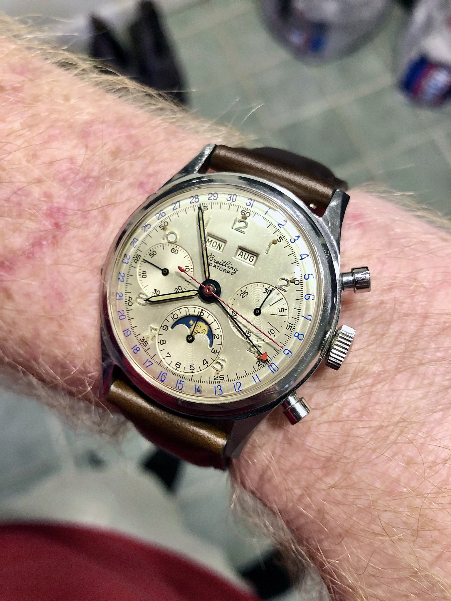

Figured out how to set the pointer date, day, month and moon phase (wrist shot is before all that was done). I had requested a full service of the movement only, and the watchmaker agreed that for a piece in this condition nothing else internal or external should be touched, though he did suggest giving some attention to the lume deterioration on the hands at some point. He also stated there were no parts that required replacement as the internal condition indicated the watch hadn’t been worn much. I use the Hairspring iOS app and after a full wind it’s averaging +12 seconds per day, measured at rest with the dial up. I haven’t checked it in different positions or at less than full wind but I’m pretty satisfied at this point. The watch looks exactly as it did when I left it in their care so I didn’t take many new pictures, but I did take a few macros for fun.
