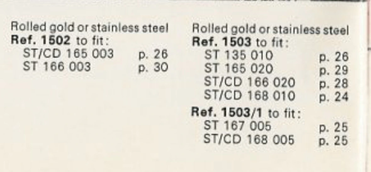

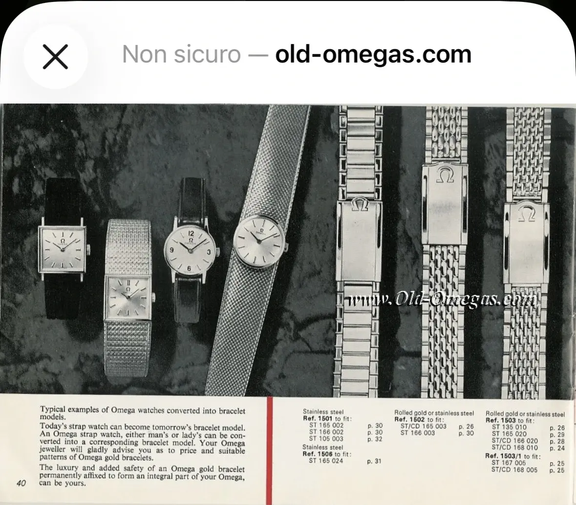

I found the attached page from an original Omega catalogue.
It clearly distinguishes:
Ref. 1503
  • ST 135.010
  • ST 165.020
  • ST/CD 166.020
  • ST/CD 168.010
Ref. 1503/1
  • ST 167.005
  • ST/CD 168.005
However, I often see the recommendation on Omega Forums that the correct bracelet is simply “1503 with No.70 end links”.
My question is:
Why does the Omega catalogue distinguish between 1503 and 1503/1?
I’m particularly interested in answers supported by Omega documentation (parts lists, service documents or period catalogues).

Thank you all for your replies.
@Dan S , you’re probably right.
I believe the 1503/1 was originally made with fixed end links, either straight or curved, specifically for the dog-leg cases.
I’ve seen a few 1503/1 bracelets with removable end links, but perhaps those originally had fixed end links that were cut off to make them compatible with a wider range of cases and therefore easier to sell.
At this point, I’m wondering whether a 1503/1 with integrated curved end links is actually a better fit for the 167.005 or 168.005 cases than a 1037 or a 1503 fitted with No. 70 end links.
In fact, as far as I know, the 1967 Omega catalogue, from which I posted the photos, is the only official Omega source that associates these cases with a specific bracelet reference.
I hope I’m wrong, because it would mean that the 1503/1 is an extremely rare bracelet that rarely appears on the market.
If anyone has any official Omega documentation suggesting otherwise, I’d be very interested to see it.
In any case, if anyone happens to have a stainless steel 1503/1 with integrated curved end links, I’d be very interested in buying it.
