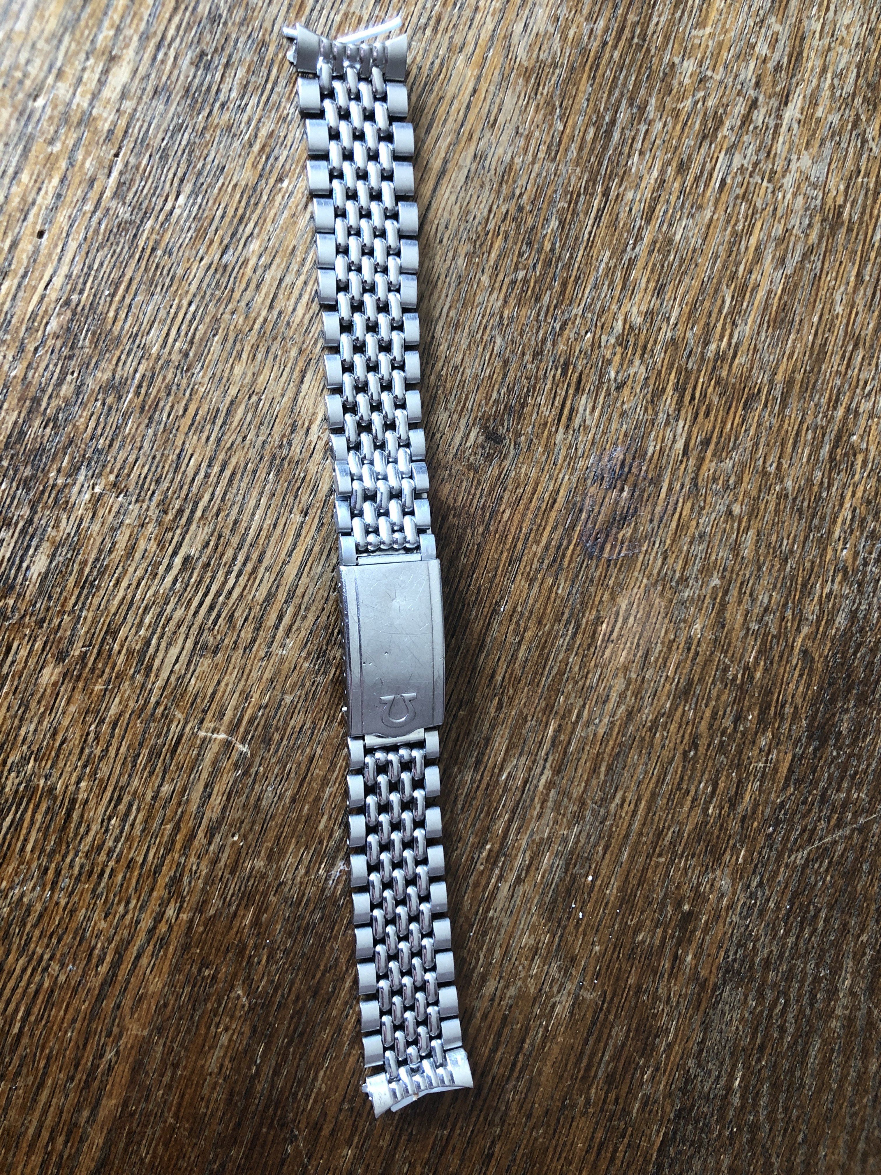

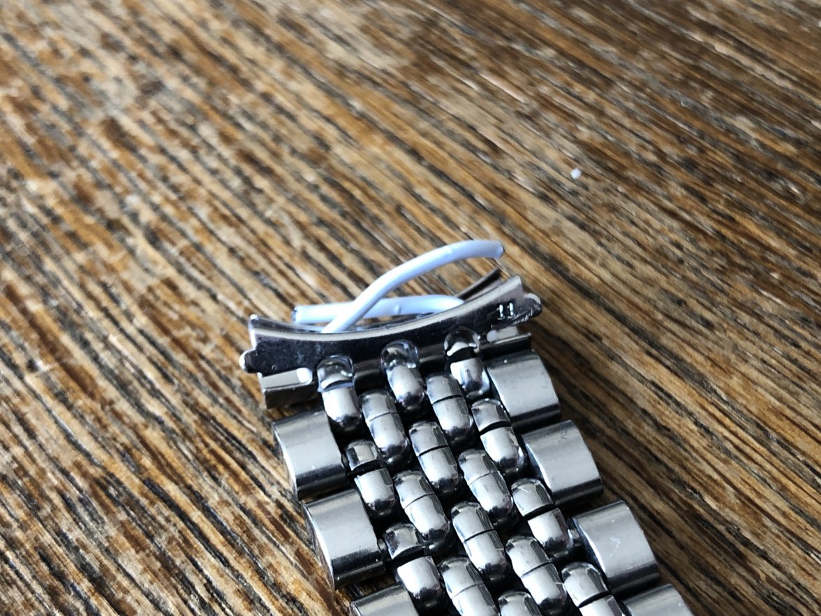

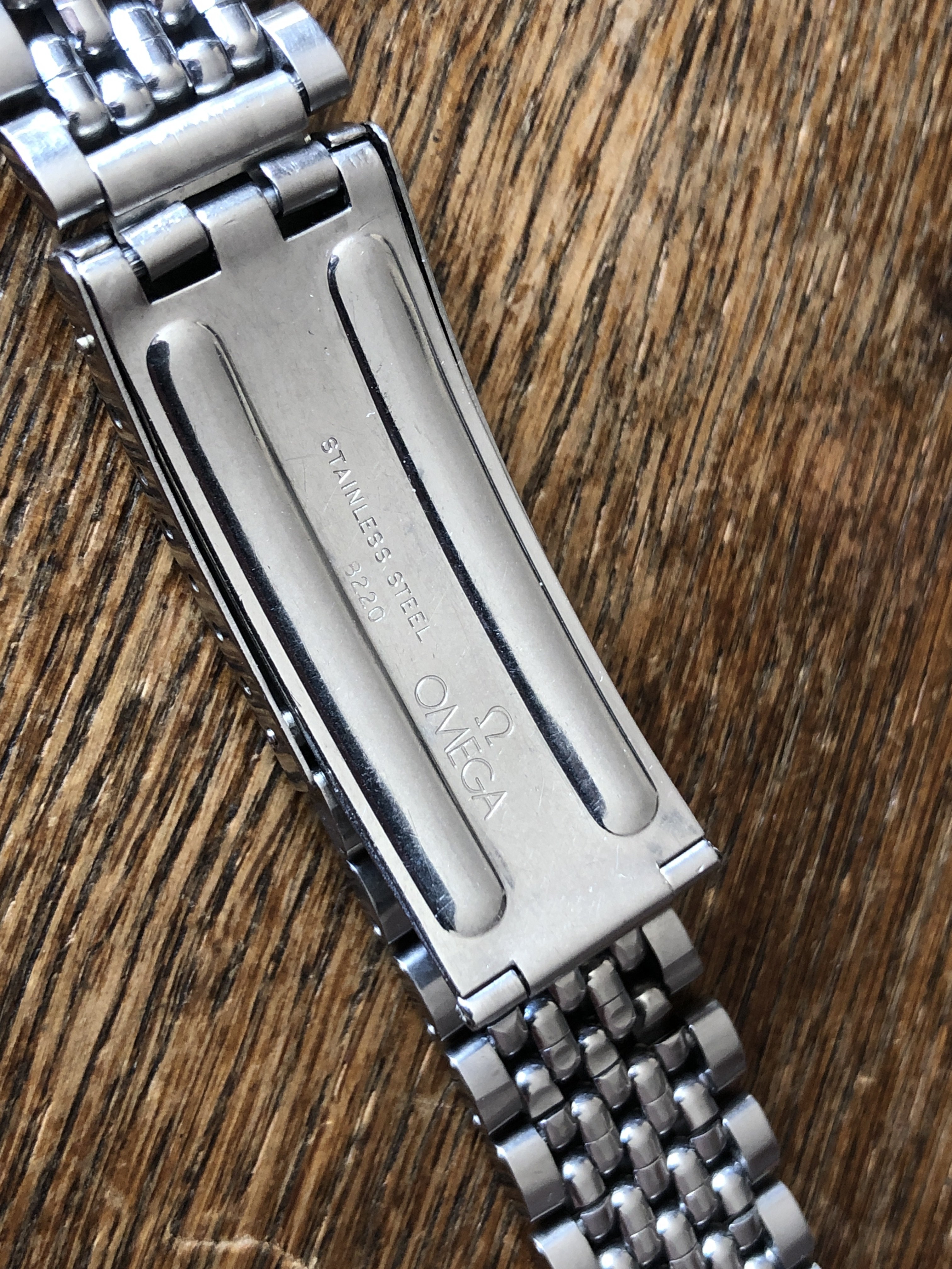

I have a 1502 BoR bracelet which will fit I think. Will post some pictures
69
120
Sounds good, so you think 1502 should fit, but what about the end-links?

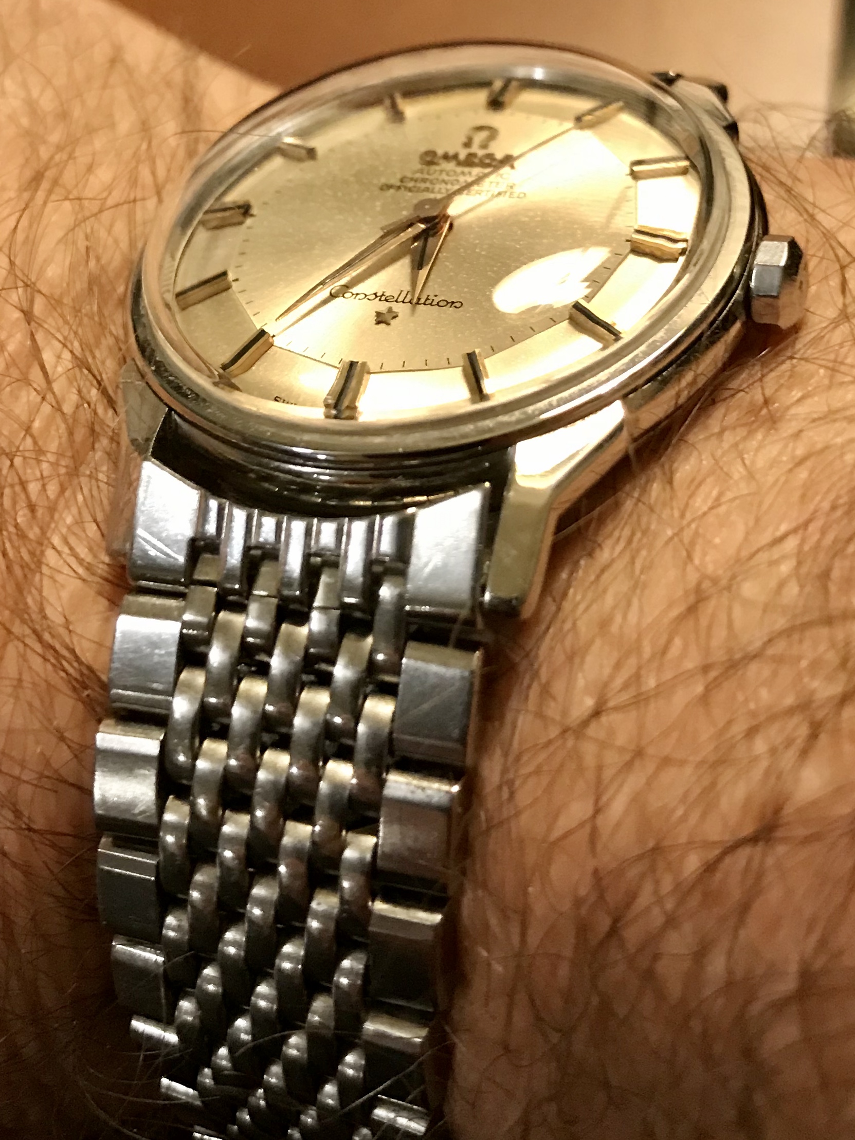

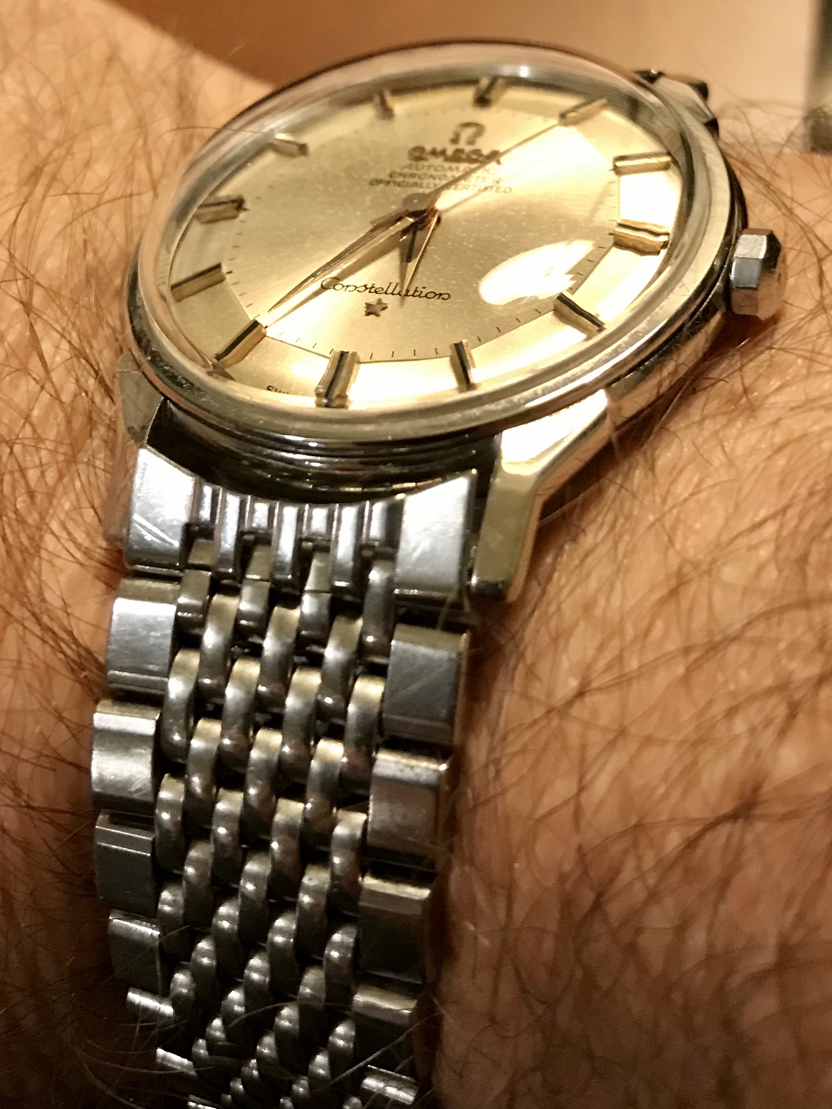

I have one on my 1964 Constellation which has an 18mm lug width. No. 1037 bracelet with no. 570 end links. I think that a no. 12/570 might also work.

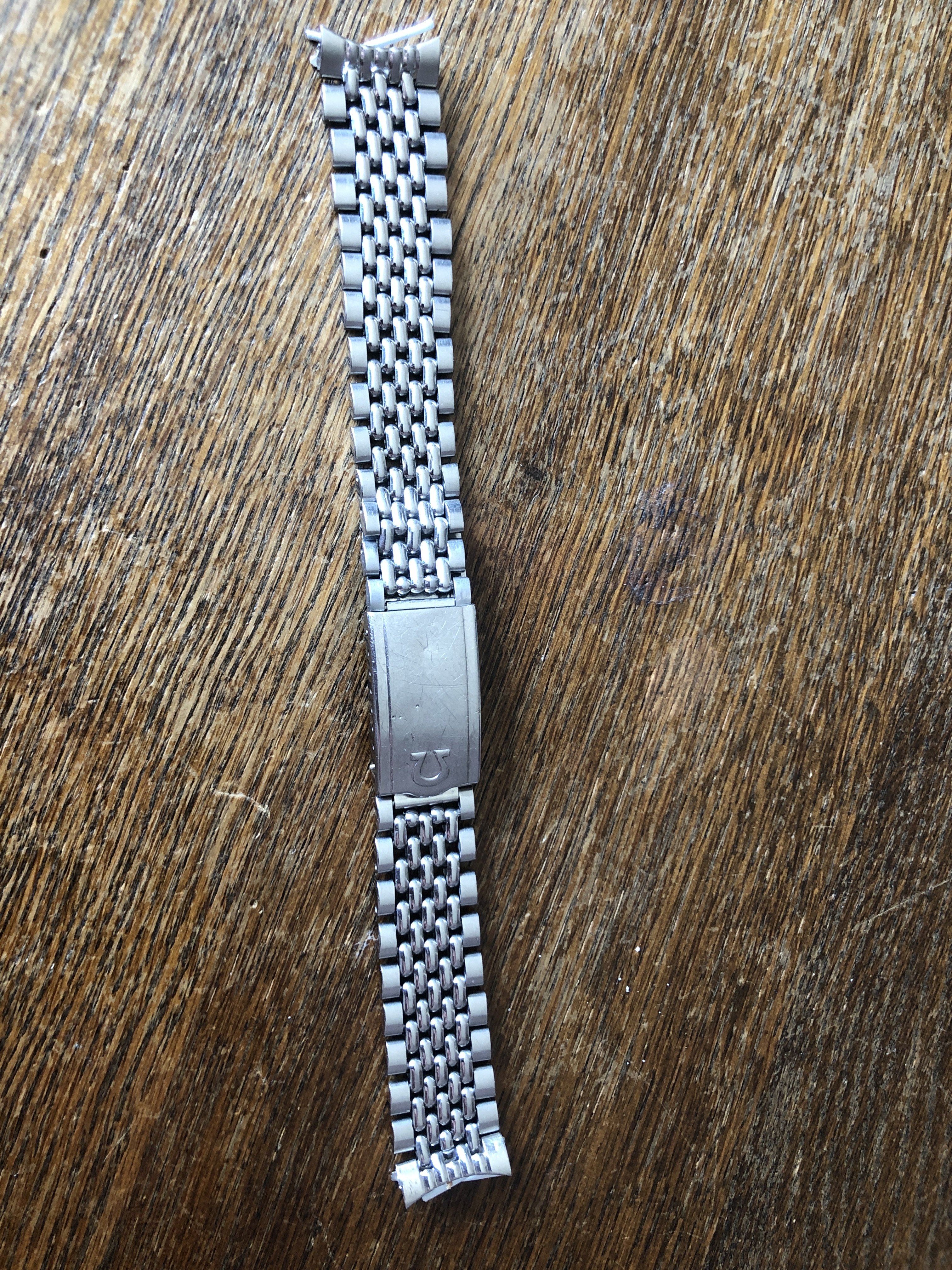

Here you have a picture of the bracelet
kind regards,
Timo

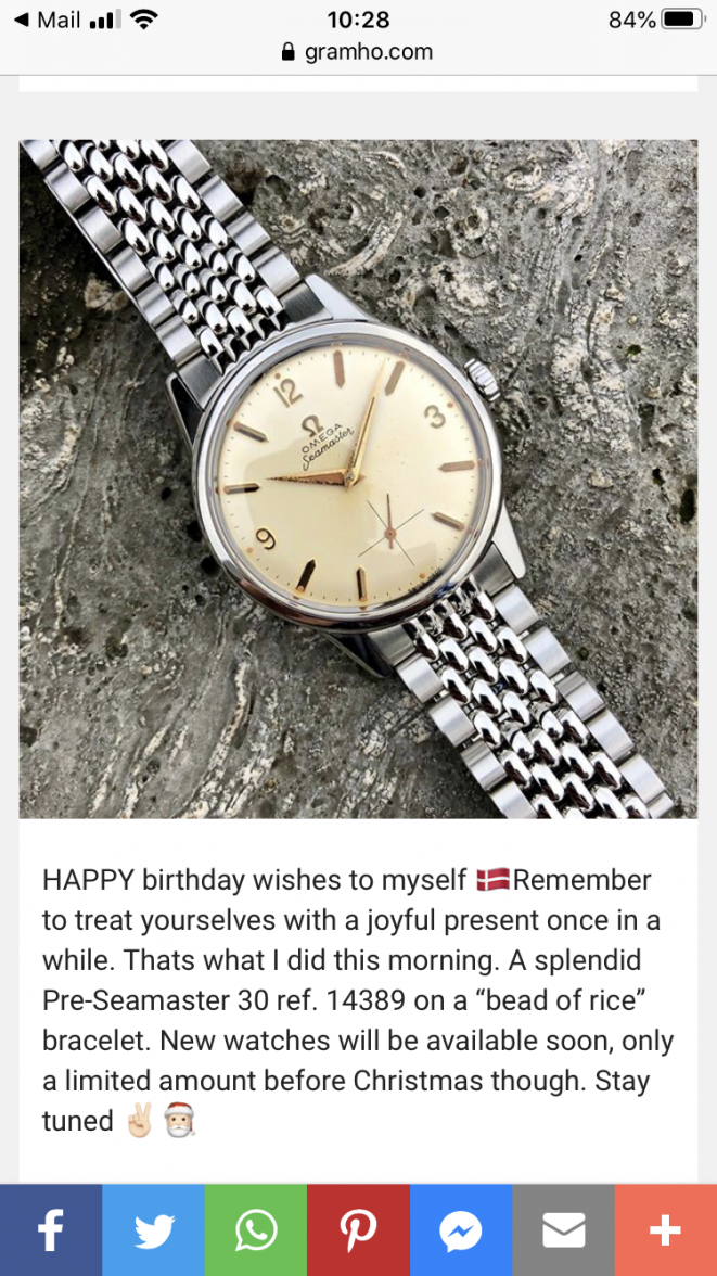

I am pretty sure the 5 row BoR bracelet is the correct one for the 14389. Here a picture from the net on the 5 row BoR bracelet
The endlinks are number 11 endlinks.

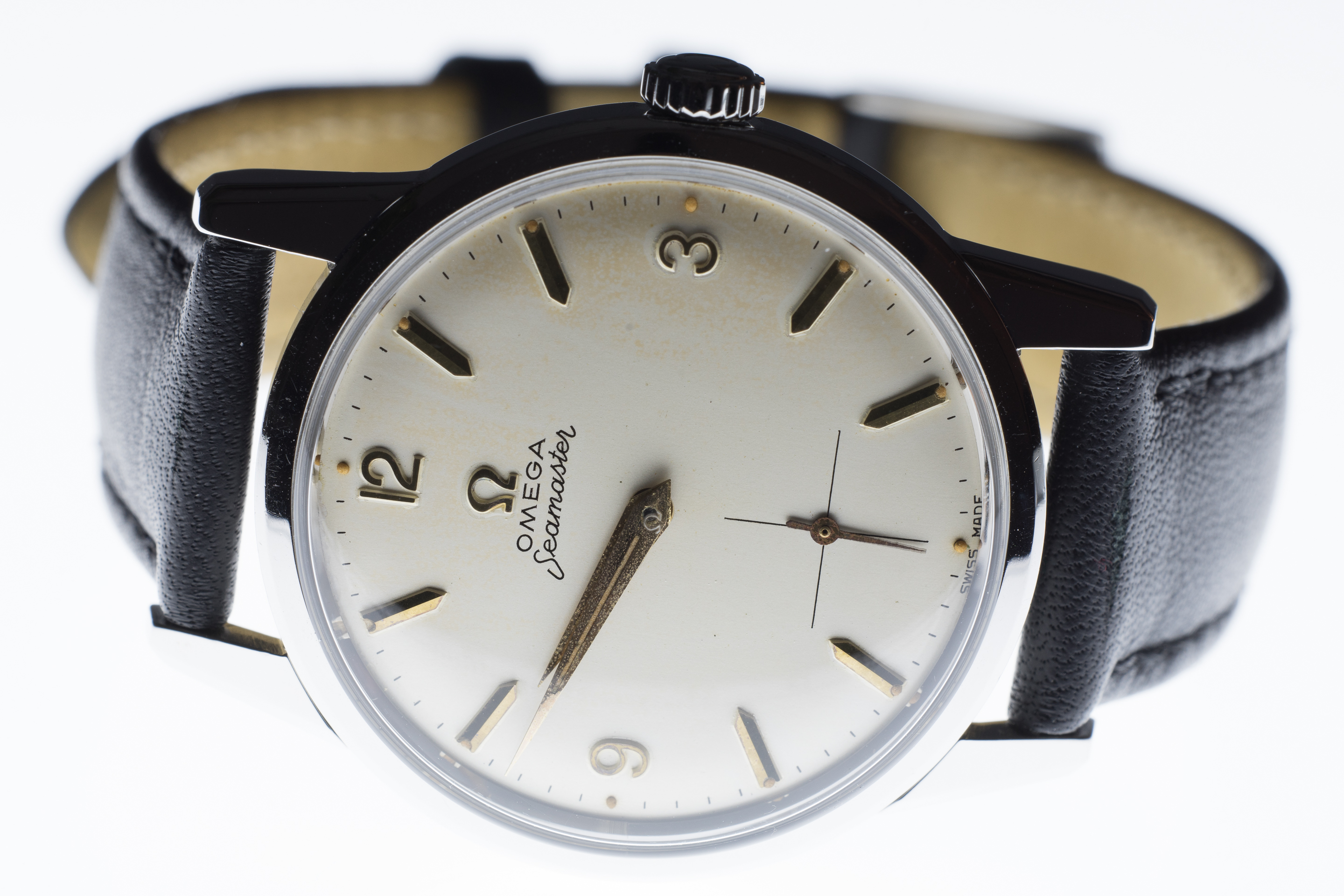

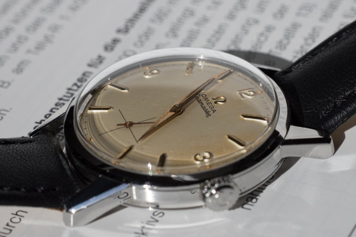

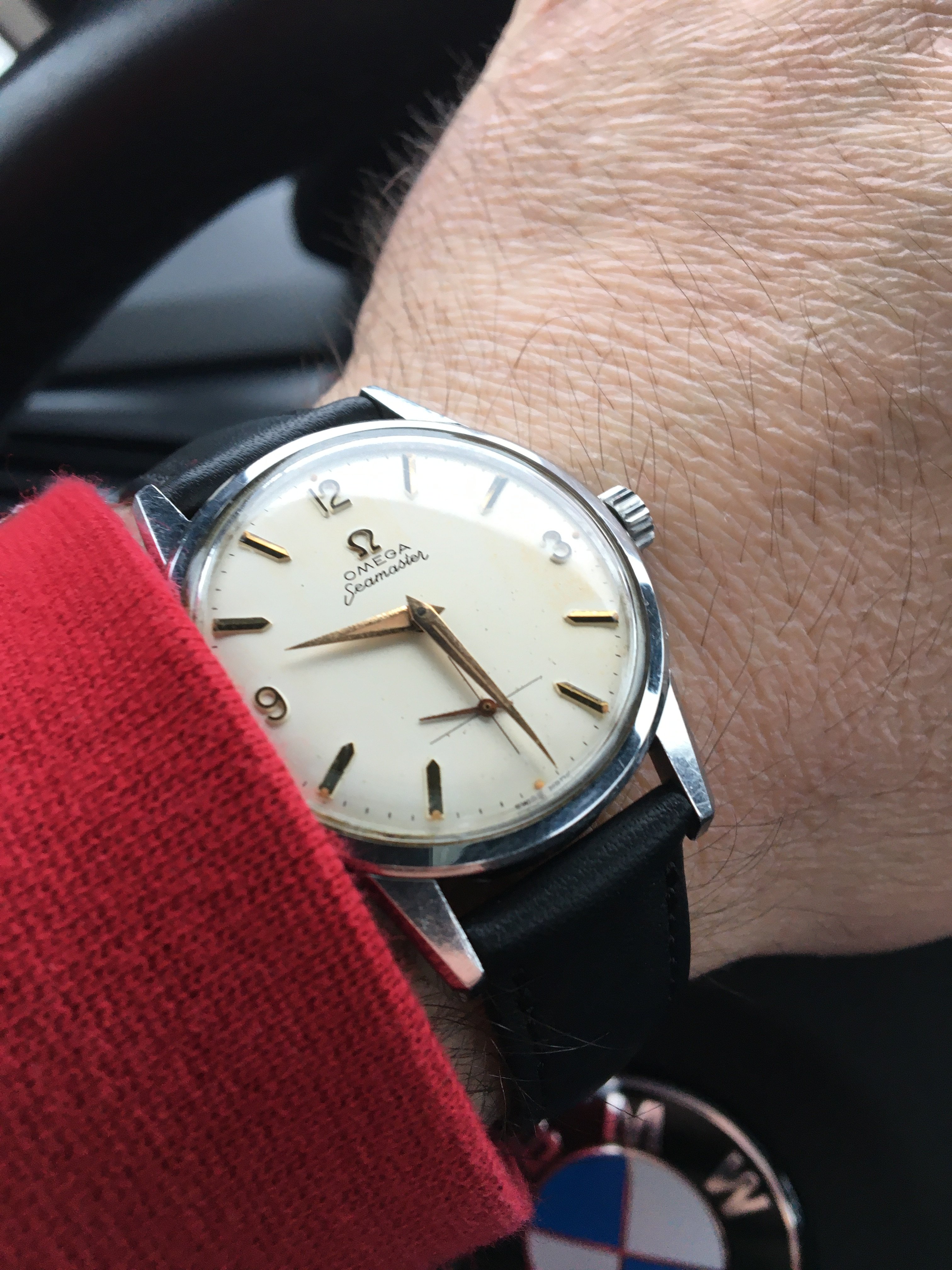

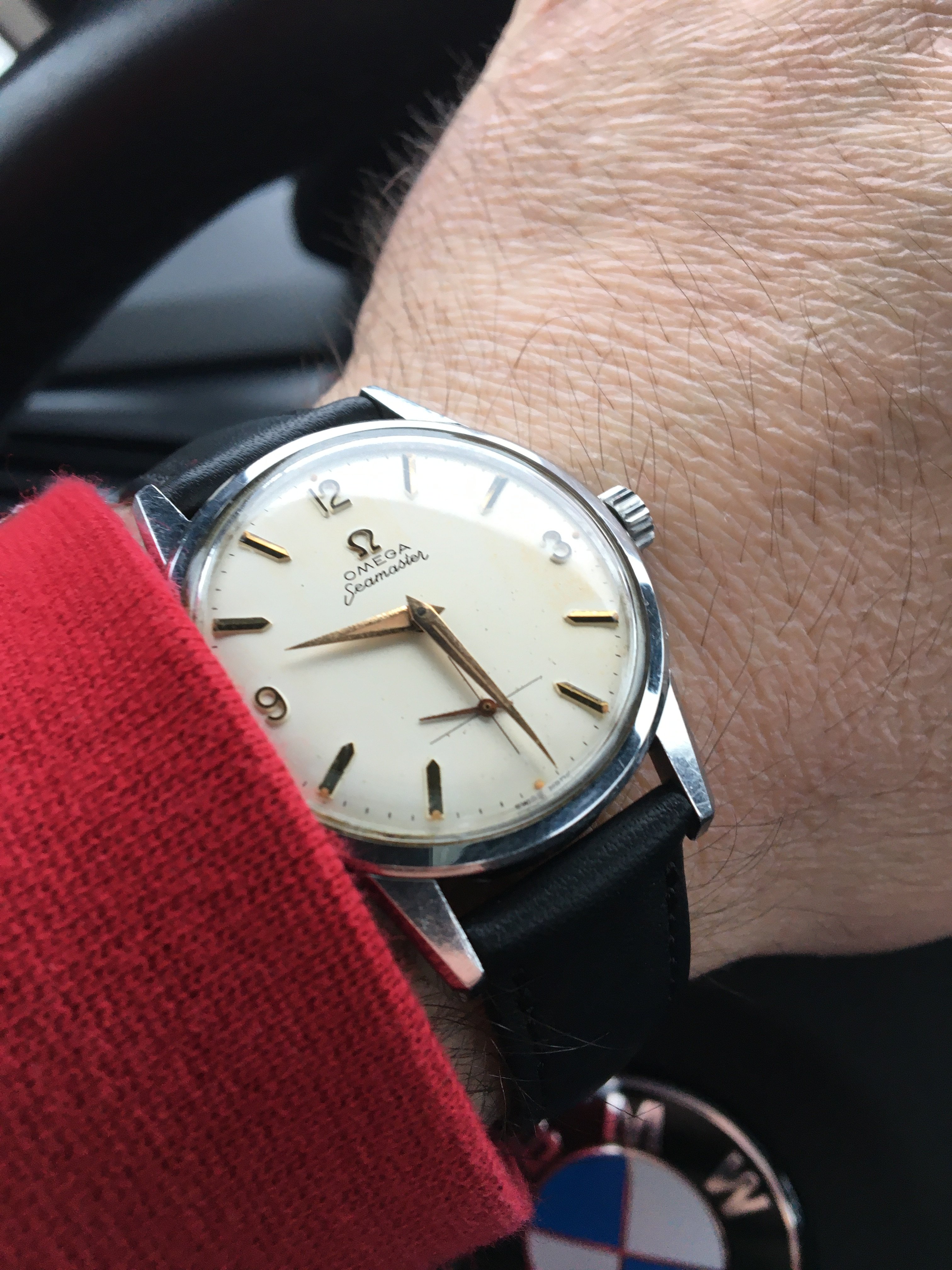

Thanks for your help.
Today she arrived and I decited to wear her on a black leather strap, just have to get a better one....
kind regards,
Timo
99
72
Loom dots look very cool and you can just make out the Omega symbol on the crystal

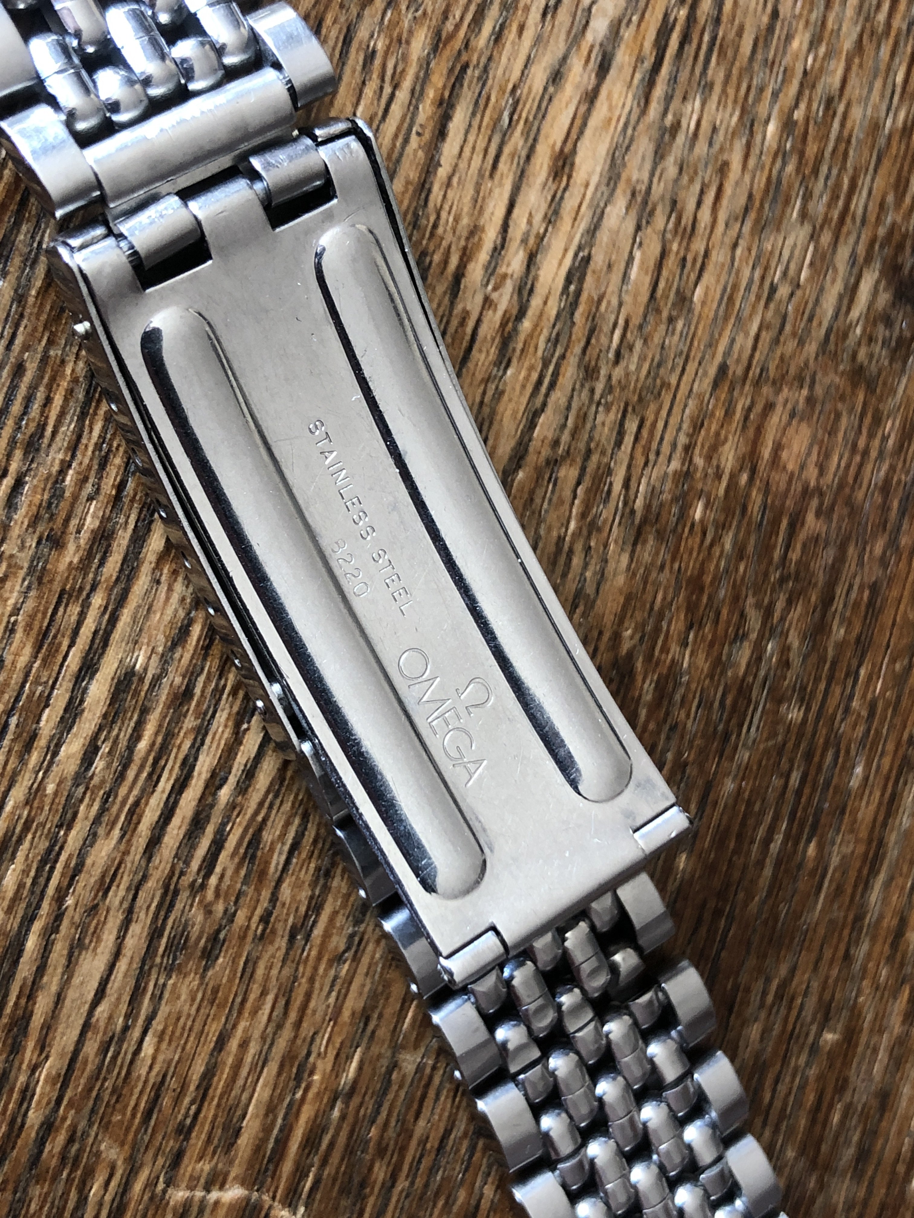

According to @Magnix's post, I guess I have the right bracelet for this watch. It was discussed in the following thread. @Timo832000, send me a PM if you are interested.
https://omegaforums.net/threads/question-about-beads-of-rice-end-links.97506/
