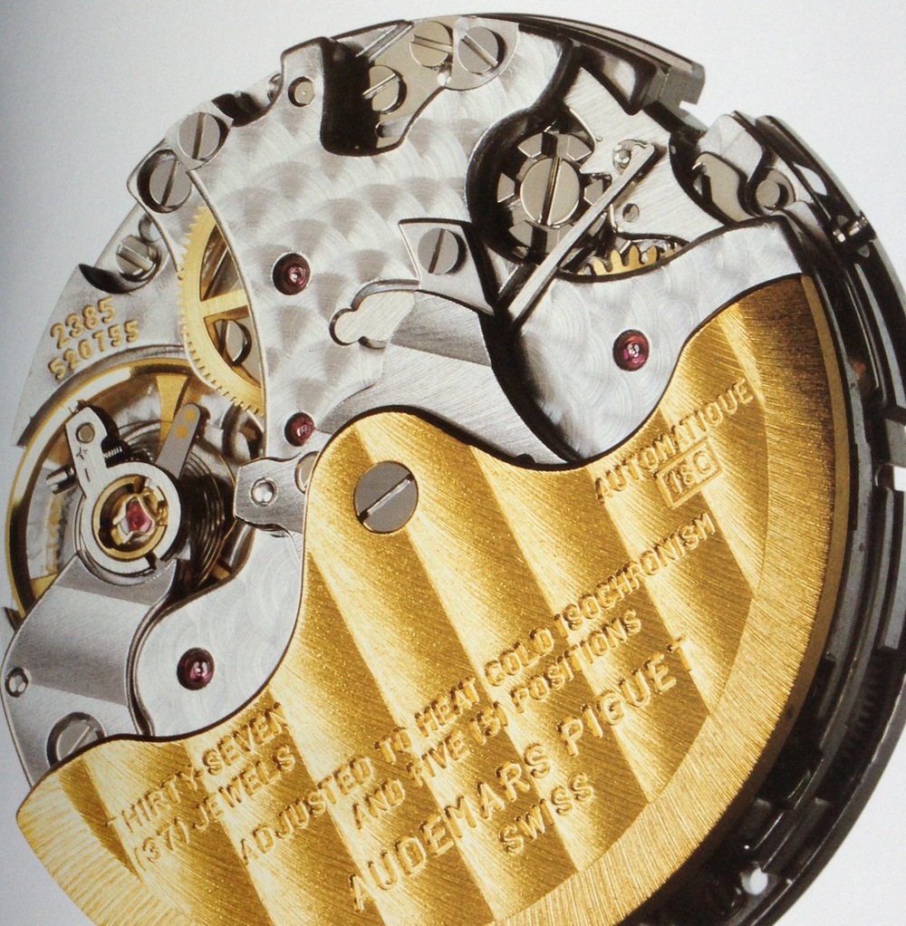

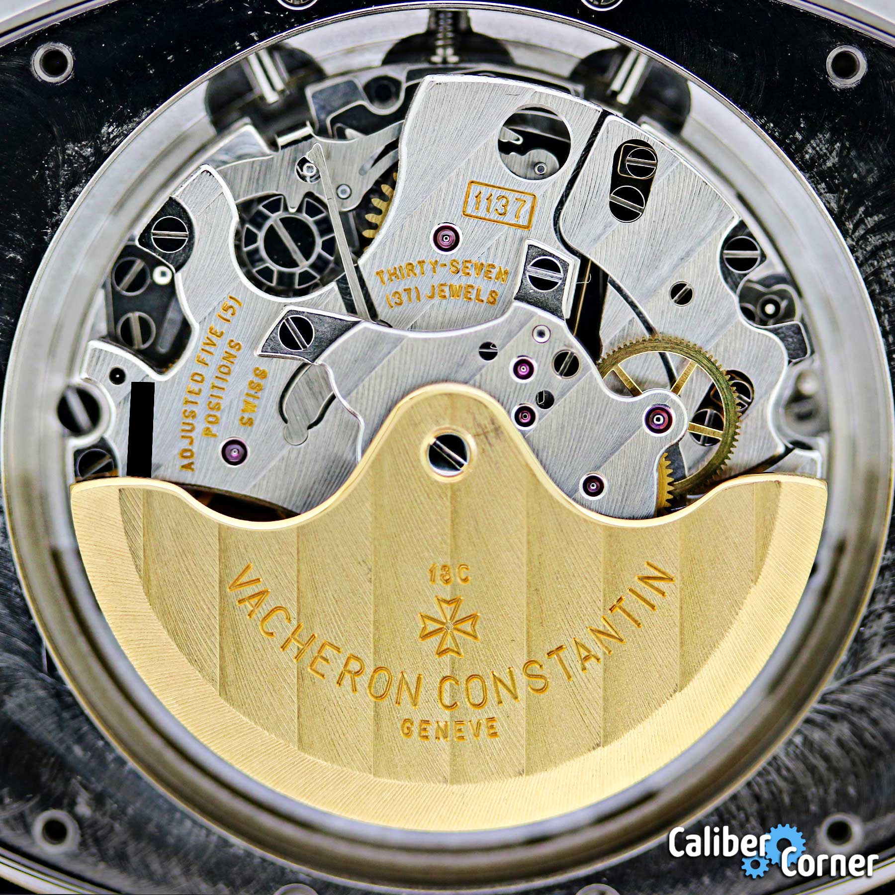

The AP and VC clearly have the gold rotor and they are also marked as such "18C".
Vacheron Constantin caliber 1137
Audemars Piguet caliber AP 2385

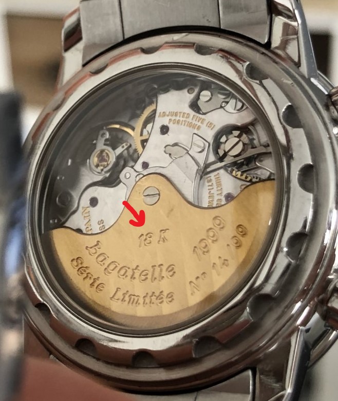

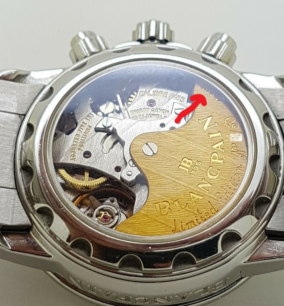

I can agree with this, however when i look at the limited editions of the same Model (Lemand Flyback Chronograph) and some other models from the same era and they do indicate the "18K" Gold.

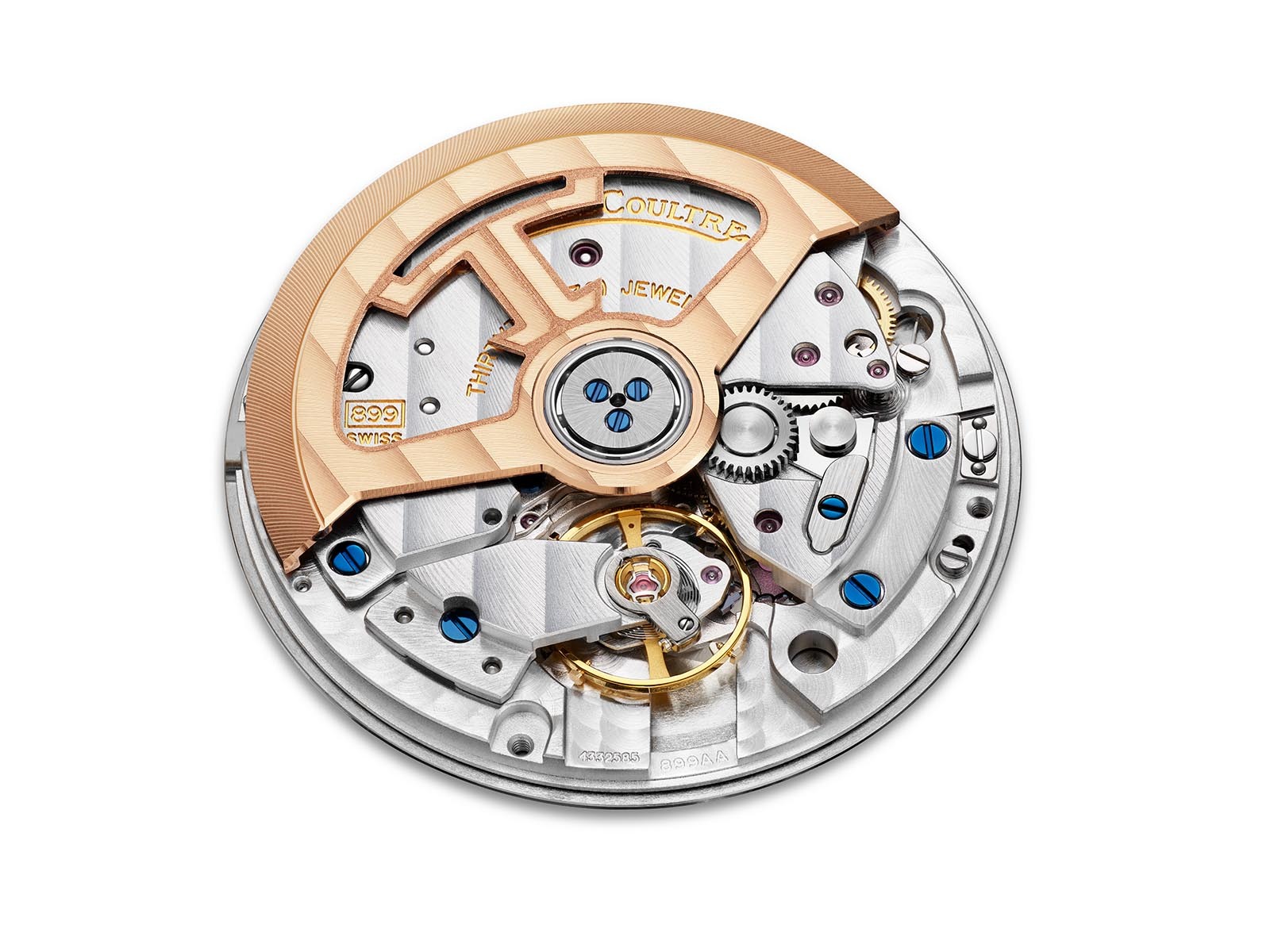

For example the older generation of JLC cal. 899 has a "22C" indication.
The modern JLC cal. 899, has no sign or whatsoever.

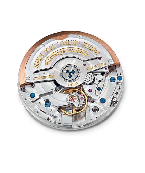

Here is a new video review from WatchAdvisor on Youtube:
He mentiones (2:40) that even though the rotor on the new Master Control line has no indication on the rotor, it is in fact a sold gold and that the stamp is apparently on the back side of the rotor. I think he asked the manufacturer directly. The resoning is that the manufacturer decided not to put it on the front side, due to design reasons. Would be interesting to see the back side.

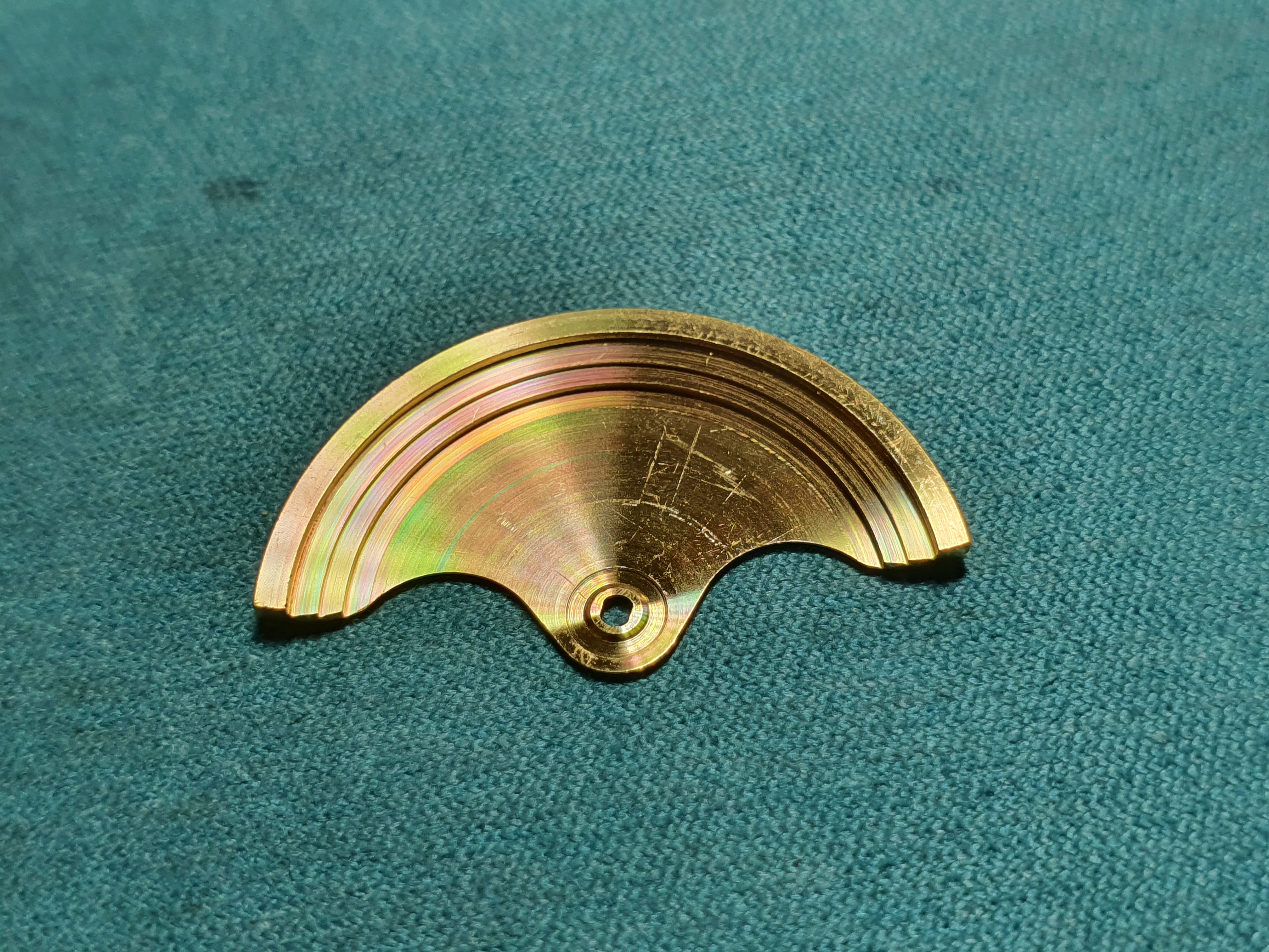

I was so curious that i took off the rotor on my Leman to see if there is an indication on the back, but there was nothing. it does not look like plating, especially if you look at the scratched places, and would make not much sence to gold fill it, so i am rather thinking it is in fact solid gold.. but it still remains a mystery why they would not indicate it.

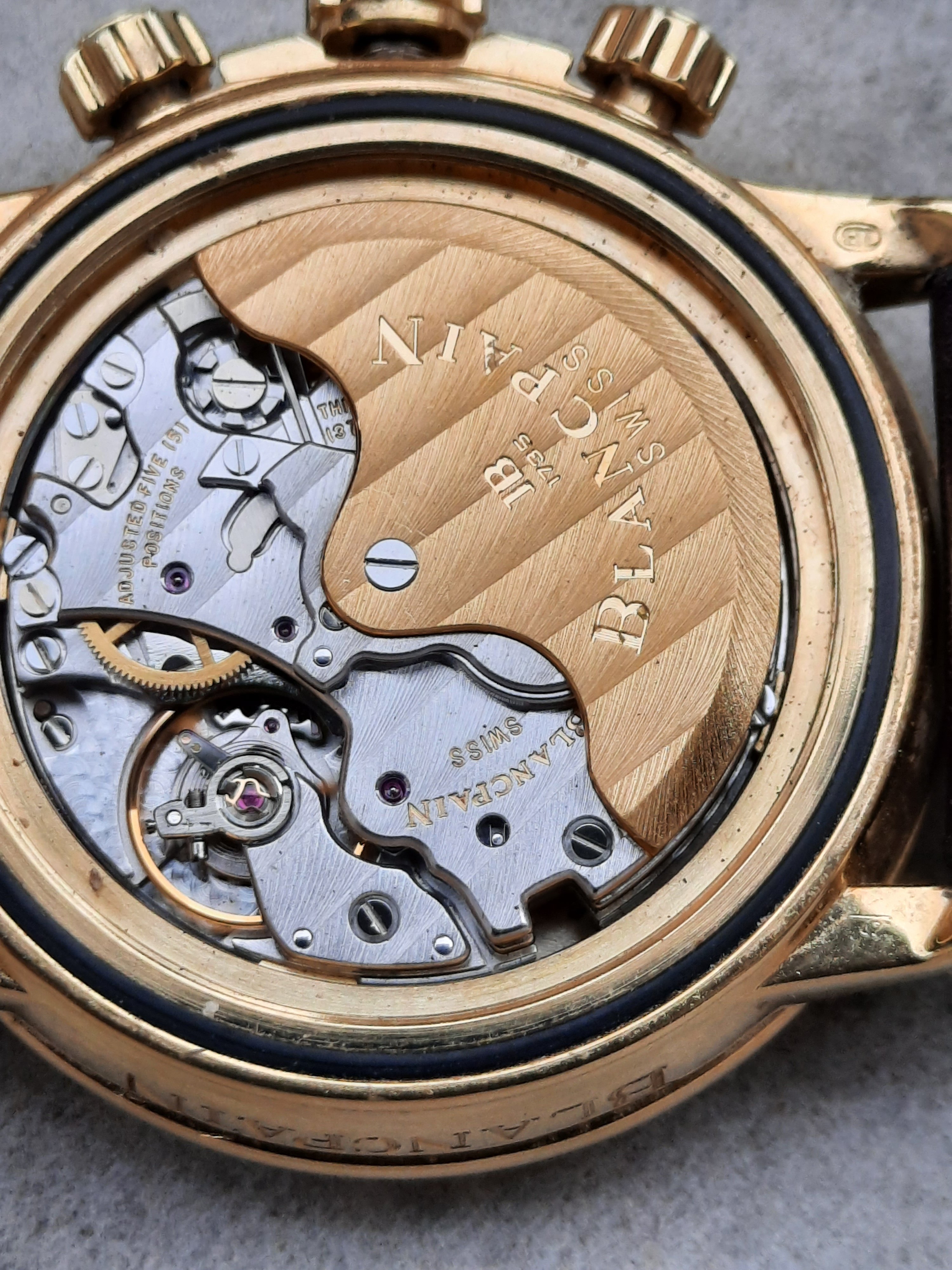

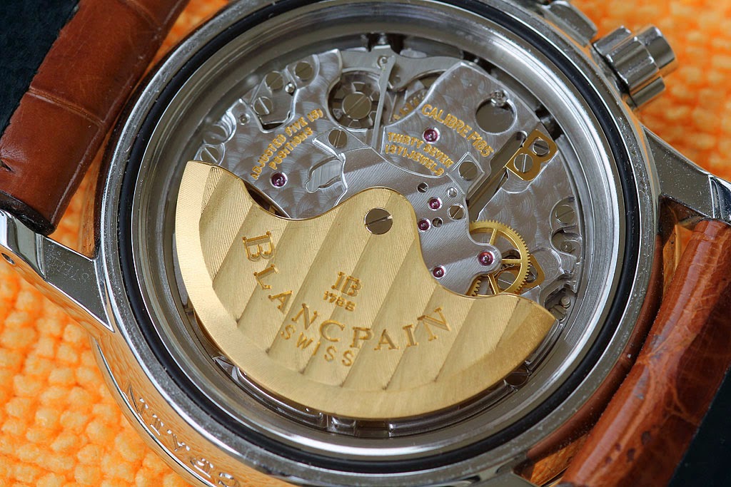

If it was gold, I would expect it to be marked...my old Leman (3 hand) was marked:
Nice looking movement there 👍
I have never seen Blancpain using blued screws before.

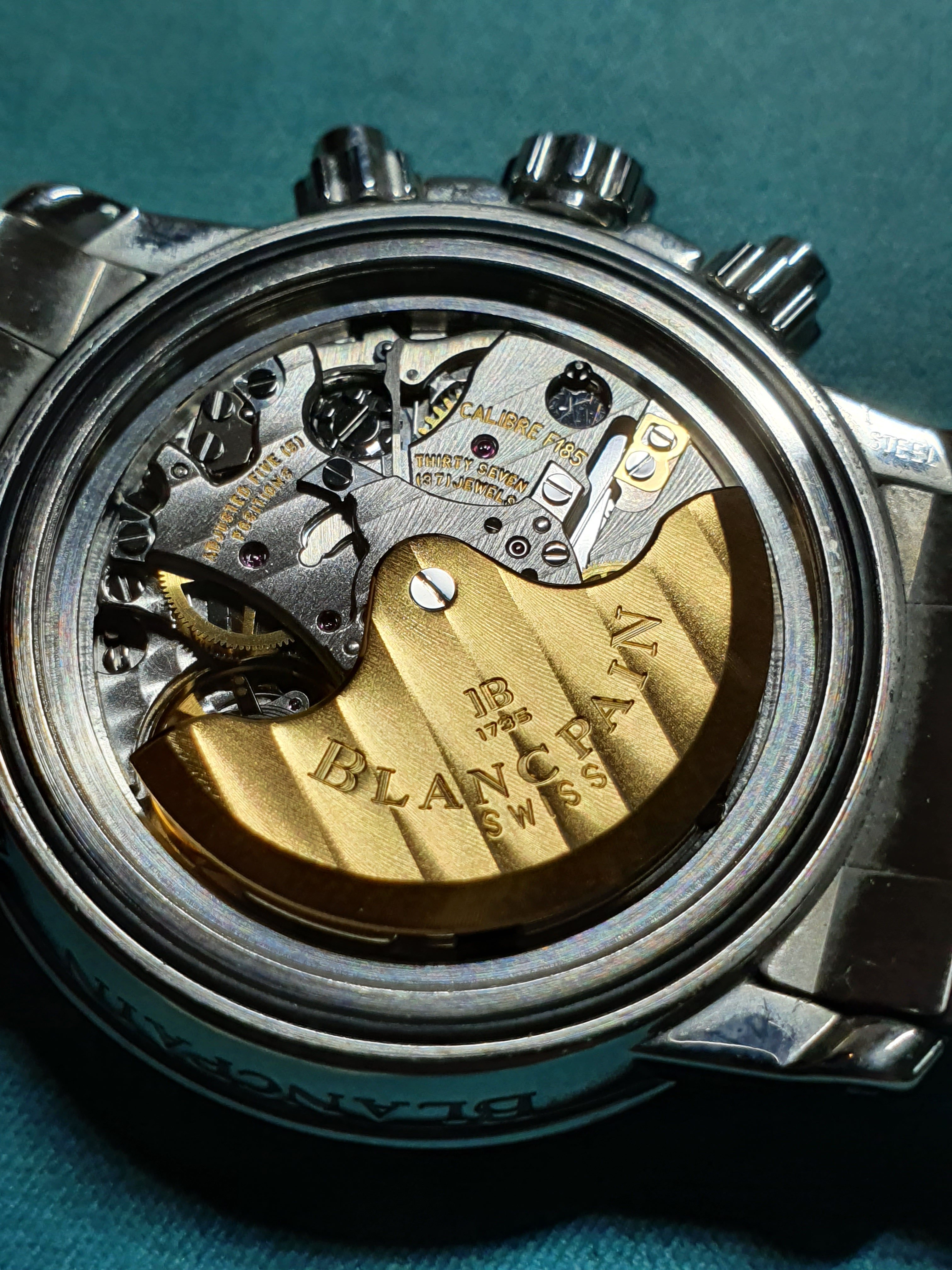

That's my 2185 (with FP 1185) and I would say it hasn't a rotor made of gold, or at least it isn't hallmarked as gold.
yeah, really strange considering its a solid gold watch. i guess one will have to drill a hole in order to find out ::stirthepot:: 😁
Unless it's marked because it's white gold, in order to avoid confusion, while yellow gold is supposed to be evident.
