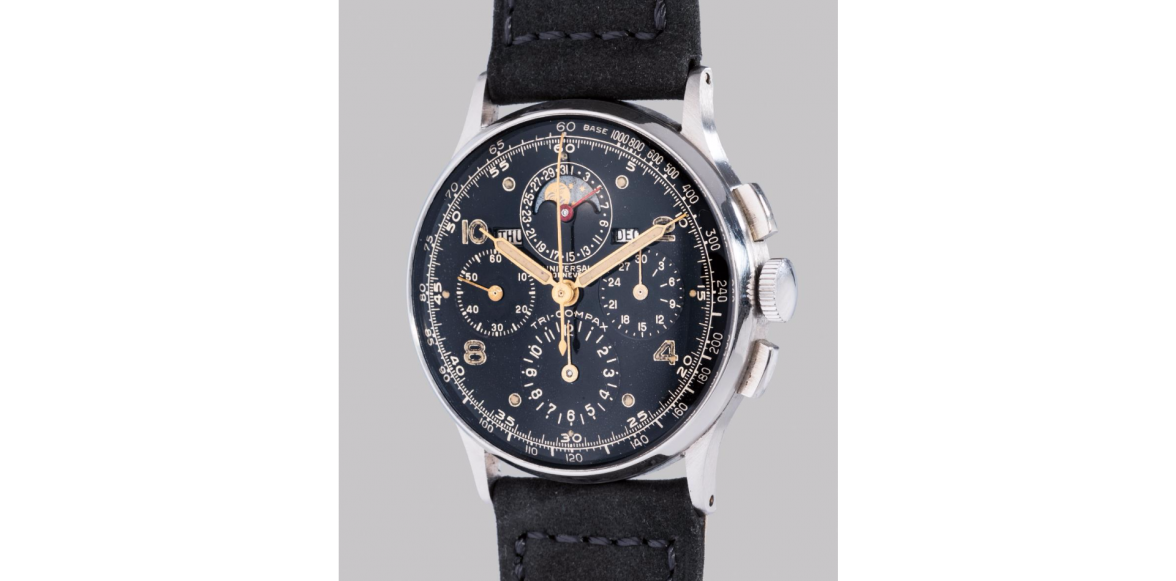

    Looks refinished to me. "extremely well preserved and crisp..." :whistling:

  3. gop76 Apr 26, 2017
    754
    2,419
    I don't know about the forum consensus but looks a redial to me. And i have many doubts about the hands...

  4. jordn Wants to be called Frank for some odd reason Apr 26, 2017
    713
    2,011
    What an original finish black dial looks like. I can't say anything definitive about the hands, but I have seen two other occasions when these syringe hands were used *shoulder shrug*

  5. Larry S Color Commentator for the Hyperbole. Apr 26, 2017
    12,521
    49,710
    Hands ... possible ... page 259. Dial looks refinished.

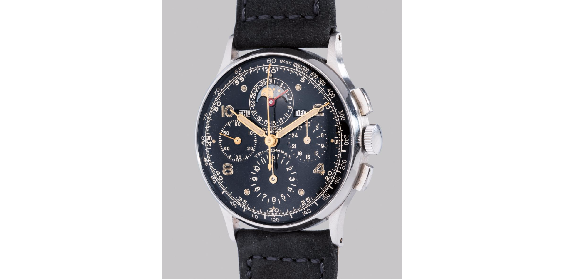

  8. LouS Mrs Nataf's Other Son Staff Member Apr 30, 2017
    6,713
    18,260
    Pic of the watch under discussion, for posterity and for those who don't care to click through:

  10. waXology Apr 30, 2017
    220
    289
    I'm going with redial. The 3's in the sub dials are rounded, while the ones in the out scale are flat topped. I can't think of a legit dial that had miss matched 3's. Overall it just looks like a mess. Could be wrong though.

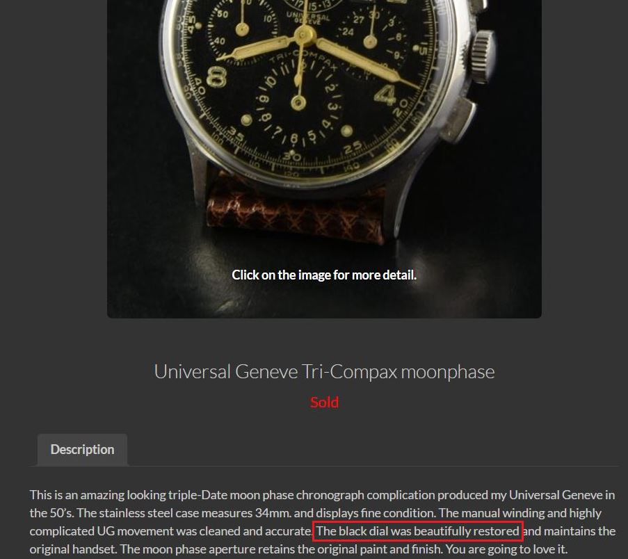

  11. ELV web Apr 30, 2017
    2,668
    24,651
    You are not wrong, excerpt from a listing found by @DirtyDozen12
    "This is an amazing looking triple-Date moon phase chronograph complication produced my Universal Geneve in the 50’s. The stainless steel case measures 34mm. and displays fine condition. The manual winding and highly complicated UG movement was cleaned and accurate. The black dial was beautifully restored and maintains the original handset. The moon phase aperture retains the original paint and finish. You are going to love it."
  12. Maybe May 1, 2017
    238
    931
    Always "professionally restored". Makes you go hm?
