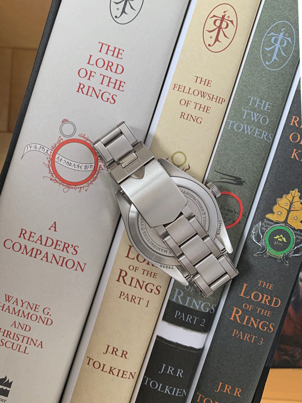

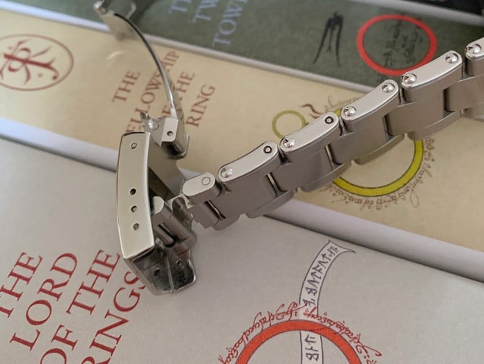

It is possible to retrofit a Black Bay 58 bracelet with a Rolex EasyLink.
Why?
It allows tool-less micro adjustment by 5mm for when you get hot or cold. Also, for those whose wrists only fit in-between a full link.
How? The process is reversible but you must sacrifice one BB58 link.
Here are the instructions and an animation of the final result,
And the EasyLink itself is seamless,
