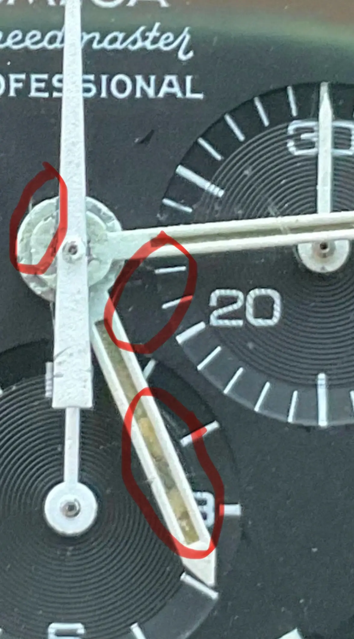

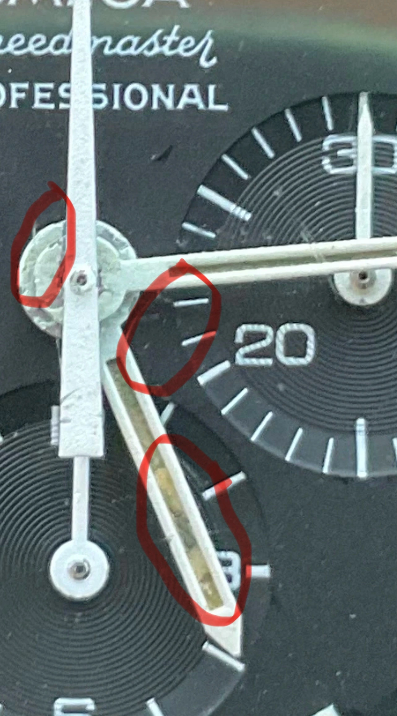

There has been work done to the hands also,
and possible scratches on the dial.

That’s a -78? The dial says -76 or earlier.

After all, it narrows down that all parts except the bracelet are of corresponding time. With issues:
-heavily polished case
-dial with distorted lume and damages on the surface
-hands with abuses and lumerepair
A little plus is: it got a recent service (in 2022) and all functions are ok. But after this review who knows if the work was performed orderly....

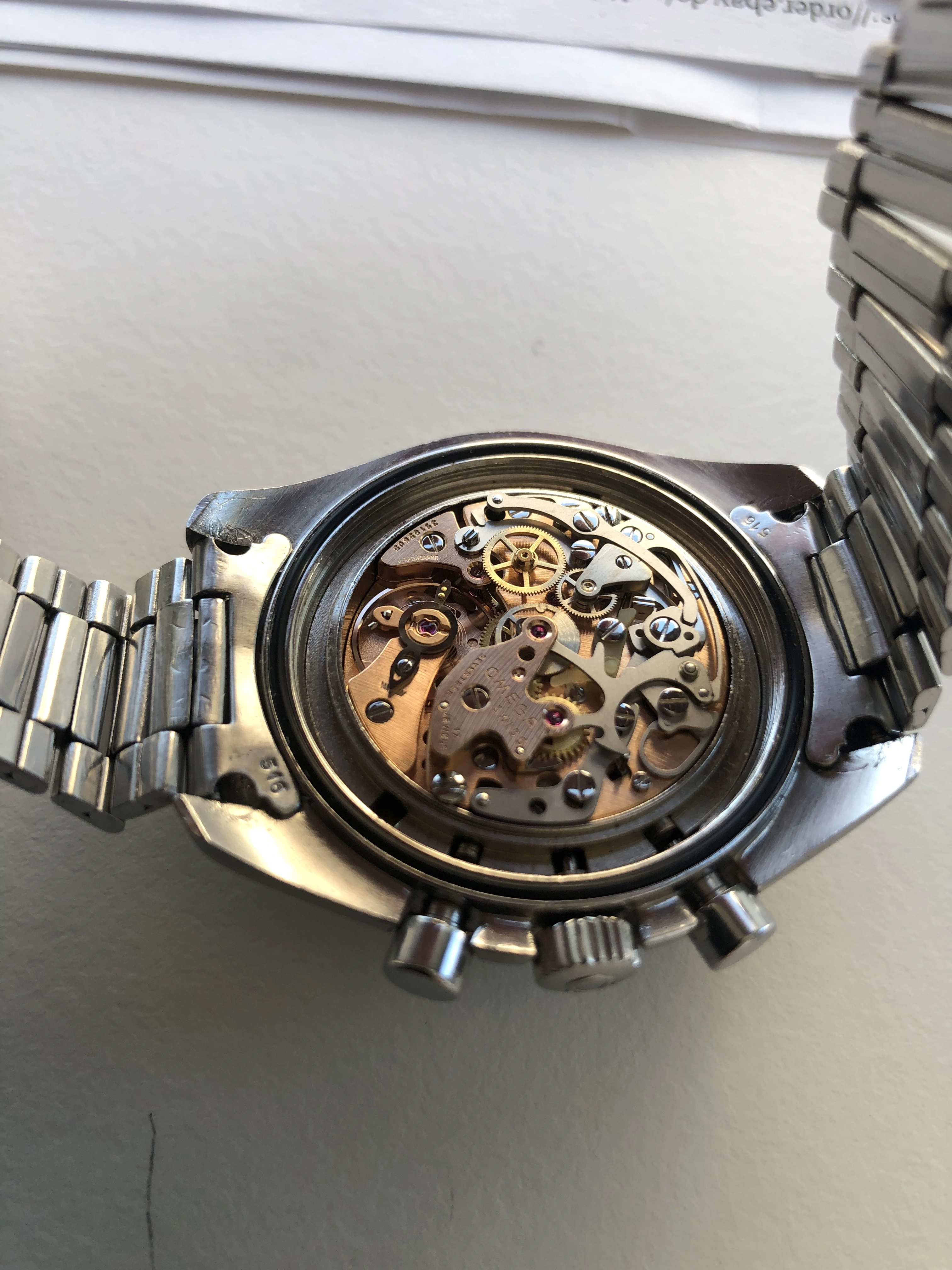

How does the movement look??
Here is a glimpse of the movement:

It’s a76.
@OneTwo that dial went through late 1977 with a change over in Sept of 77 for the -76.

No I am calling out the members who didn't notice the font on the dial which is the differentiator for the -74 and most -76 dials. LOL.. Including one I know should have known better....
As for the watch, the dial lume damage is odd and shows the dial was spun slightly in storage while out of the watch. The hands seemed like they are not a matched set. Unless the price is great I am not a huge fan of how this presents.
