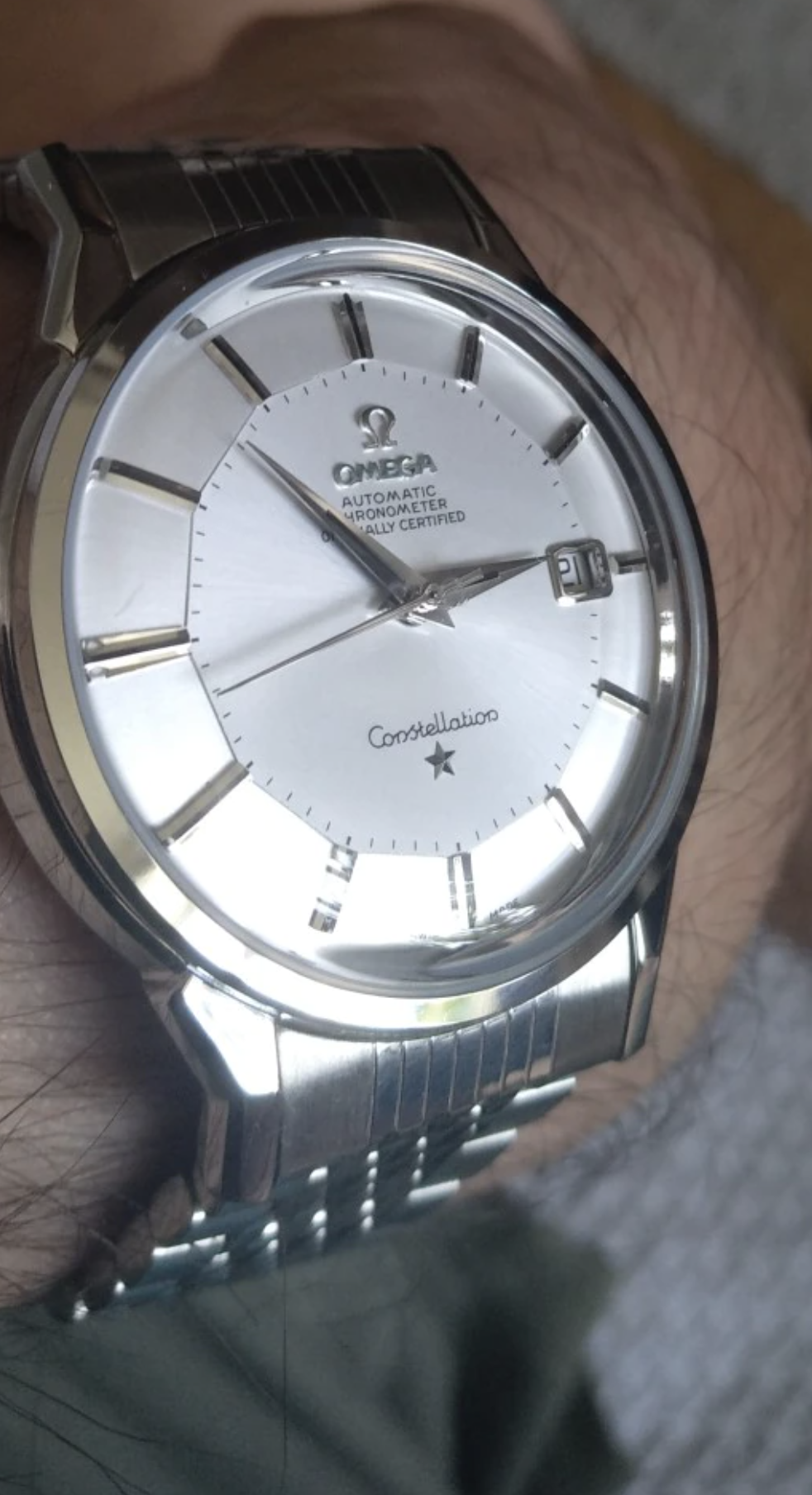

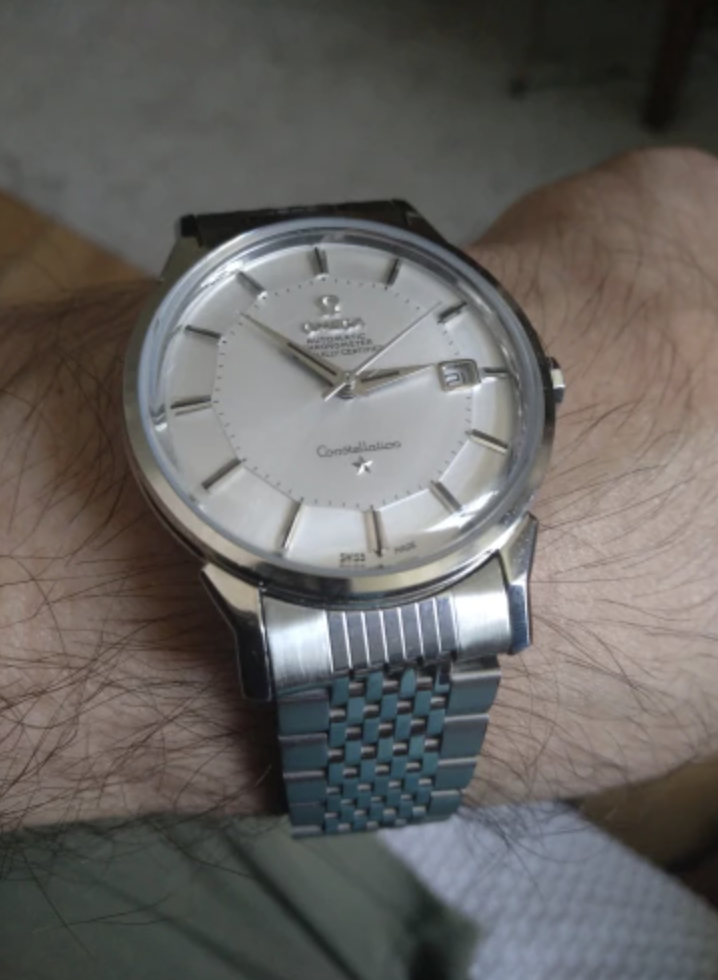

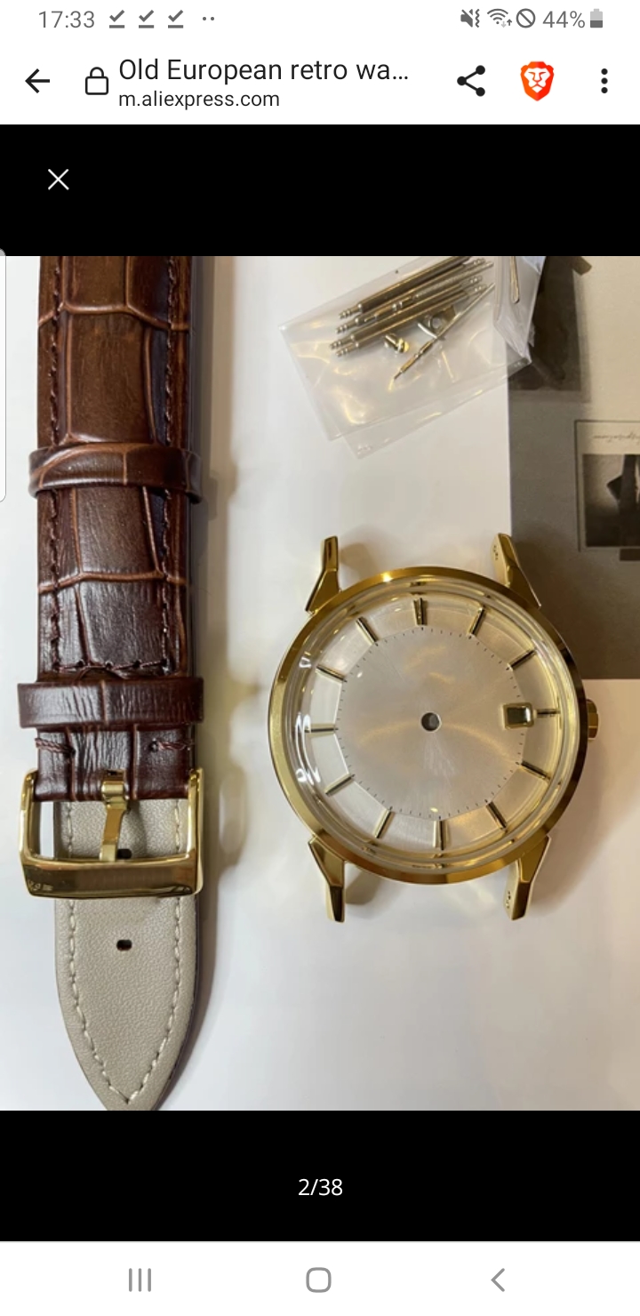

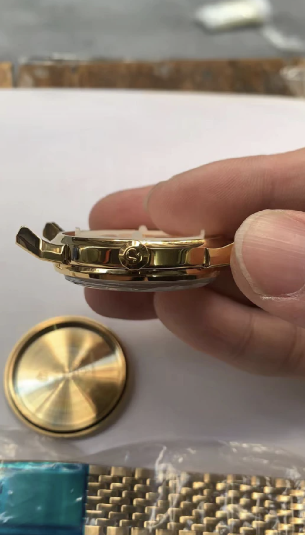

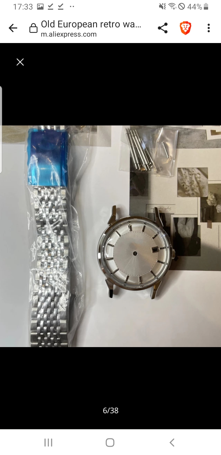

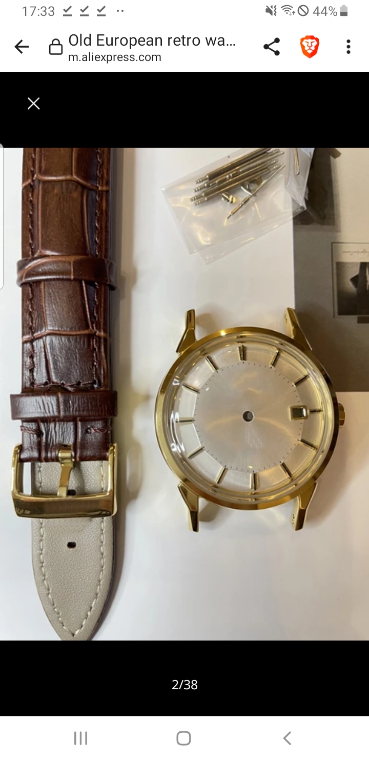

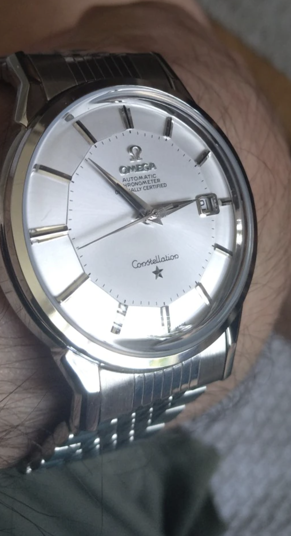

They nailed the frontal look
Well, the marker shape is off and the general proportions of the dial are too. A quick way of seeing something is amiss (if the case shape doesn't raise the alarm) is the size of the 3 o'clock marker.

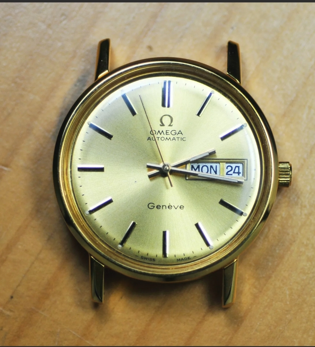

Firstly, good to post this @Kik_Kat_Kish 👍

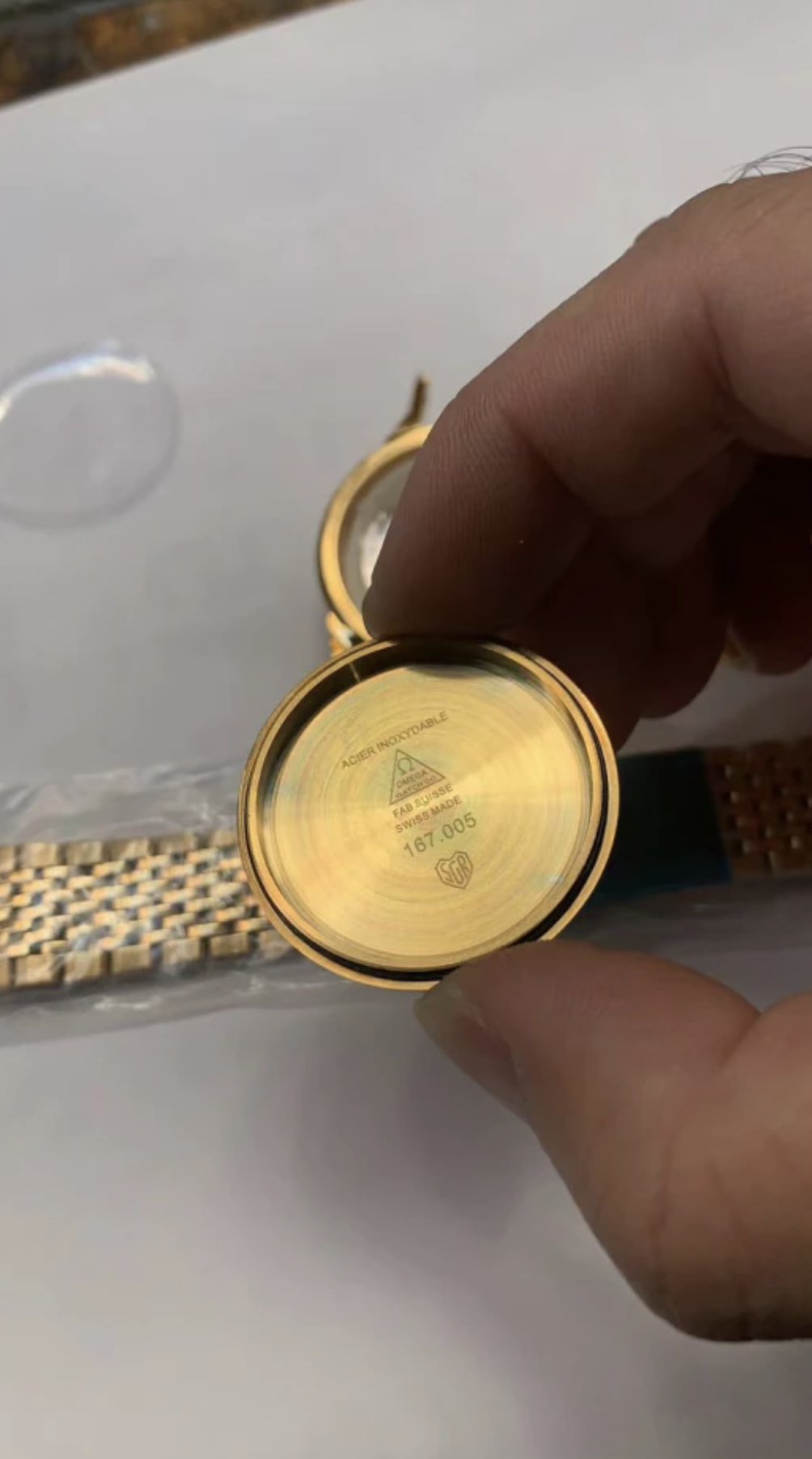

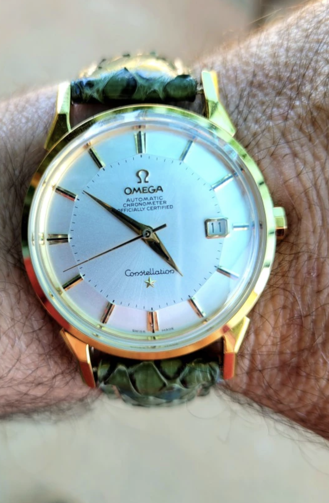

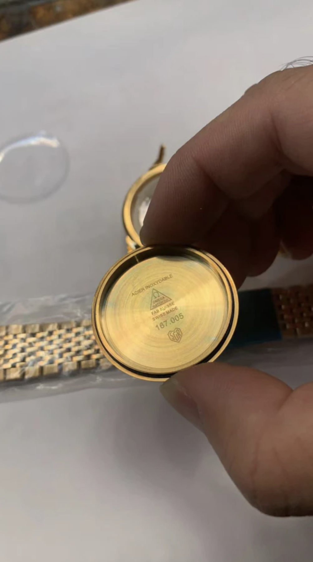

shame they didn’t get the right reference number if that gold coloured case back goes with the gold case and dial with a date that @kaplan shows.
Fortunately, everything about these cases and dials is slightly off if you know what you’re looking at but I’m sure they could easily fool the uninitiated.

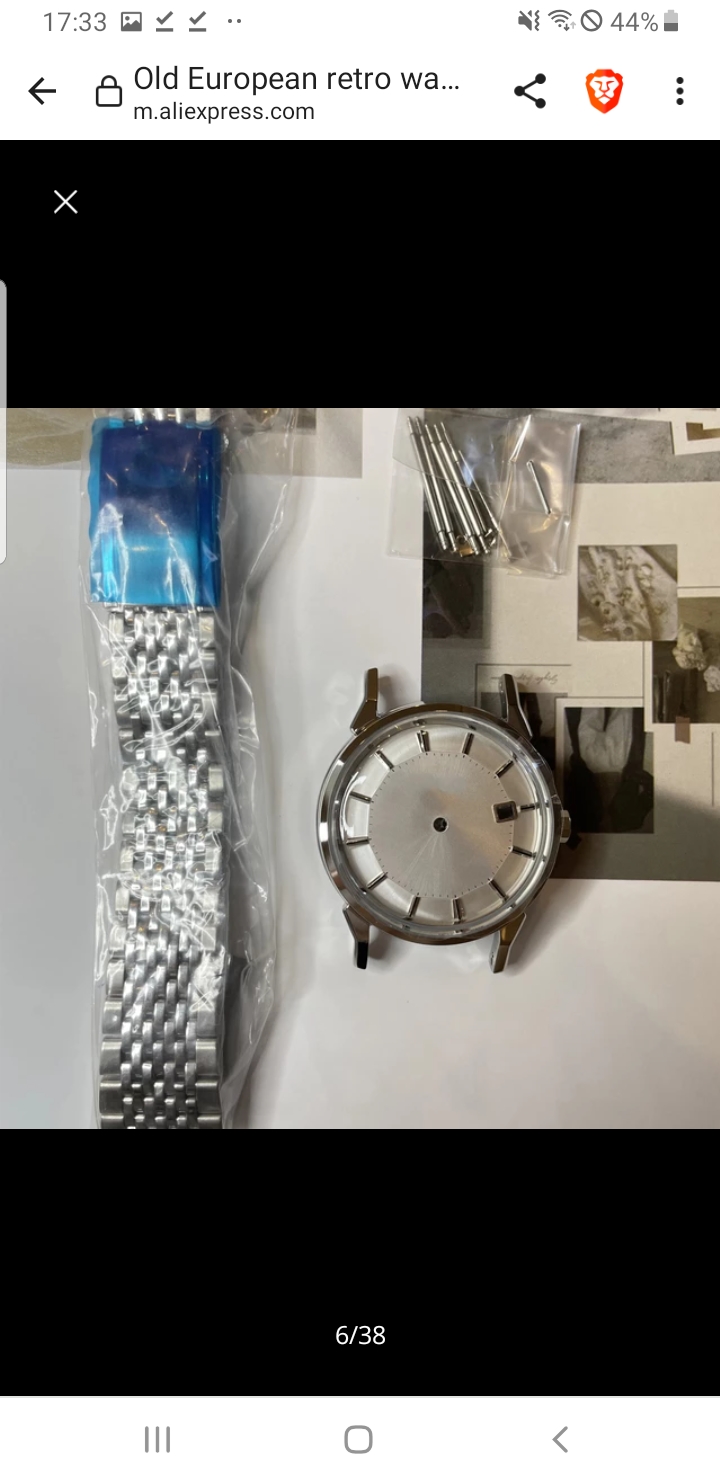

As far as I've heard these existed for quite some time, I'd be more worried if they were aimed at 565 movements like the Seamaster 60's that have been rolling out low key
Edit: For those who don't check the Aliexpress link or stumble onto the post after the store listing is removed, the parts are for Miota movements etc.
We all should report the store listing

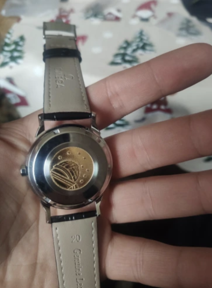

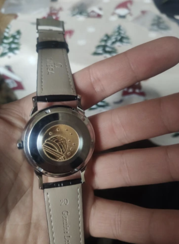

Is nothing sacred?!
Nope.

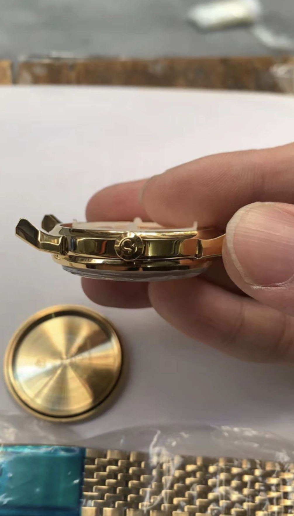

The gold medallion is way too large and the originals do not have bricks in the observatory.
The fakes are getting better.
Scary,

Oddly enough, the size of the medallion leapt out at me too.
It appears to be based on a mid-late 60s medallion ( after the brickwork change ) such as a 168.010.
Whilst the .004s changed medallion types, I can’t ever recall seeing a non-precious dogleg with a brickwork medallion. ( unless someone here knows better)
Regarding the size, if the case is larger, I wonder if the manufacturer thought they should scale up the medallion too. ( I see it takes a fake 20mm Omega strap)
what is pertinent is how awkward looking the fake cases are, illustrating just how good the original designers were at getting things ‘just right’
