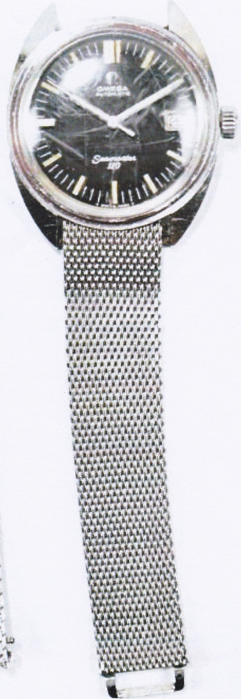

See the attached.
I'm just starting out getting a small collection together. This is the second of three that I have. It was bought at Auction and sent to OMEGA to see what can be done. The idea being that these first watches will be kept for a long time. That's why, within reason, 'cost' is not so important.
Regards the link, thanks. I read it before purchasing. The watch seems to be genuine. A mess, but genuine.

The picture is poor. It's from the Auction catalogue. I was busy at the time and rushed the watch off to OMEGA without taking any myself.
The hands look aged, like the face. But there are many problems with the watch. Some serious. For instance the dial feet are broken.
