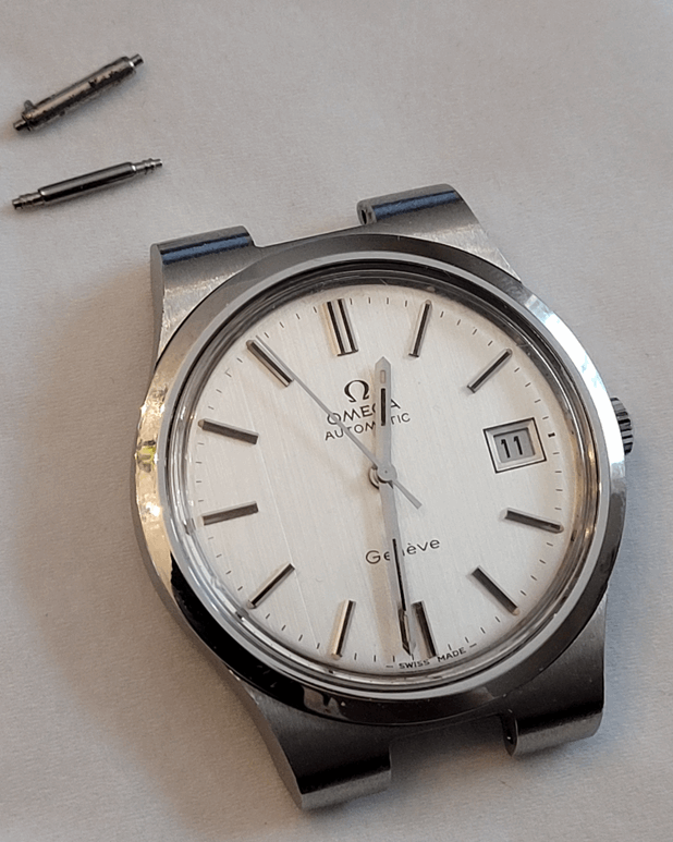

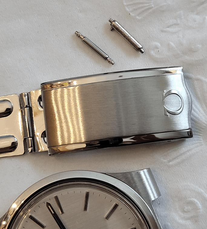

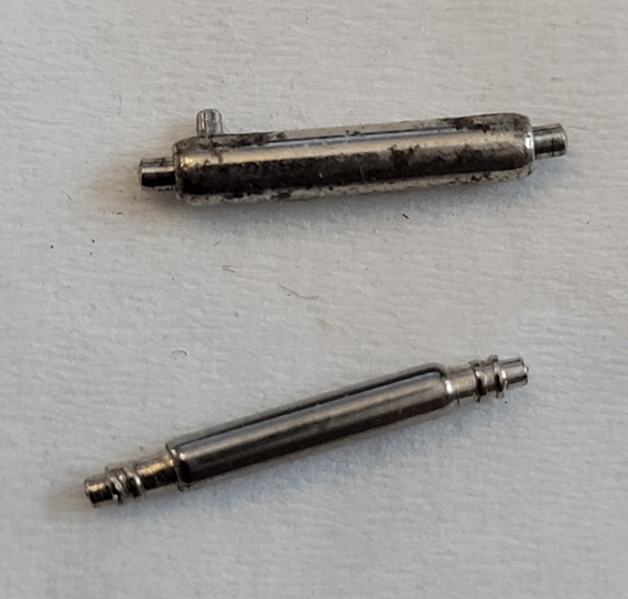

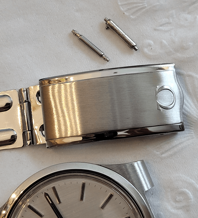

I just got my first vintage Omega (1973 Genève), and one of the spring bars connecting the bracelet to the case is incorrect (1.5mm instead of 1.8). I would like to replace both of them just for peace of mind. The lug width measures at a tight 9.5mm, and because it is an integrated bracelet it appears to be set up for a quick release spring bar (came with one).
What brand spring bar should I get for the best quality and reliability, and what should be the actual size for this watch?
85
56

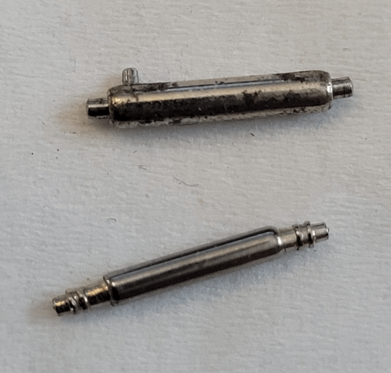

The 1.8mm quick release has a pin size of 0.9, and the 1.5mm spring bar has a pin size of 0.8. Doubtful that either of these are original.

The sizing is a bit mystifying. Are they all in round mm lengths? My lug spacing is 9.5mm, and the barrel of the one 1.8mm pin I have measures 9.38mm in length.
OK, so I measured both of the bars that came with the watch, and the 1.5mm diameter spring bar collapses to a length of 10mm. I suppose this is possible because only one pin needs to be compressed in order to remove the spring bar. Perhaps I should be looking for a 10mm spring bar (this would be much easier).
